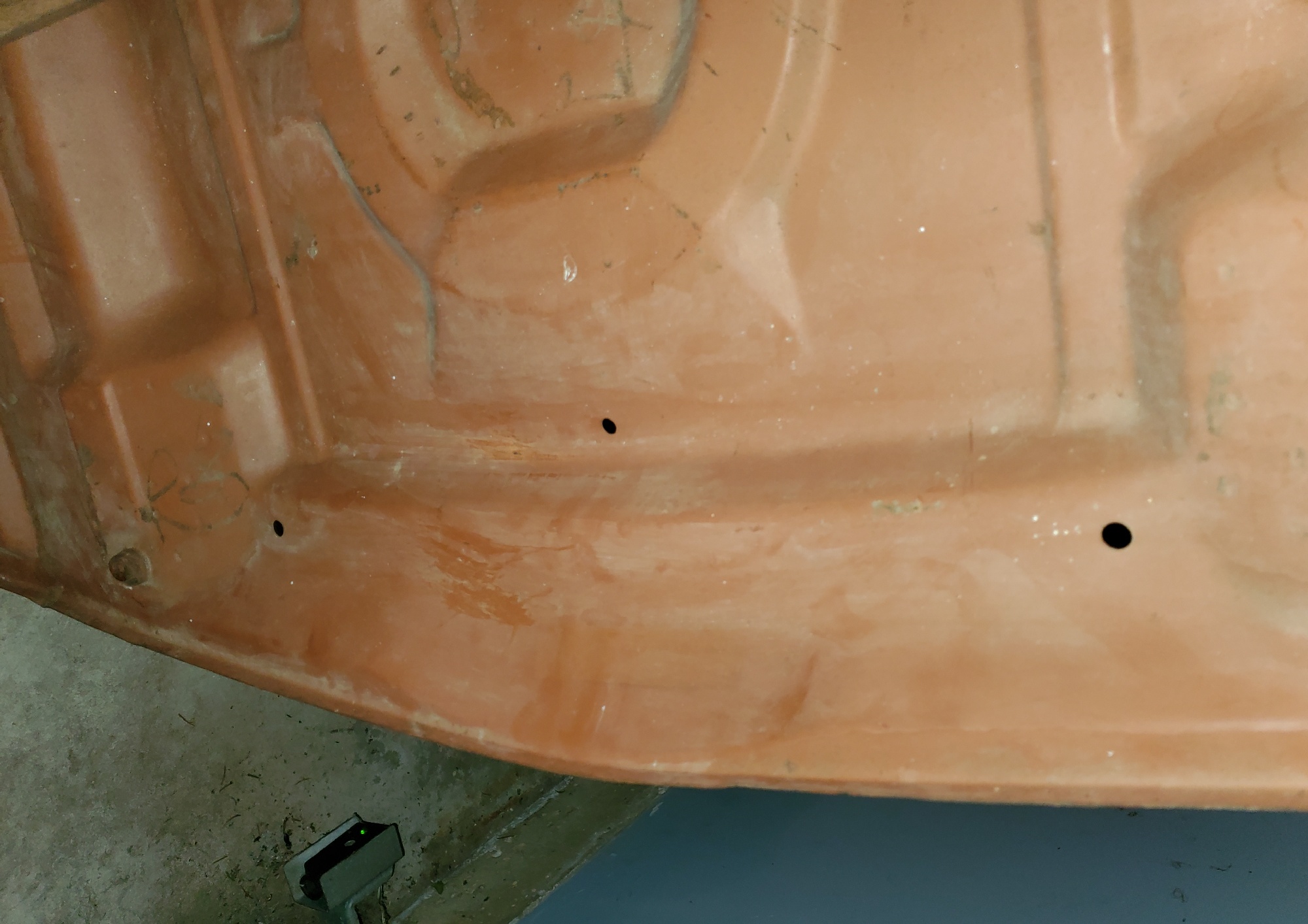

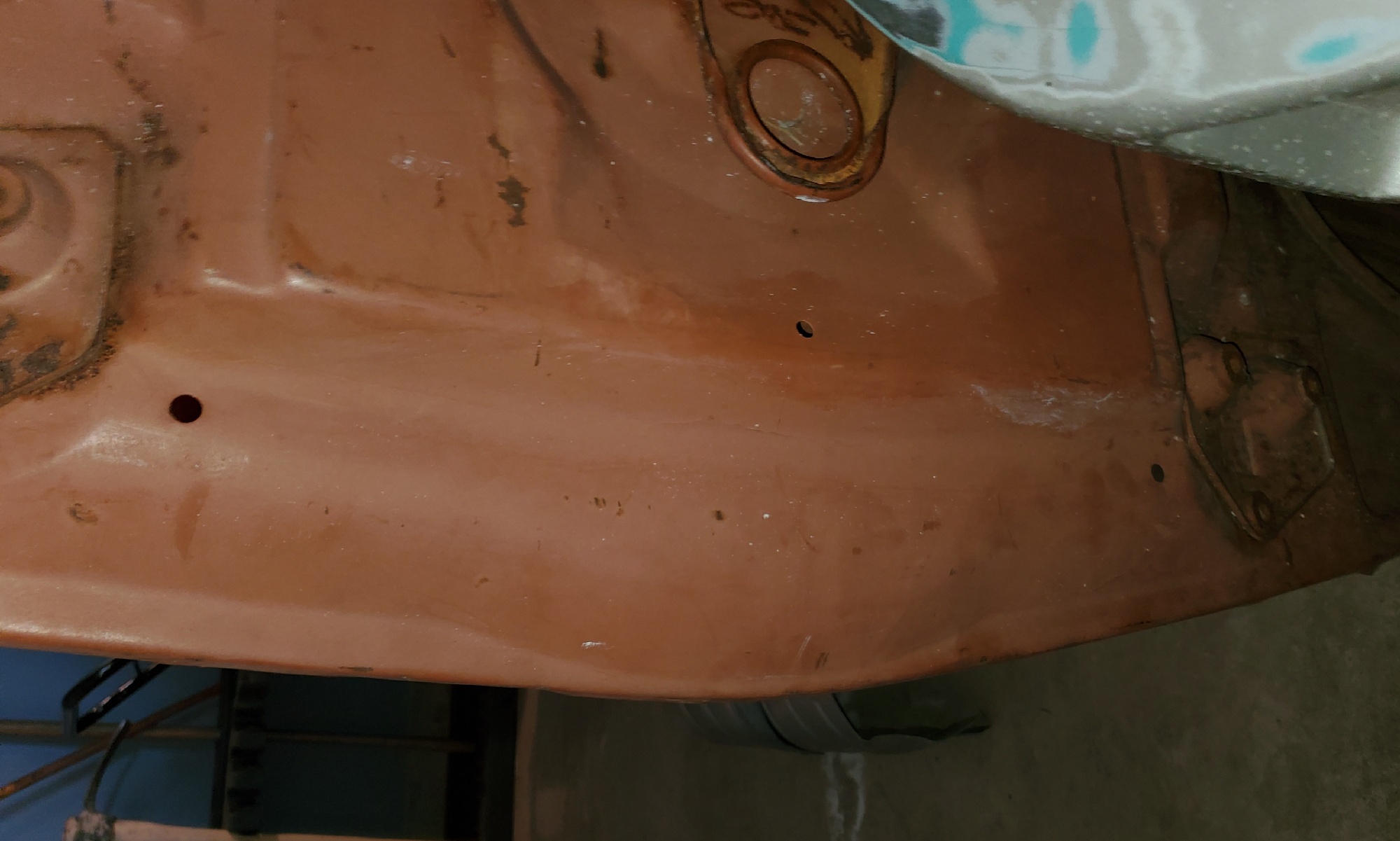

gms
Luke,
Here are some pix of my NOS floor pan

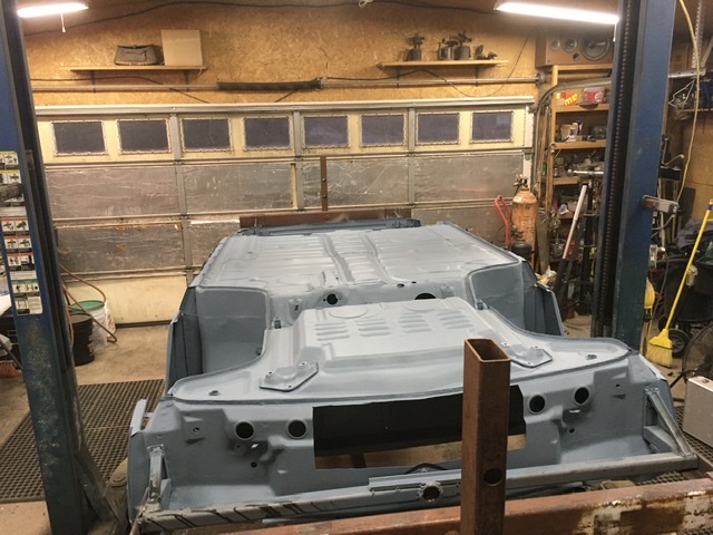

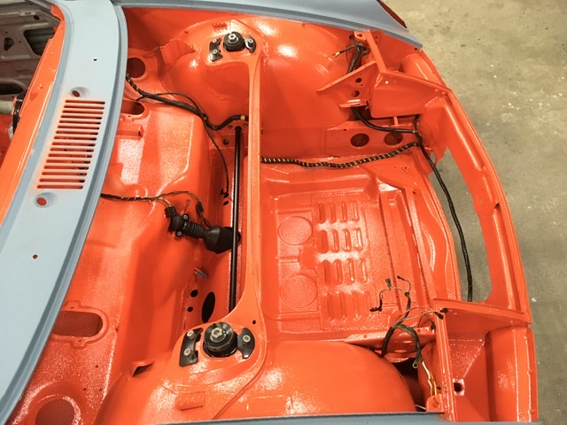

mate914
I used POR 15 inside all and out side all..... it has something to do with where we live.

Luke M
QUOTE(gms @ Mar 18 2021, 07:36 AM) *
Luke,
Hi Glenn,
Thanks for posting the pics. Is the section circled flat then has a recess for the spare tire ?
I may have to fine tune the pan a little more.
