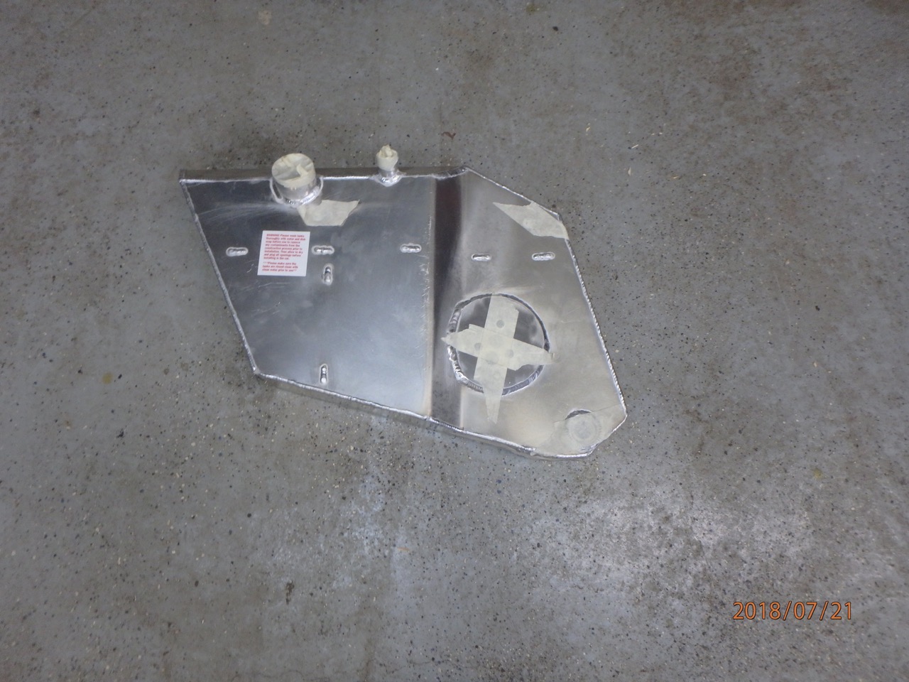

First up new oil tank.
Yes thank you Ben. I do have two factory original -6 tanks that will stay on the shelf. I see no need to spend time to clean restore, patch or what ever else I have to do to make them right.

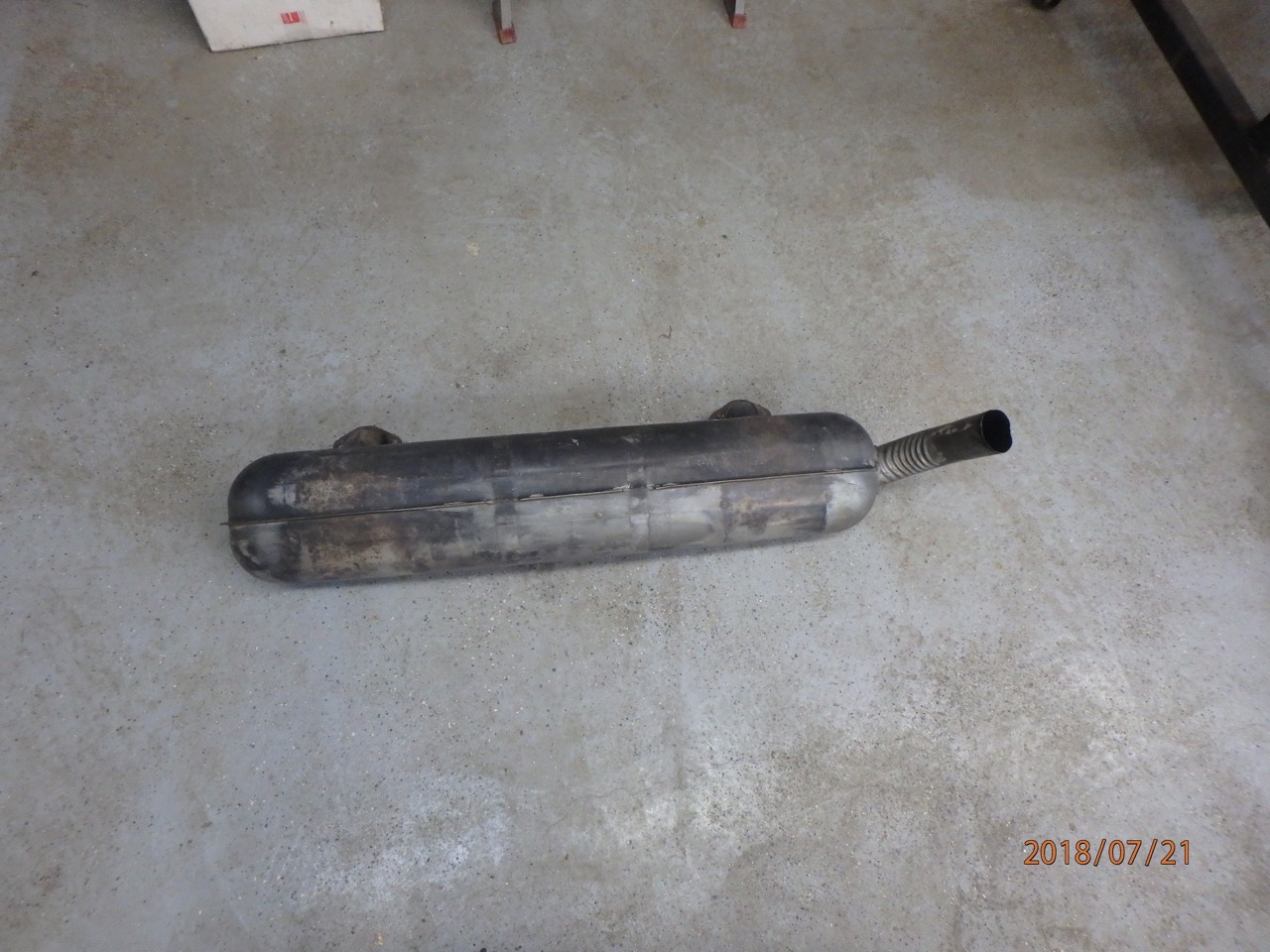

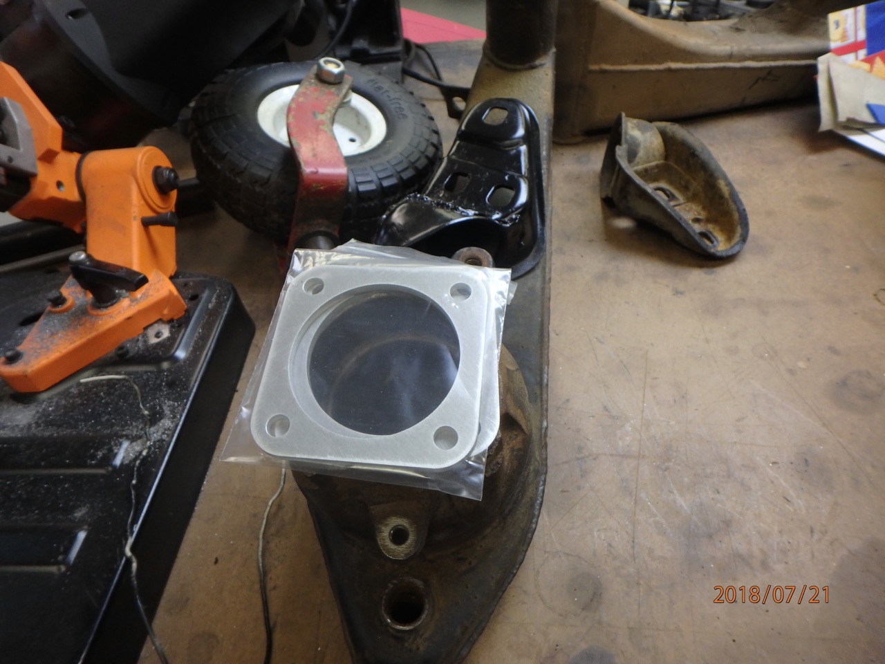

Pete and I traded some parts a while back, and I got this supper nice muffler off of him. Again have the factory stock part, but this one will work nicely.
Just needs a bit of cleanup, and has a nice chrome tip

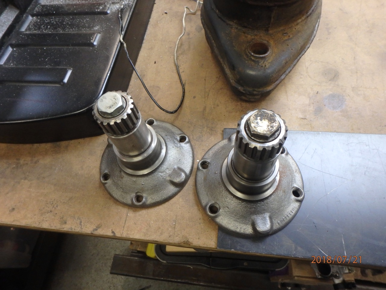

108 transmission drive flanges and bolts.
Bolts in backwards so I don't loose them

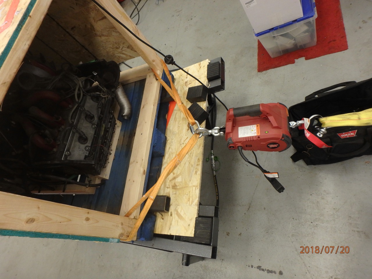

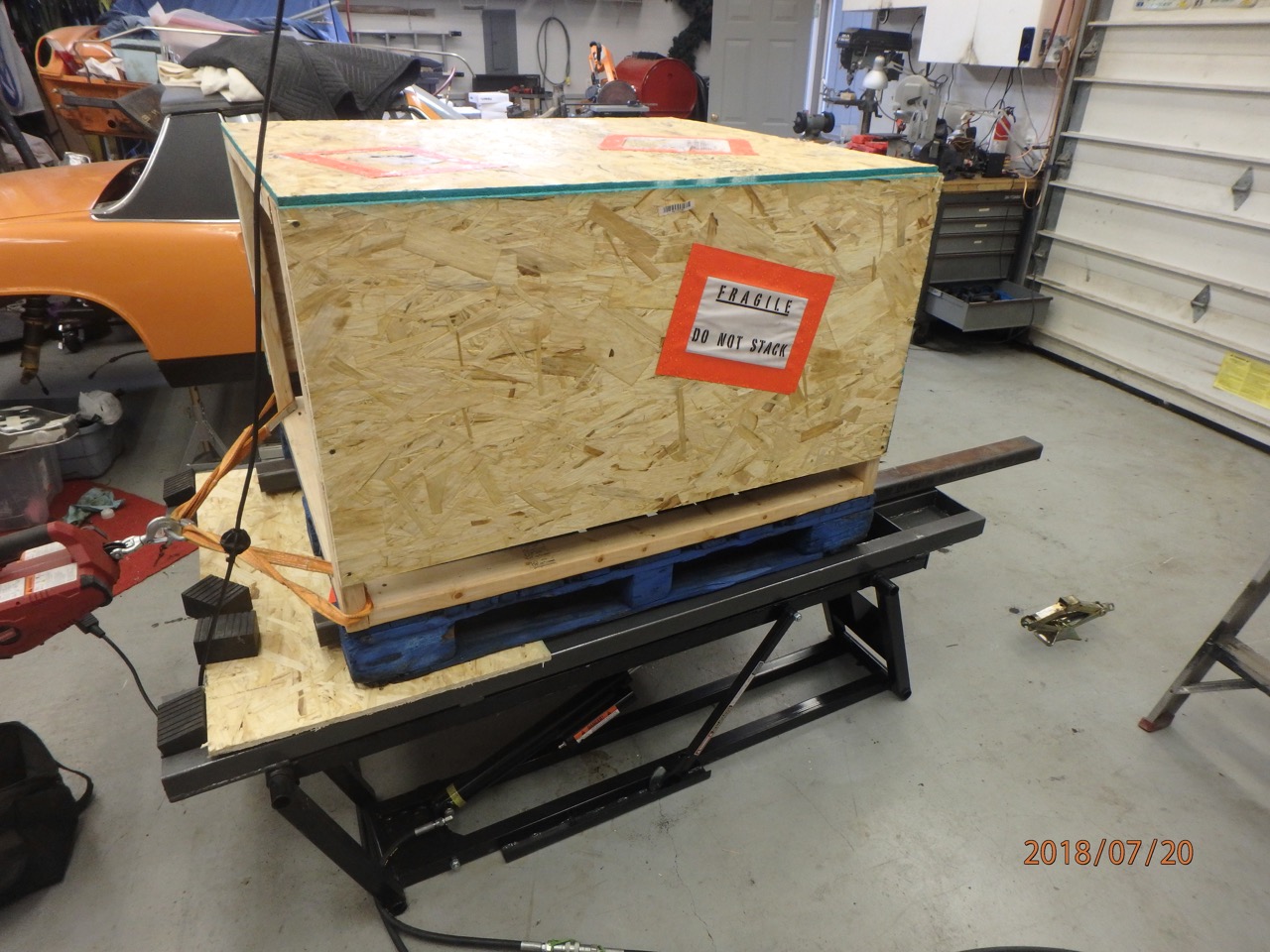

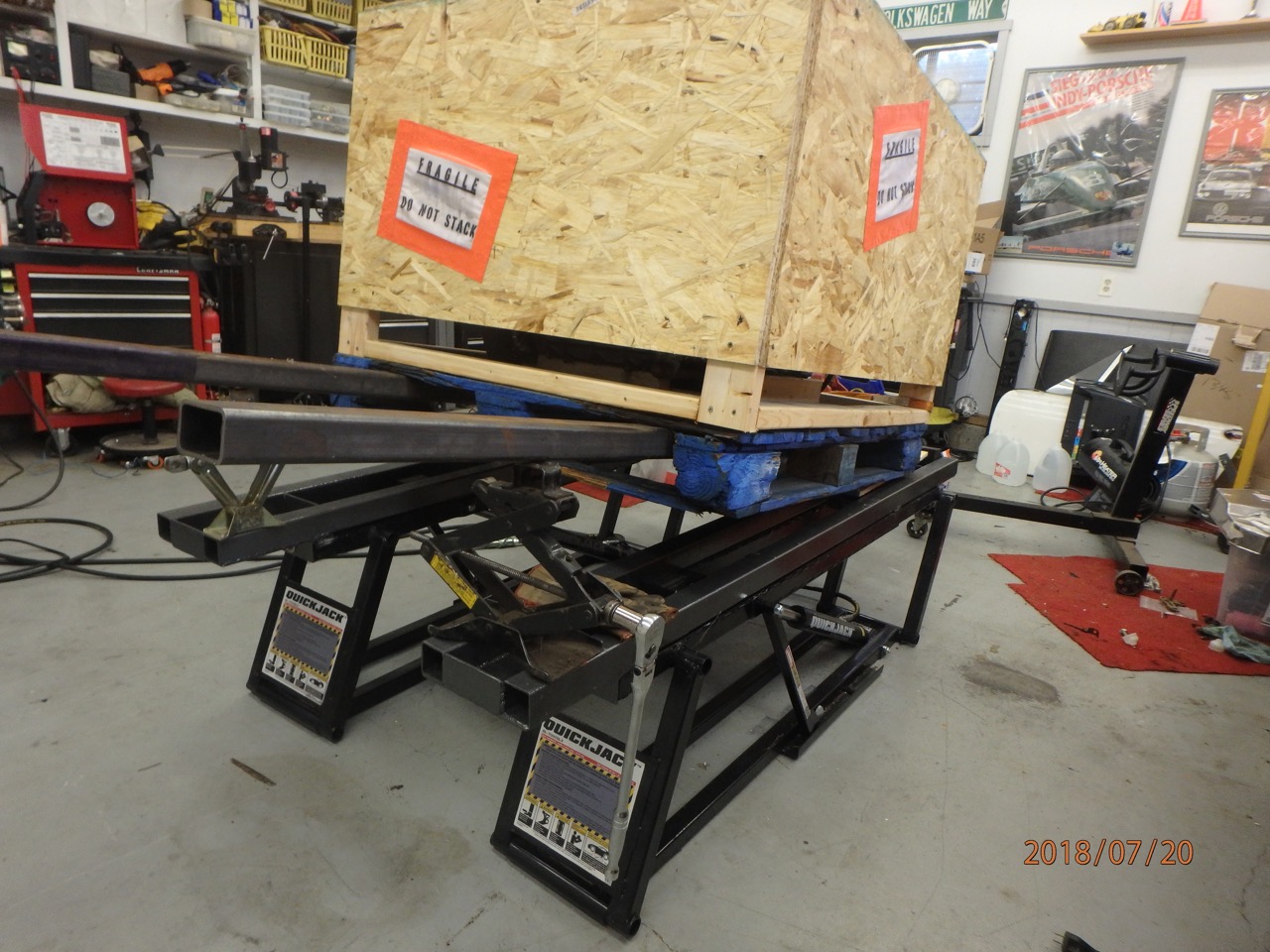

Finally got the 2.7L 911 engine home, had to unload it out of the truck. I really need a gantry, normally I have a tractor around with a front end loader for this stuff. So I had to make due with what I had.
Used my Warn winch to pull it off the truck.
Several tense moments and it was out and flat on the lift

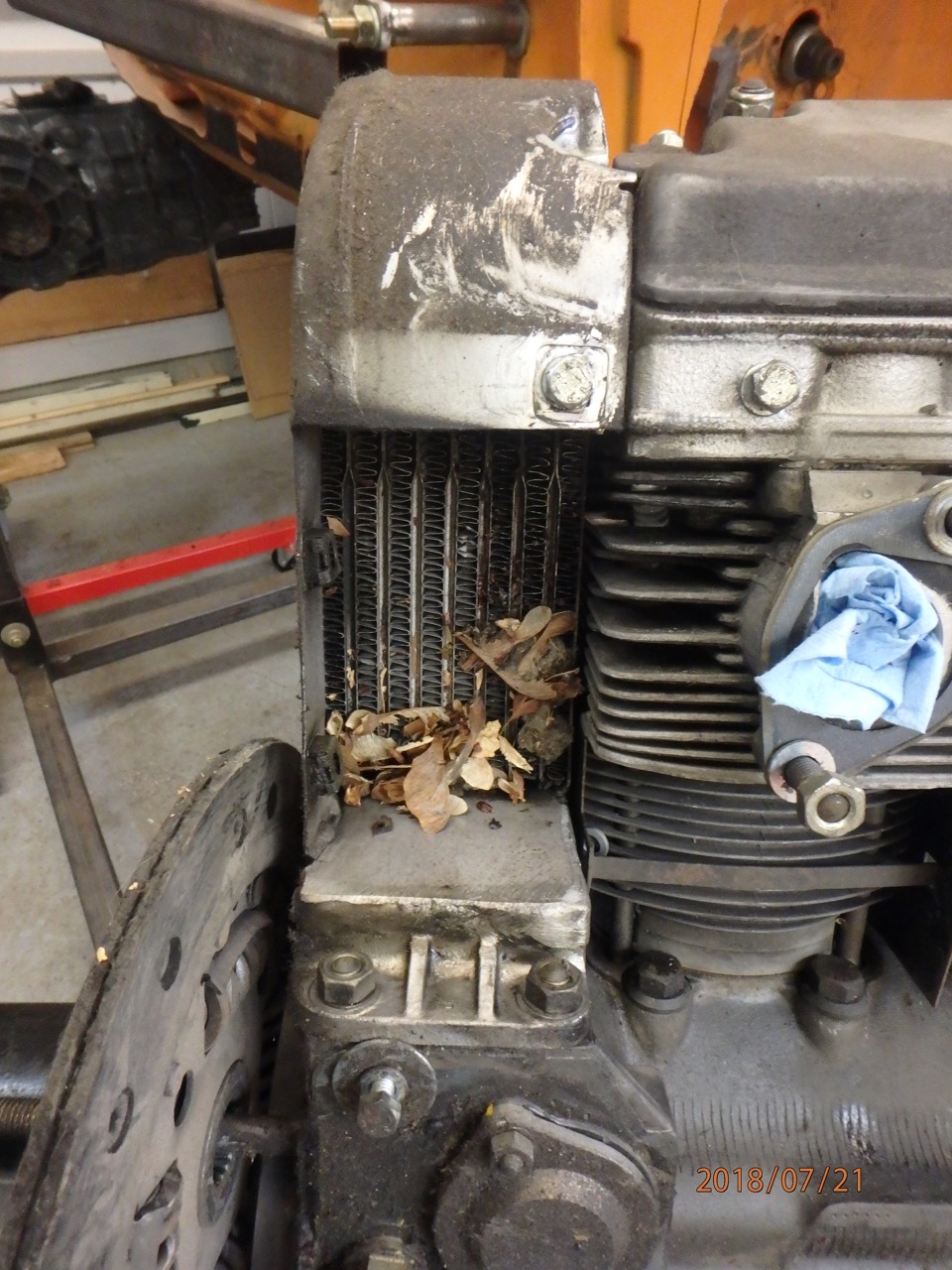

Only thing out of place was these.
Maple seeds seem to get into everything.

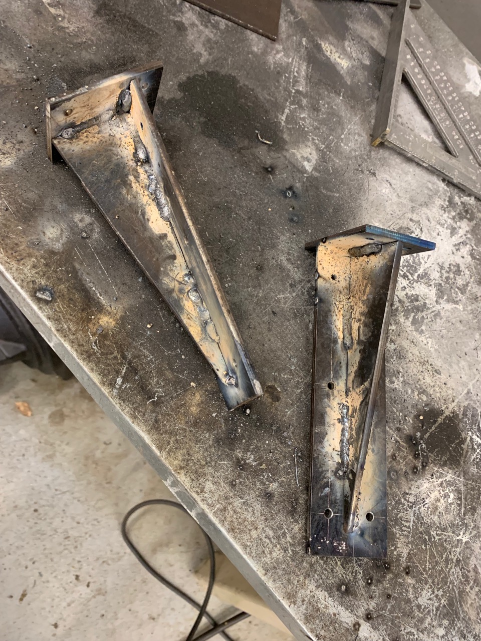

Very ugly right now, I will clean them up and get them coated.

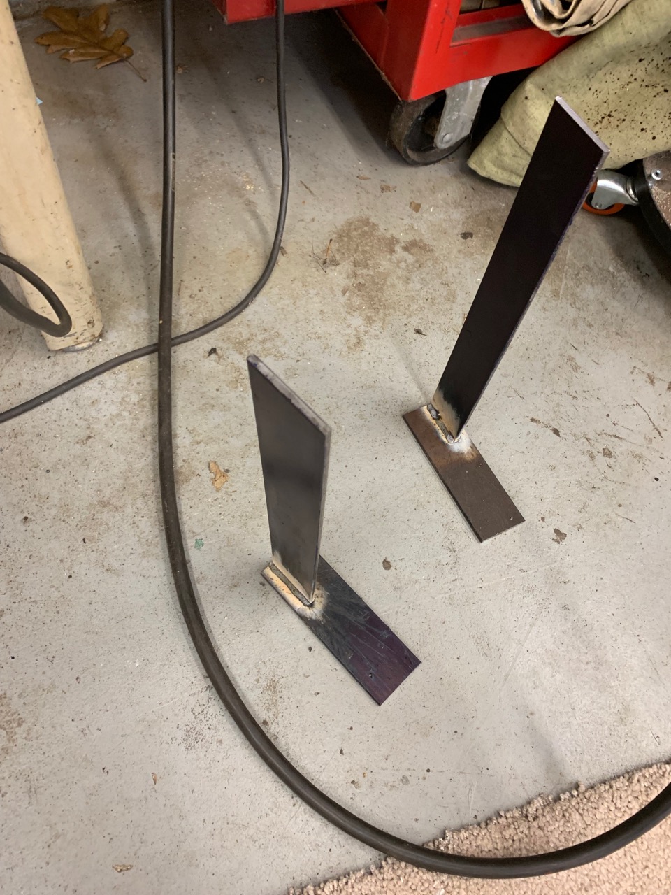

Wife had an item on my list also. We purchased a new bed frame, the old one had an incident, that left it a bit less than desirable. So I have to make new brackets to mount the old headboard to the new frame.
Slots where done using my Sherline Mill, fells good to make some chips fly again.

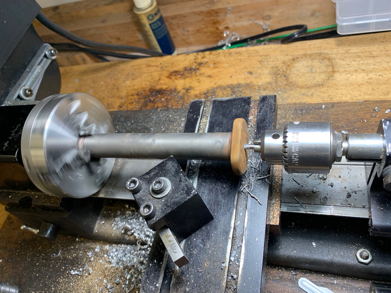

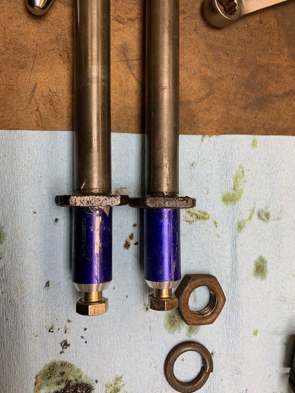

So that made we think of other things to work on. I have and I am in the process of purchasing the world supply of 914 H&H rear swaybars. screwy.gif I do not like the funky linkage they have on them, idea.gif I can fix that.

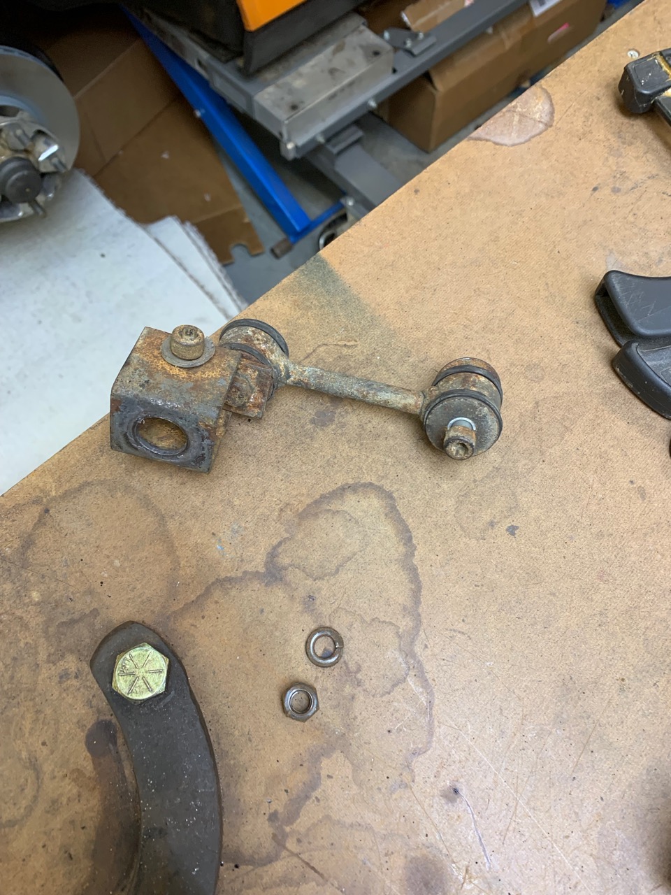

First up get the dang things off the set of shock bolts I got with the setup. smash.gif

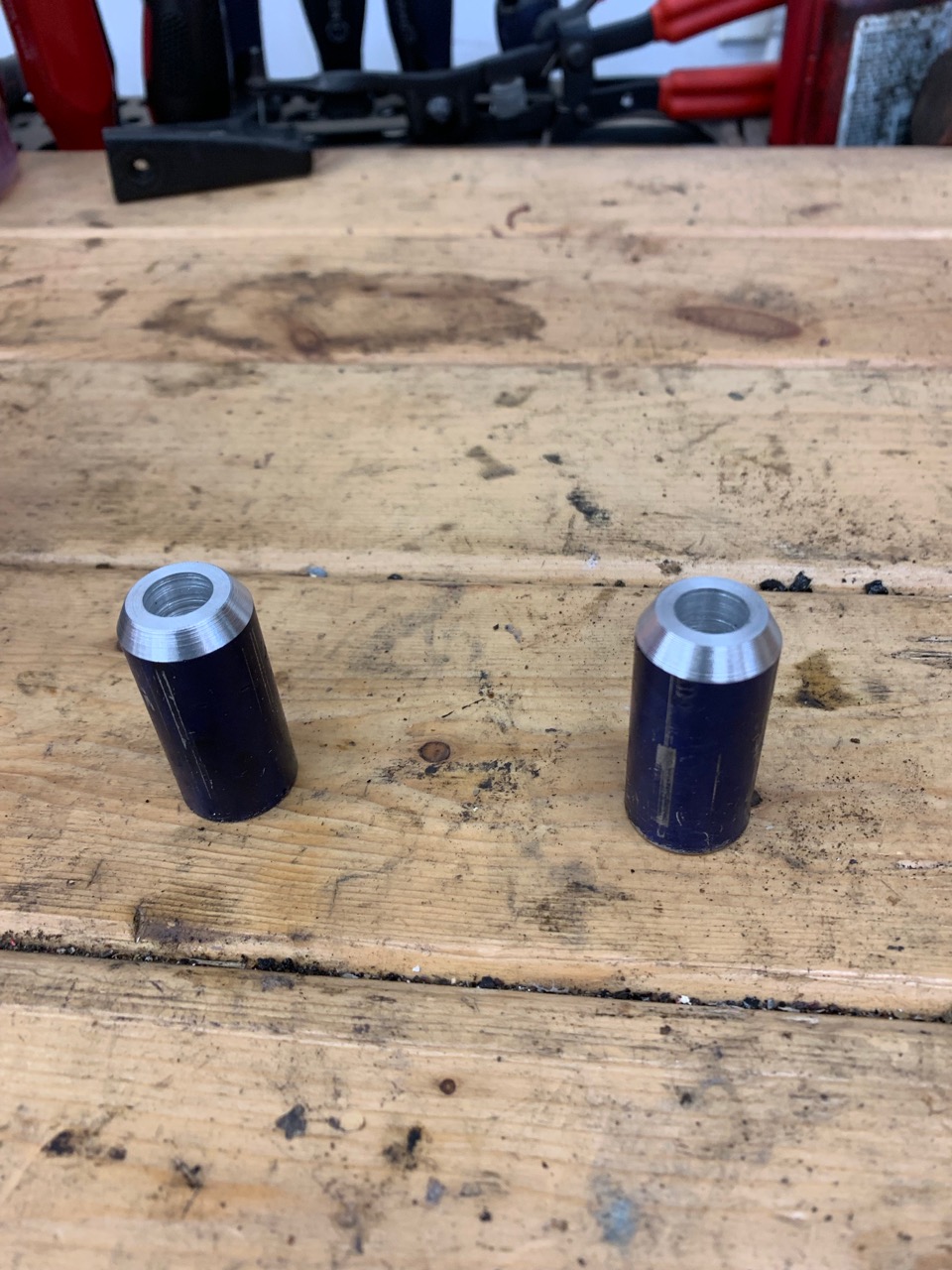

Next up take the bolt over to the metal lathe and make more chips, and curly Qs, oh this is so much fun.
I centered it, then drilled it out to 5/16" to then tap it to 3/8-16 so I could install a bolt into the bolt.
Next up more chips flying and I had to make the spacers to get the drop links to align with the trailing arm and the swaybar arms. And this is what I came up with.
They are tapered at the end to allow the rod end room to pivot.
And all done.
Need to clean up, and get them anodized and plated. These little projects took longer than I wanted today, but I had a lot of fun, got some machine time in, got some welding and fabrication time. I can't complain.
