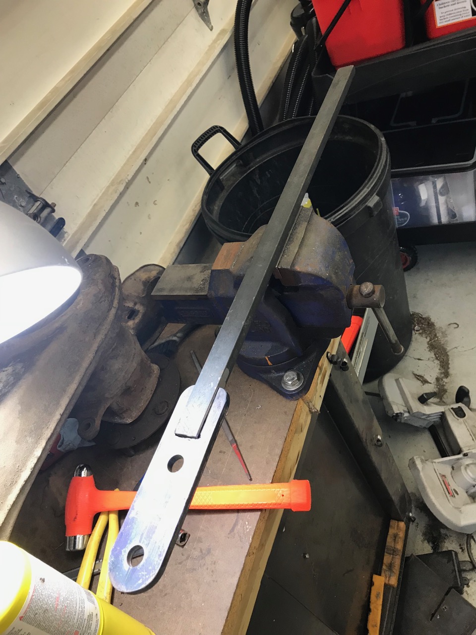

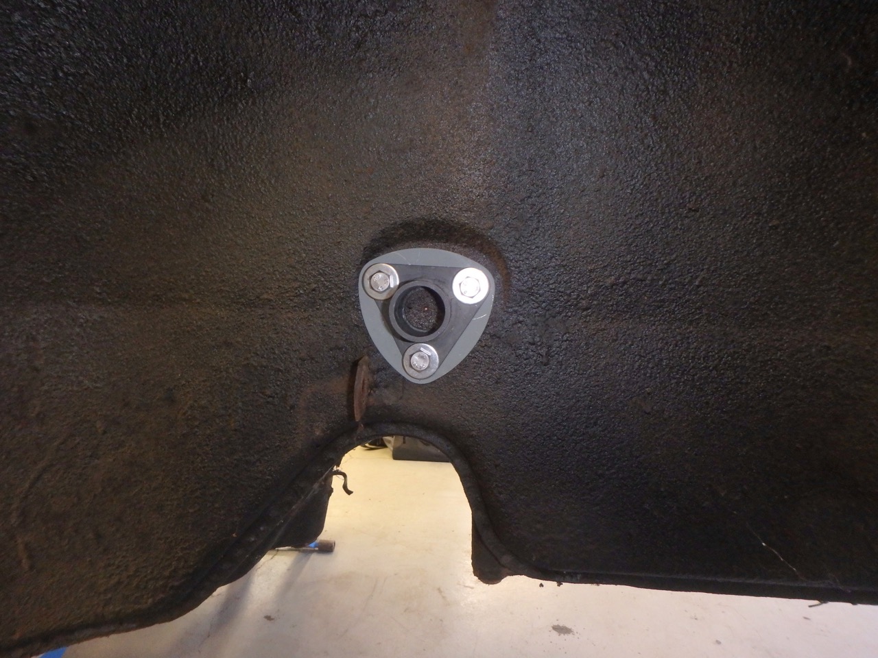

got in the shop tonight, and finished up the swaybar installation.
Not as smooth as my roller bearing mounted swaybar on the EG conversion, so I need to add a bit of machining and a grease fitting, to give them a little less friction. That equals more lathe and mill time. piratenanner.gif

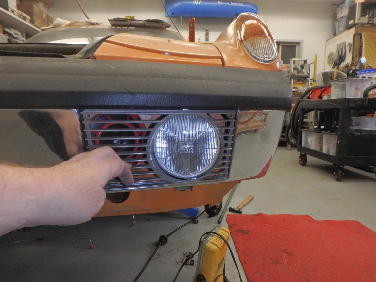

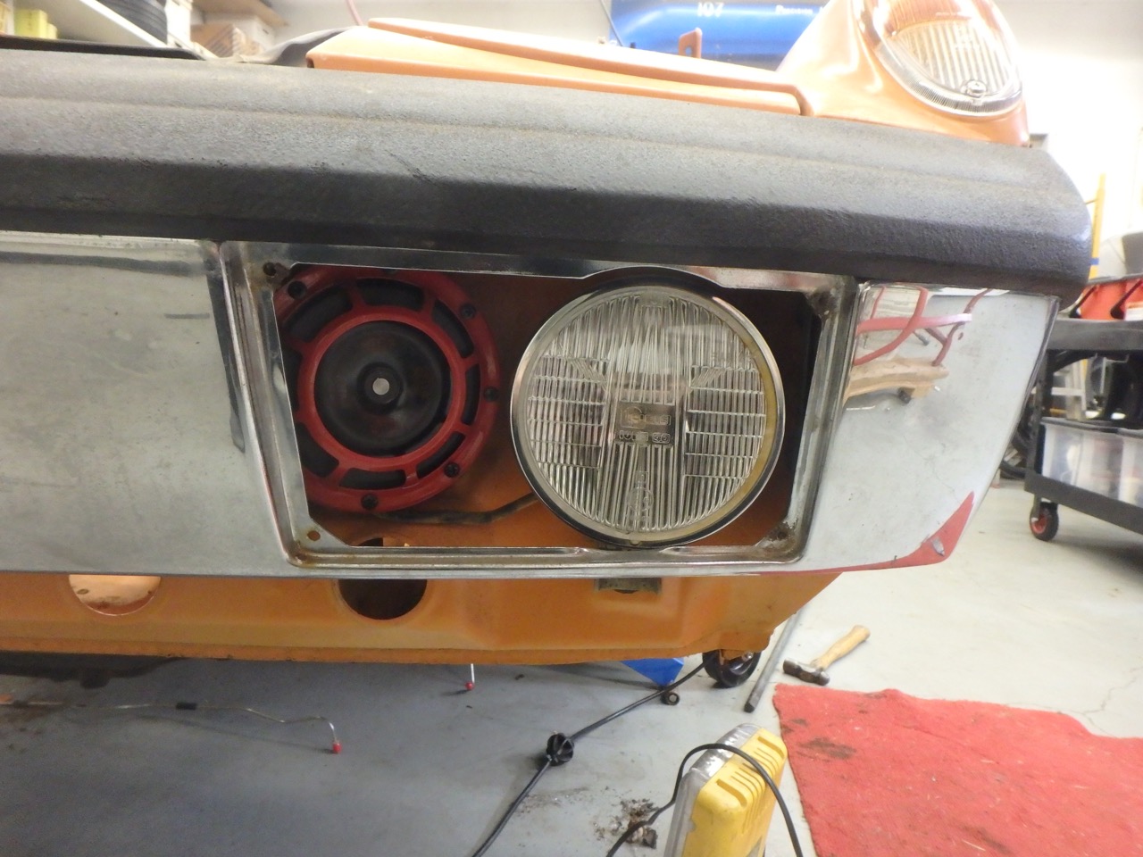

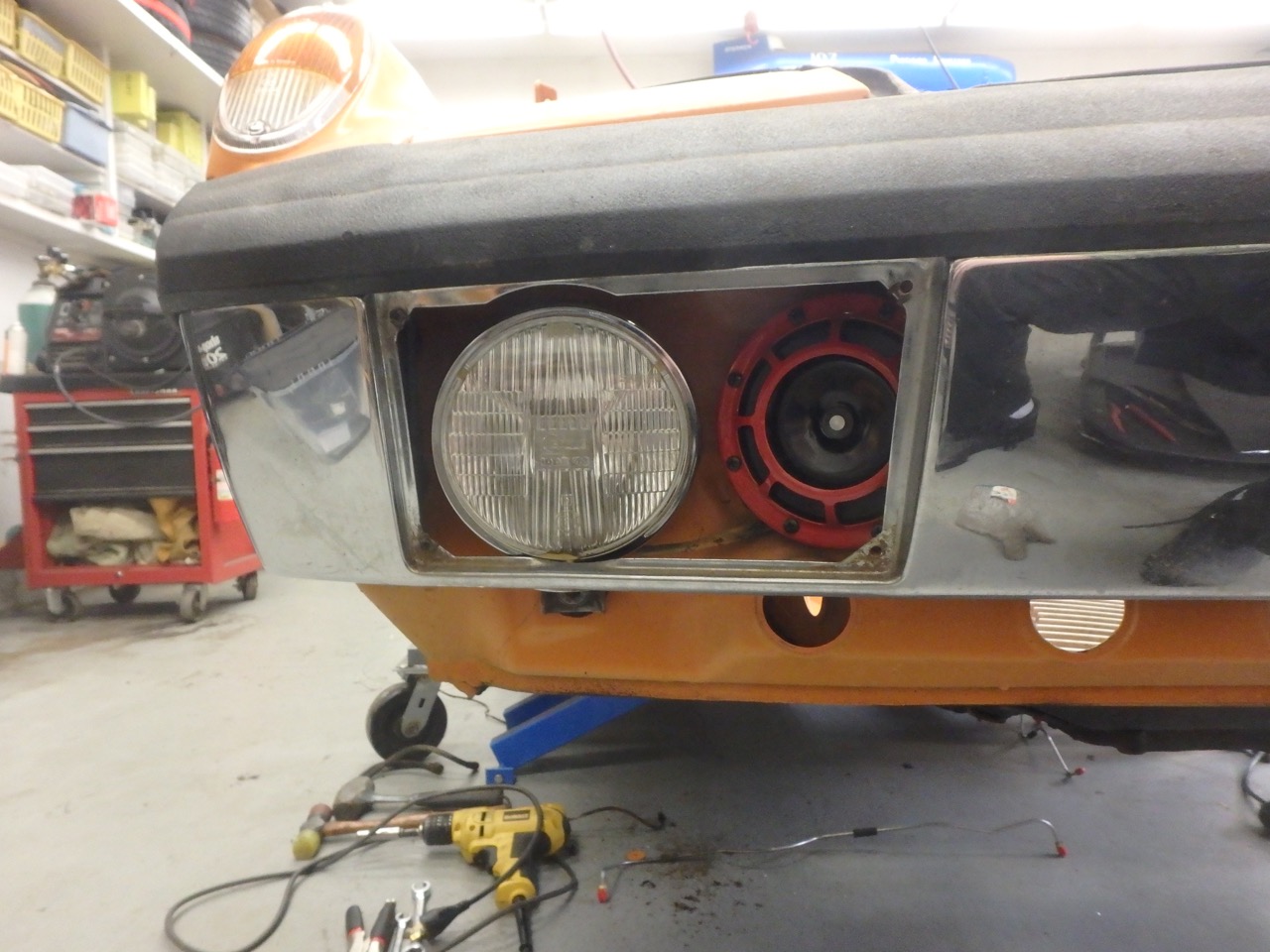

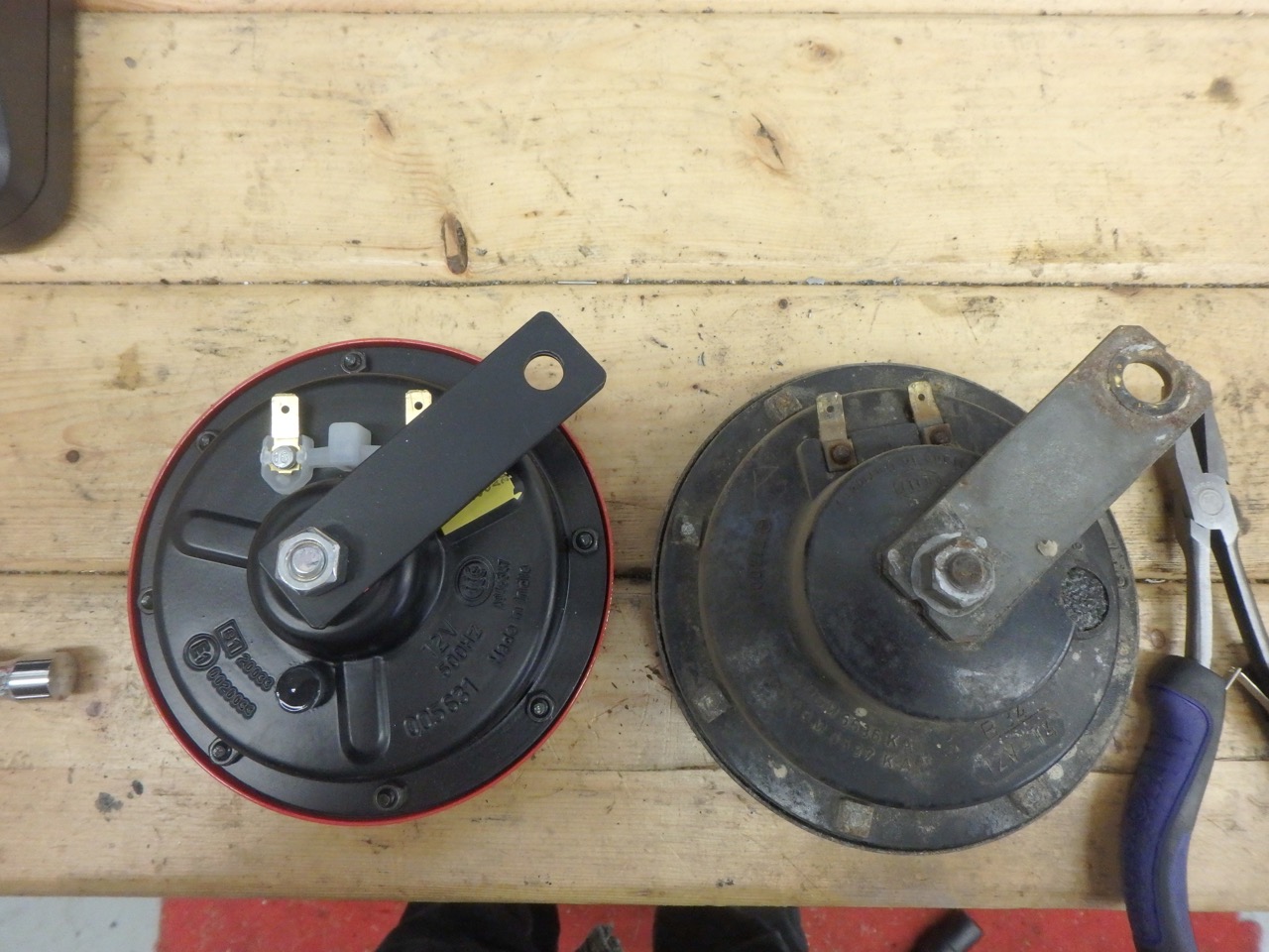

First up horns, each bracket needed to be clocked correctly. And the electrical posts needed to be bent from 90 degrees to 0 degrees or maybe 1-2 degrees if your wanting to be picky.
The Horns are Hella SuperTones, 130dB Might keep somebody from running over the top of the 914. dry.gif

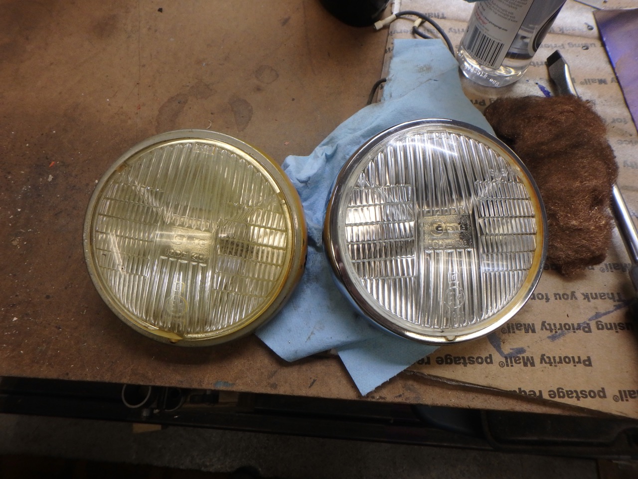

Next up cleaned up the Cibie Friving lights.
Both sides mounted up
Need to find some SS screws to mount the grill covers with, anyone know the screw size off hand?

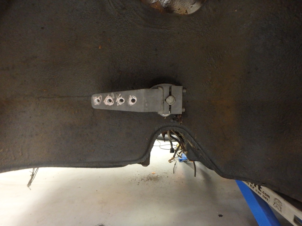

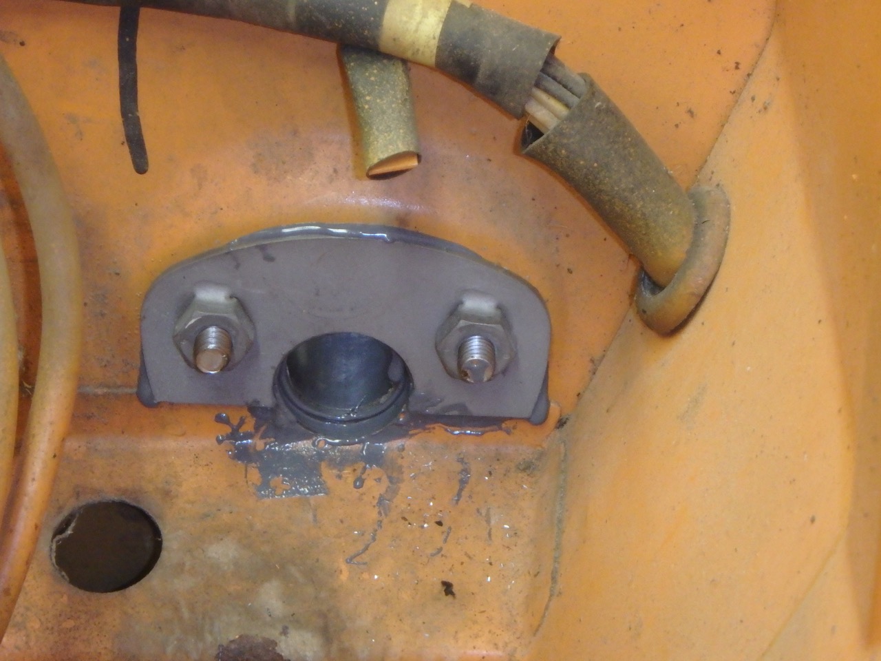

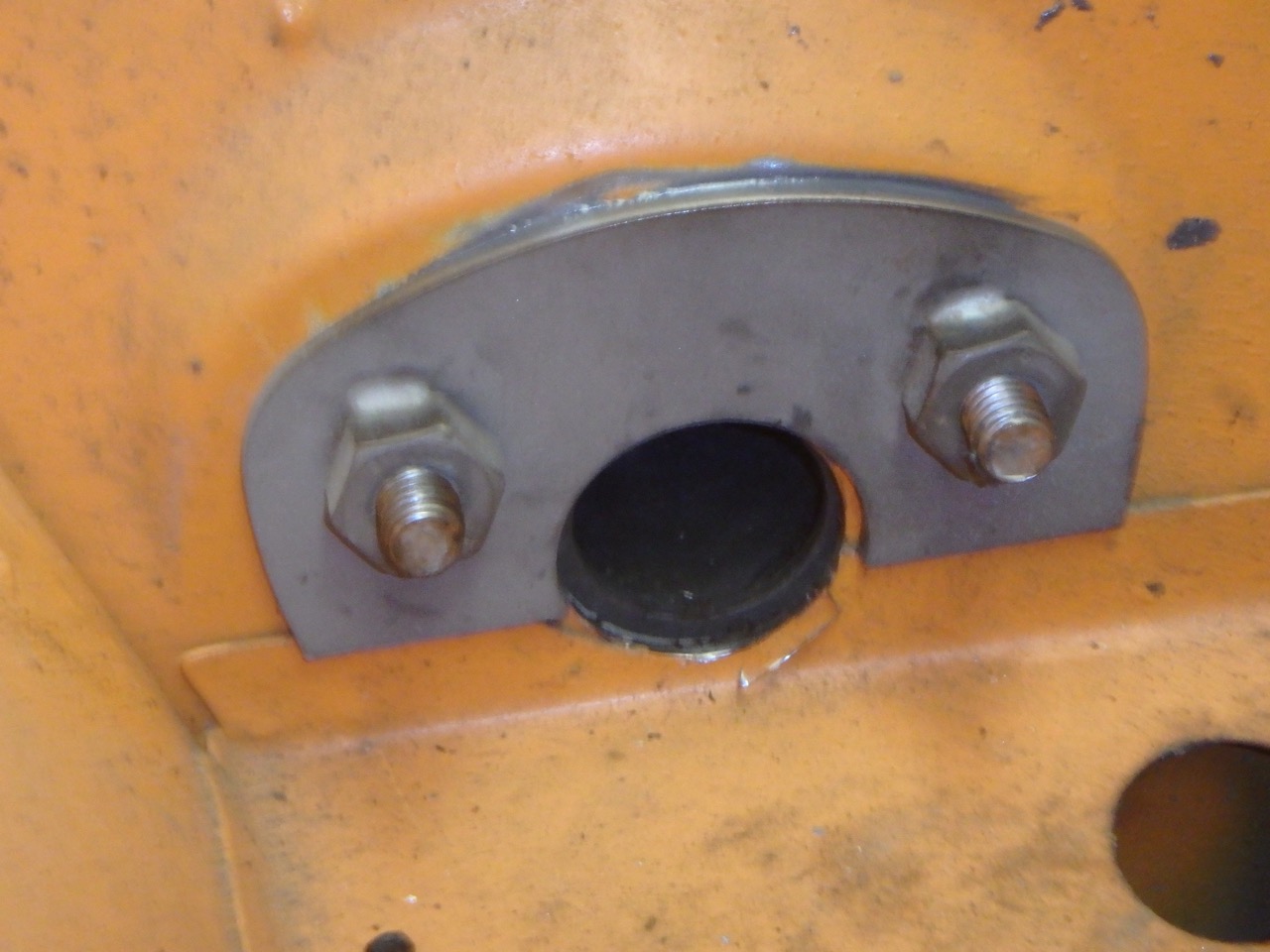

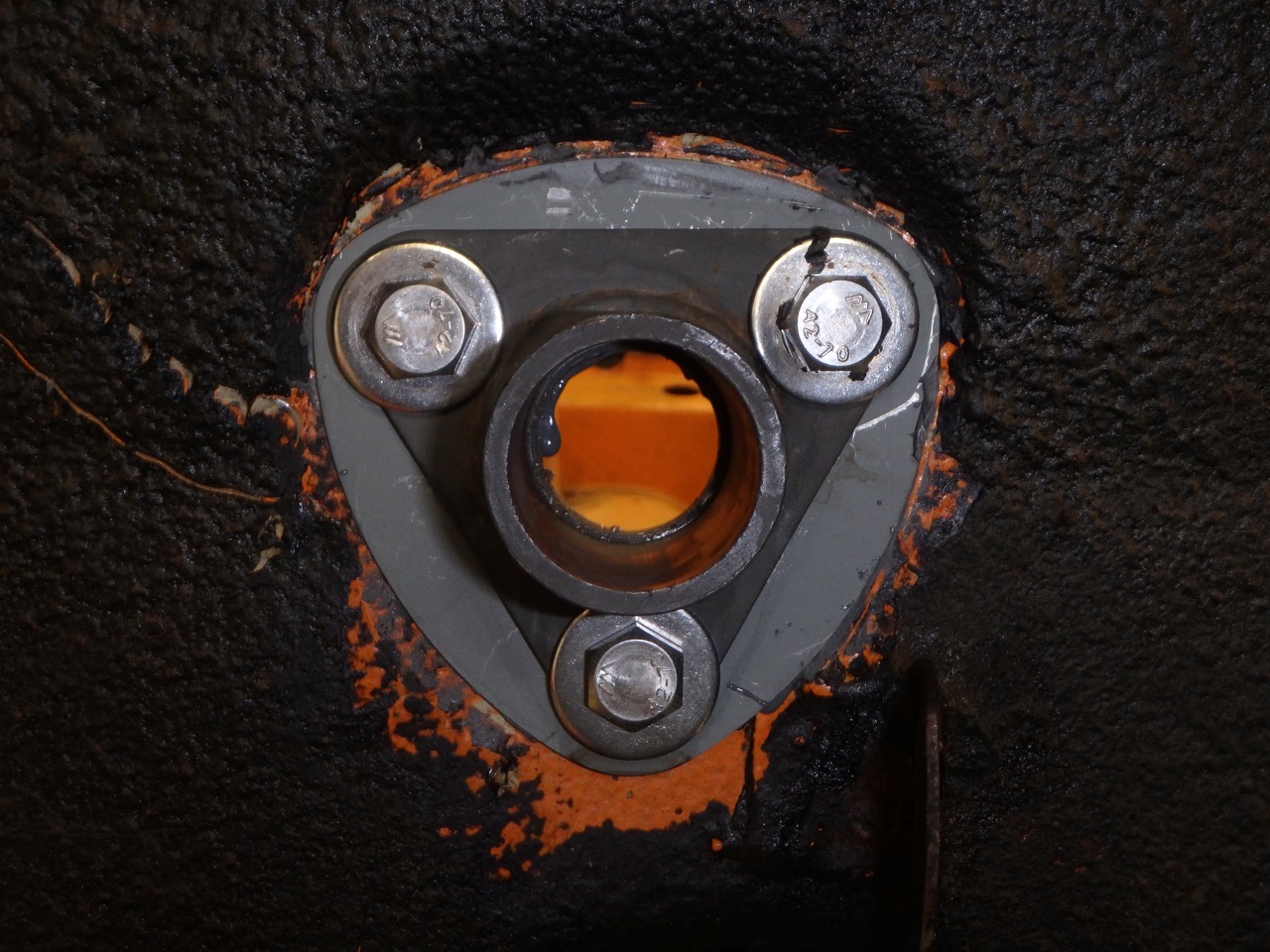

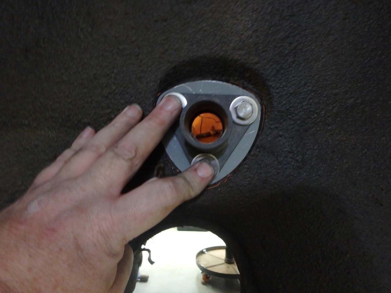

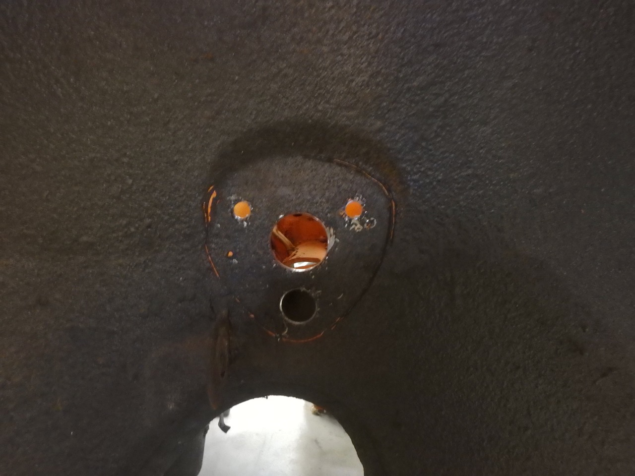

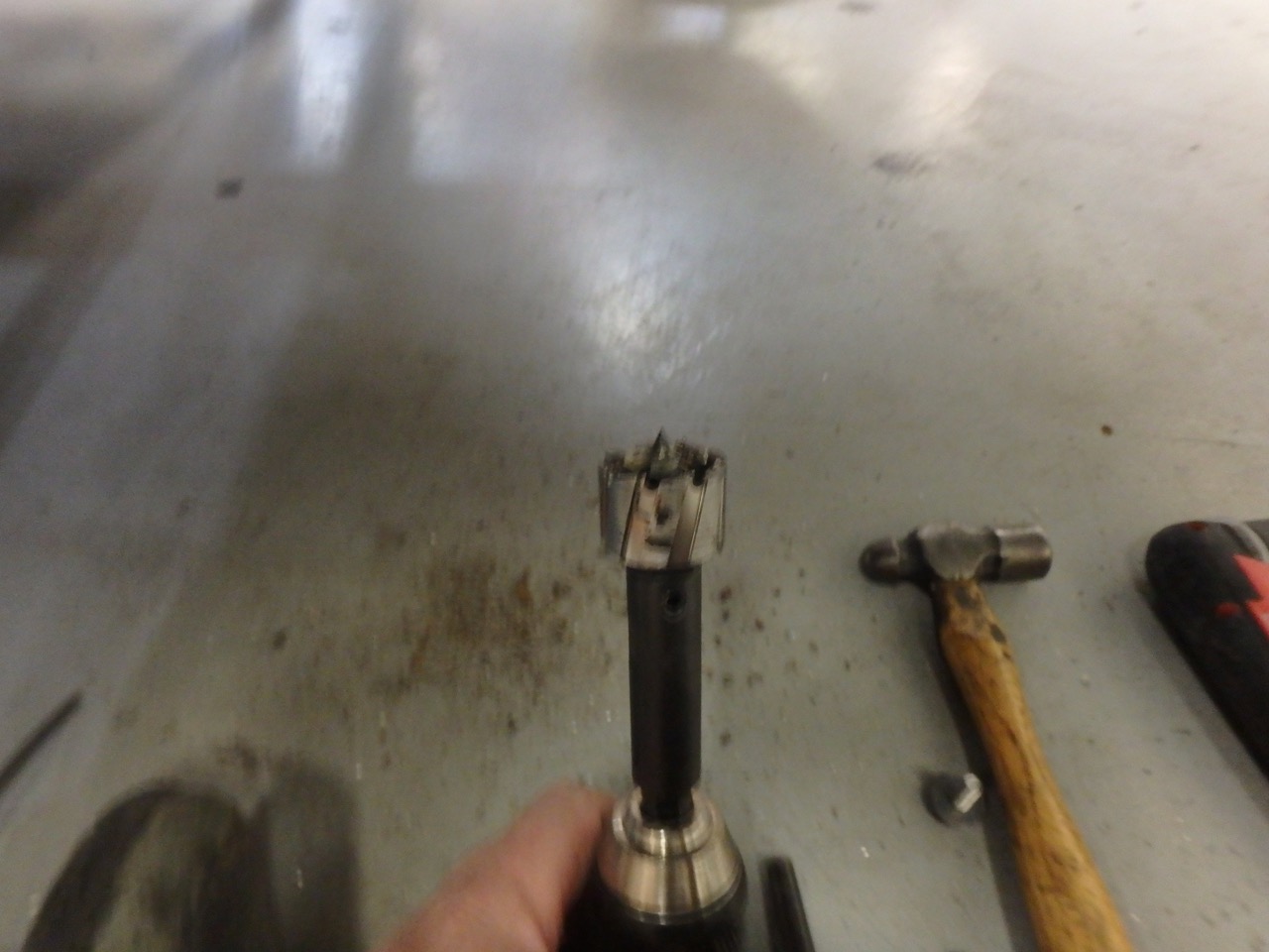

Back to the sway bar installation
JB Welded them in. Brad says that will work, and in reality your clamping these, and just keeping them from falling down behind the gas tank. That would suck.
If it becomes an issue, it is not like I don't know my way around welders av-943.gif
In the wheel wells, once set I will hit them with a top coat and then undercoat them. Just to make it match what Dad had done.

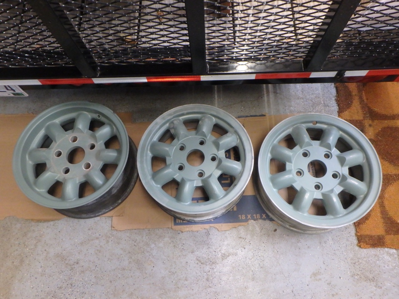

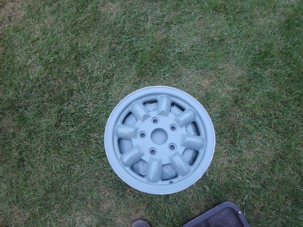

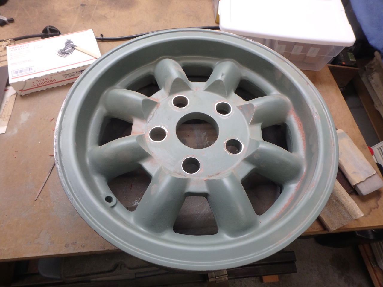

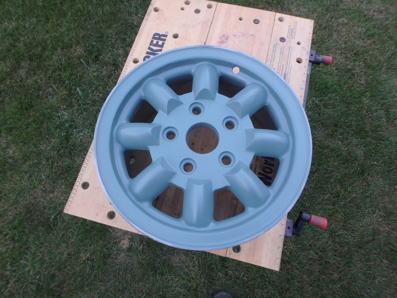

Been working on my second set of Mini-Lites the first set is going up for sale.

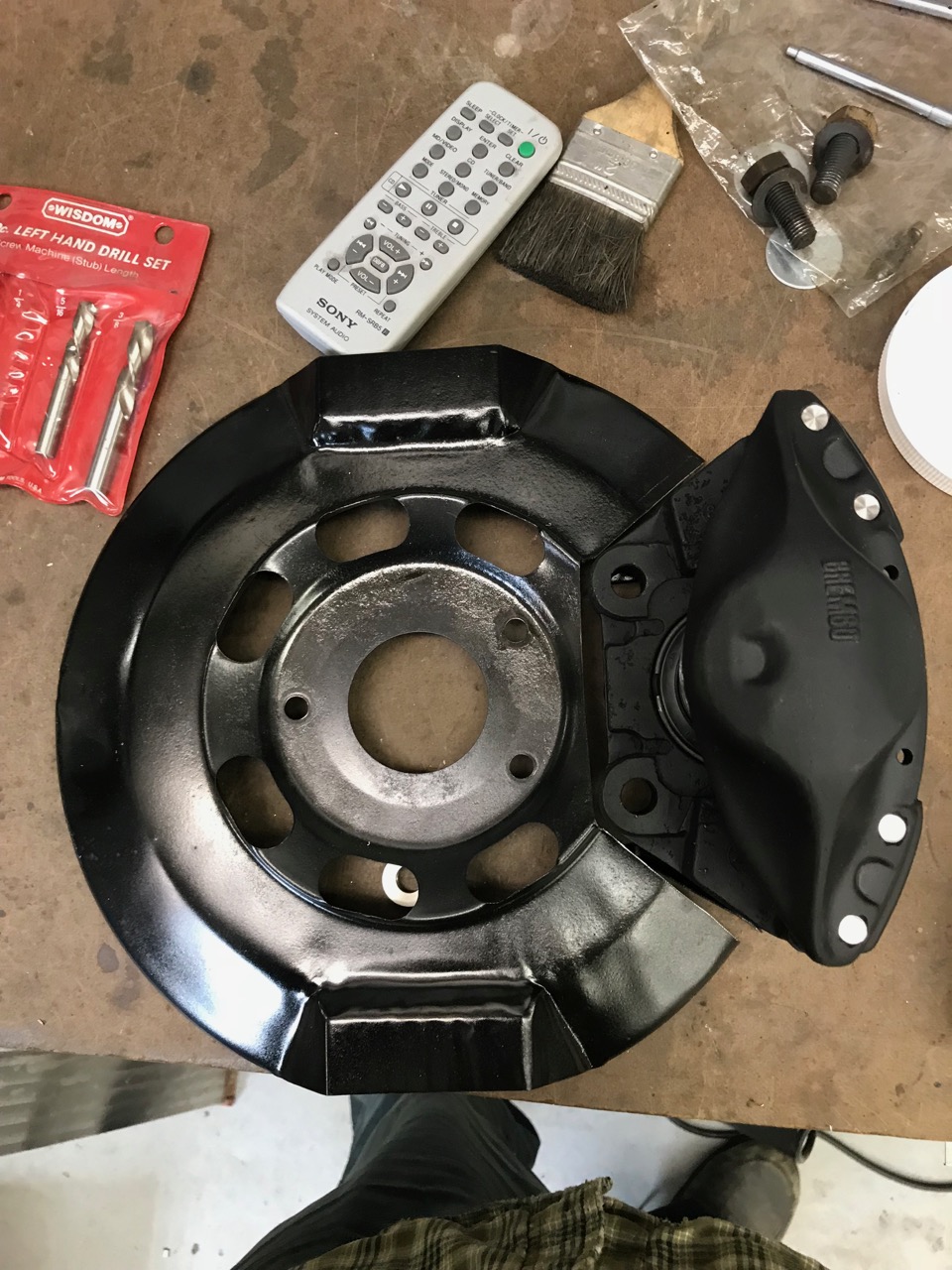

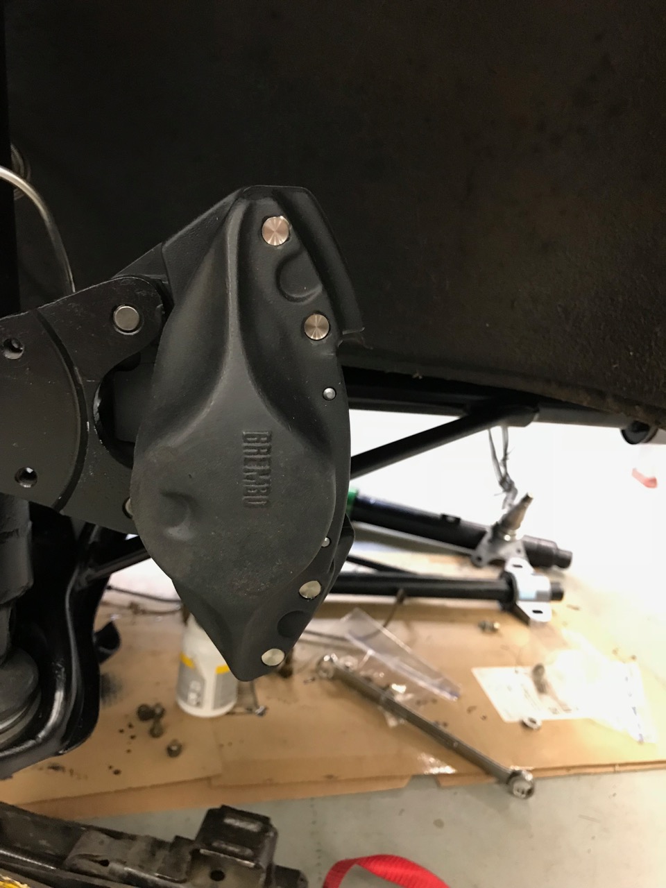

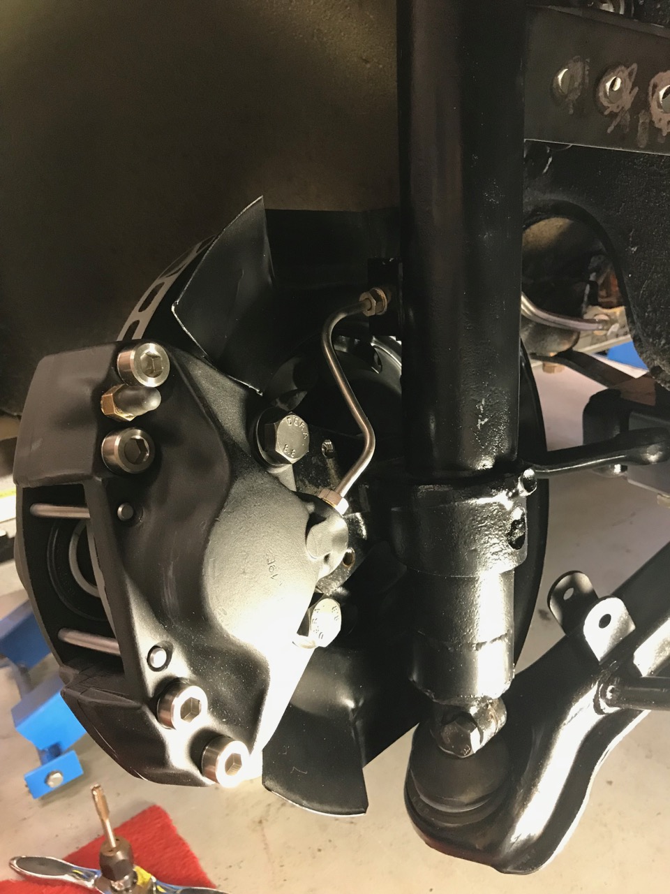

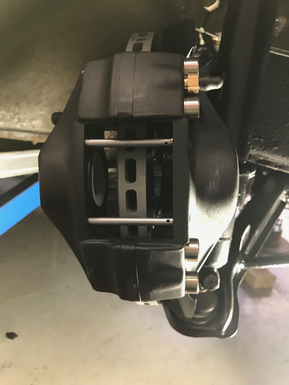

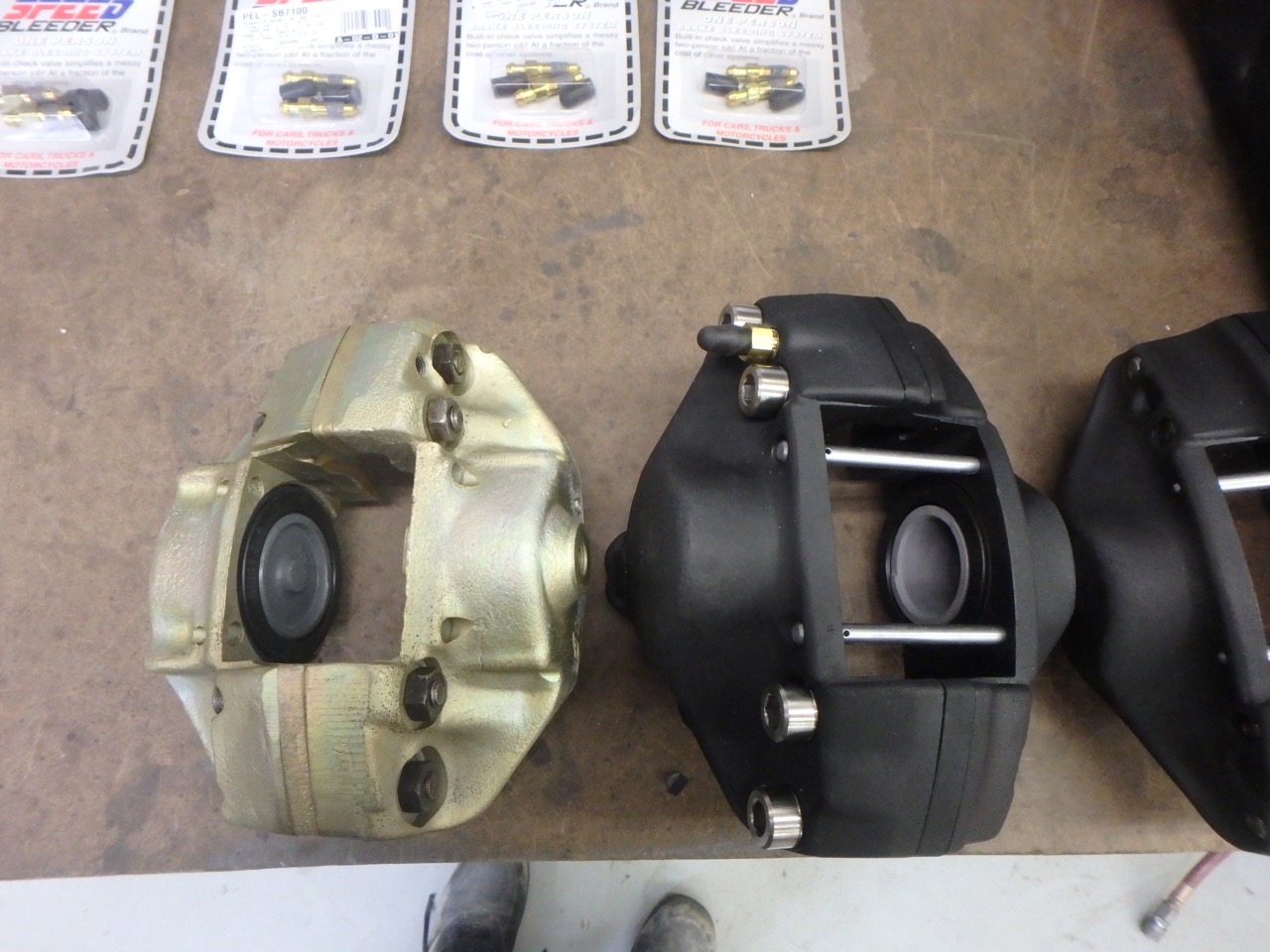

Last but not least some brake Porn drooley.gif PMB, a sourced set of Brembo Alpha calipers, and speed bleeders drooley.gif
Alphas Much bigger than the 914-6 fronts aktion035.gif And they are Aluminum aktion035.gif Much lighter to boot aktion035.gif
And I ordered to many speed leaders, did not realize they come in pairs. headbang.gif Yet it worked out because the Alpha Calipers required a M10 bleeder and I just so happened to have 4 sets for my EG build, that is using Boxster Calipers which are also M10. piratenanner.gif For once a mis-order worked for me.
Speed bleeders going into the classifieds also. At a fraction of the orginal cost shades.gif

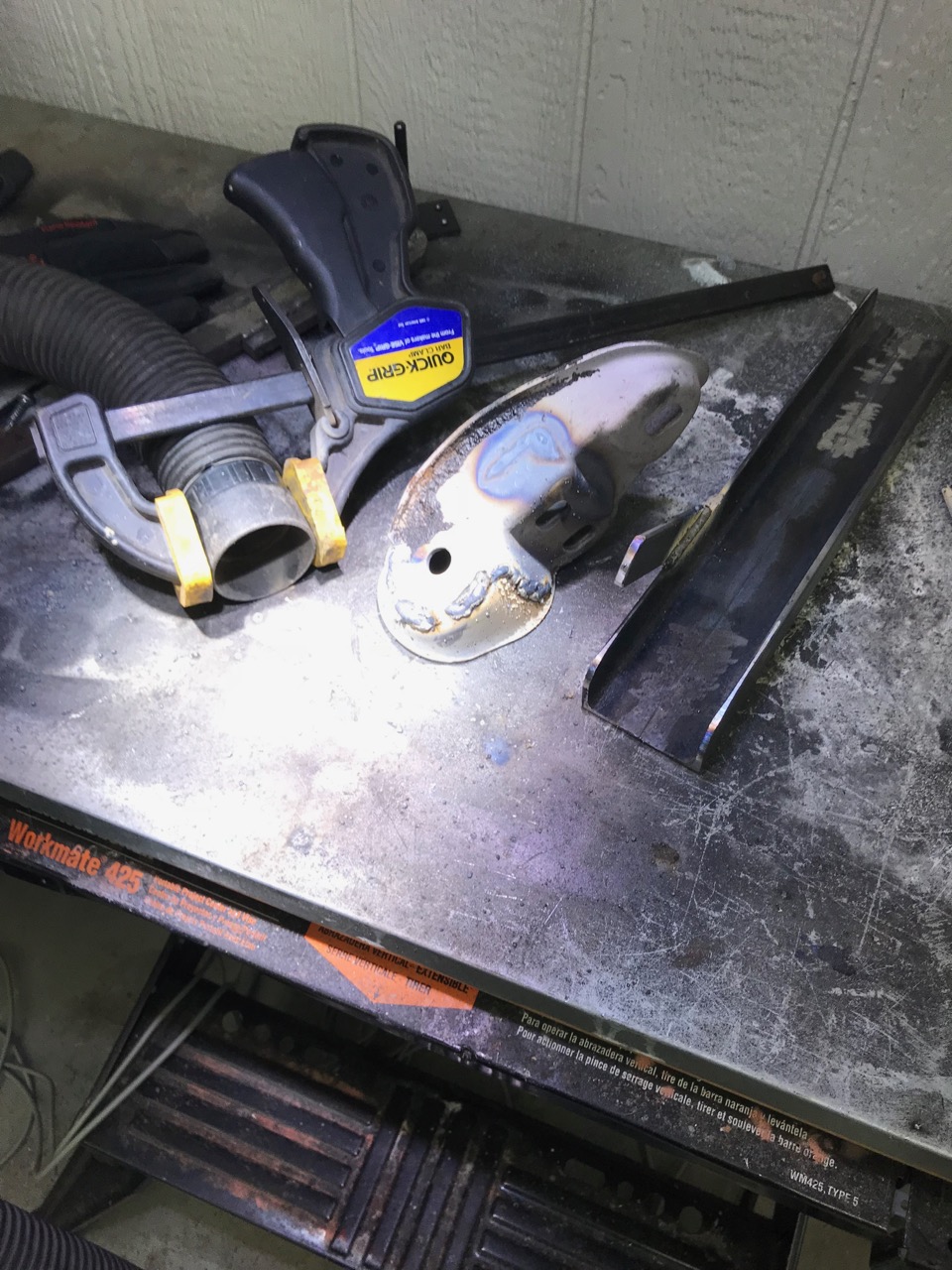

Been traveling for work. here is the update of what I got done while I was in town.

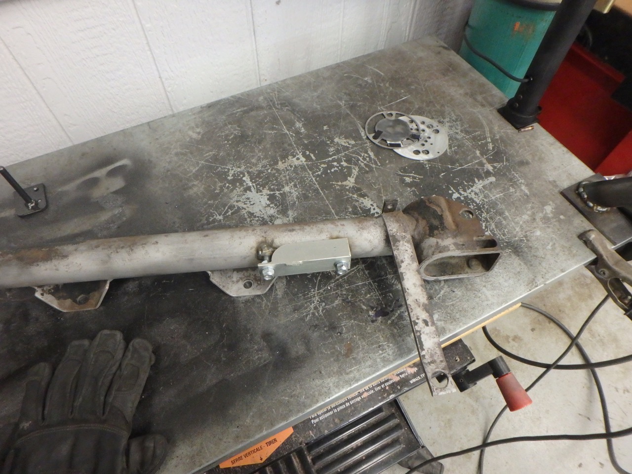

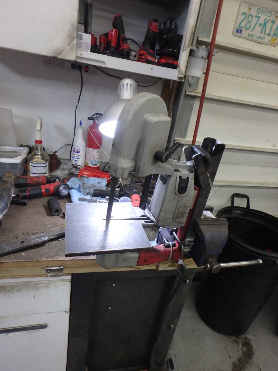

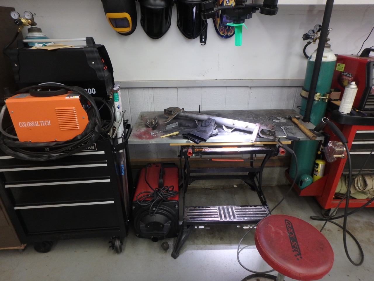

First up got my welding area kinda of setup. I am still looking for some steel to build a good bench, or a used one I like.
Nice to have dedicated welding space, now to get to welding. I have not been welding for about 6 months, man I am rusty, but I got back in the grove pretty quickly. I worked on some welding tank mounts, and other things to get the muscle memory back.

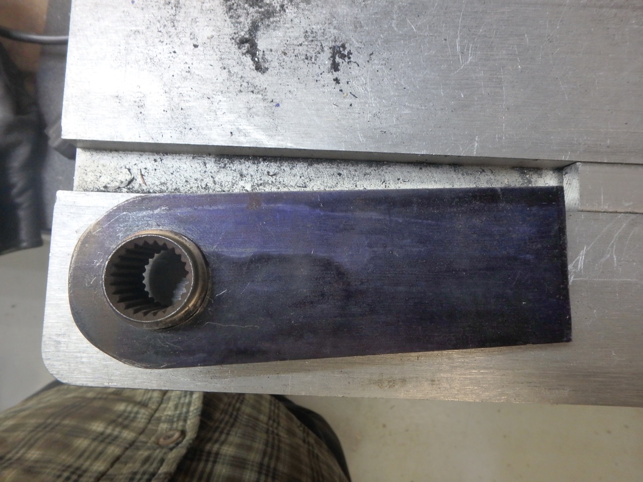

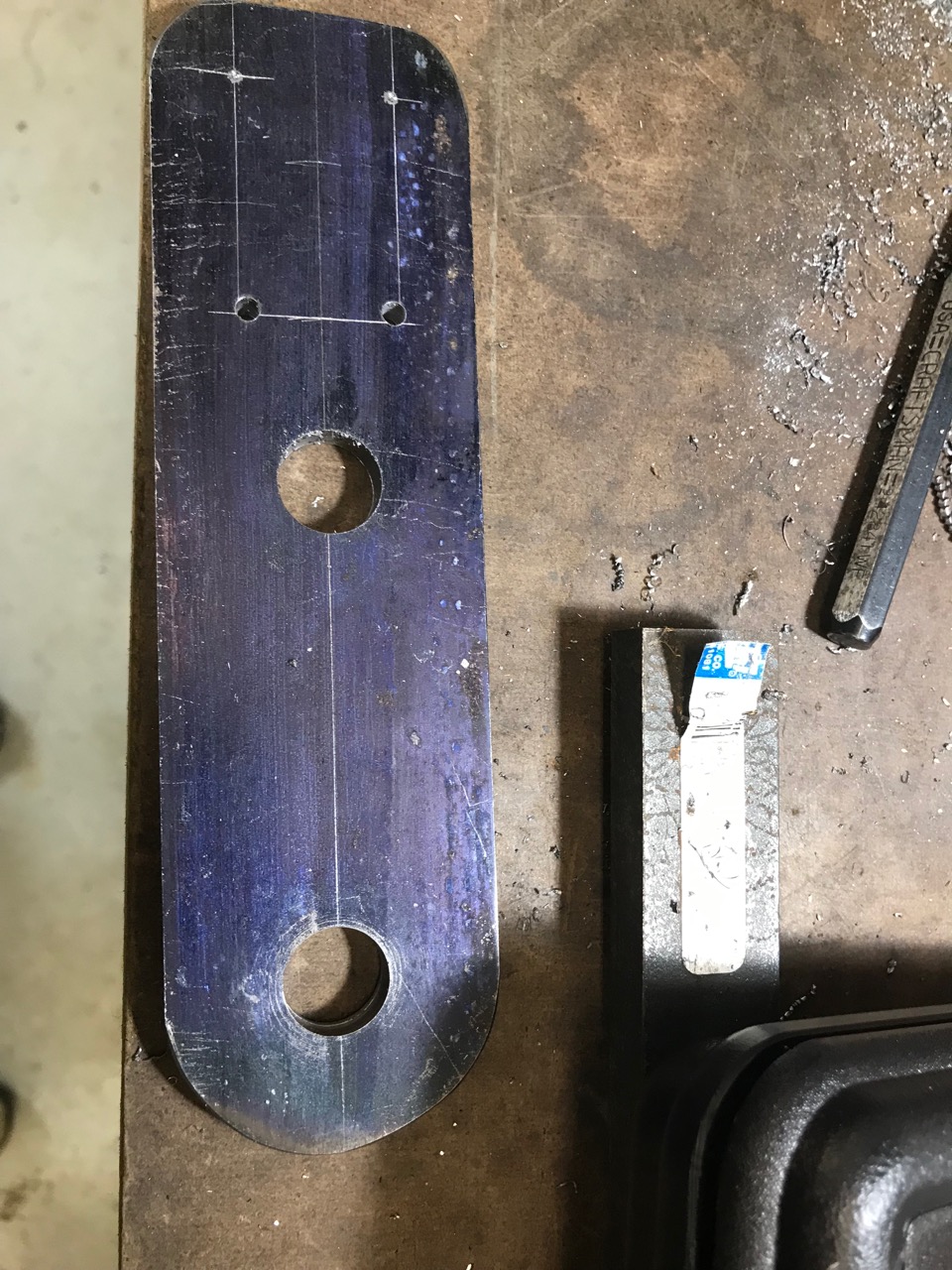

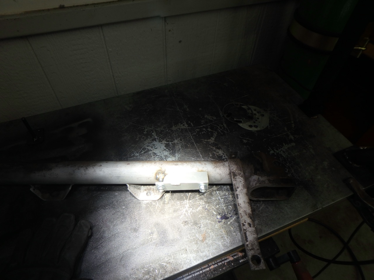

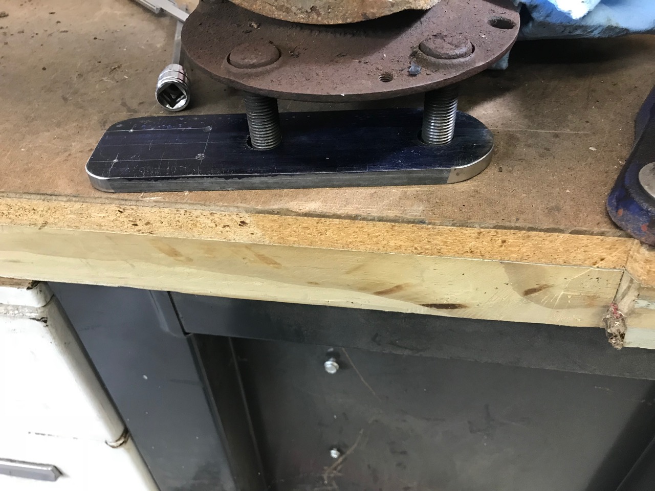

Then I started this.
Welded up
Okay no I am not welding in a dark shop, I have some strong lights, but this welding table light really screws with the digital camera. This is just turning off the light.

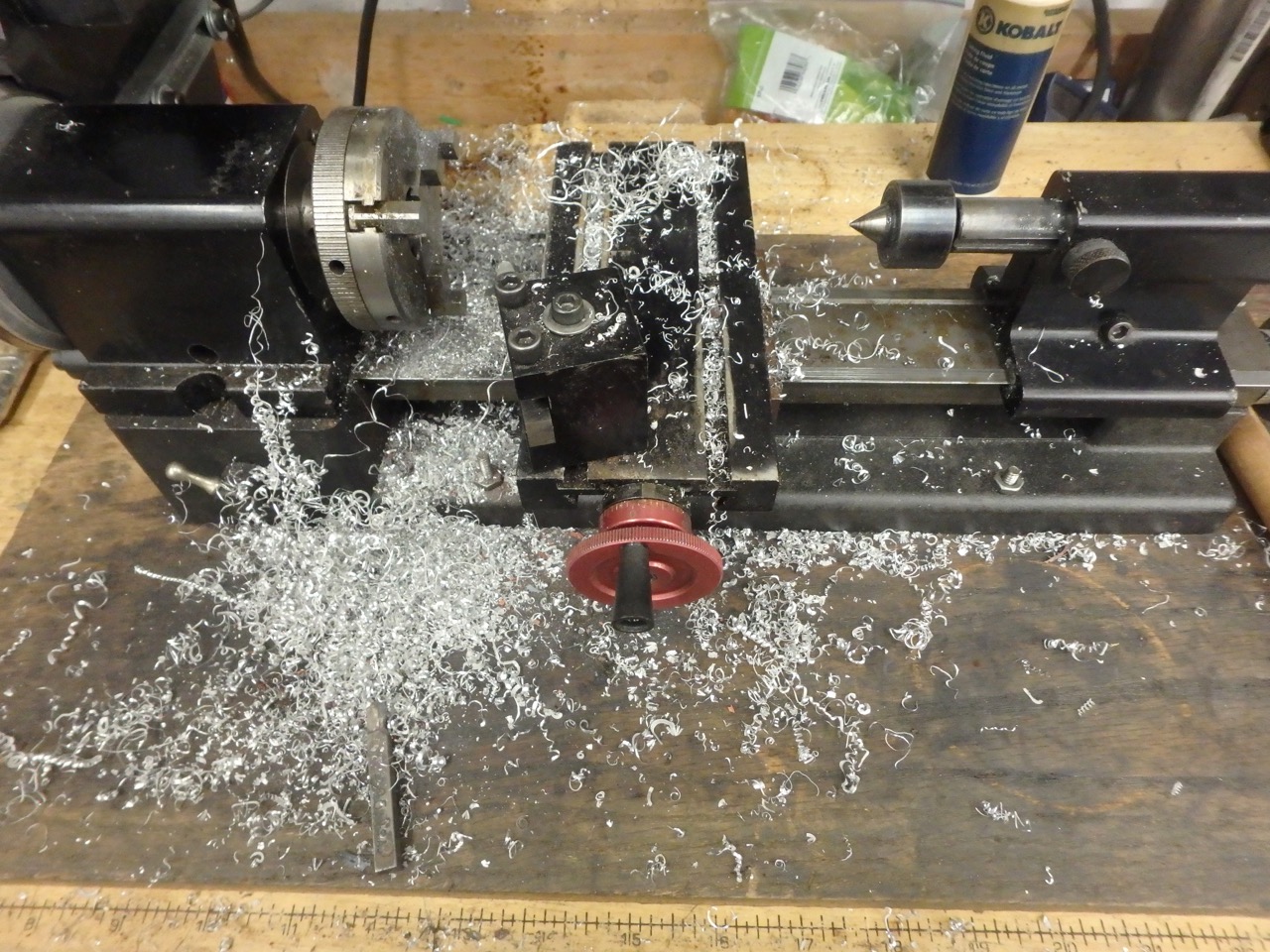

I tend to measure project success and the amount of fun I have had by the number of chips, pile of metal shavings, and metal abound.
Great little 3" lathe. I have the same one myself.

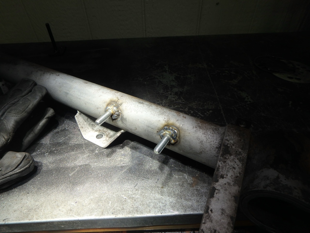

QUOTE(914forme @ Dec 1 2017, 09:05 PM) *
Did you actually use your Tig welder for part of the right bolt or is it just a really clean MIG weld?
mb911
Its mig.

QUOTE(Amenson @ Dec 1 2017, 11:04 PM) *
Well what you see there is the difference between rusty to fluid. Both MIG'd.
TIG should be operational this week. Then lots of practice, lots and lots of practice.

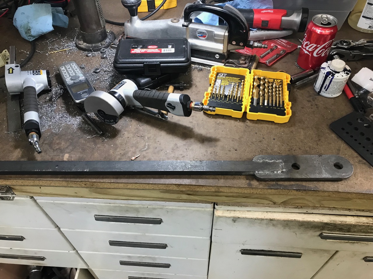

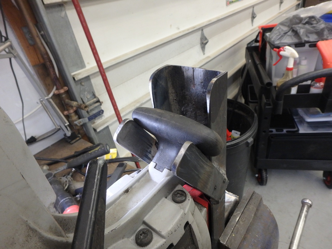

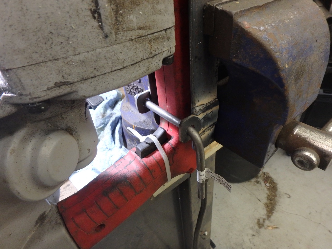

Some of the TIG stuff I lined up, need to make some tooling to do them is some 901 transmission rebuilding tools. I have a clutch spline I started to make into a tool. Would like to TIG these up.
And a Long socket that has been cut and prepped , and never welded. Just waiting on me to get the nerve to grab the TIG and do it. Maybe I'll do that today. Force me to finish the TIG setup. If I wanted to get it done, I would just grab the MIG and do it. confused24.gif
jd74914
QUOTE(914forme @ Dec 2 2017, 09:20 AM) *
If you want to make it a litle less threatening, you could use the Sherline to turn an aluminum or brass insert to keep its shape while welding. Then it's relatively insensitive to heat. Not to make more work for you or anything. blink.gif

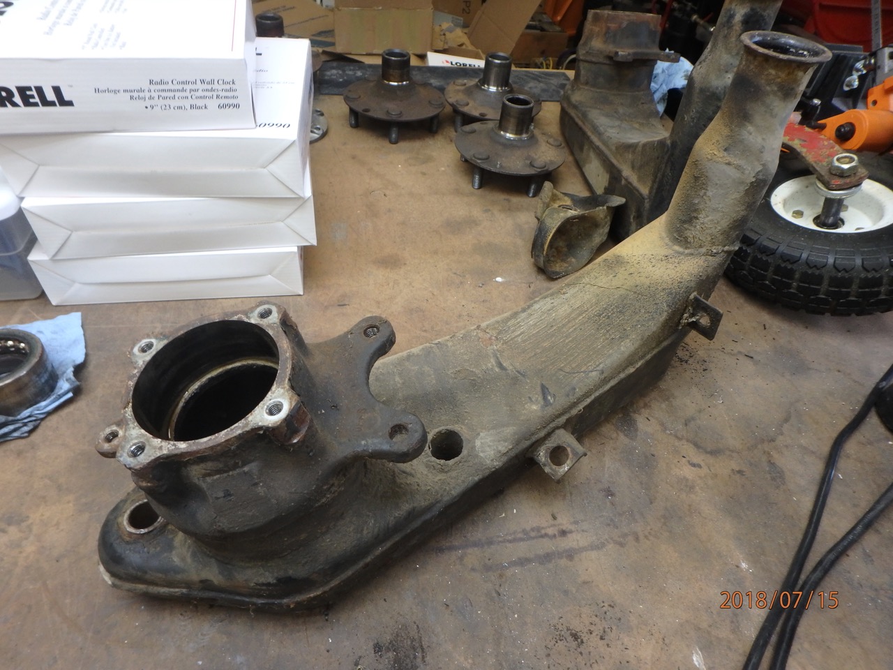

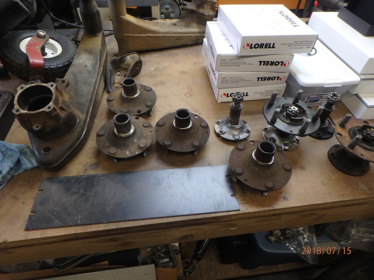

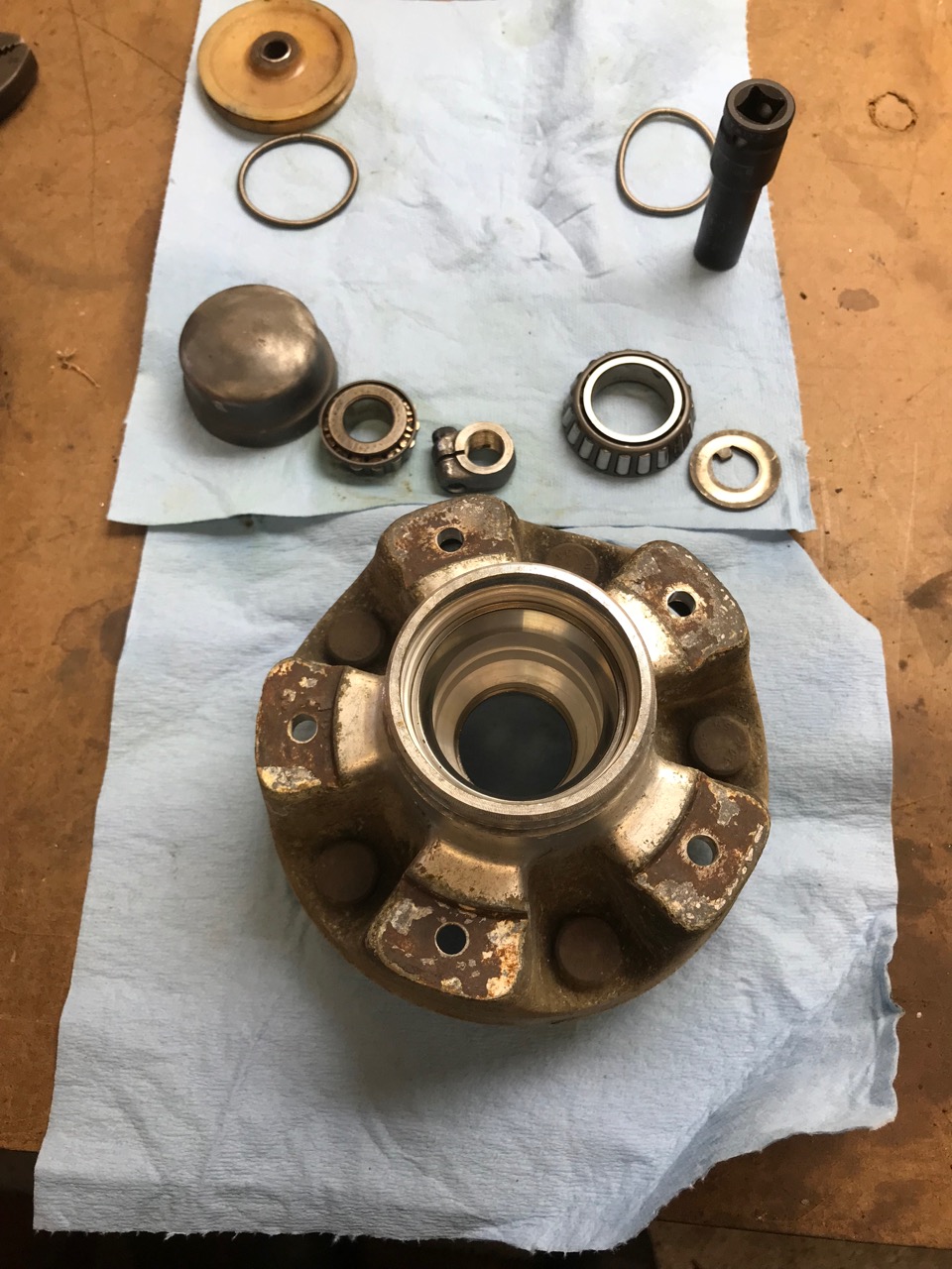

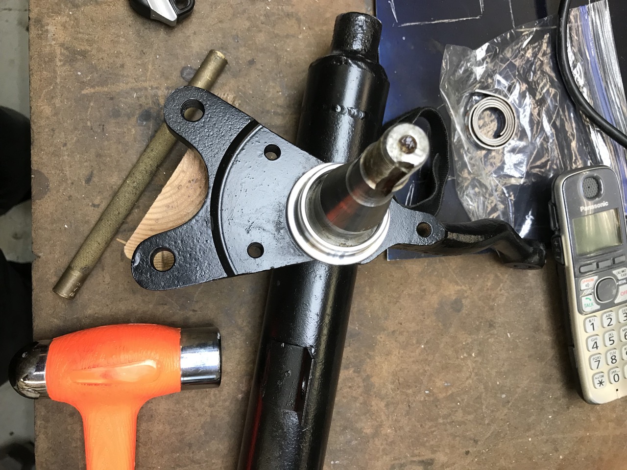

I also found some parts I tucked away in the shop, and got to work.

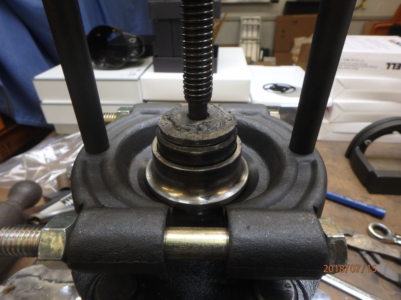

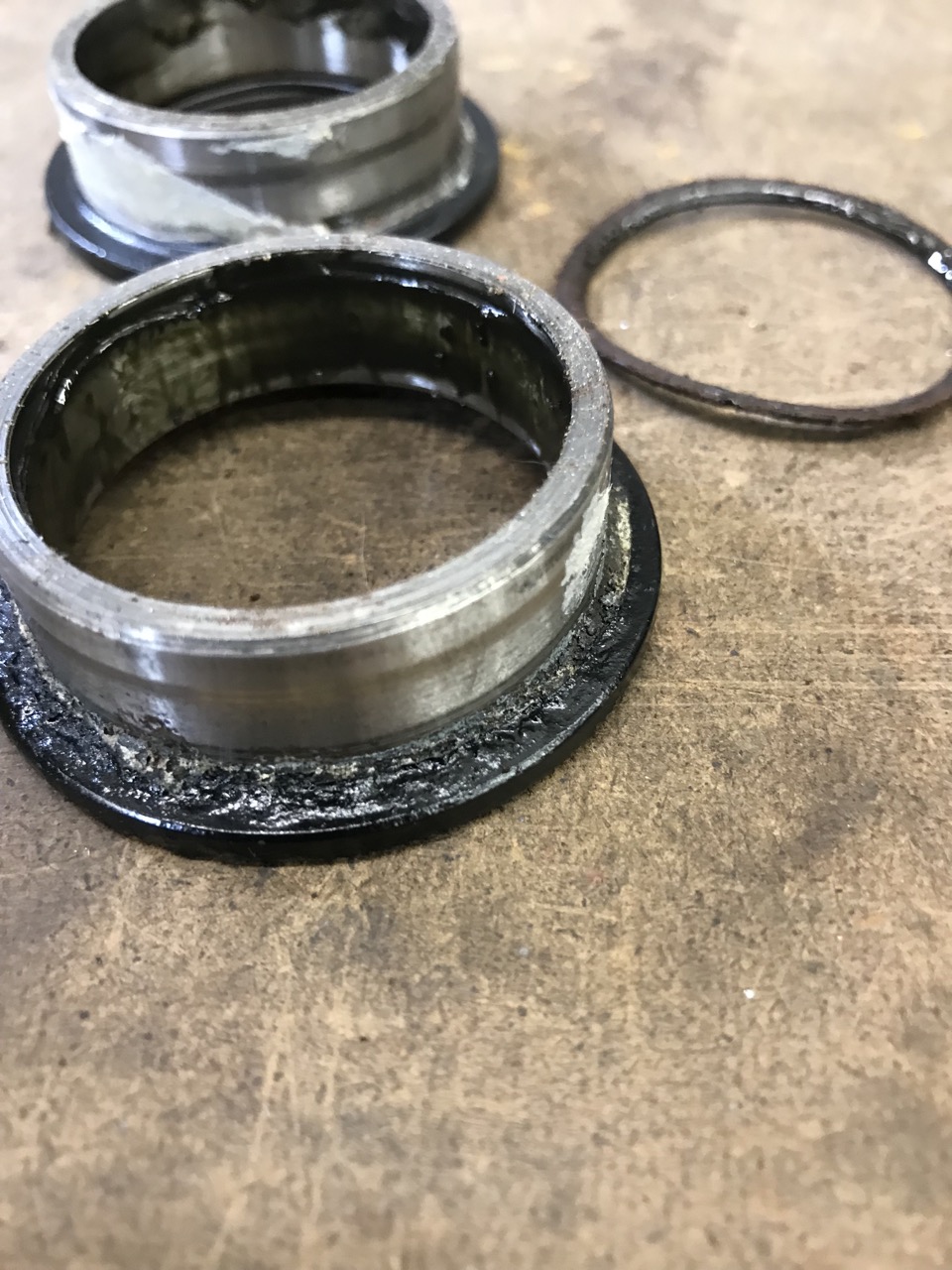

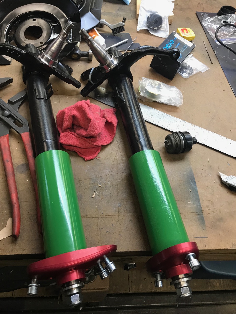

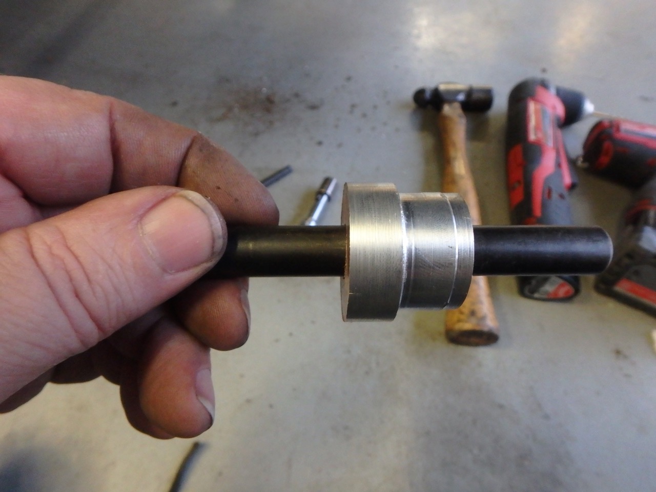

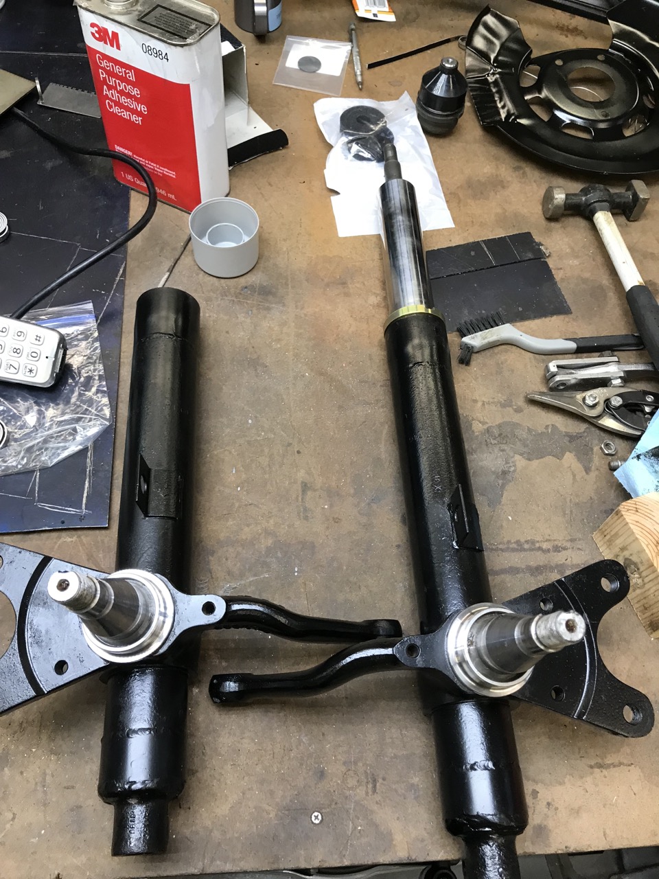

I had a couple scratches in the seal and bearing spacers on the struts. So new ones go on. Dang they are a tad expensive. blink.gif
And new ones back on with new o-rings also.

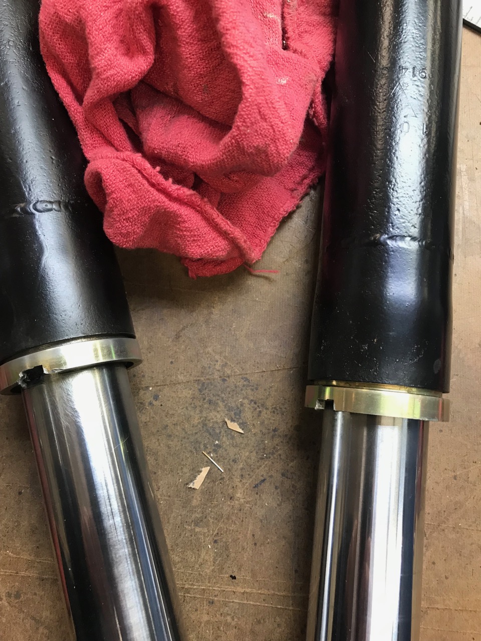

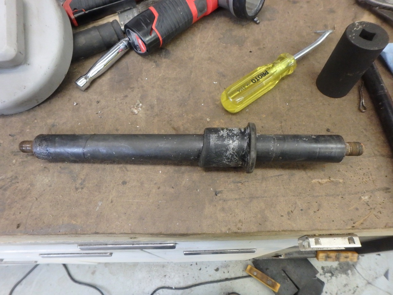

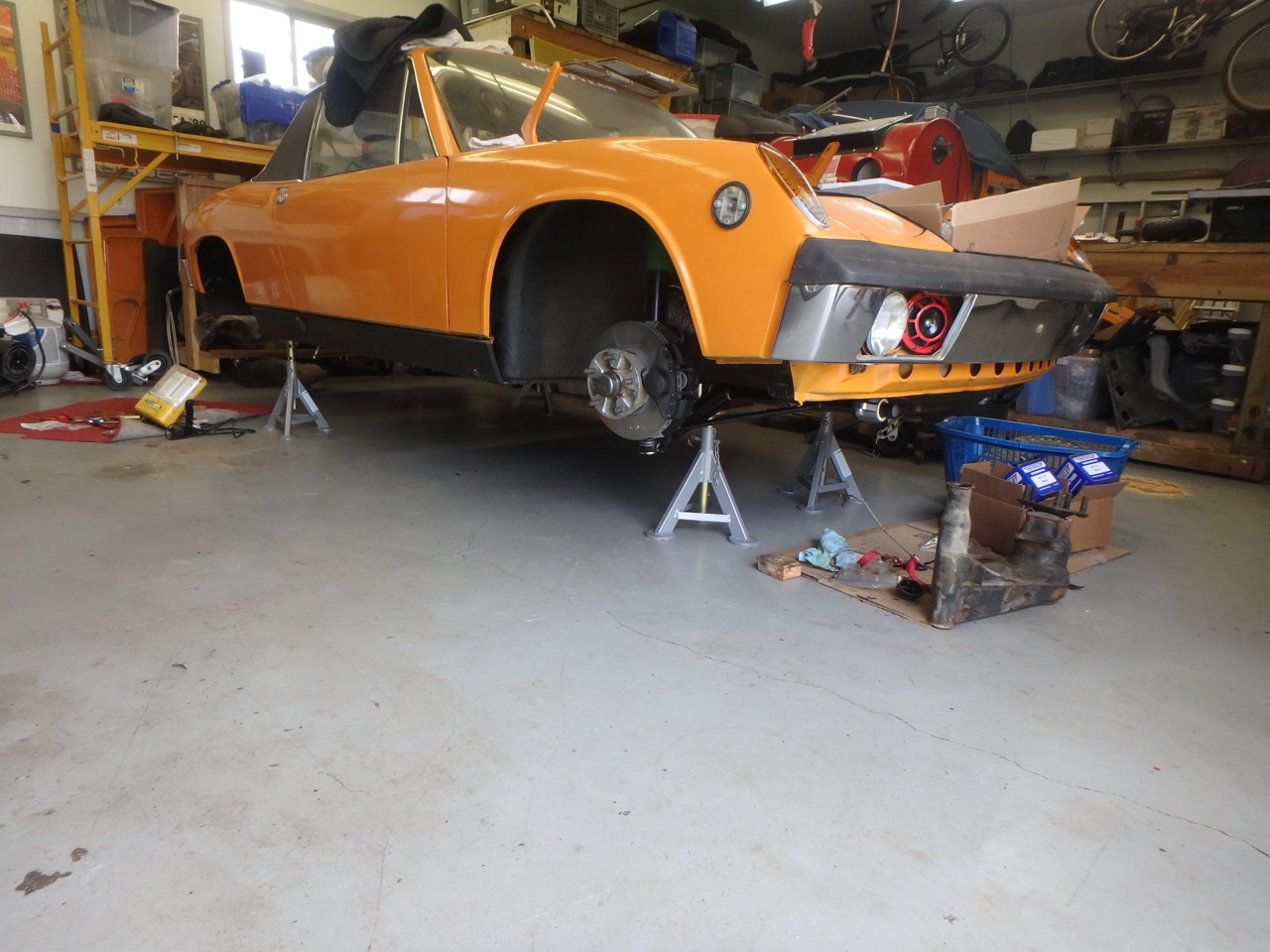

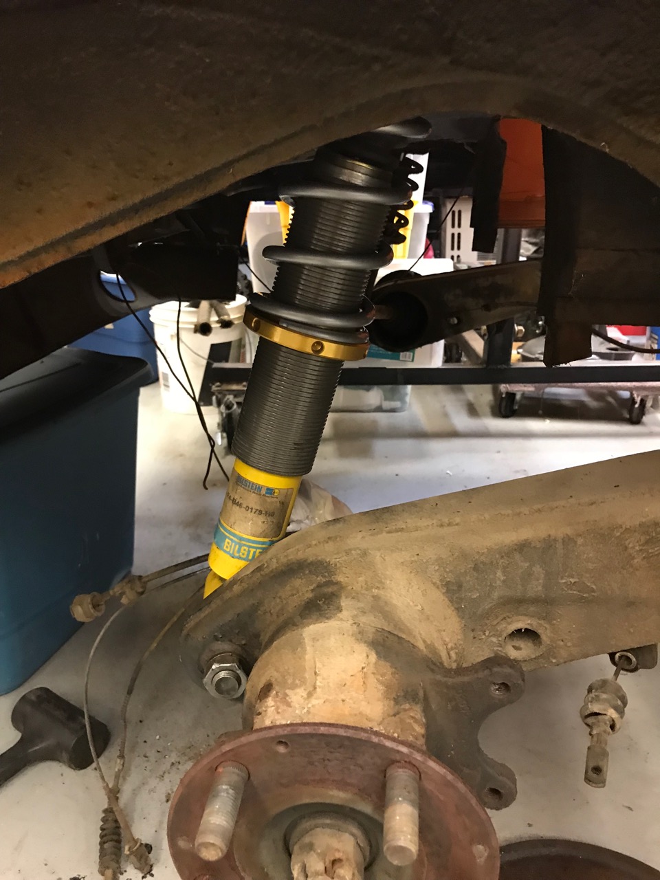

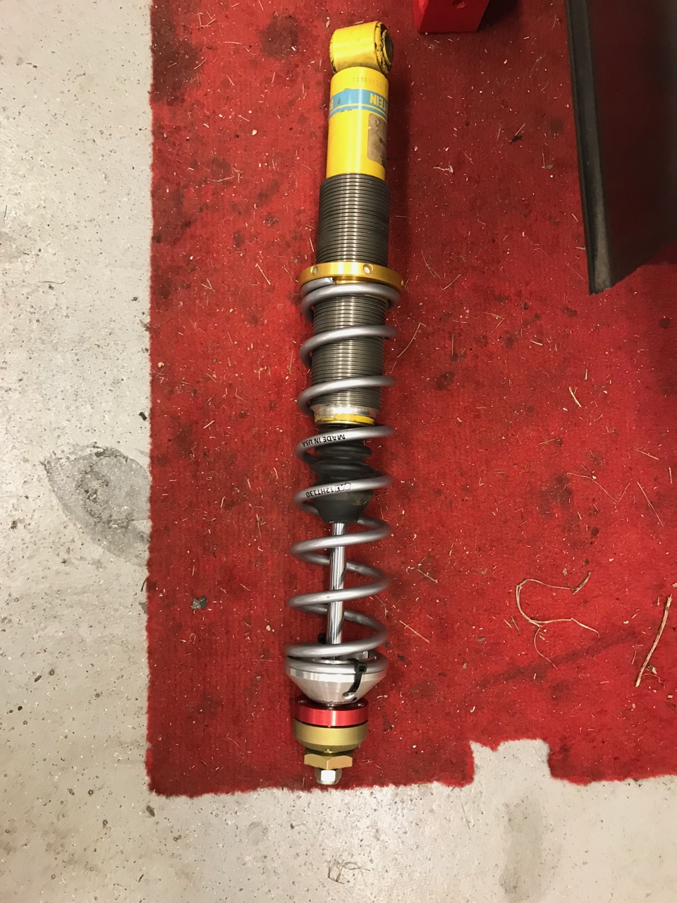

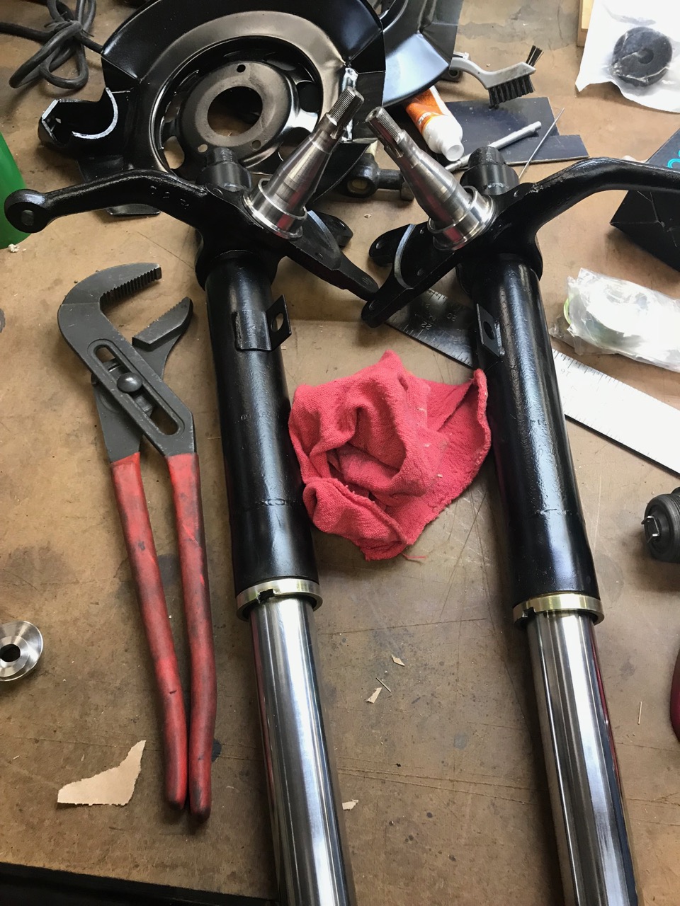

And then I ran into an odd one. One Bilstein insert fitted perfectly in one strut. the other did not fit. two threads engaged and we are tight. headbang.gif
Swapped inserts, and the one that did not fit now fits in strut A with inset B. Insert A gets two threads down into Strut B and stops headbang.gif headbang.gif headbang.gif headbang.gif headbang.gif
Like everything with this car one step forward 2 back. And I can not find my spanner for the insert top nut.
Oh and I also have an issue with the new ball joints locking into the arm. The ball joint key is narrower than the key that is welded onto the arm. headbang.gif headbang.gif I did find all my new ball joint hardware.

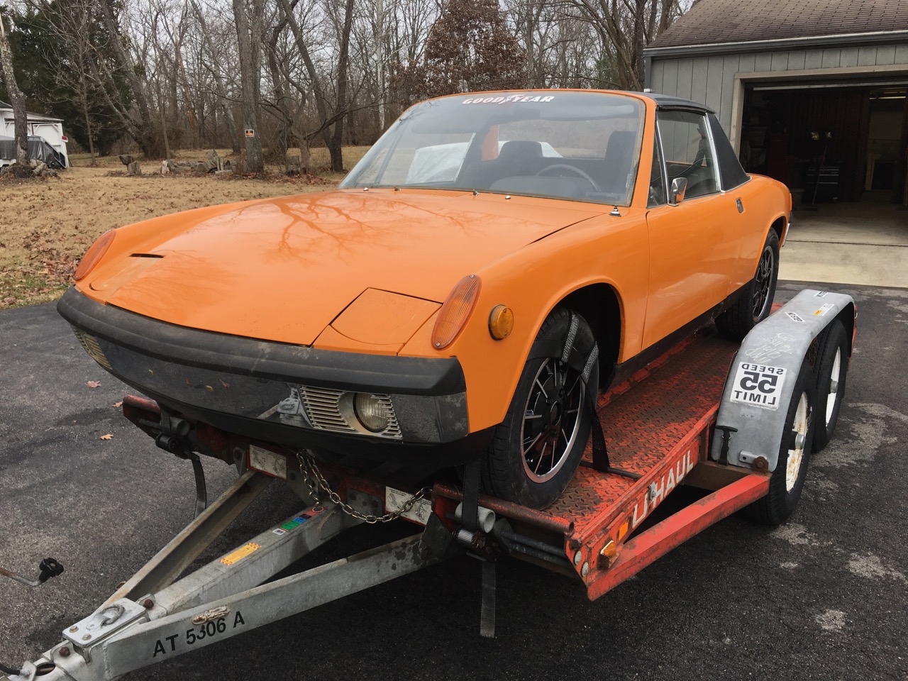

This is the garage it was stored in for 40 years.
Saturday I brought it to my shop. Rented a U-haul trailer as all my trailers are up at the farm. Car has not seen the light of day in 40+ years.

LOL, not a pipe wrench but I did use a set of huge slip-joint pliers and a rag and so mild invention of new word combinations I got them on. I think there was something in the threads. So I chased the threads. I spun them on a couple of times and then brought out the big gun. To get both of them on good and tight.
Both seated the same amount.
And then it was quick work to assemble everything else.

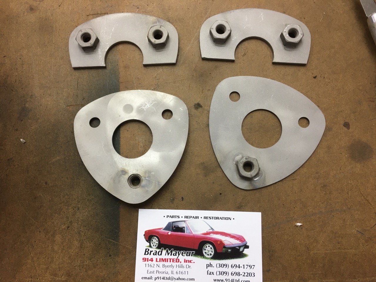

I only switch the chamber plates 3 times headbang.gif First time I did it right though I did it wrong screwy.gif
The second time I thought I did it right only to assemble them wrong wacko.gif
The third time I did it just like the first time only to know I am correct this time w00t.gif

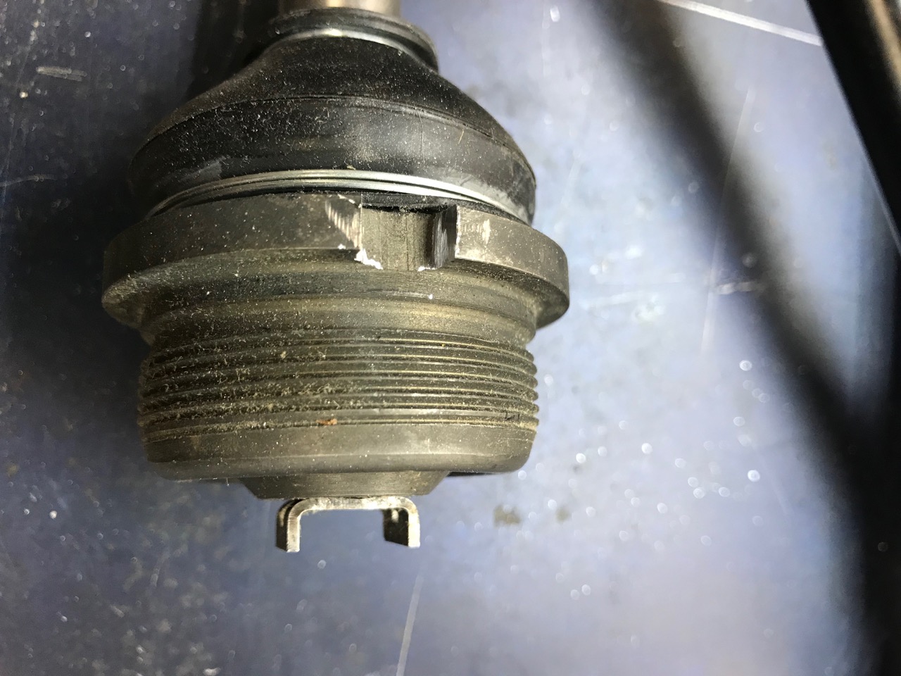

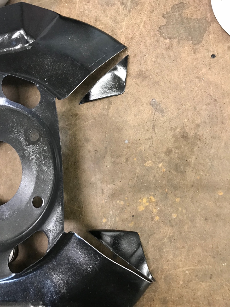

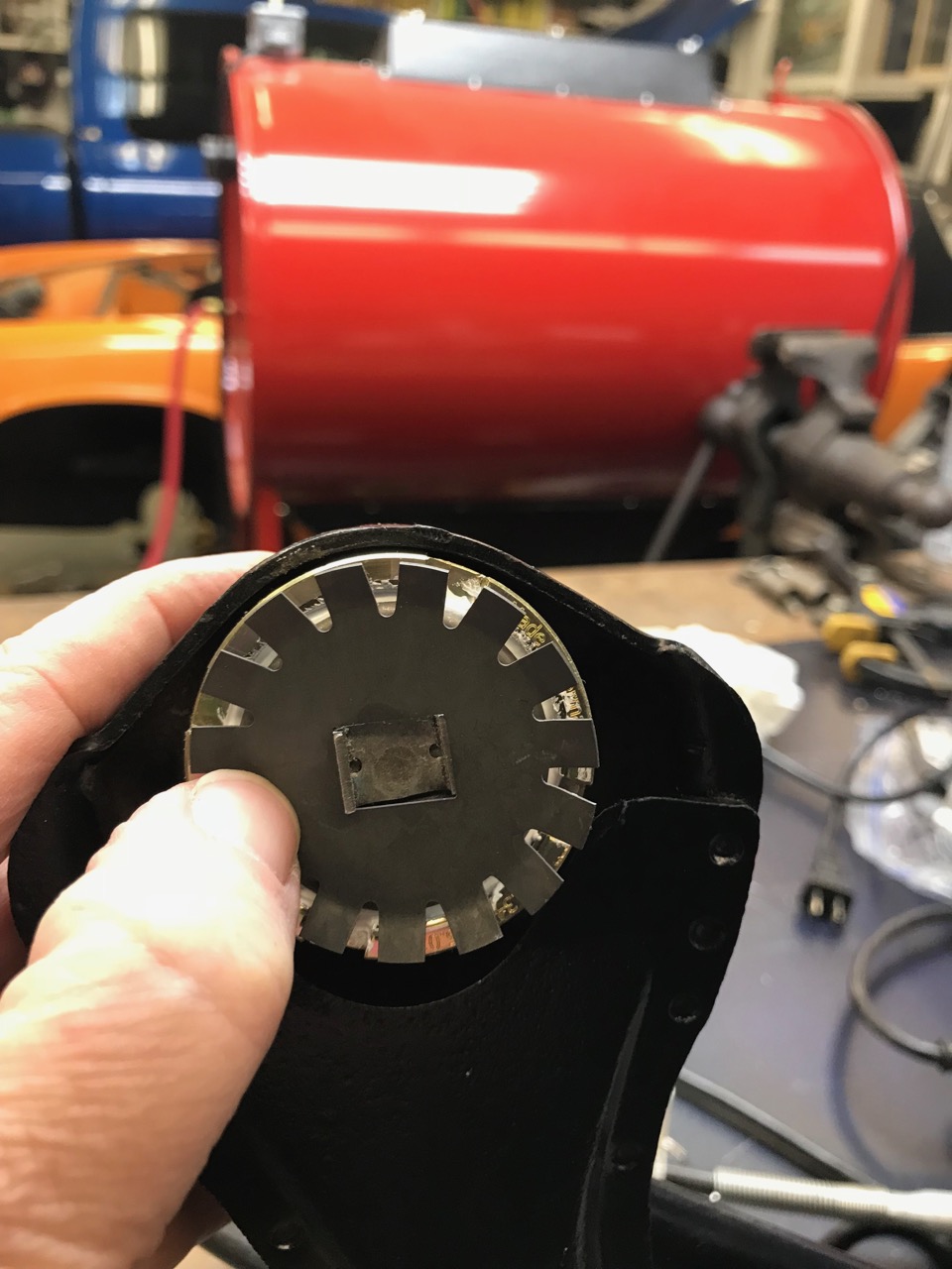

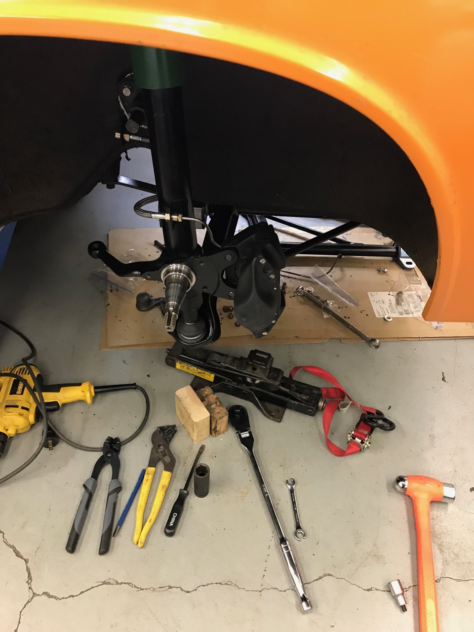

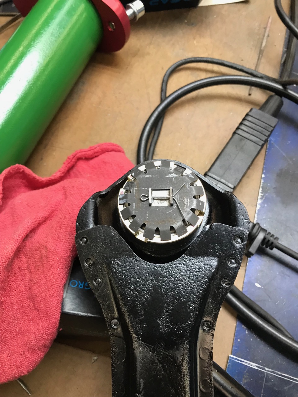

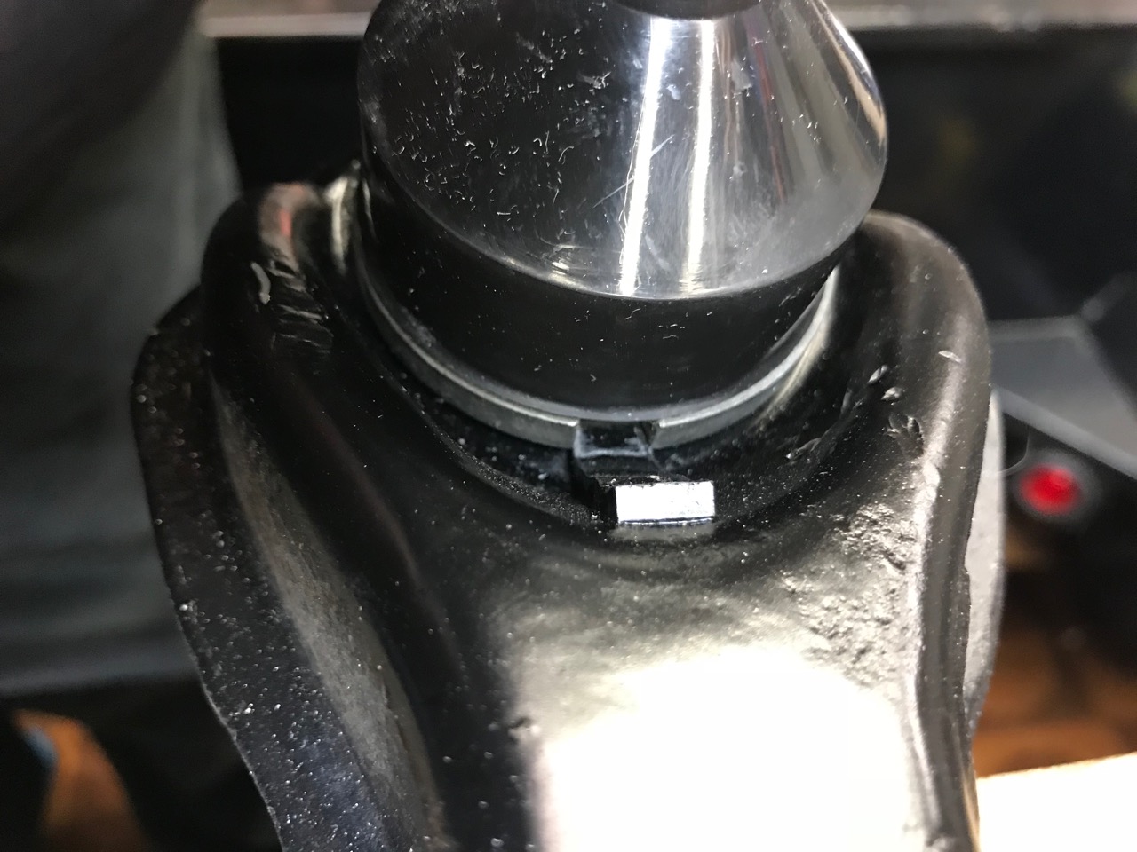

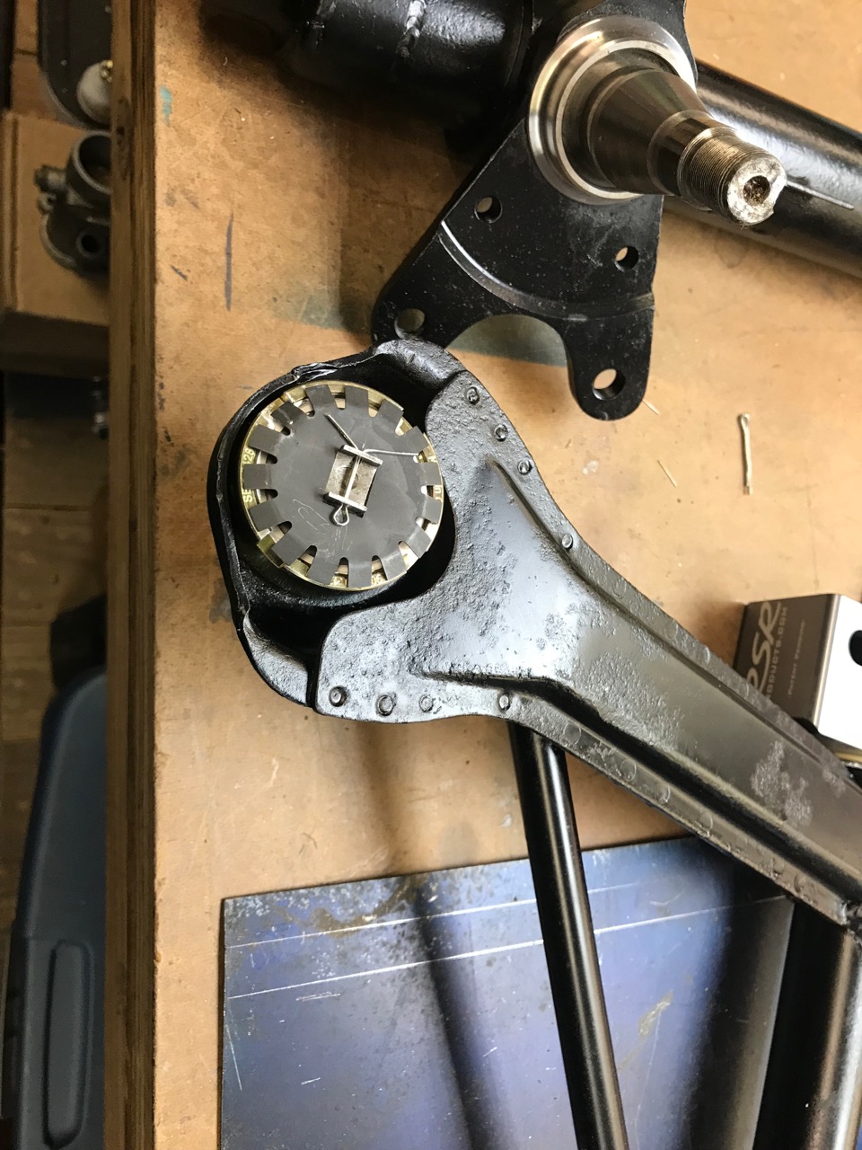

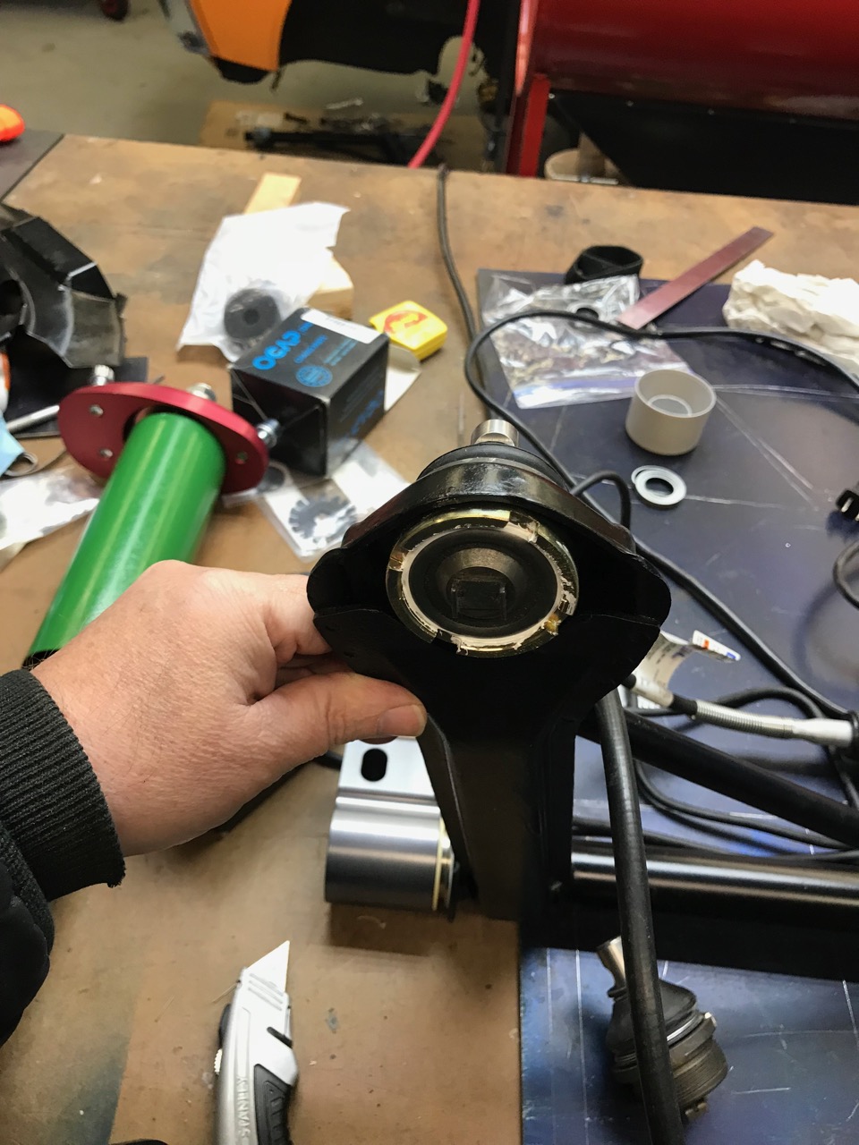

I could never get the ball joints in the arm to seat properly. Or at least to my likely. So out came the calipers.
So the opening of the ball joint needed to be opened up just a tad.
A diamond wheel and a bit of grinding latter with the Dremel and Ta Da!
Little ceramic anti-seize and more brand new parts. And this side is together.
The retainer clip that keeps the ball joint nut from backing off, does not fir the tabs on the ball joint. headbang.gif
So which part to modify this time. The retainer or the ball joint. I'm pissed at the ball joint manufacturer so why not. And the both of the retainers fit the other ball joint. Crappy quality control. ar15.gif
Took the big slip joint pliers and modified the retainer tabs. And one side all done.
Well, the other side I had to modify the tab area of the ball joint by the same amount. And rest of the assembly went much smoother. w00t.gif

Kent, I just want parts that fit headbang.gif I can get bogged down in the details if I let my inner German engineer take over. Hell, that guy almost cost me two fingers! Sometimes I just have to tell that guy NO, it will be fine, it is good enough, and let's get this done.
I won't even tell you how much time I spent looking at these ball joints just to put them back into the box for another day. Check and re-check part numbers to make sure I have the correct parts. You can only stare at the PET for so long before you go screwy.gif I had even considered cannibalizing the EG build just to get this car done. I knew its ball joints fit, lol.
I see the guys get out the grinder all the time to make the parts fit. Many different years of parts and many repro parts often create issues. The worst is trying to make parts fit on a freshly painted chassis. I'm a strong believer of pre assembly on a primered shell but due to the labor cost, that never gets done at the shop. But then there's always time to fix the issues headbang.gif

I keep looking at the swaybar re-enforcements thinking they really need to be welder.gif

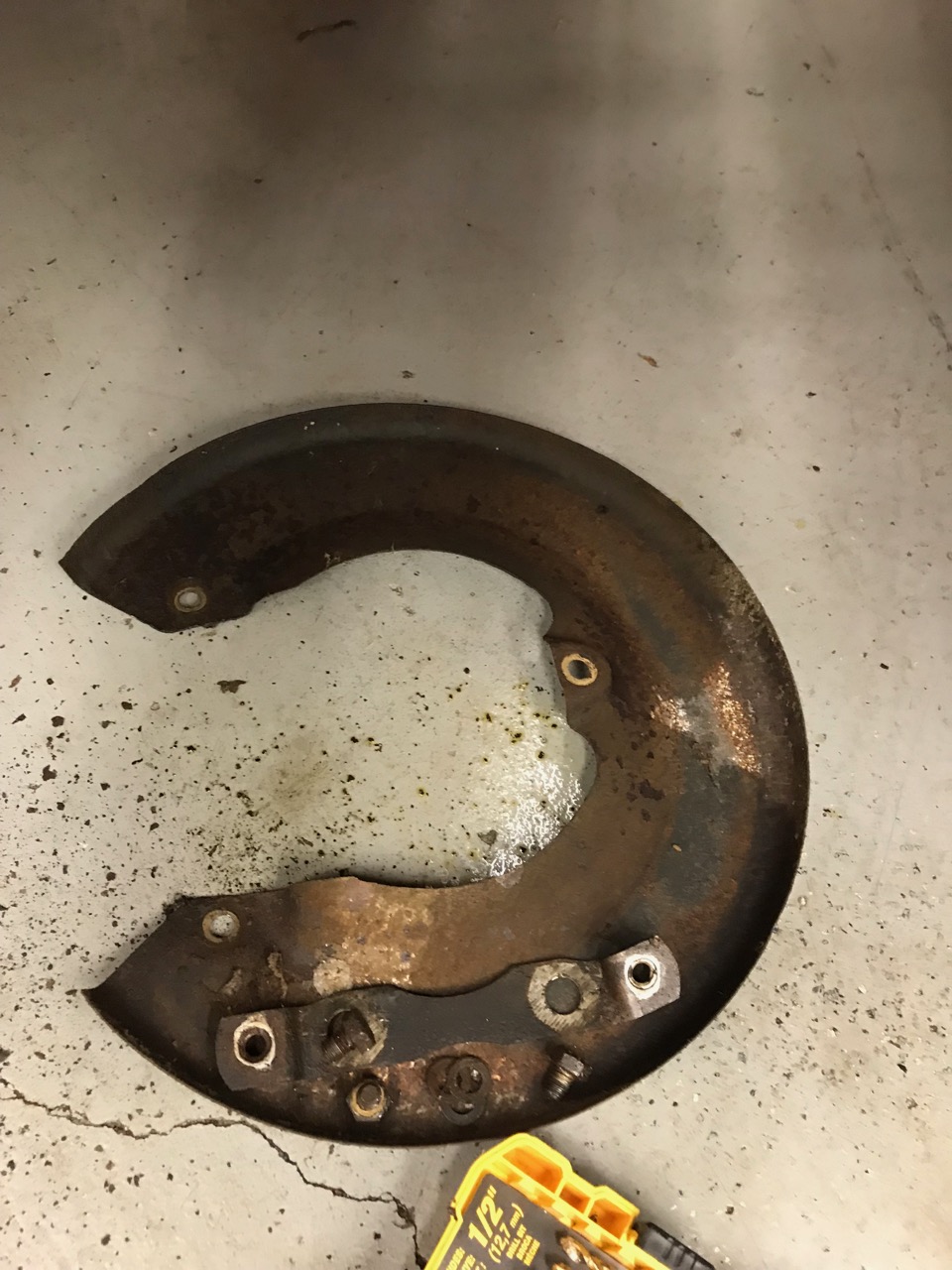

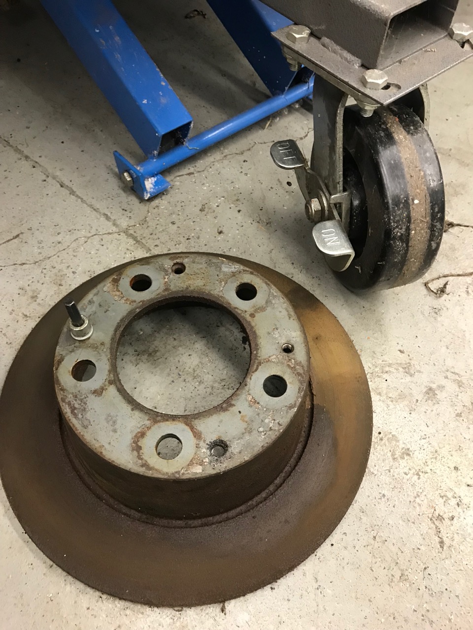

Worked on getting the old rotor off the passenger side rear. Like everything on this car, it rusted solid. Sitting is a real bitch on cars.
First up get the rotor off the hub. I used a couple of cap head screws I had around. Could not get the rotor keeper screw out. So I drilled it out. Remnants still need to be removed. Letting it soak in some penetrant.
Backing plates need to be cleaned up.
Old Shocks off and replaced with these Bilsiens. Custom valved, adjustable colors, 140lbs springs, monoball shock tops.
Installed - required a 38mm socket. Good thing I work on large machinery otherwise I would not have a 38mm around. Yes it is a 3/4" drive, bit over kill for a shock top nut. Never thought I would be using 3/4" stuff on a 914 huh.gif
Rear Arm still has to come off get cleaned up, have the pivot arm bushings installed, and new bearings installed.
Onto the passenger front
Hub and parts all laid out.
All assembled
Struts and Arm in place and mocking up the brake calipers

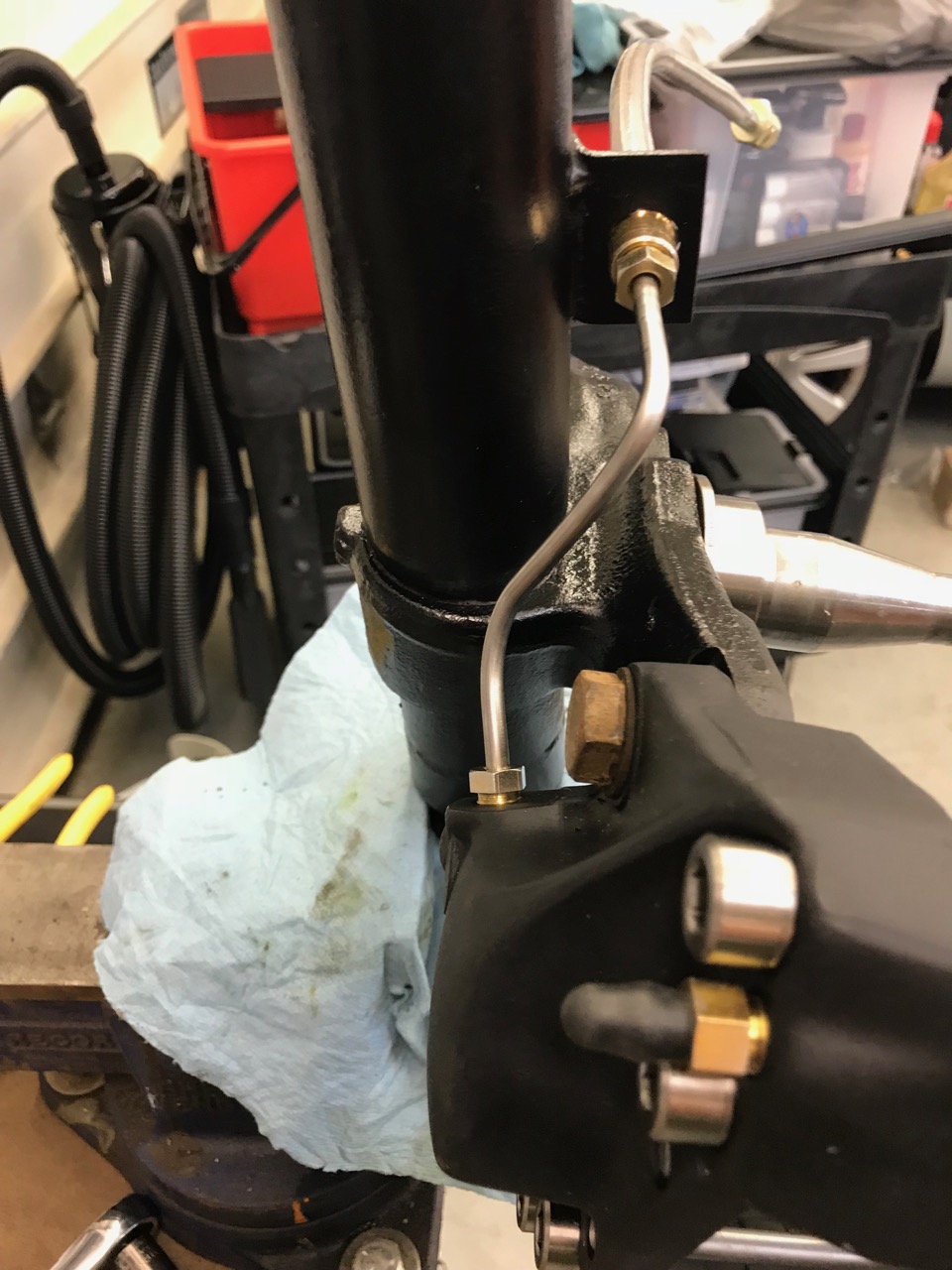

Alfa GT Brake Caliper, why you might ask. 3" caliper bolt spacing, larger pads, lighter calipers. think of them as a 911S Alloy caliper for the 3" strut.

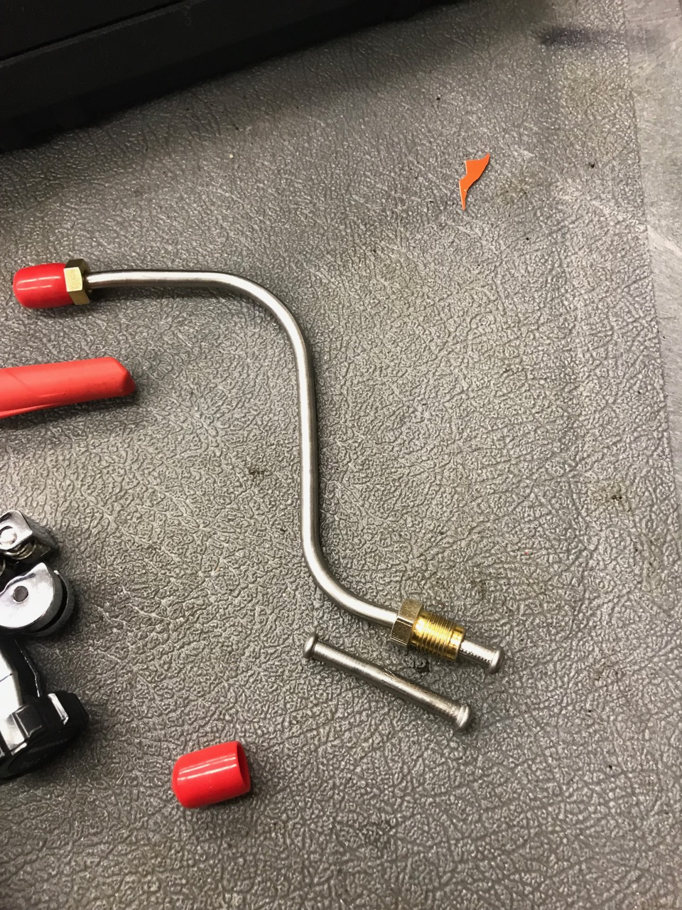

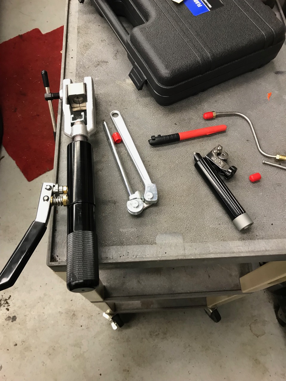

Had to remake the caliper hard line
The small piece is the part I cut from the PMB original line. These SS lines are hard. Also tested the flare on the SS line using the scrap piece. Screw it up first before doing the real line. I will take a picture of the original and the modified line. Before I duplicate it for the drivers side. Luckly I have the proper tools to form them and remake the flare. But man SS is hard to work with.
That is where I stoped late last night

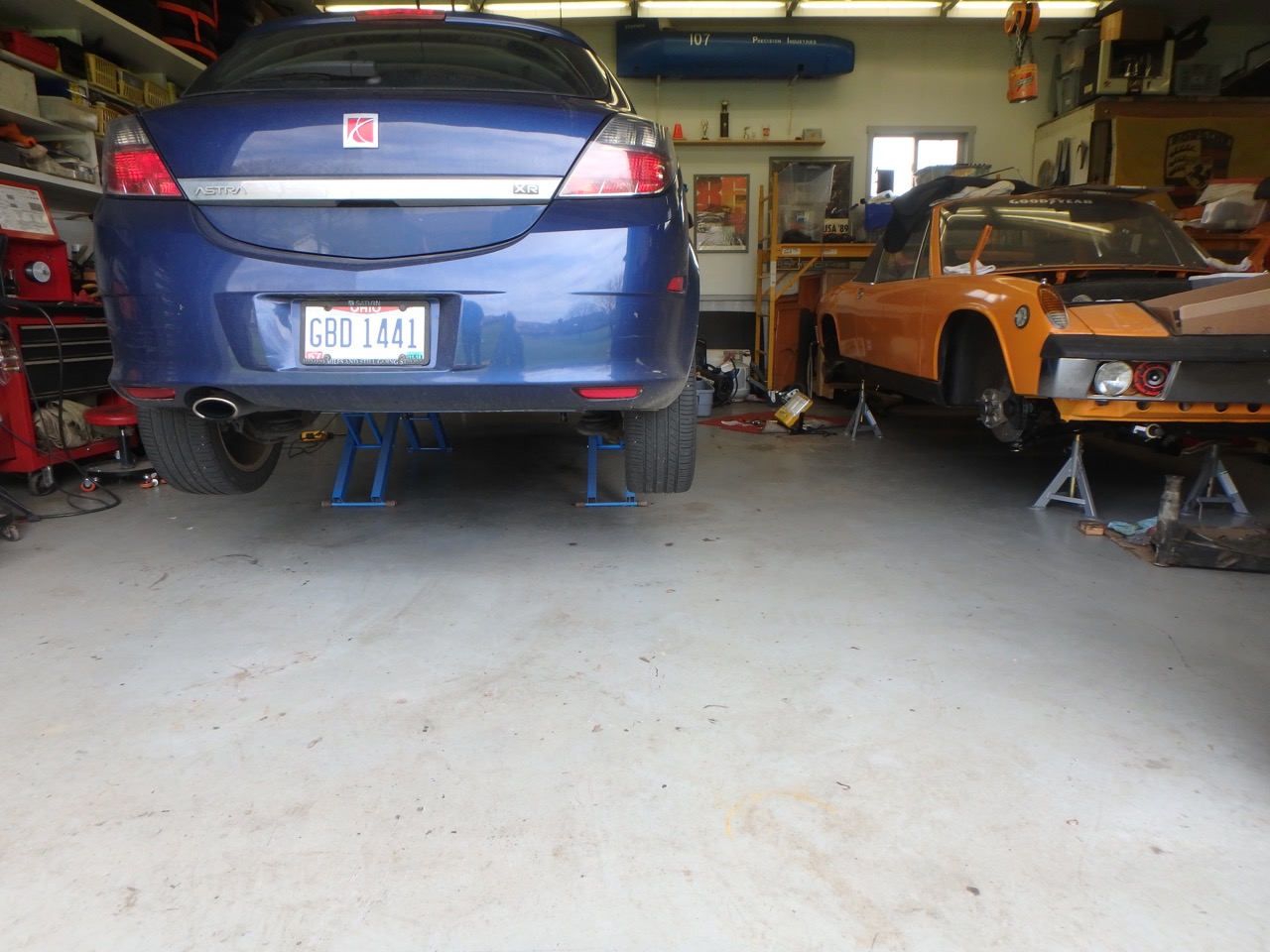

All of this to get this car off the lift so I can do a timing belt on the wife's EOS, and all the other odd spring jobs that come up. I really need a couple of lifts. a 4 poster to store stuff in a vertical fashion. A couple of mid rises, as I like to move my stuff around to fit the need of the work. Bolted down 2 posts just don't work for me. I have some stuff that is over 30 feet long. Everything in the shop is on wheels, so when I need to get the big stuff in, smaller stuff just moves around.

914forme
I made two steps forward and the two steps back to move three steps forward in the end.
So the short of the long I got al the suspension in place on the front, and looked over to see the steering rack under the bench headbang.gif
Take everything back out, instal the steering rack, and put it al back in. So where I was today when I stopped to eat at 3pm is where I once again am when I stopped tonight. headbang.gif
Frustrating to say the least. Not sure how I forgot that piece.
First thing this morning I made the second brake line for the drivers side. And fitted it up on the bench.
The Alfa calipers are a bit big, so the stock rain shields have to modified just a bit to make them fit.
Trim a straight line from point A to B then debur.
Passenger side is done, well almost I need to get a 803 615 715, not sure where that got to confused24.gif

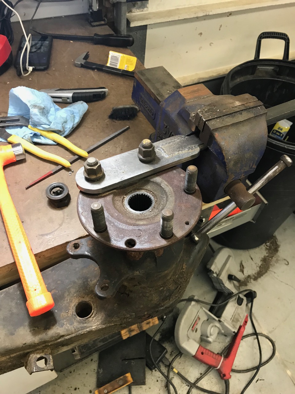

Okay so if you can't find the tool you need you make one.
wub.gif Rotabores
Now it becomes a bit clearer what I am doing
Big long handle allows it to mount in my vice, or used on the car. For now it is being used in the vice.
This is very handy for taking that nut off to remove the stub axle.
More work to come latter tonight.
On a sad note you see my Portaband on the floor. Using it and it slipped out of the vice and hit the floor. Carnage ensued! I need to make a mount for it to better support it while working with it. Or I need to pickup a larger floor standing band saw. Work has a couple 26" units coming up for auction idea.gif Need to do 3 phase in the shop oh that opens a whole new can of worms. w00t.gif
Will also need to add a machine room to the side of the shop. Another 40 x 60 should do the trick.

First up working on rebuilding the rear trailing arms. Pressed out the rear pivot bushing and tube. Upgrading them to Rebel Racing parts. But as everything with this project, it did not go as planned. One of the rubber bushings got stuck in the arm. I finally got it moved to one of the ends, and drove it in so it did not moved. Grabbed a drywall saw and cut one side of the bushing. Grabbed some long needle nose pliers. And twisted the end and finally got it out. headbang.gif
Seam welded the rear pivot cup, do this to all my 914s. Just makes me feel better. And yes it allowed me to get my welder.gif on.
the item beside the outer cup, is a mount for my portaband. Don't want to see it fall on the floor again. You can pull one pin and use the portaband as a handheld saw. It is handy to have a portable bandsaw.
I use a foot switch to control the on off. Allows two hands on the project.
Mounts into my older Record Vice. YES I love this vice it has been with me for years. I need a few more vices in the shop.
I had to test my new stand out with the Portaband. So I mounted my old iPhone on the door of one of my cabinets. Built a a simple mount that holds the case to the door. Easy, keep it out of the dirt and grime of the work bench.
That is it for tonight, off to work on some gauges.
76-914
I've been thinking about buying a portable band saw just for metal cutting. Any tips on building a jig w/ table? beerchug.gif
914forme
QUOTE(76-914 @ Apr 15 2018, 11:28 AM) *
I need to redo my table. I bought this one used from a pawn shop. Great deal, as cheap as Harbor freights better quality. The Dewalt version the top handle unscrews making it easier to bolt to a stand.
I am going to make a new blade guide to use when using it I mounted. It was broken when I picked this one up. So the blade guide will be a tad bigger than the original. But it will allow me to bolt the top plate to the saw. Will most likely make a frame out of steel. And then screw a piece of melamine to it for the top. Nice and flat, yet easily replaceable when needed.
It works well for what I do, but every time I’m in Scott’s shop I see his big band saw and I think man I need one of those. It’s eats up shop space, and I have ways of cutting bigger stuff.
I’ll detail out what I come up with.
The stand was made out of flat steel and angle . Easy enough, and cost a few bucks. Steel was out of Lowe’s clearance. Stuff was so cheap, I drove from store to store buying all the had. Idiots it was cheaper than what the scrapers where paying for used unclean steel. I bought every stick I could buy. And been using it up for years. Love getting bargins on raw materials I can use to build.
Welding wire is a Blue Demin product designed for galvanized steel. Burns a bit hotter, and sparks a bit more. I like the penatration and puddle cleaning I’m getting with it. Oh and the slag comes off in sections great product for heavier welded items. I also used I to seem weld the cups. Worked great I stand blasted the cups before. Welded them up, nice and clean puddle, containers burn off. Bit more smoke, but that hose leads to a lLicoln fume extractor. That thing is the best. Need to build an adjustable arm for the extractor.. shop stays nice and clean. smile.gif

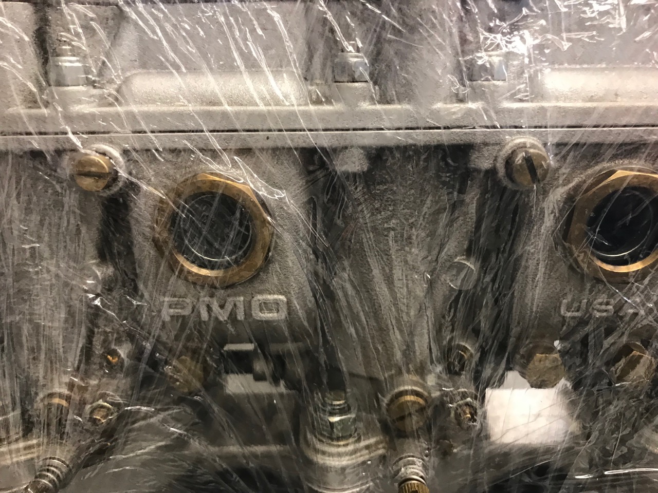

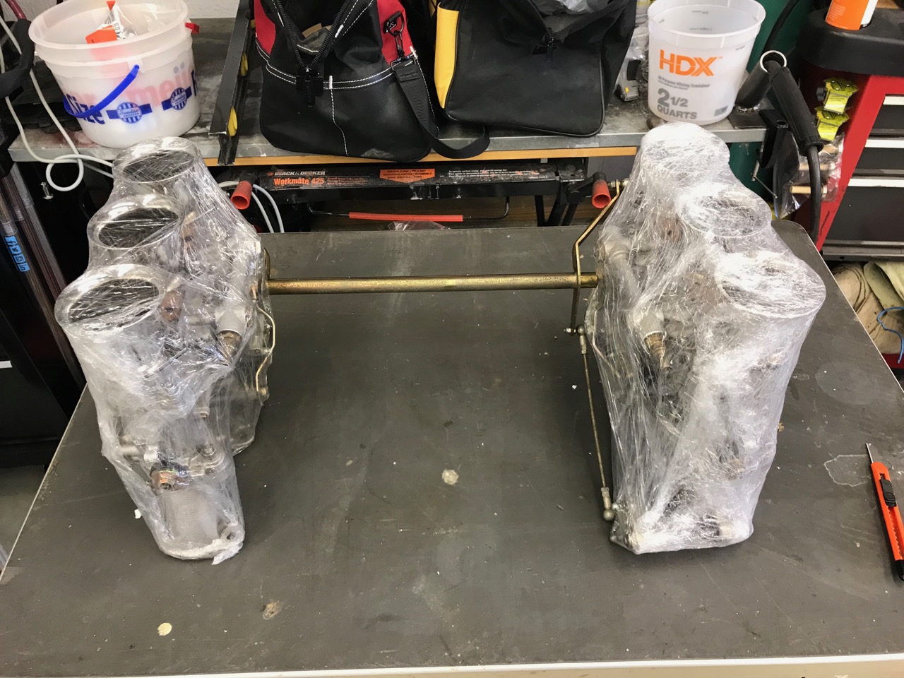

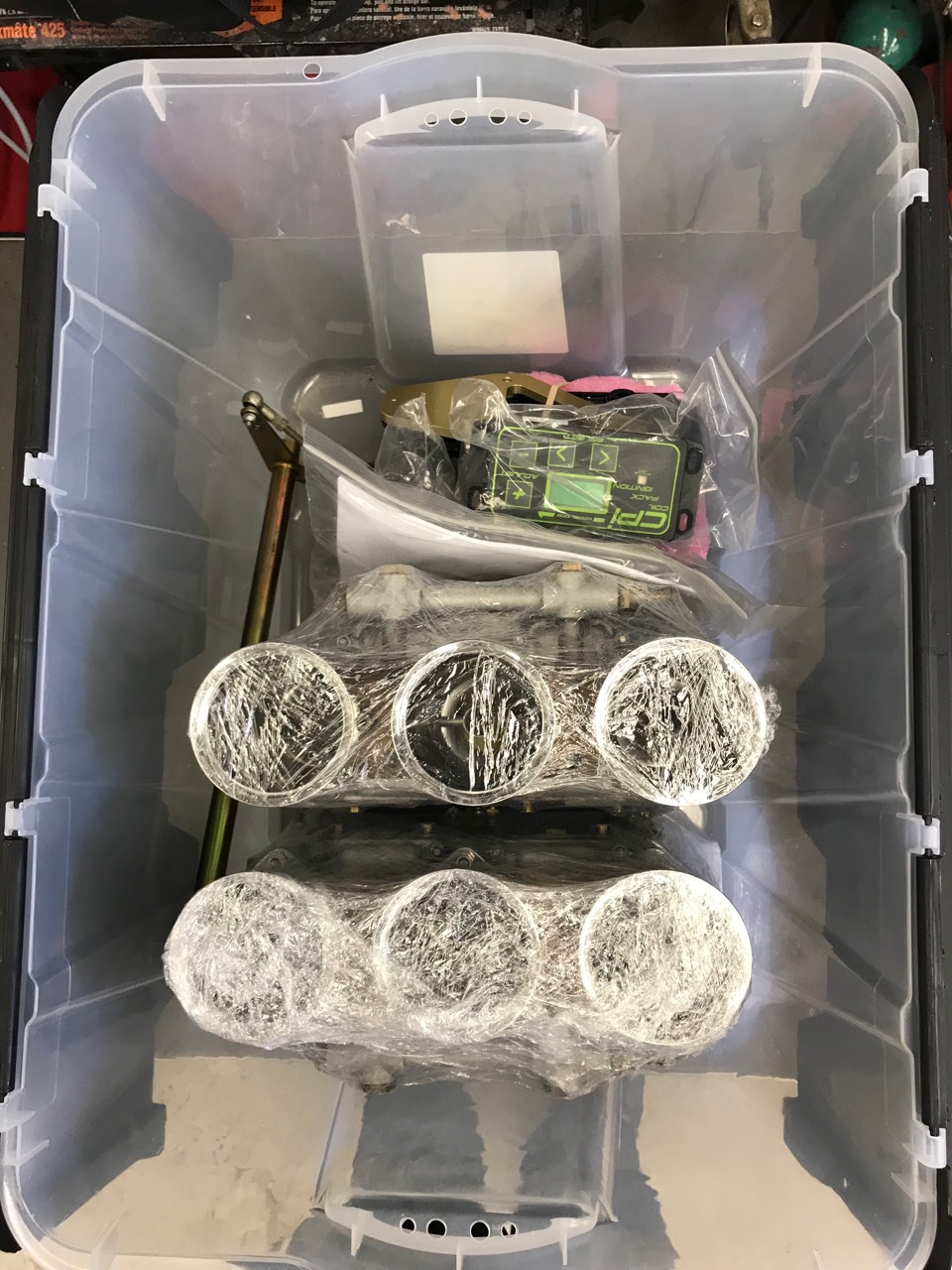

Let the parts gathering continue.
Some times a box full of peanuts and brown paper brings you more than drugs wrapped in coffee.
Today they brought me a different form of addiction.
Yes PMO Carburetors, will at least make the 914-6 go. Need to check the specifications of everything and get parts on order to make them right for the engine, car and altitude.
Did not unwrap them as I was putting them into storage, along with the digital ignition system.
EFI will be down the road, right now I need to get this car running. Everything else can happen as smaller projects to make the car better.

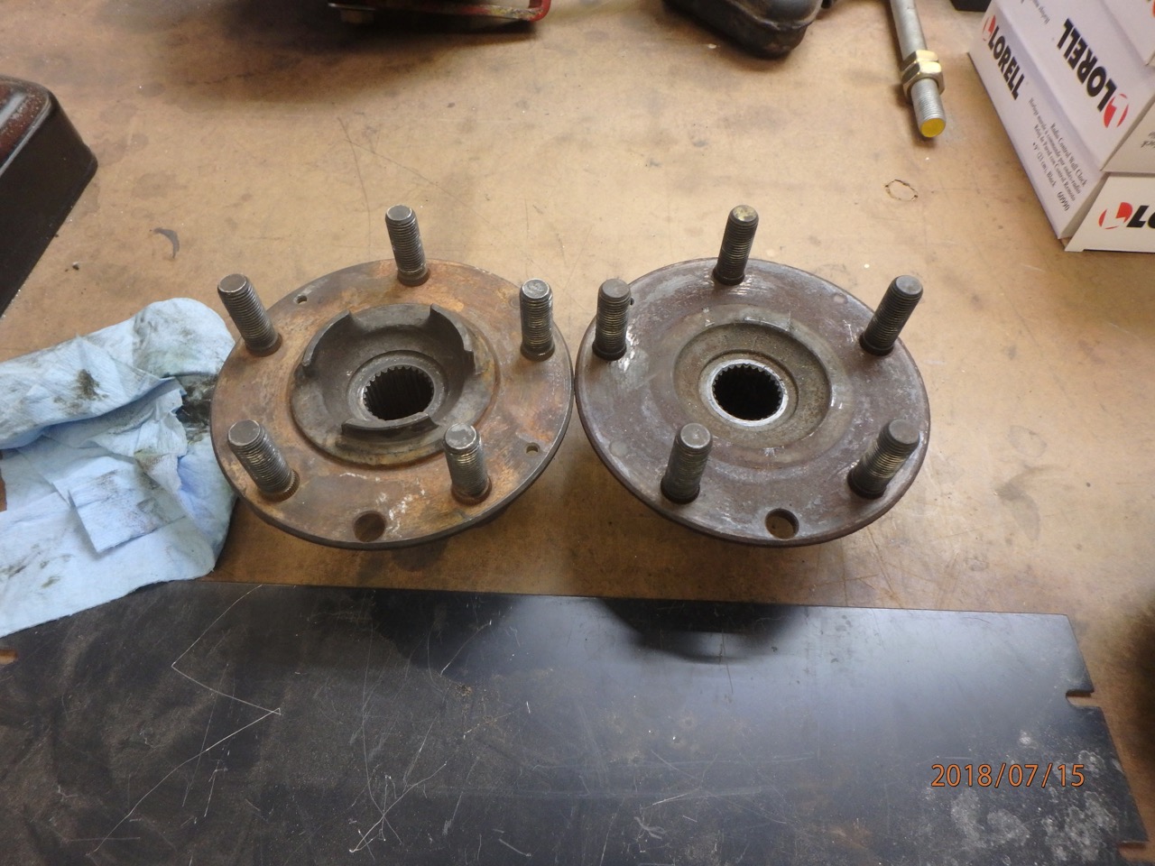

I have been doing a lot of gauge building for a few people, while I am waiting for a process to complete, I got back on Dad's -6 today doing a lot of the stuff that needs to be done. Prepping parts for cleaning, rust removal and paint. I am onto the rear suspension of the car.
Love getting in the shop

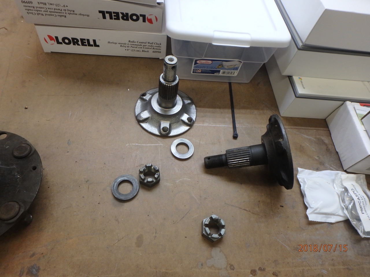

Up frist pulling hubs out of the arm and bearings off the backs of stubs. I mount the hub in the arm. Use my SirTools bearing puller to pull the hub out. Then go after the bearing race that always stays on the back side. These can be a bugger to get off. Mounted in my handy hub tool. I could take a cold chisel and give it a couple smash.gif on each side 180 degrees apart. That made enough space to get my bearing puller onto the back side.
Note th homemade centering and surface the bearing puller goes against. It is designed to center in the hub, and then hold the bearing puller screw in the center also. Makes for an easy pull. Simple to make a 3/8 wash on the top of 1/4 Steel from the scrap bin and a 3/4" nut on the back side with the points rounded off. Not pretty, does a great job. aktion035.gif
I took apart both arms, and did 6 sets of hubs off bearings.
Carnage as follows documentation makes me feel like I got something done today.
Late model 911 hub centric hubs on the left, original 914-6 hub on the right. Going hub centric - will need to machine the bearing spacer for the hub.
108mm stubs - 930 CVs here we come, no worries about CV joints.
Parts broken down. And a wheel that fell of the mower deck of one of the big tractors. Solid wheel because the area it mows has Locus trees, and the thrones eat deck tires for breakfast, lunch, and dinner, with a snack in-between. I need to get that one done, have not ordered the tire yet. dry.gif
Now to spend days cleaning all this up in prep for paint. And get parts ordered that are need to finish this up.

First up Passenger side sway bar mount. At least Prep.
So I signed up the backside with the notch in the wheel well and used a transfer punch to set my first screw location. Drilled it, opened it ou for the bolt, and bolted it together. Moved the transfer punch to the next hole, and got a center mark, and drilled it out. I then bolted the sway bar mount in place to give me the location of the lower hole. I marked the center, and then drilled a pilot and then used a step drill to punch it out to clear the not on he back side of the Brad's outer plate.
That all done it looks like this.
Click to view attachment'
So then I need to mark the center one the swatbar location. Since I was missing time on my metal lathe, I turned a spacer down.
Fits like a precision glove, well because it is a precision fit.
Transfer punch inserted in the last picture , give it a few hits with the hammer, and disassemble the pieces one last time. Probably not dry.gif

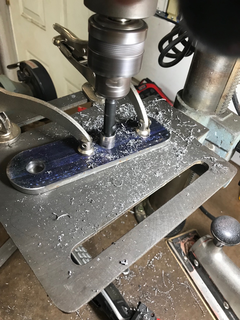

Drill a pilot hole and then drill the hole.

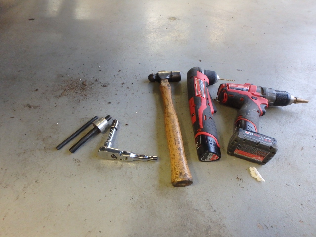

Tools of the trade to fit these, in a pile on the floor.
Small Ball Peen hammer
Socke wrench, extension and socket
Transfer Punches
Close Quarters drill - pilot holes
1/2 inch drill - step drill
Rotabroach to drill the big hole
Final Big hole drilled
And in place, well I', holding it in place, did not feel like bolting it all together to take it apart again.
Next up for this side is clean the undercoating. Scuff up the paint, and JB weld it to the car. Yes normally I would weld, but since I don't want to repaint, where the weld would burn off paint, it will be JB Weld. Brad says it will work, and I see no reason it would not work.
Oh the not fun part of my day, I have been working on one of the sets of MiniLites I have. Prepping for paint, as they where in good condition. But lots of small paint chips, and different colors. So following the instructions off a wheel restore that works on Ferrari Mag wheels I got to this point.
That one was sitting on my stool that turns, hate the stool, but it does a great job for painting wheels
And the last one, all where baking in the afternoon sun
Hope to get a bit more done on the wheels over the week, but maybe I will focus on the sway bar mounts and install. Would like to start having the car go back together.
And well my plan is to put it together, as McMark says a running driving 914 beats any of them that are on jack stands any day.
Stephen, what was the step drill used for vs the Rotabroach? - and what sizes were they? Thanks !
914forme
The Rotabroach was the size of the swayer reinforcement, can't remember the exact size. The Step drill I used to drill the bolt holes, I like using step drill because they debut the hole at the same time. The Rota's are great for drilling big in sheet metals, leave a nice clean hole. Love them.
Hope that answered the question and made it clearer.
