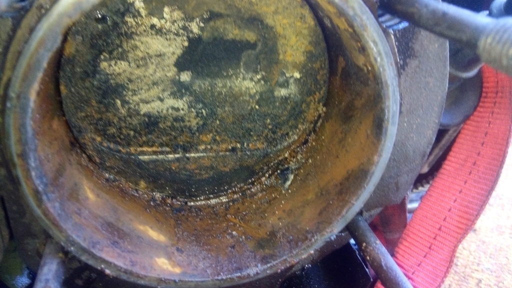

I have two cylinders with rust in them. One pretty bad. Wonder if I can hone these? Also, How the hell am I going to get my cylinders off the pistons with the rust? Here is a pic of the worst one.

Leave some penetrating oil on it for a day or so. And/or carefully use a flat instrument and a hammer to gently but firmly push/tap the cylinder jugs away from the case. My guess is that you'll probably need new pistons and cylinders anyway. Good luck!
Don't think a honing would do it?

Tough to tell before you free the jugs wink.gif. But the pic looks as if there will be pitting under that rust. And if the cylinders have never been replaced, there's a good chance they're scored after 40+ years.

Pretty sure there will be some pitting. Good news it's a VW not a 911, so you have fewer new ones to buy and they are less expensive.
New pistons and cylinders. ONly about 4 years on them.

Thanks for offering. I got a stock set of jugs. If the rusty ones are too far gone, I can have them bored. So far, only one of the cylinders looks like its got pitting. Hopping its not so far gone as to be beyond honing out.
The rings, however, seem to be rusted into the grooves. Gonna give them a long diesel soak.
The generosity of 914 people never fails to amaze me. Sniff. Must have dust in my eye all of a sudden.
