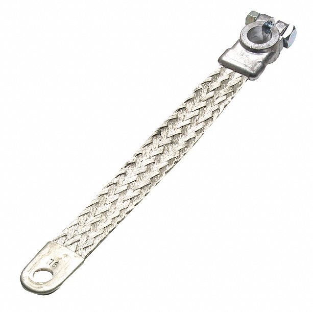

Help me decide on the main battery ground placement? Battery will reside in the trunk from now on:
I could use the stock location for the battery ground. I’m not
Sure if there are drawbacks to the extra length (?) .. but then I would have to drill for another large grommet into the trunk - not liking that.
Literati914
May 31 2024, 06:50 PM
.. or I could possibly just add a bolt thru stud above the neg battery post and run a short neg cable like stock. Any drawbacks to doing it this way? :
ClayPerrine
Jun 1 2024, 06:01 AM
I would put the battery back in the stock location. But if you are not going to do that, then put a stud in close to the battery tray and run a short cable.
And a braided ground cable is better than the one you show in the picture.
Literati914
Jun 1 2024, 10:01 AM
QUOTE(ClayPerrine @ Jun 1 2024, 07:01 AM)
roger that.. thanks.
