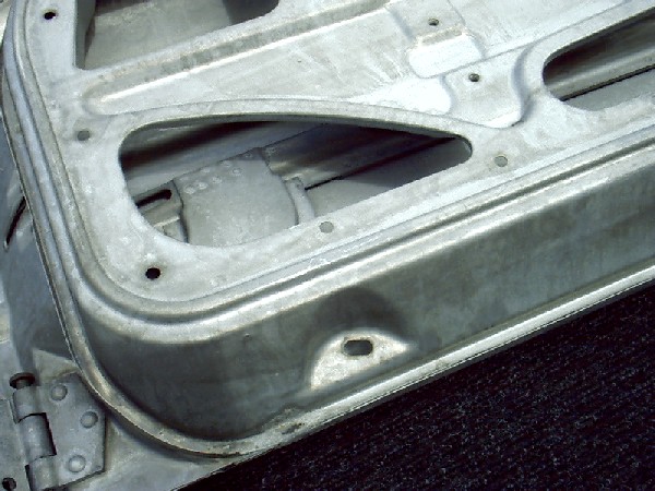

I voted for strip it to bare metal, both here and with my wallet! I didn't want my baby to die an early death of some form of cancer. Plus the PO(s) had covered her with at least 3 different layers of so-so to crappy paint and the bondo on the drivers side and trunk lid were pretty thick!
Here you can see the shiney surfaces like fenders were soda blasted, and the dull places like wheel wells were sand blasted. blasting cost about $1K If you don't have the skills, I would budget at least $15-20K for the stripping, body work and paint! It hurts to think of it, but I think the finished result will be someting I can gaze upon with pride for many years!

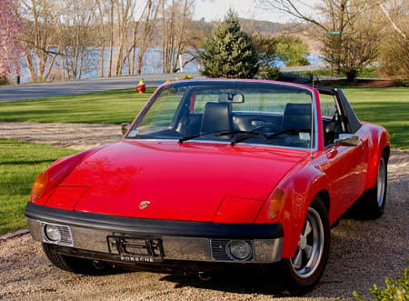

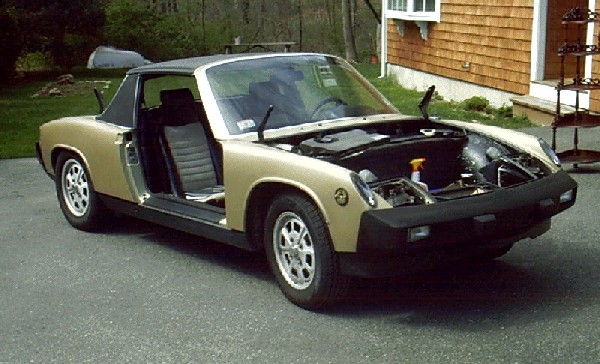

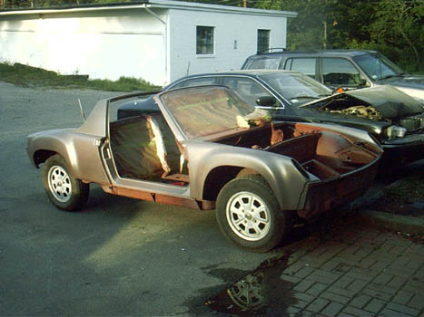

Apr 28 2007, 05:47 AM
I too was worried about being able to get as durable a paint job as the factor, and also about removing paint from areas where I could never replace it. So I dipped my doors, engine lid, and headlight covers. Then I had the trunk lids blasted, to keep the paint plus Ziebart intact in the channels.
That pretty much left the four fenders, and after cutting them out for flares, there wasn't much of them either. My car had been repainted, back in '80, so I could hand sand the fenders and use the different paint layer colors as a depth gauge. I took it down to a mottled mix of original primer and original color, mostly primer.
My car was virtually rust-free. Trunks and engine compartment were Zeibarted after that repaint in '80. Terrible stuff to live with, especially in the trunks, but after soaking it off with solvent and rags, it had done it's job. I left it on the undersides, just cleaned it and freshened up the wheelwells.
Every car is different and needs its own strategy. The hybrid approach worked for me.
Click to view attachmentClick to view attachmentClick to view attachmentClick to view attachmentClick to view attachment

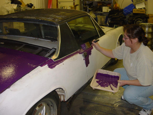

Apr 28 2007, 08:44 AM

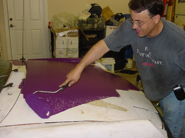

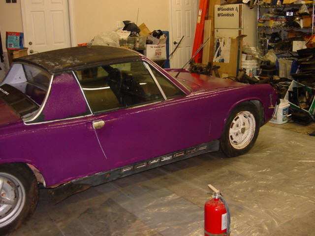

I don't think you need to remove all the old paint.. just get a nice, thick napped roller and paint right over that rust, dirt and anything else you happen to find.
Click to view attachmentClick to view attachmentClick to view attachmentThen the owner sees his car and ends up looking kinda like this...
Click to view attachmentSeriously.. with cars as old as ours, you almost have to take them to bare metal to get them right. After 35 or more years, you don't know what horrors could be hiding under the seemingly original paint.

Click to view attachmentI'm on my second strip job now, first was my 74, now my75. I'ts a HELL OF A LOT OF WORK....did you get the emphasis--Not for the faint of heart.
Also consider, after you strip and re-work the body, everything else looks like crap, which leads you down that slippery slope of refurbish/replace/$$$$$$.
Lastly, once you determine the bottom line for your budget, double or tripple it and then you are closer to reality.
