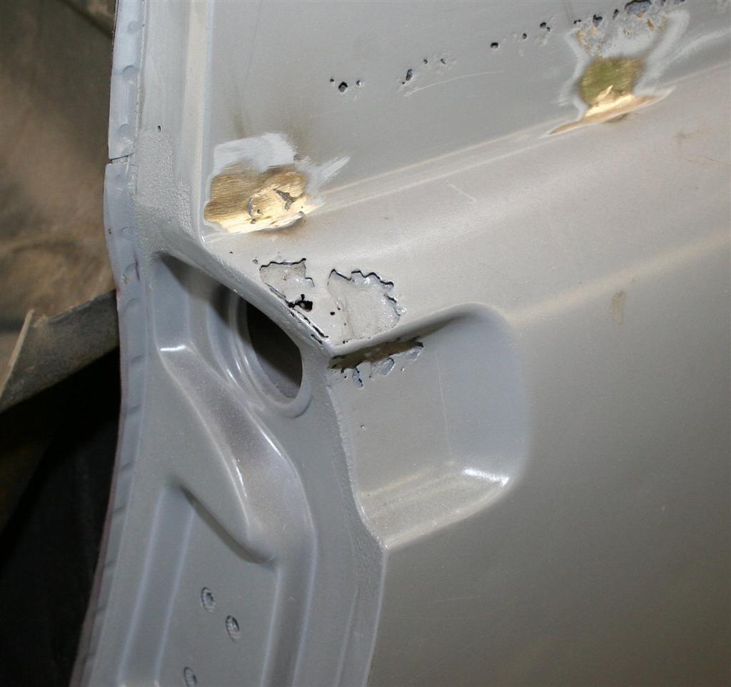

Here is an example of what media blast will reveal....didn't look too bad until after blasting. Look inside the door handle cavity on the top. It looked perfect before blast and would be difficult to get power sanders into but showed up easily after blast.
