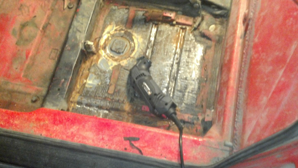

If you're removing them for good / not trying to salvage the shelf, I found it easiest to use an angle grinder and/or an air die grinder with a 3" cutting wheel to grind off the spot welds -- much faster than spot weld cutters. And if done slowly/judiciously you won't have to fill in the little circles left by the cutters.
Just grind the area of each spot weld until it is paper-thin, then carefully pry it away. Easy-peezy, especially after you get the hang of it.
Geoff
rohar
It's been a couple hours and nobody replied, so I improvised with the grinder, seems to be my default. You don't want to know what happens when the wife leaves me without direction in the bedroom.
Seems much of my near future is grind, weld, grind, weld repeat until dead.

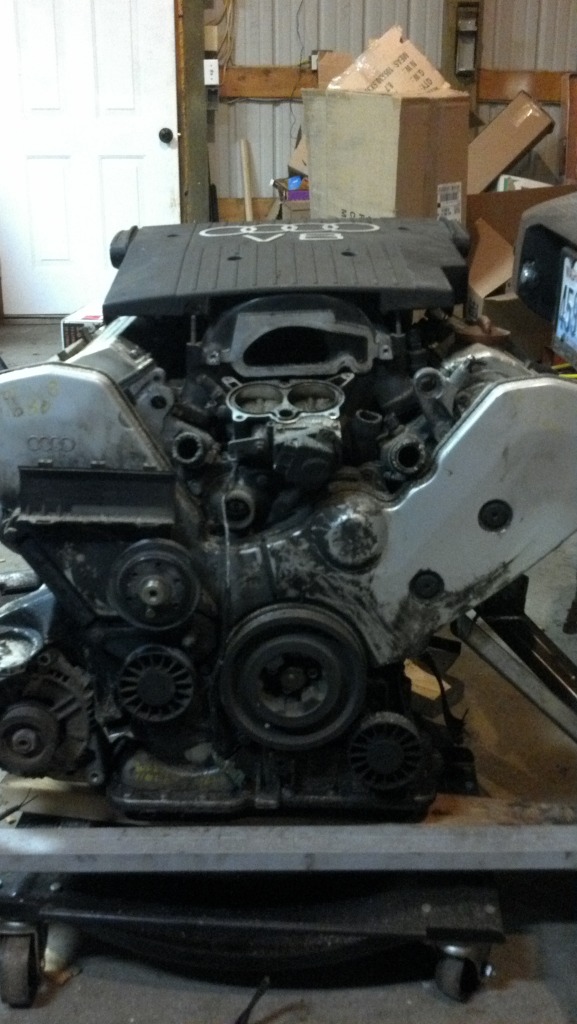

More parts arrived today. I've got an airbox!
Problem is it's too damned tall, this isn't gonna fit under the engine lid:
IPB Image
On the up side it didn't cost much and I've now got a plug to mold something that works. Who's dumb idea was it to put an Audi V8 in a 914 anyway?

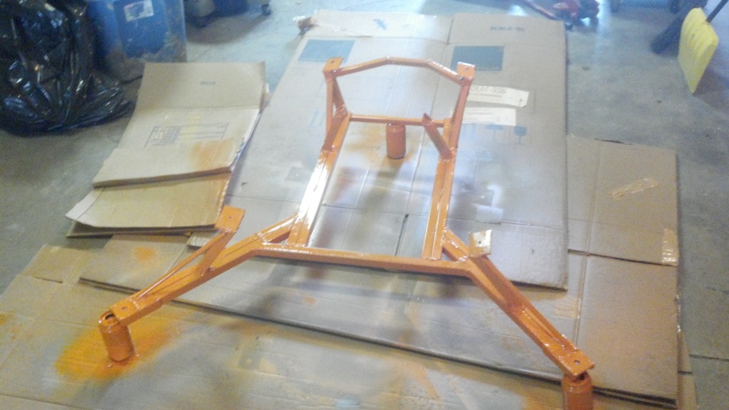

Lately there's been both time and money. This never happens. I just wasn't happy with the motor mounts I made so this happened:
IPB Image

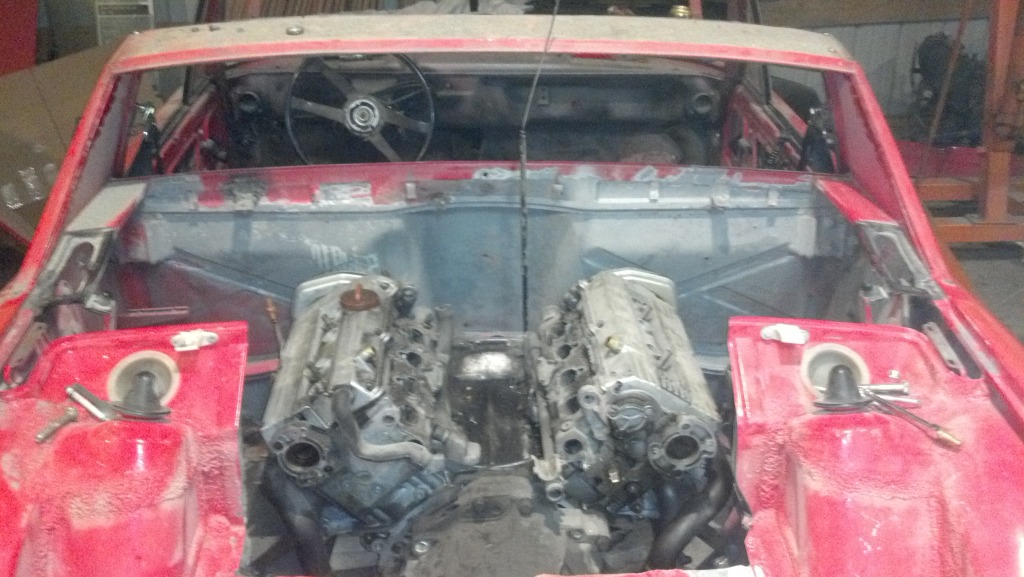

After a little blasting, that hell hole isn't so hellish after all. I'm gonna toss some more metal in there shortly just 'cause.
IPB Image

QUOTE(rohar @ Apr 15 2012, 04:46 PM) *
IPB Image
What size square tubing did you use? With all due respect, it looks too light.
rohar
QUOTE(JRust @ Jun 14 2012, 05:43 PM) *
QUOTE(rohar @ Jun 14 2012, 04:55 PM) *
WOOHOO! Clutch/flywheel solution is DONE! Flywheel's even got an integrated trigger wheel for the megasquirt!
Sure, now that it's done you want picks?!
Sadly, I forgot to replace the pilot bearing when I put it together, guess it's coming apart again. Pics to follow.
rohar
QUOTE(tomeric914 @ Jun 14 2012, 06:17 PM) *
It does doesn't it? 1" 12ga obviously doubled on the laterals and stitch welded with 1/2" solid diagonals on the forward mounts gusseted..
The math works out, the mount points will recover from a 500lb pressure deflection. Since the engine is only producing about 300lbs (ish) at those points all will be well if I managed to push some decent welds.
I agree though, it LOOKS dainty.
tomeric914
QUOTE(rohar @ Jun 14 2012, 10:27 PM) *
Doubled horizontally (as compared to a single 1" square tube), the deflection is roughly cut in half.
Doubled vertically, deflection in this case would be reduced by a factor of 4.
There will be a lot of different forces at work. My concern is the basic vertical load. A 500 lb static load may result in deflection of 0.1" and a max stress in the range of 10ksi. A shock load (speed bump, railroad tracks, pot hole, etc.) could be 5 times that resulting in stresses higher than the material (and welds) can handle, especially when repeated.
Your design may be perfectly fine, I can only comment based on the picture and information given.

rohar
QUOTE(tomeric914 @ Jun 14 2012, 08:54 PM) *
If it were possible to go vertical, trust me I would have. Because of where everything ends up (half shafts, exhaust etc) there just isn't room for bigger steel.
Once the engine/tranny are back together I'll bolt it all up with the bigger assemblies and reassess. Thanks for the input though, that's a big part of why we post these things in the community!

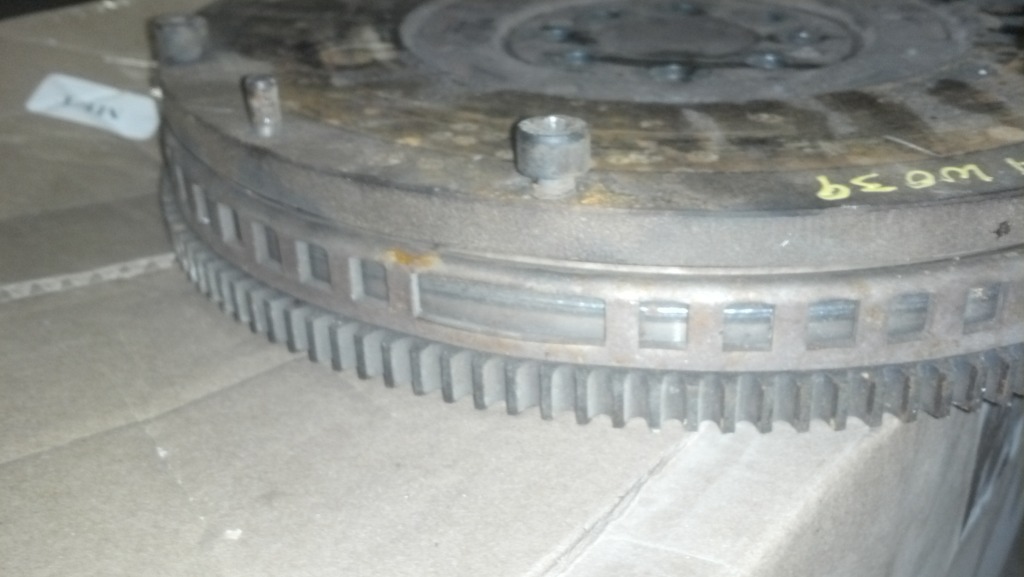

As promised, trigger solution:
IPB Image
It's dual mass so it's heavy as hell and doesn't leave much option for lightening it. On the up side, I can run cheap solid center clutches and there's one less thing to fabricate.
There's even a mount point in the bellhousing for the hall sensor. The VAG parts bin is awesome.

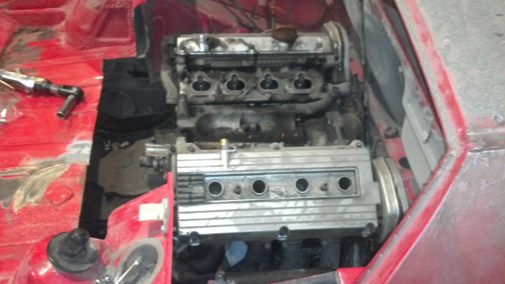

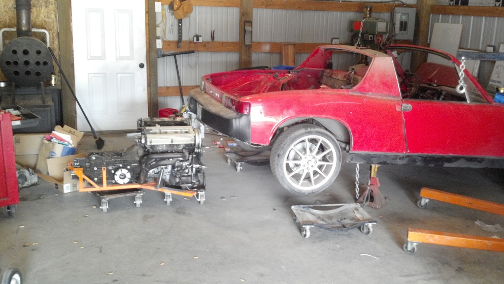

Ok, I've been neglecting the 914. I'm a bad man and I should feel bad. I can't help myself, the 944 is like 2 weeks away from being track ready so it's taking up the lion's share of my time. That said, I did procure these for the teener today. $275 for the pair, never used, only test fit. With ajustable sliders:
IPB Image
Gotta love craigslist!

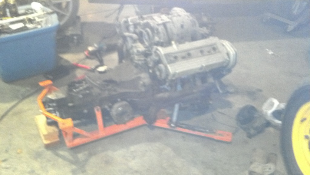

I know, terrible question to ask on your wedding day, but do you mind if I put this in through the rear?
IPB Image
Oh, and yes, there's a lot more metal to add to that yoke, test fit.

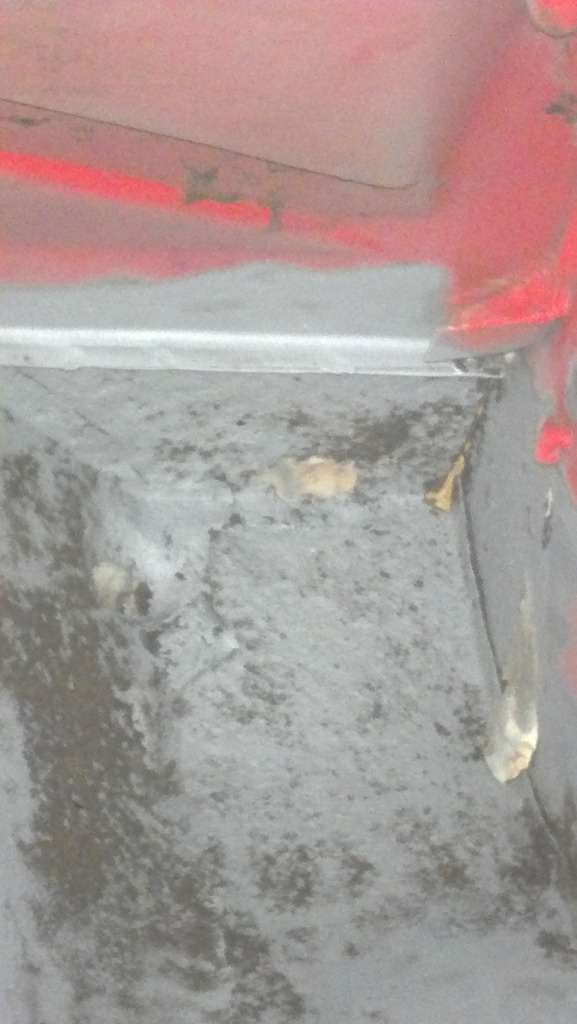

ALL the tar crap is off the floor pan. Only about 5 spots of light rust. Weather permitting I'll roll it out of the shop and blast them tomorrow. If all goes well, primer Sunday.

The belly pan and trunk are now completely rust free. Couple of spots in the trunk that will have to be cut out and patched. Nothing bigger than 2x2 and only two spots so I'm feeling pretty lucky.
While I was there, I tore the pedal box out as it's not gonna work and even banged a couple of dents out of the floor where some DAPO put a jack in the wrong spot.
Primer in those two areas tomorrow then I'm done with bodywork for a while.
Stainless fuel lines and intake manifold gaskets will be here early next week. Time to start putting the old beast back together.
