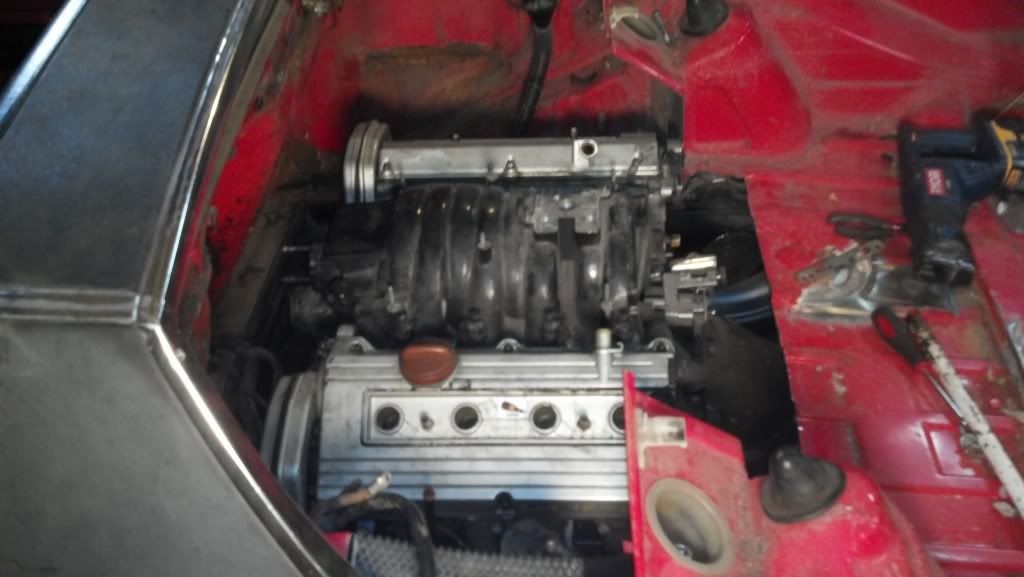

So with the acquisition of the 944, I've come to the conclusion the teener will be v6 powered. I'm pretty comfortable holding the V8 over until I'm done with the teener then doing a swap on the '44.

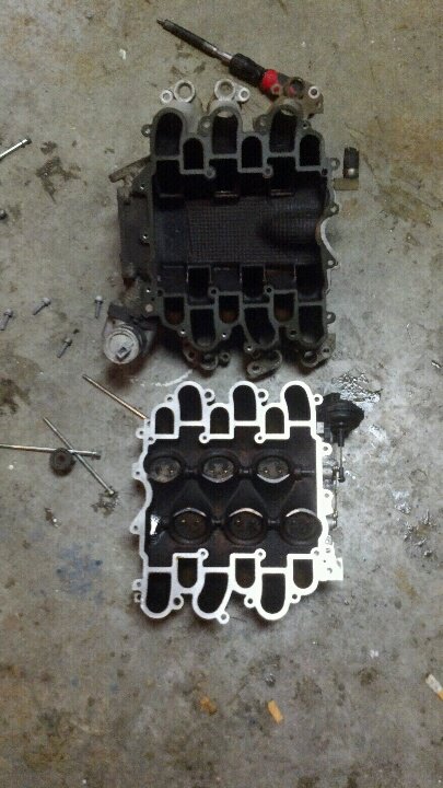

In the vein of getting something productive done today, I started tearing down the intake manifold. The flanges are symetrical, so the throttle can face forward or backward. Only problem is that the long runners (it's kinda like varioram on this one) hit a cooling pipe when flipped backwards. So I'm cutting the long runners off as I'm not gonna need the low end torque anyway. Now I've not worked with this engine a bunch, so when I opened the intake I was a bit surprised:
The upper half opens the short runners by a series of 40mm butterflies. I've got half a mind to keep the butterflies and use them as individual throttles. Sure, there'll be some external plumbing to make it idle, but it looks promising.

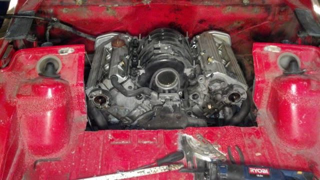

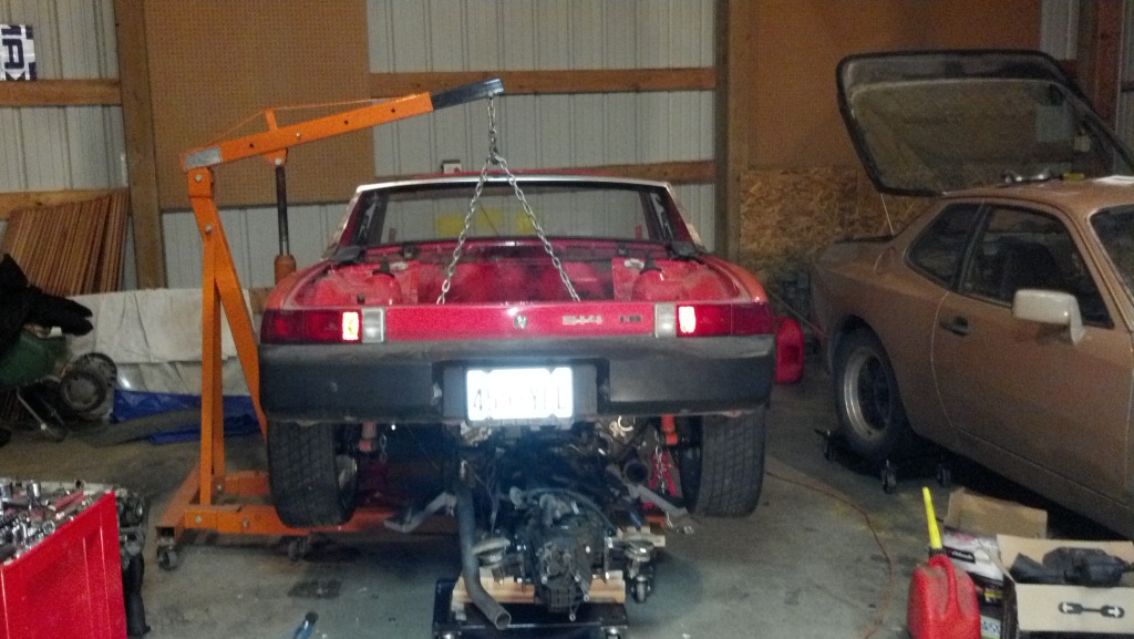

rohar
Dec 23 2011, 07:09 PM
Hey, you pull a v6 from a 914 your way, I'll pull it my way:

rohar
Dec 24 2011, 10:36 AM
QUOTE(aircooledtechguy @ Dec 24 2011, 08:01 AM)
Red-neck two post lift. . . All you need now is a big-@$$ pair of vice-grips at the base of the hyd cylinder as a "safety lock" in case of hyd failure. . . GIT-R-DONE!!

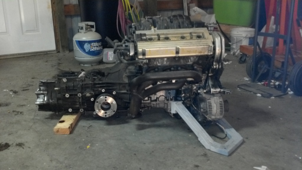

There was no way in hell I was getting under there. Got the engine/tranny down on a pair of dollies. Used a floor jack to get the chassis up about 2 inches and bolted the chain to the motor mounts. Jacked the car up in like 1 minute, went to the back of the car and pulled on the tranny. Slid right out. Then I put the chassis back on the floor really fast
You don't want to know my procedure for swapping engines on MK1 VWs.
Maybe I'll make more progress today.

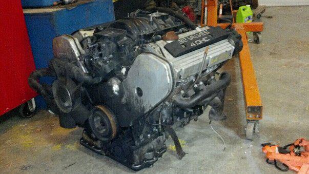

rohar
Dec 24 2011, 05:31 PM
That tranny sure looked smaller on the other engine:
Forward with the /8!

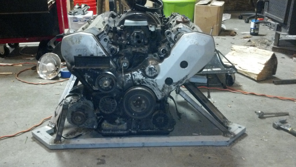

rohar
Dec 26 2011, 03:11 PM
Alright, things aren't going as fast as I'd like. Passenger mount is hell with the alternator AND the starter in the way. Threading the needle on this one.
Patterns are done, now to start cutting steel.

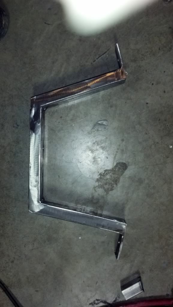

Dec 29 2011, 05:49 PM

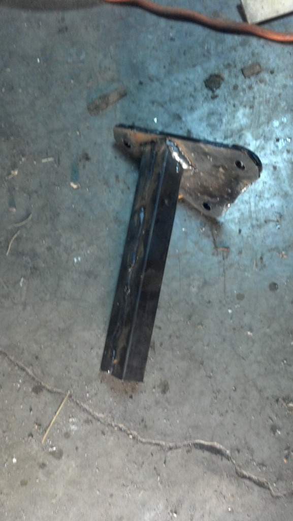

Alright, the motor mounts on the /8 are a bit much. More the passenger side than the driver's side.
The beginnings of a passenger side mount:
No really, I'm gonna make that into something worth having. Now stop laughing. Really, stop it!
rohar

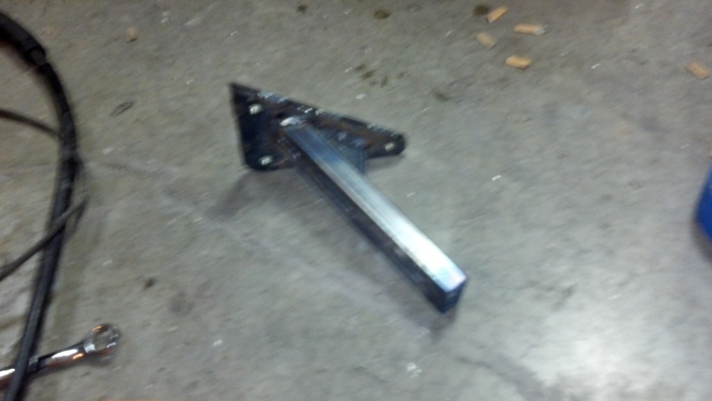

Dec 30 2011, 01:56 PM
Lookie here, one finished passenger side motor mount stub:

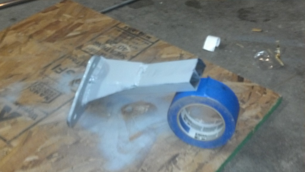

rohar
Dec 31 2011, 07:40 PM
Same song, second verse. A little bit faster and nowhere near as worse:
That engine is gonna get bolted to the chassis tomorrow.
Oh, and it's cold out there, I couldn't stop shivering so the focus on the camera is munged.

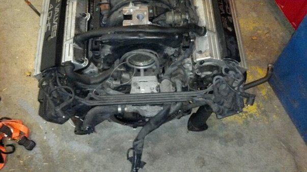

rohar
Jan 1 2012, 07:36 PM
It ain't mounted yet, but I'm well on my way:
Friggin nightmare engine...

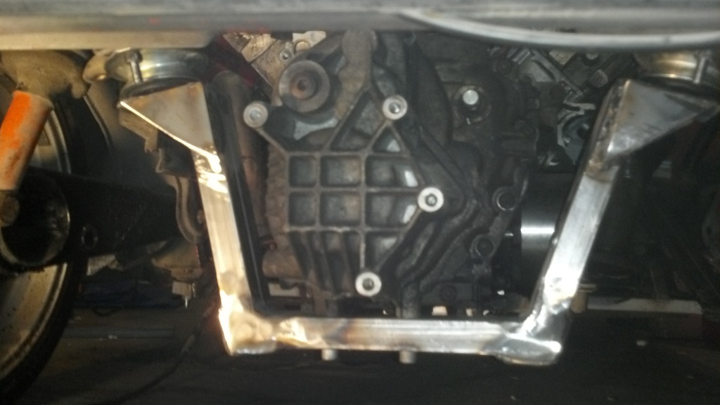

rohar
Jan 6 2012, 04:15 PM
I mounted a tranny:
No wait, I mounted a tranny:
It'll get some diagonals and some cleanup when I pull the mess back out of the car. I'm thinking next project is a lot of chassis cleanup and plumbing.

Andy, please tell me you know who that is! It would be a travesty if anyone over the age of 20 in this country didn't.
Yeah, it should be pretty quick. I'm paying more attention to keeping it driveable and dependable though.
