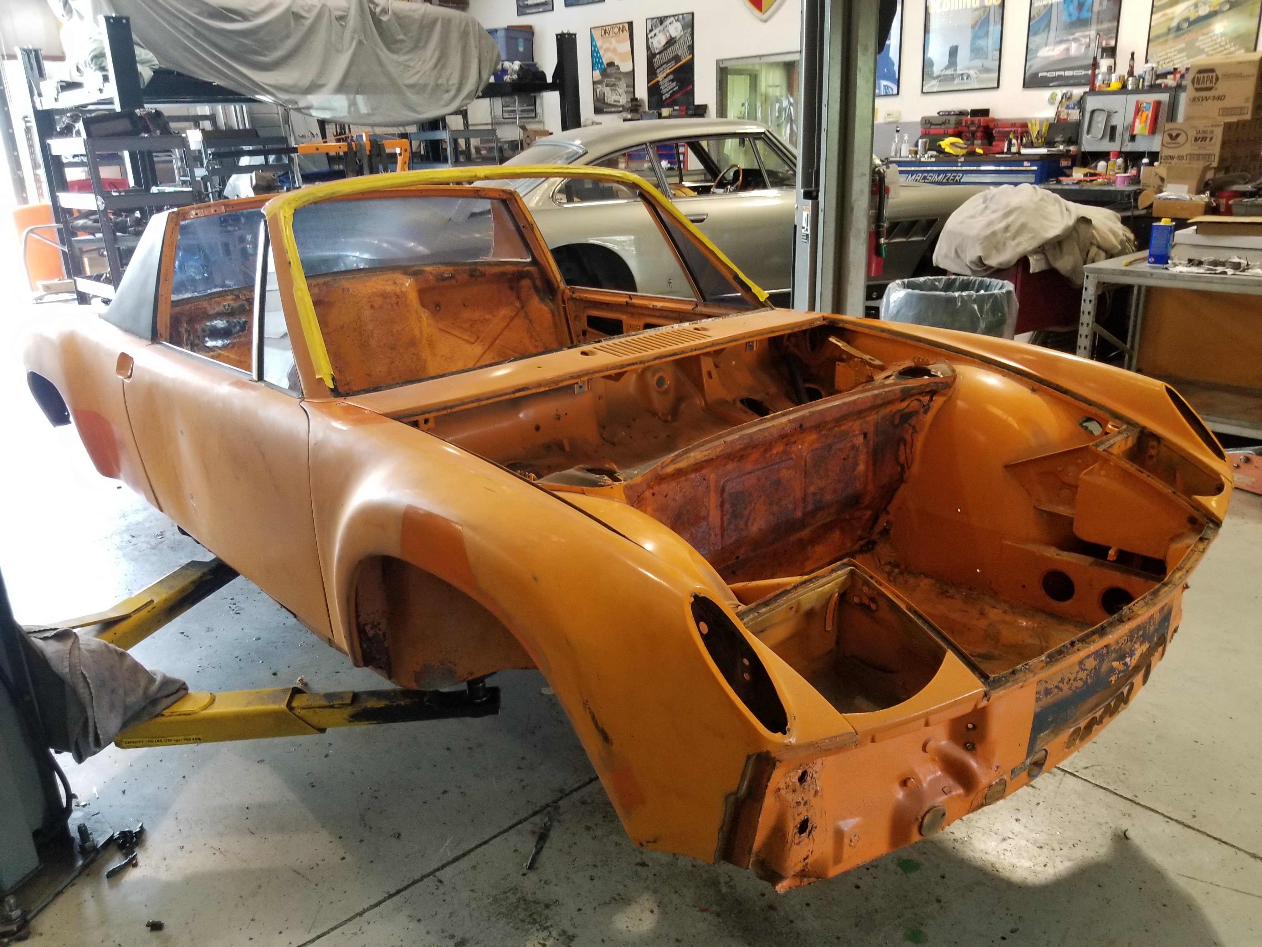

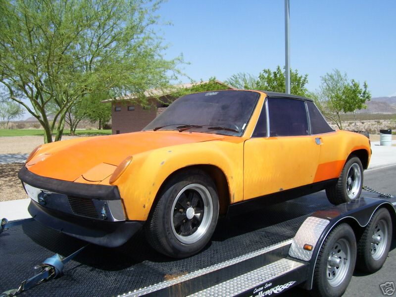

Here's what it looked like forever........... and when I got it. Photo is from the eBay ad 15 years ago (!)

So like I said, nothing happened except parts buying, which was another adventure. But last year, the ugly began. Doesn't look too bad prior to stripping...

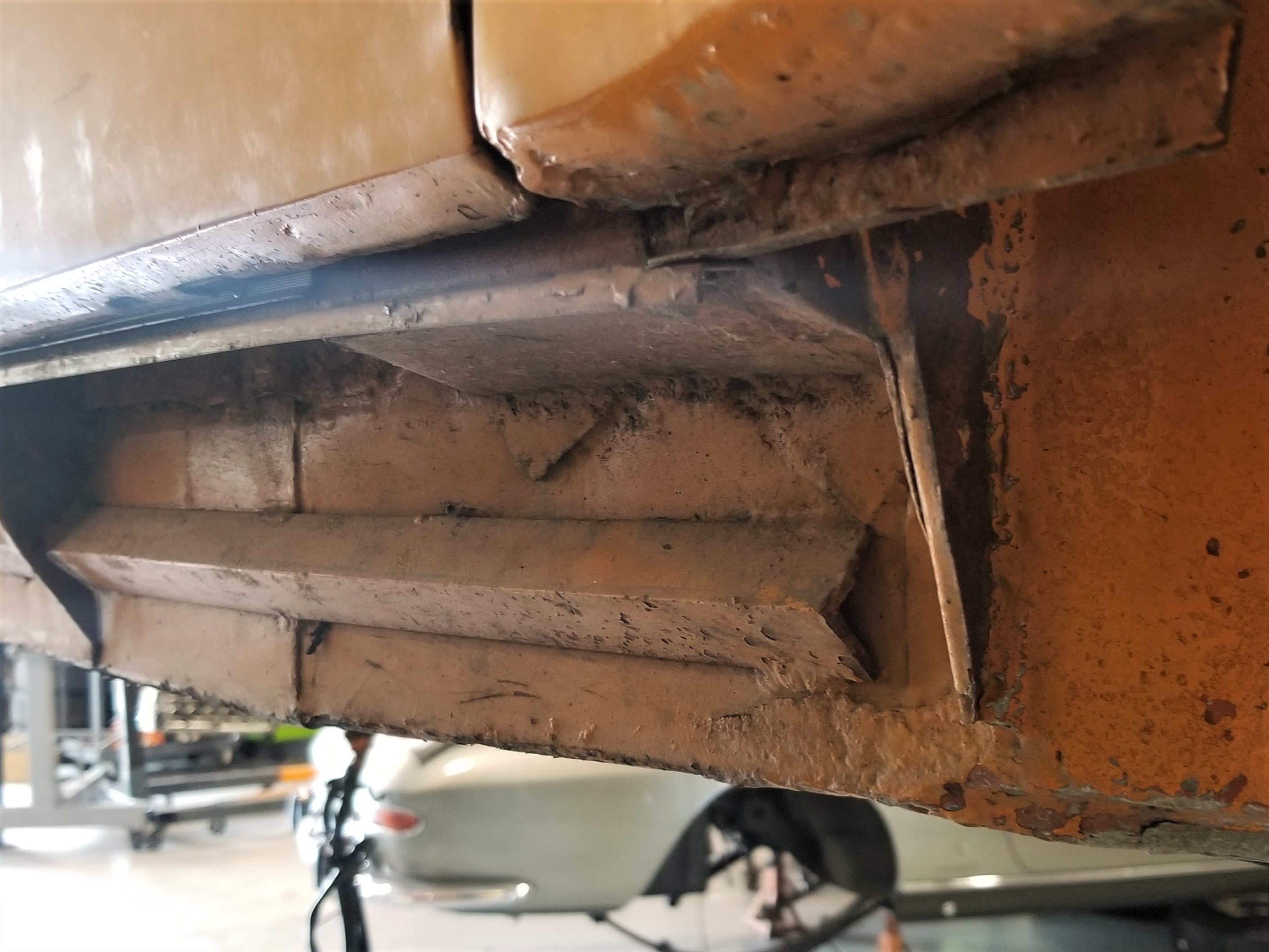

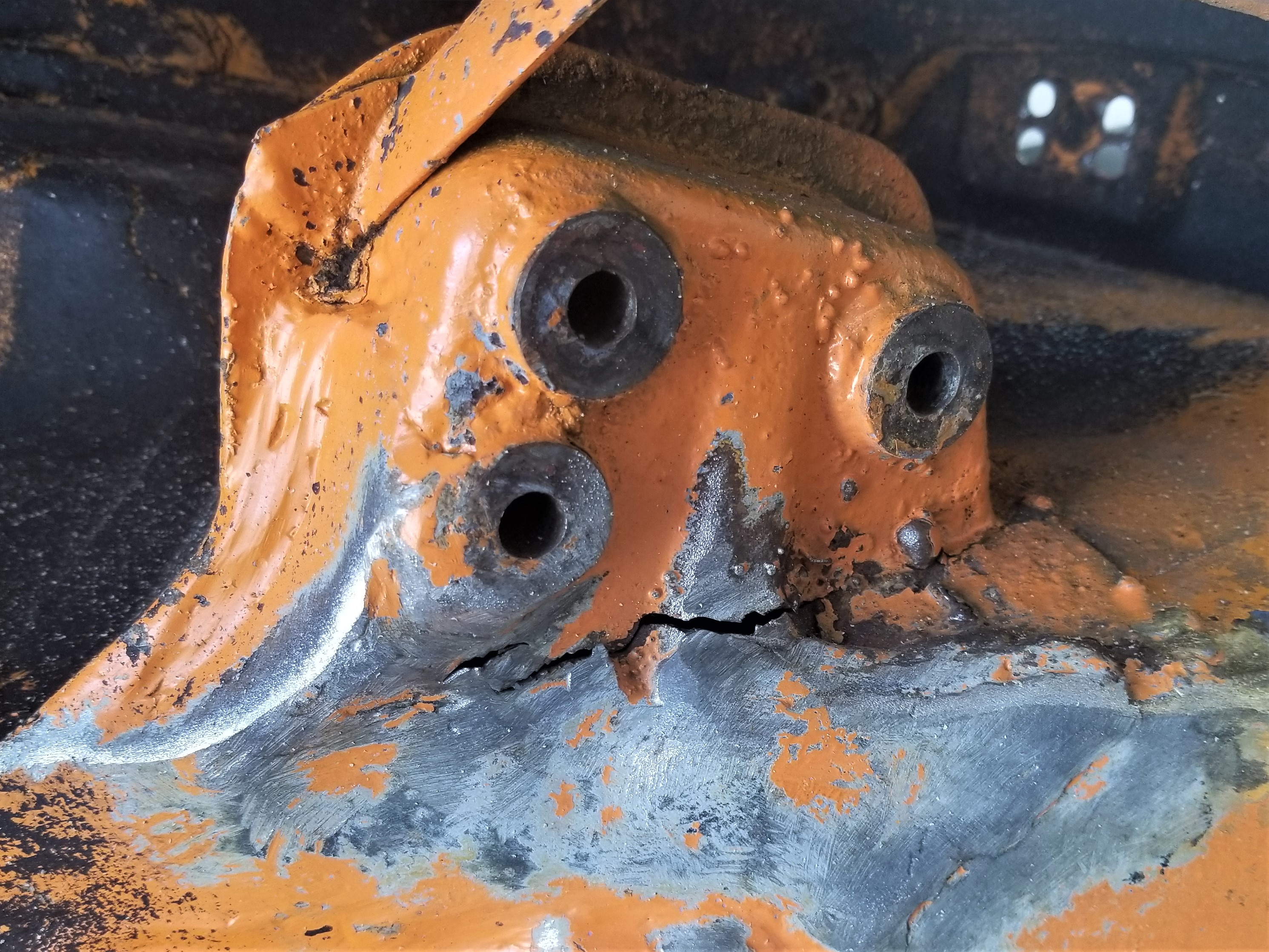

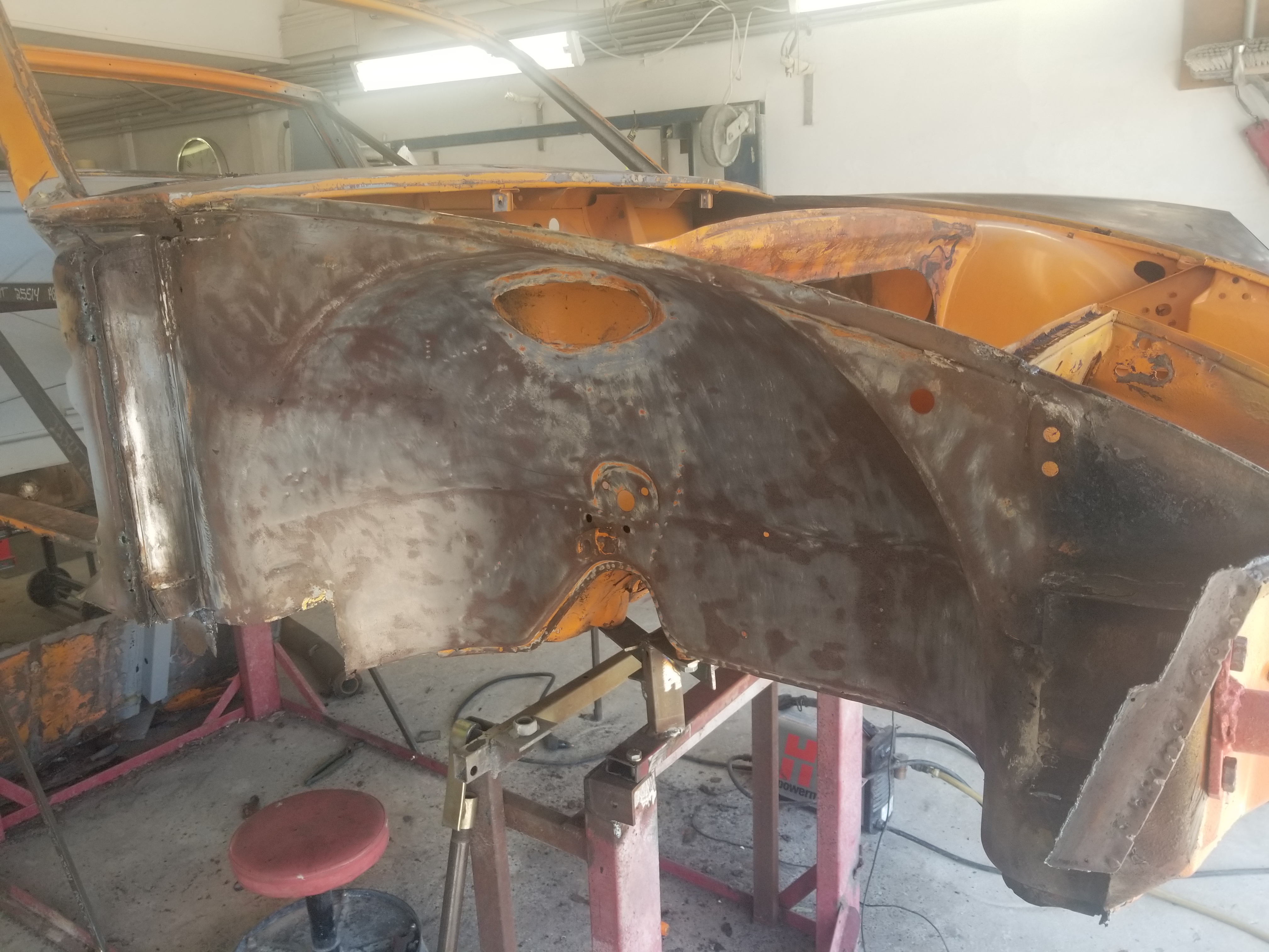

It's the early '70s... braze that shit! The patchwork repairs really makes you wonder what happened to this thing?

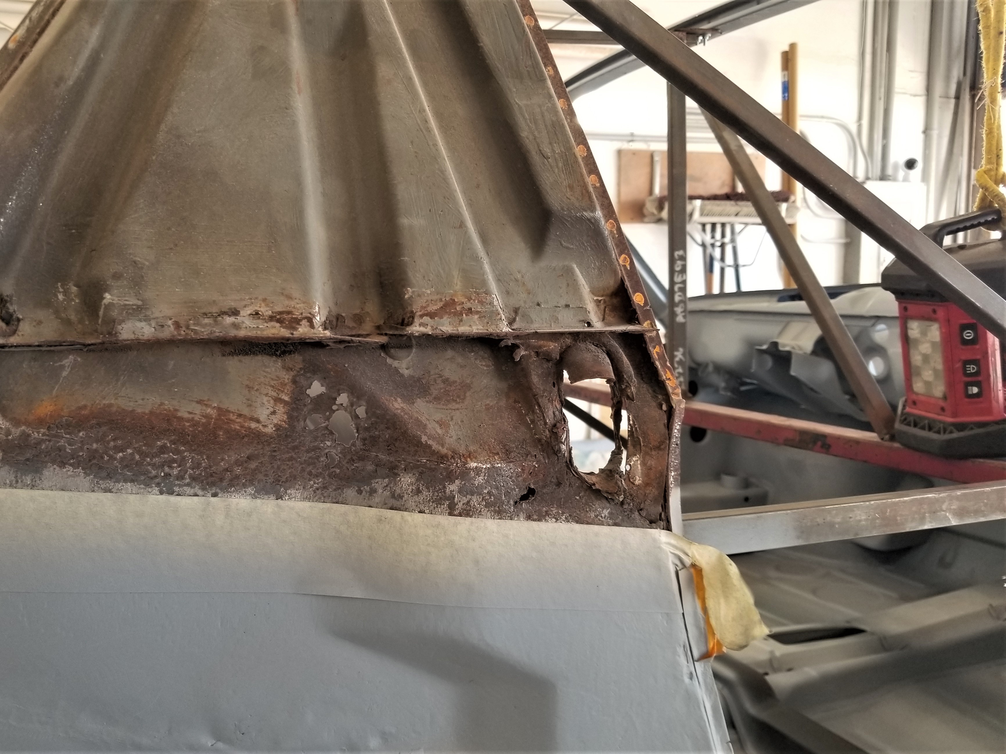

A hidden surprise and angle iron repair.

Given the amount of weathering and stress these little cars undertake over decades, doesn't look that bad to me.
It'll suck to redo all that brazing. Gotta admit, back in the 70's, probably nobody that "built" this 914 thought it was going to be around in 2022.

Thanks for the moral support. Didn't look that bad to me either, but it was... right side was rotten.

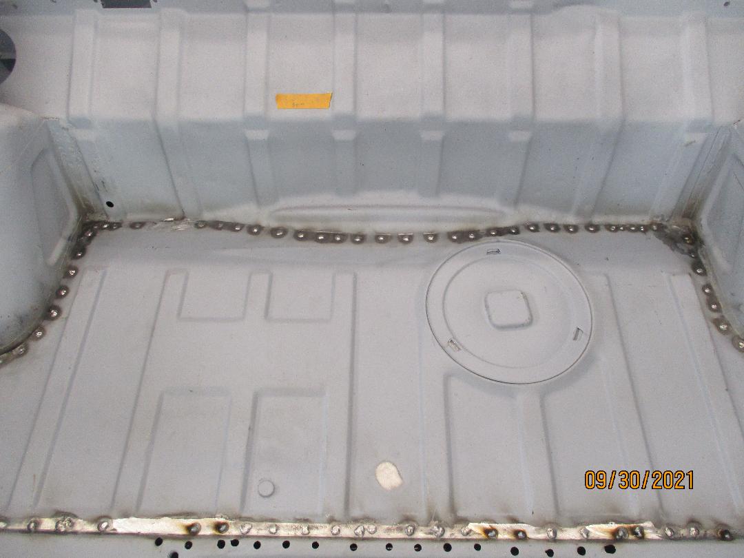

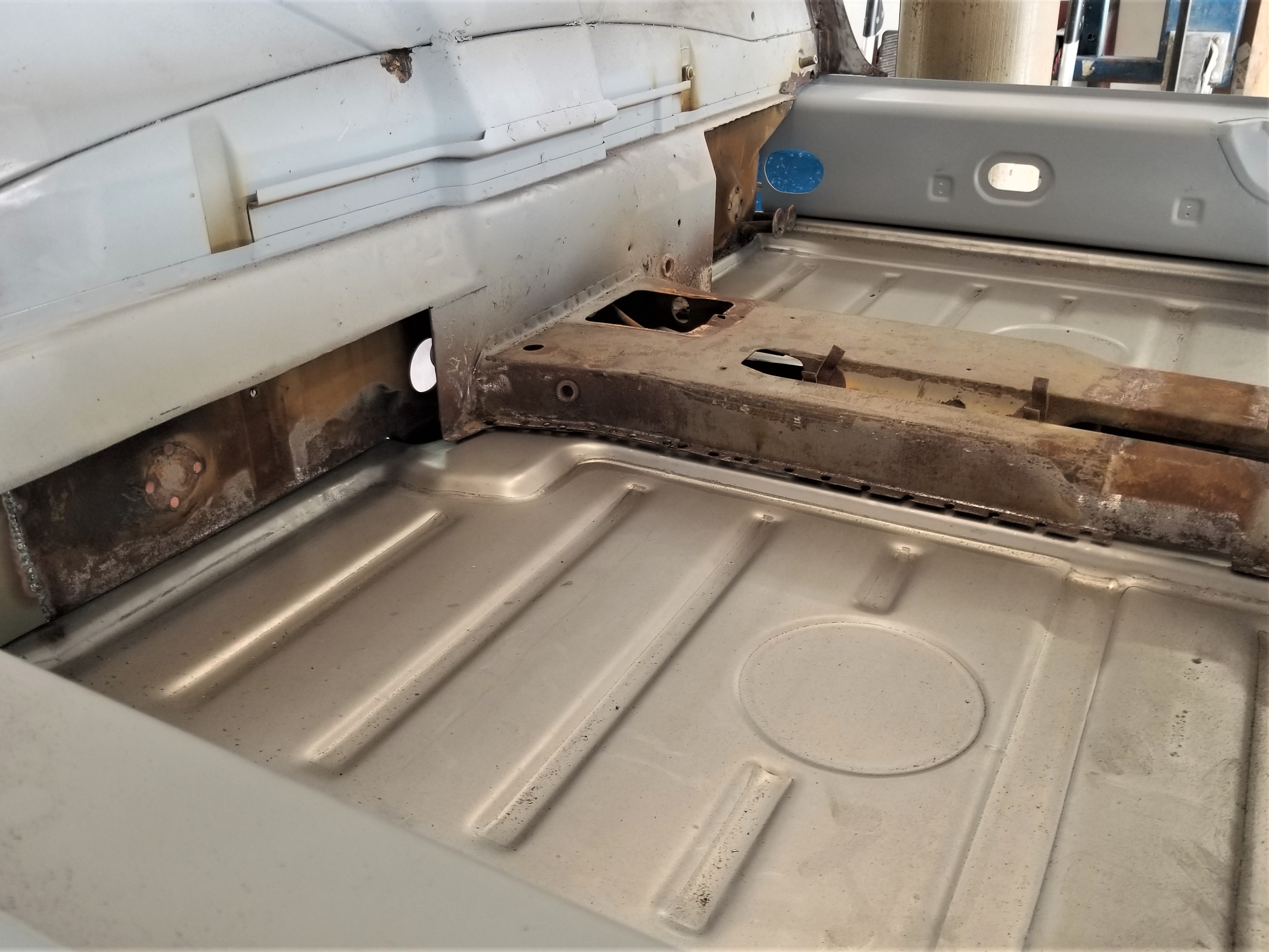

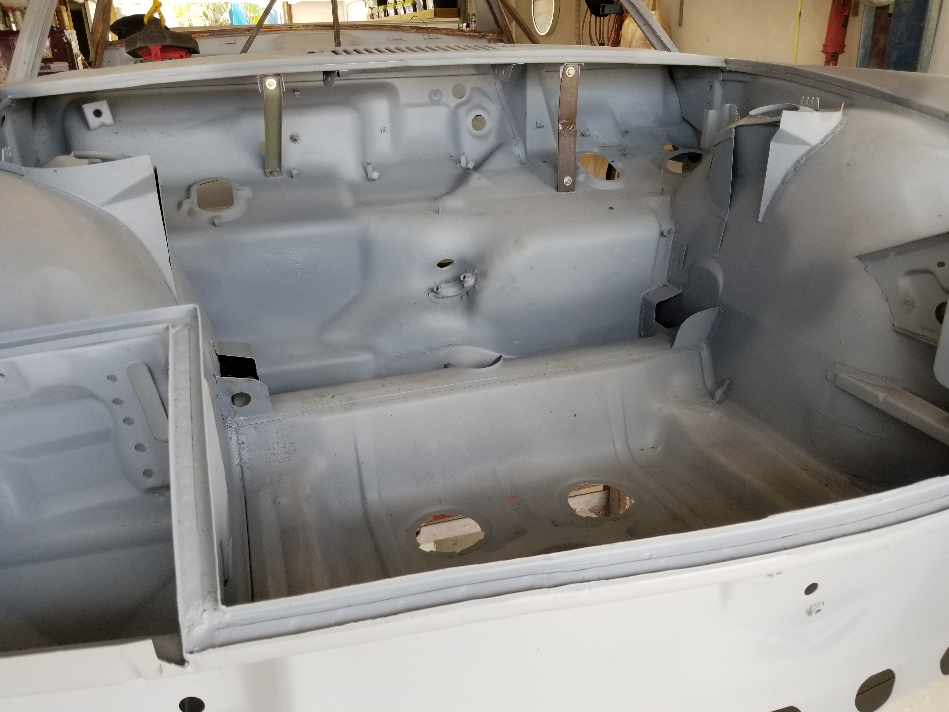

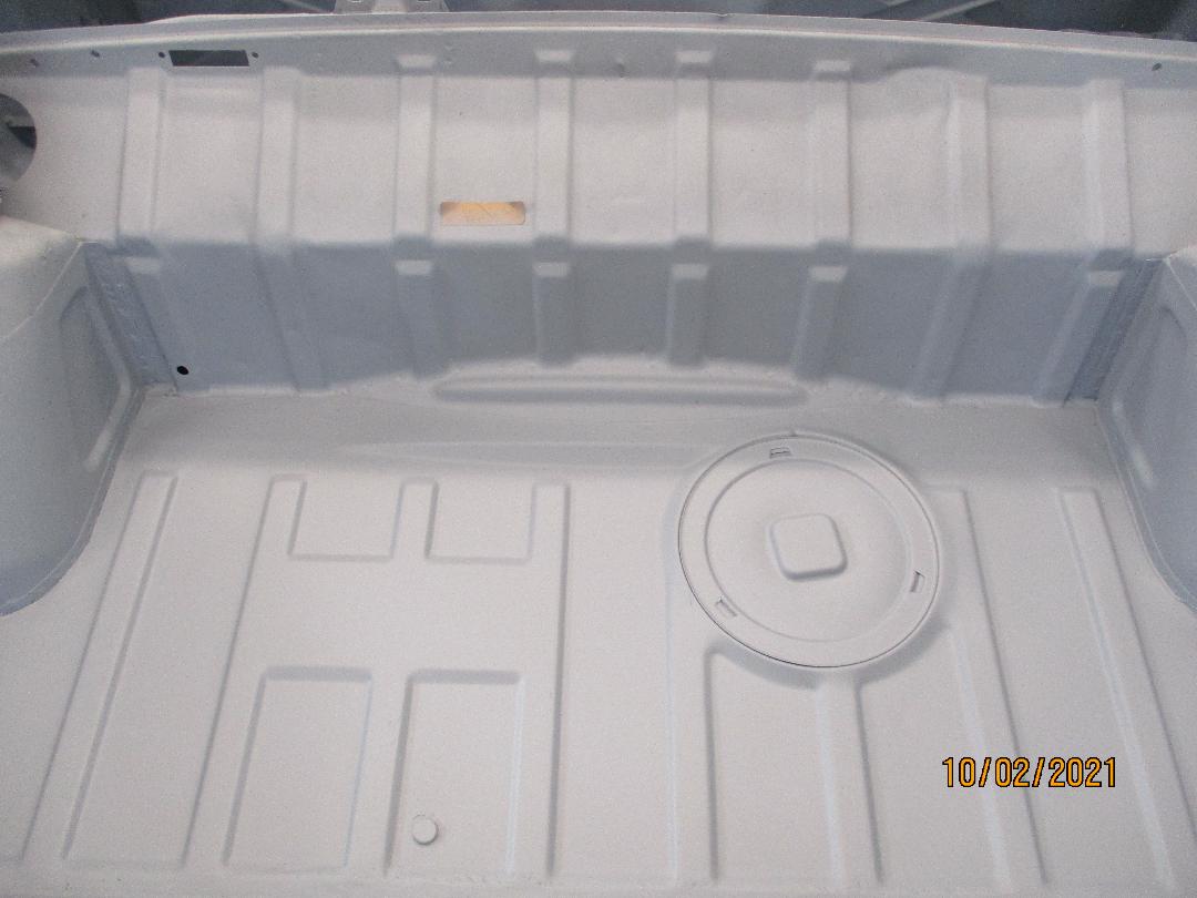

Same with the trunk floor... and it along with the taillight panel had apparently already been replaced at some point, the number was missing.

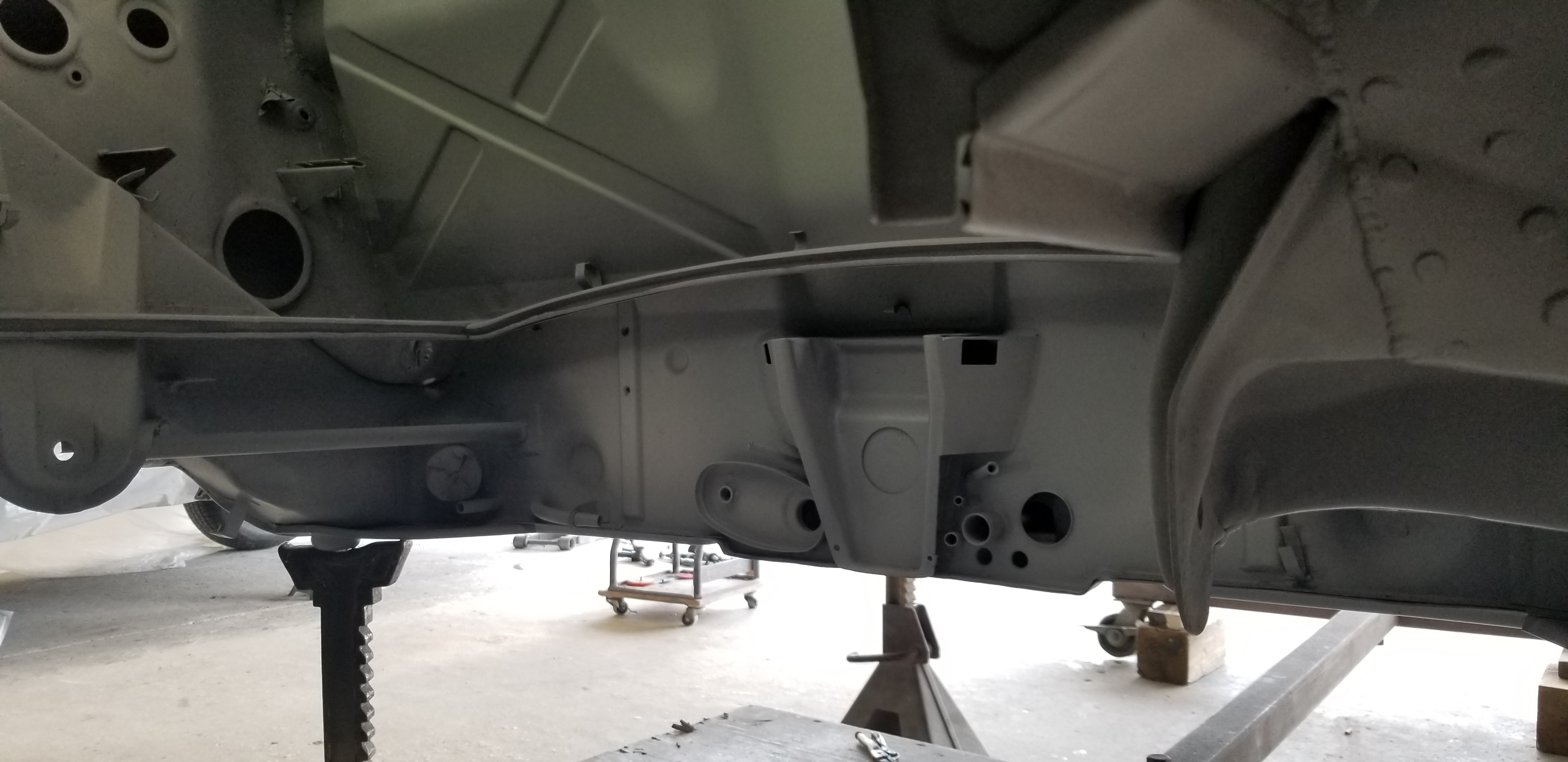

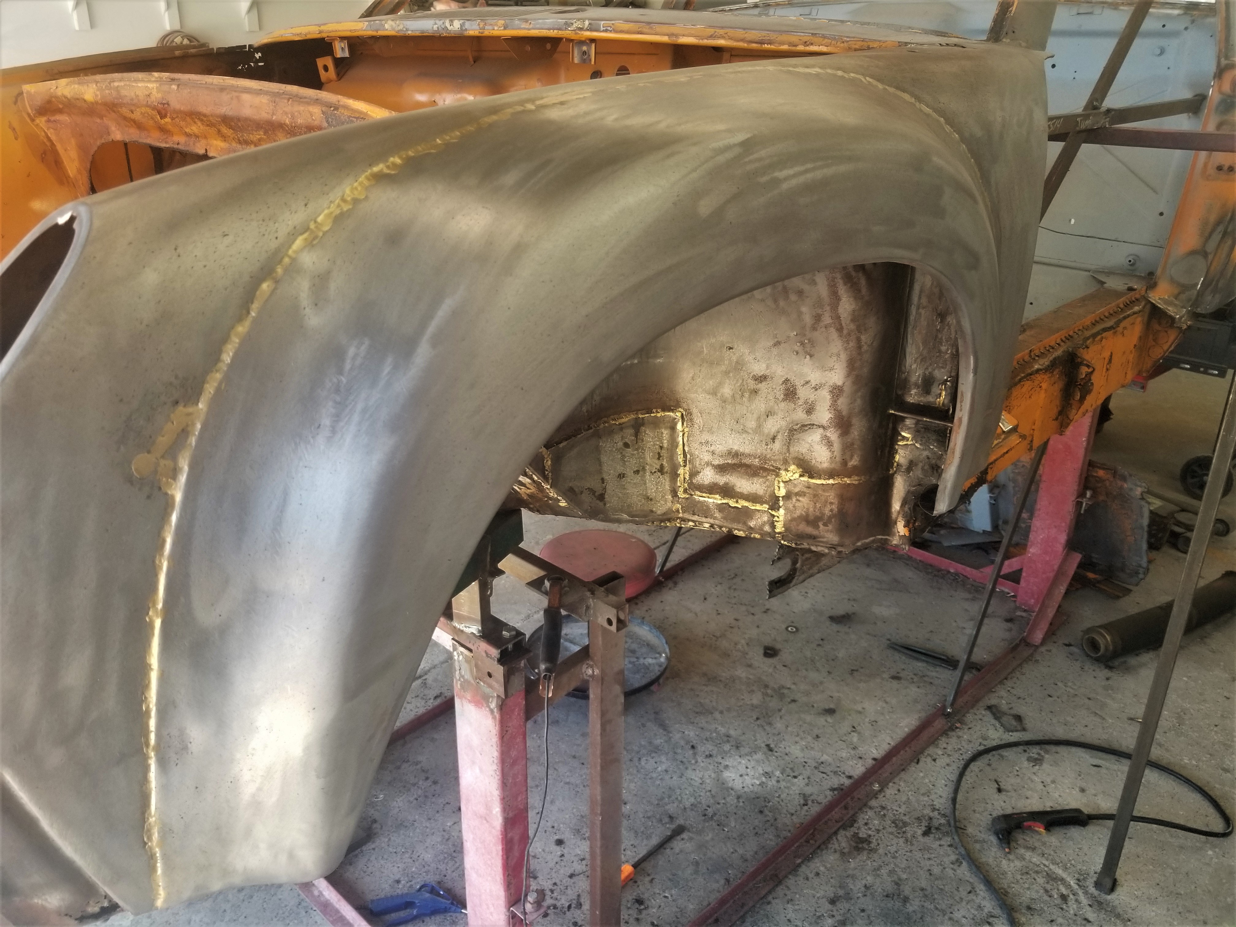

Pans, inner and outer longs, LS targa bar base, vents, pedal box, frunk & trunk floors... a LOT of steel. But that was the worst of it, and by January 2022 it started to look like a car again.

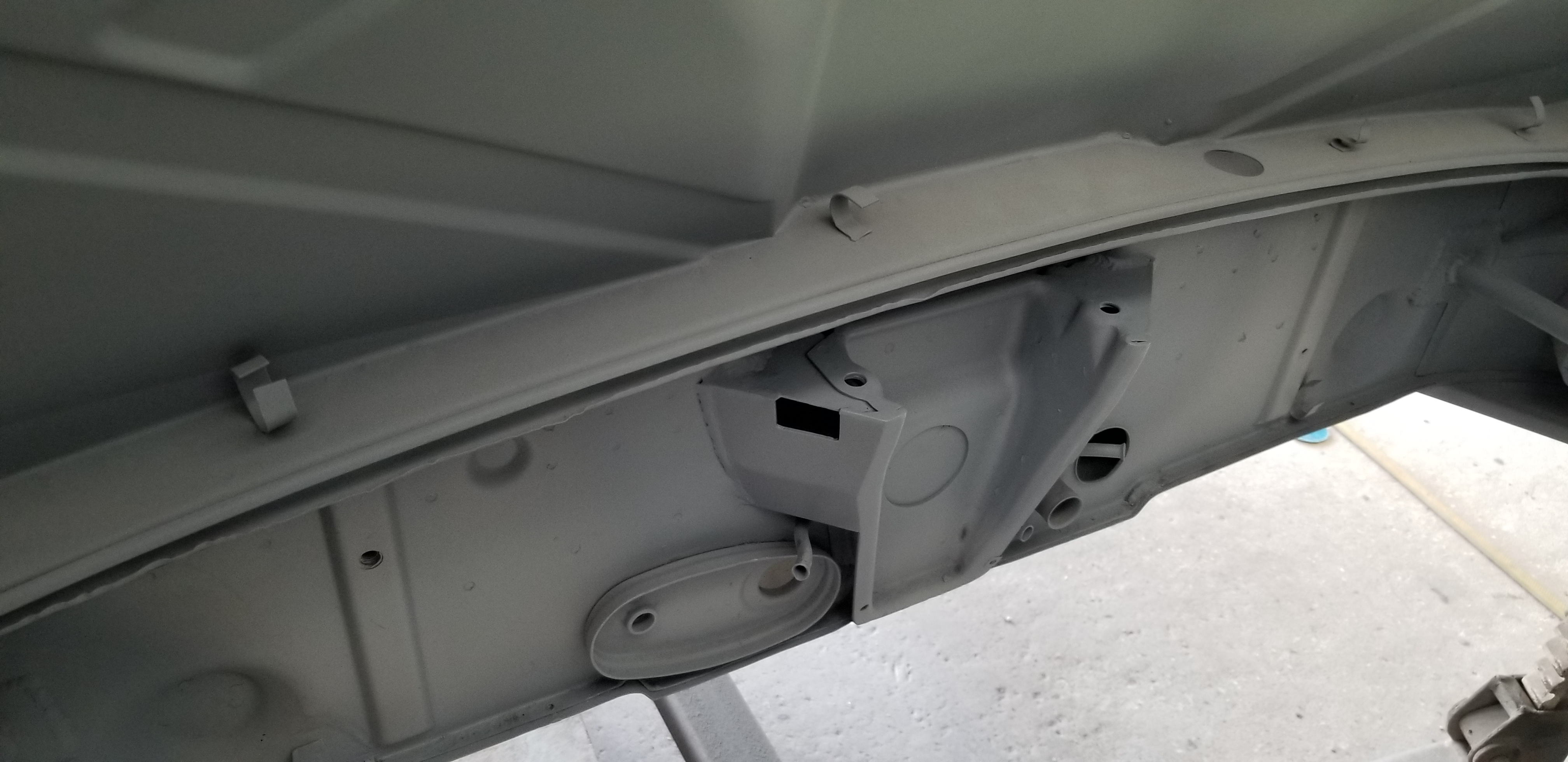

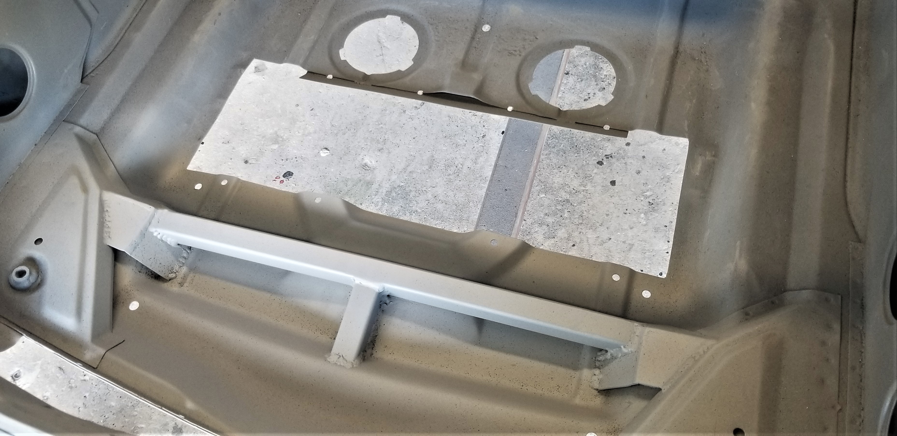

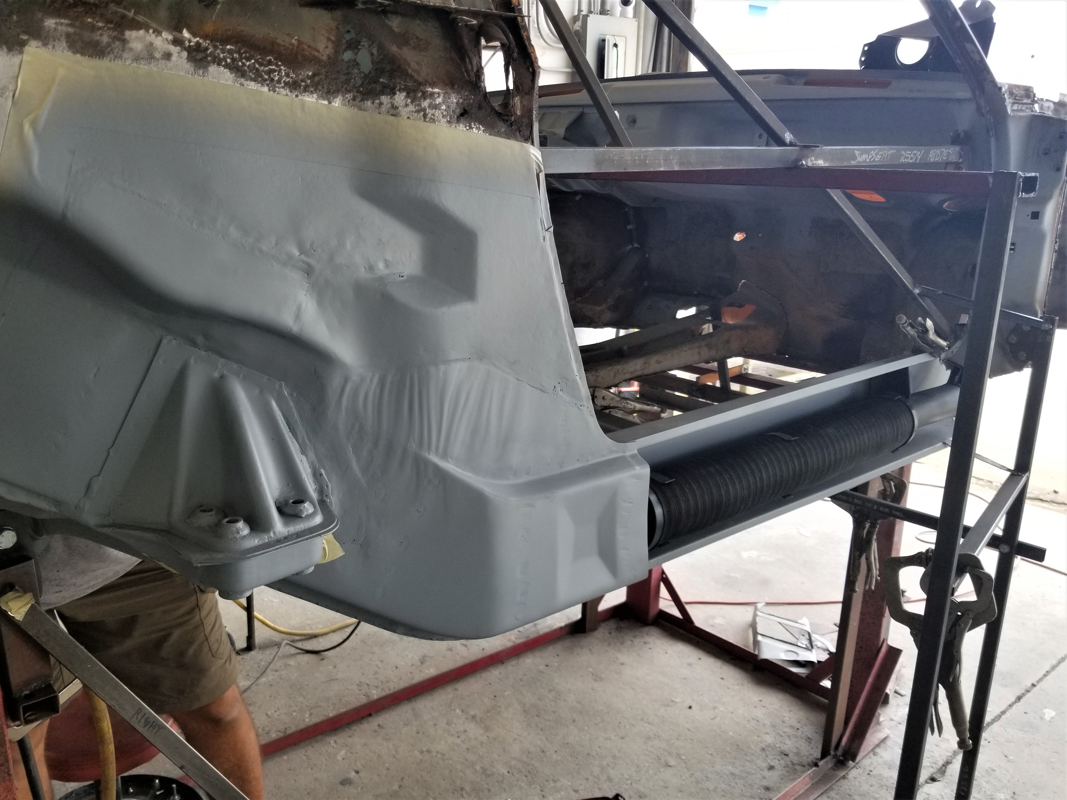

Chassis reinforcements...

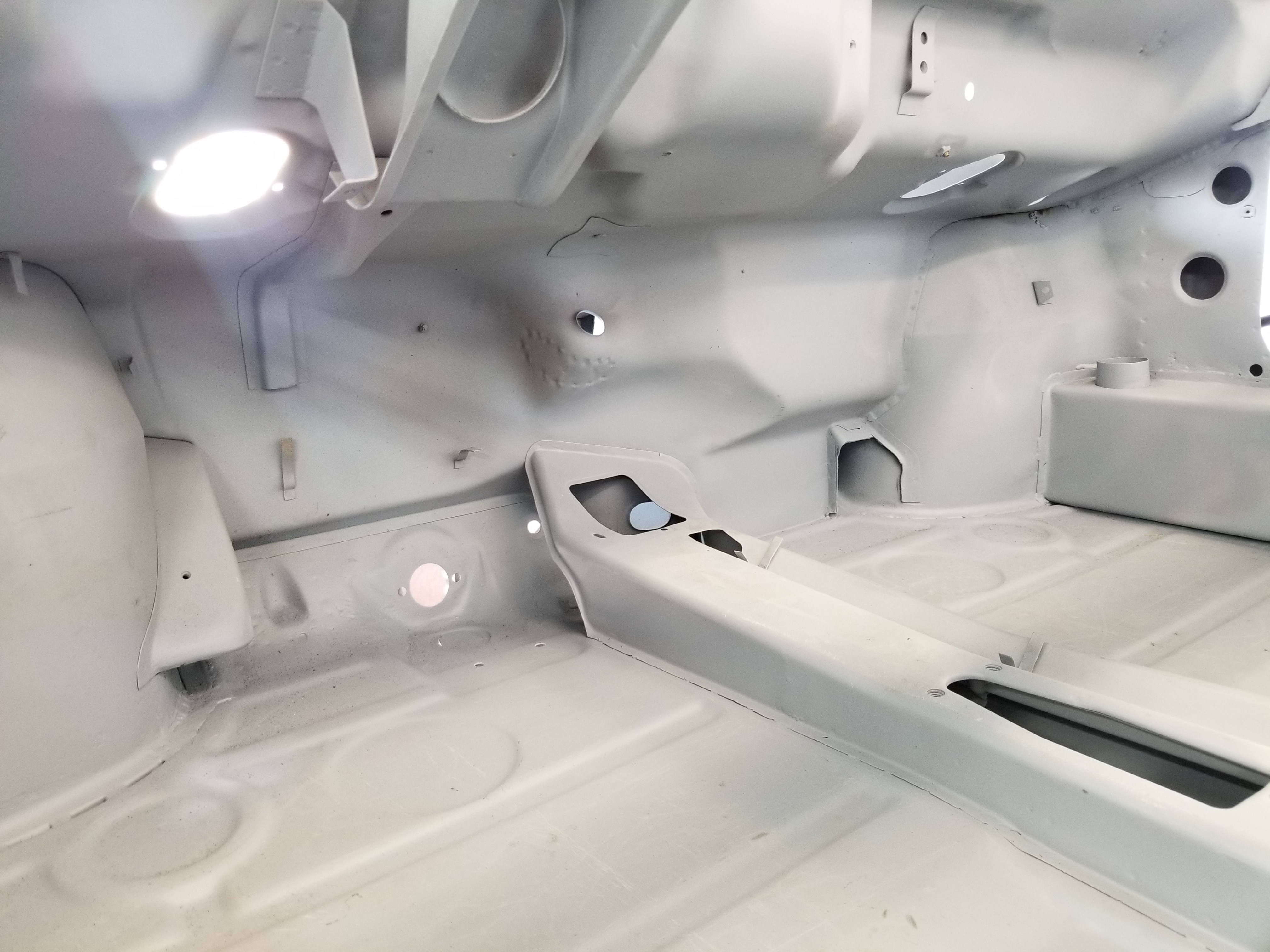

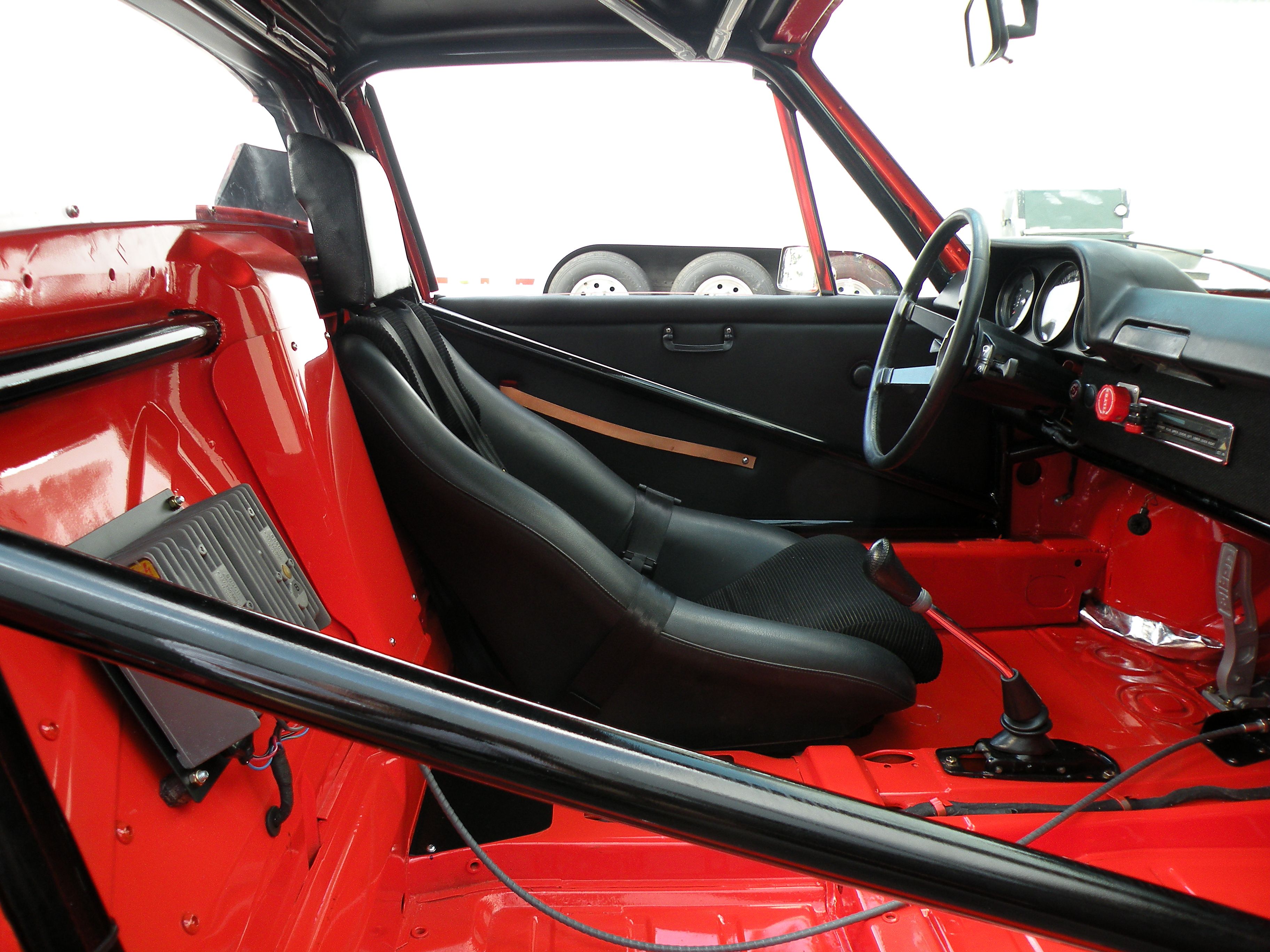

Cockpit floor completed, seat perches for the Scheels and handbrake relocation up soon.

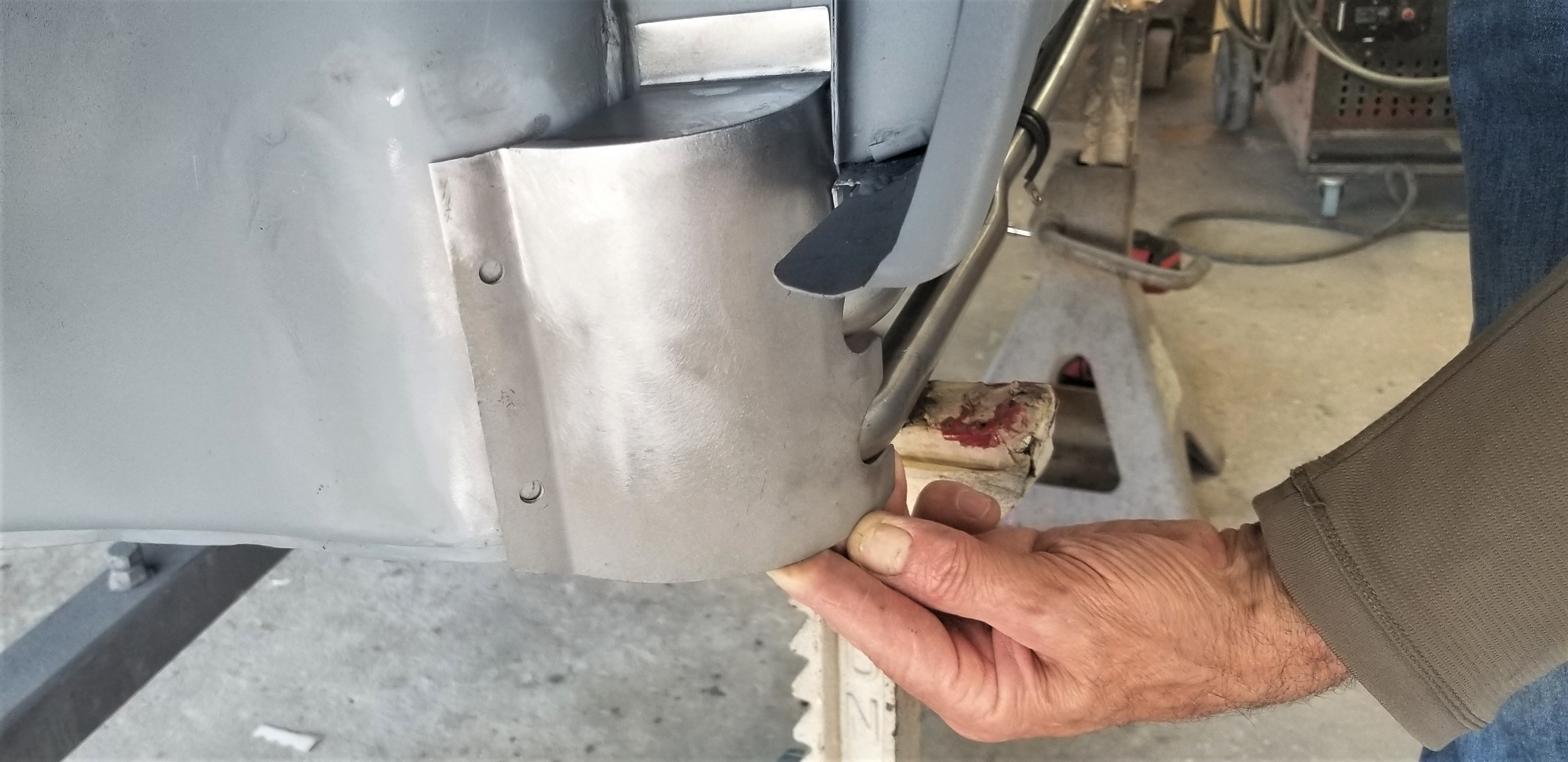

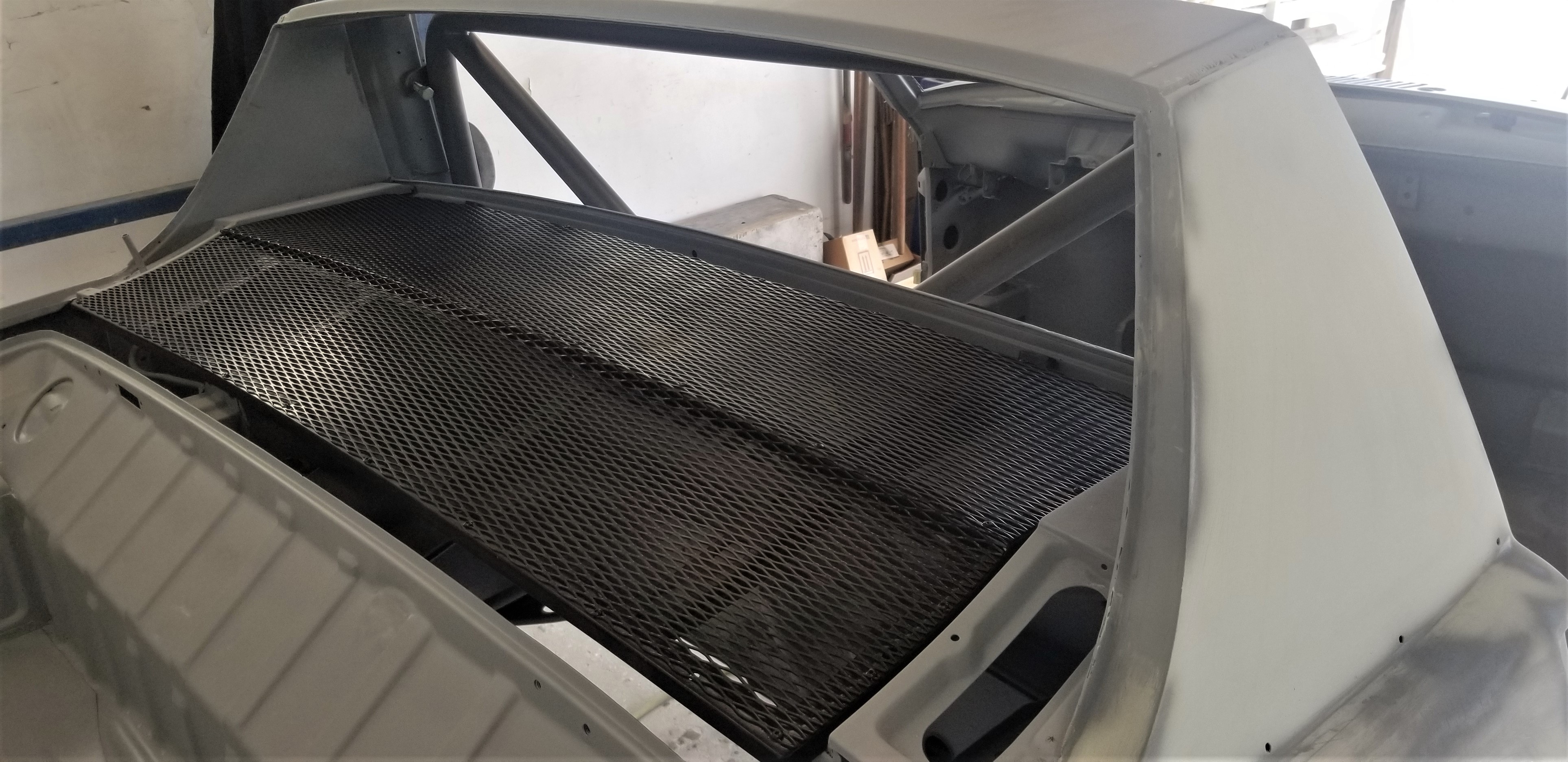

The shop's fabrication skills are exceptional... asked for a simple cover similar to factory GT's and they produced this Satanic detail:

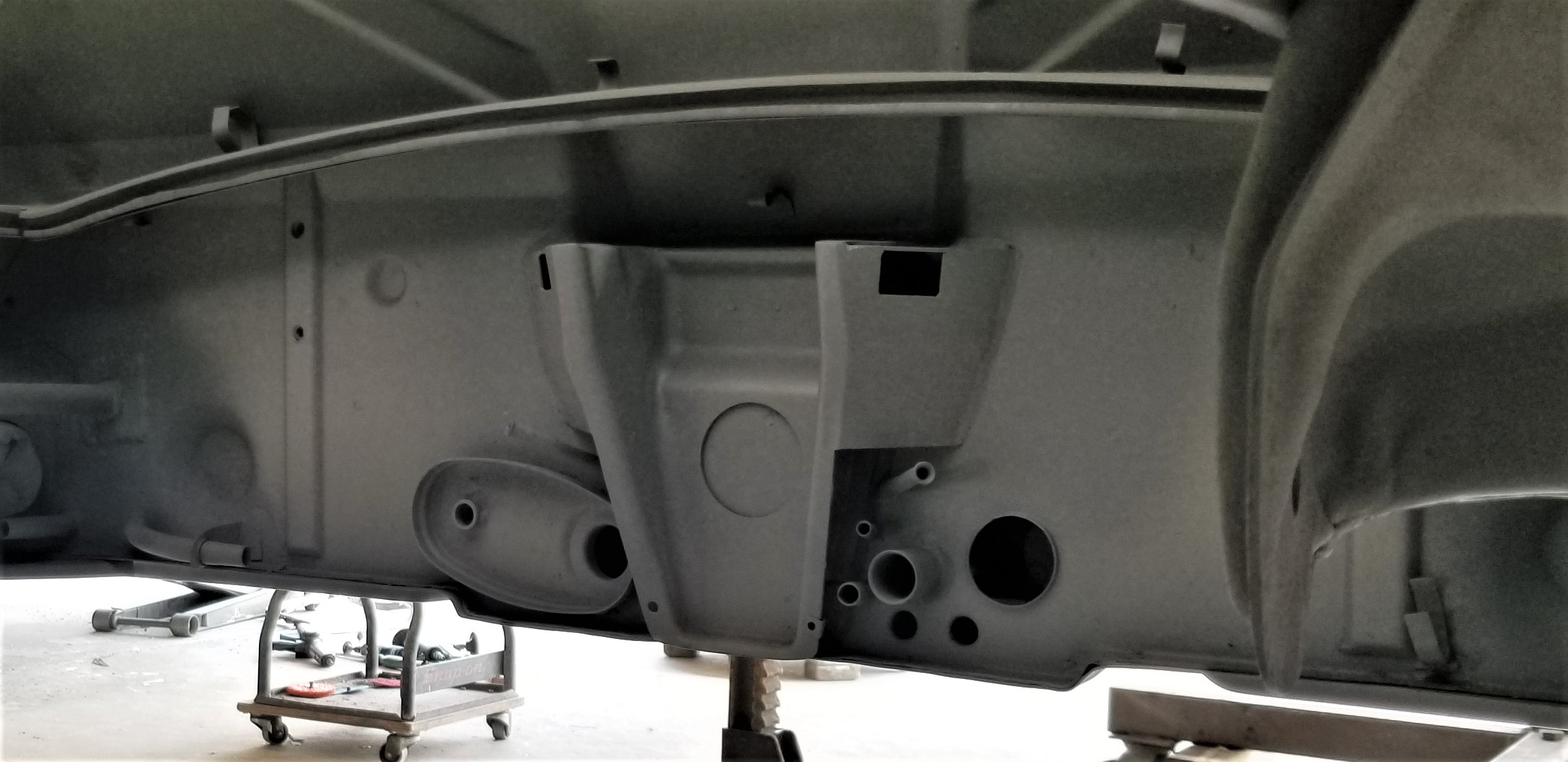

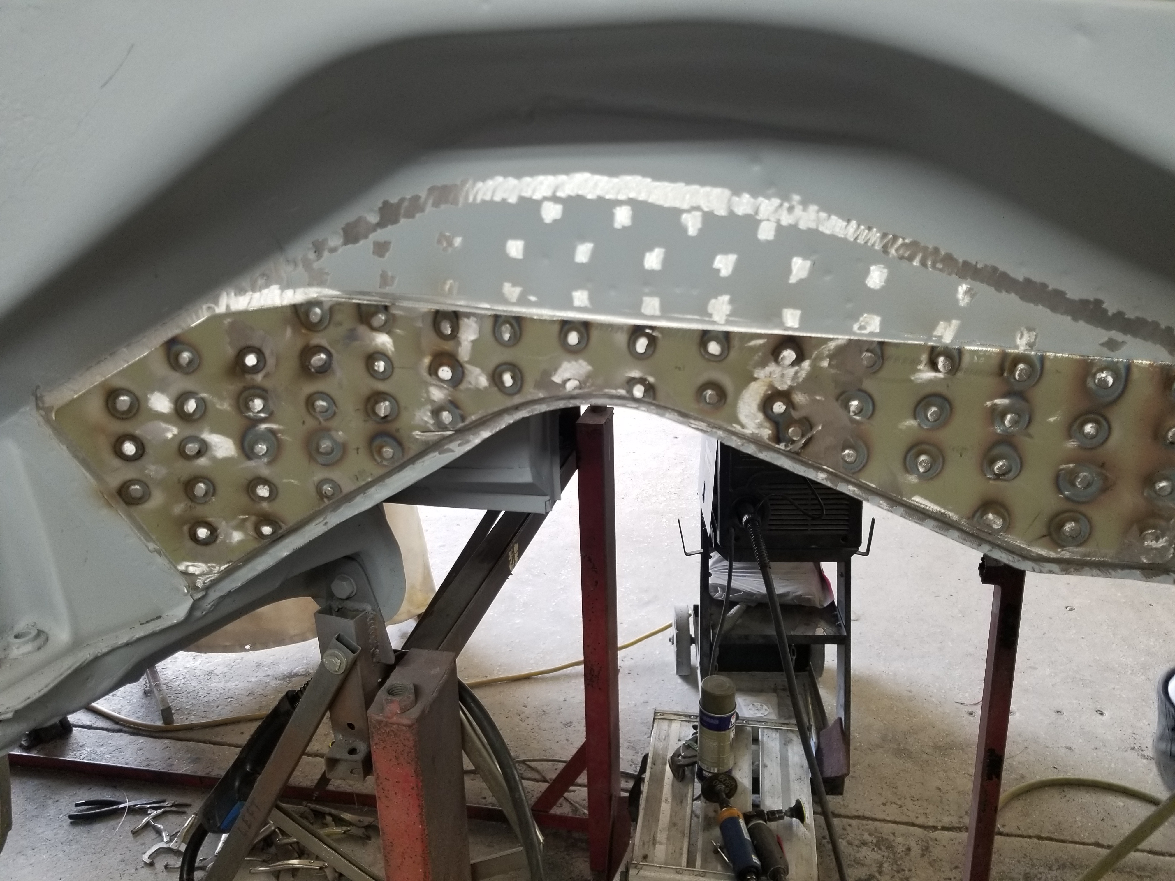

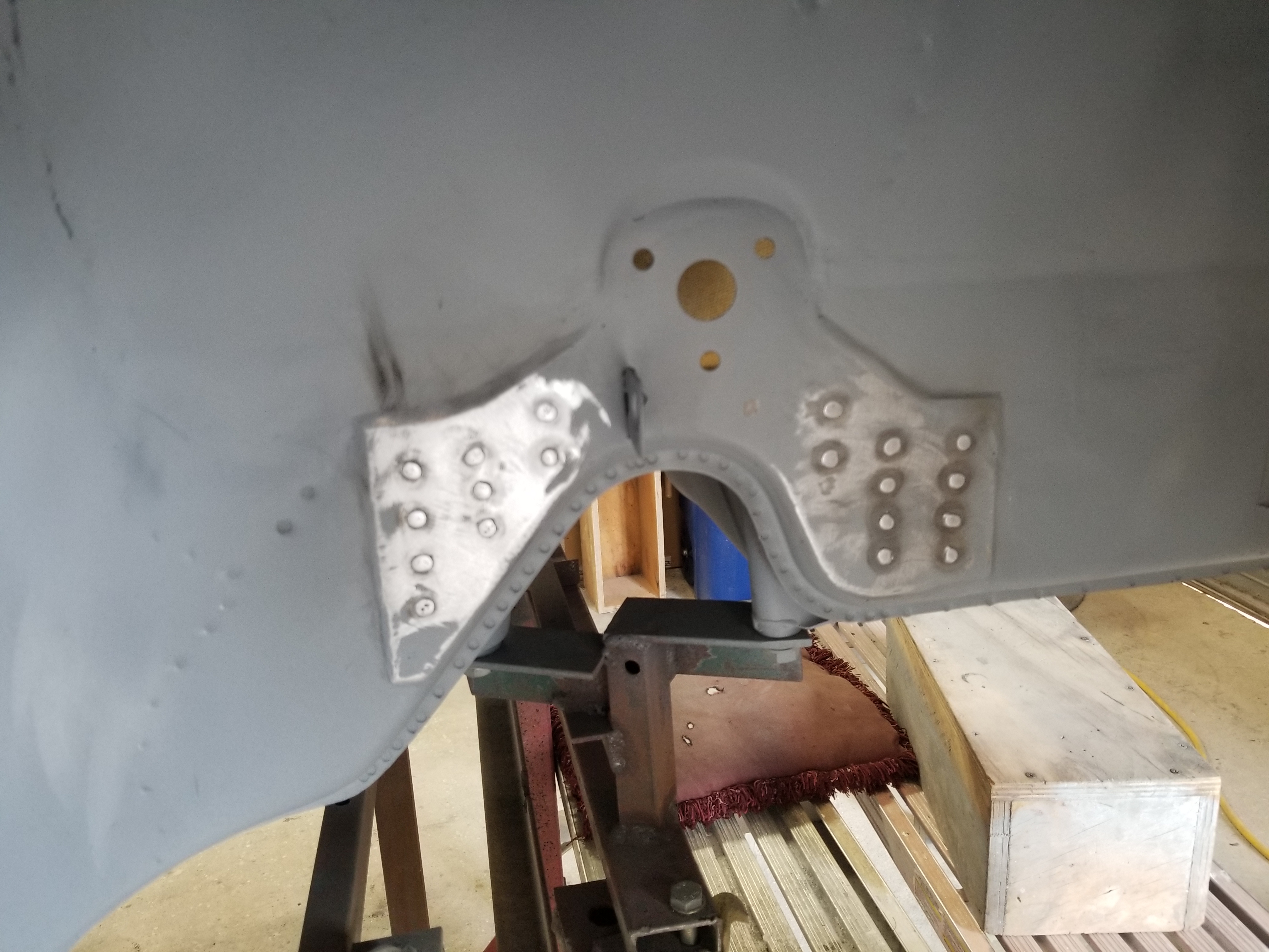

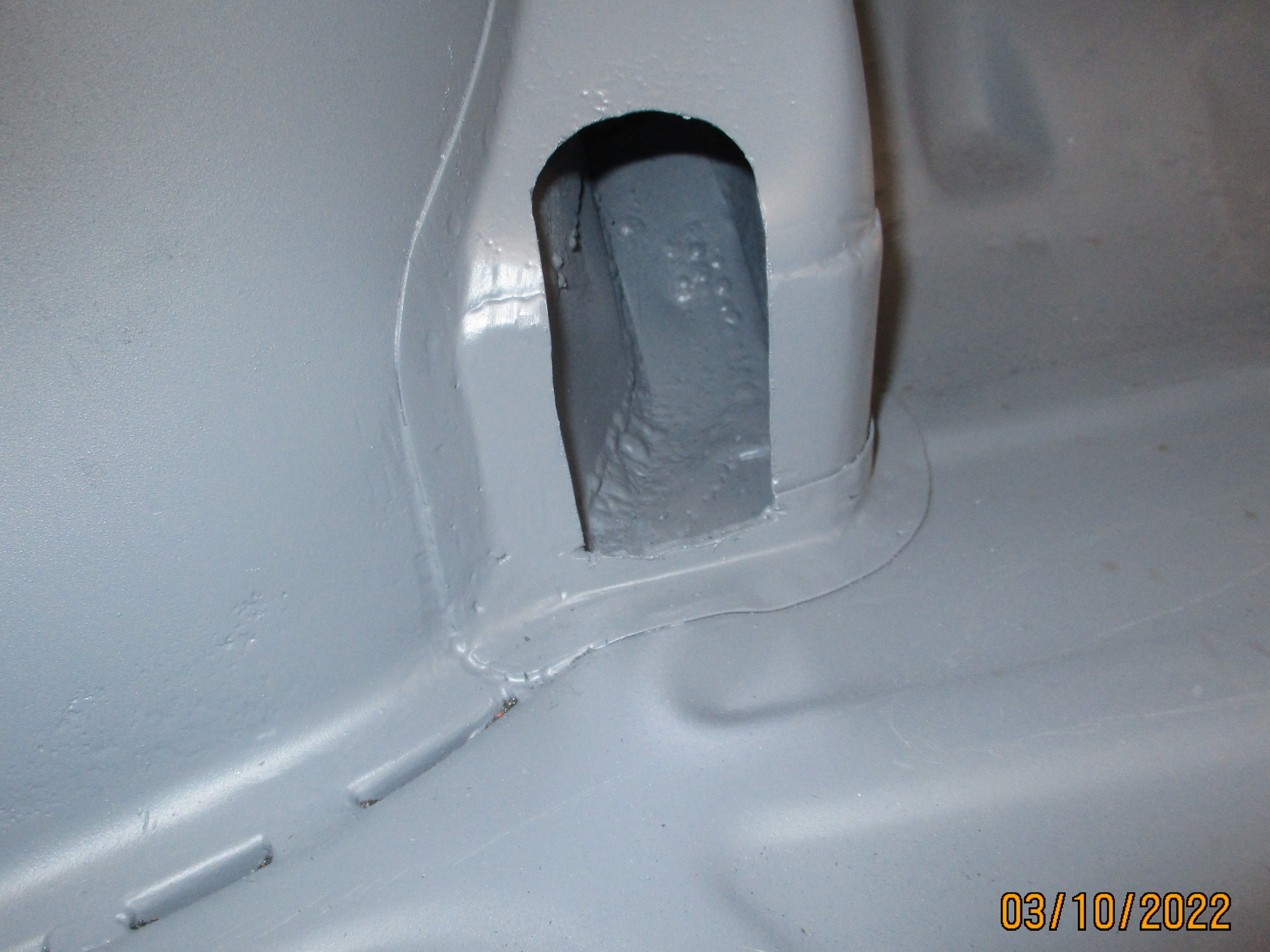

Engine mount and suspension reinforcements...

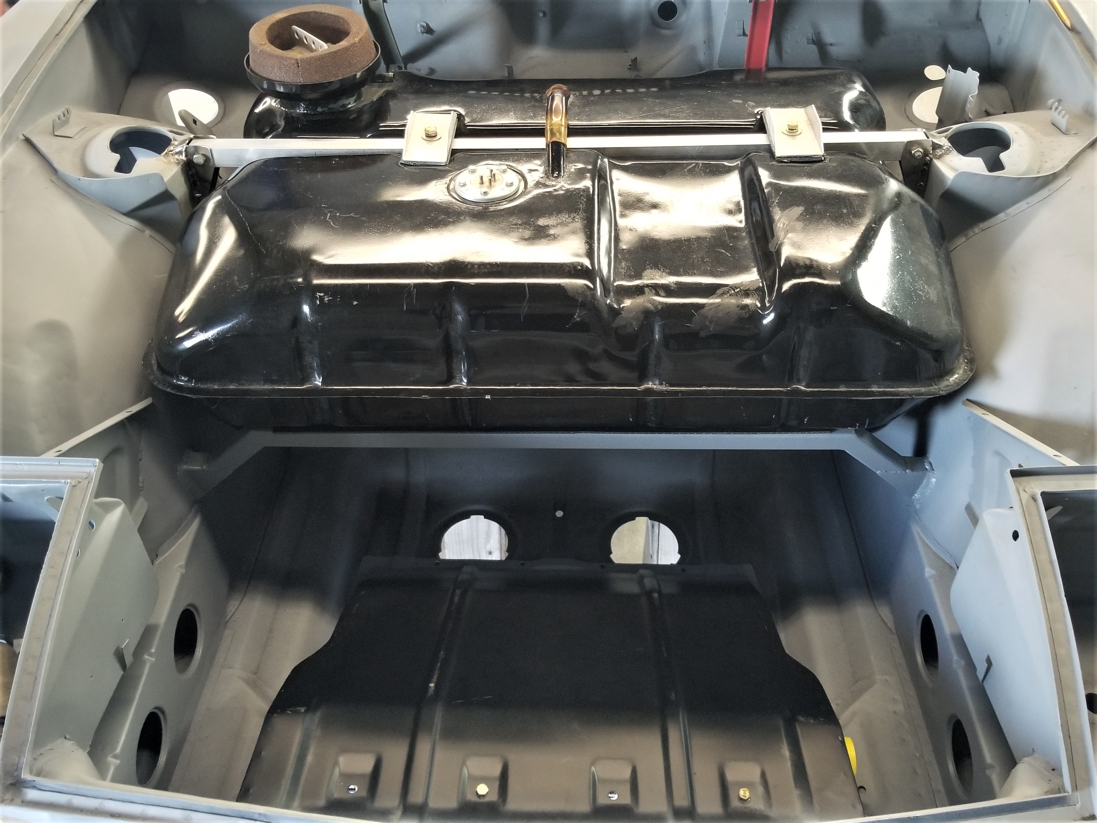

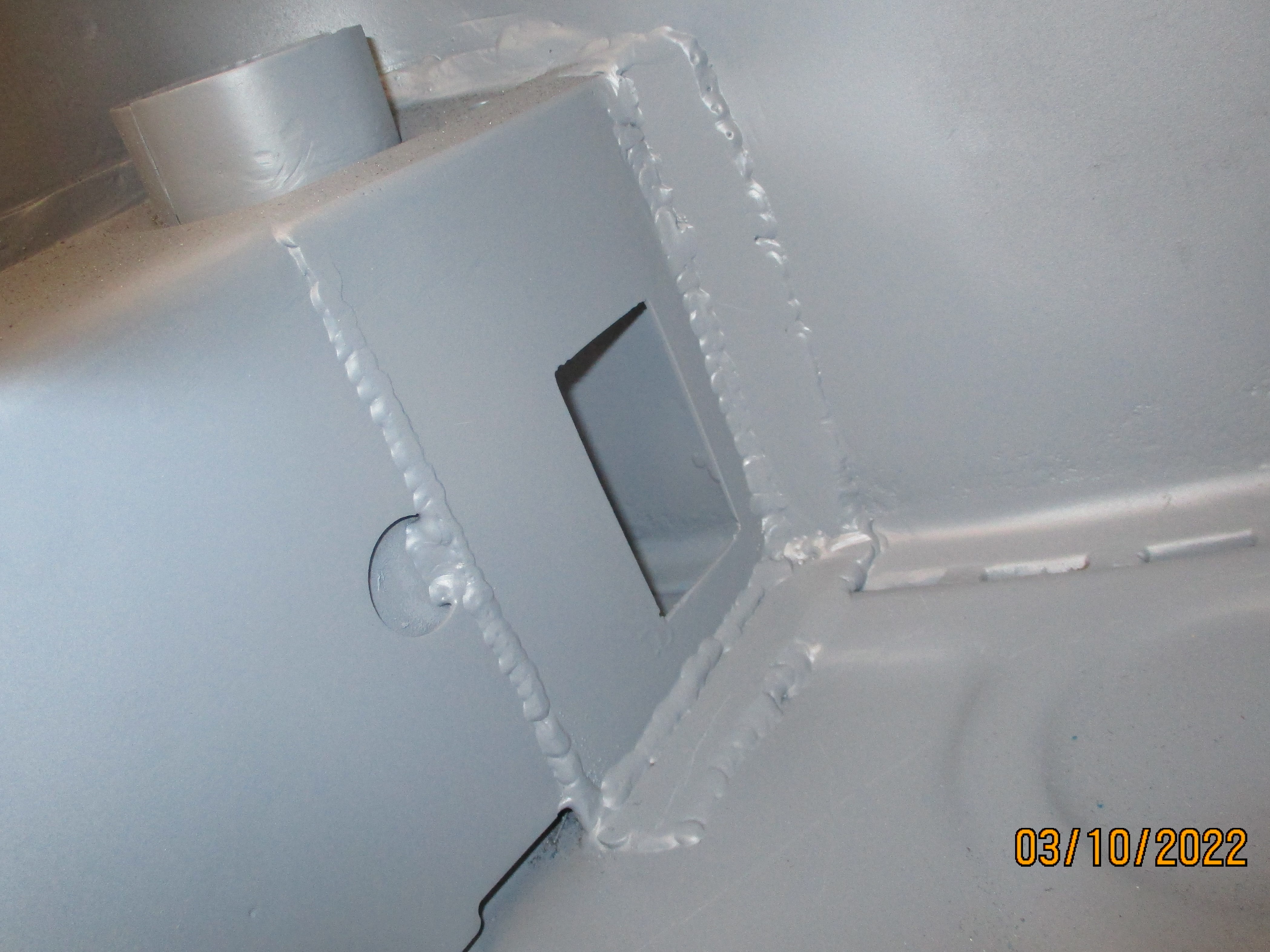

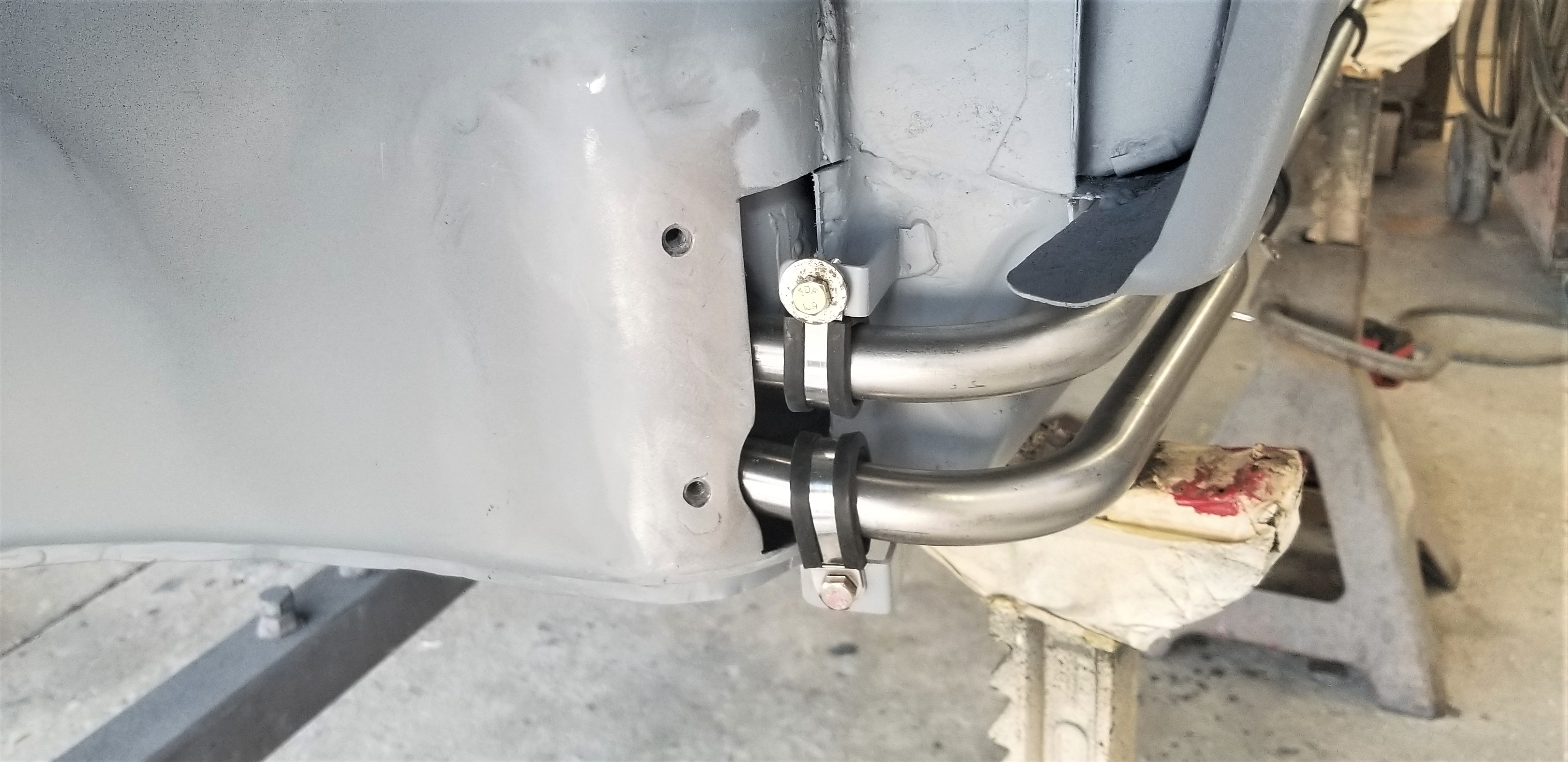

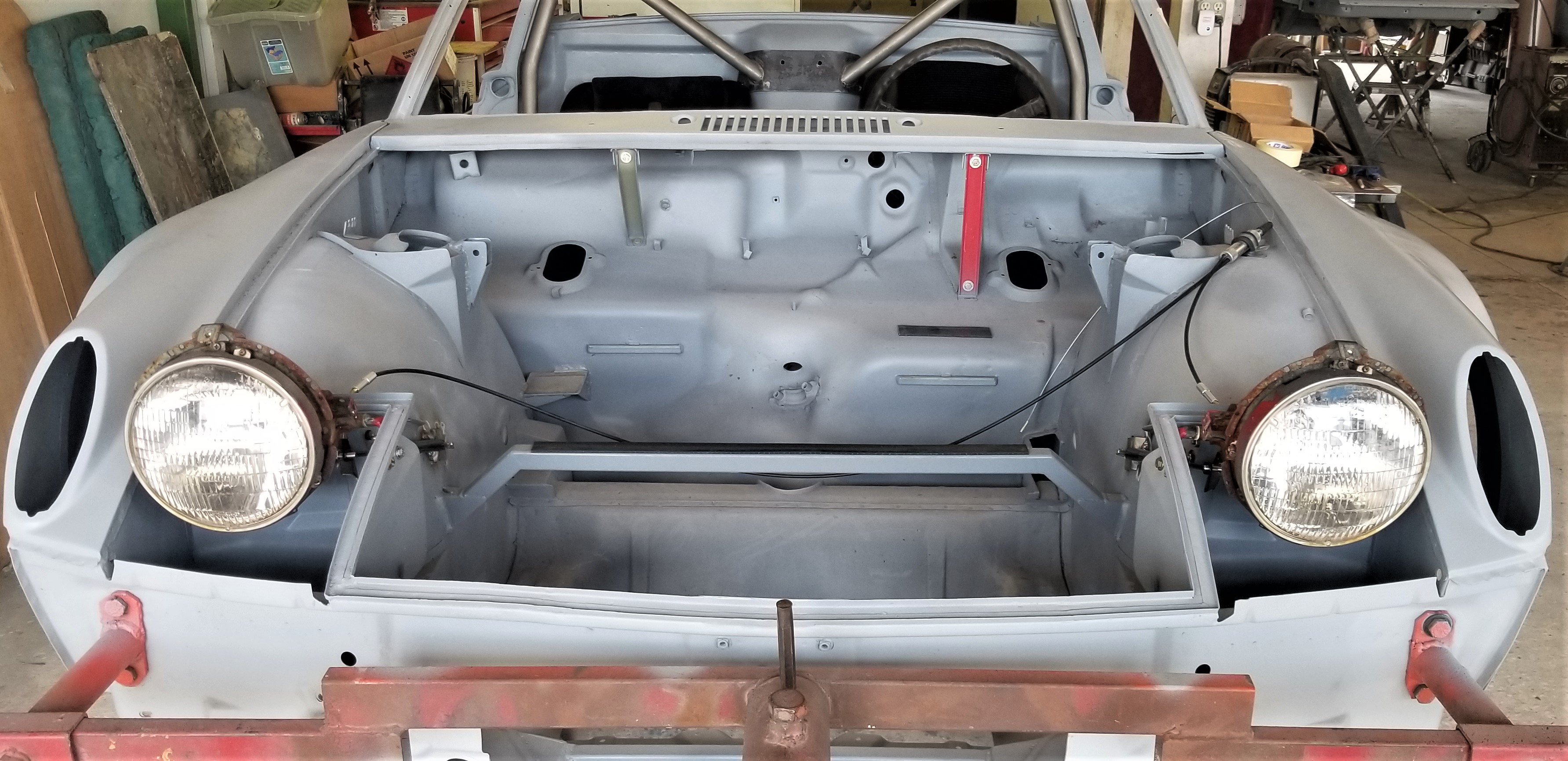

GT Fuel tank and oil cooler mods were straightforward...
Bullethead
Test fitment: like buttah! Yes, that is a real-deal NOS GT tank. I sold a kidney.

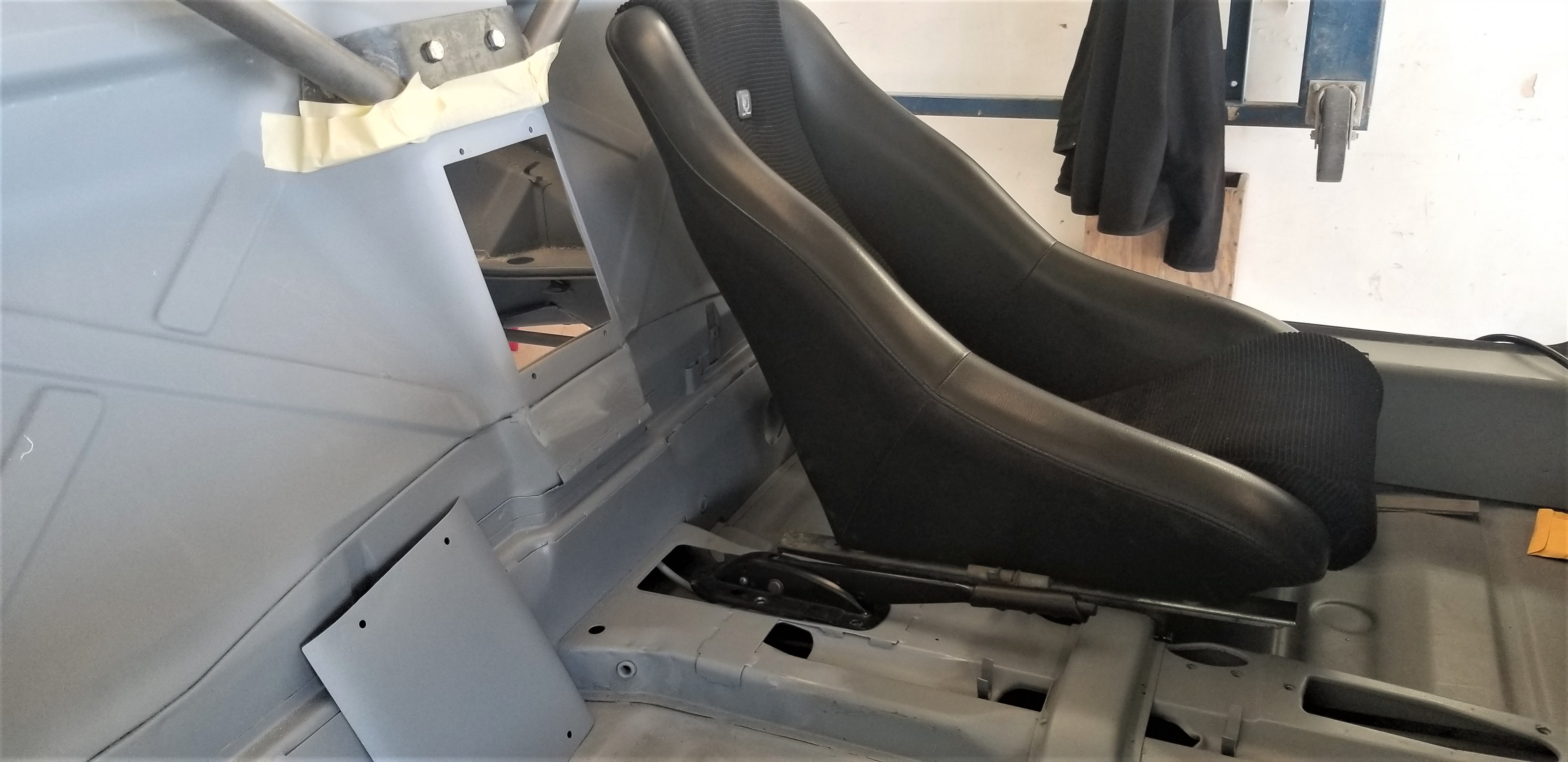

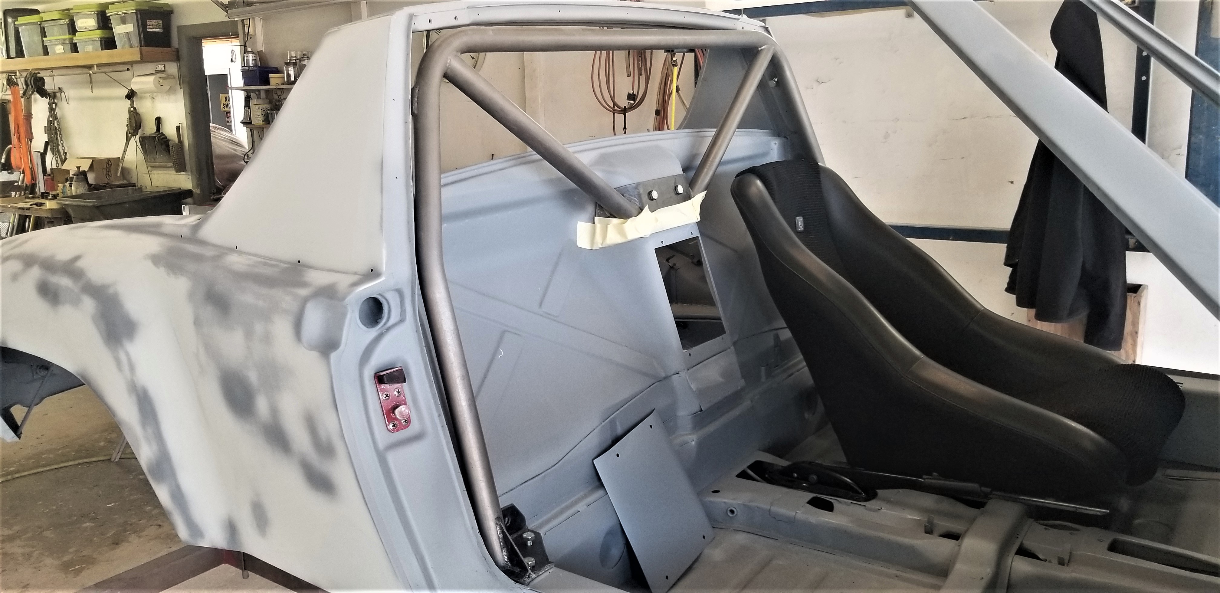

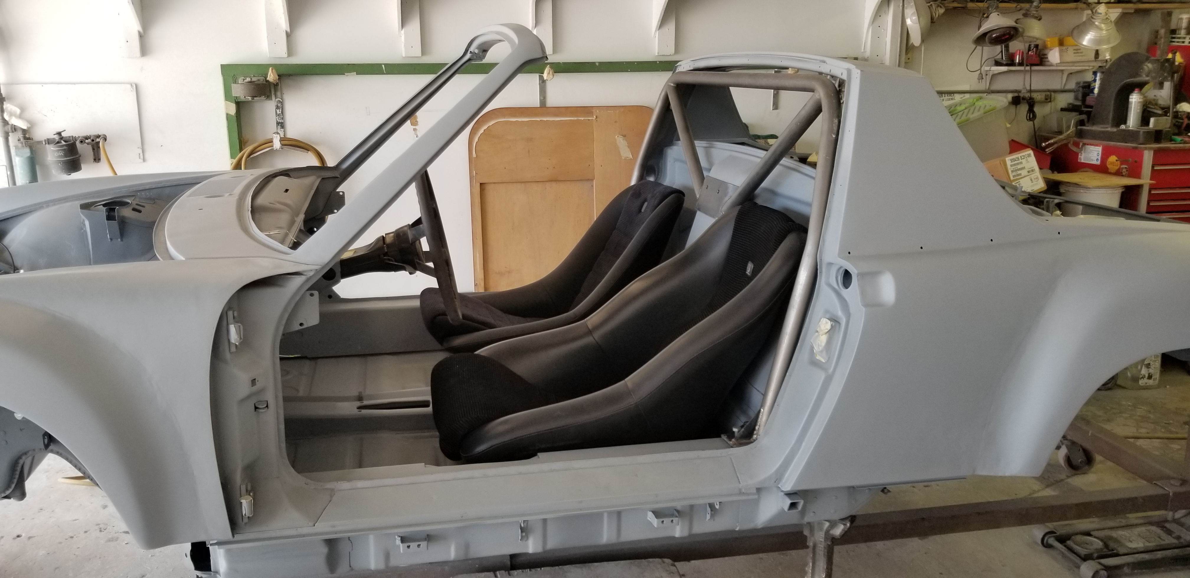

As of yesterday, determined seat locations with the bar installed. Some adjustments to do... also fitted the manual headlight kit from Mittlemotor. Cables are too short! Grrrr.
On the kit I saw, the cables were bicycle cables and housing. If so, go to a bike shop and get some high quality teflon lined housing. It's worth the money over the cheap replacement stuff.

Cheers Mark, but the buttons on the ends of the cables are really small. Have asked the kind folks at 914 Rubber to check with the supplier and hope they can solve it.
The cables are nearly a foot short, kinda hard to imagine that sort of quality control fuck up.
EDIT: Just looked at a half-dozen cable makes and MAYBE Shimano ends will fit. Fingers crossed for a simple solution.

Your roll bar looks way too short - too close to the helmet in tech inspection.
See this: https://pbase.com/9146gt/image/113481744
This will still fit under the targa top
Check the end of a derailleur cable.
Bullethead

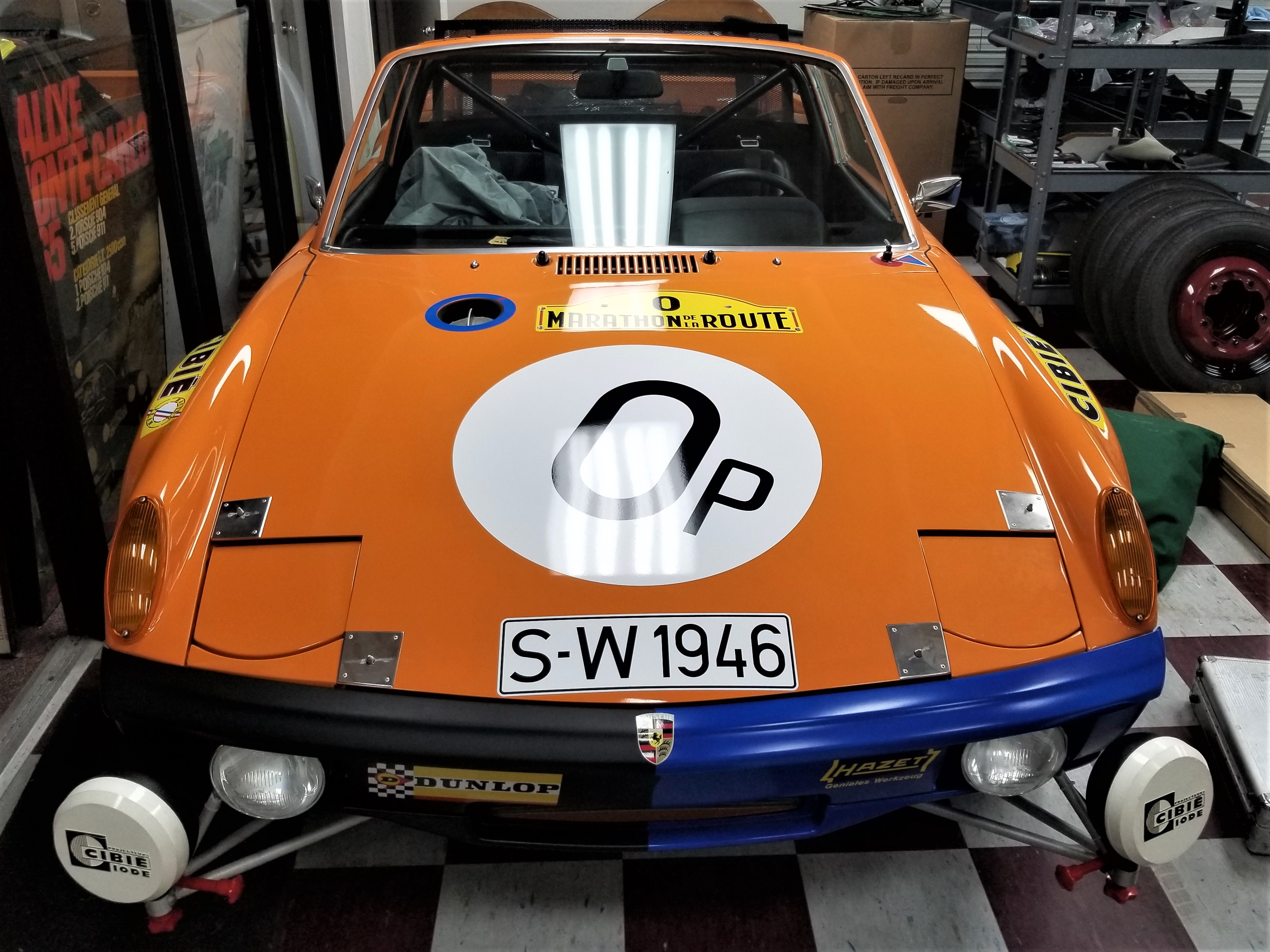

No worries. The bar is an exact reproduction of the factory piece fabricated by one of the best-known Porsche race car restorers in the world (who sold me the car in the first place).
I'm building an accurate replica, not a track car so we're not concerned with the current rule book. It will be a streetable GT for rallye use mainly.
Biggest difference from a period GT is the engine; I'm using a twin-plug 2.8 RS motor with Webers.

A few more detail shots of the oil line cockpit routing.

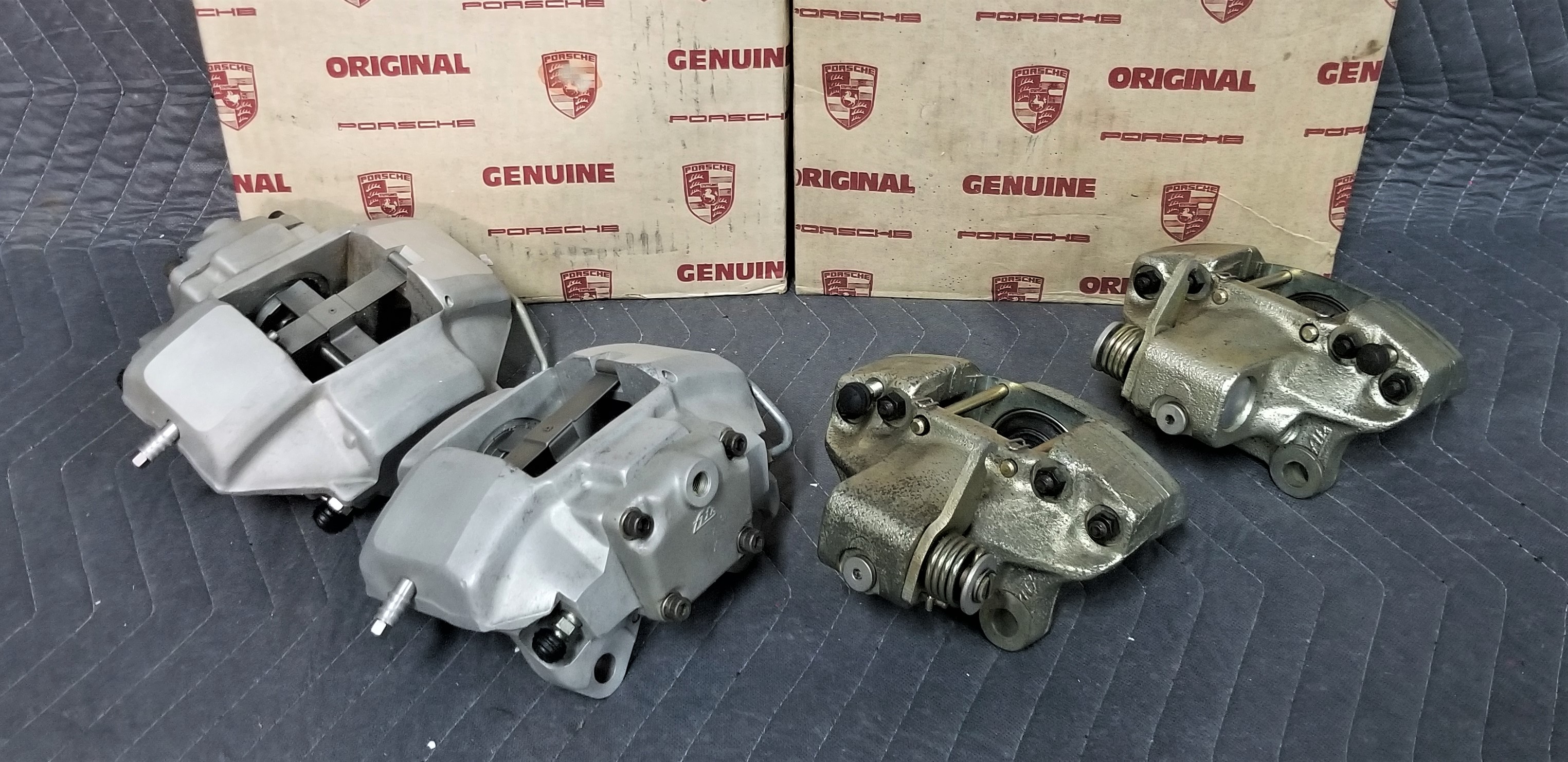

How about some brake porn? NOS vented GT rears plus calipers... lucky to get them and the 908s. Thanks Bernie!

908’s!!! LeMans here we come. Quick change time, That is sweet! beerchug.gif

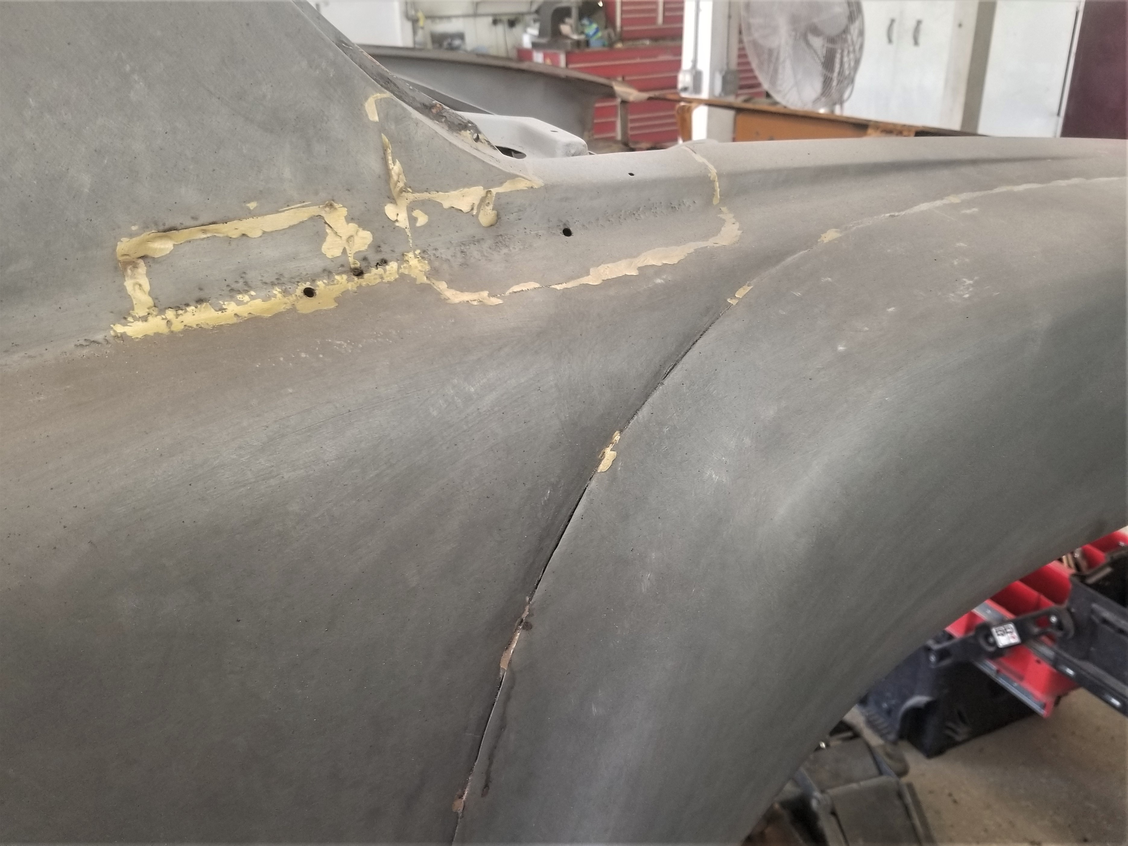

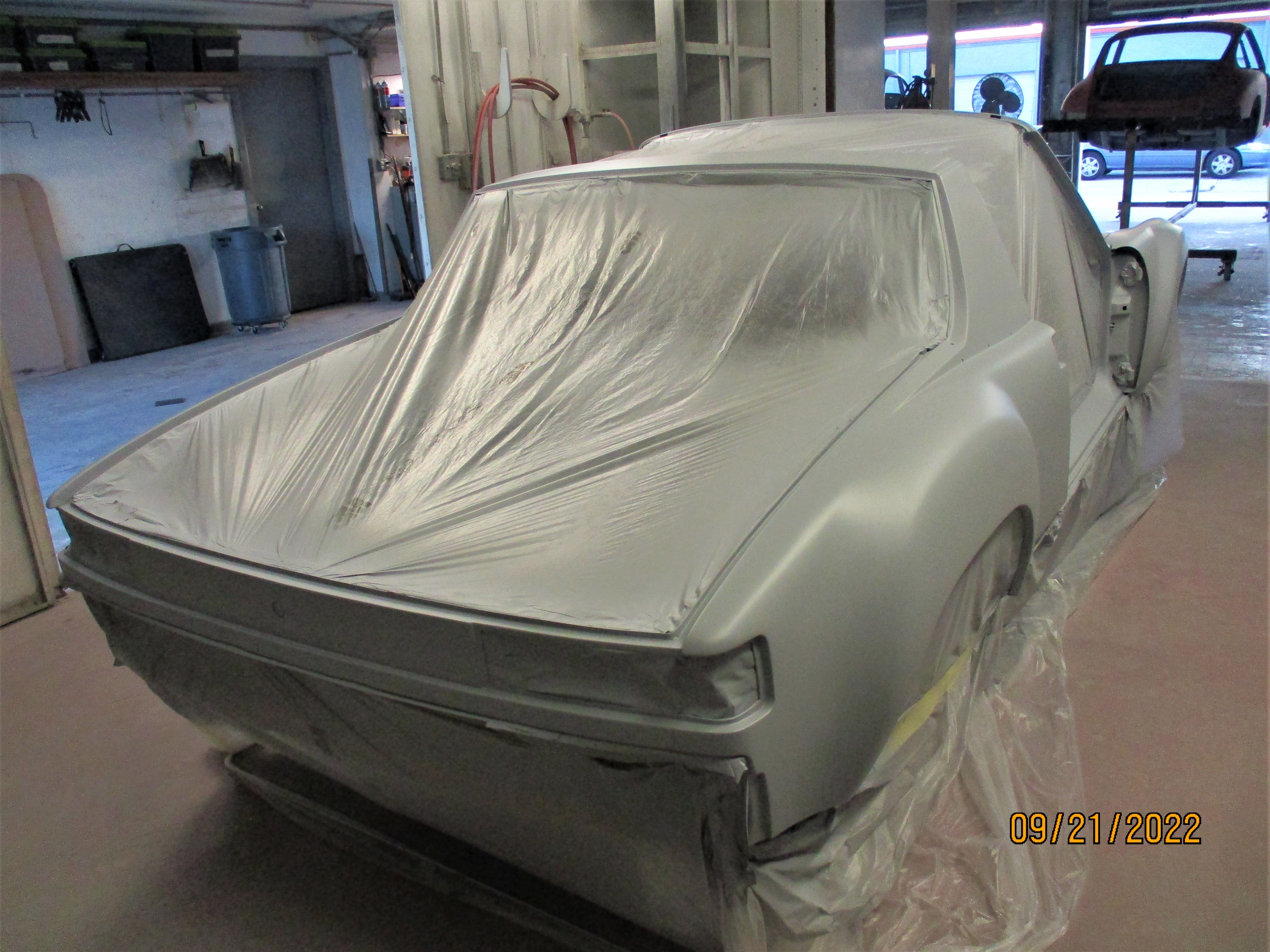

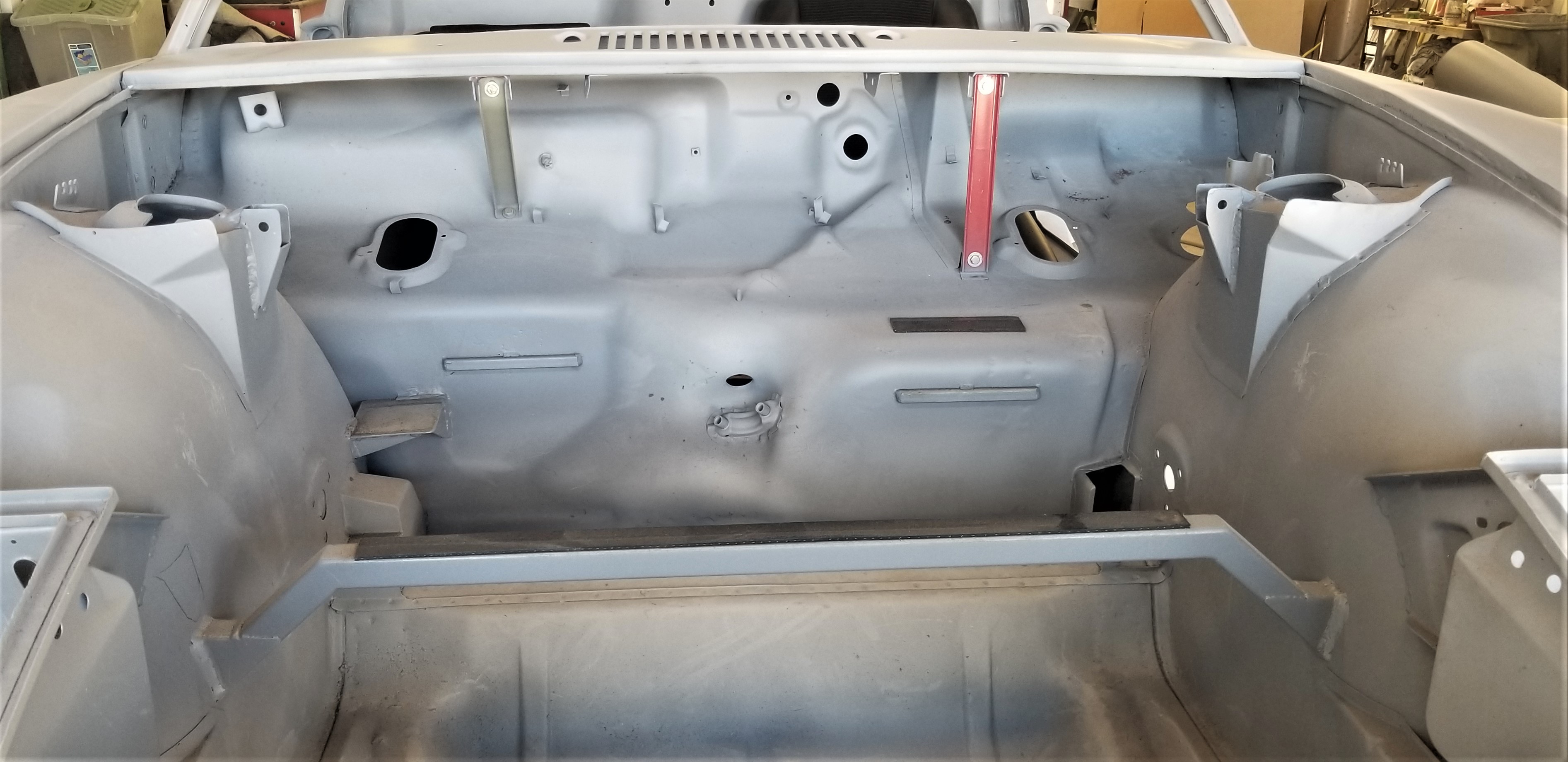

Slower pace of work this summer, but now much closer to paint. Final fitment of all panels and mucho blocking time... color cards sprayed and approved. Next post it'll be orange again.

Are you planning to add a headrest? If this is display only thats fine but unless wearing a helmet or adding a headrest (or both) this is dangerous. Most any back or forward accident force will have occupants smashing skulls on the rollbars. That design is meant for a fully caged track car.
Bullethead
Obviously... looking for Scheel 914 headrests now, but will have something by the time it's rolling. Will also wrap the bars.
And believe it or not, the factory GTs weren't fully caged. The roll hoop plus chassis reinforcements were it... as we all know, everyone added more and more. My old car:
