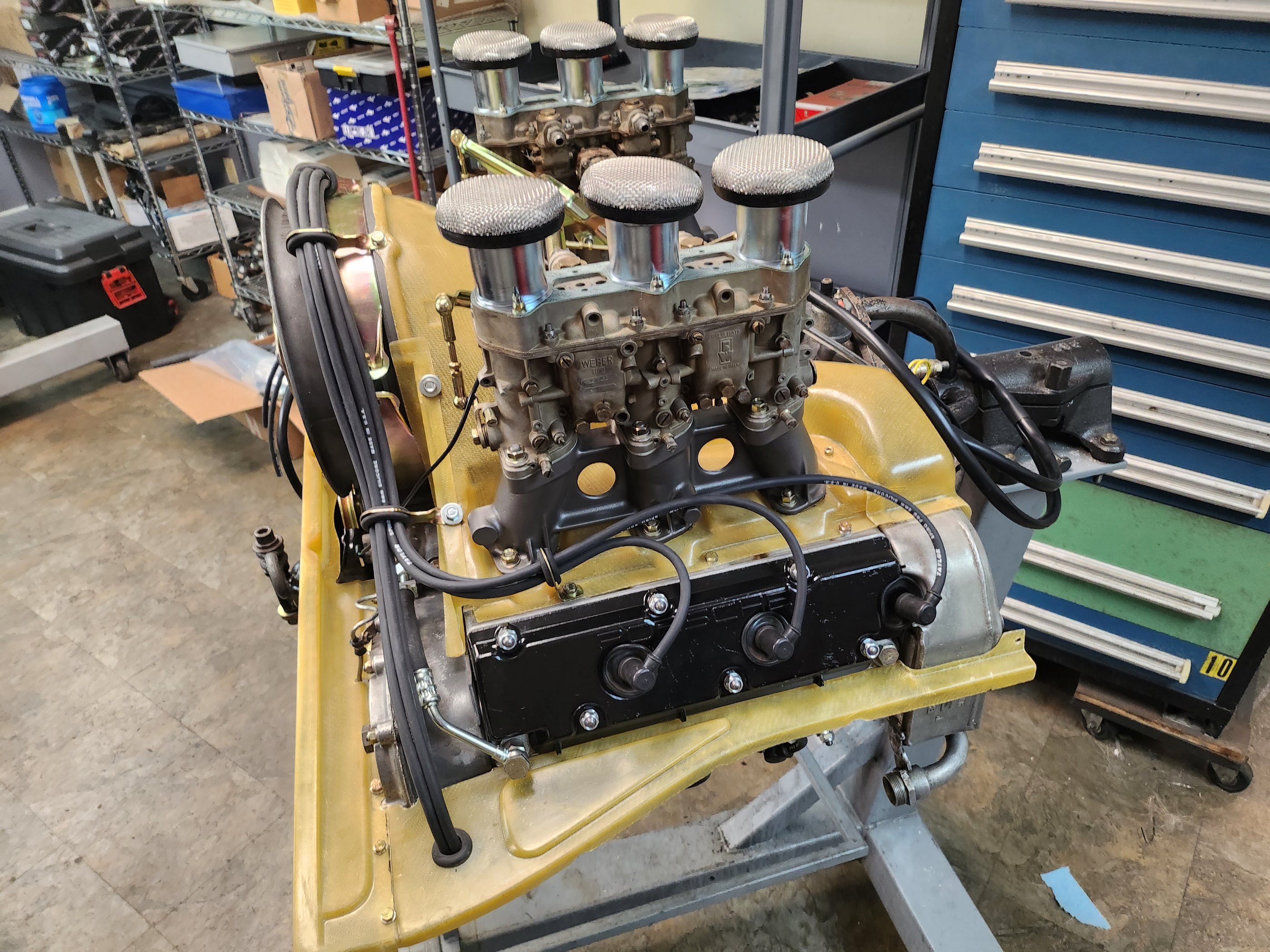

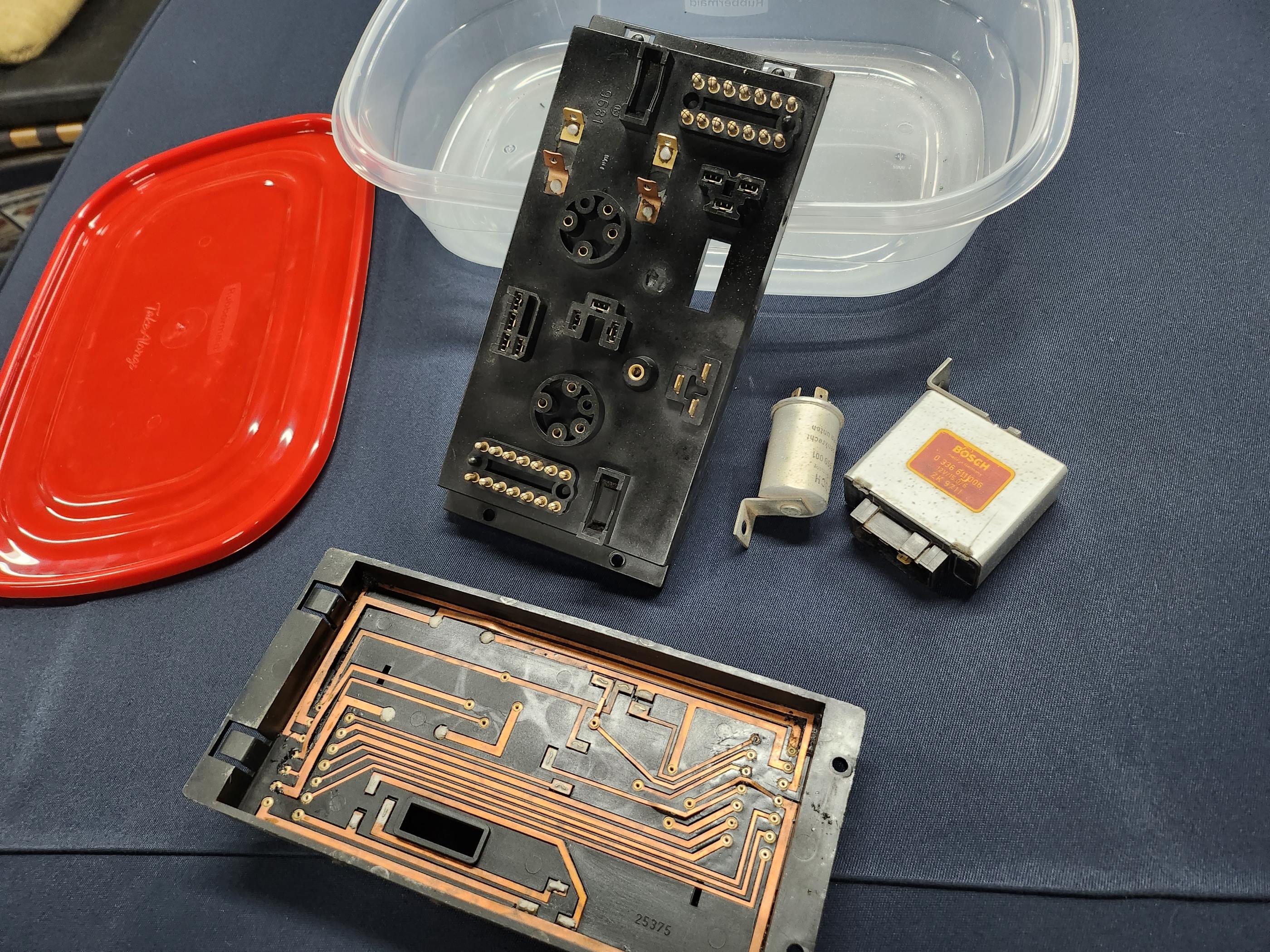

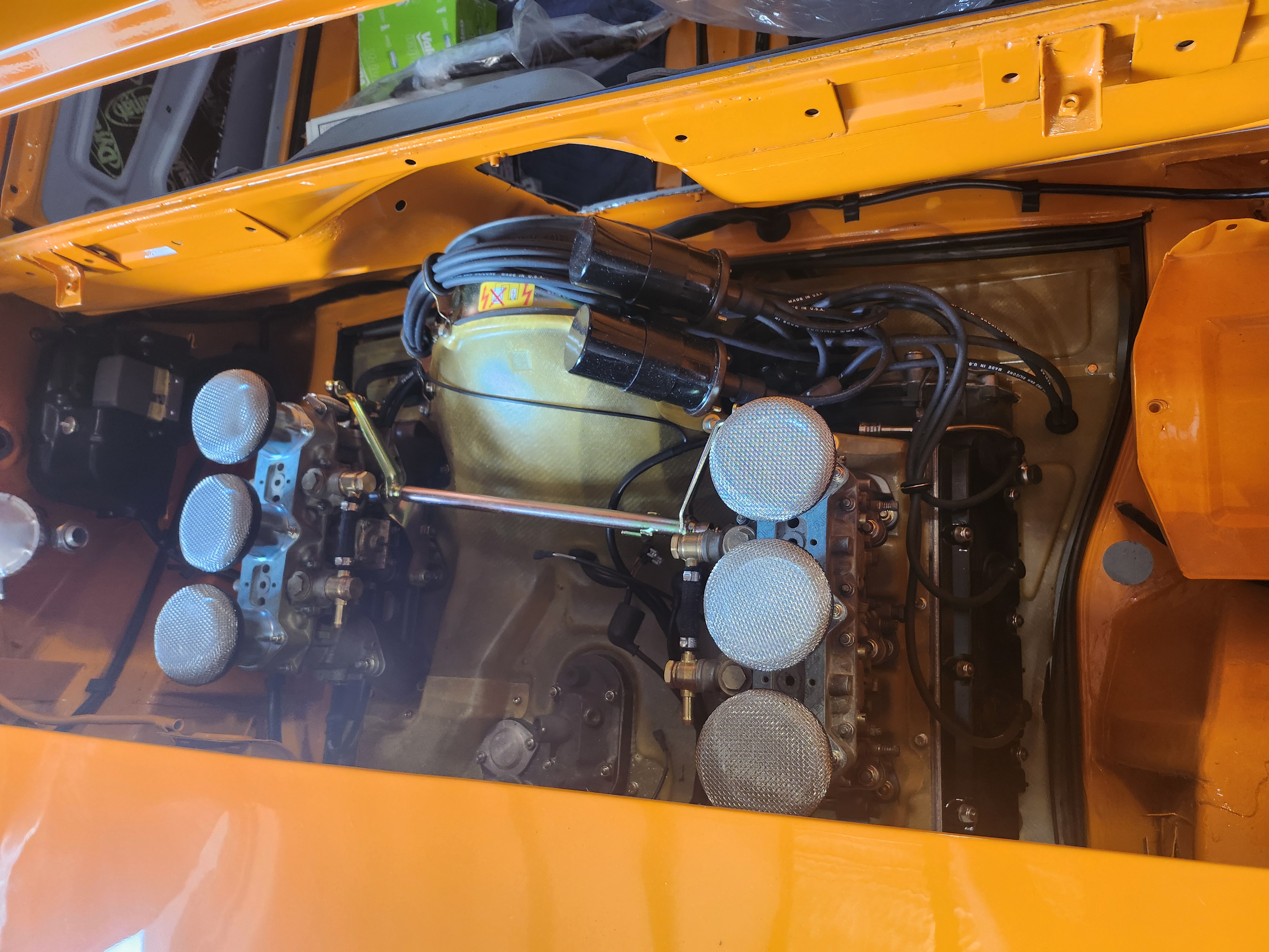

Bought an engine board without knowing that I had one already, so cleaned, tested and sealed the pair. One might be for sale in the near future.
Bullethead

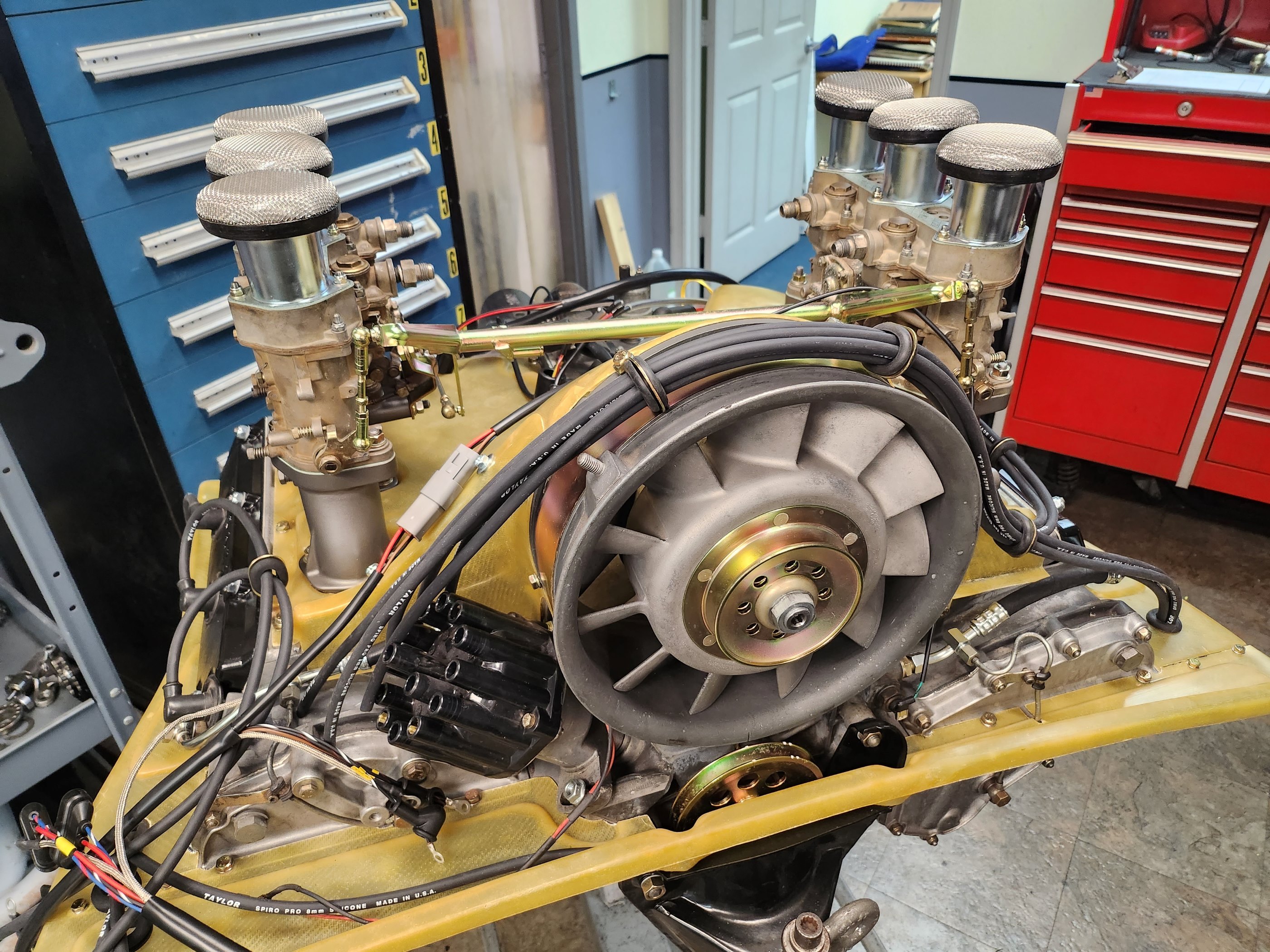

Engine is 2.8 twin-plug with S internals and cams, 46mm Italian Webers backed by an LSD 901 transaxle. All fresh, carbs rebuilt and dressed with new FG tin... looking very nice.
BillJ
Where did you find those velocity stack covers?
Bullethead
QUOTE(BillJ @ Jun 12 2023, 04:49 PM) *
They're from BBR Filters, a couple of eBay stores sell them, or try https://www.carburetion.com/Products/Produc...spx?Part=CUSF64
A pair of rain hats goes on too. We're still a ways off from drivetrain installation.
BillJ
Thanks!
Rainhats may be an issue with tall intake manifolds
My passenger side interferes with the front wall of the trunk

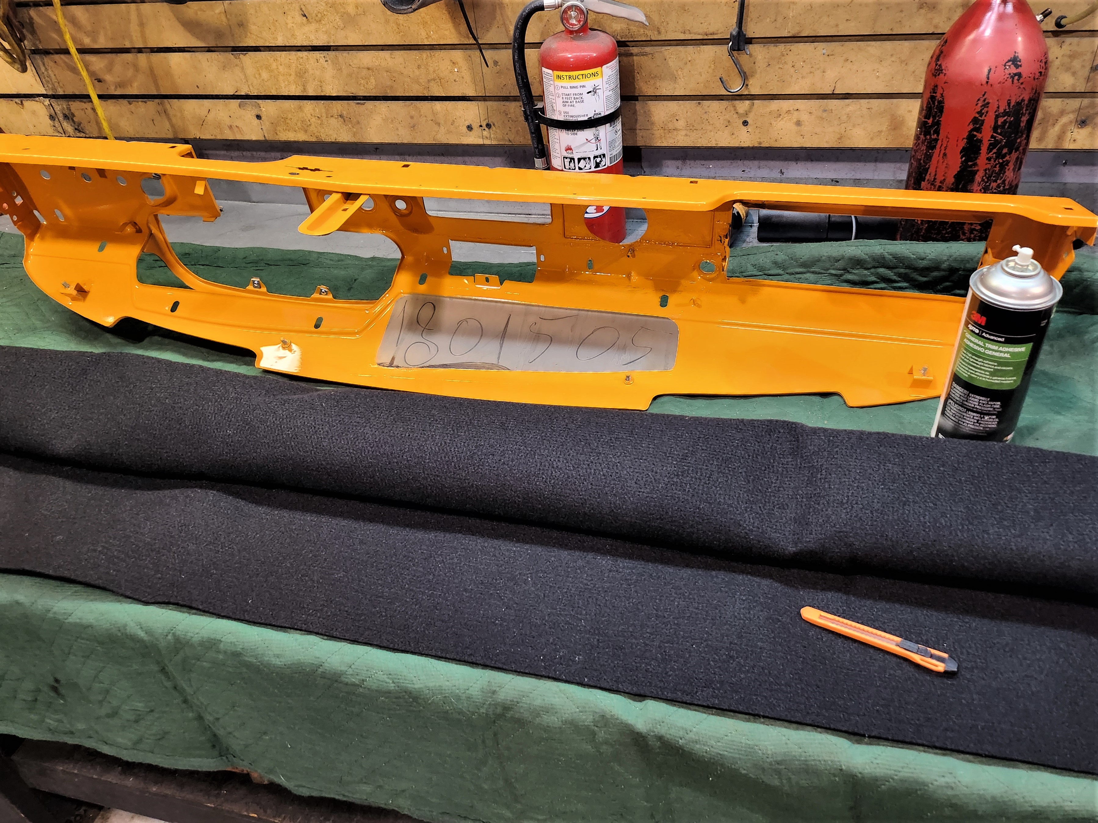

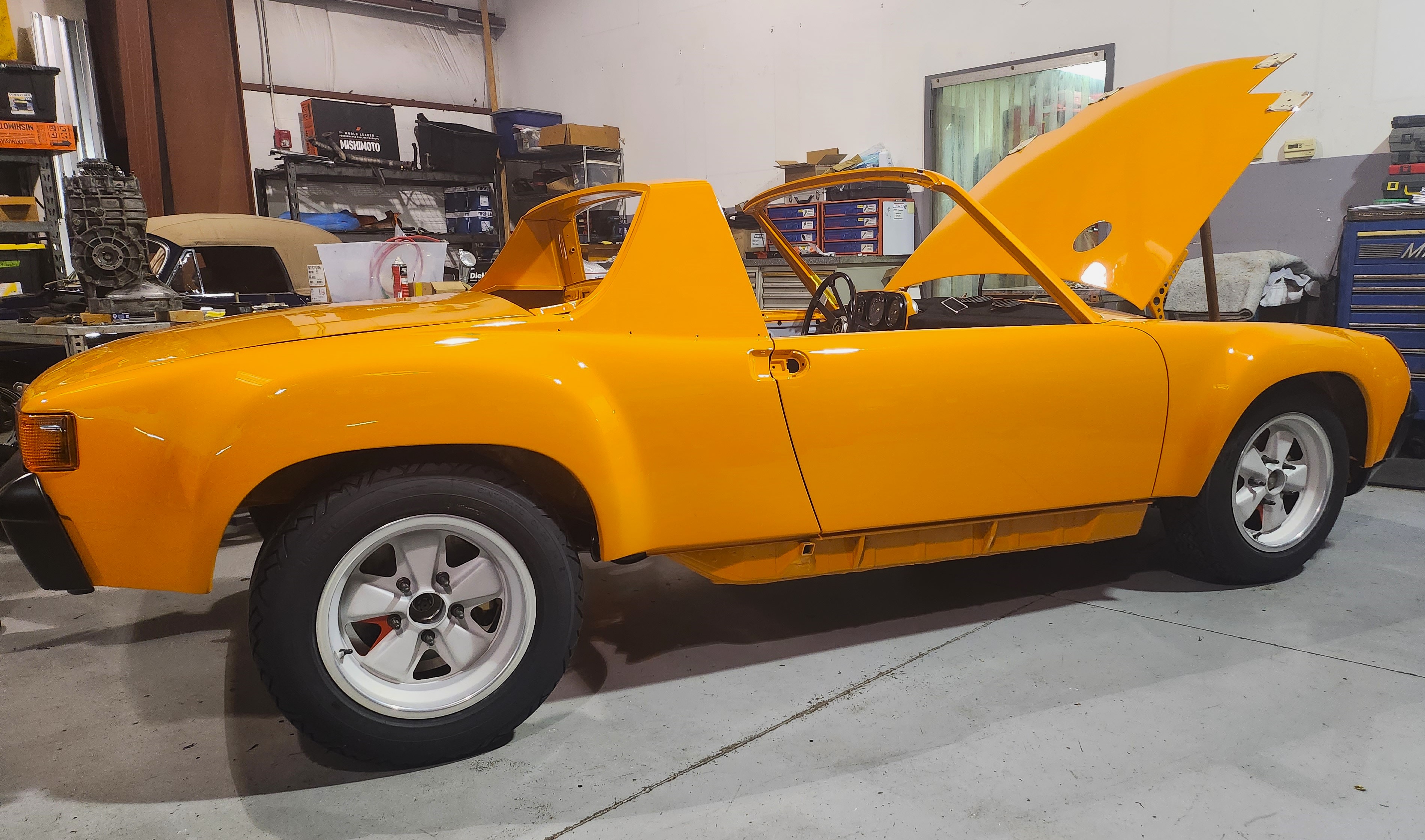

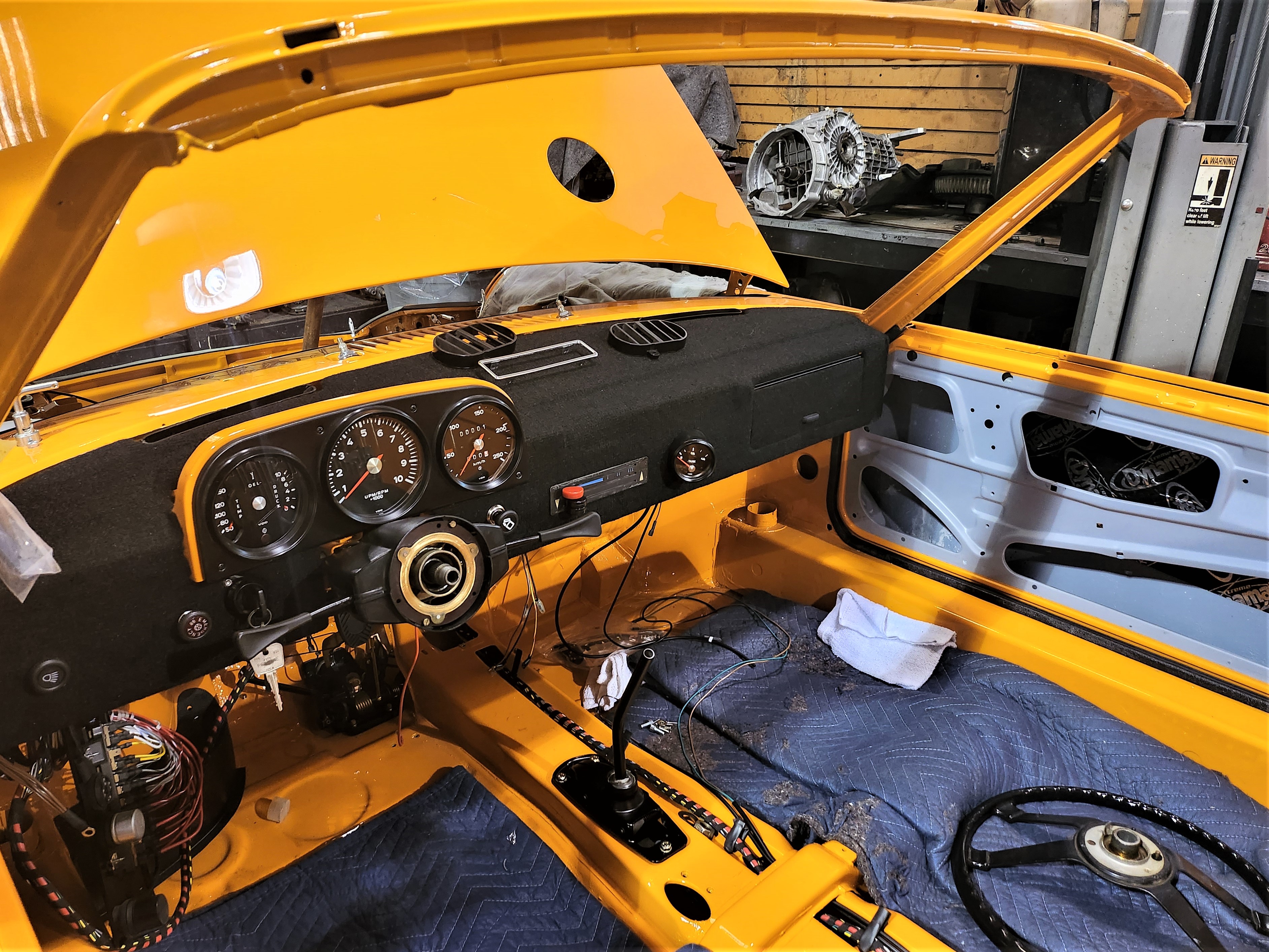

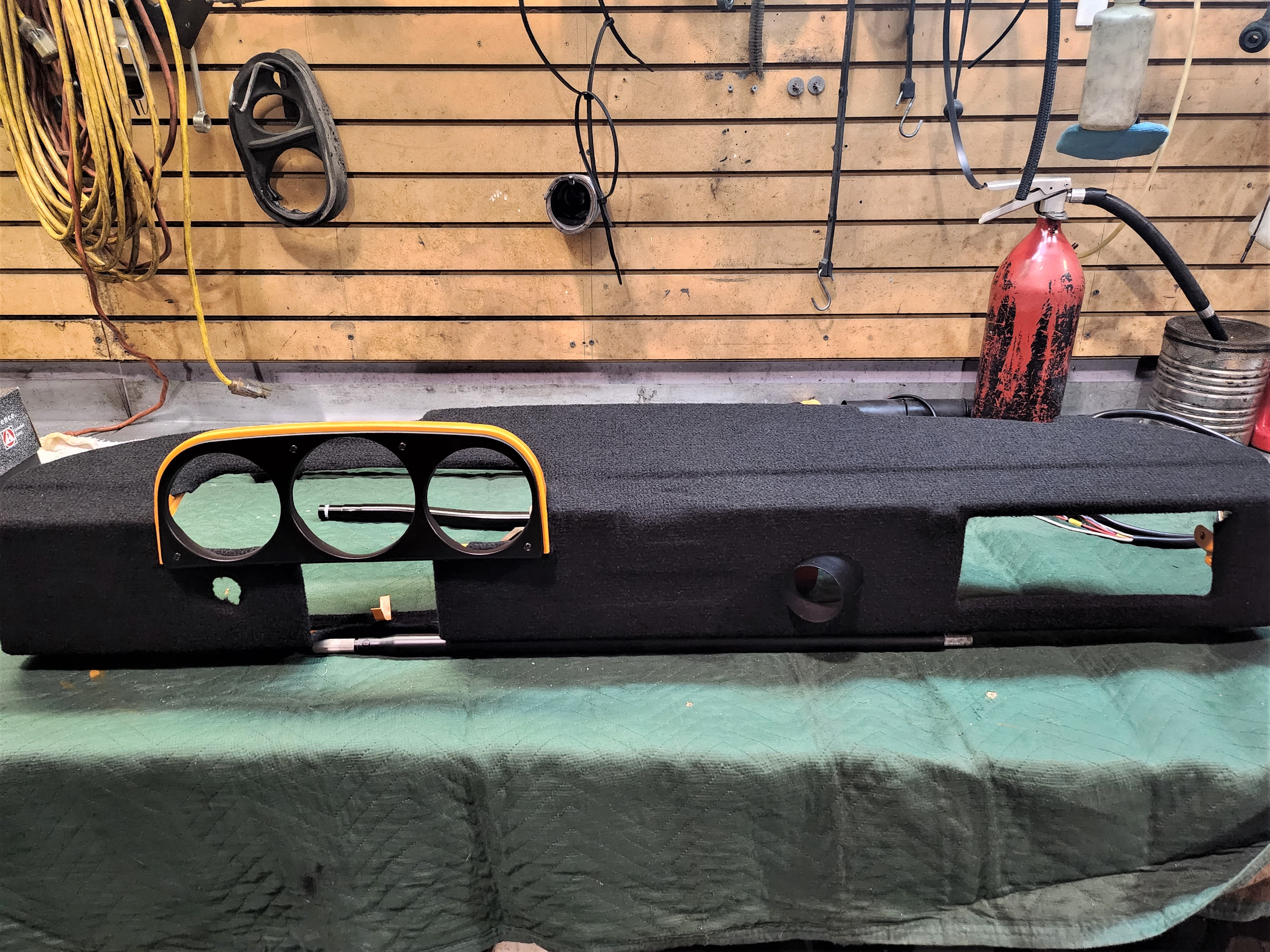

Got the dash covered and the fuel gage mount installed... will cut out holes for switches and controls as needed. The fuel gage mount came out very tidy.
Bullethead
Bullethead
Also got the cooler and shroud installed... unfortunately, we didn't fit the fog lights + grills when the bumper was, so quite a bit of trimming is in the works. Stupid oversight. Thankfully, the horns WERE fitted, so no issue there. Pics to come.

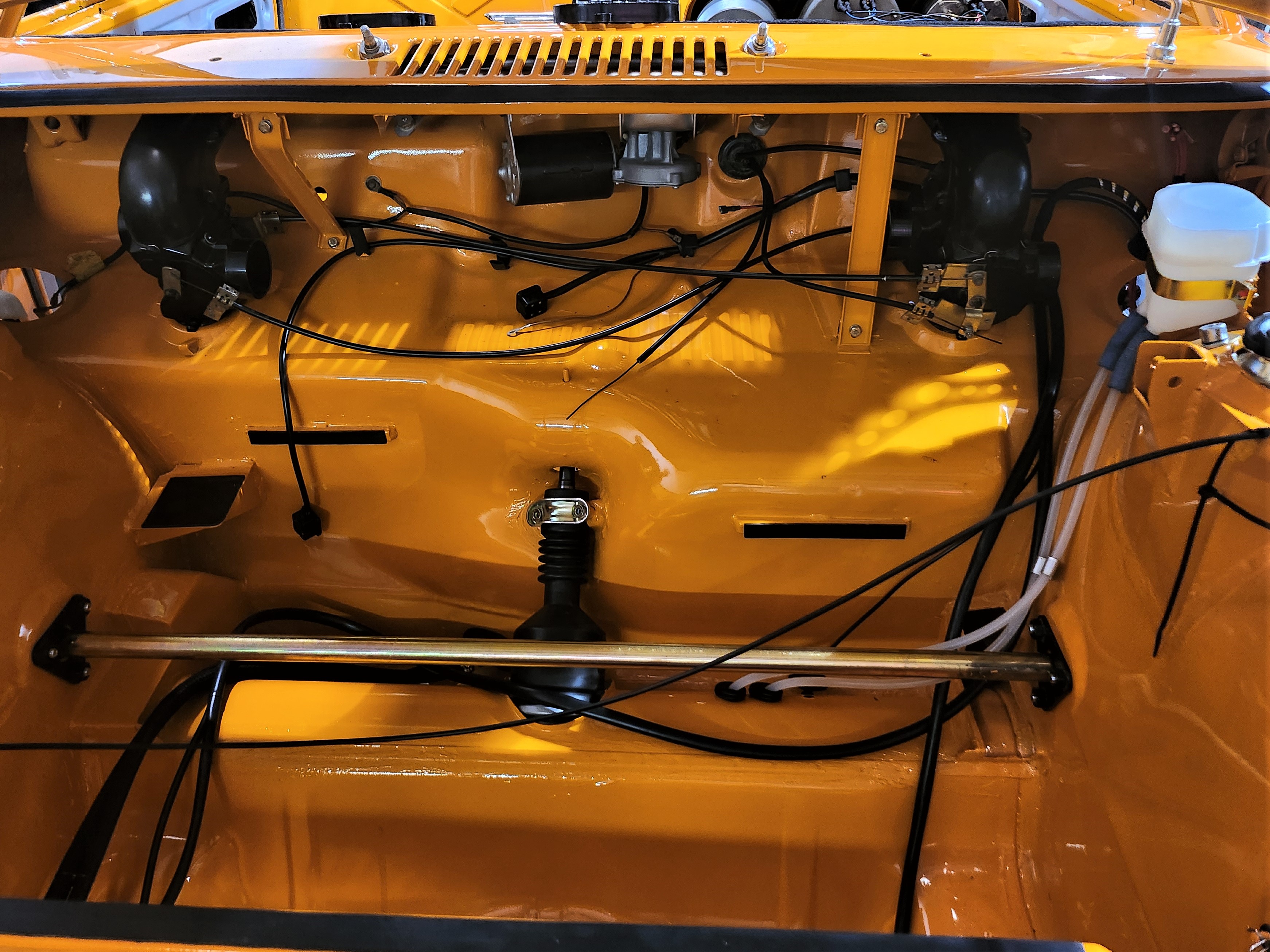

A little more done on the dash wiring, wiper system in, blower/defrost is next.

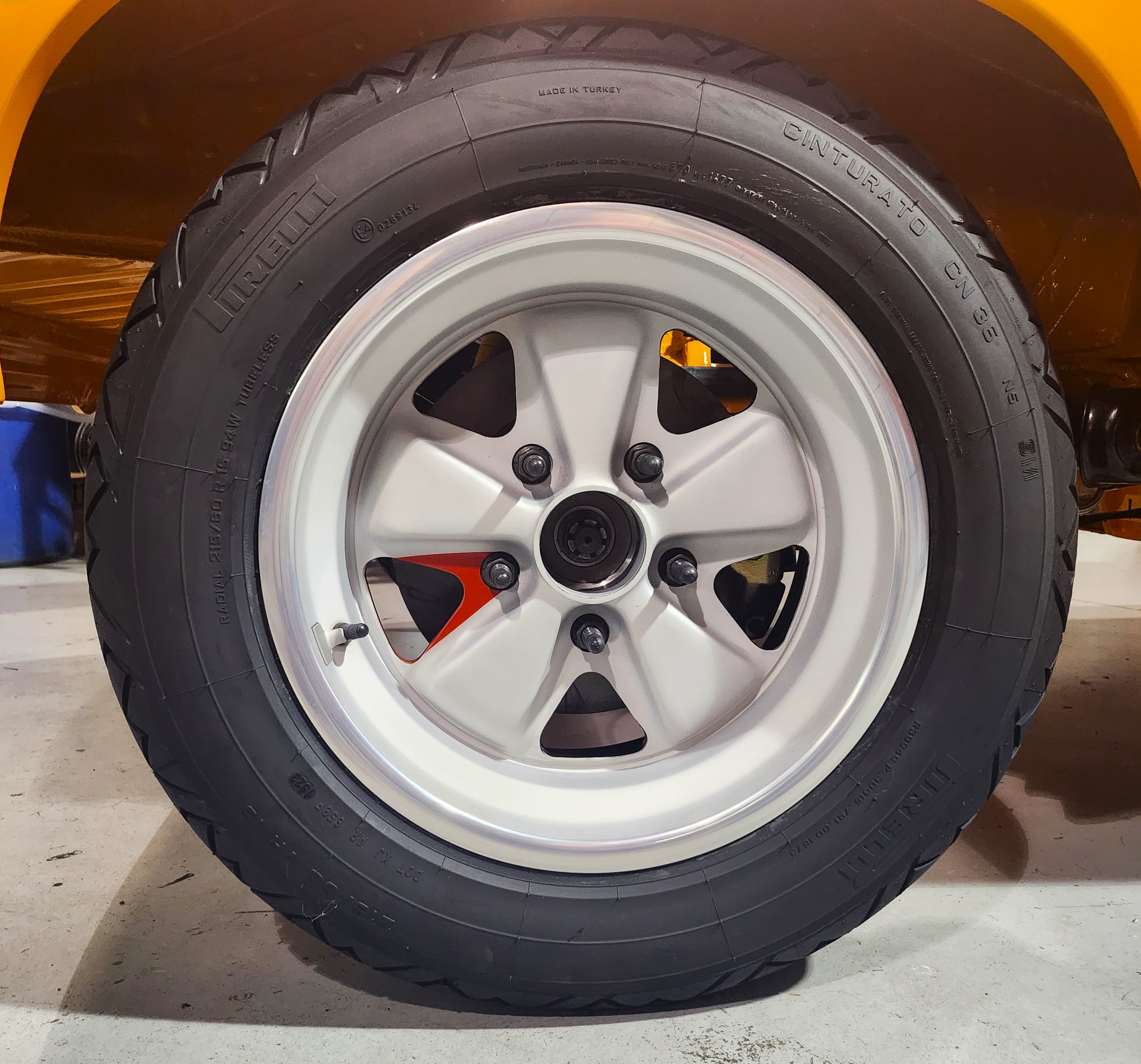

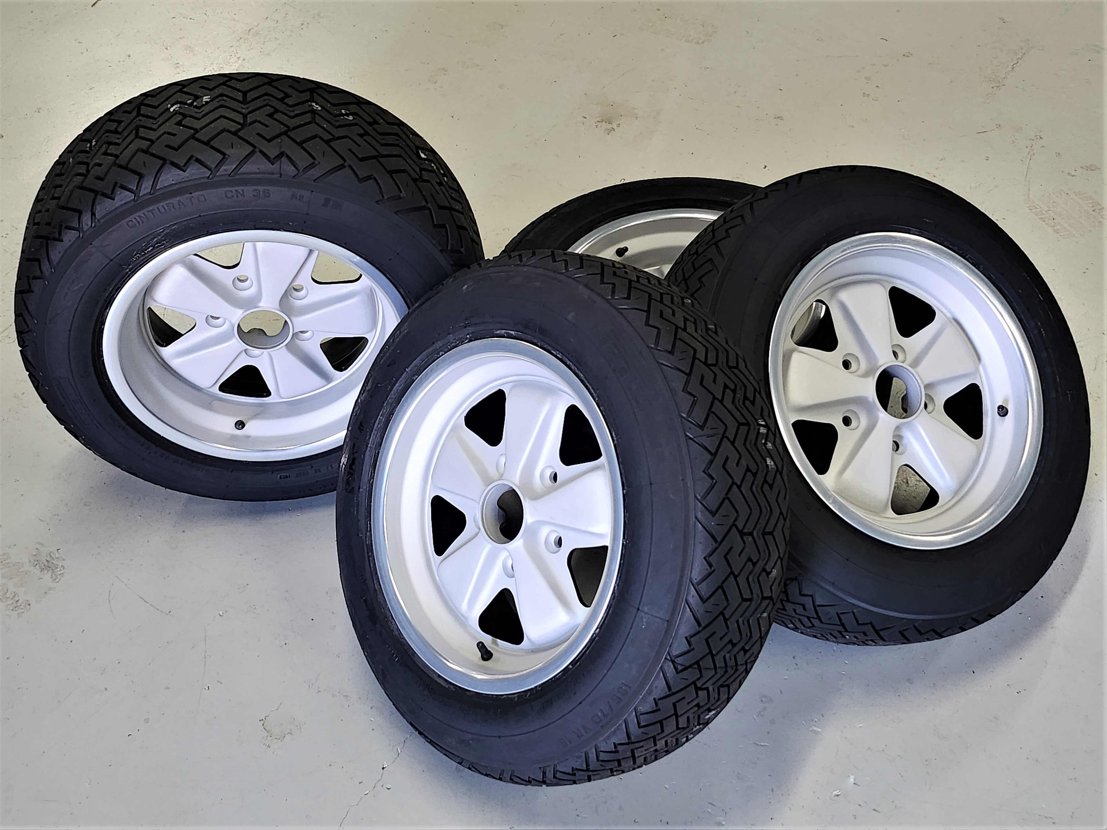

After trying all year to secure a set of Michelin TB15s for 7s & 8s, I gave up and waited just 7 months for some Pirelli CN36s. I have these on my '67 S and love them, they'll do fine here.
Mr. Weidman anodized these in his signature RSR finish, no painted petals. Thinking of just the valve petals in a small flag of color... or maybe the lug end. Suggestions appreciated! beerchug.gif
I have a line on a spare set of 8s & 9s, hopefully the Michies will be available at some point.
horizontally-opposed
Car coming together really nicely, in typical Russ fashion. That interior is a stunner. Now I am curious—were the insets under the door cards done that way on some or all cars?
Wheels definitely want for something…I'd do the dayglo red at the least, clear anodized petals to match the lips with RSR finish as you have it at most…but I know that's a hassle. ONS / "Recaro" 914-6 GT shows the way...
Bullethead
agree.gif Exactly Pete @horizontally-opposed . Like the ONS/Recaro fire car, or Larousse/Perramond #0141 which both painted the flags red. What about green or safety yellow?
What's odd is why they DIDN'T paint the petal facing the valve. Never really noticed that until now. confused24.gif I will paint the flags on the valve petal, safety yellow is likely...

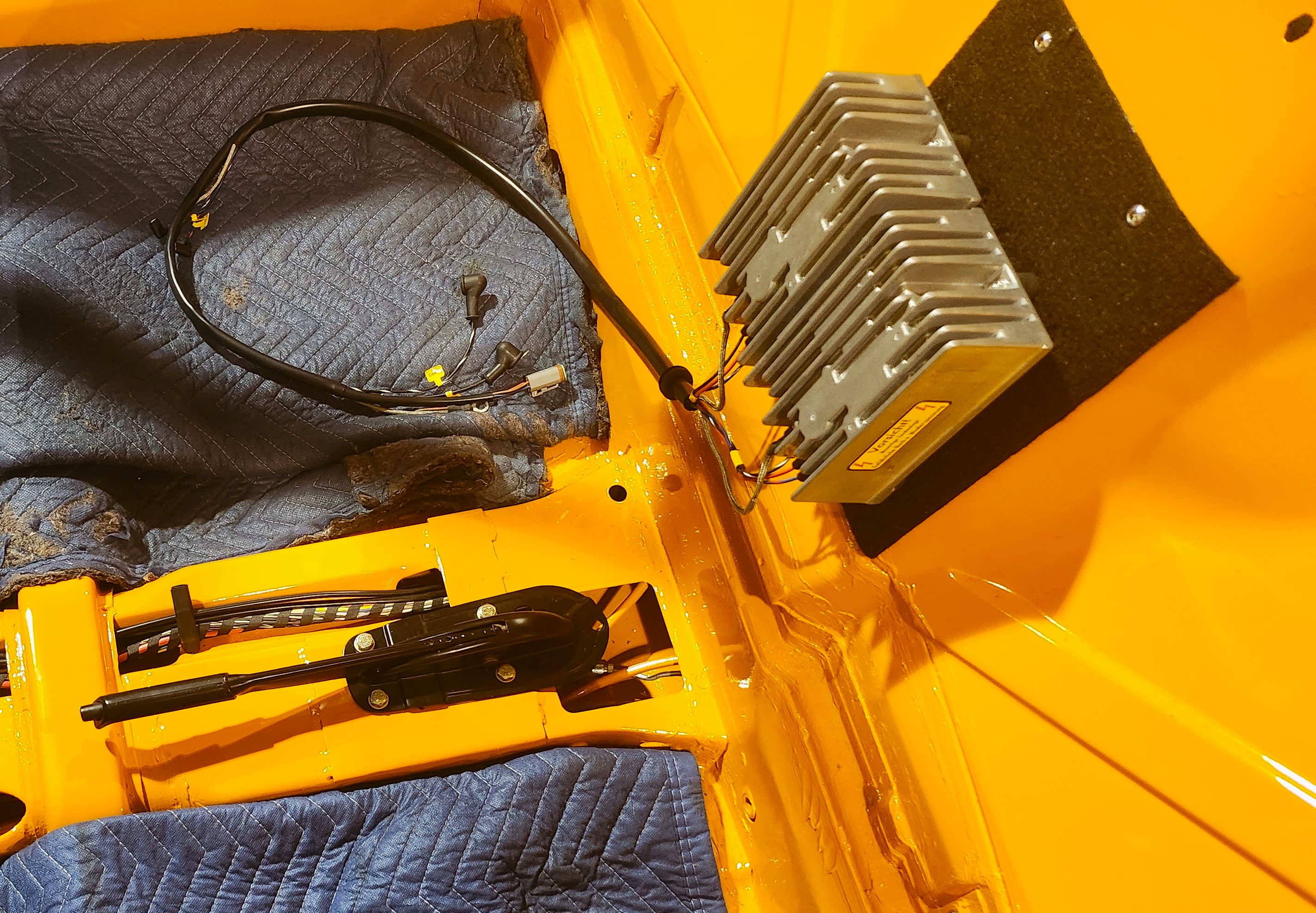

The guys from Klub Sport have returned from RRVII, and reassembly is slowly resuming. I painted the wheels as described above, got the ignition boxes installed and tomorrow will drill the handbrake holes. Details on that modification to come when the cables get here.

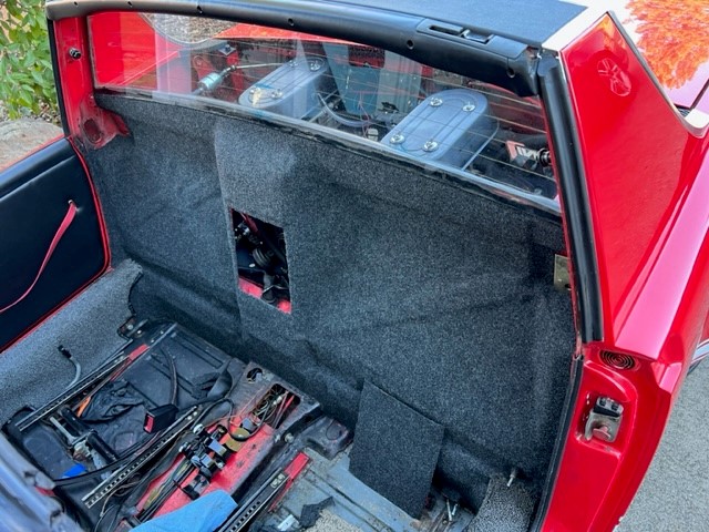

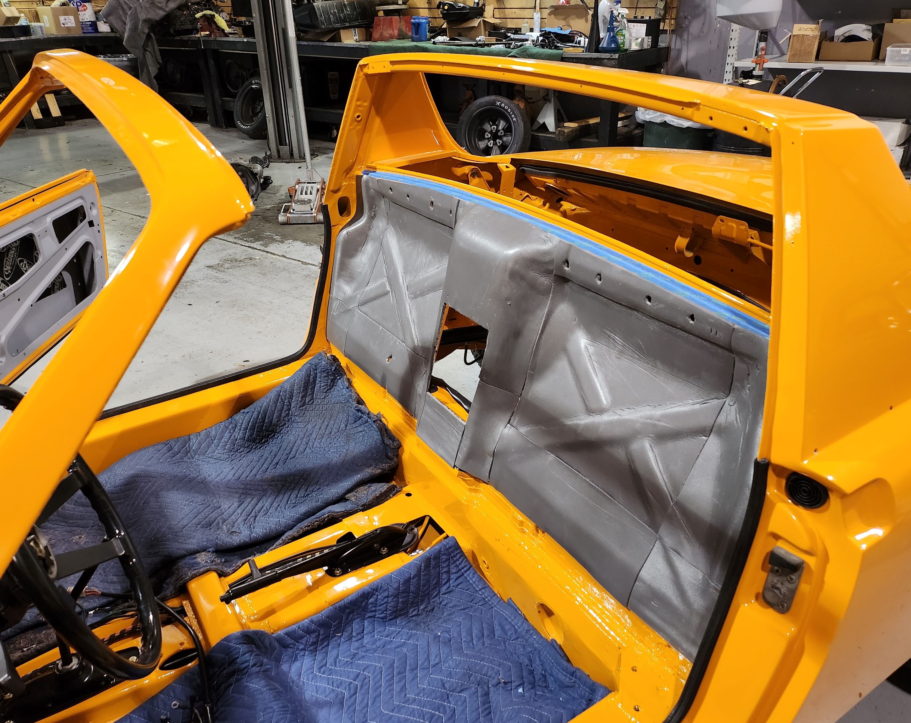

Did the insulation today... combination of one layer of Dynamat covered by Siless Liner, a closed cell foam sound and heat barrier. Doubled up, hoping for a tolerable cabin.
Also test fitment of the Perlon that didn't inspire confidence. I don't want to fuck it up so will likely bring in a pro to do it.

I just did my own perlon, its not too bad just get it not backed. Start at the top and go down. Then the part that stretches over the firewall hump (middle) will stretch out. Nice thing about the perlon is if you do mess up you can cut out the wrinkle later. You cannot detect patches. Just don't over glue it so the glue comes thru.
One thing I will say is once it's done you can see any changes in the firewall that are 1/8" or bigger. But it's not bad though because you only see them at certain angles and the seats cover most of the view of the perlon.

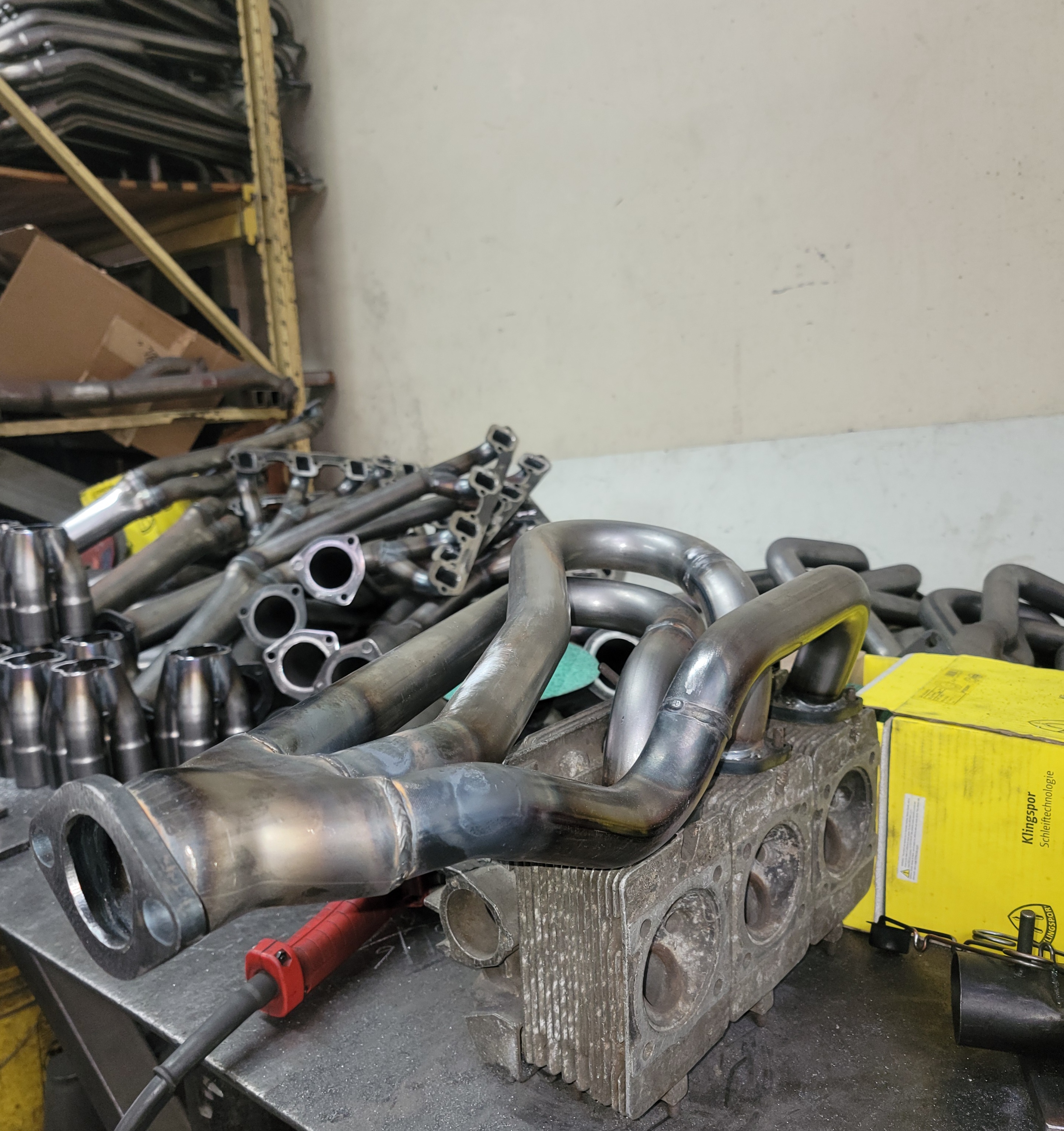

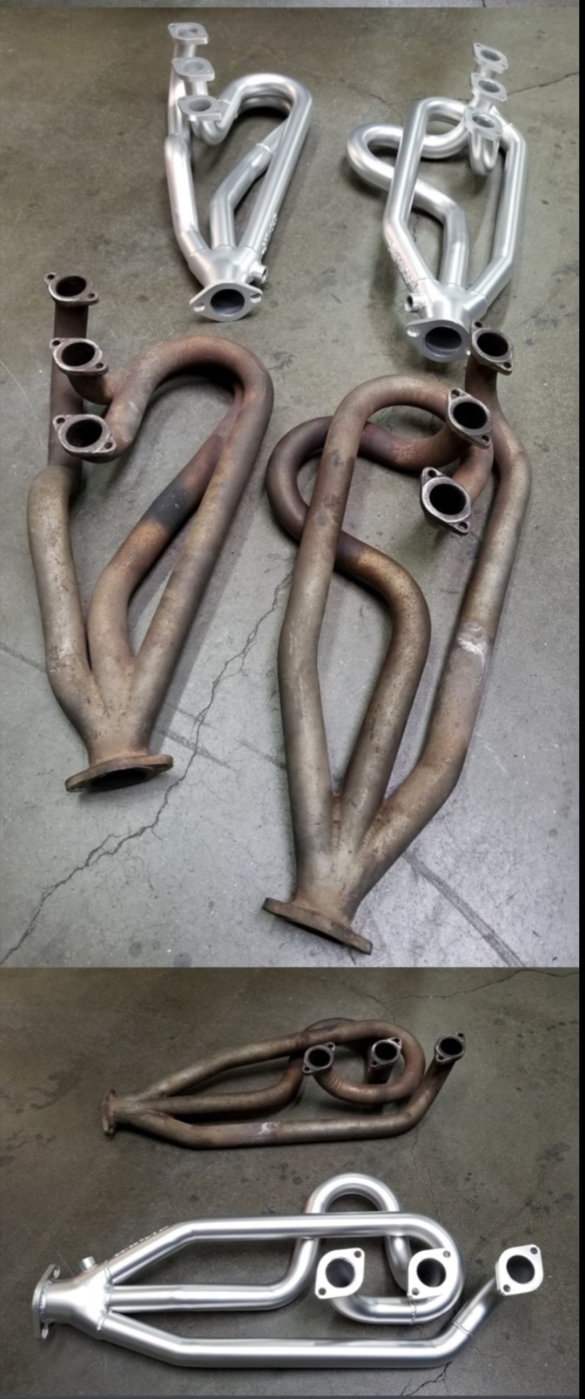

Maltese Falcon
Pair of Proper 1.625" competition 9146gt exhaust headers coming your way
Justinp71
I will agree those headers are amazing, I have them and they make a ton of power smile.gif.
BillJ
Marty equipped my car as well. Very well done.
Bullethead
Maltese Falcon
Thank you @Justinp71 @BillJ @Bullethead & many others for representing the World of exhaust scavenging with our brand !
Marty + the MSDS crew
Maltese Falcon
Last QC check is the cylinder head fit / fine tuning the fitment with thermal adjustments if necessary smile.gif
