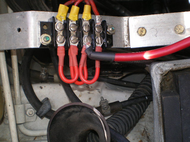

See pics of the new 4-way and 6-way kits, and the completed install of mine. Kits are designed to go on the outer edge of the battery box, however some have mounted elsewhere. If you have need for longer wires so you can mount yours differently, let me know and we can make that work for you.

For everyone's info, the 4 red wires being talked about are:
2 4.0 mm wires, one runs to the KEY switch at #30 and the other runs to the fuse block and ties fuses 10, 11, and 12 together on the unfused side to the battery.
The other 2 wires are 2.5 mm and both run to the relay panel in the engine comp. Positions 12 and 14 of the 14 pin connector.

Finally got it finished and tested.
All good. See first post for installation pics. You may not be able to see from the pics but I used two 20 amp fuses and two 25 amp fuses. Tried the starter, lights, turn signals which are the higher amperage loads, no problems.
If you are interested in this kit, be aware that it requires some rewiring and connection of lugs and proper connections are critical. I always use uninsulated lugs where possible and solder them at the lug end of the wire slightly just to be sure of a good connection. If one is careful, even insulated lugs can be soldered at the lug end without damaging the insulation. PM me if you are interested.
EDIT: the wires in the top picture are for illustration only, they are not the correct size.
