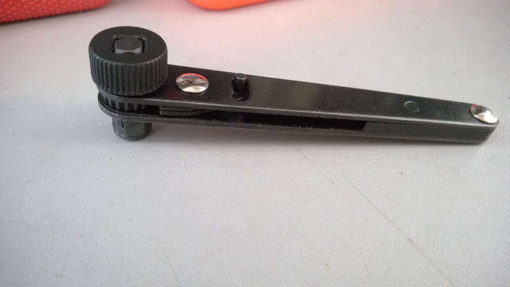

well, I still don't understand how you guys access the outer headlight cover screw? remove front marker lens?

guess if I just remove lens, maybe I would have a lesser angle on screw driver to install this last screw?
914forme
Small bit and bit holder does the trick also, remove the turns signals WTF.gif
Or take a bit and put it the proper size socket, and put it in confused24.gif
I'm a tool whore so I am sure I can find about 10 different ways to do this with out taking out the turn signal buckets.
Hold the bit in a pair of vice grips
Hold the bit in your fingers
Hold the bit it a socket
Hold the bit in the tool shown above
Bit in the flex thing
Right angle screw driver
Goto autozone, have them replace your light bulb. Have your wife do this it works out better. Have her tell them she took the cover off thinking thats how the bulb got changed.
Drive it up to Mark's shop and ask to borrow the proper tool, and do it there.
Go to any tool store buy the proper tool, and promptly bring it back.
Get a 12" long 1/4" bit, drill a hole from the outside fender through everything that gets in your way to the screw. start the screw take a 12 inch long #2 philips screw driver and screw it in. blink.gif Problem solved. confused24.gif
Sorry not trying to be an arse about it, just can't believe taking the turn signal bucket out is the favored way.
jimkelly
(( driver bit in fingers seems like a decent solution to me - thanks ))
