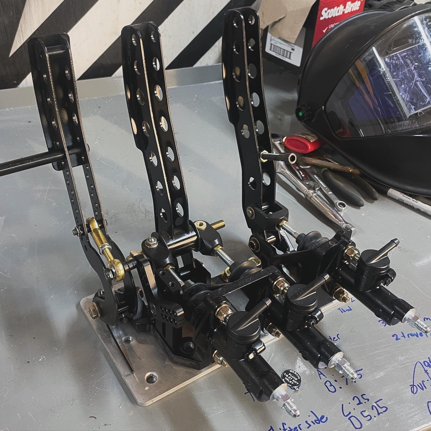

Could the reservoirs be inverted if one wanted to hang vs stand the cluster?
tazz9924
Feb 17 2024, 04:06 PM
QUOTE(76-914 @ Feb 16 2024, 07:48 AM)
This one is specifically designed to be floor mounted but there a slightly different part number that’s meant to be hung

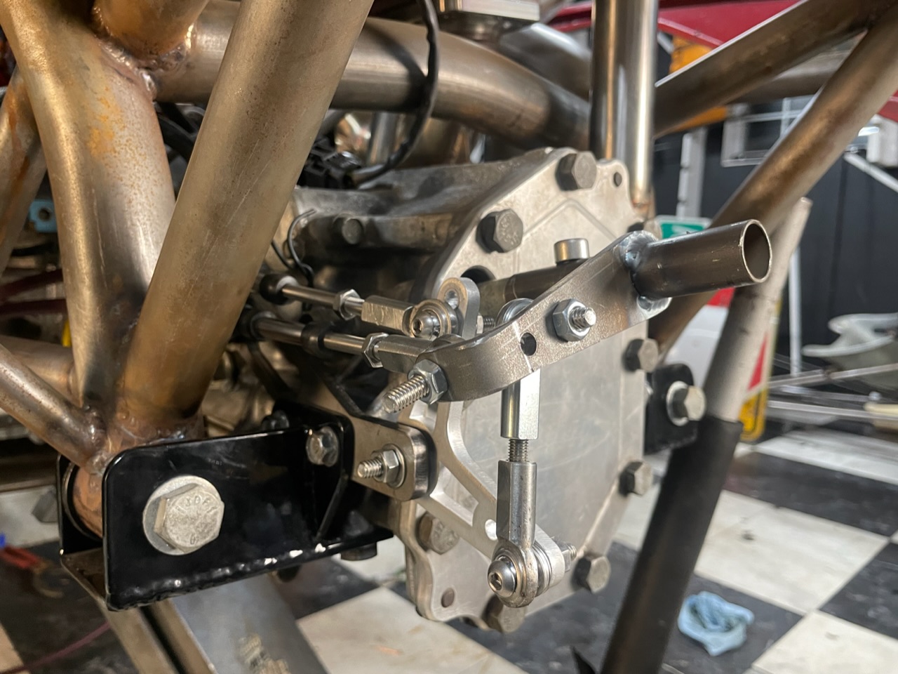

tazz9924
Mar 7 2024, 07:39 AM
I “finished” the shift linkage. Everything looks great, it goes in every gear but theres one major issue: 1st is on the right and fifth is on the left
. I didn’t mess up, not totally. The original shifter in my old car id from an mr2 and I thought id be fancy and get a k tuned shifter. This was a bad idea because apparently the k tuned shifter pulls the cable when you move the stick to the right instead of pushing it like the mr2. So maybe a good cable shift mechanism (minus cables) and a subaru cv to 914 stock cv custom axle will be fir sale soon
Blown59
Mar 8 2024, 01:31 PM
QUOTE(tazz9924 @ Mar 7 2024, 07:39 AM)
Click to view attachmentThank you for being the guinea pig, I was just looking at those shift boxes on ebay the other night and almost pulled the trigger on one. I wasnt sure how it would fare being designed for the front wheel drive Honda.

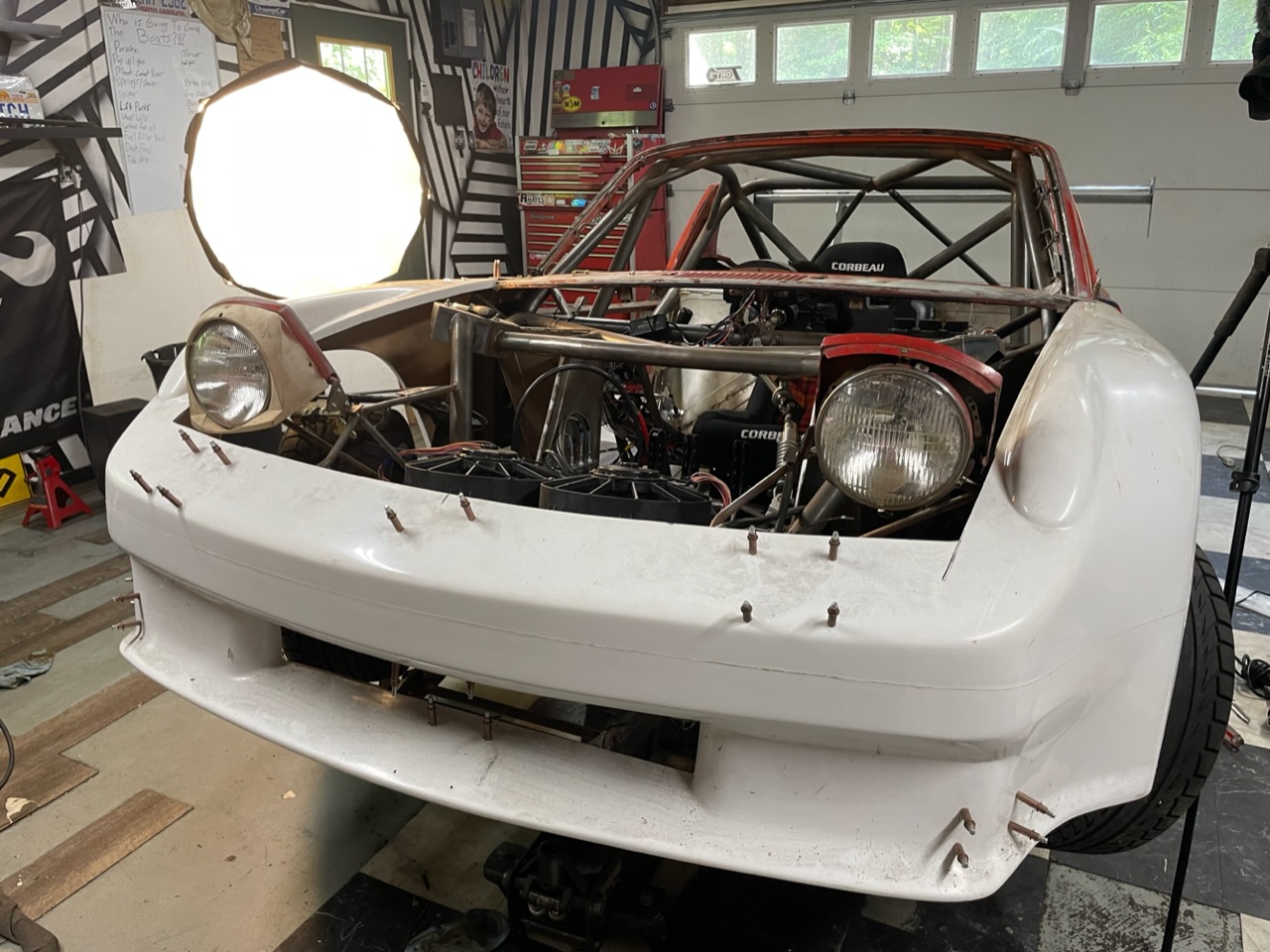

Aug 17 2024, 07:07 AM
Progress has been… bumpy lately. Since my good friend past away, and racing two cars at the same time at Sebring my motivation to do anything tanked. With that being said i have done many good things to the car, starting with headlights.

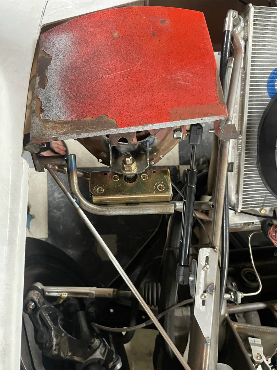

Click to view attachment Click to view attachment I used a very short gas strut to lift the light itself and i used a door latch catch to keep the lights down. I used laser cut parts to slot everything and leave everything totally adjustable. It will eventually be activated by a pull cable but that gets to wait till after powder coat. Its just one of those things that make me smile
76-914
Aug 17 2024, 10:04 AM
QUOTE(tazz9924 @ Aug 17 2024, 06:07 AM)
The door latch was a clever idea. Sorry about your buddy passing. Did you make a new video update yet?

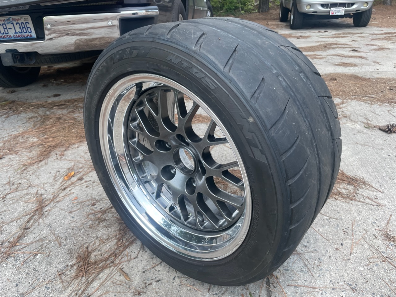

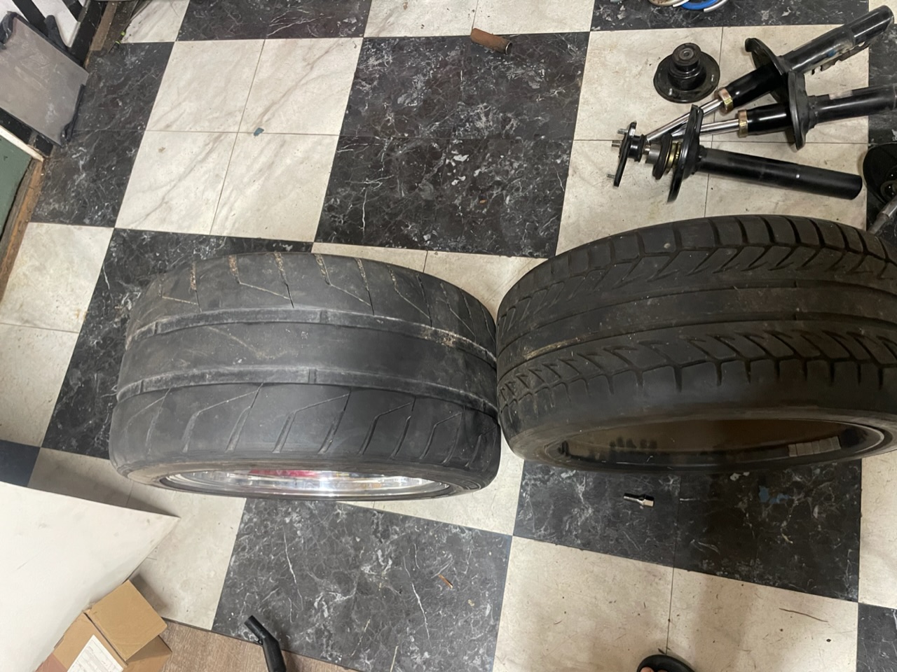

I also got some used tires to mount up on my fikse rims. Amazingly i bought a set in the exact sizes i wanted so its a perfect mock up. 275 fronts 315 rears. Meat. Neat.
Click to view attachment Click to view attachment Comparing old rear 245s to 315, this is a comically big tire.
