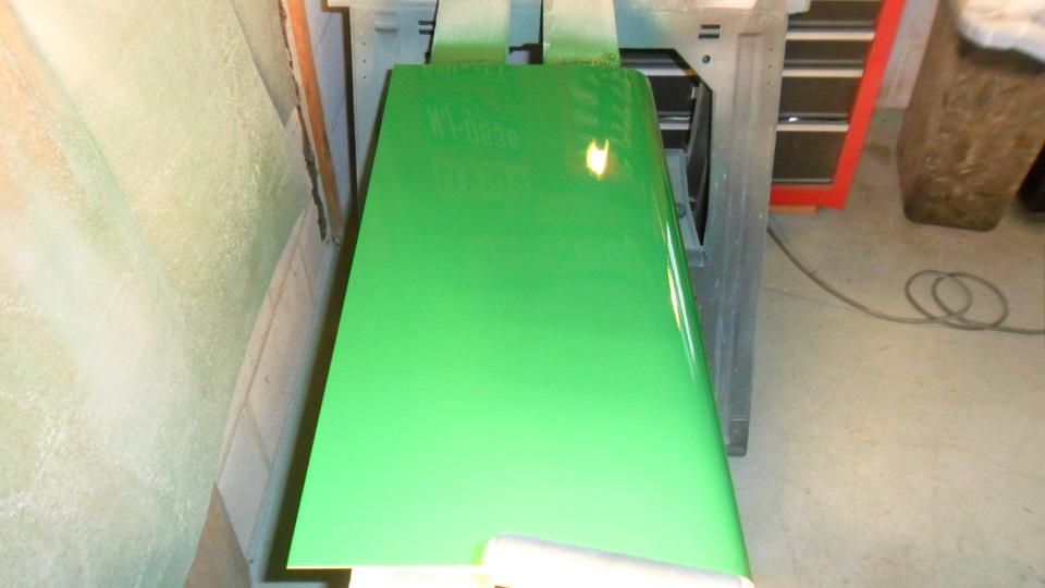

It got ugly two days after spraying primer...

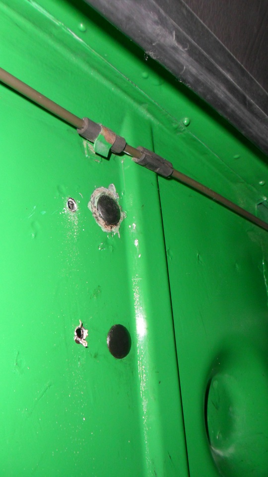

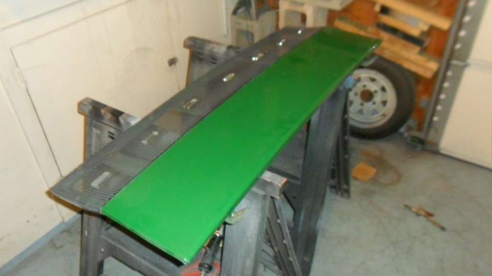

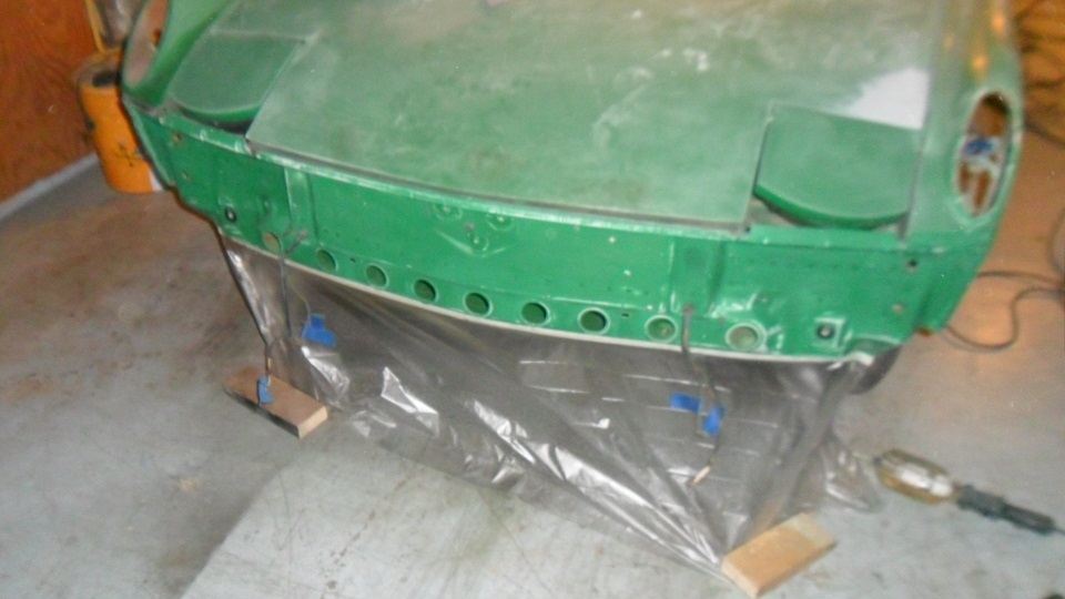

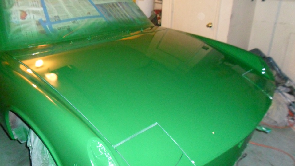

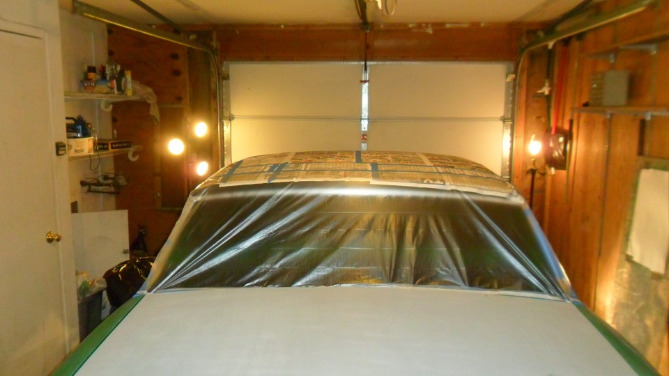

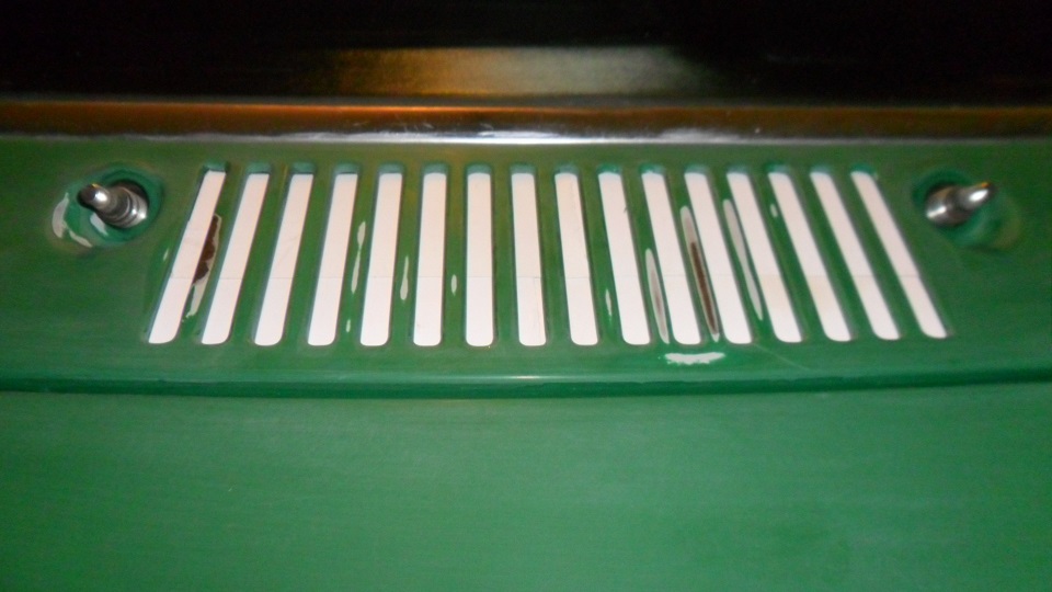

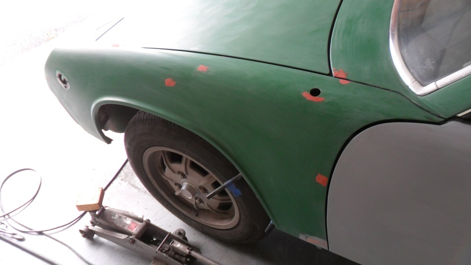

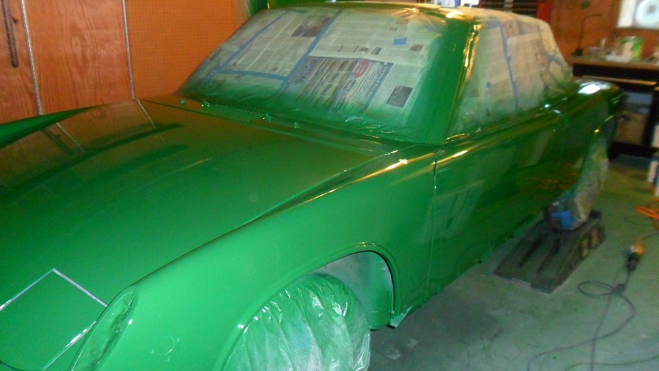

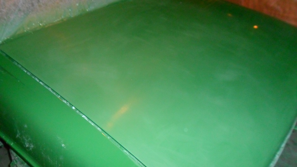

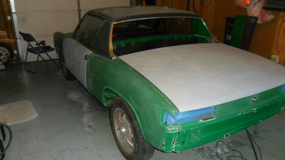

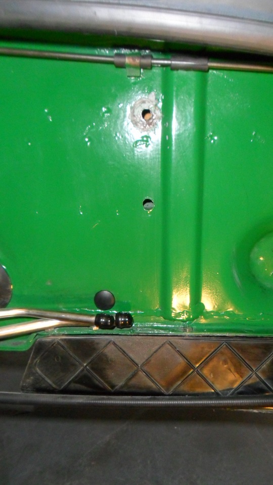

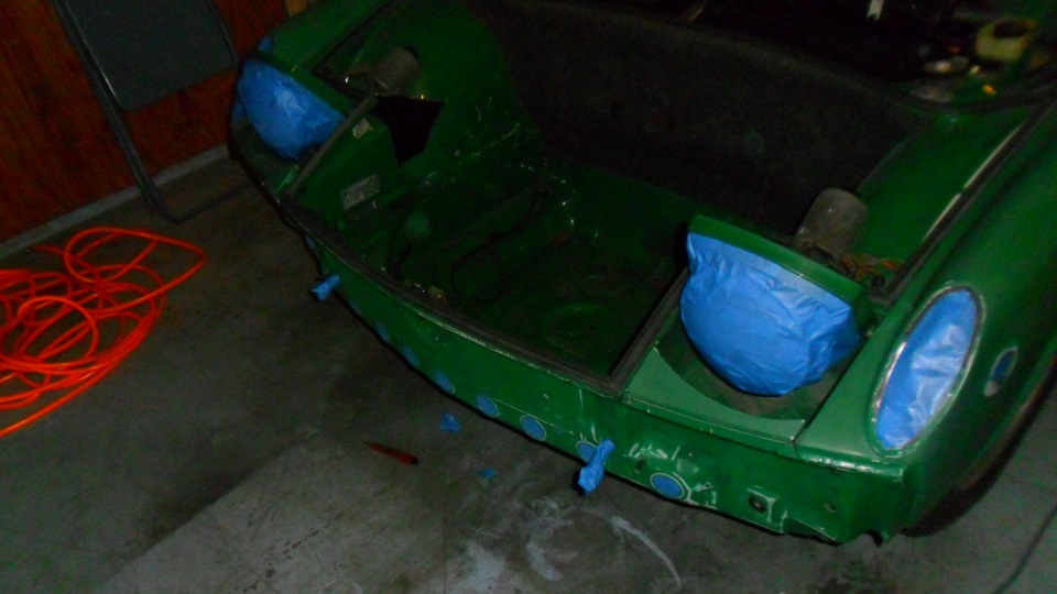

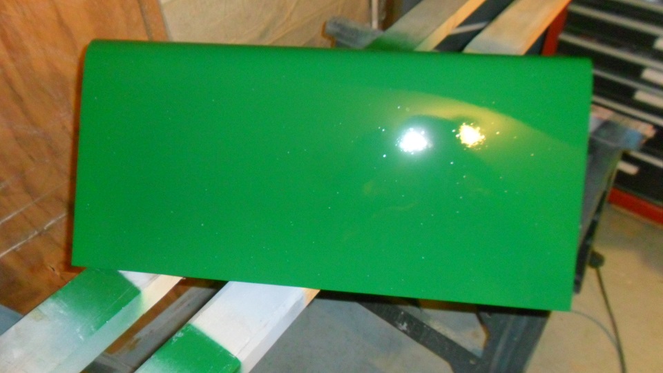

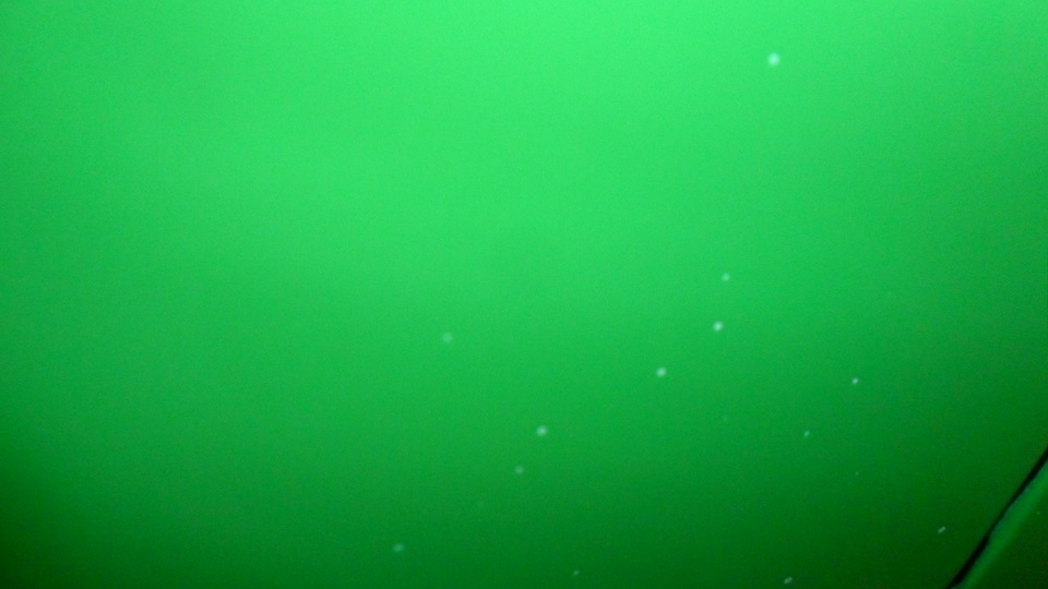

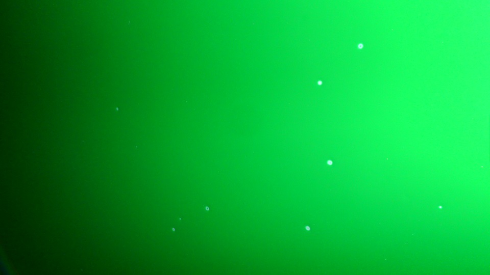

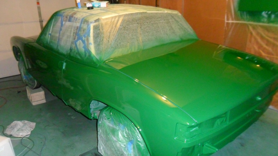

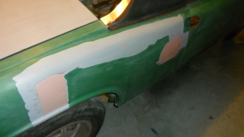

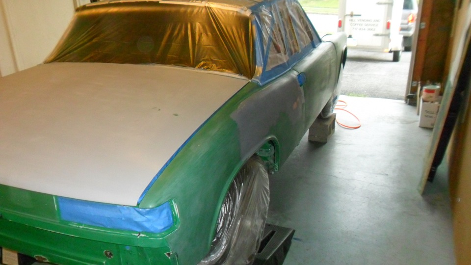

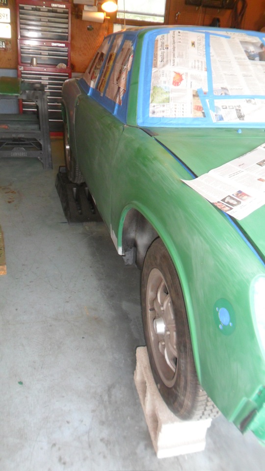

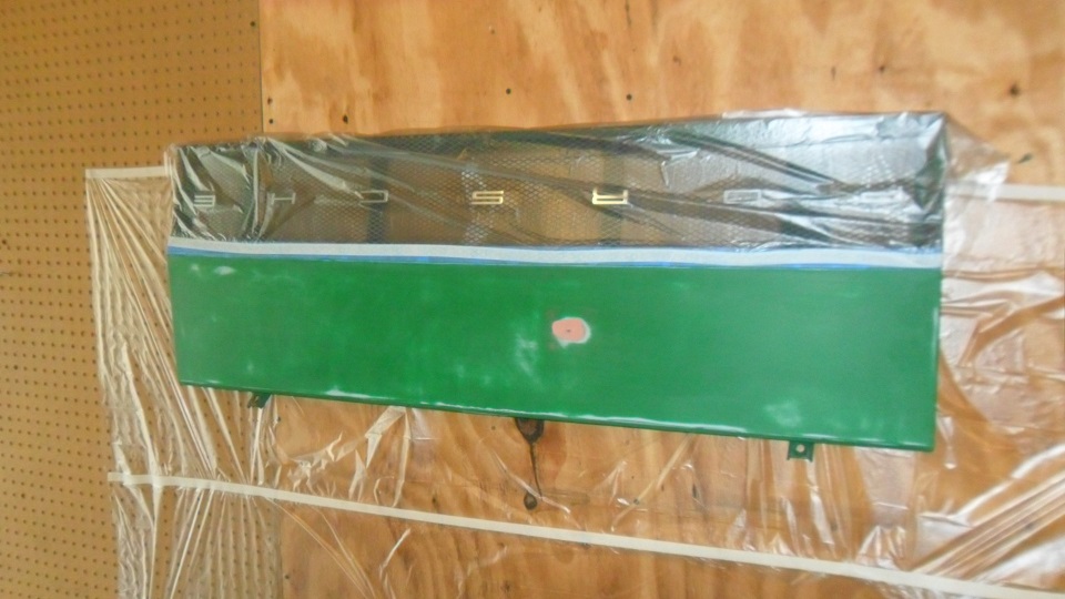

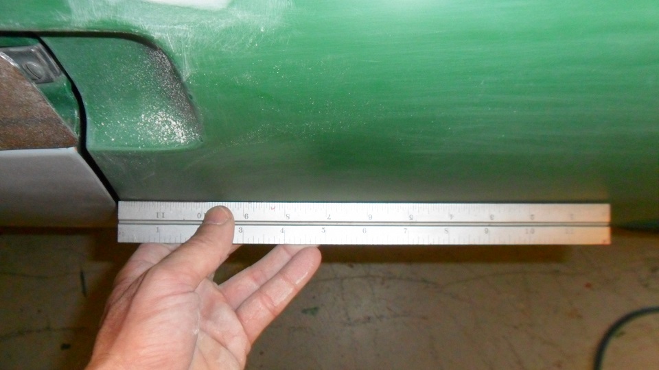

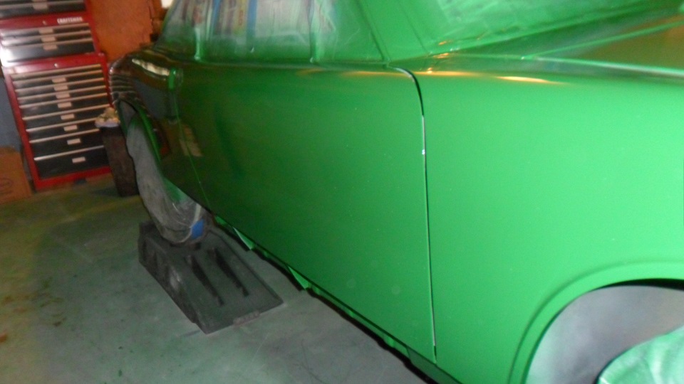

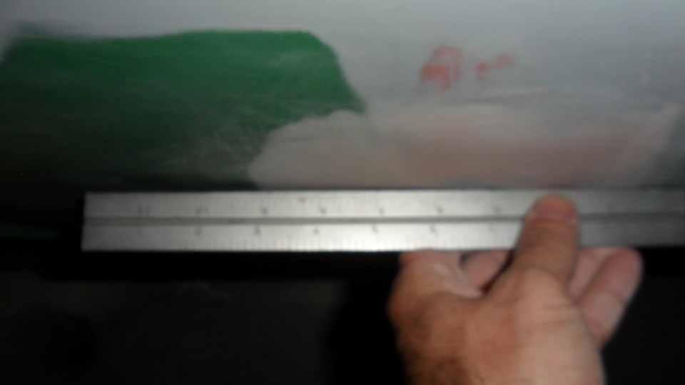

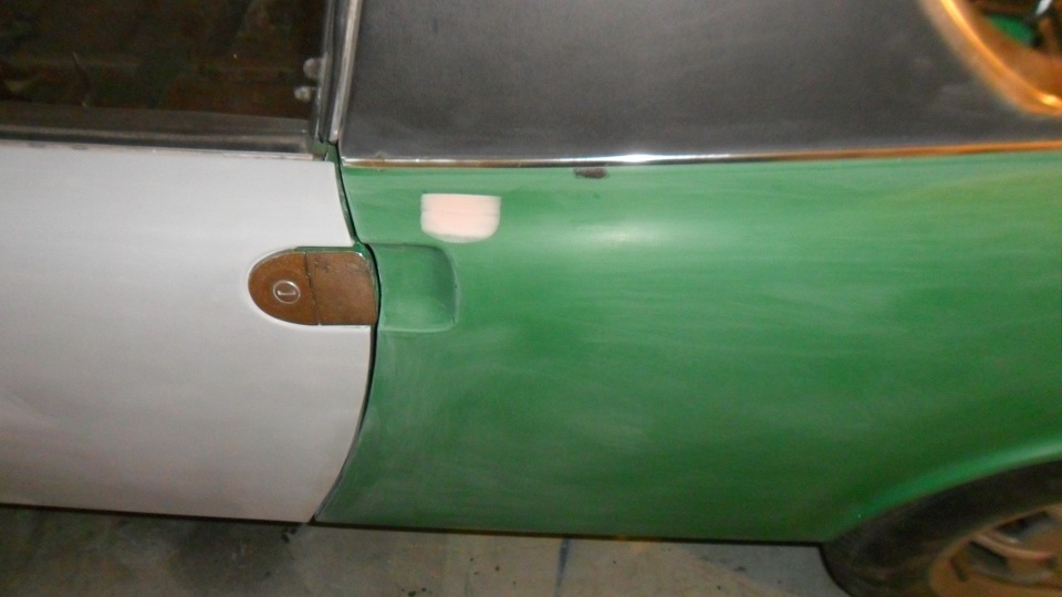

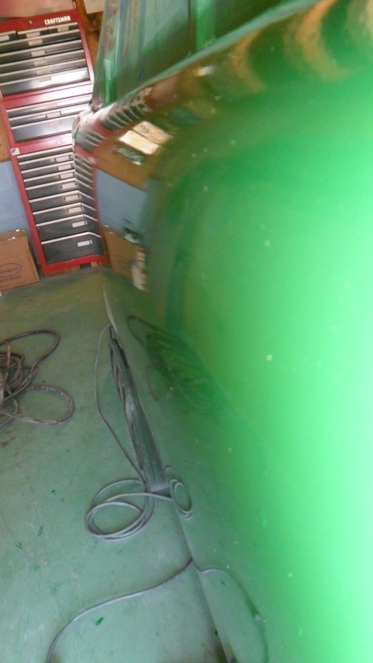

Finished sanding the car, cleaned the garage, wiped car down twice with wax & grease remover and followed up with a tack cloth right before shooting color with the 1.4mm tip. About 3/4 of the way into the first coat, I noticed a few fish eyes forming in the paint. Tried applying less paint to bridge them closed, but nothing worked. Not completely realizing how bad it was getting, I shot the 2nd coat of single stage acrylic enamel:

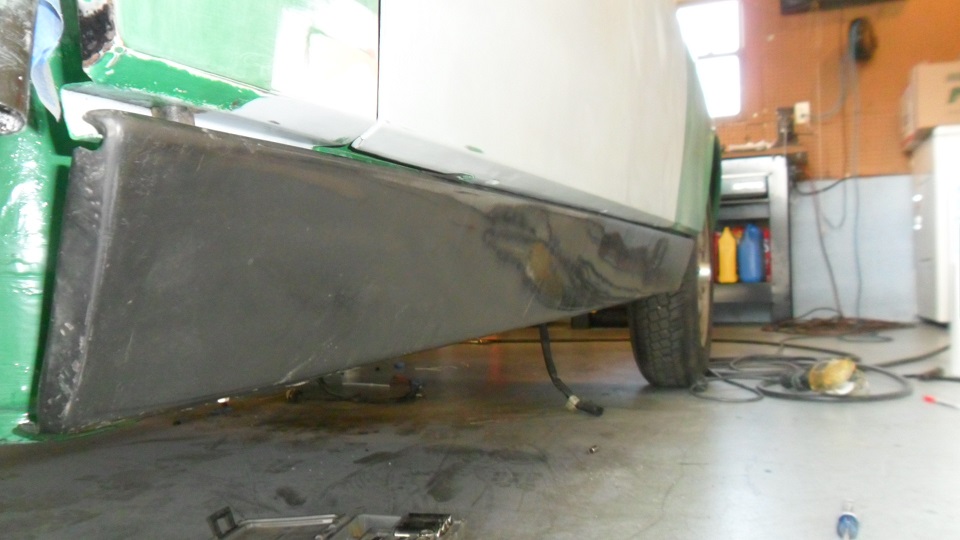

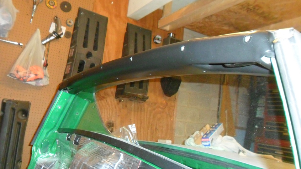

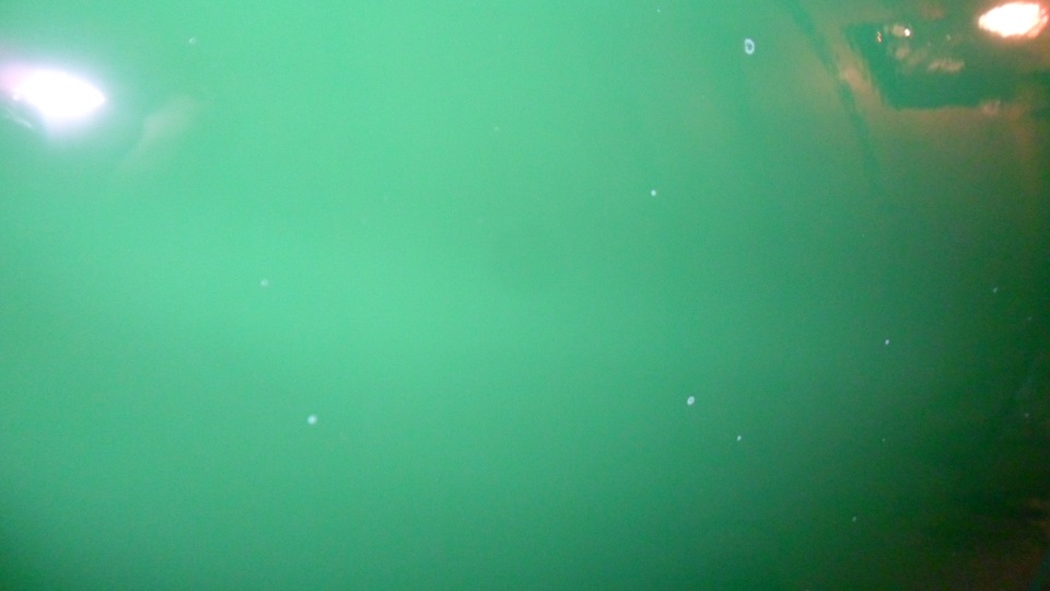

Click to view attachmentClick to view attachmentClick to view attachmentClick to view attachmentClick to view attachmentCleared out of the house for the evening due to the paint fumes. Came back the next day to inspect the paint job. There were fisheyes everywhere in the paint!

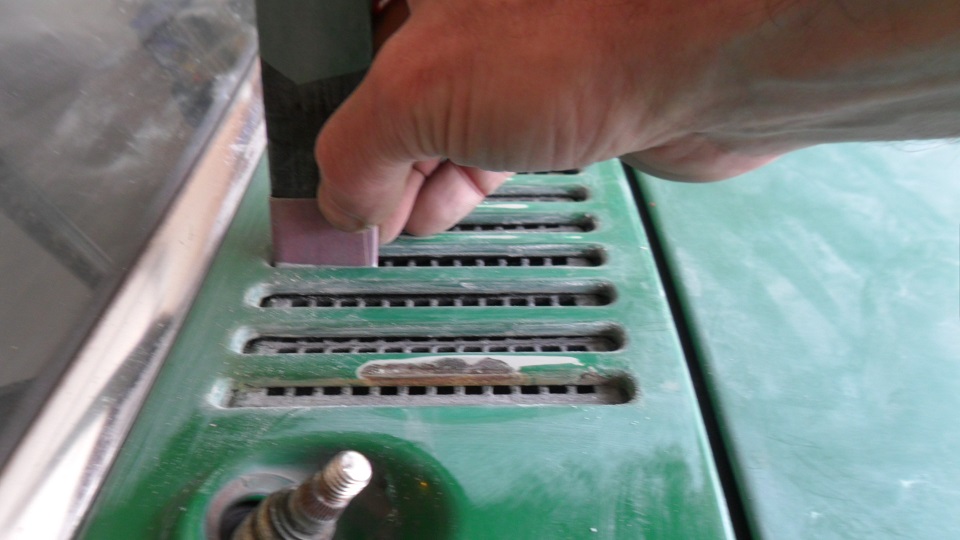

. The worst part about it was that aside from the fish-eyes the paint job was decent. Devastated, I tried filling all fish-eyes with a small tiny paint brush...made two passes over the car filling holes. Started color sanding with 1500 grit, hoping to save the paint job. Started rubbing thought the color down to primer while trying to get a good finish.
I need to sand the car down to primer.

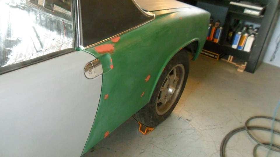

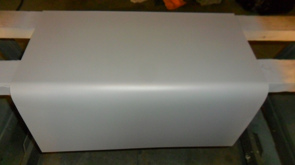

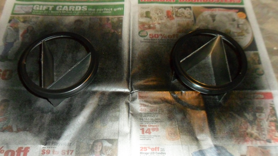

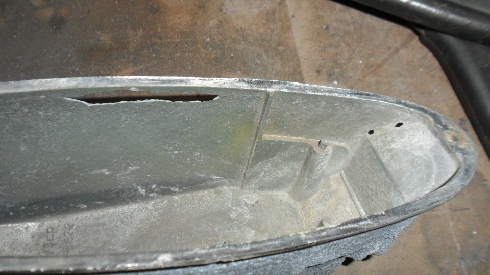

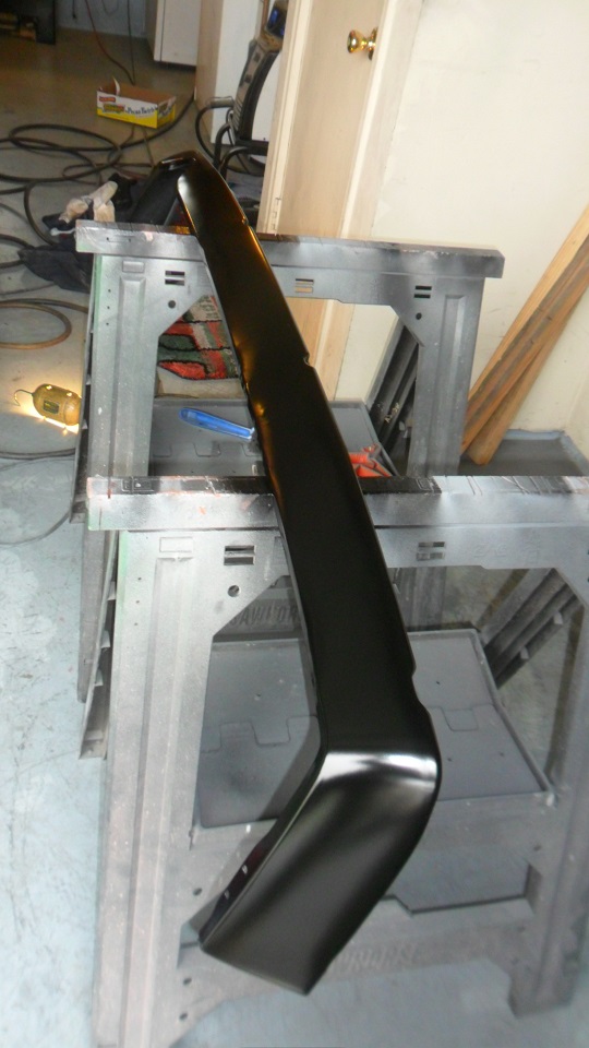

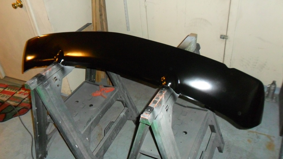

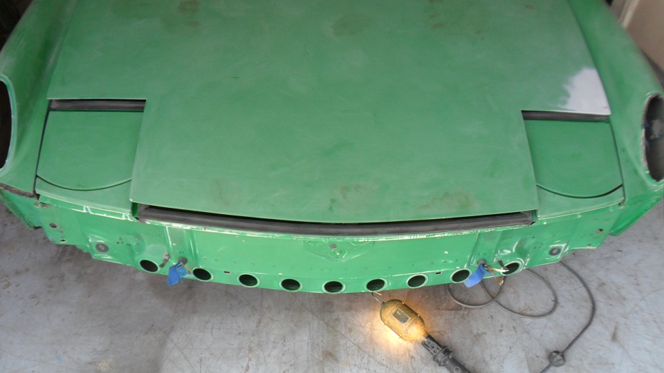

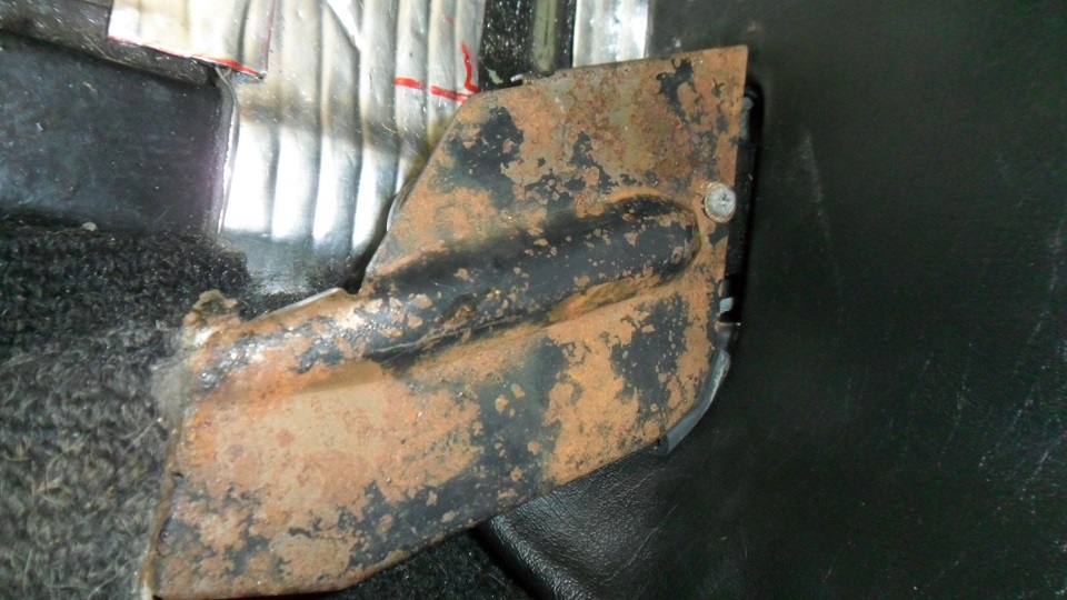

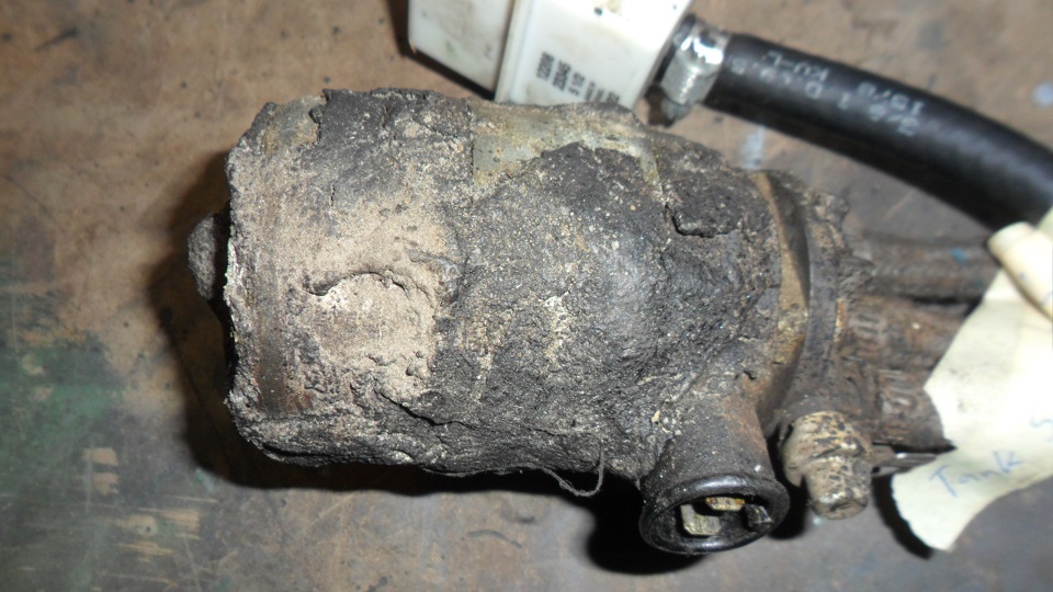

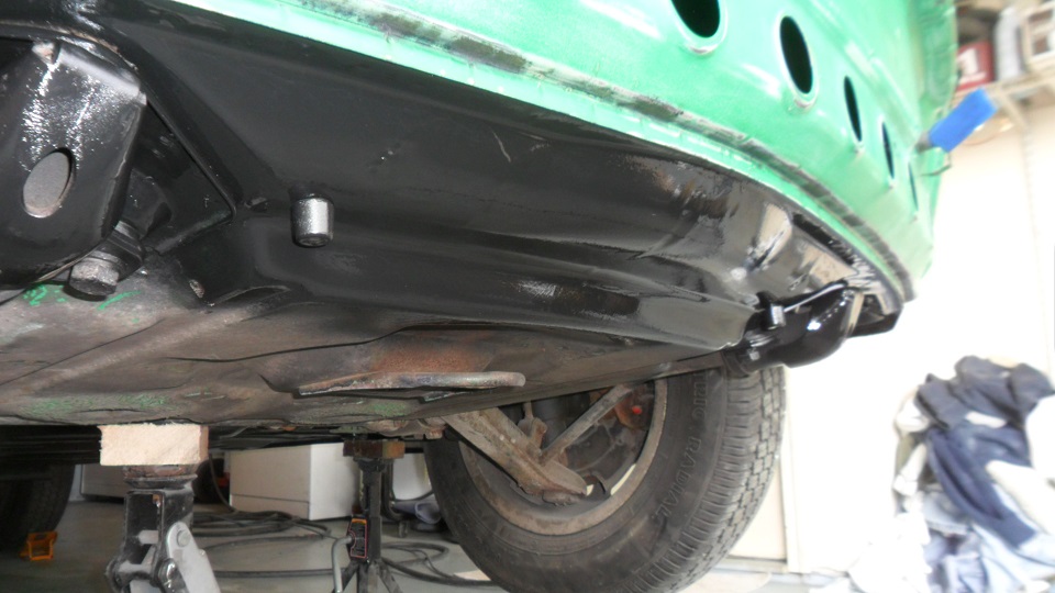

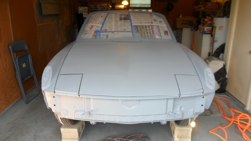

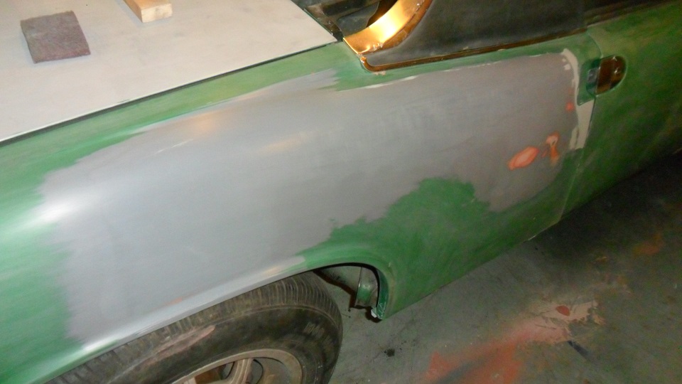

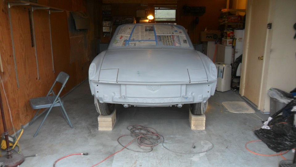

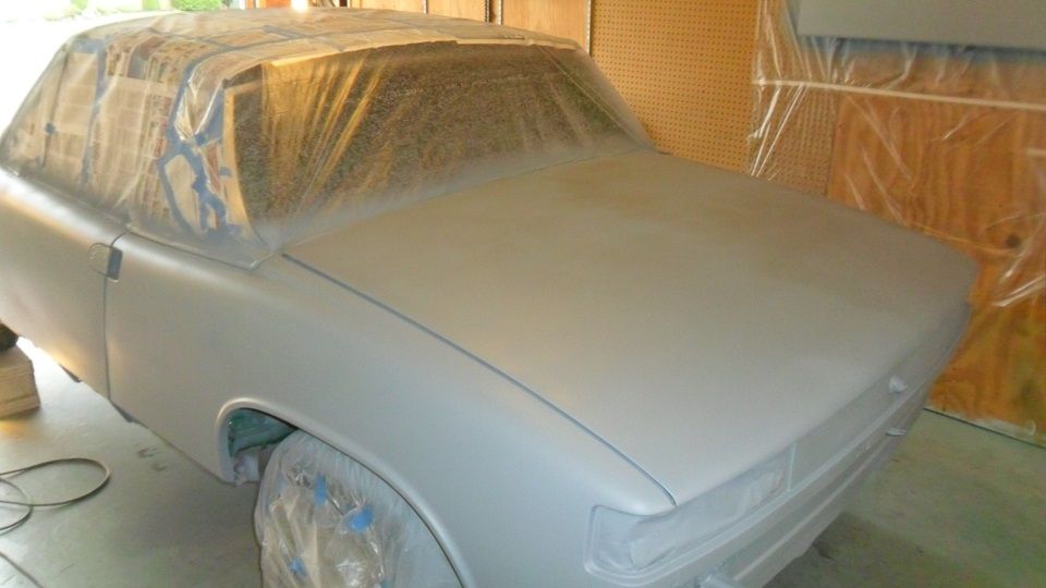

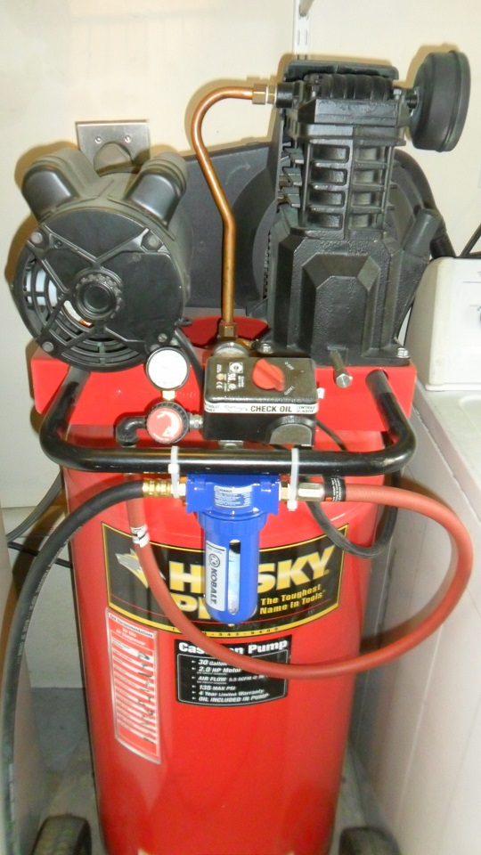

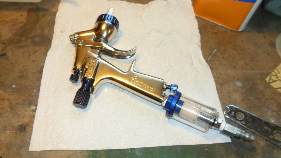

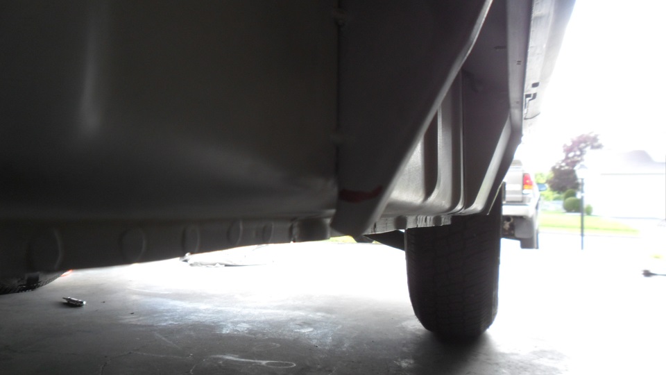

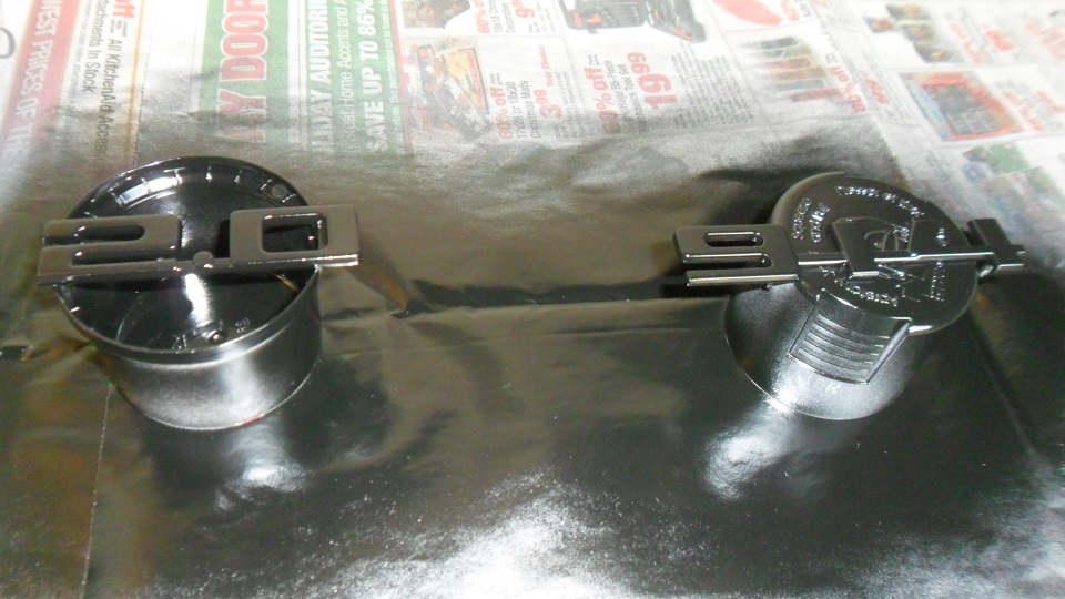

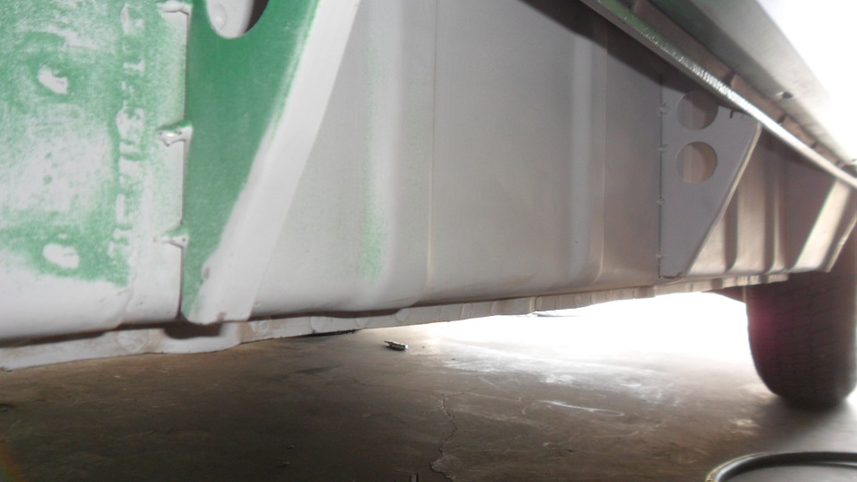

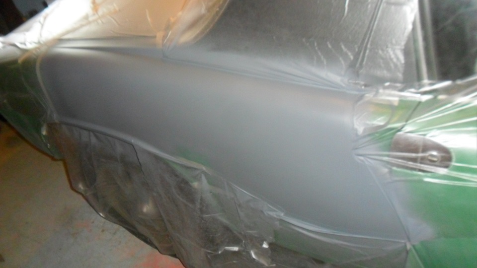

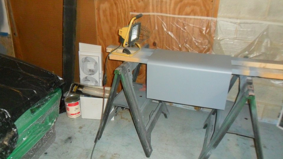

Frustrated as hell, I need to find someone to shoot color for me. I am 90% certain that it is water getting through the air line of the compressor causing the fish eyes. I don't plan on painting a lot of cars. If I do, I will invest in, or build an air dryer system. What I don't get is why I didn't have problems shooting primer in similar conditions two days prior:
