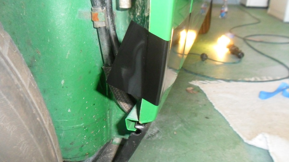

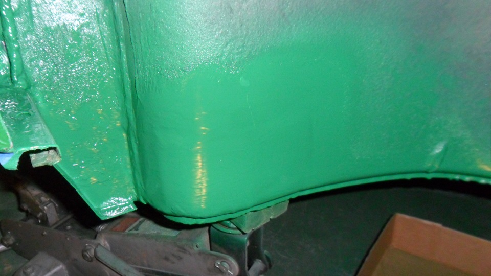

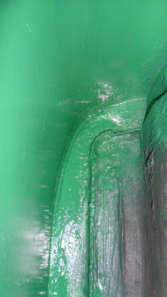

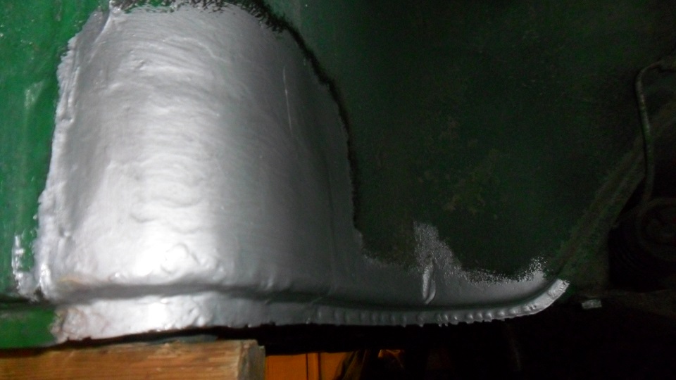

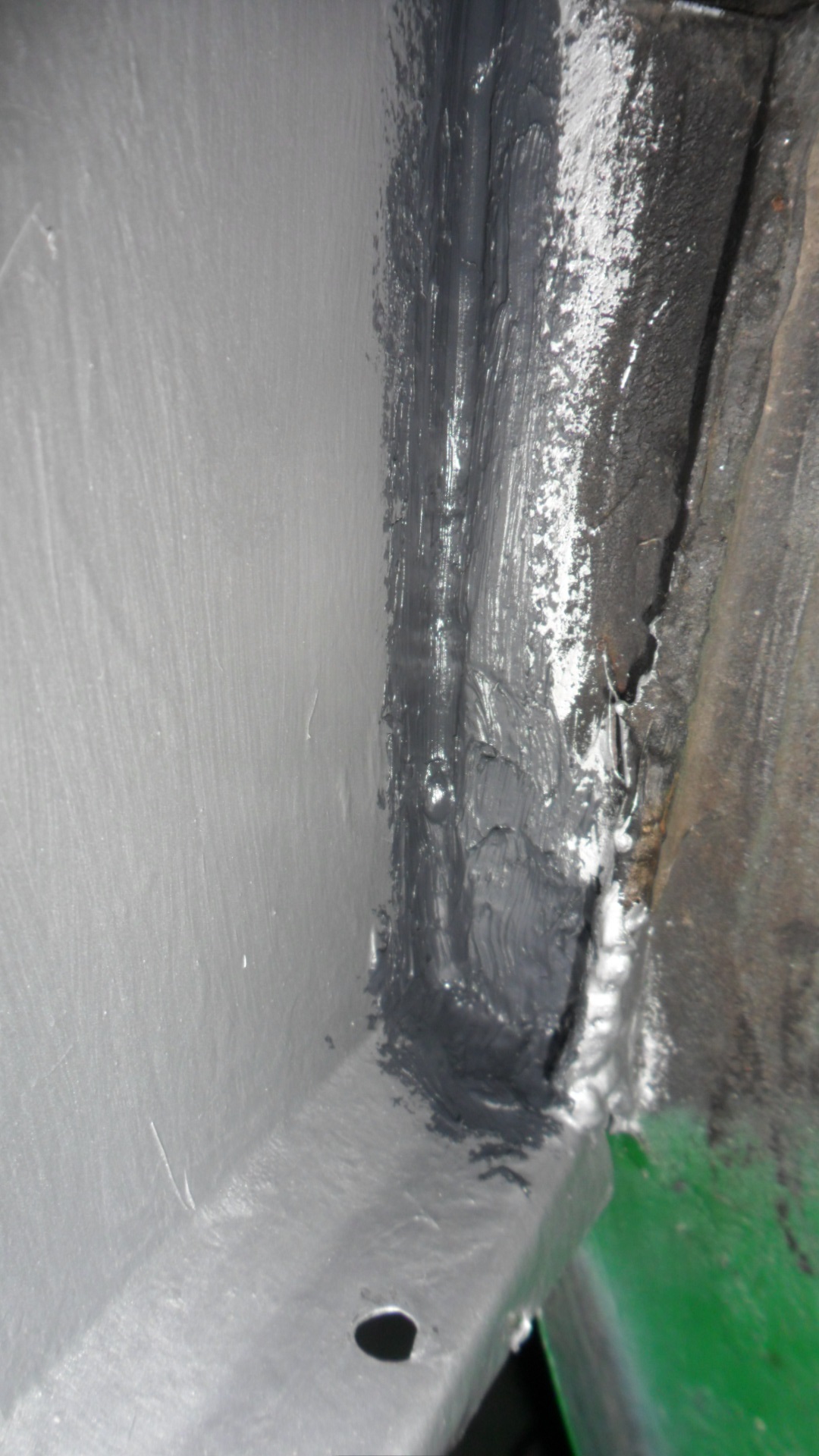

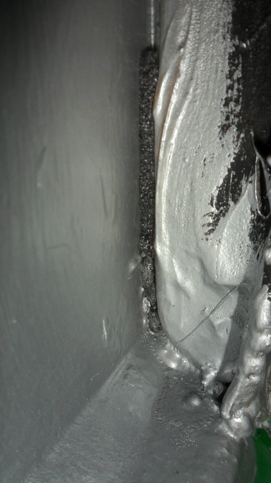

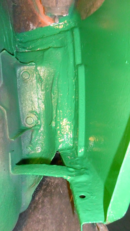

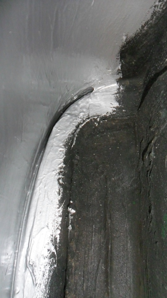

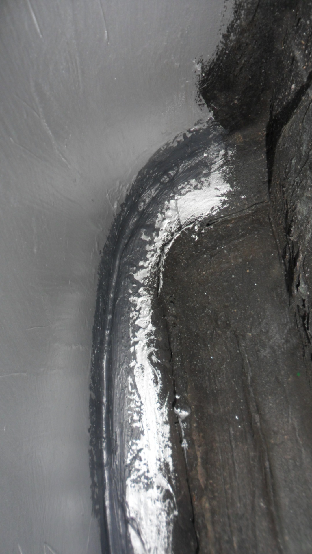

I noticed some rust in the passenger side front fender well. Additionally, there was some substandard work performed by me early on in the restoration that I wanted to fix. My right front fender was replaced at some point and there were two gaps that I didn't think seam sealer would fill properly, so I cut down small pieces of polyethylene pipe wrap to fill the gaps. Cleaned the whole area with a wire brush, banged on two coats of rust bullet & a coat of seam sealer.
I couldn't handle getting jacked for big $ for another custom fill Zambezi green spray can, so I found something very close at Lowes for the topcoat:

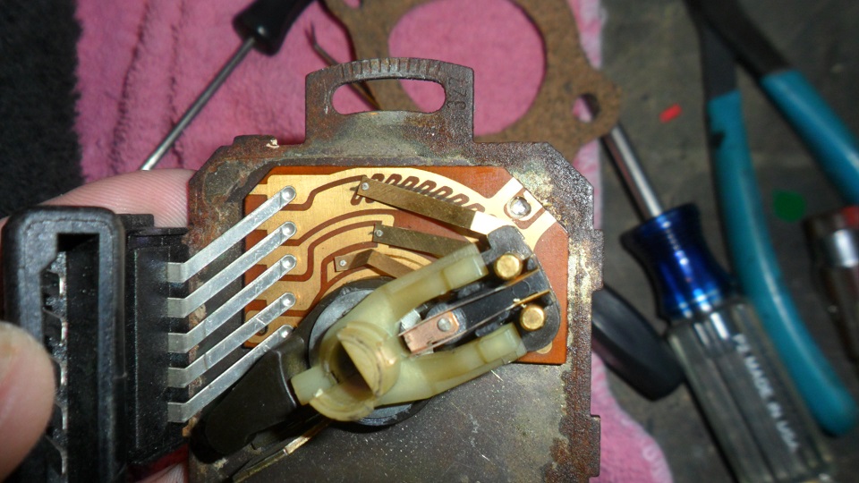

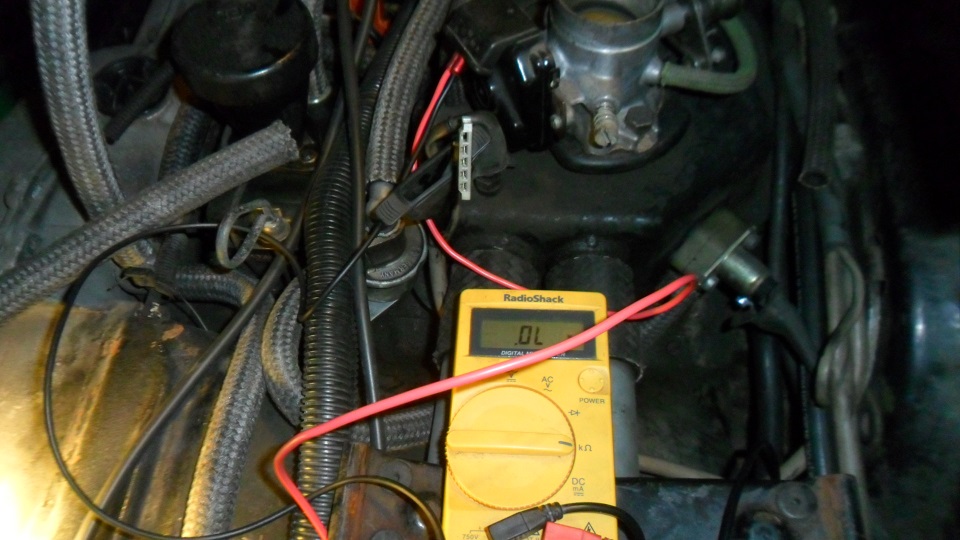

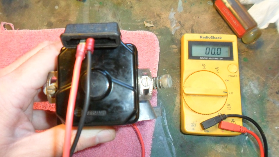

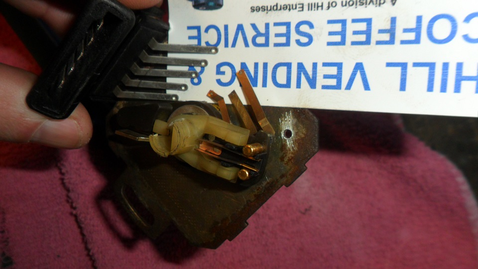

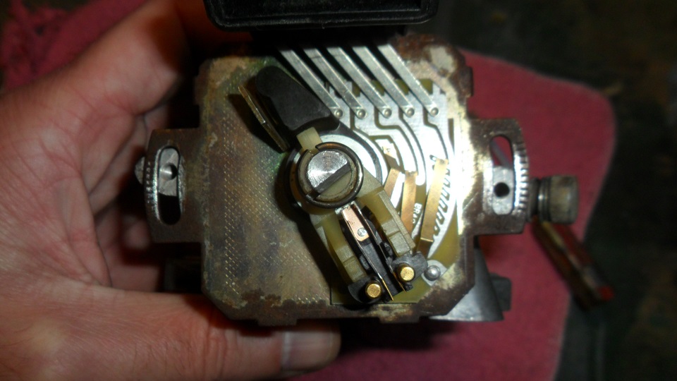

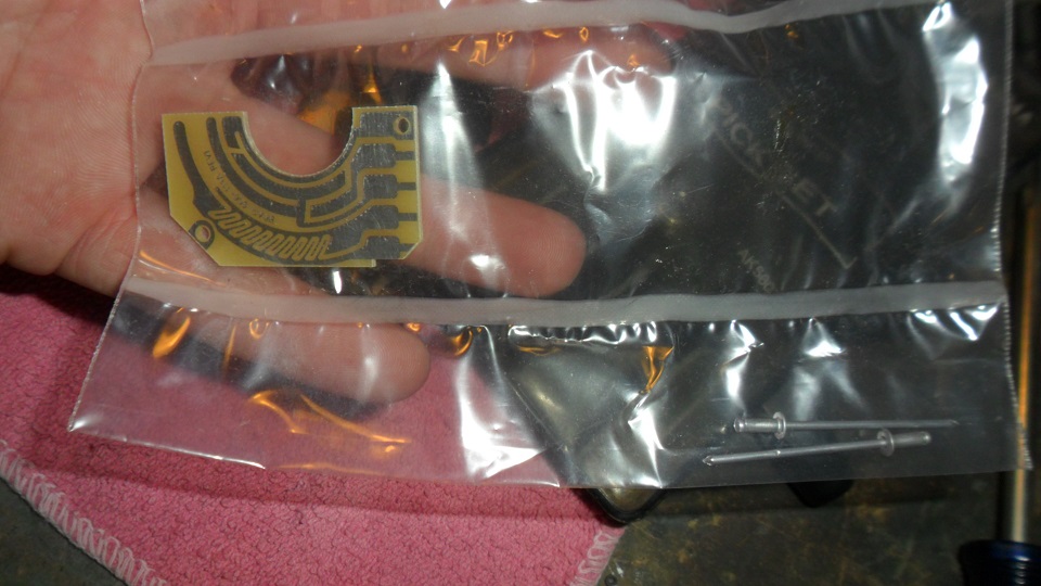

I bought a replacement TPS from Dave Sprinkle a few years back as part of a group buy. It solved my idle hunting problem immediately. The car now idles perfectly through the entire warm-up sequence. The instructions supplied with the board were excellent. I used the Pelican article to test the old TPS and calibrate the new one.

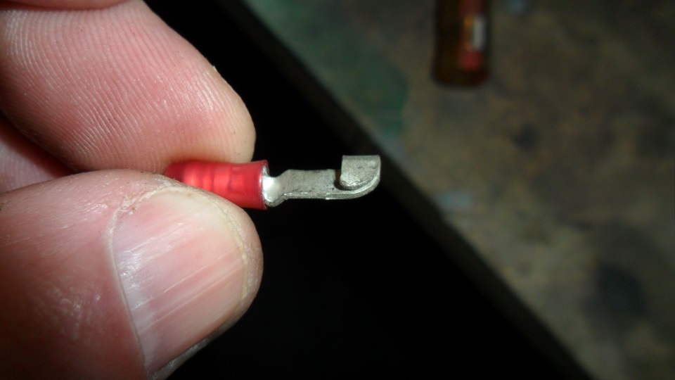

Trying to hold the VOM leads while rotating the TPS body proved to be difficult for me, so I used some solderless handshake connectors and wire to make it a little easier.
Unfortunately, I broke one of three plastic fingers off the TPS trying to remove the circlip. When I reinstalled the clip I didn't notice any problems just using two of the fingers so I rolled with it.

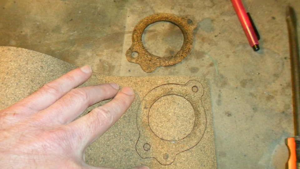

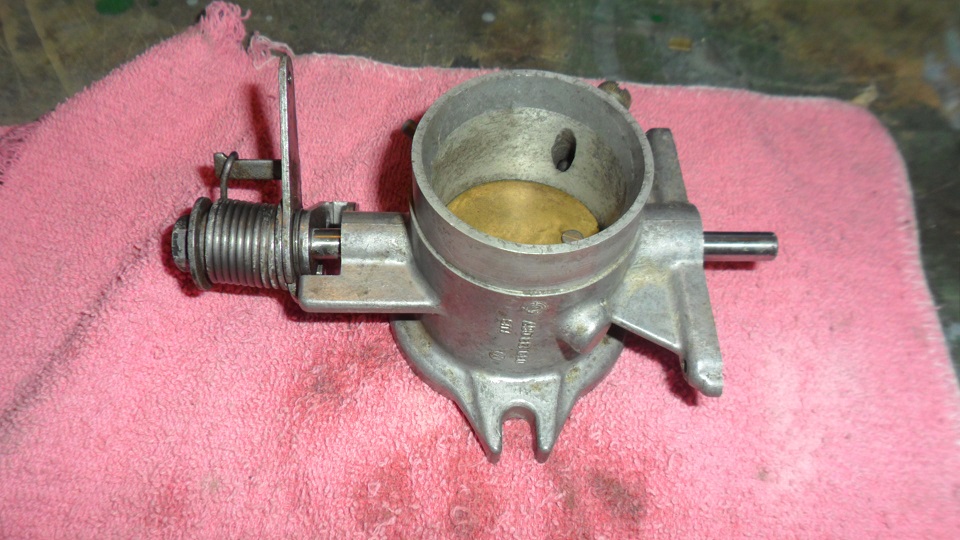

I messed up my old throttle body gasket & made a new one. Soaked the throttle body in carb cleaner while it was off:

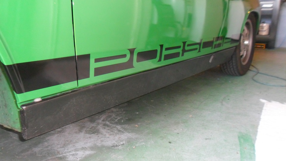

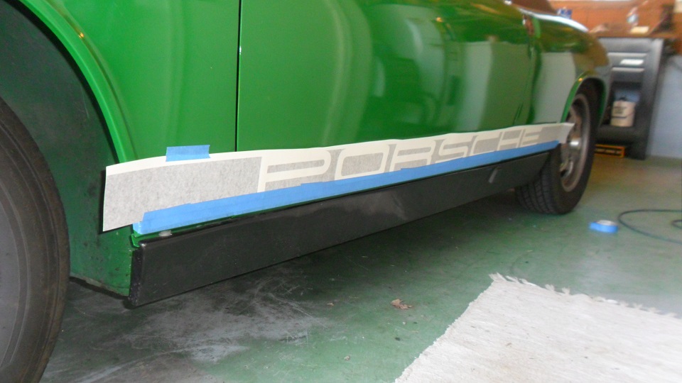

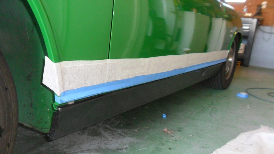

Bought a set of negative side stripes from Van. Nice decals with great instructions - thanks Van! beerchug.gif

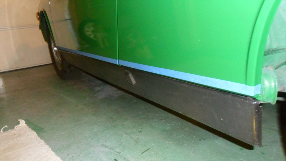

For prep, I sprayed and dried the lower part of the car with water twice, including the wrap-around areas, then followed up with two wipe downs of denatured alcohol.
Trimmed down the bottom of the decal to the edge of the vinyl.
Ran a strip of 3/4" masking tape across the bottom of the door for up-down placement then adjusted the fore-aft with a few pieces of tape on top of the decal. Evened up the excess on both ends.

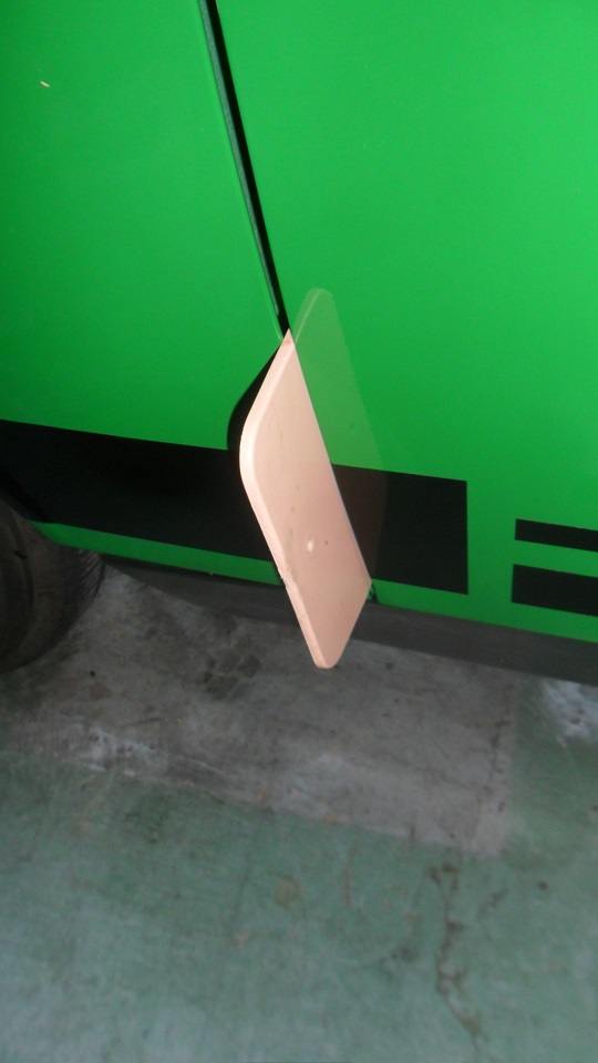

Per the instructions, I made a hinge with masking tape on the bottom. Sprayed everything down with 2 drops of dish liquid and 1 qt water, then applied the decal using a bondo spreader as a squeegee.

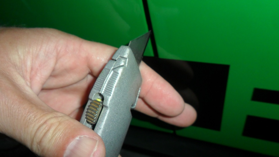

Ran a utility knife through the seams and worked the vinyl around the corners.
Turned out nice!

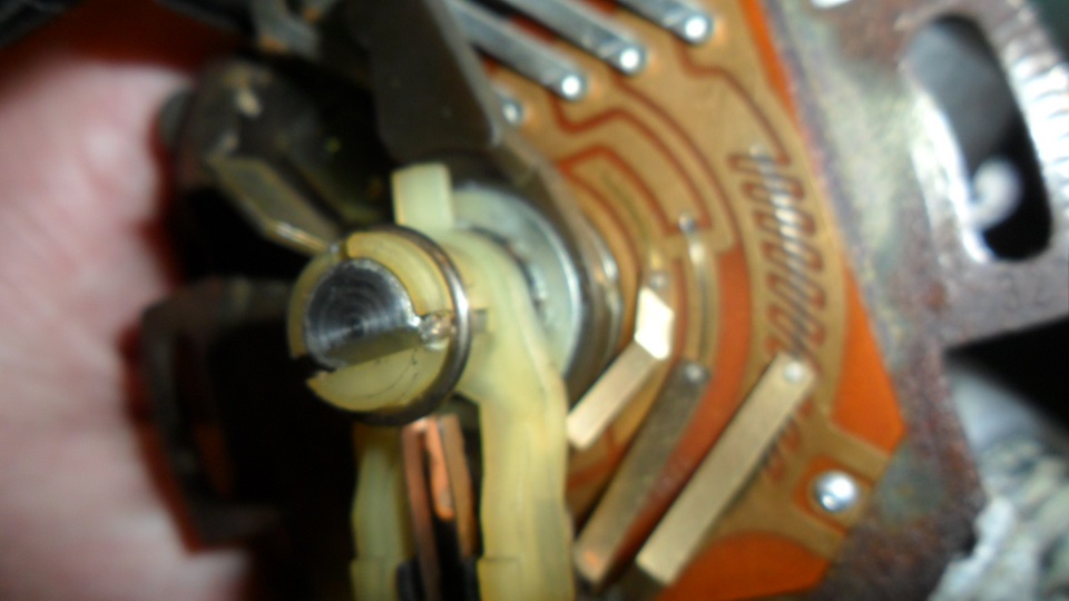

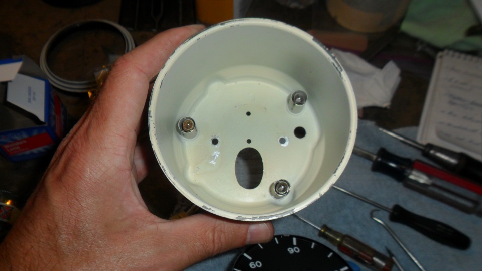

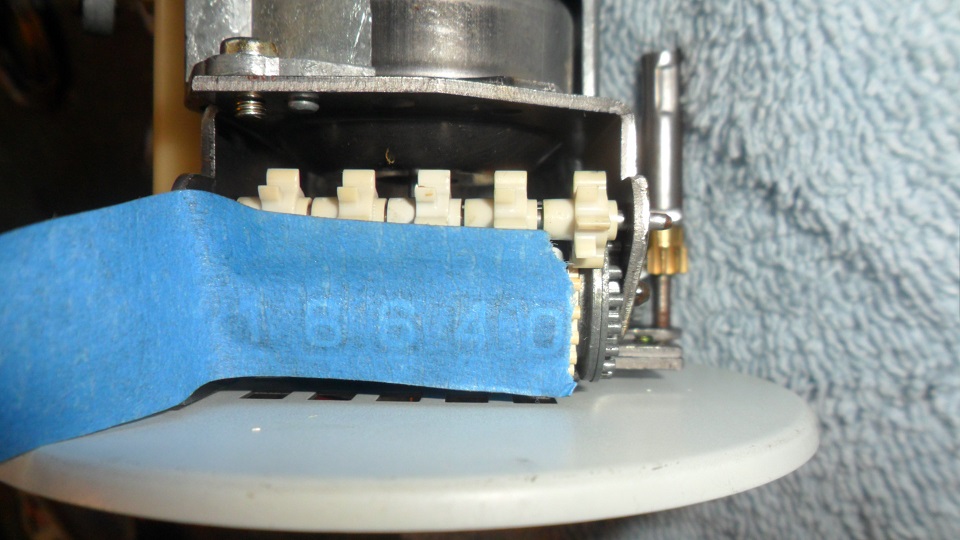

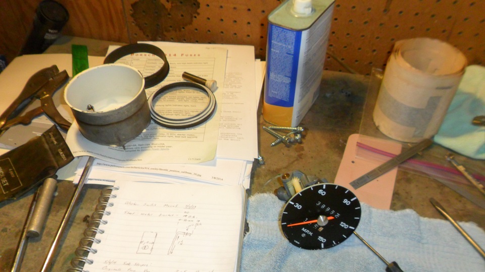

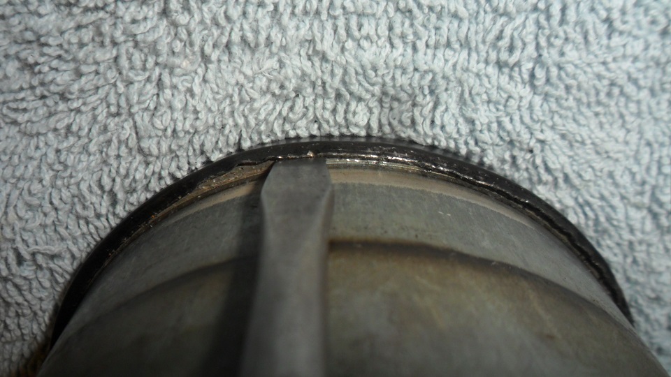

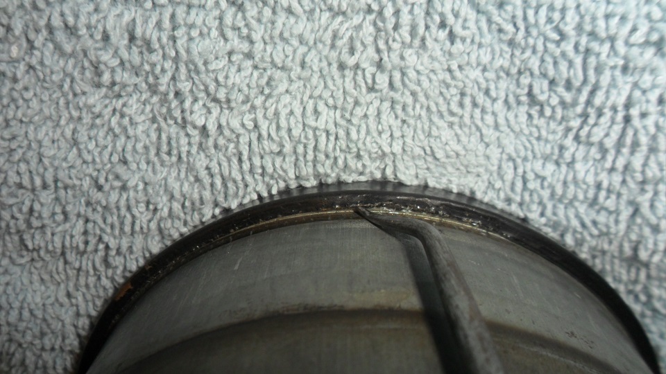

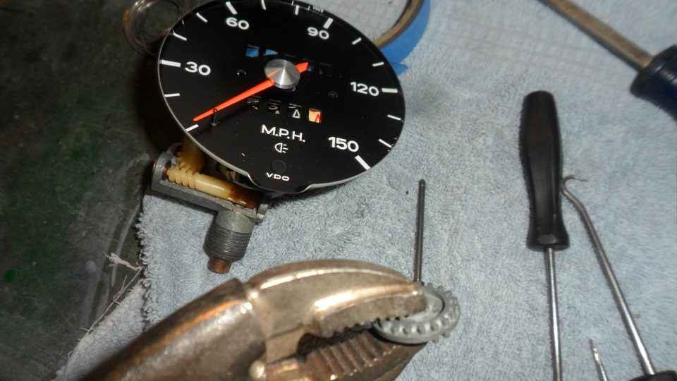

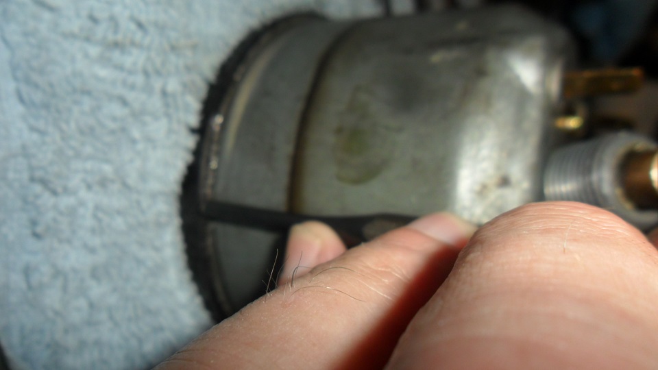

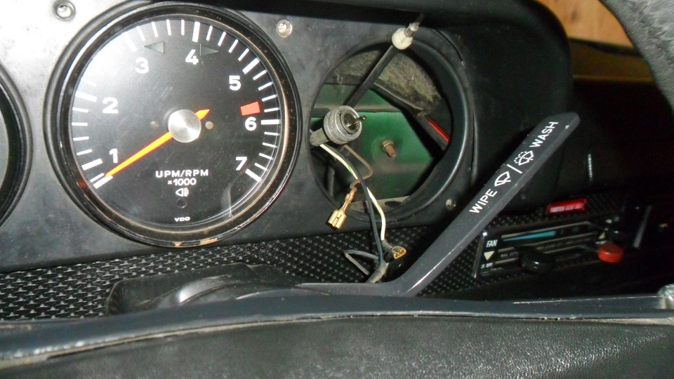

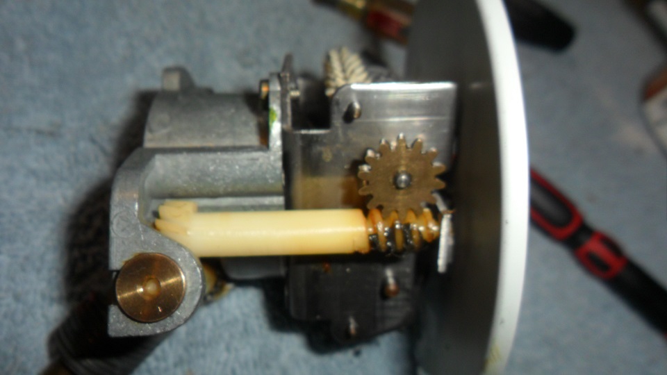

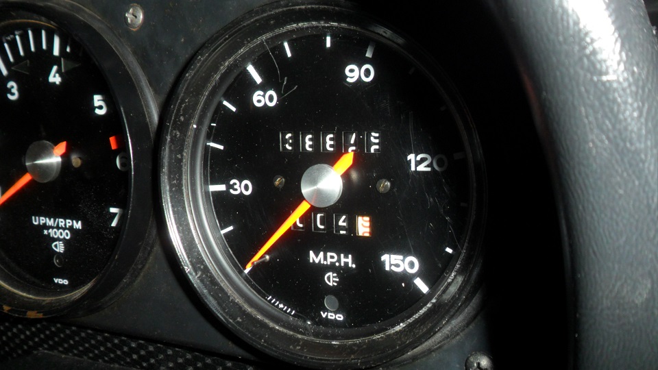

My first odometer repair failed last year. I tore back into it last week. Carefully pryed the ring off with a pick and screwdriver. I used the Pelican article as a guide. Taped the gears, removed the shaft and pinched the pot metal gear with vice grips. I wanted to add some Loctite, but I was nervous about getting it where didn't belong.
Something kept slipping in the odometer mechanism upon reassembly, causing the numbers to be half visible as the ODO rolled forward.
I ended up re-aligning all the gears. Took me multiple tries to get it right. What a PITA. evilgrin.gif
After having it apart twice, I got smart and tested it with a drill and a square bit before reinstalling the ring.
Lubed the gears with some new grease.

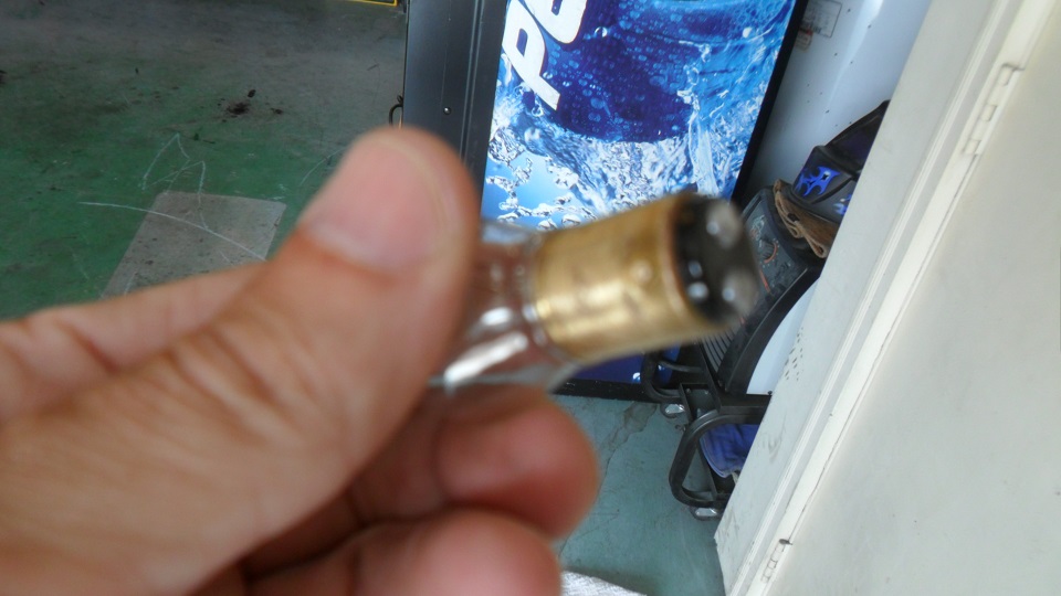

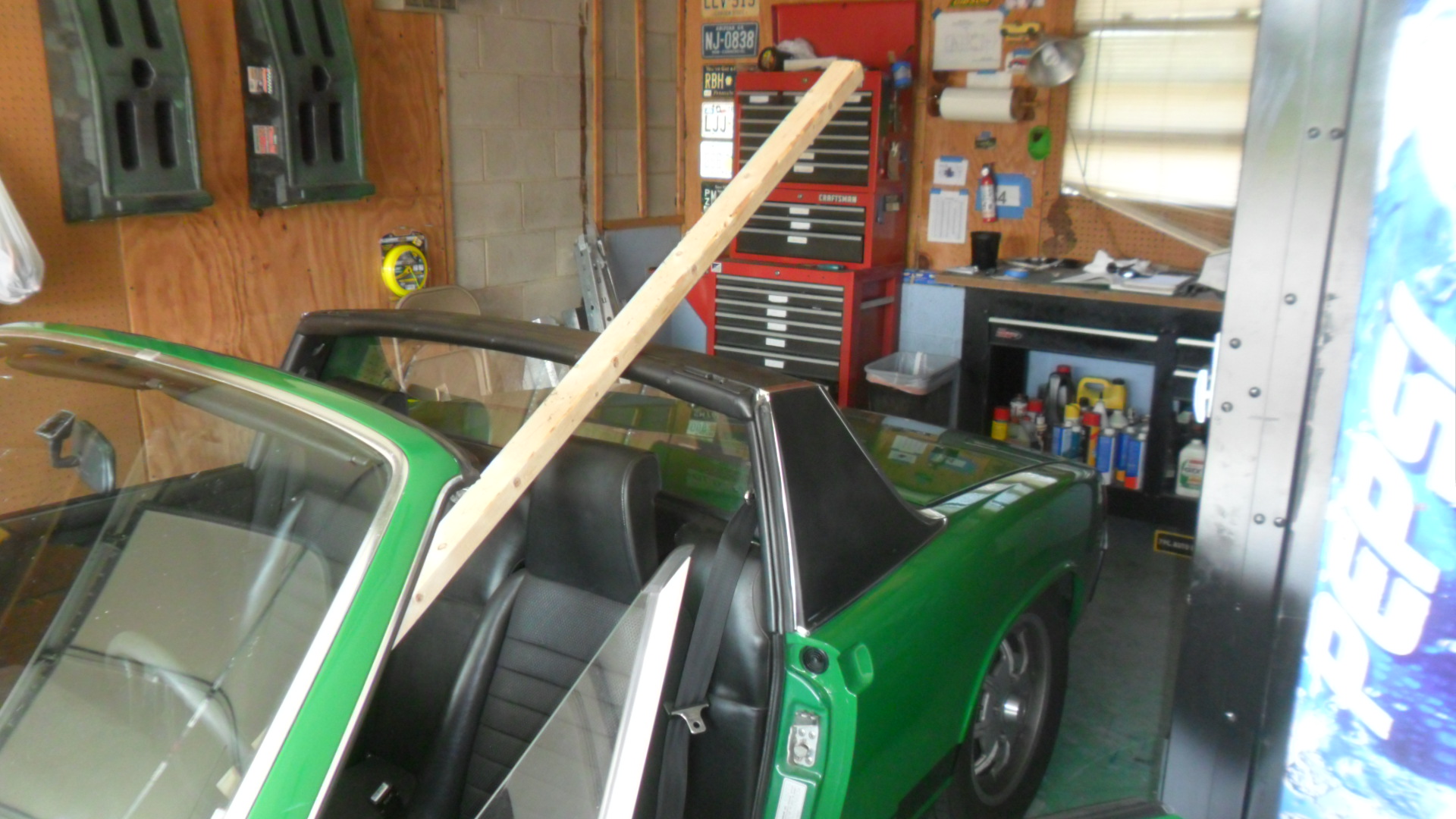

Passed state inspection, but I've had some intermittent problems with my right rear brake light. It just goes out on its own and stays out until I pull the bulb out and re-seat it. Cleaned everything up today with 220 grit sandpaper, bent the tabs tighter in the housing with a pick and reinstalled the bulb with dielectric grease. It was to bright to see the brake lights on the garage door, so I pulled into the garage and broke out the special tools.
I'm in the process of adding up the receipts and will post the whole truth so folks know what they are in for before closing this thread. Regardless of the total, it was all worth it. driving.gif
Porschef
The hemlock 2x3 is indeed, a very special tool...
