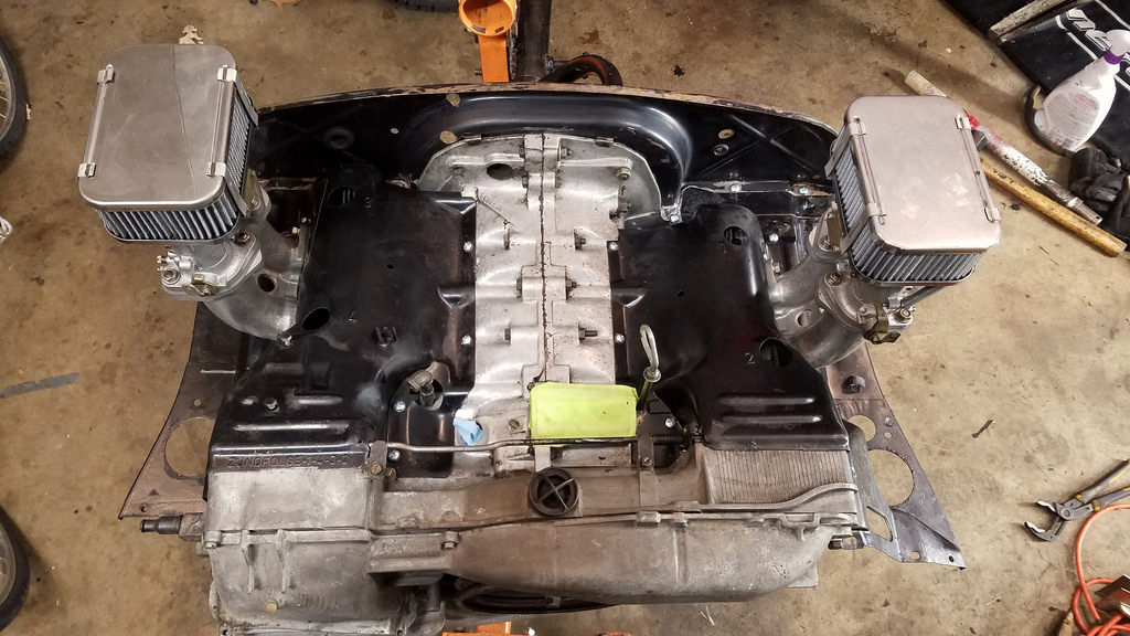

Finally got myself to pressure wash the tins the other day. Then hit them with a quick coat of paint.
Today I mounted most of them.
IPB Image

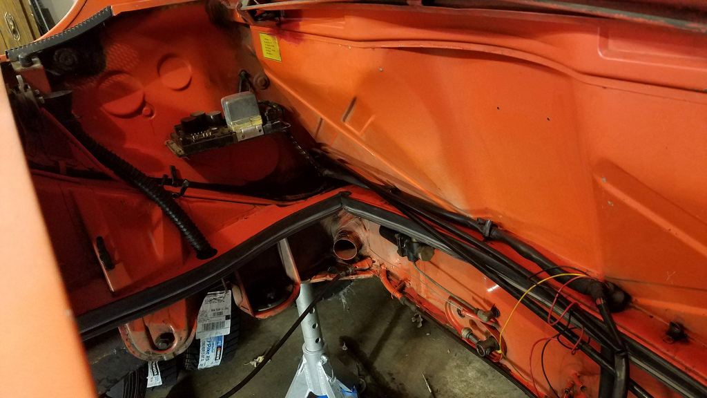

Then I spent most of the day cross legged in the engine bay with a bottle of purple degreaser, a small brush, and two rolls of shop towels.
IPB Image
After that I was able to install the new engine bay seals.
IPB Image
So much better.
Also ordered a new alternator, pretty soon the engine will be ready to go in!

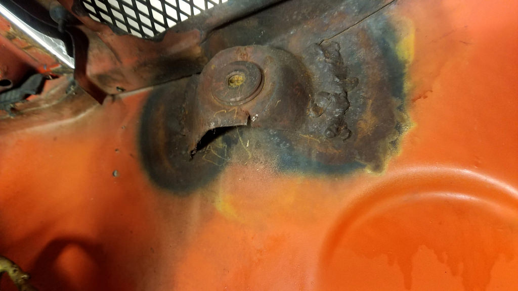

Also inspected the "repair" done by someone in the past.
IPB Image
Fortunately the other side broke it's welds off clean. This side will be ground off with a cutoff wheel. I have access to an endmill and lathe after hours at work, so I will probably design and build my own hinges in the spirit of the J West hinges.

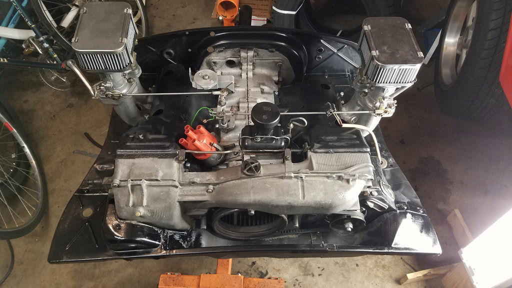

Getting closer. Oil tower installed, rest of the tins installed, alternator and belt installed. Throttle linkage installed but not entirely set up yet. I want to dig back through the archives and find a thread I saw at one point talking about this style linkage.
IPB Image
As much as I would love to purchase new linkage that's more accurate, with a baby on the way the time frame and cash flow for this project are greatly diminished.

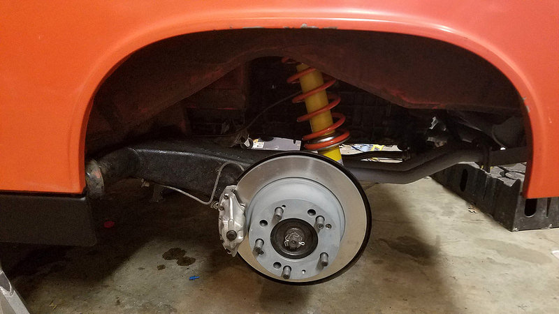

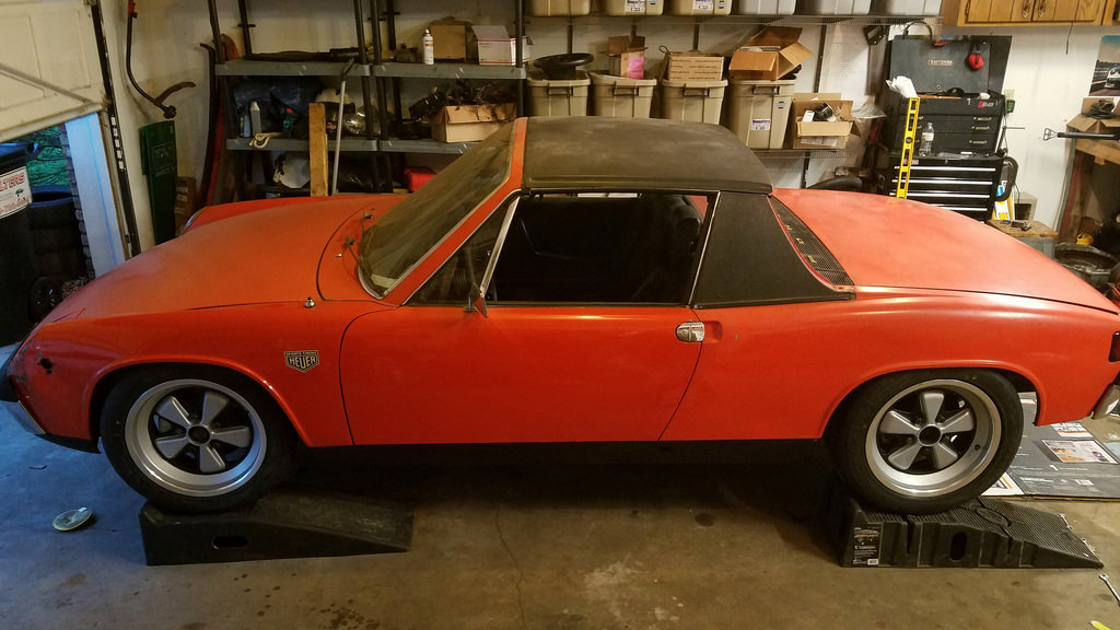

Another day in the garage, I built a positive pressure bleeder to keep the reservoir full and pressurized to about 3psi. I have speed-bleeders on all 4 corners so it was pretty simple to crack the bleeder, pump the pedal several times to move fluid through, then close the bleeder. Bled them in the correct order (RR, LR, RF, LF) and adjusted the rear brake pad clearance before and after. Got all corners bled and ran out of fluid, I'll let it rest and then bleed the whole set again once I pick up some more fluid.
I didn't have a chance to fully rebuild the axles, it'll need to wait until later. I absolutely needed to get the car on the ground and moved over today, so that meant not hooking up all the cables just yet and just getting the axles in. In my VW days I know that if you rolled a MK1/2/3 VW Rabbit/Golf/Jetta without the axles in place, you'd ruin the bearings. Not sure if that's the case with the 914's, but better safe than sorry.
Once the brakes were done and the axles in, it was time to mount the wheels again and lower the car. It's been a mystery exactly what the "stance" would look like so I was very excited to see what I had. I knew that I would probably want to space the fronts out a bit, and that the rears would be close to the fender even after I rolled the lip.
IPB Image
Happy to report that the rears are about perfect. On full compression they tuck inside with almost a centimeter of room. The fronts DO need to be spaced out, I'll start with 20mm and go from there.

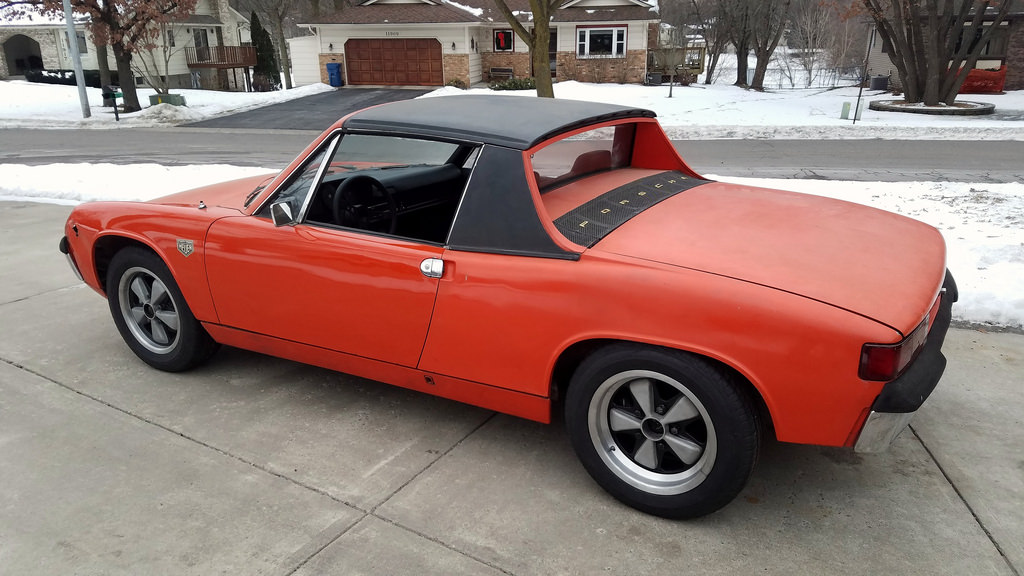

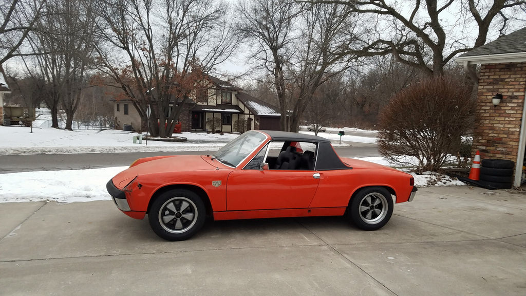

I rolled it outside in the daylight.
IPB Image
Never before has the orange rocker covers and front lower panel looked so odd. Can't wait until it's warmer and I can paint those...
IPB Image
So now that the car is on the ground and my wife can park inside again I'll be hitting small things here and there on the weekends, the goal is still February for running/driving.

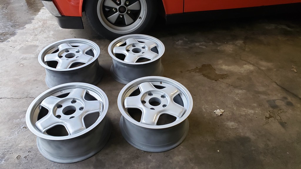

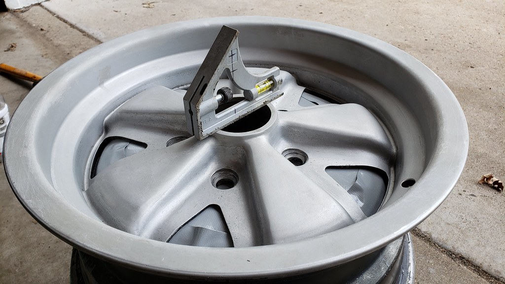

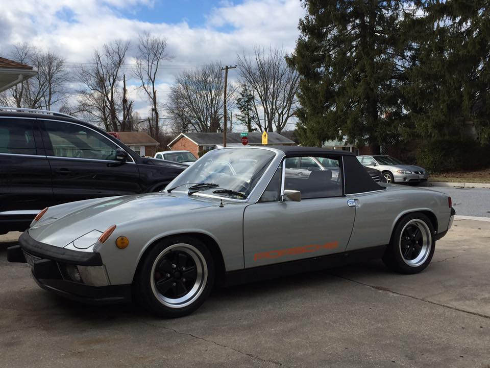

I decided to put the Compomotive Fuchs up for sale with the tires and get something else. After a bunch of forum reading I settled on Euromeister Fuchs in 16x7 all around. These will get the same RSR treatment as the previous wheels, or something close.
IPB Image
Here's someone elses car with the same wheels/size/offset. Stole it from Facebook. If this is you, sorry, and thanks. smile.gif
IPB Image

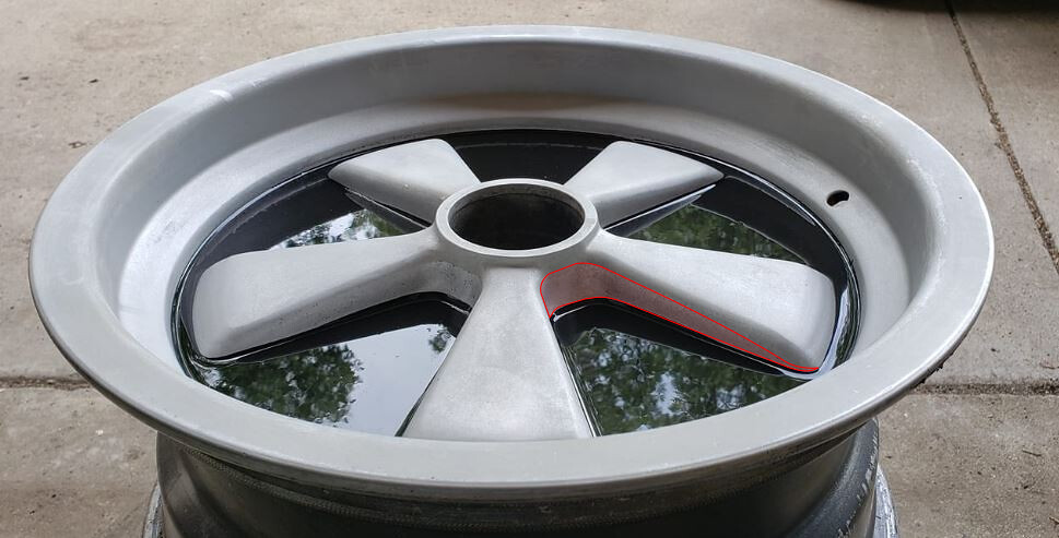

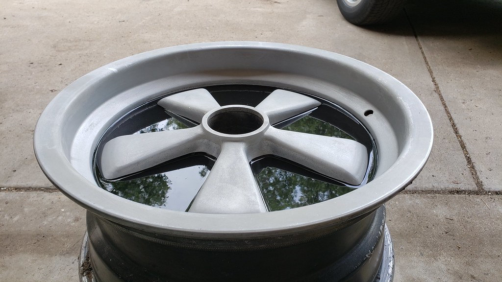

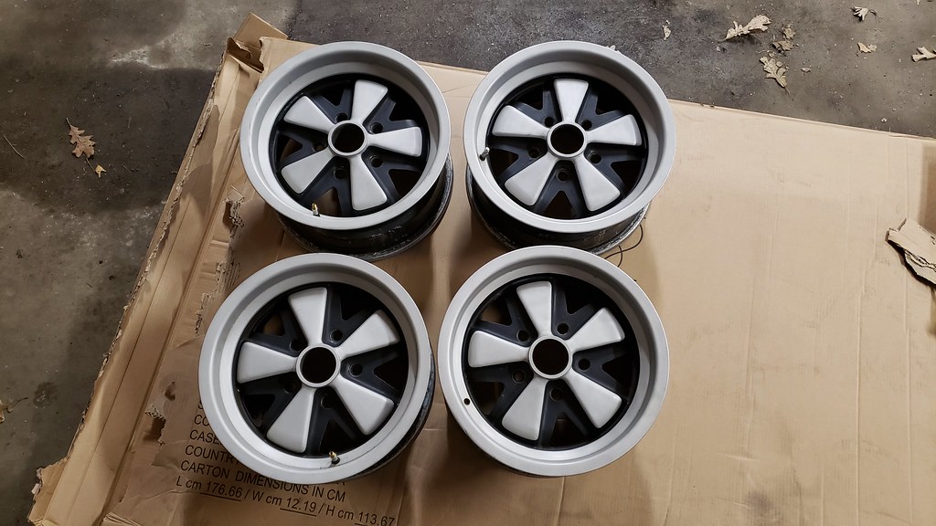

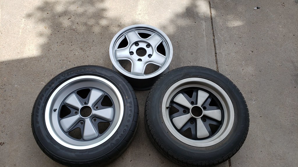

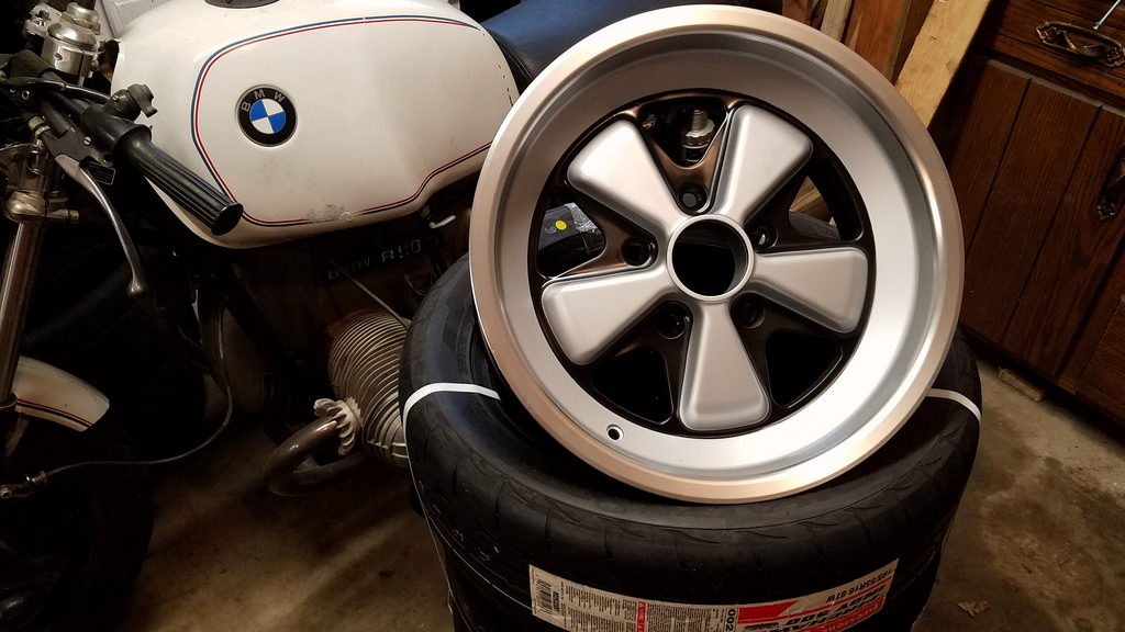

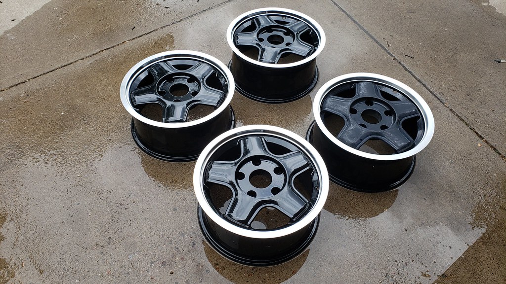

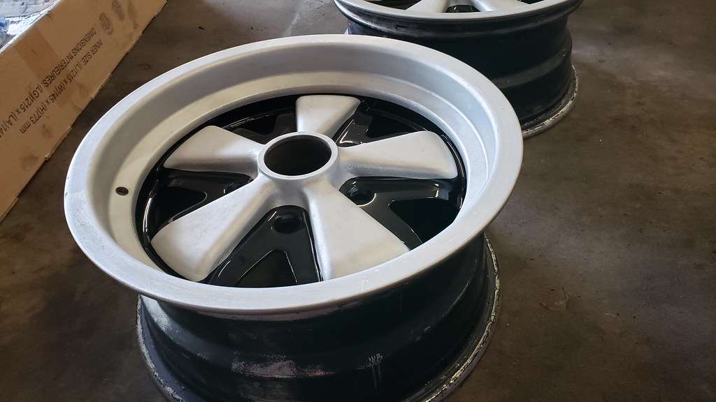

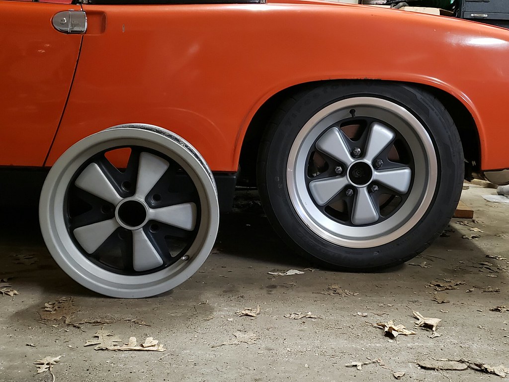

Started refinishing the Euromeisters. Did a faux RSR because I didn't want to get them anodized. Lip is the stock machined/polished, inner width of the lip and the pedals are dull aluminum, and background is flat black. Pic was taken when they were still a bit wet so it looks glossy.
IPB Image
Loving how the first one came out.
Tires are Firestone Firehawk Indy-500 in 195/55-R16 because I wanted easy fitment.

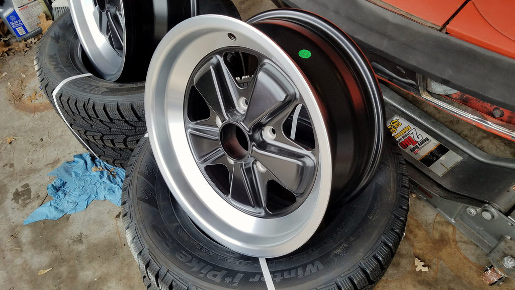

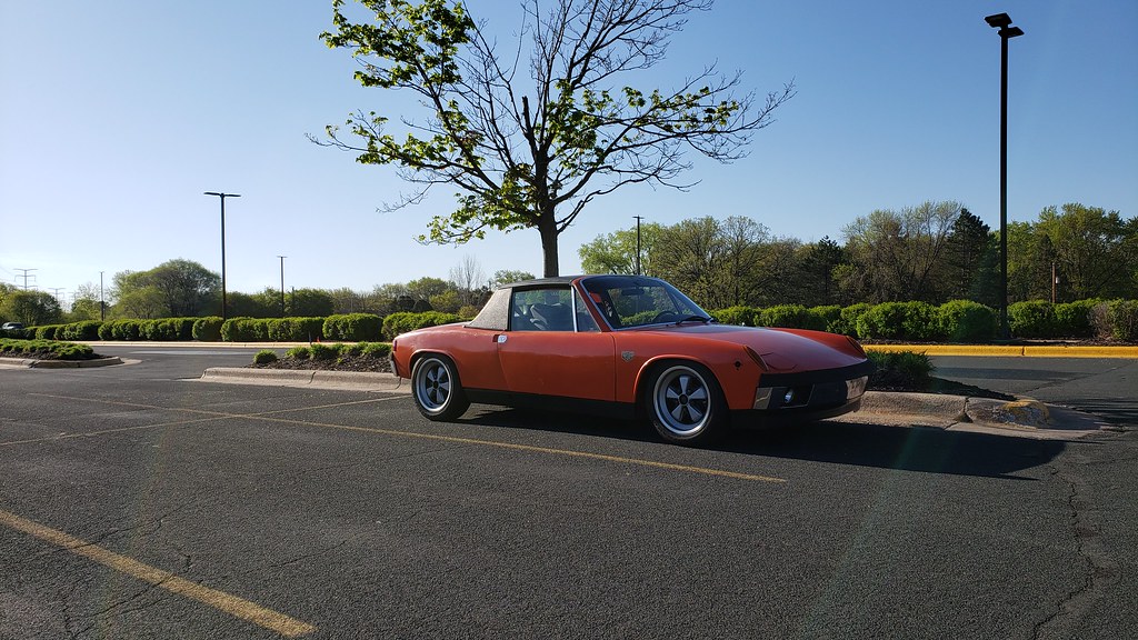

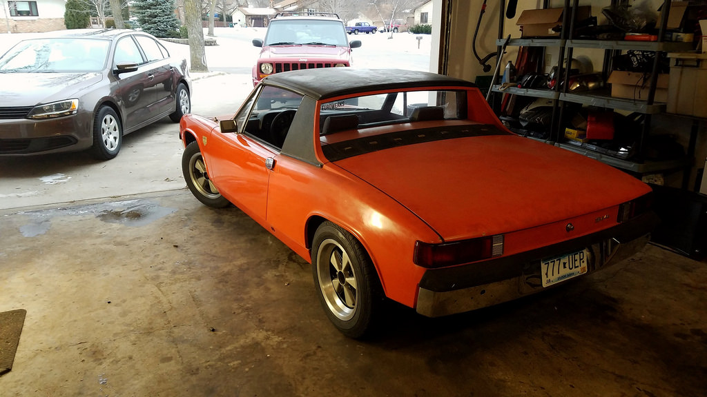

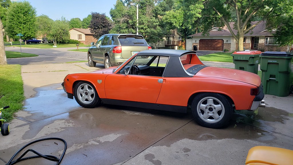

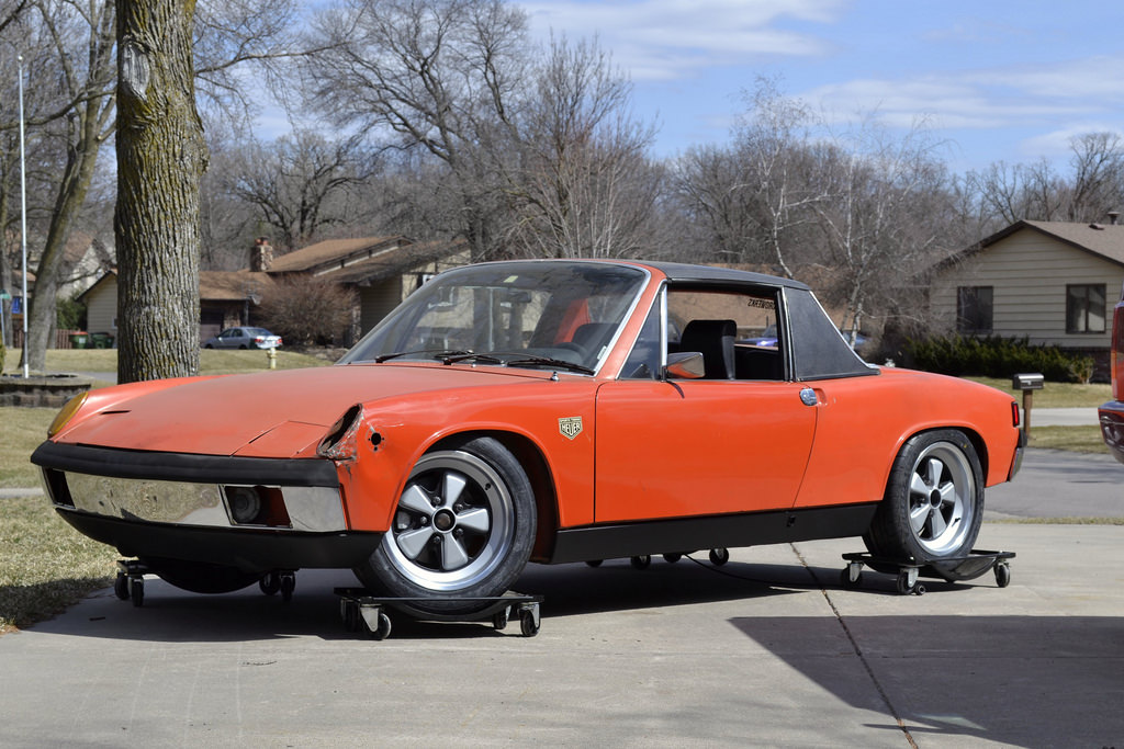

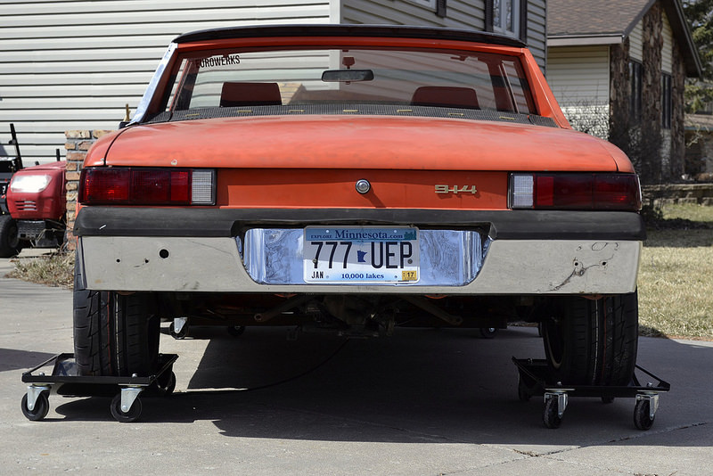

Couple more pics of the project. I finally had enough of the orange rocker covers. The bodywork/paint part of the project will be a few years down the line probably, and I wasn't about to wait that long to fix the rockers, so I just sprayed them quick.
Also mounted the wheels and rolled it out into the sunlight.
IPB Image
IPB Image
I want to drive this so bad. I might get a whole Saturday next week that I can tackle some more on it. Every time I put a list together of everything I still have to do the lsit gets longer and longer.

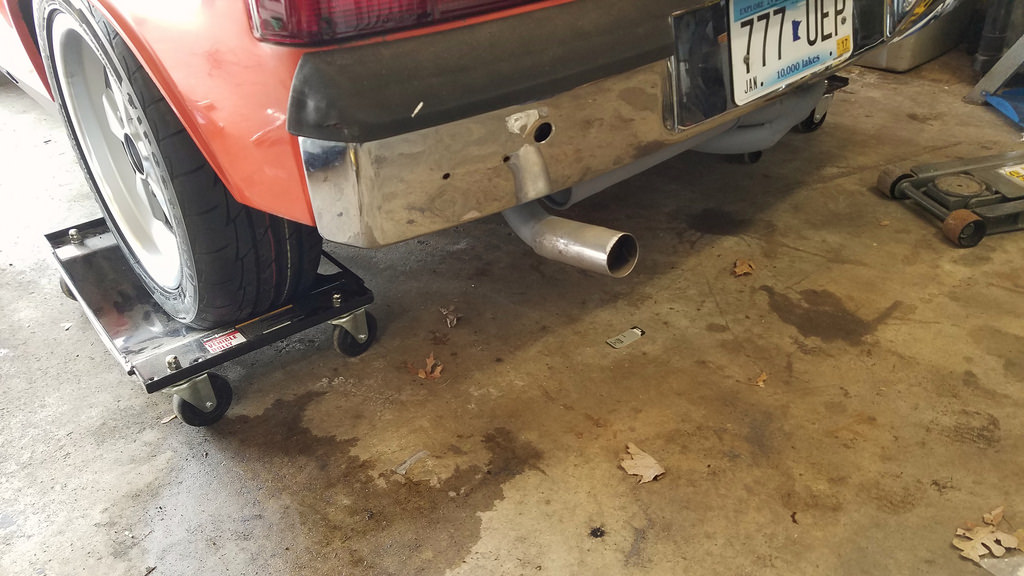

-installed the headers and then the rear section of the exhaust
IPB Image
Exhaust doesn't look like much, but I like that about it.

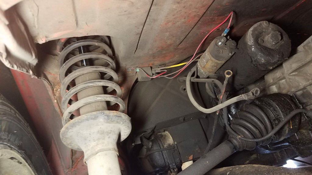

The previous owner had this relay setup for the starter, kinda hacked in there. This pic is pre-teardown.
IPB Image
I'll be doing a hot start relay as well, but not like this. I'll be following Mark Henry's guide on this.

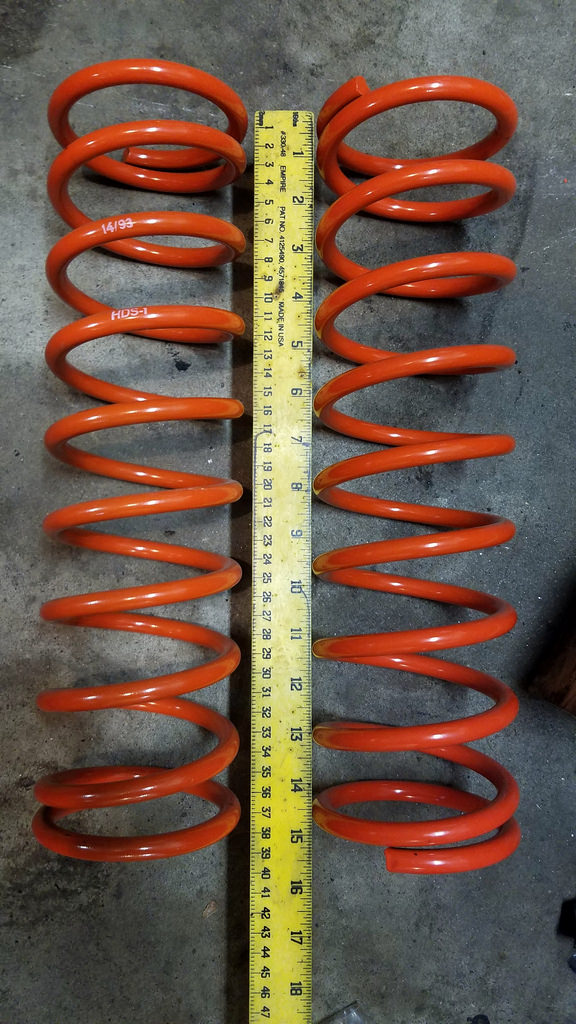

These rear springs came with the car, couldn't find much info on them.
IPB Image
Marked "HDS-1" and "14/93" <~~(I assume this is a spring rate marking, but no idea how this translates)
Did a bit of search but couldn't find out what the spring rate is, anyone here able to enlighten me?
Spring dimensions:
-15" long
-4.125" outside spring diameter
-.425 wire diameter
Using a spring rate calculator, I get approx 115 lb/in which I believe is very slightly higher than stock.

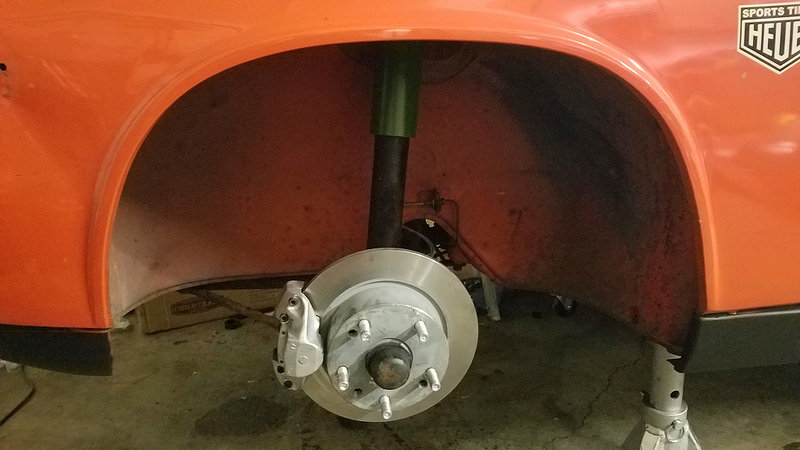

On Saturday I got out and tinkered with it a bit more. Primed the engine, tested the lights and ignition, everything works. Tested the fuel pump and that works too. Swapped the new rear brake rotors on.

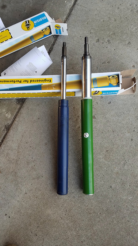

Then last night I got out again. Got the front shocks in
Here are the fronts, old vs new. New ones are larger but they're also lighter. All the valving is in the upper section so it reduces unsprung weight even more.
IPB Image
Front's installed with new balljoints
IPB Image
rears I did a few days ago
IPB Image
Everything is back together but the car is up in the air with the wheels off. I had to disconnect the brake calipers up front. I was planning on bleeding them again anyway but this cements it in. Might try to sneak home early to do that today.
Also, rookie mistake... I knew the drivers outer tie rod was bad but the passenger side was solid still, I had ordered just the one side. As I got it all apart it became evident that the passenger side wasn't far behind, torn boot that was hidden. I put it all back together anyway and I'll order a new passenger side today.

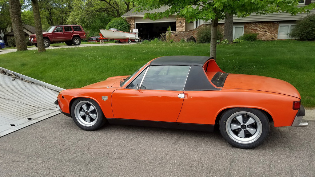

Heard back from Tristan same day. So far it's looking really good. The base settings for the carb and ignition timing were plenty to get it running if you applied a bit of throttle. He did some tuning and it's pretty smooth but will be replacing the idle jets, moving from 50 to 55. He had to order the 55's which will be here Thursday. He had 60's that he tried but that went too far the other way. The carbs synced up really well, he had a couple minor suggestions regarding the carb linkage, mainly replacing the ball ends because of a tiny bit of slop, likewise with the central pivot.
I hadn't gotten a chance to install the clutch cable. I had a new one but wasn't sure if I needed it or not. They will be installing and adjusting that this week as well.
He noted a slight leak on the tail shifter. To be honest I hadn't really touched the transmission, never quite knew if I would be going to a side shifter or not so I didn't want to waste any time on it. Now that it's running I will probably revisit that, I did replace every bushing in the linkage and the metal to metal area at the rear has minimal wear, so for now I'll stick with it and address the leak.
I did a home alignment using the string method and accurate measuring to within 1/32" It should be plenty to be able to drive it and not destroy my tires, but I will be getting a professional alignment to make sure it's good.
So it's looking like next weekend I'll be ripping around in this thing!

IPB Image
I did the side-shift trans swap last season thanks to Jule. Shifts great now, all things considered. Also did a L.E. airdam up front, and had a period with the car where I had roundels/meatballs/number circles on the sides and then pulled them off a short time later.
New muffler from Ben is on and it sounds great. I'll be getting some good audio/video but it's going to wait until after I can fix this rattle coming from the front end. Sounds like it may be the alternator, but another option I haven't checked yet is an exhaust leak.

I stumbled upon a set of Revolutions on here. These are a style of wheel I've loved, going back to my VW days. Pretty good price and they were NOS, so I bought them.
IPB Image
I was not, however, fond of the black centers. So I had them blasted and I painted them silver.
IPB Image
Shot comparing the Revolutions, the 15" rep Fuchs, and the 16" rep Fuchs
IPB Image
Anyway, I installed the revolutions, rolled it out into the driveway.
IPB Image

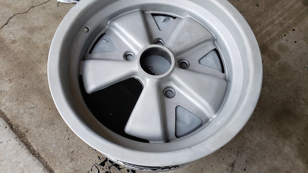

Immediately decided I didn't like them and started refinishing the 15" Fuchs right then and there. I already had the paint stripper and supplies etc.
So, I stripped the old paint off of the 15" Fuchs. Taped up the holes, leveled them out.
IPB Image
I used the bucket method this time instead of masking.
IPB Image
after filling all 5 areas and connecting the shallow strips.
IPB Image
This is a shot showing the areas (red border) that were painted previously. That was the thing that threw me with them, the mask line wasn't right.
IPB Image
Once they were all done, I think the mask line is better, but now maybe a little low.
IPB Image
I think I'll re-do them again, maybe in the spring.
IPB Image

I swapped the factory steering wheel back on, I like the diameter more than the smaller 3-spoke I had. Both in terms of driving control and also gauge visibility. I re-wrapped my wheel in leather, and got a hockey puck horn button.
IPB Image

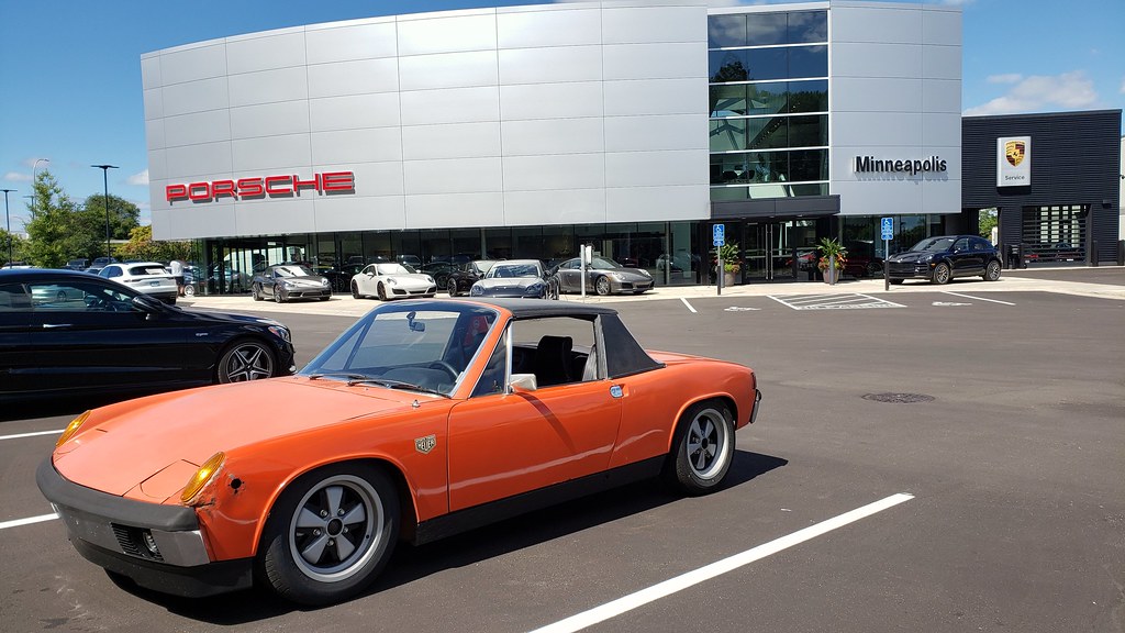

I ordered a seat on August 1st. I was hoping to have it by the drive (early October) but didn't actually end up getting it until the end of October. I had originally gotten a quote through GTSClassics and the price was just way too high. Then I saw that Pelican offered the seat at a lower price so I ordered through them. It turns out that Stephan/Pelican just hadn't updated their catalog. It was listed as including the headrest and free shipping, items that would normally add a couple hundred to the bill IIRC.
I received the seat sans headrest. Initially a bit perturbed I contacted Pelican about the missing headrest (with no clear way to mount a headrest either) and they contacted Stephan. Found that indeed their listing should not have said that the headrest was included, but he is sending me a headrest with grommets anyway because of the mixup. So it was a positive outcome with two companies, both Pelican and GTSClassics.
IPB Image
