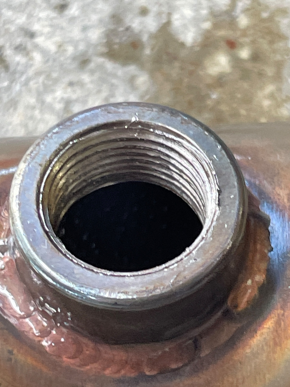

O2 sensor bung not have anti seize on it?

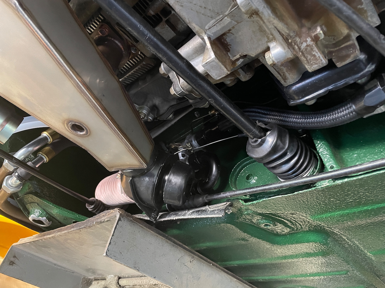

50mm is 2” give or take for the heat hose. Again look up scat or skeet tubing and you will find tons of options
Tom1394racing
I bought my 50 mm heater hose here:
https://www2.cip1.com/vwc-028-129-087-agr/

@MB911 Hi Ben - Not sure about the anti-seize, it was installed by AASE Motors. But, looking at the plug, it does not look like it. beerchug.gif
technicalninja
They actually make Hi temp anti sieze for exhaust stuff.
Powdered nickel instead of aluminum.
https://www.amazon.com/Permatex-77124-Nicke...urce=1&th=1

This is what I would suggest https://www.pegasusautoracing.com/productse...sp?Product=3630

OK, we removed the driver's heat exchanger and used a tap to clean the threads of the o2 bung. Reinstalled the heat exchanger and then installed the o2 sensor and connected that up.
