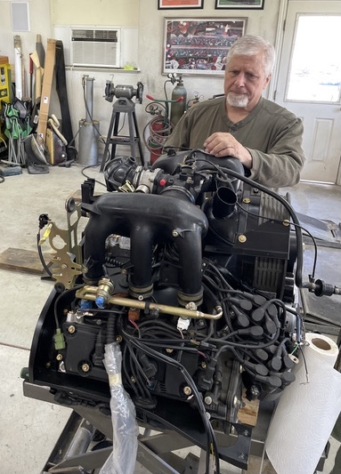

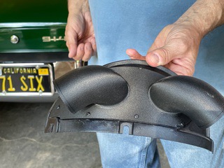

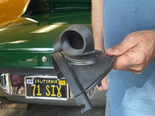

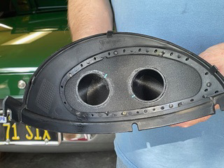

We began yesterday by admiring the absolutely beautiful Mickey Mouse ears a good friend of Greg's 3D printed for my car. A special thanks to Steve Silva for hating the PMS ears enough to ask his good friend if he could do this. Just amazing finished product and made out of the good stuff so they will not deform or melt. We started the engine and I was amazed at how much air pressure comes out of those 2 pipes even with the engine running poorly. No wonder the heat exchangers pump out such great heat. Hooked up the hoses and called that done.
Here is a pictures of the as-shipped PMS Mickey Mouse ears on the engine. You can just see the two pipes sticking up, almost straight up. That was not going to work for the way we wanted this build to look.
Here is how the beautiful 3D ears look:

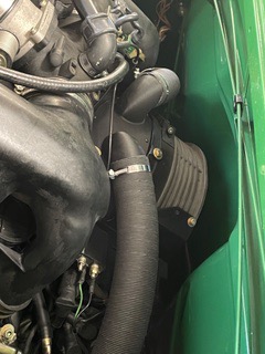

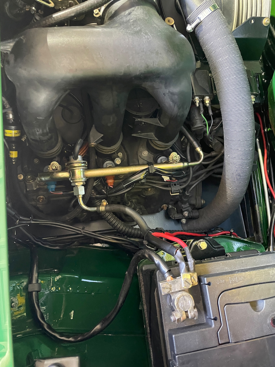

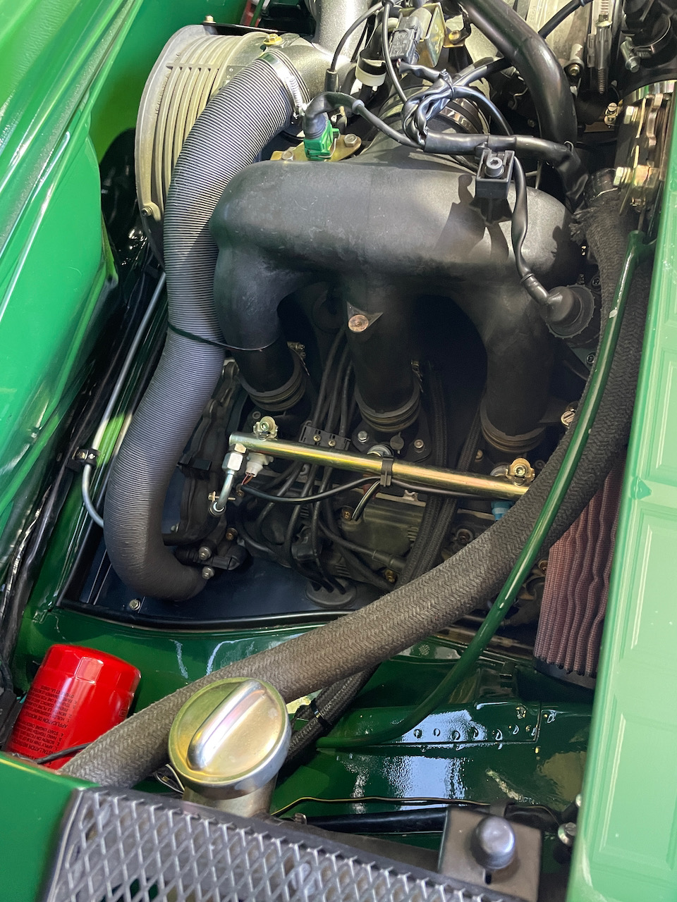

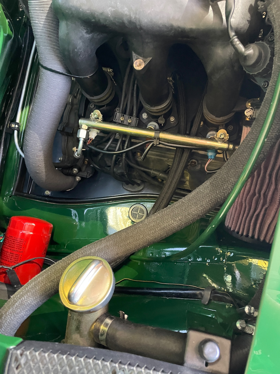

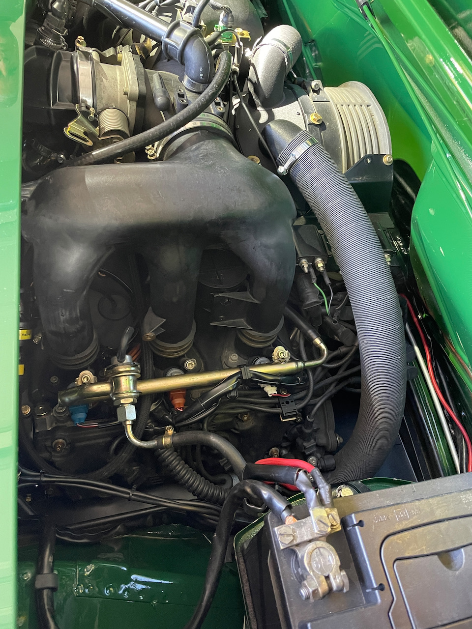

Thanks Eric; Totally agree re the feel of the 3.6. Here are a couple photos of how the engine bay turned out. Given all of the stuff on these engines, I think we did a pretty good job of making it look as uncluttered as possible.
A big thanks to Greg and Steve's good friend, Cayley for making those absolutely beautiful "Mickey Mouse" ears.
Also to Clewett Engineering for their terrific serpentine belt kit- I think that is a must-do upgrade for a 6 in a 914.

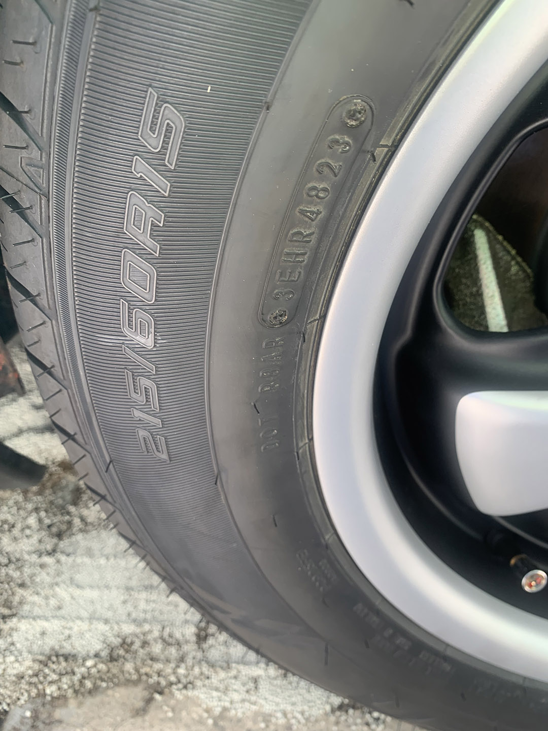

On my list is to borrow an unrestored deep 6 rim and mount a 205 x 65 x 15 tire and move it around the car to see if it will clear. Once I figure out which tire I want and if it fits, I will get a set for my wheels. Right now I am running 195 x 65 x 15. beerchug.gif

QUOTE(Cairo94507 @ Aug 6 2024, 01:10 PM) *
I'd be interested to know Michael if a 195 on the front feels noticeably less heavy on steering than a 205 or not ? I'm running 205 65 15 on the front and 225s on the rear with a 3.2 engine set up.
Also I've never driven any other 914s but mine doesn't really like road bumps and the suspension does seem to crash/bang a bit if theres the slightest pot hole (which is a problem on our rubbish UK roads!). I've never known if that's just how these cars are? It's had renewed dampers with a 16mm anti roll bar and had usual suspension set up.

The 195x65x15 are not heavy at all when turning; very easy to steer. beerchug.gif
ClayPerrine
We have 195/65-15s on Elwood (the original six). It steers nicely with no heaviness in the steering, unless you are not moving.
With that and the pea gravel driveway, getting out of the garage is a workout for all our 914s.

For me 24 psi front 28 psi rear.
205 x 65 x 15 f
225 x 65 x 15 r

For you guys: Info on Marks Blue Car with the Bob / Mark rebuild finished my PMB Performance
Stock body 74 car. The wheels are copies of Deep 6 front and 7rs rear. Copy of Deep 7s with extra 1 in going to the inside.
215-15R rear 1/2” spacer on the 7r wheel. Fender roll provides 1/2” clearance. 205-15r front on 6 wheel with 1/4” spacer.
At the time Eric said this was the 1st time they actually installed this set up. Was just theoretical previous. He will use this configuration going forward on non flared builds
Mark says no scraping at all.

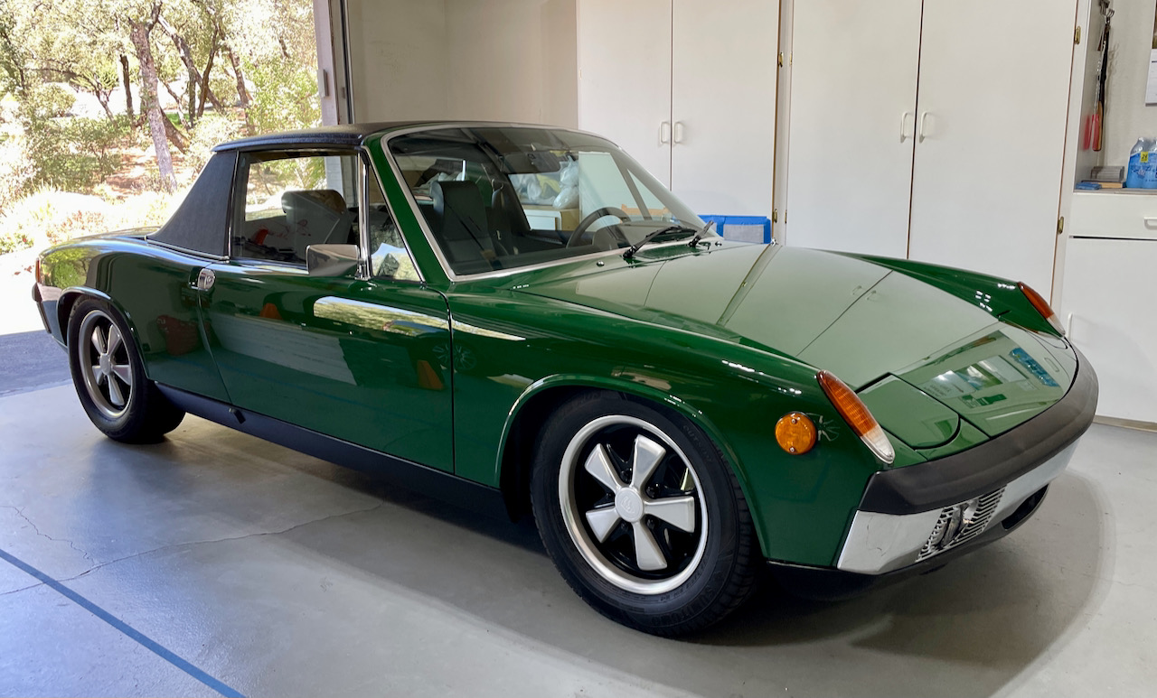

Cairo94507

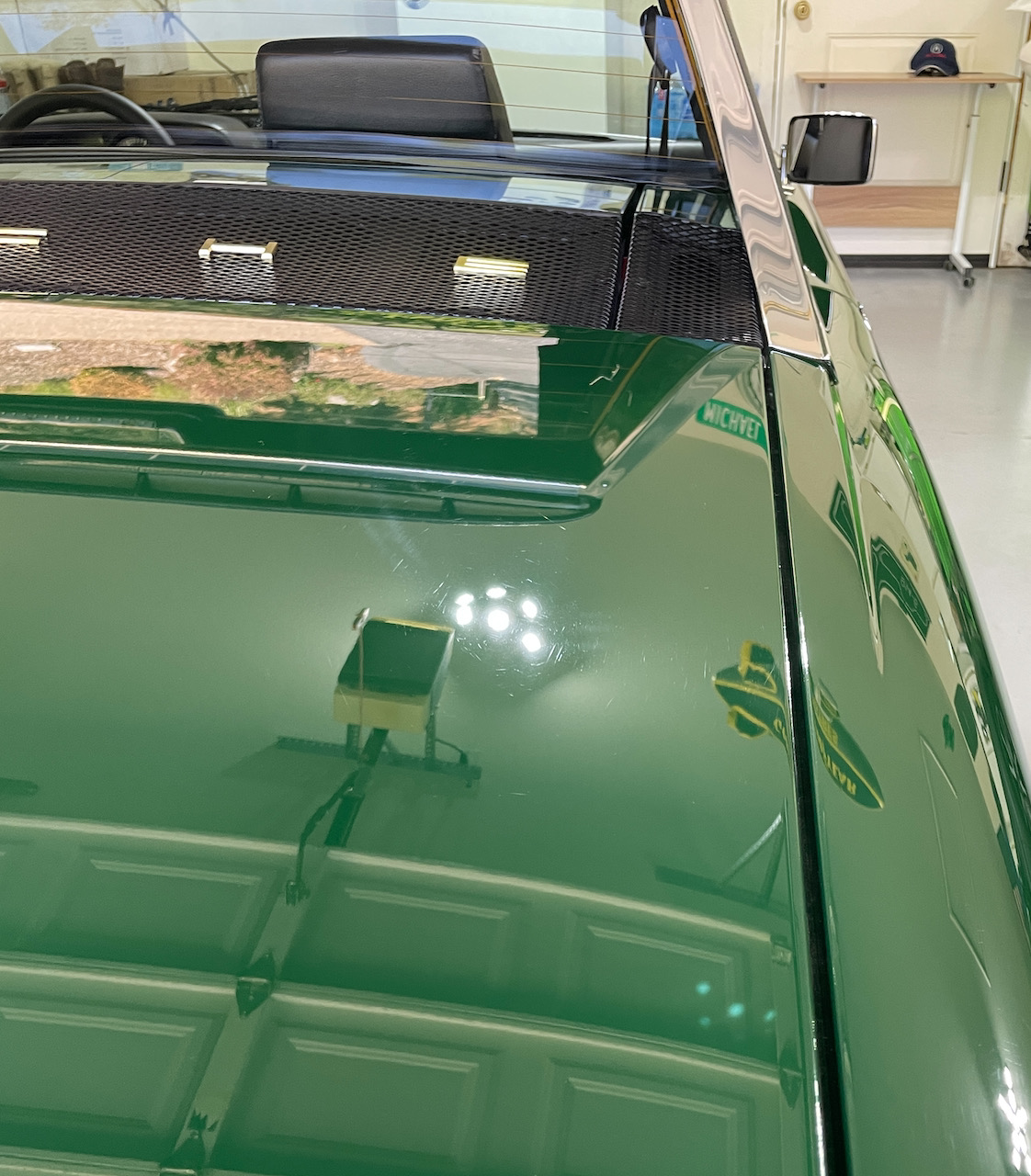

My car was apart from February 16th to August 4th. In that almost 6 months of being crawled over and worked on we had only 1 very minor mishap. We ended up with a small, soft dent, maybe the size of a dime, on the trunk lid, maybe 6" back of the engine lid on the passenger side. Fortunately, no paint damage. I have been around enough shops and cars getting worked on to know stuff happens.
I called a shop recommended by Porsche of Rocklin- Bullseye Paintless Dent Removal, (Bullseyedent.com) located in Roseville. When I called last week and spoke with the owner, Keith, I told him I had an original 914-6. He said those are rare and he has not seen one in years. He said he would be there when I brought my car in.
This morning I met Keith and his employee Shawn. Their shop is exactly what you want to see when you roll in their door. Immaculate and stocked with everything they could ever need to work on your car. Two very nice guys indeed.
Keith actually worked on my car. First he used his paint gauge to measure the material on my car to identify any possible issues; (bondo) none were apparent. He took his time, about 1 hour, as he slowly and methodically worked the soft dent out. I have watched PDR guys work on my cars before but I have to admit this was a nail-biting experience. Fortunately, any anxiety I had was not merited. Keith did a great job and that small, soft dent is now history. I highly recommend Bullseye Paintless Dent Removal.
I am taking my car to Mels Original Diner in Auburn for a car show this Saturday, 8/17. Now that the dent is gone, I will feel much better about showing it. Yeah, Mels is mostly a hot rod kind of show, think American Graffiti, but I kind of feel like my car has a toe in the hot rod pond. I love muscle cars so my brother and I are looking forward to a fun day. If you are in the area, feel free to stop by and say hello. I am pretty sure I will have the only 914 in the show.
