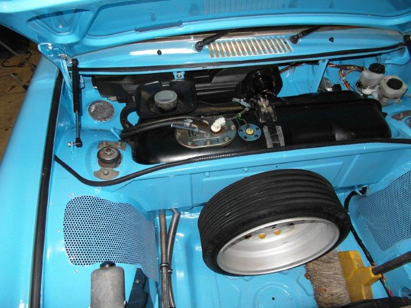

BIGKAT_83   Here you go.works like a champ. The fuel pressure ...   Jan 15 2013, 11:30 AM
scotty b   awesome. Thanks Bob. :beer2: I've been lookin...   Jan 15 2013, 12:59 PM
Chris H.   Yeah and that plastic screw-top is a PITA to get o...   Jan 15 2013, 02:46 PM
BIGKAT_83   No I just ran it the way I got it out of the Impre...   Jan 15 2013, 02:57 PM
Chris H.   Ahhhhhh.... I misunderstood you. That's norma...   Jan 15 2013, 03:01 PM
