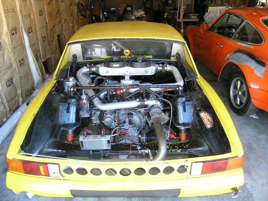

DBCooper Air-Air
(IMG:http://www.914world.com/bbs2/uploads_offsite/dragracevws.com-364-1284055950.1.jpg)

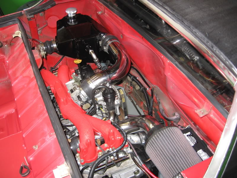

DBCooper Air-Water
(IMG:http://www.914world.com/bbs2/uploads_offsite/dragracevws.com-364-1284055951.2.jpg)

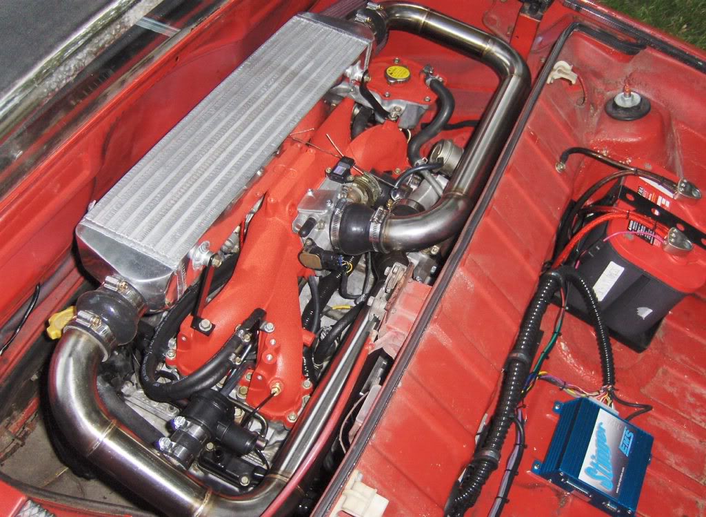

Anklebiters Stock Set-up.
(IMG:http://www.914world.com/bbs2/uploads_offsite/dragracevws.com-364-1284055953.3.jpg)

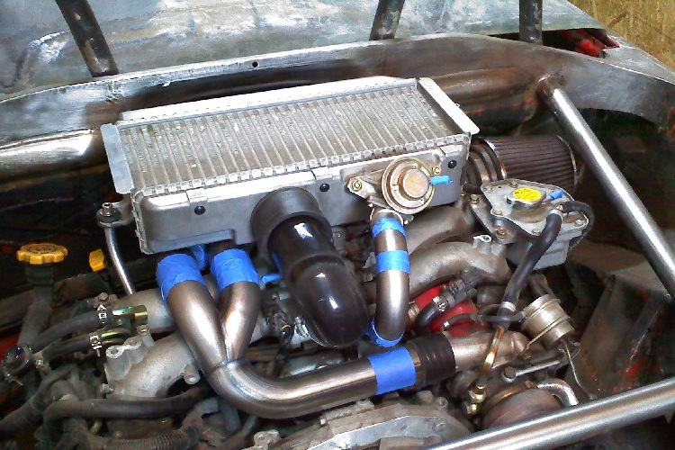

HeaterGuy Air-Air
(IMG:http://www.914world.com/bbs2/uploads_offsite/dragracevws.com-364-1284055954.4.jpg)

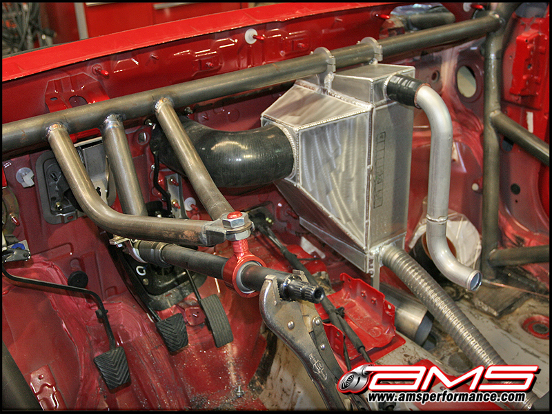

Cool Air-Water inside the cabin.
(IMG:http://www.914world.com/bbs2/uploads_offsite/dragracevws.com-364-1284055957.5.jpg)
