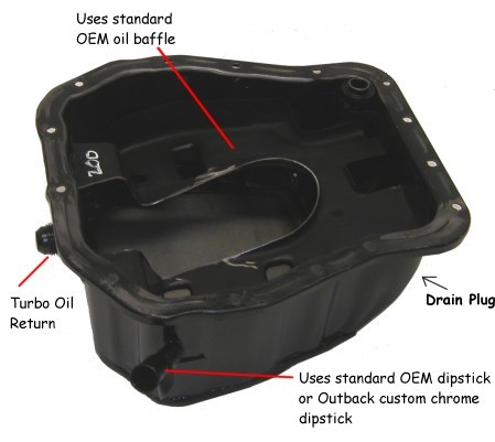

Oil System
- Different Sump Pans
Outfront sells a shorten oil pan for $270 which included a shortened pickup tube. They also list a mid-engine pan for $370, but I am not sure what the difference is.

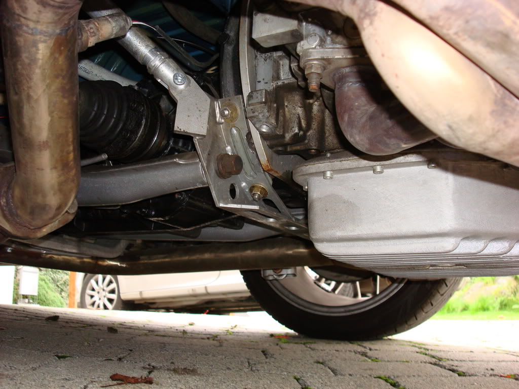

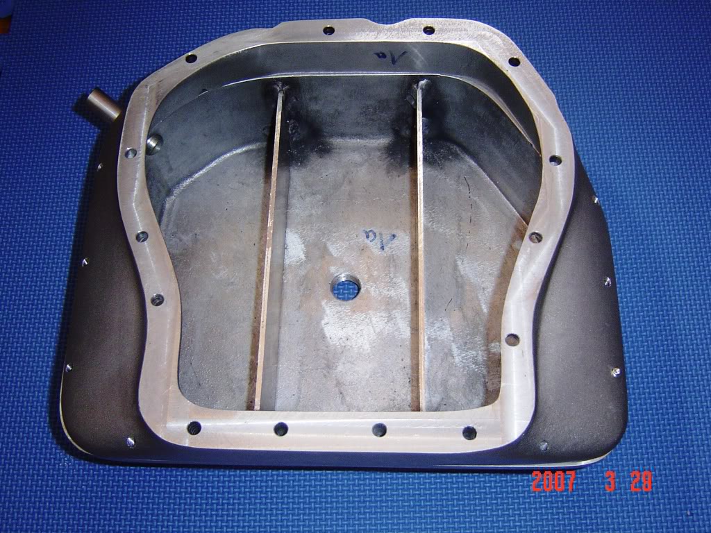

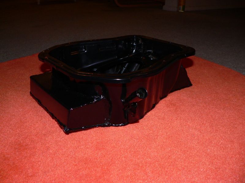

Here is a nicely modified pan from TonyAWAVW with side kick-outs.
Bugat5Speed (http://www.bugat5speed.de/en/) offers a cast aluminum sump.
Details:
Some Product Details:
-Works with EJ 2.0, 2.2 and 2.5 blocks
-The sump is sandcasted like all our other parts.
-The capacity of oil is 4,25 litres (that´s only 0,25 less than original). If you shorten an original sump you loose about a 1 litre.
-It is very stabile (you can put a hydraulic lifter under it and lift the car), so nothing happens if the car is low and the sump hits the floor). If you have the original sump, that´s virtually impossible.
-The cooling properties are much better than with the original one. Water temperature is reduced by about 10 degrees Celsius, if you switch from original to the bug@5Speed sump.
-The pick-up tube inside the sump must be modified (shortened). But that´s no big deal. Anyone who does such a project will easily handle this task.
-The original dipstick can be used, but must be shortened a little.
- Overall dimmentsions are 275 x 320 x 120 mm (length, width, height).
*** One key point, these sumps will interfere with the stock motor mounts, if your using the RJES conversion. Will require modifications of mounts.

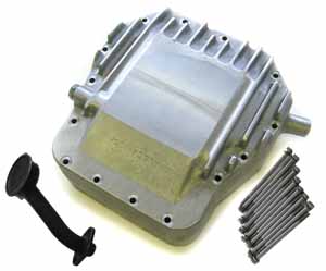

Small Car Performance also sells a cast aluminum pan. Link
Features
* Thickwall alloy aluminum for handling the worst conditions
* Stock Subaru oil capacity (4.3 liters) or 5.5 quarts when filled to the later Subaru level
* Shaped bottom for superior oil scavenging
* Finned exterior for heat dissipation
* Heliarc welded screened oil pickup
* Stainless bolts with aluminum washers
* Comes with o-rings for the oil pickup and for the stock or our flexible dipstick
* 4 5/16" total height saves over 2 inches when compared to the stock Subaru oil pan

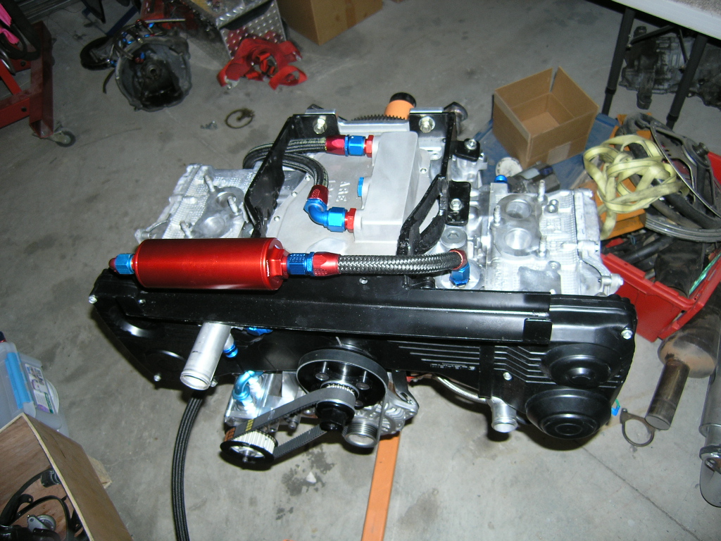

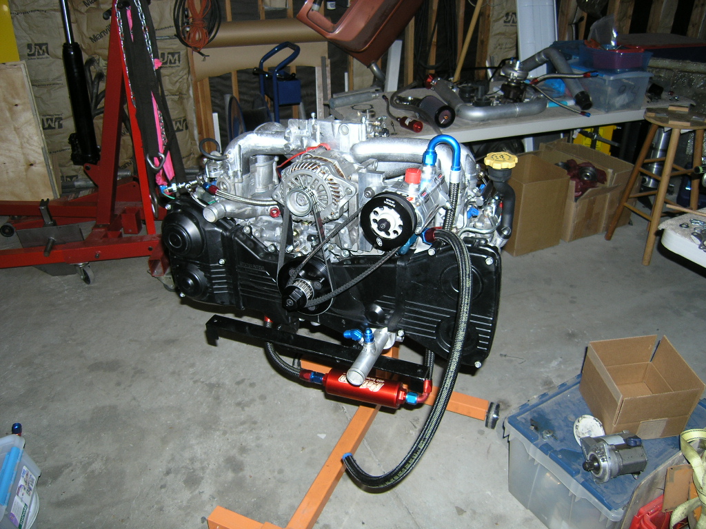

- Dry Sump Set-up
Not sure if it is needed, but some have converted to dry sump set-up. The expense of this set-up can exceed $3K and is very complicated.
(IMG:http://www.914world.com/bbs2/uploads_offsite/dragracevws.com-364-1284054503.2.jpg)
(IMG:http://www.914world.com/bbs2/uploads_offsite/dragracevws.com-364-1284054508.3.jpg)
