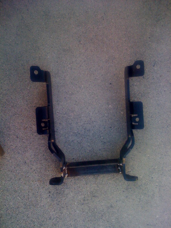

Here's what our smallcar engine mount looks like after fabbing it up for 914 use.
(IMG:http://www.914world.com/bbs2/uploads/post-2697-1262148792.jpg)
(IMG:http://www.914world.com/bbs2/uploads/post-2697-1262148814.jpg)
There isn't much progress lately on our project, but here's our thread link:
http://www.914world.com/bbs2/index.php?showtopic=92942

Britain Smith   Thanks for the pic. The one difference I see betw...   Sep 14 2010, 11:34 AM
