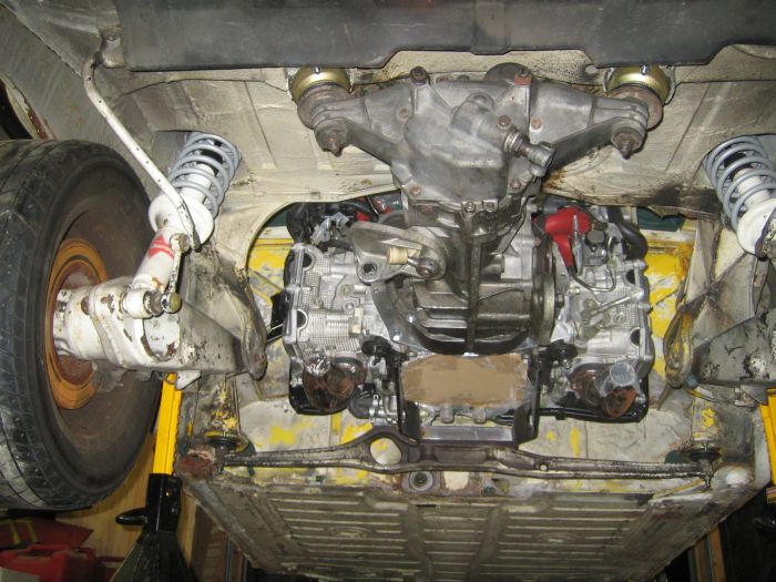

TonyAKAVW - U-shaped mount bar.
DBCooper - Modified Renegade Engine Cradle.

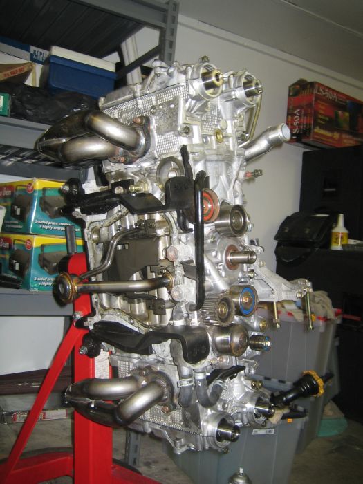

Outfront Motorsports makes a mount which bolts to the bottom of the motor.
HeaterGuy:
(IMG:http://www.914world.com/bbs2/uploads_offsite/dragracevws.com-364-1284054508.3.jpg)
Small Car Performance also make a similar mount (might be the same as the Outfront mount, not sure). Link

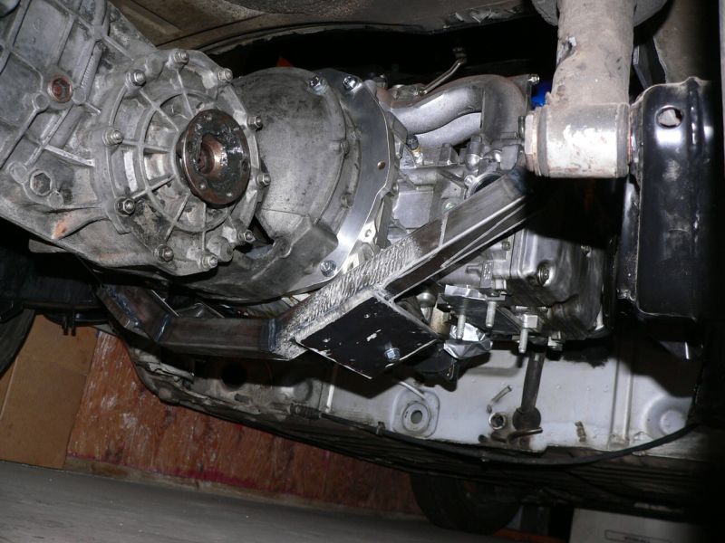

This is from Amenson's thread.
(IMG:http://www.914world.com/bbs2/uploads_offsite/www.digitaldash.org-364-1284136187.1.jpg)
He modified it to fit to the stock 4cylinder engine bar.

QUOTE(Britain Smith @ Sep 9 2010, 08:58 AM) *
(IMG:http://www.914world.com/bbs2/uploads/post-364-1284054904.jpg)
I just saw this, sorry. That's not a Renegade cradle, it's the first one we made. At one point someone commented that it looked like a Renegade (though better made) but I don't know because I've never actually seen a Renegade cradle. So this may look like one, or it may not, I don't know.
