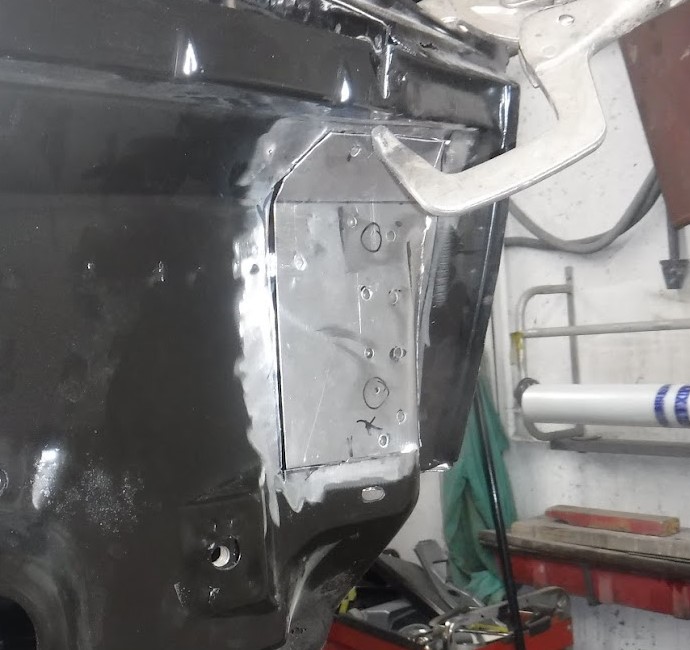

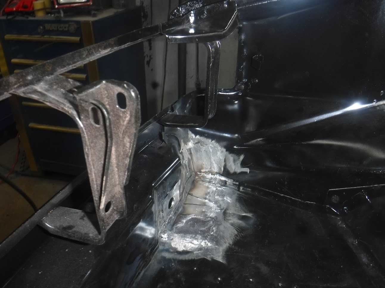

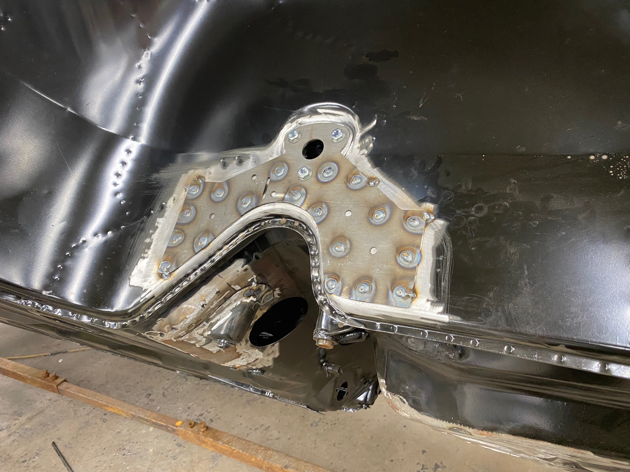

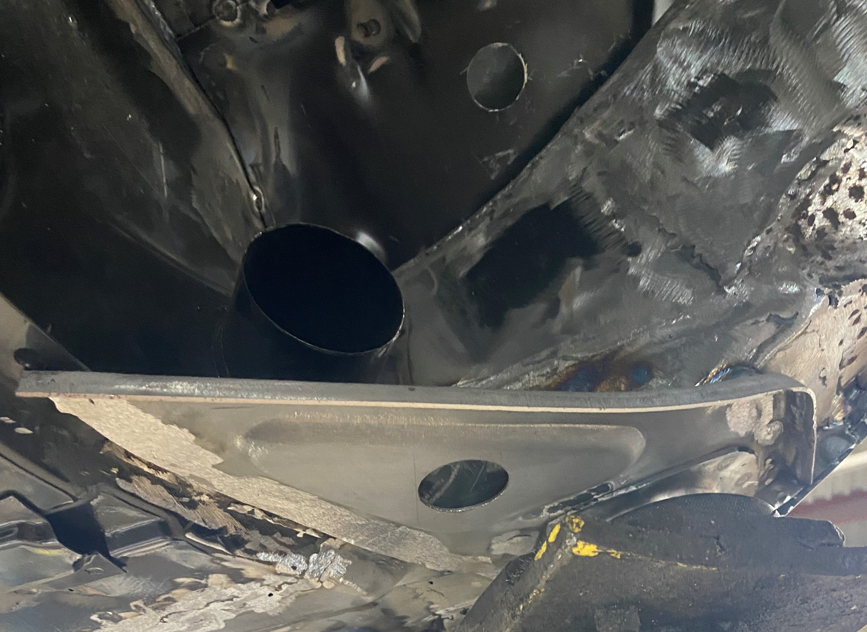

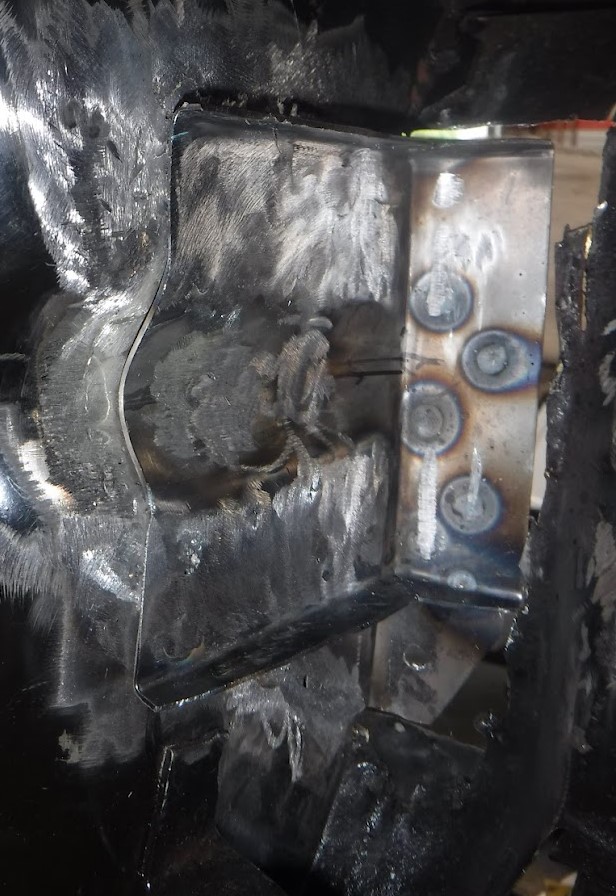

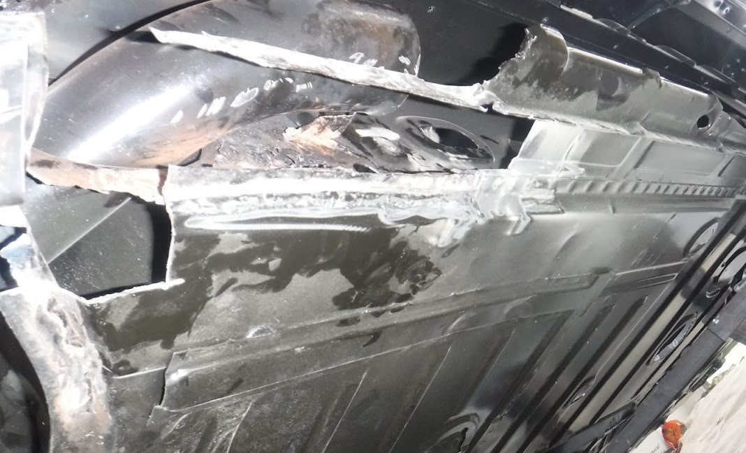

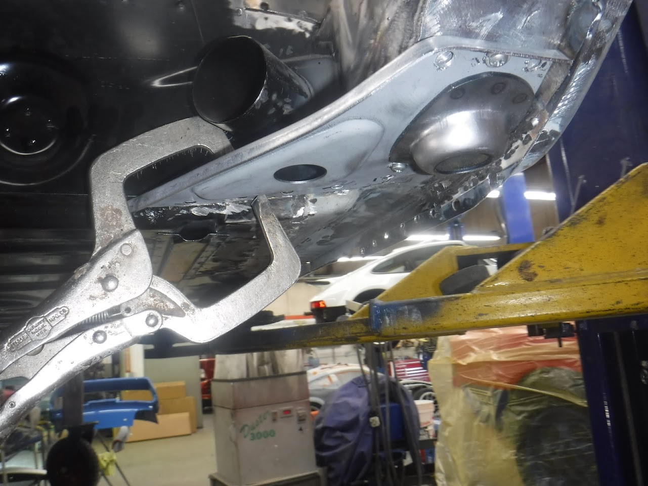

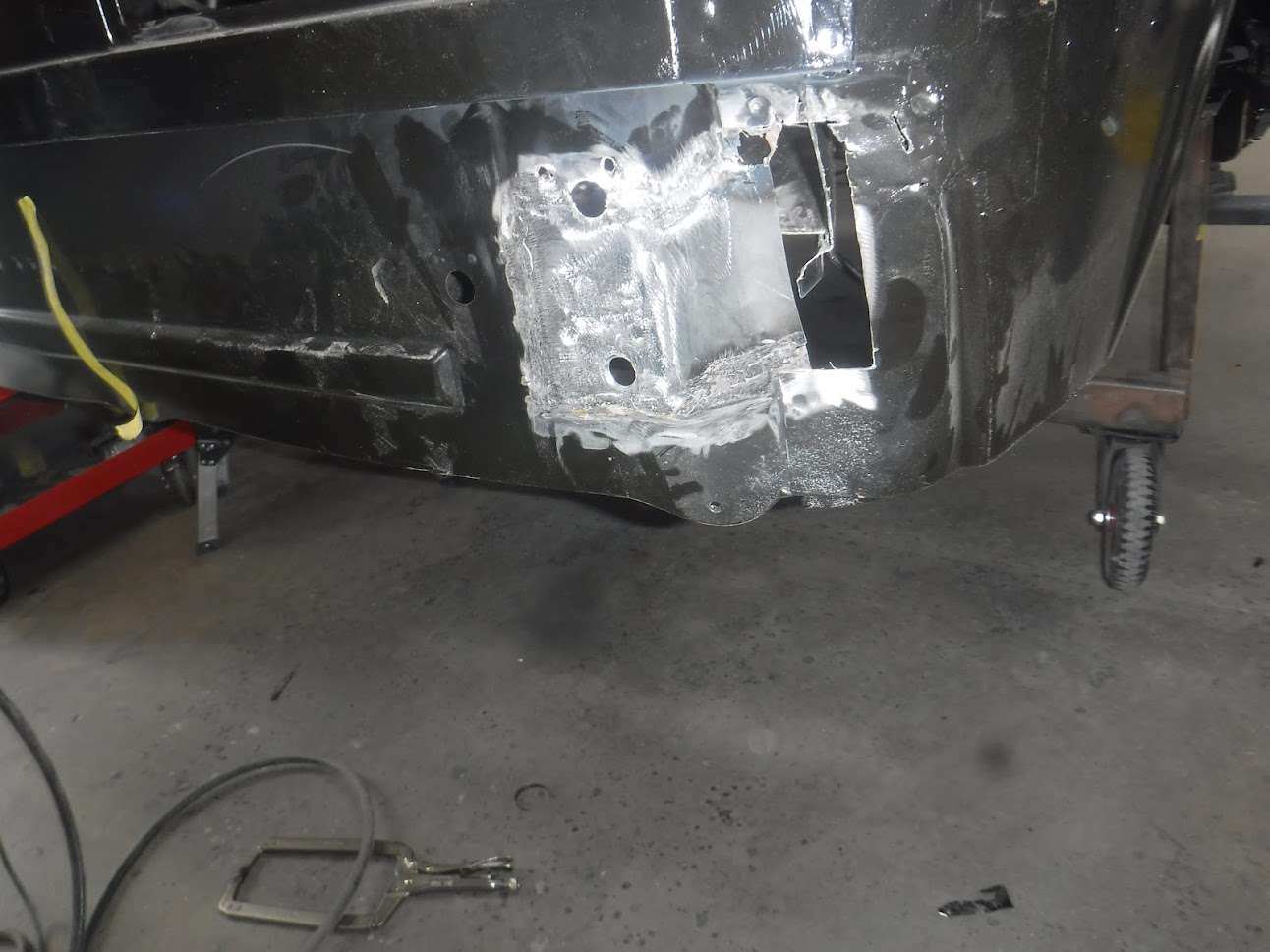

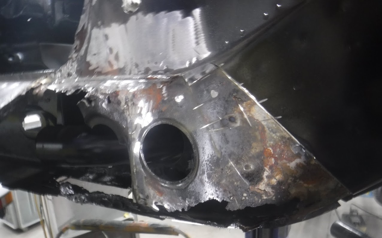

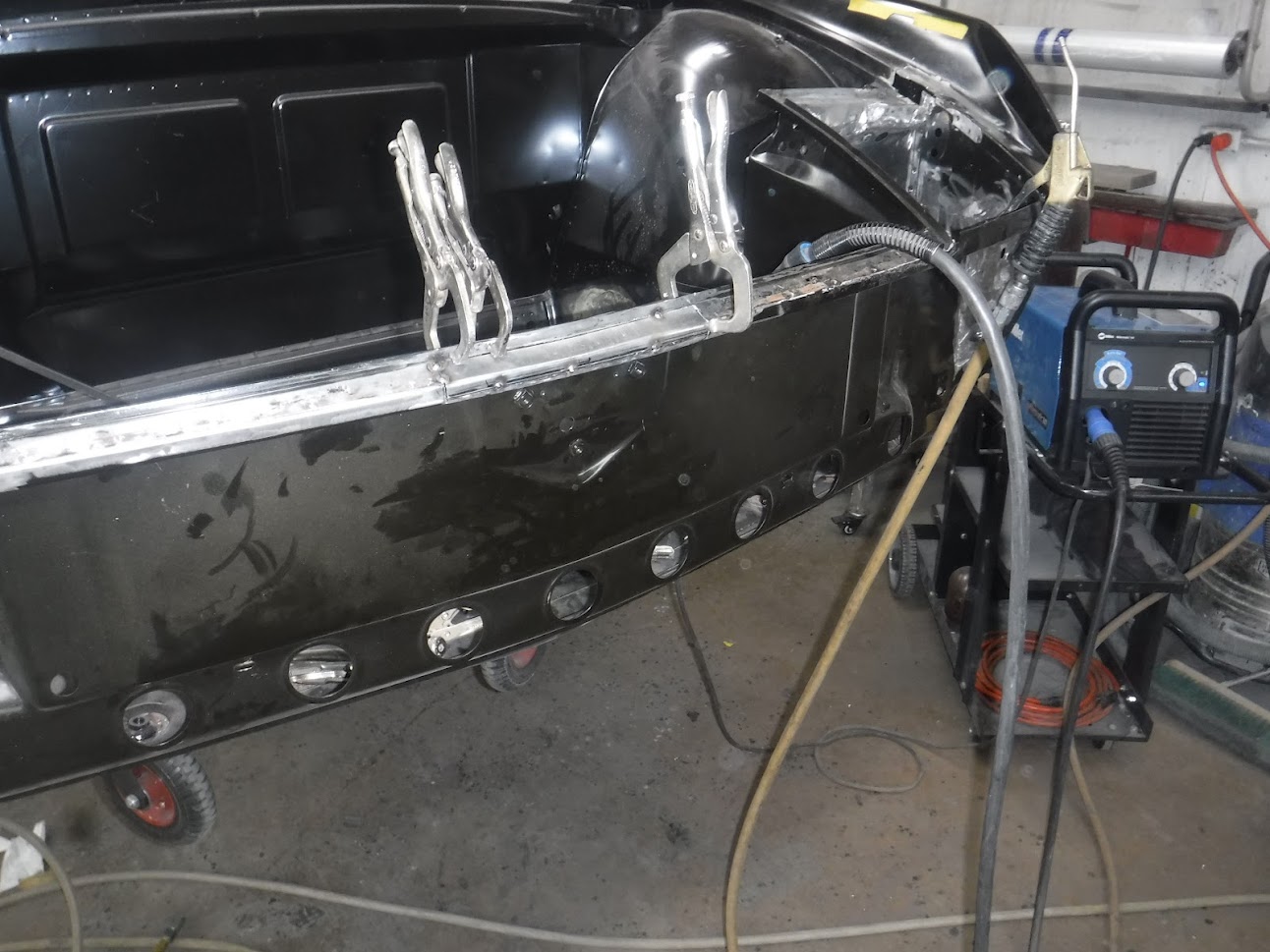

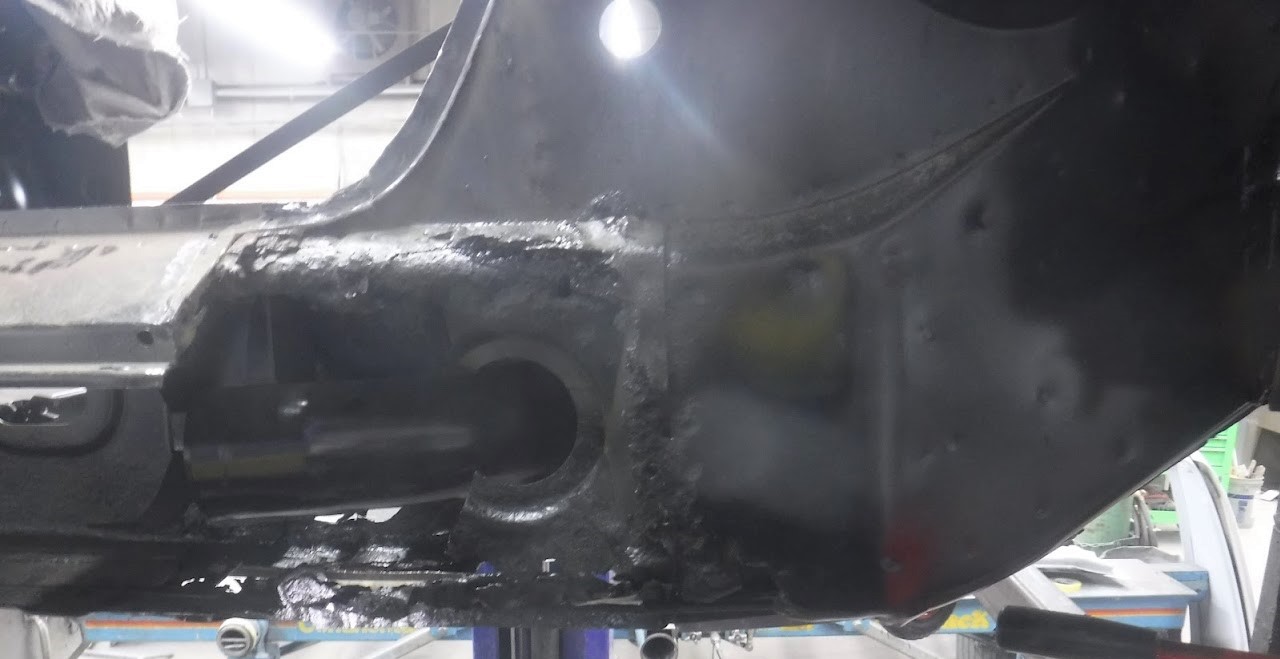

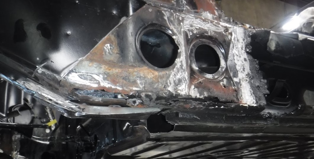

Here are some photos of the repairs in the rear bumper mount area
Click to view attachment Click to view attachmentClick to view attachmentClick to view attachment Click to view attachment

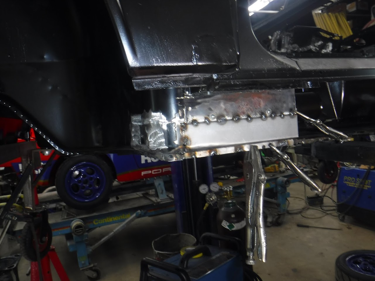

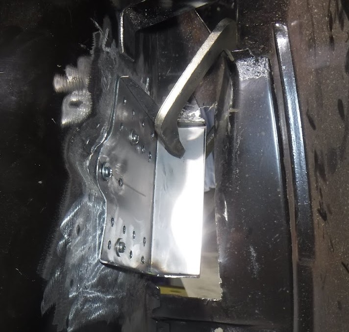

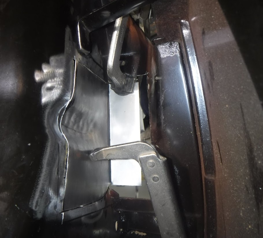

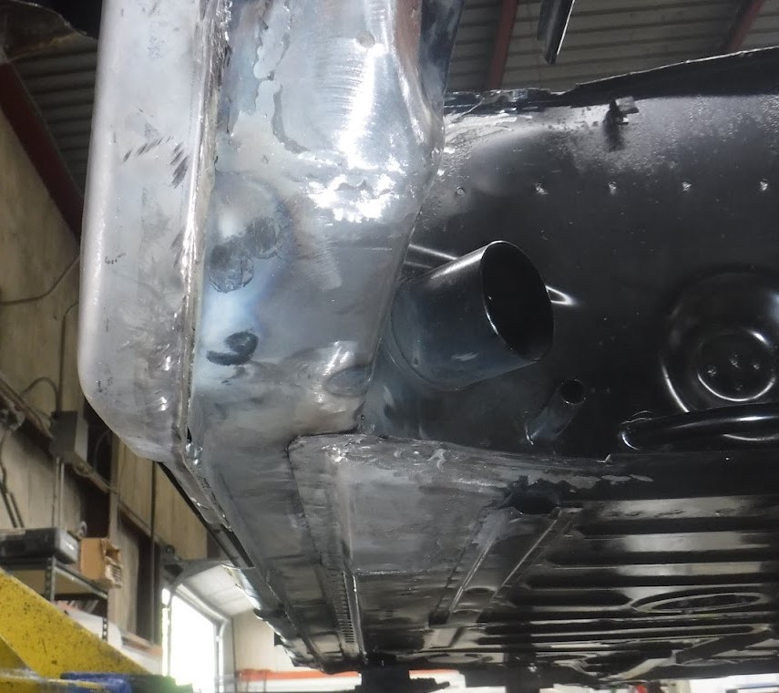

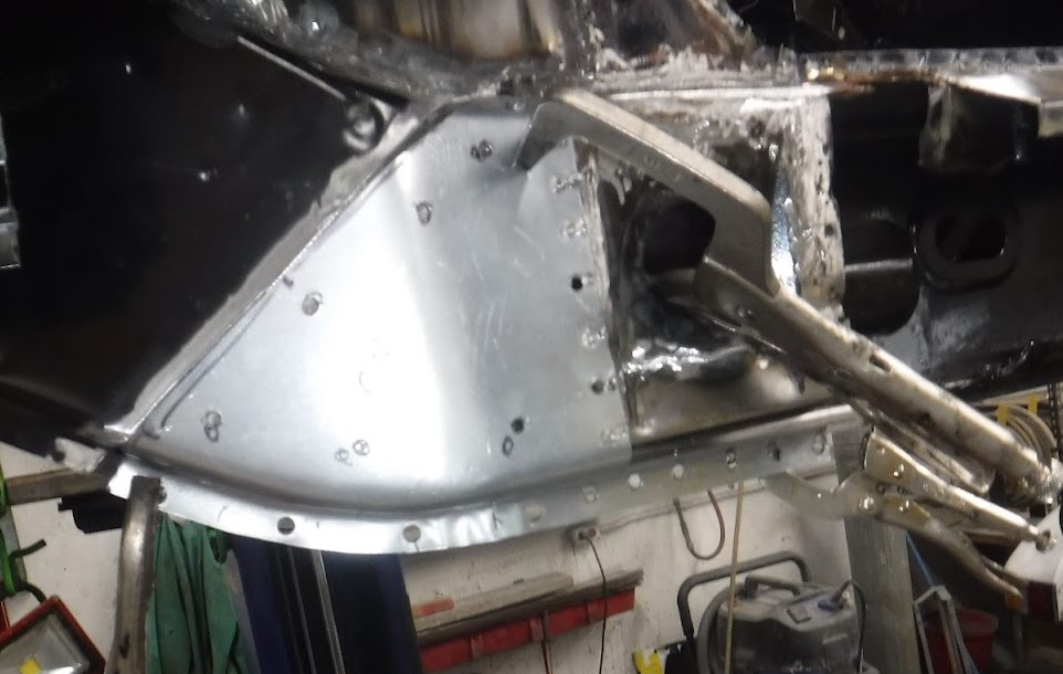

RHS Rear bumper support.
Click to view attachment Click to view attachmentClick to view attachmentClick to view attachment[attachmentid=873
925]Click to view attachment

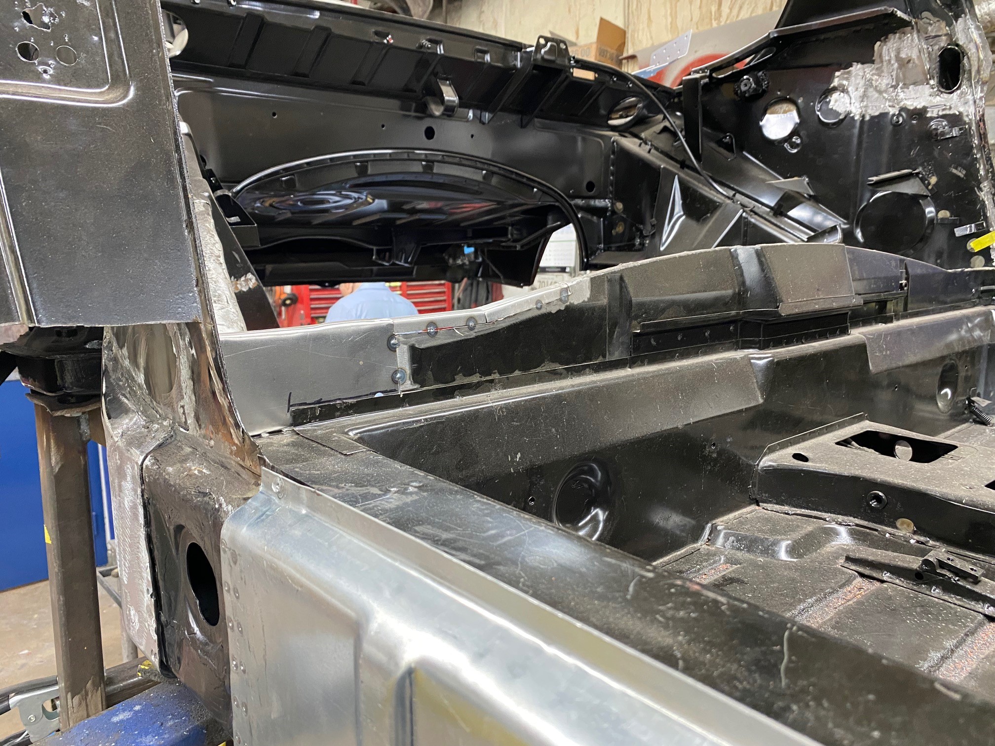

Tom1394racing

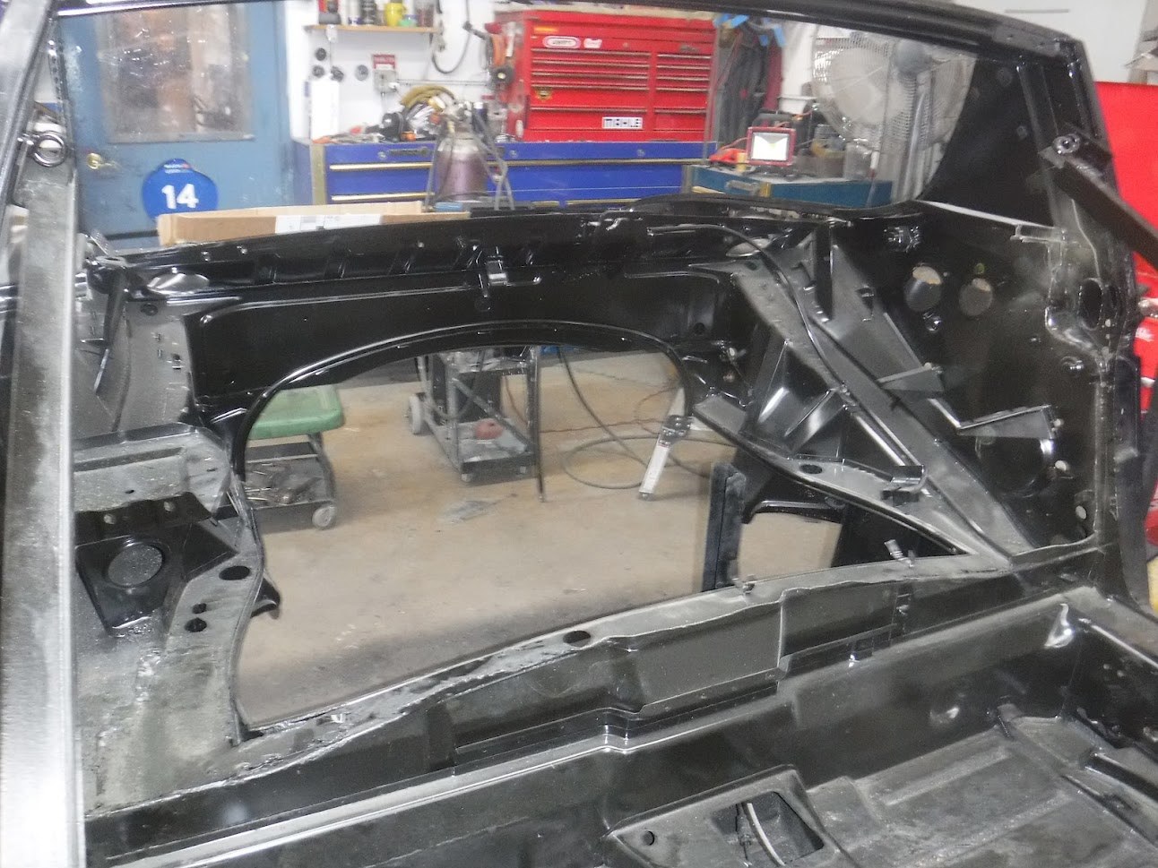

Ready for NOS rear firewall.

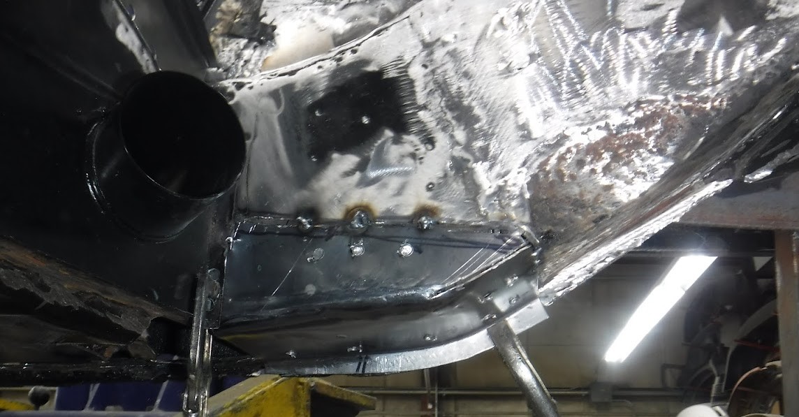

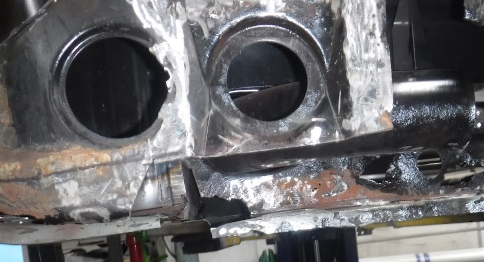

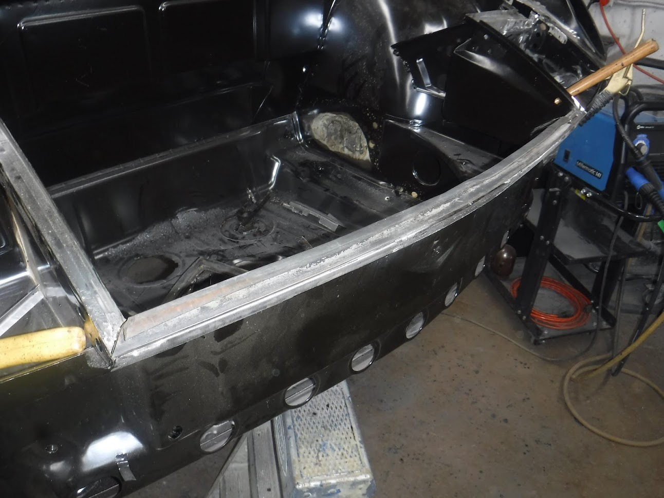

Tom1394racing

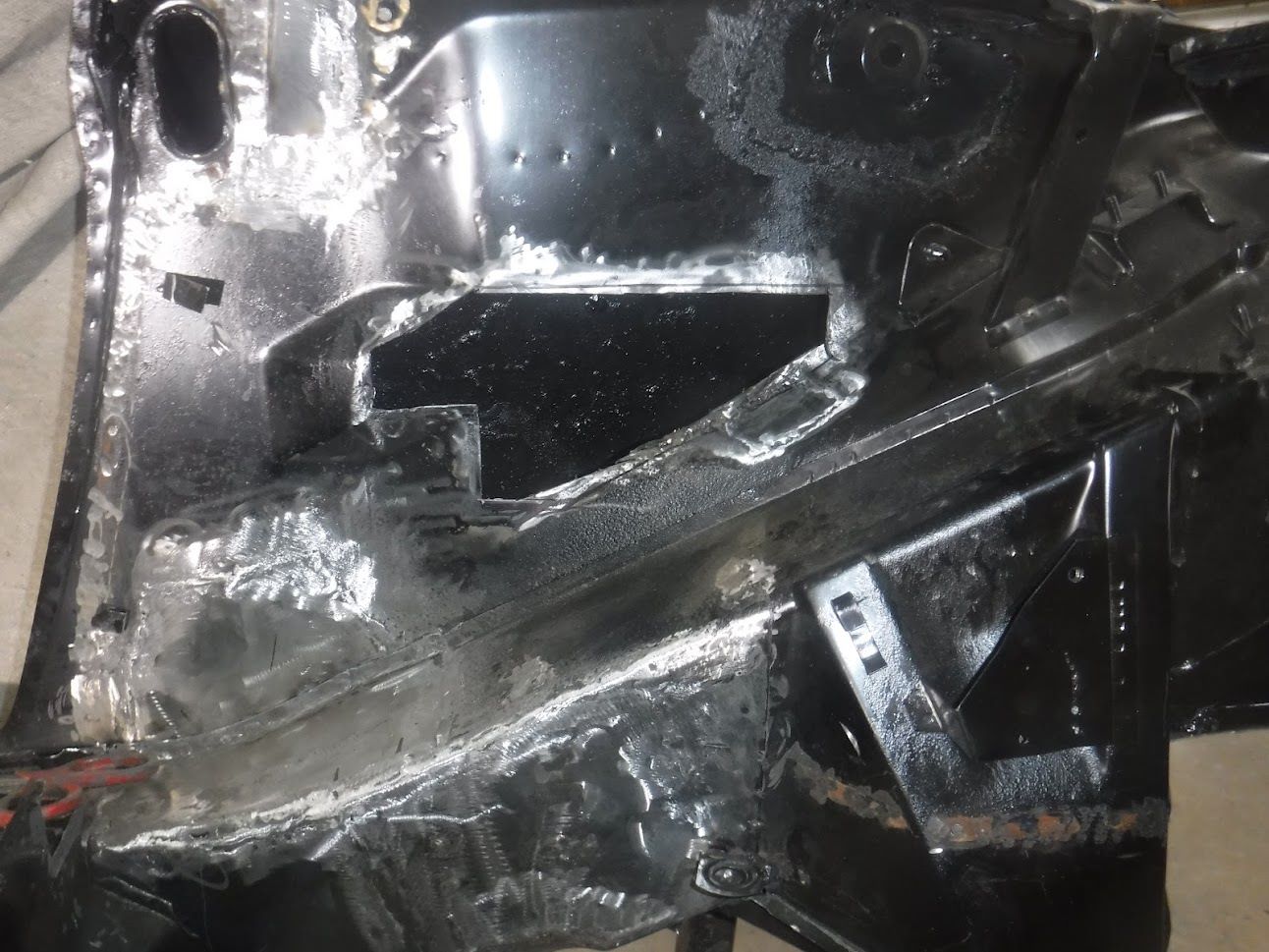

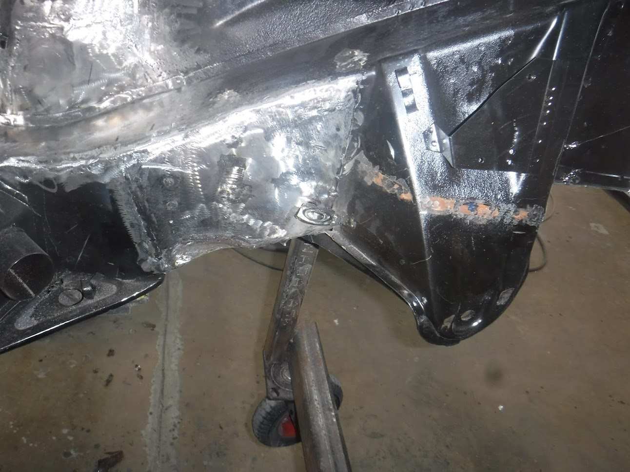

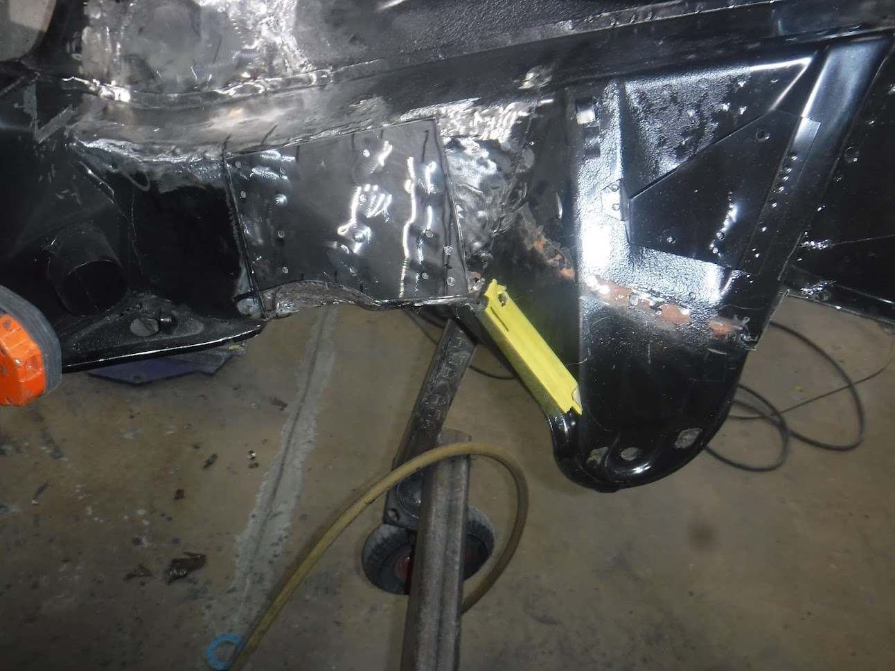

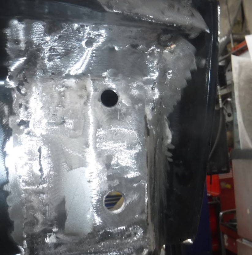

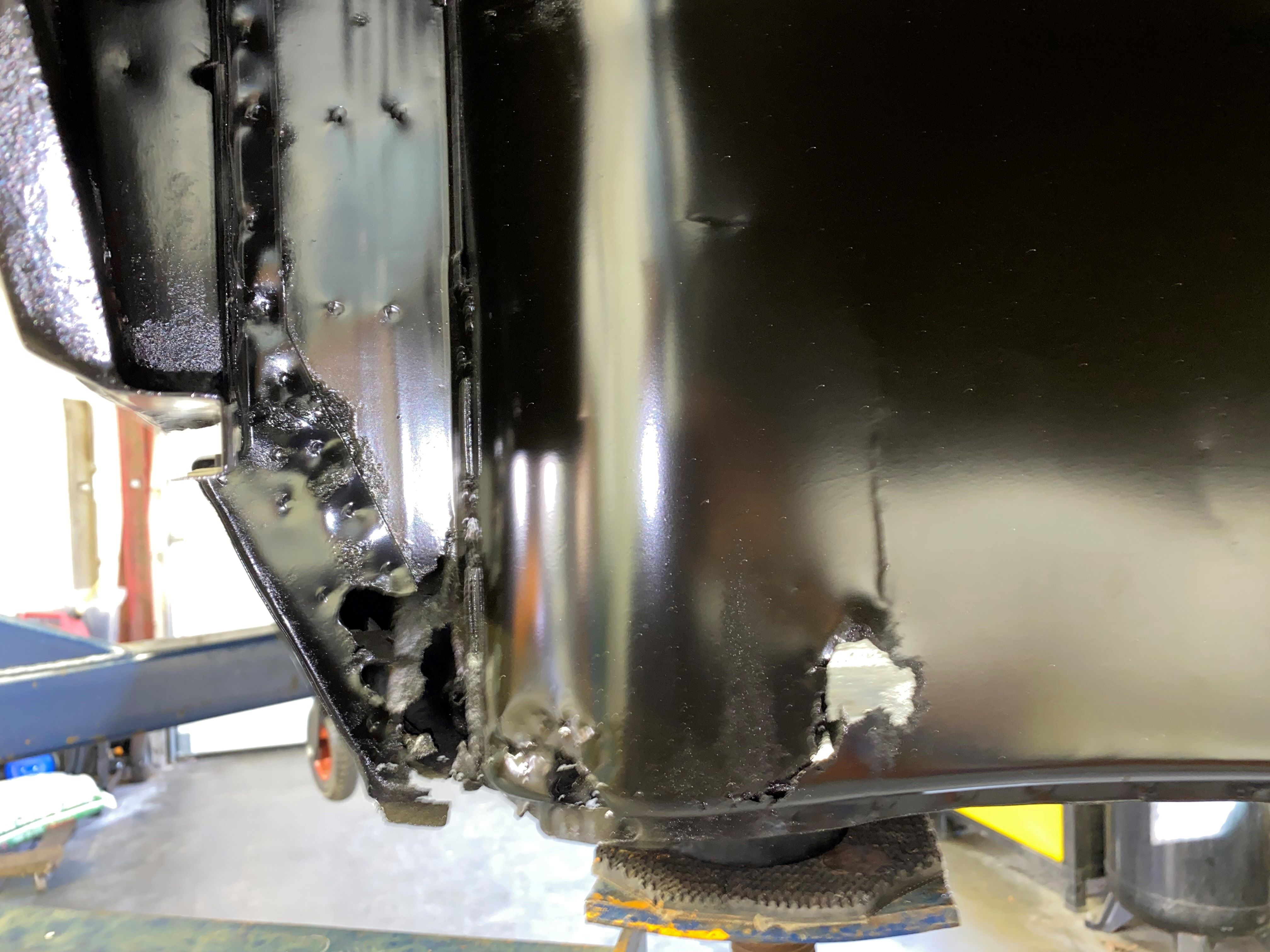

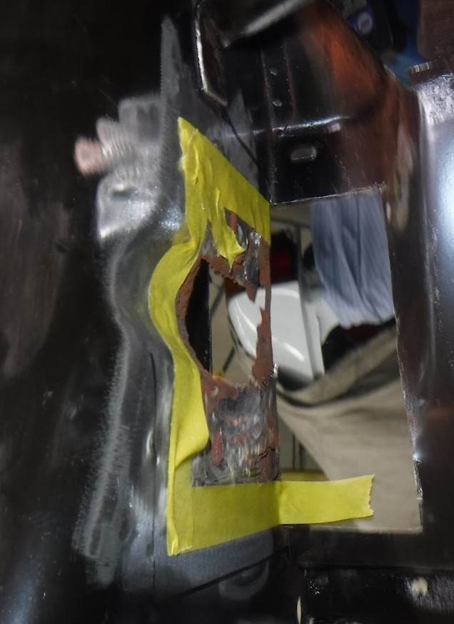

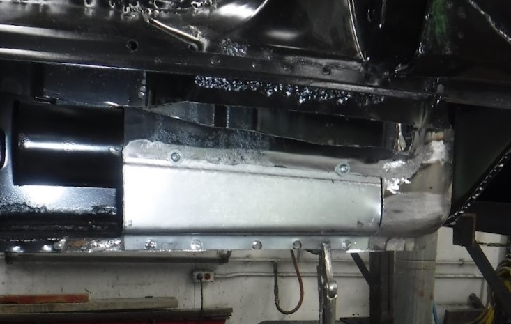

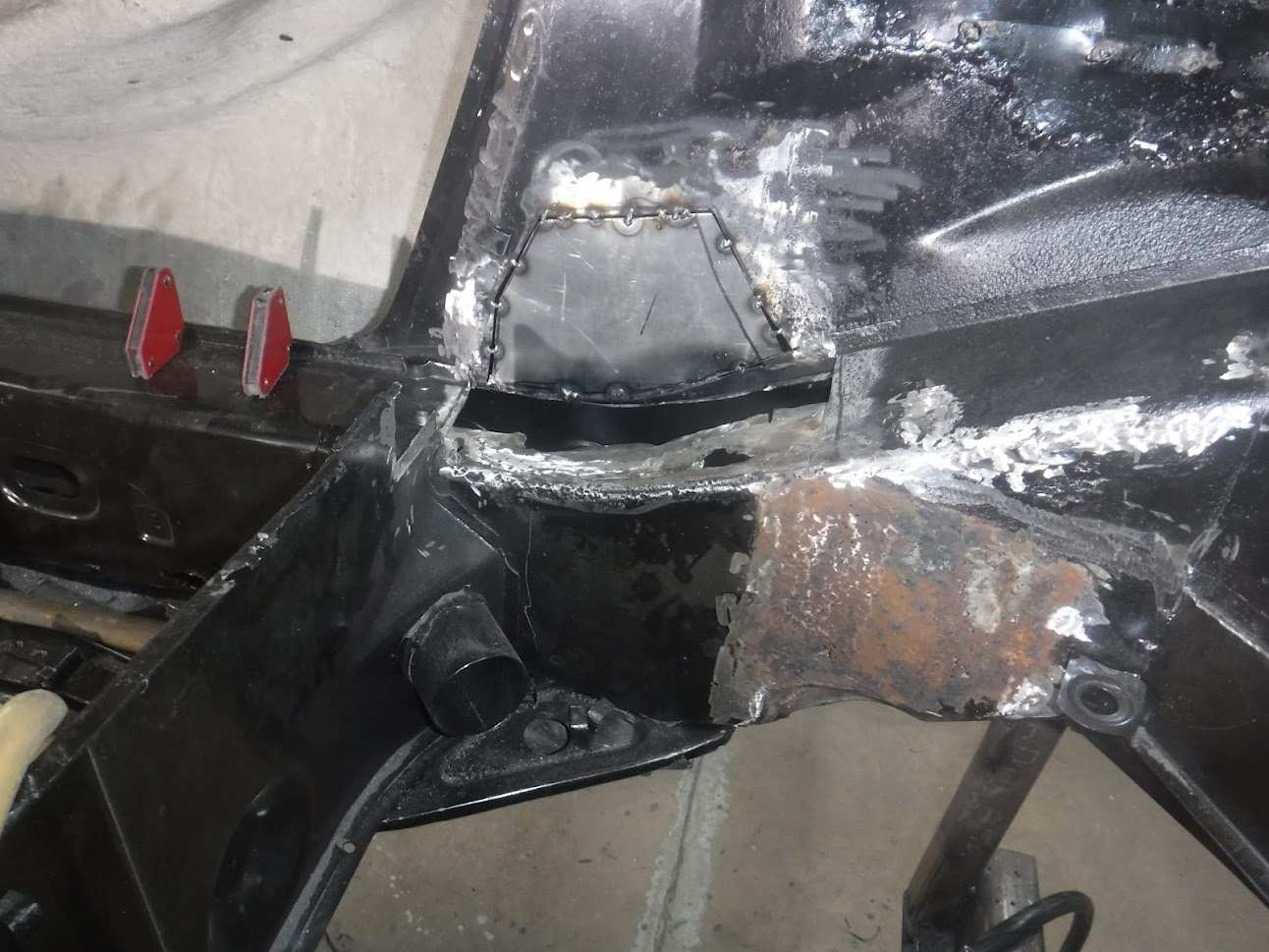

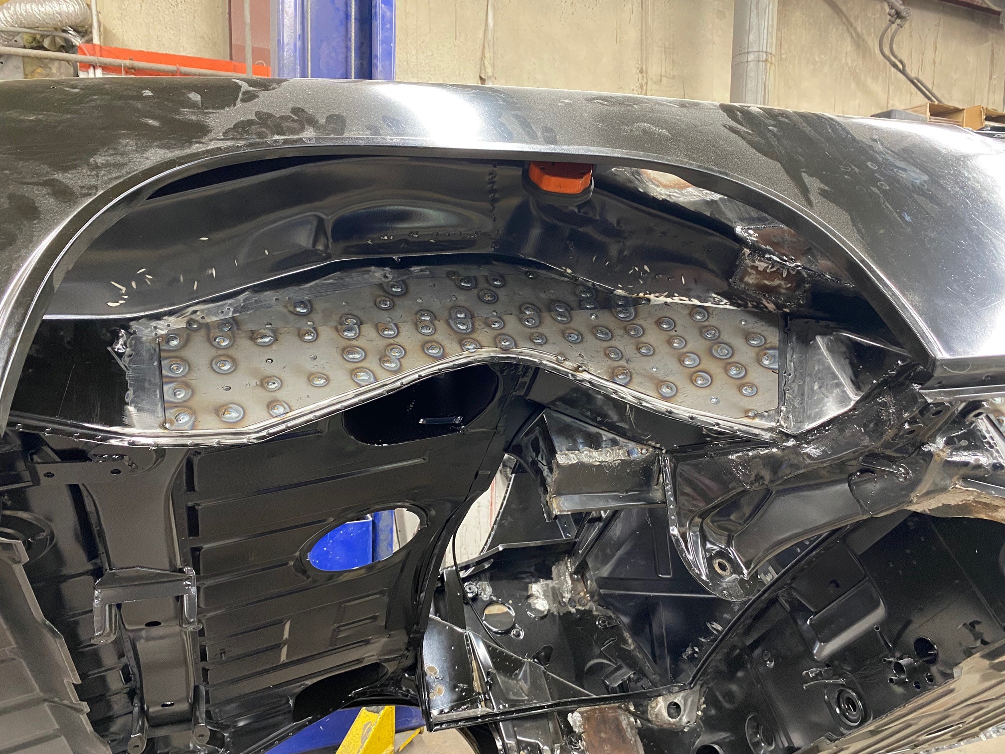

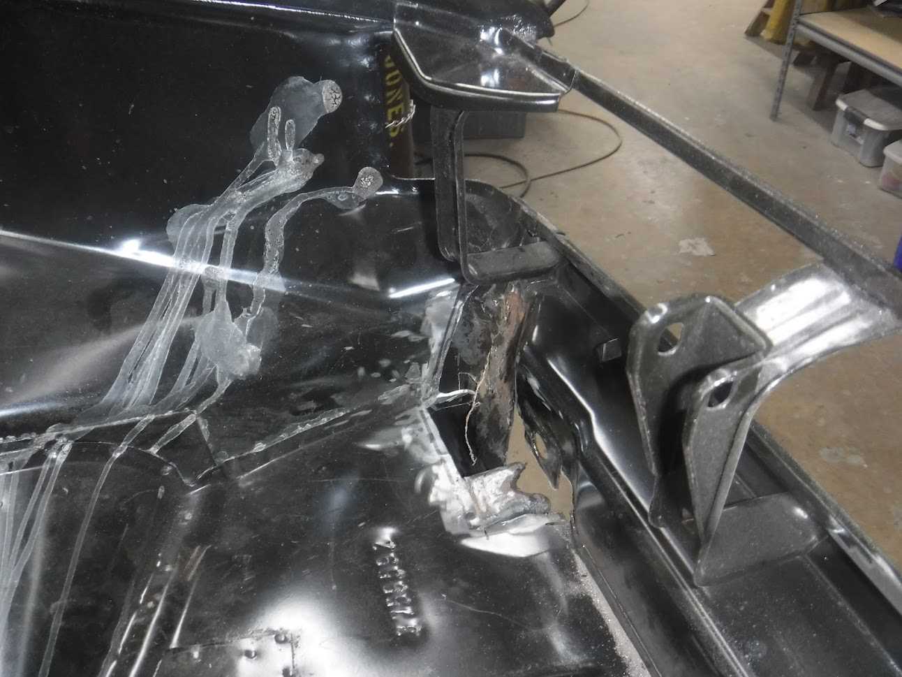

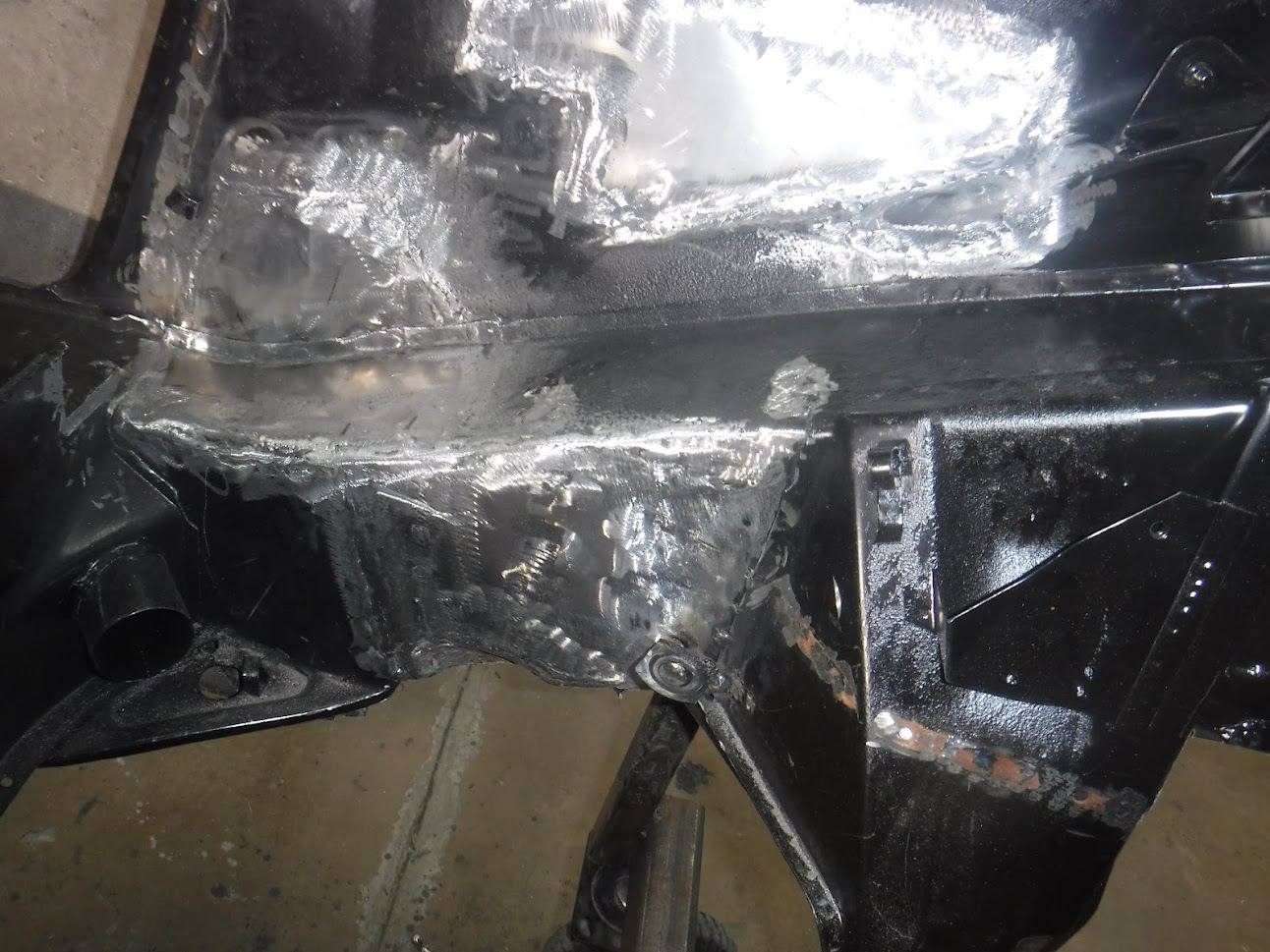

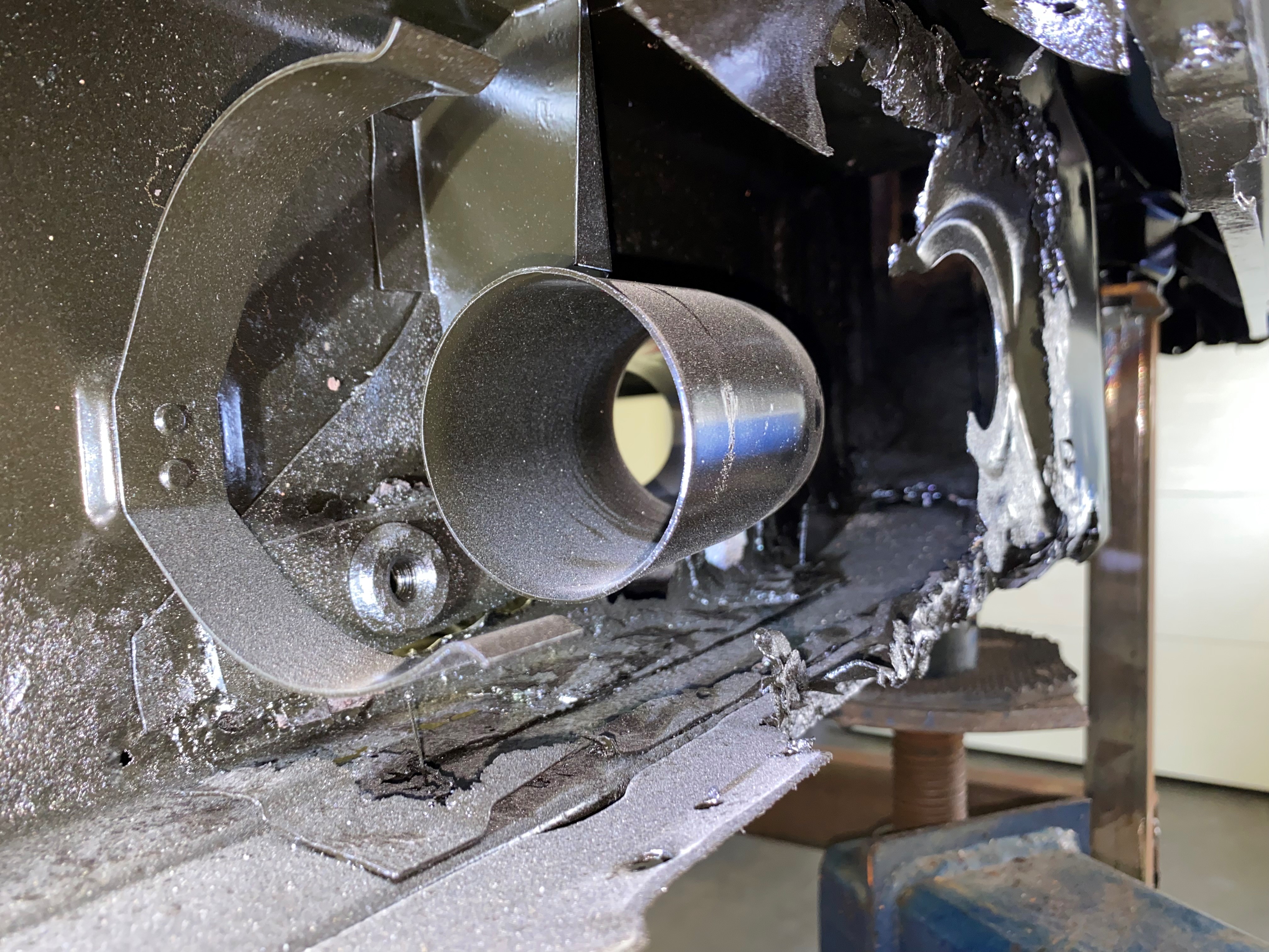

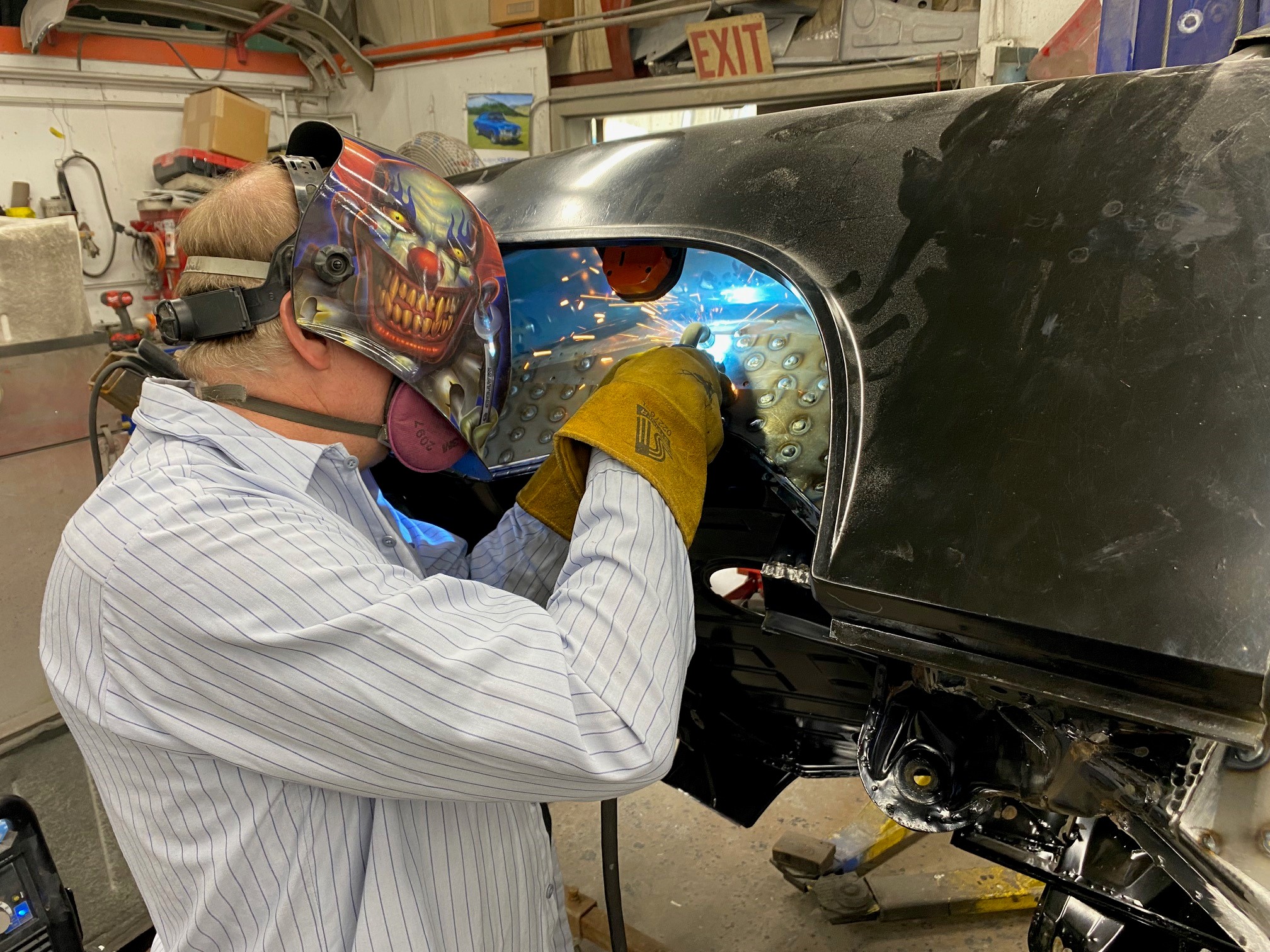

More progress on rust repair at Auto Associates. Engine bay L&R (hell hole) side rust repaired. Heater tubes reinstalled and outer longitudinals being replaced. Interesting note on the acid/e-coat dip. We have found some spots where neither the acid nor the e-coat penetrated. Fortunately, these areas also had only light surface rust.

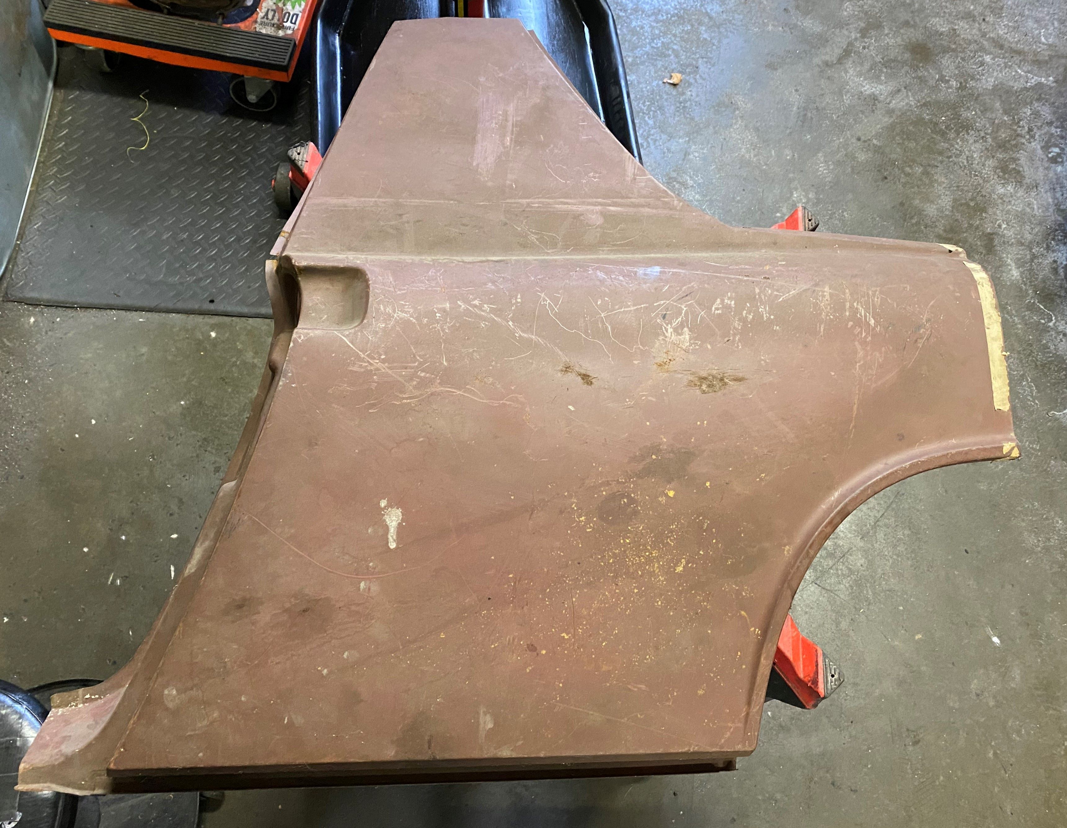

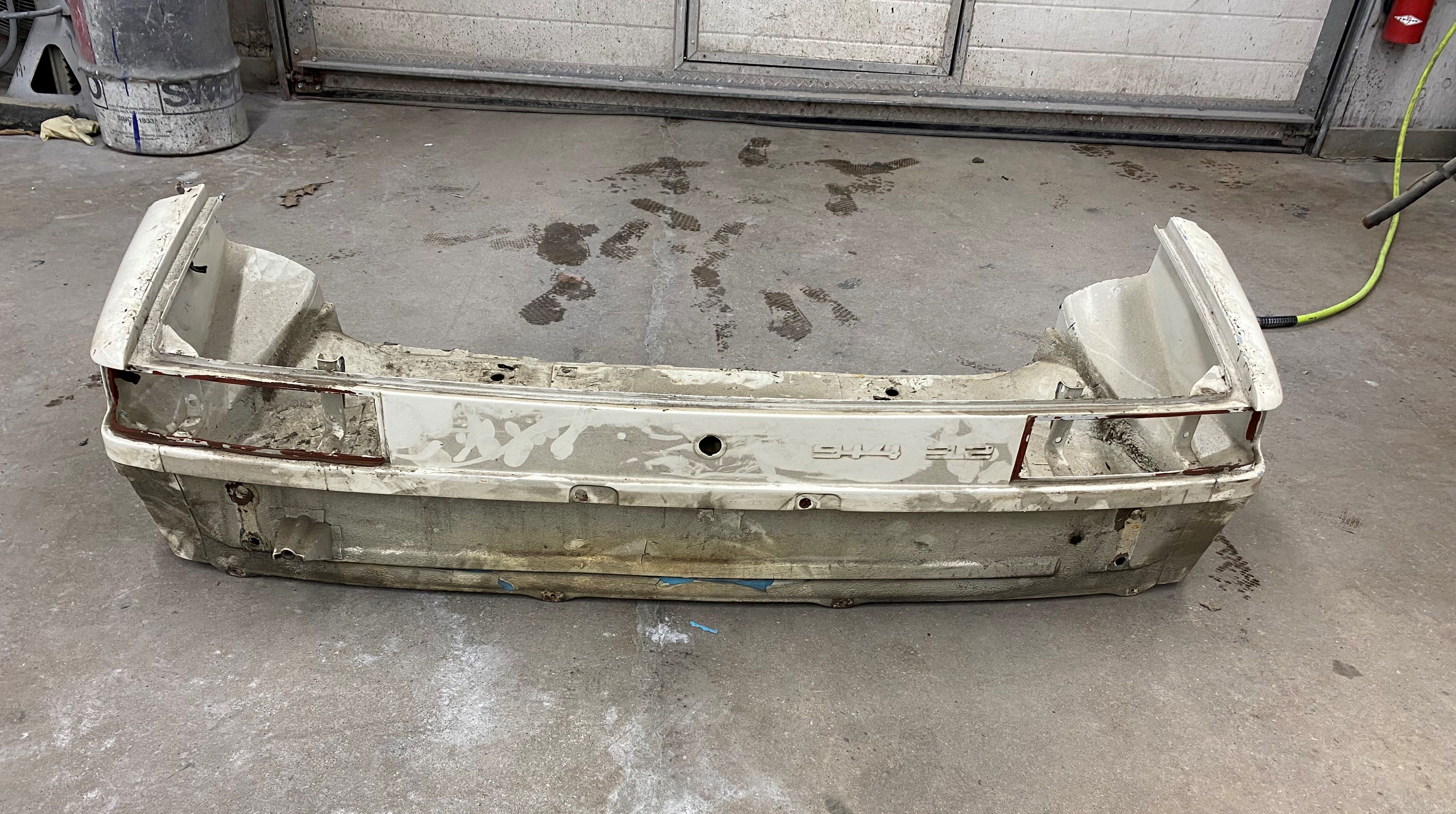

I was able to find some good replacement panels. A LHS sail/rear quarter at Carlisle and a rear panel from our friend Chris Foley. We will use only the taillight section of the rear panel. However, if anyone has a good RHS sail/rear quarter panel like the LHS I found, we could make good use of it.
Front fender well repairs are also completed.

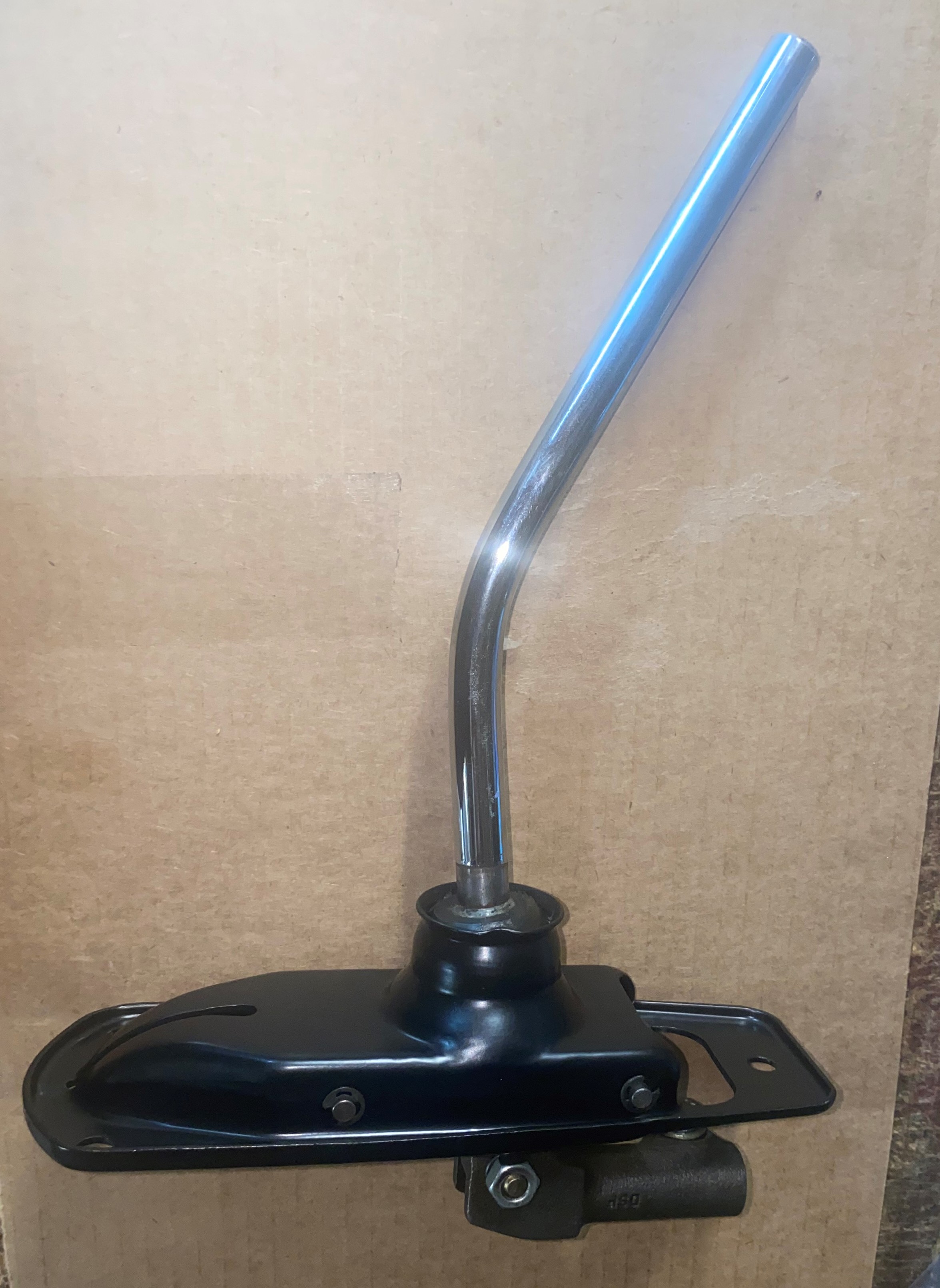

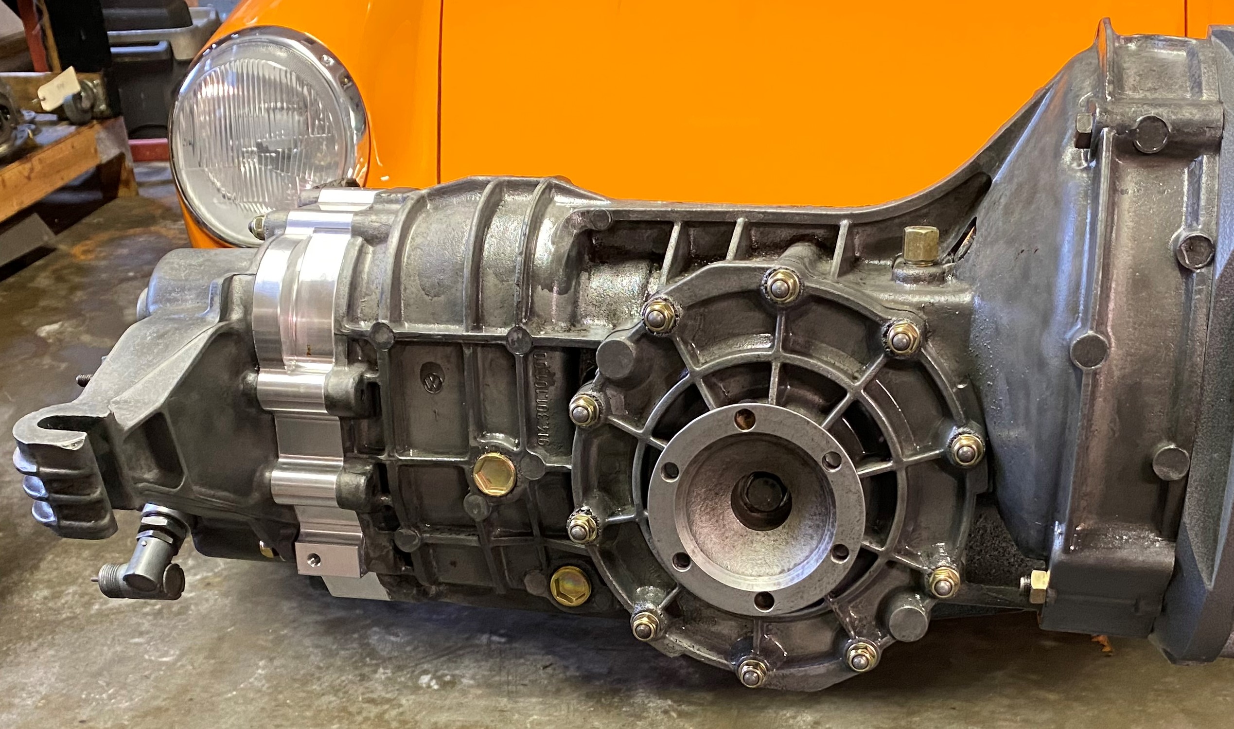

In the meantime, the original '73 side shift gearbox has been rebuilt with a billet Al intermediate plate and 108 mm output shafts to mate with sway away axles and 911 108 mm CV's. The intermediate plate was drilled and tapped to accept the 914-6 throttle bell crank. The gear box will also get the Tangerine Racing precision shift coupler.

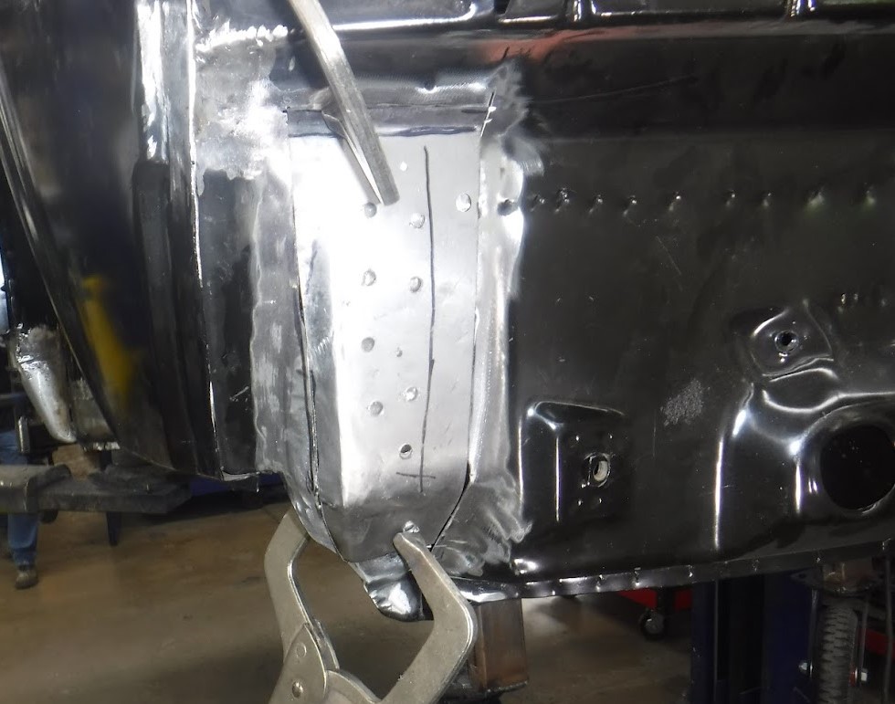

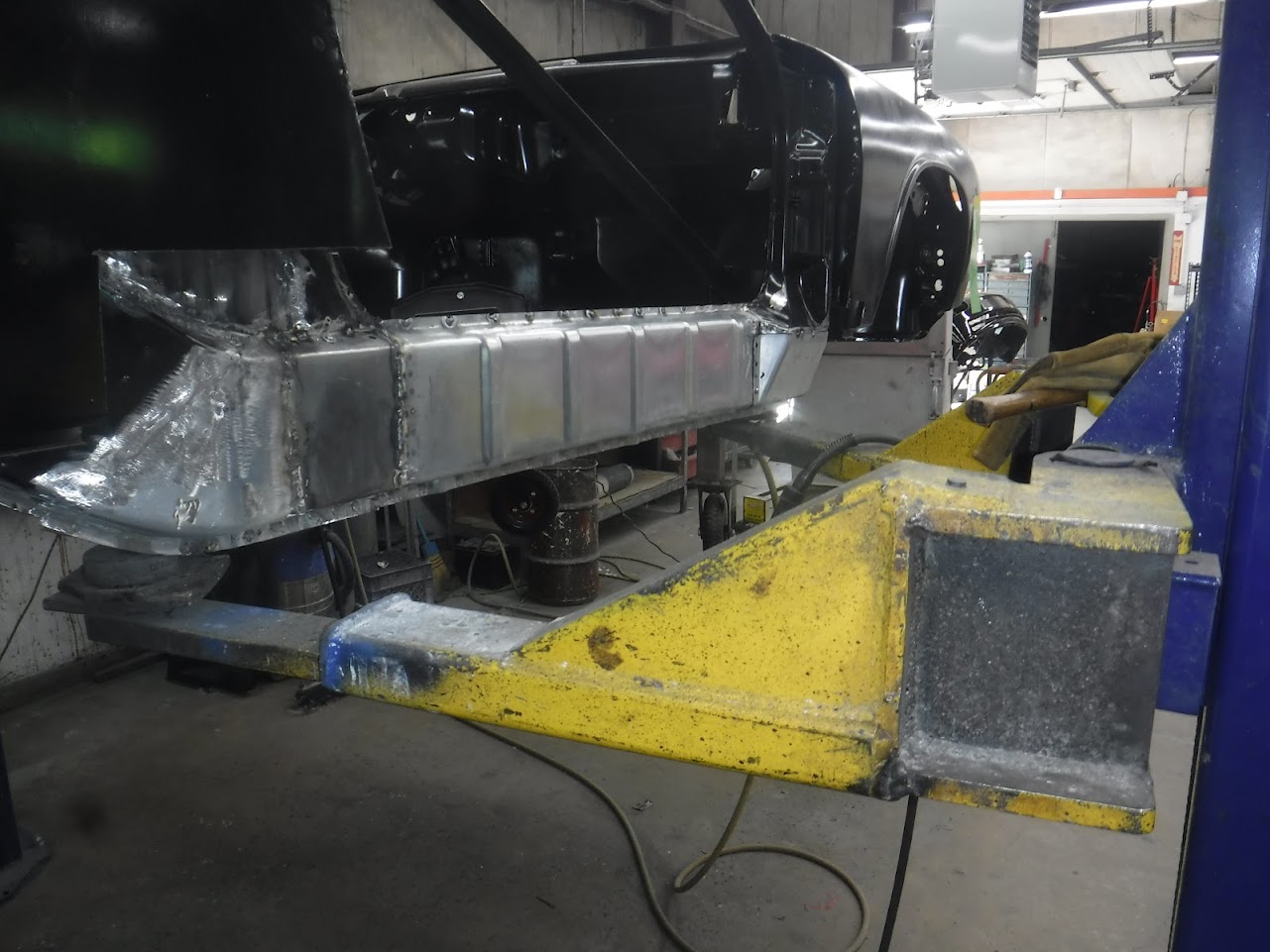

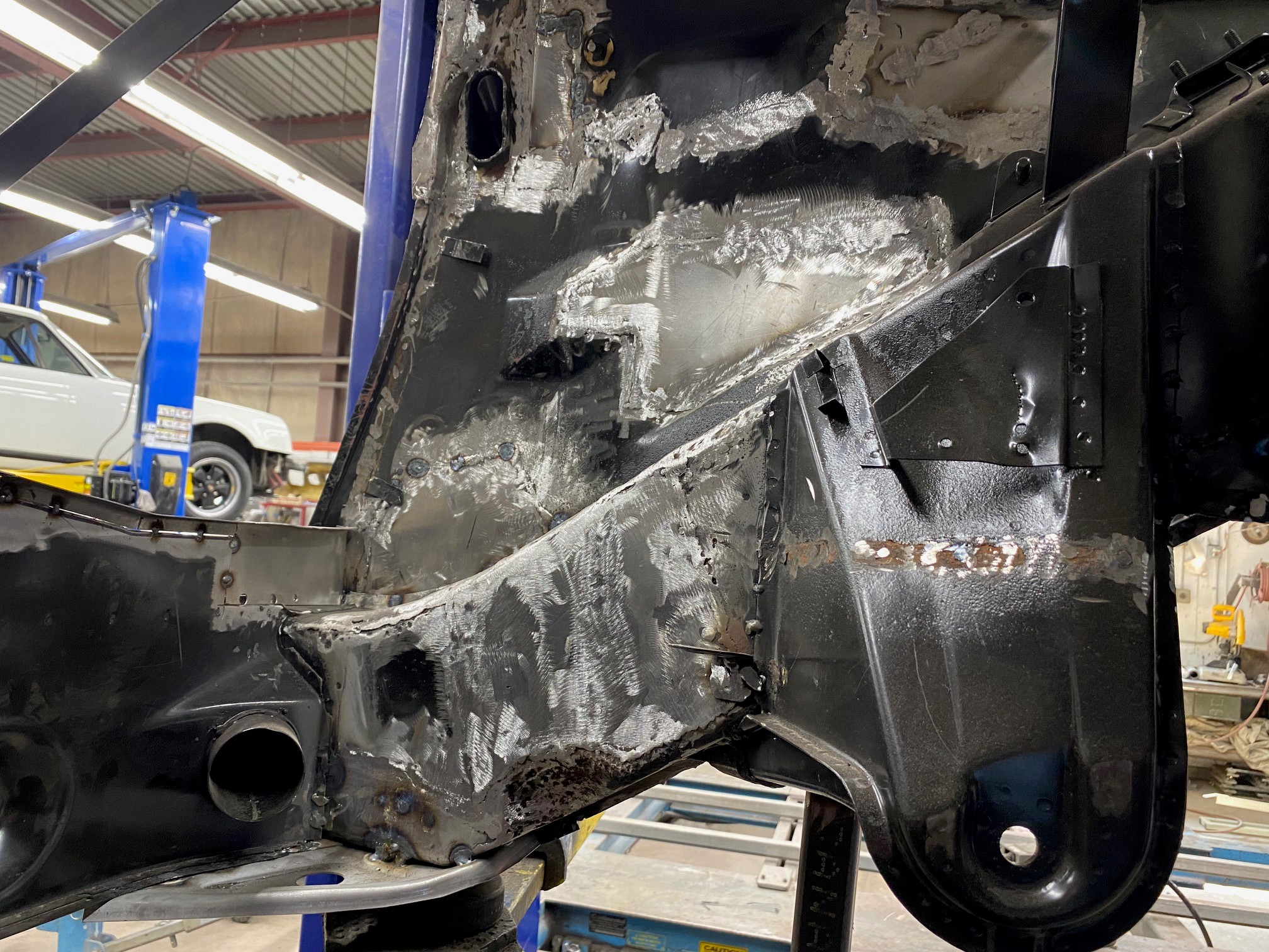

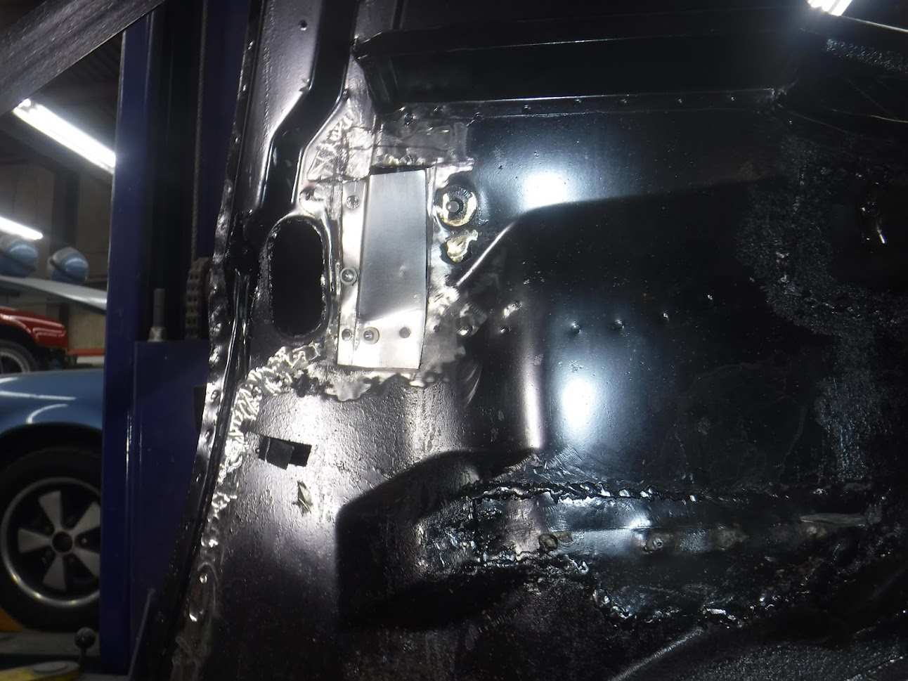

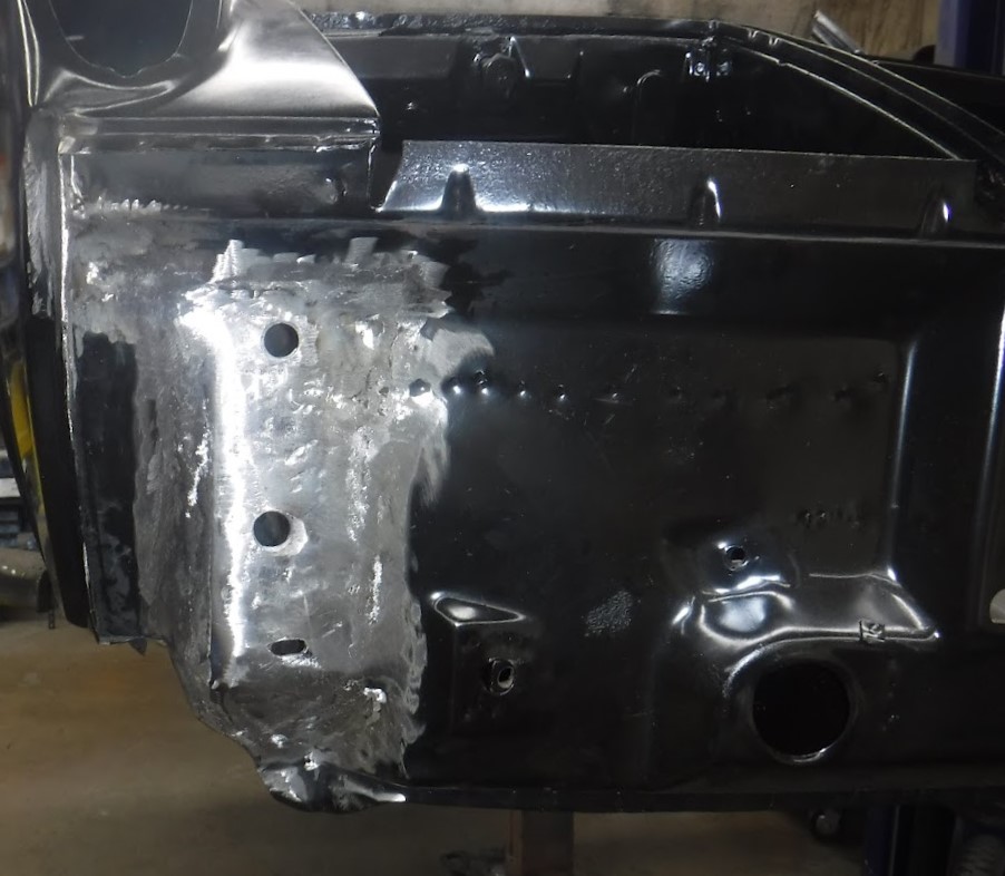

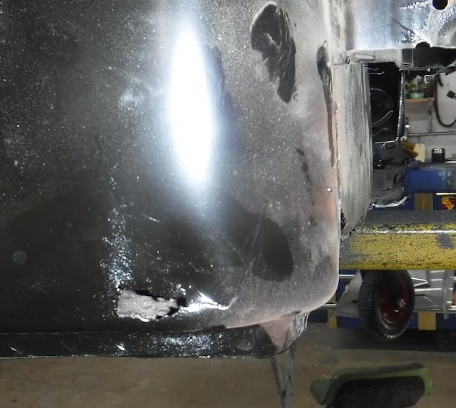

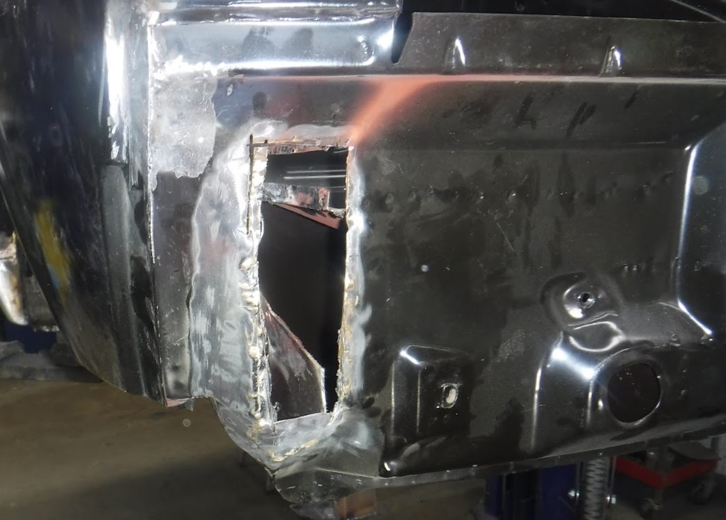

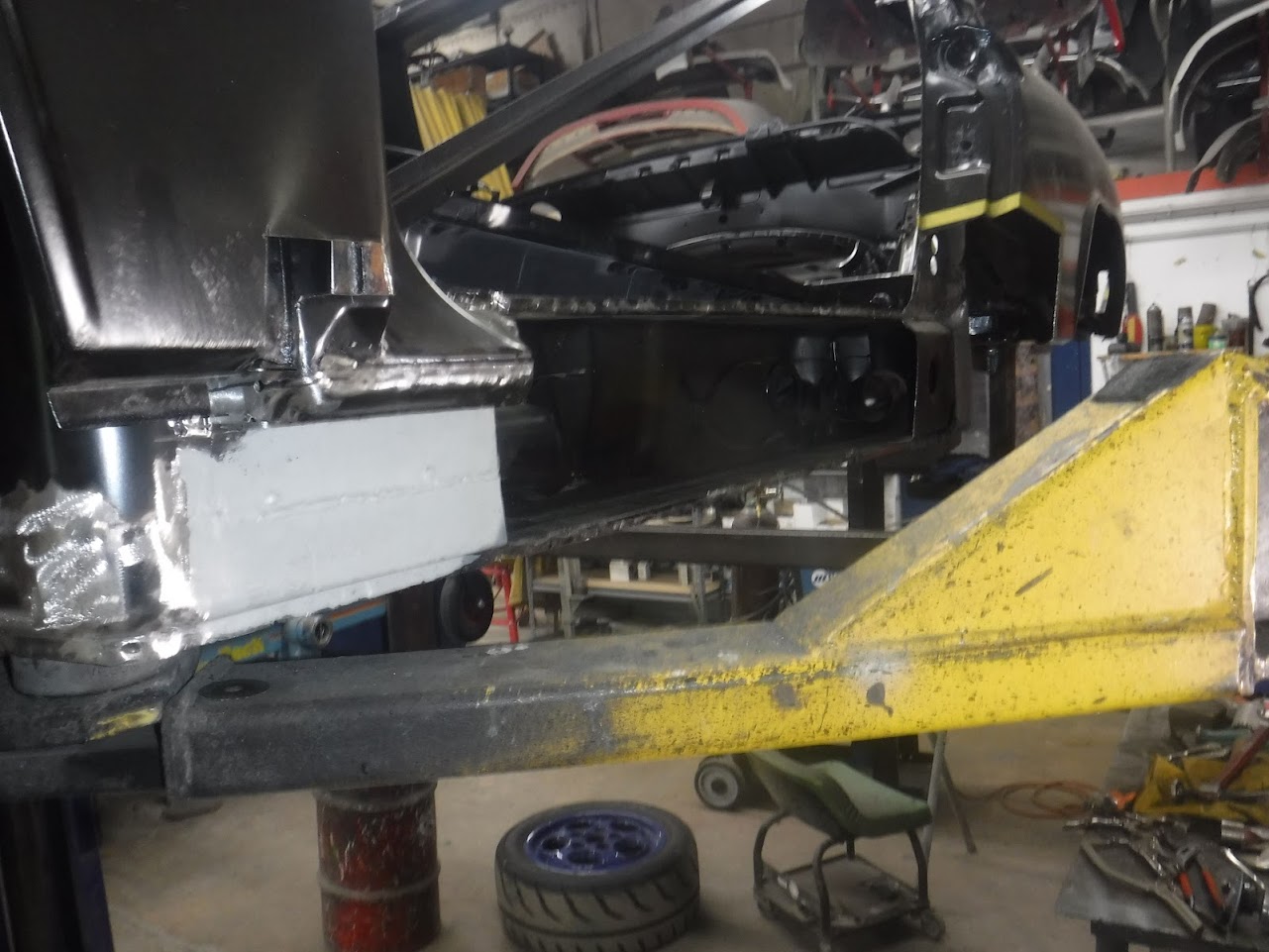

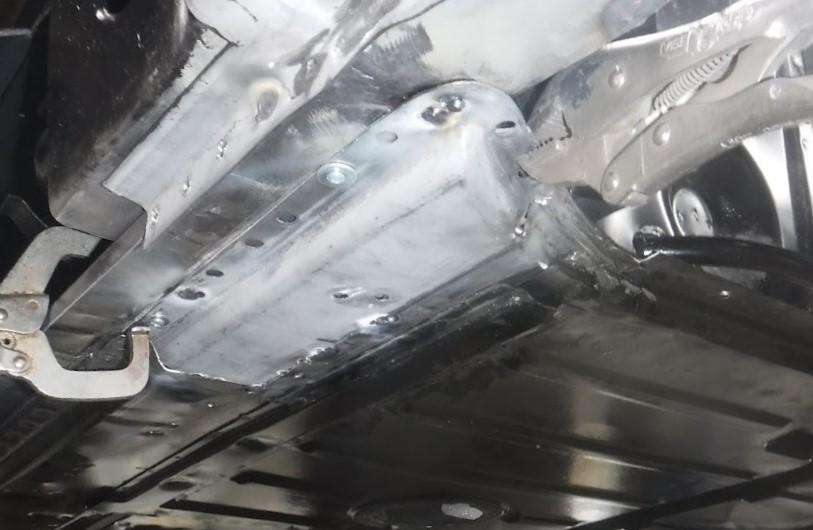

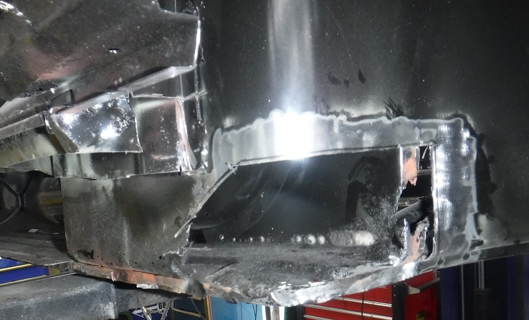

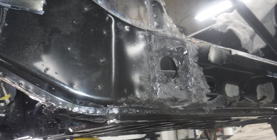

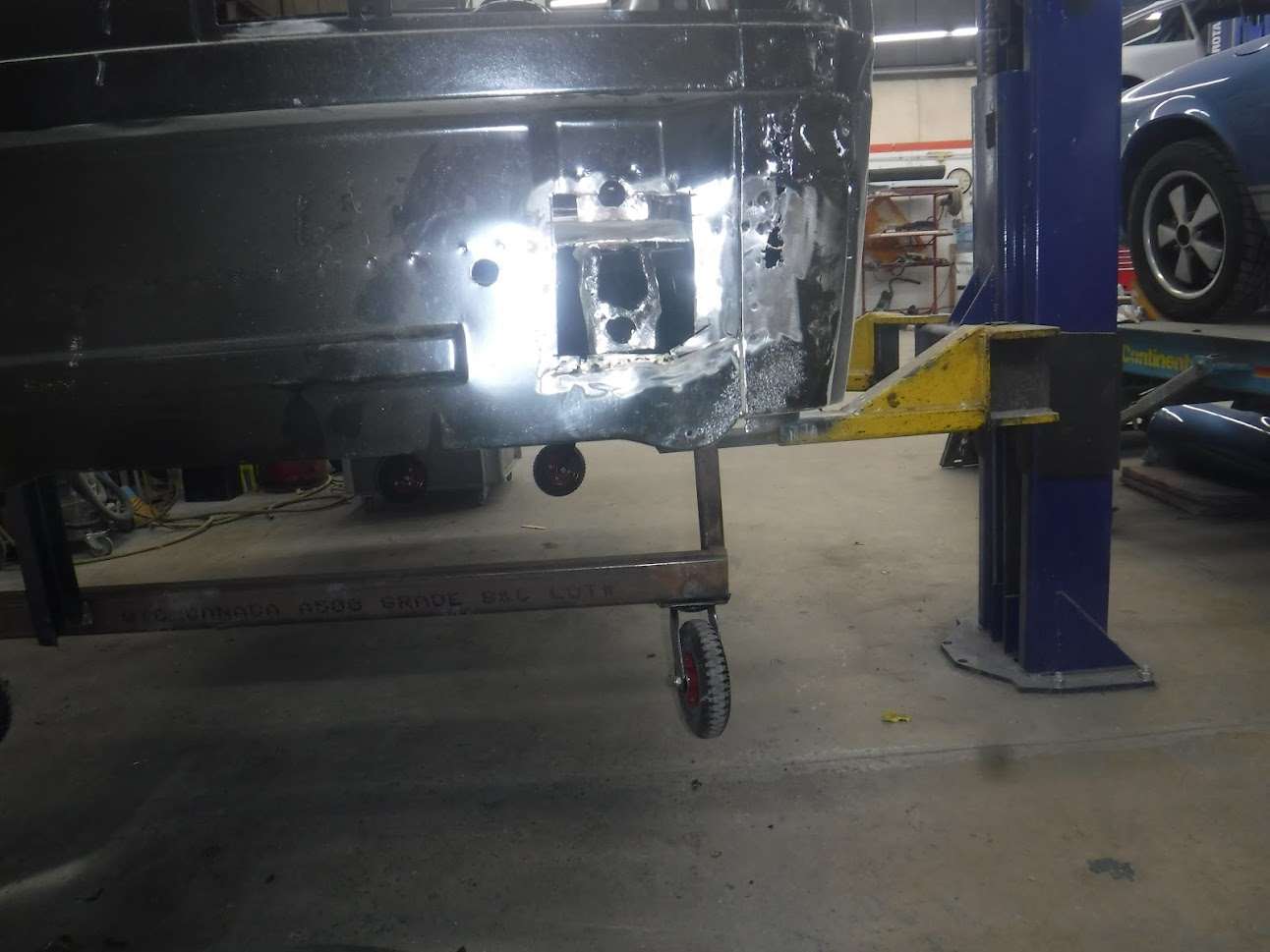

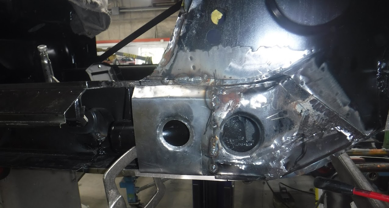

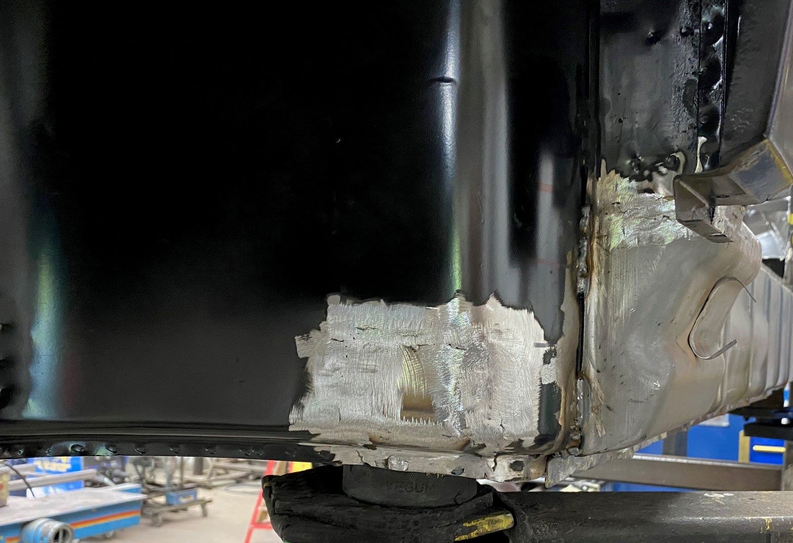

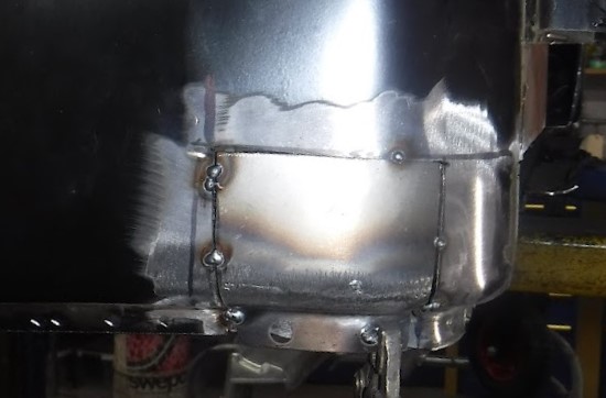

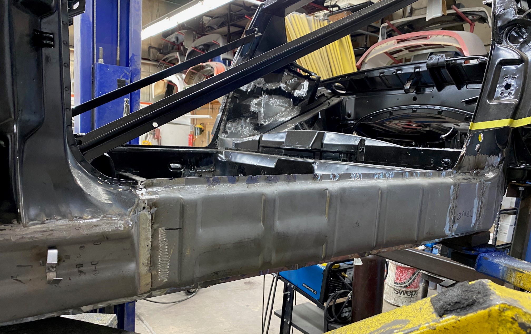

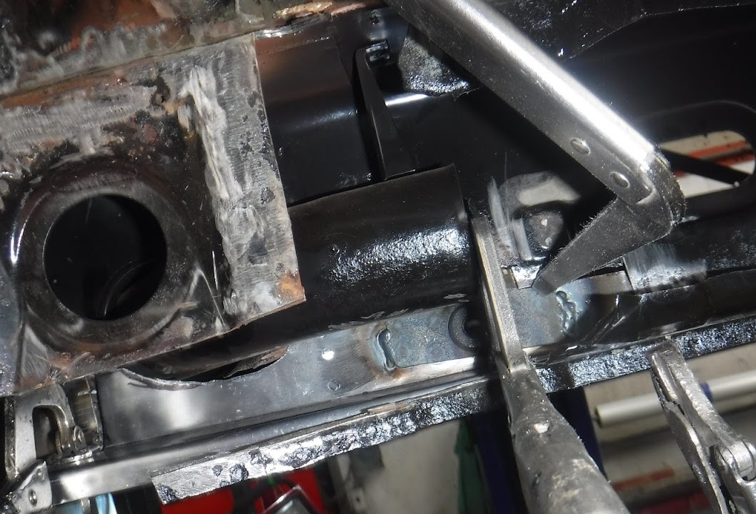

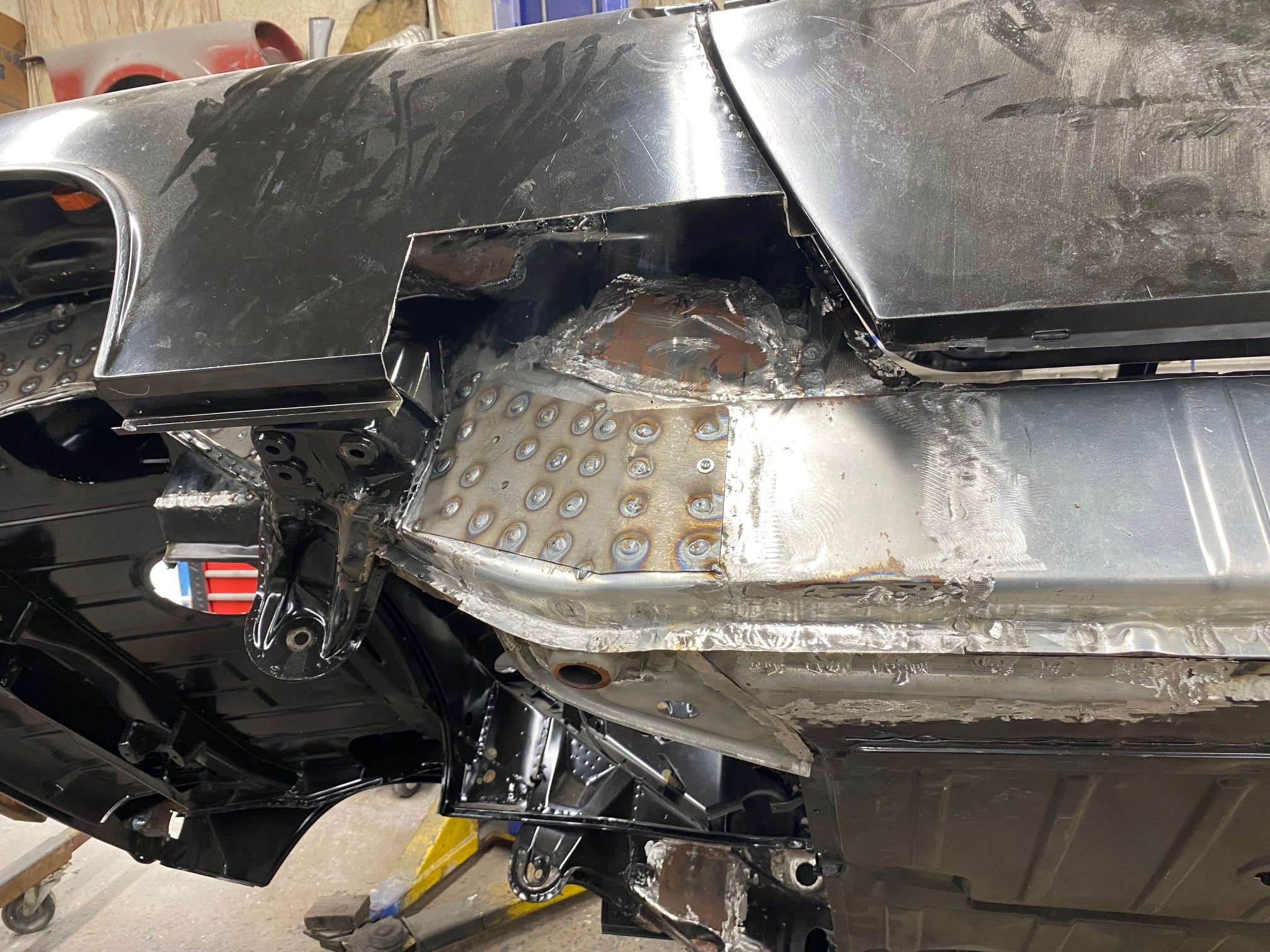

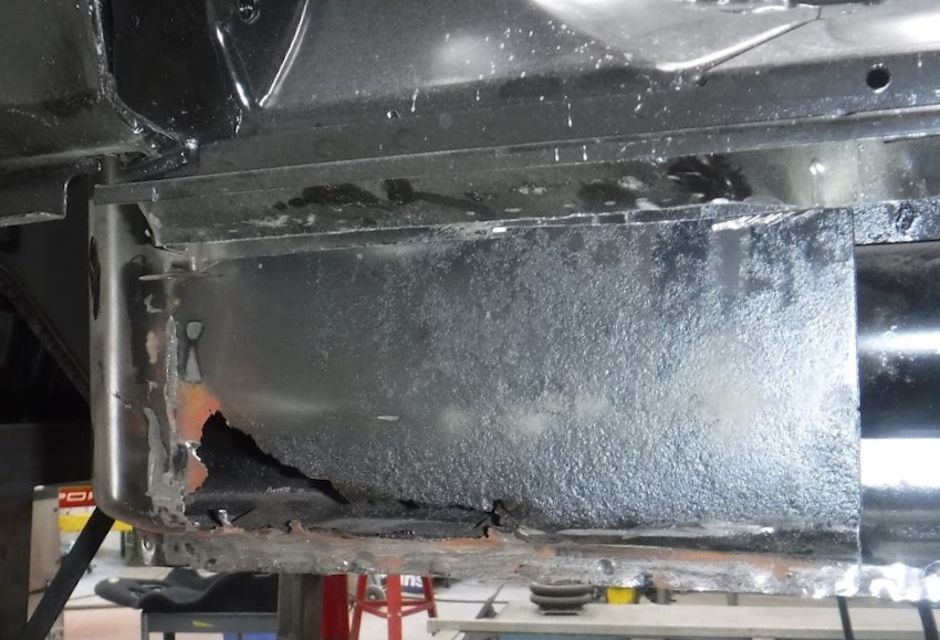

Rust repairs are continuing at Auto Associates. I thought it might be useful to post more detailed photos of the process. Here are repairs to the right front corner.

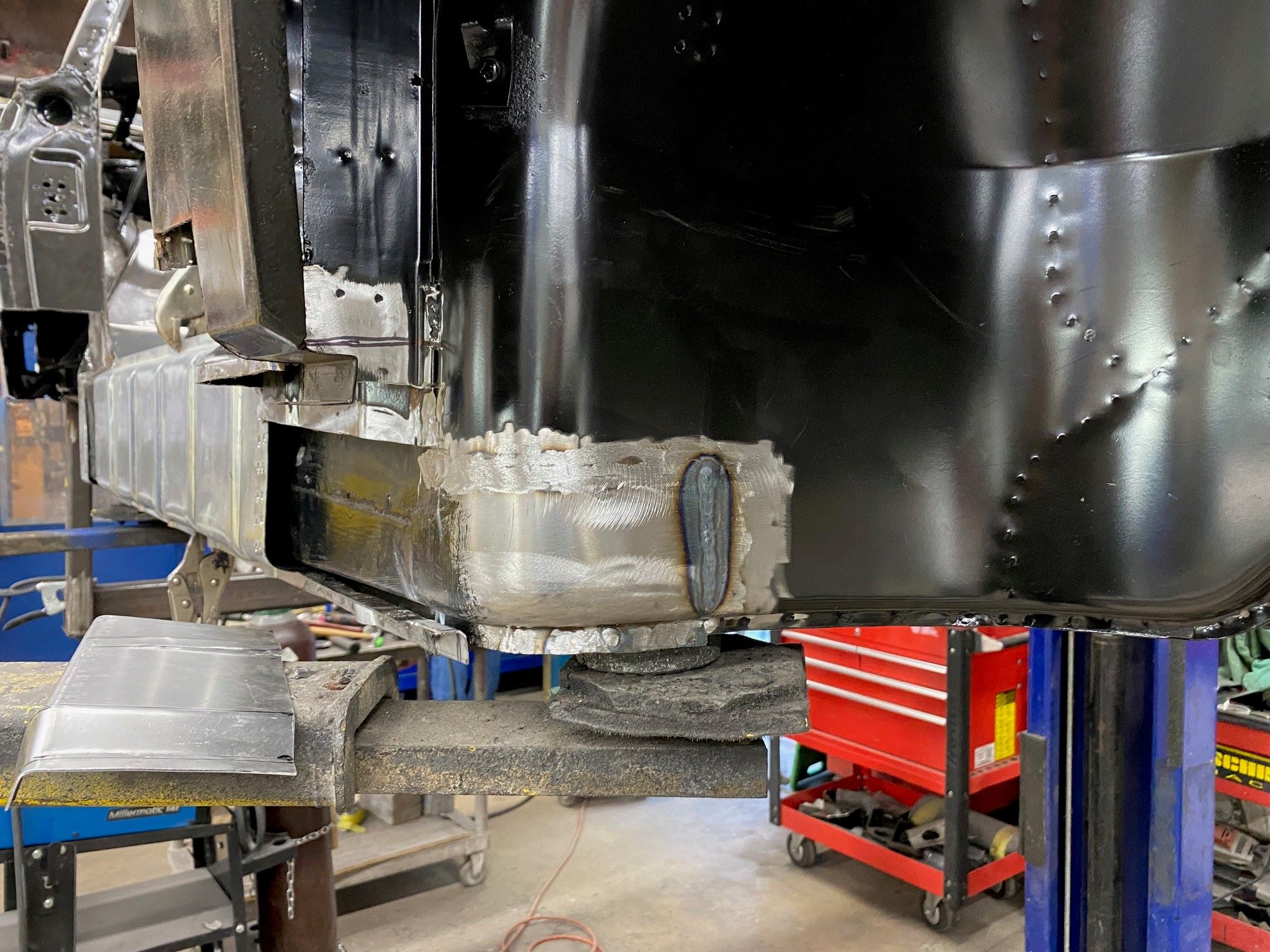

Tom1394racing

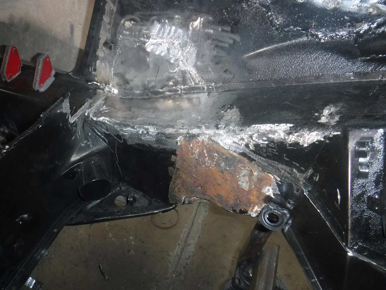

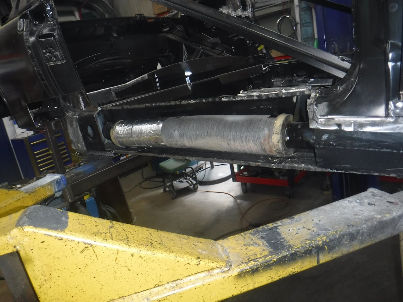

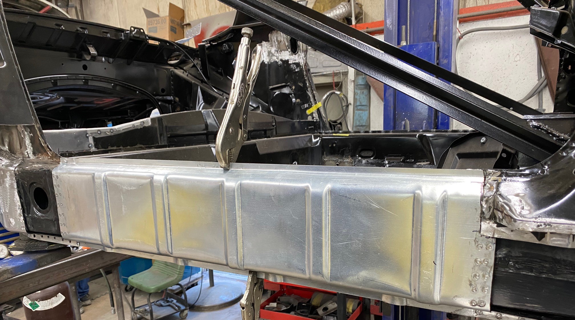

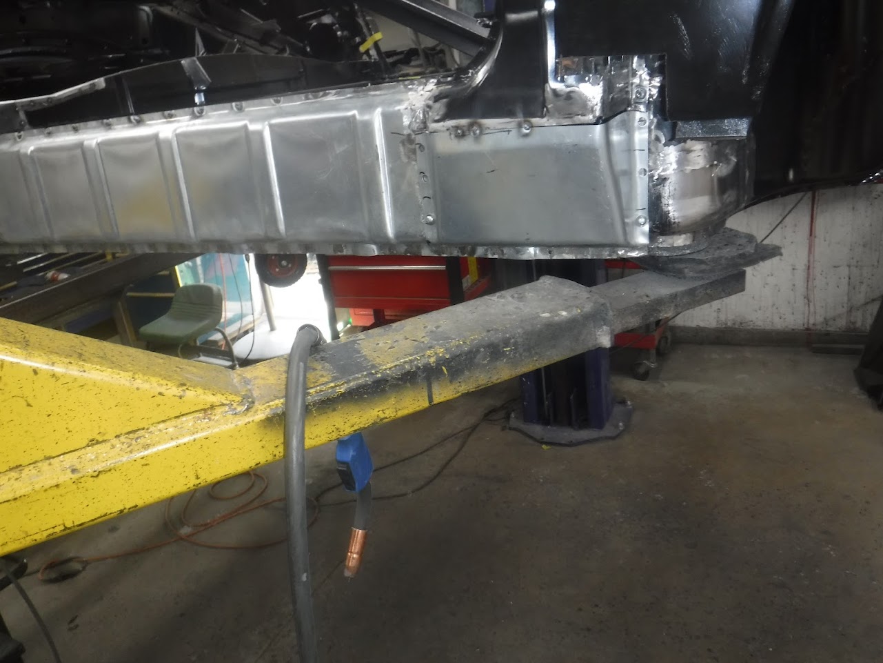

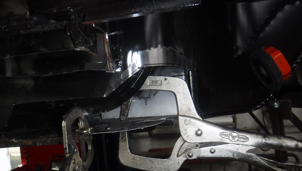

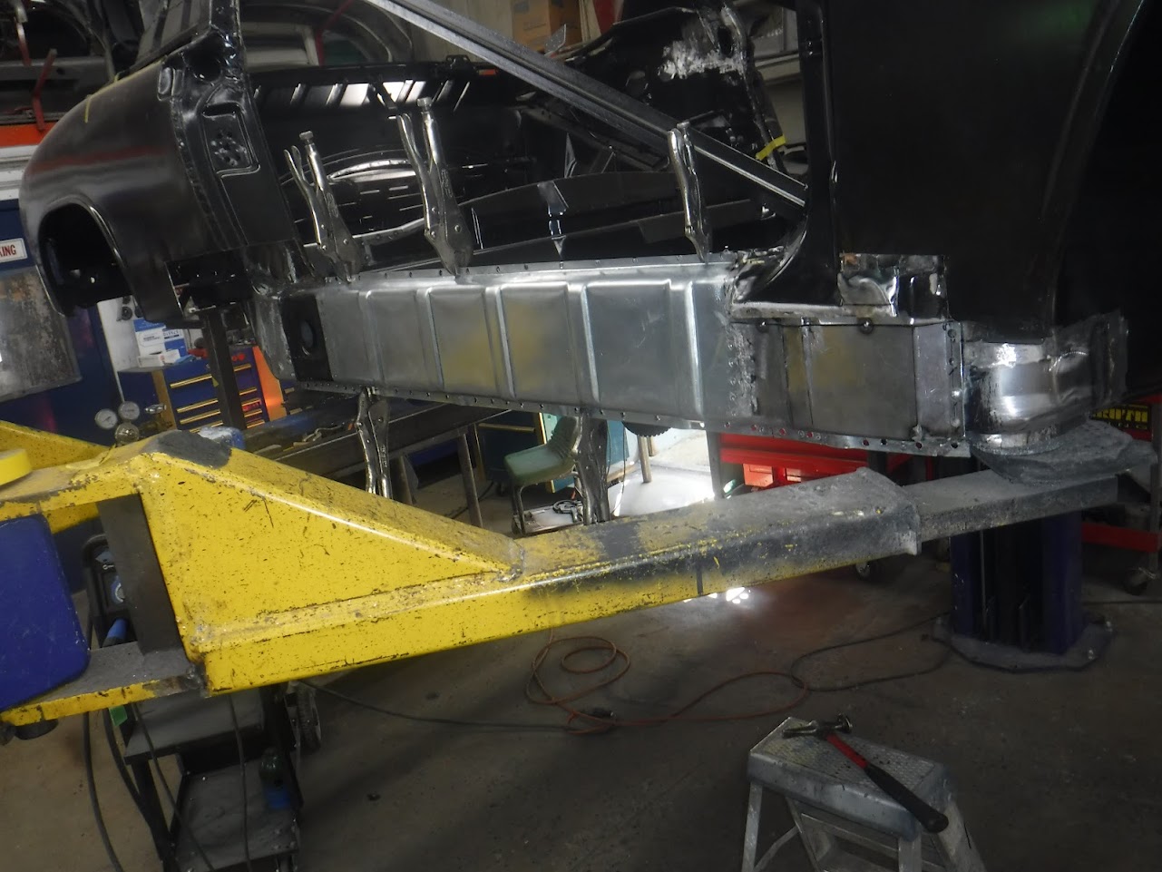

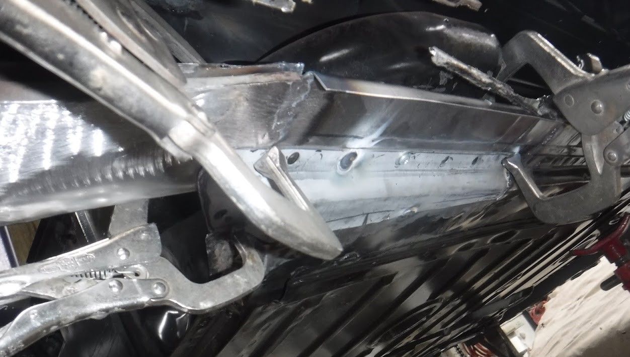

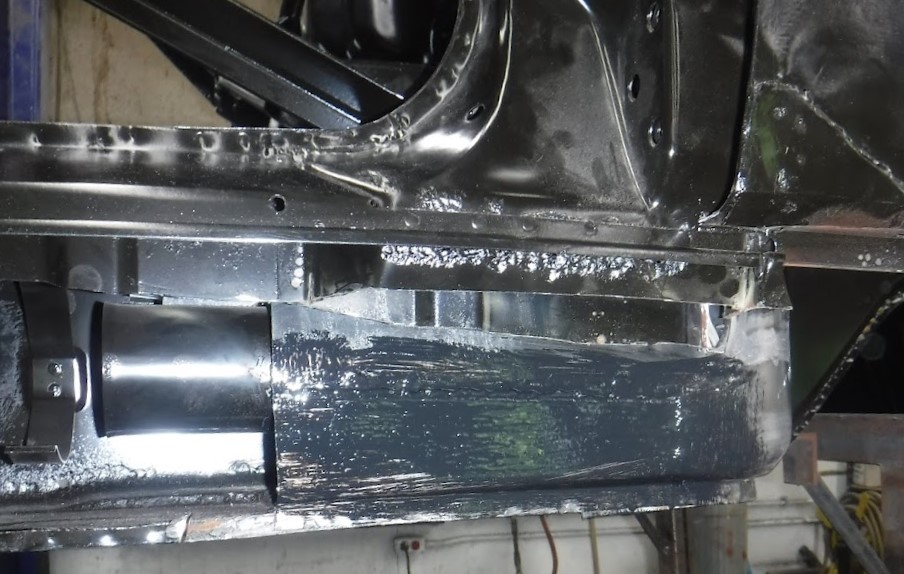

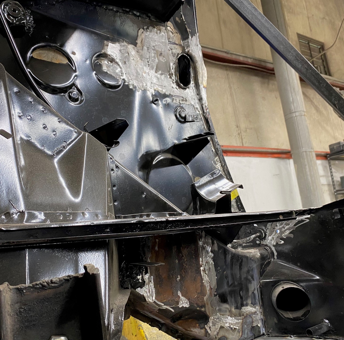

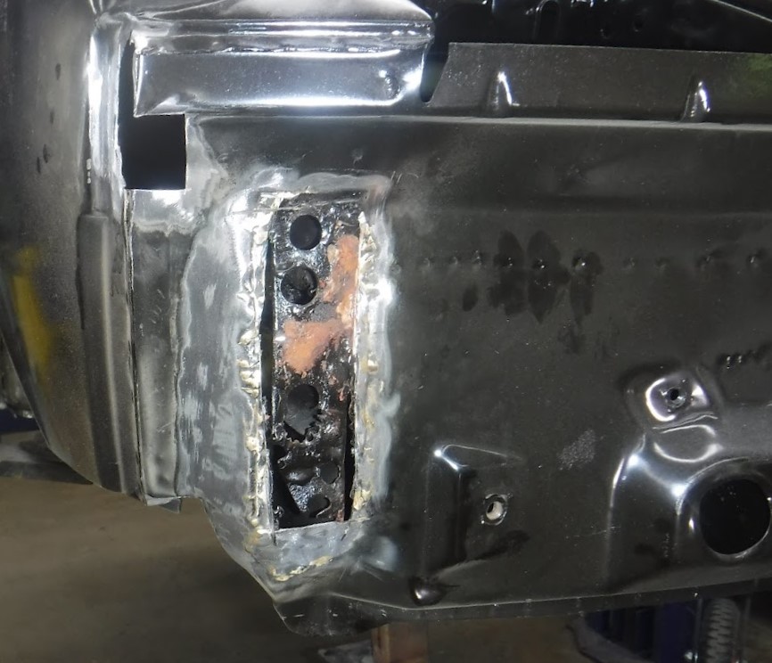

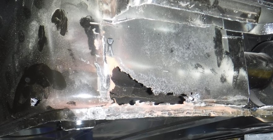

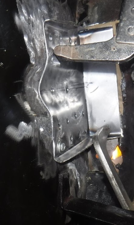

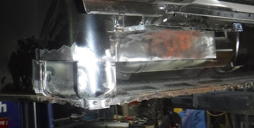

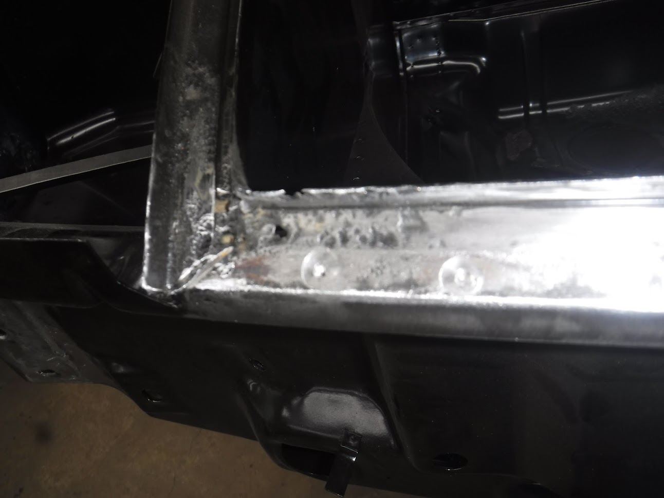

Here are the repairs to the RHS outer longitudinal.

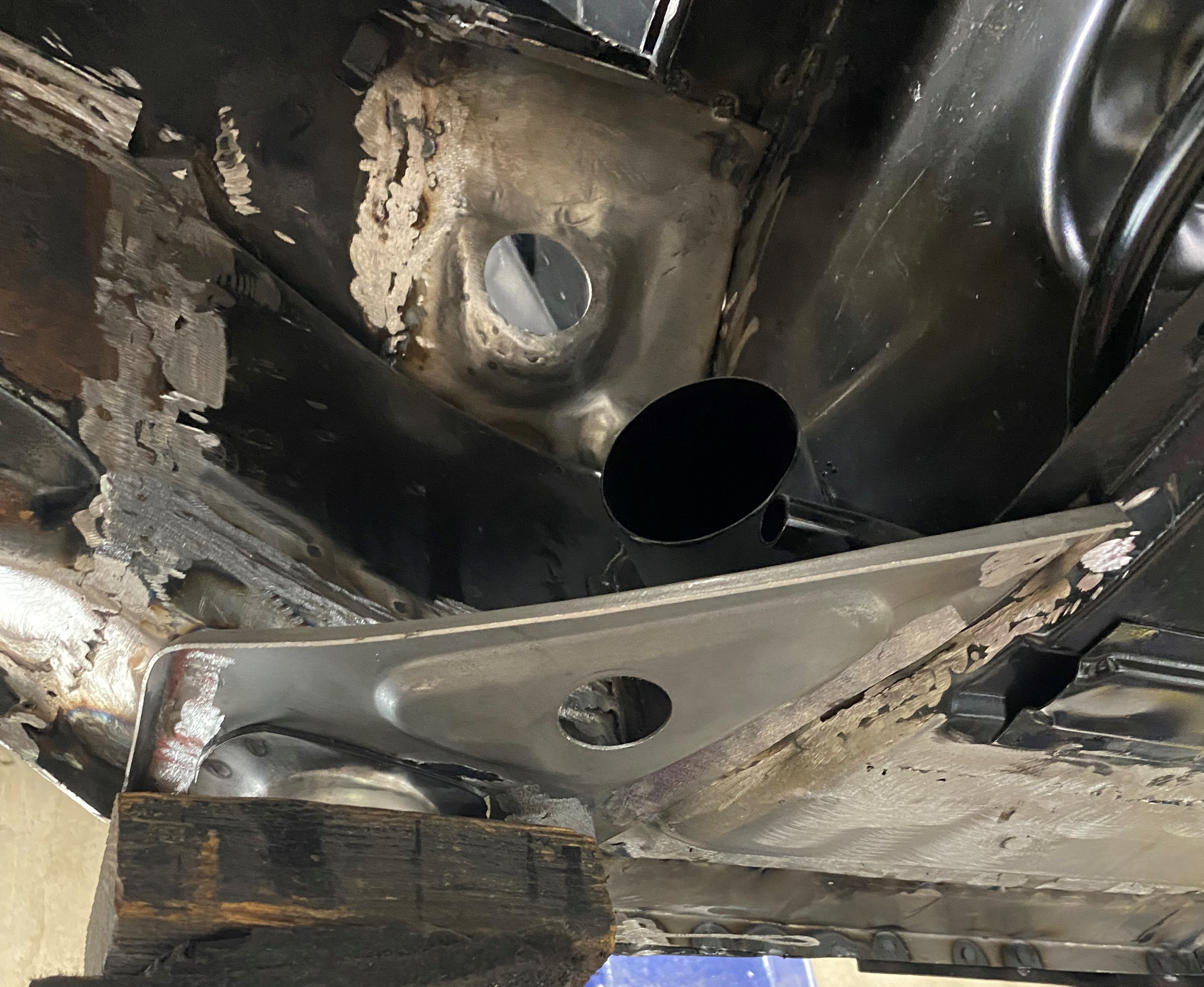

Tom1394racing

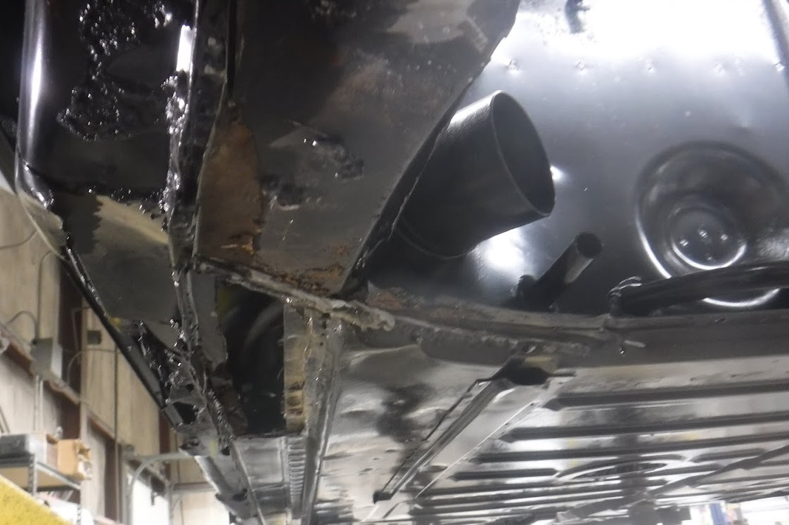

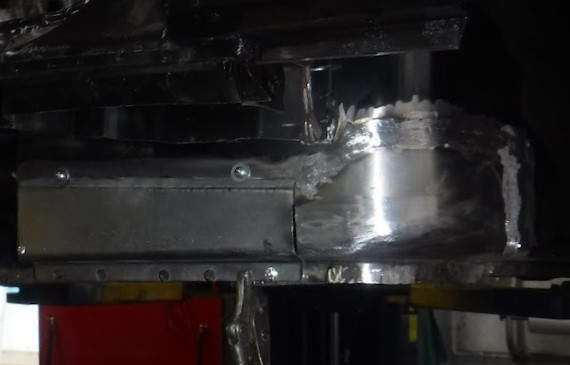

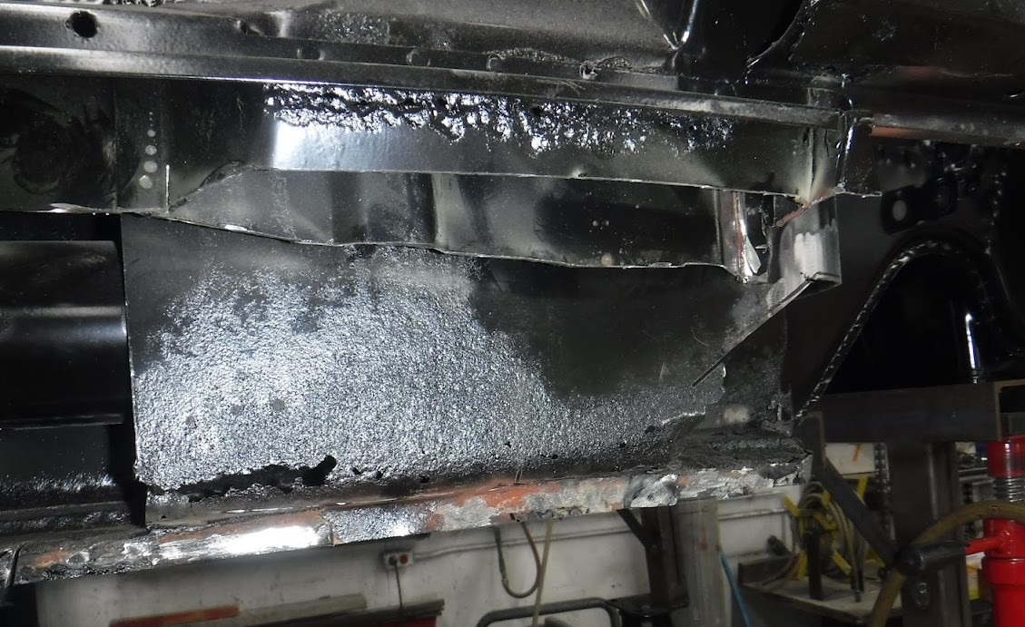

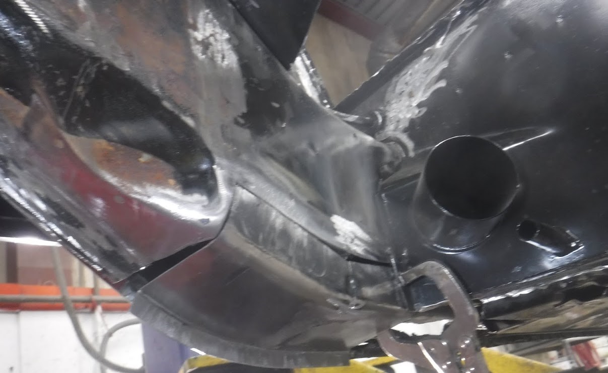

Here are the repairs/replacement of the rear floor jack points.
All of the prefabricated replacement panels used so far have been supplied by Restoration Desing and have fit nicely.

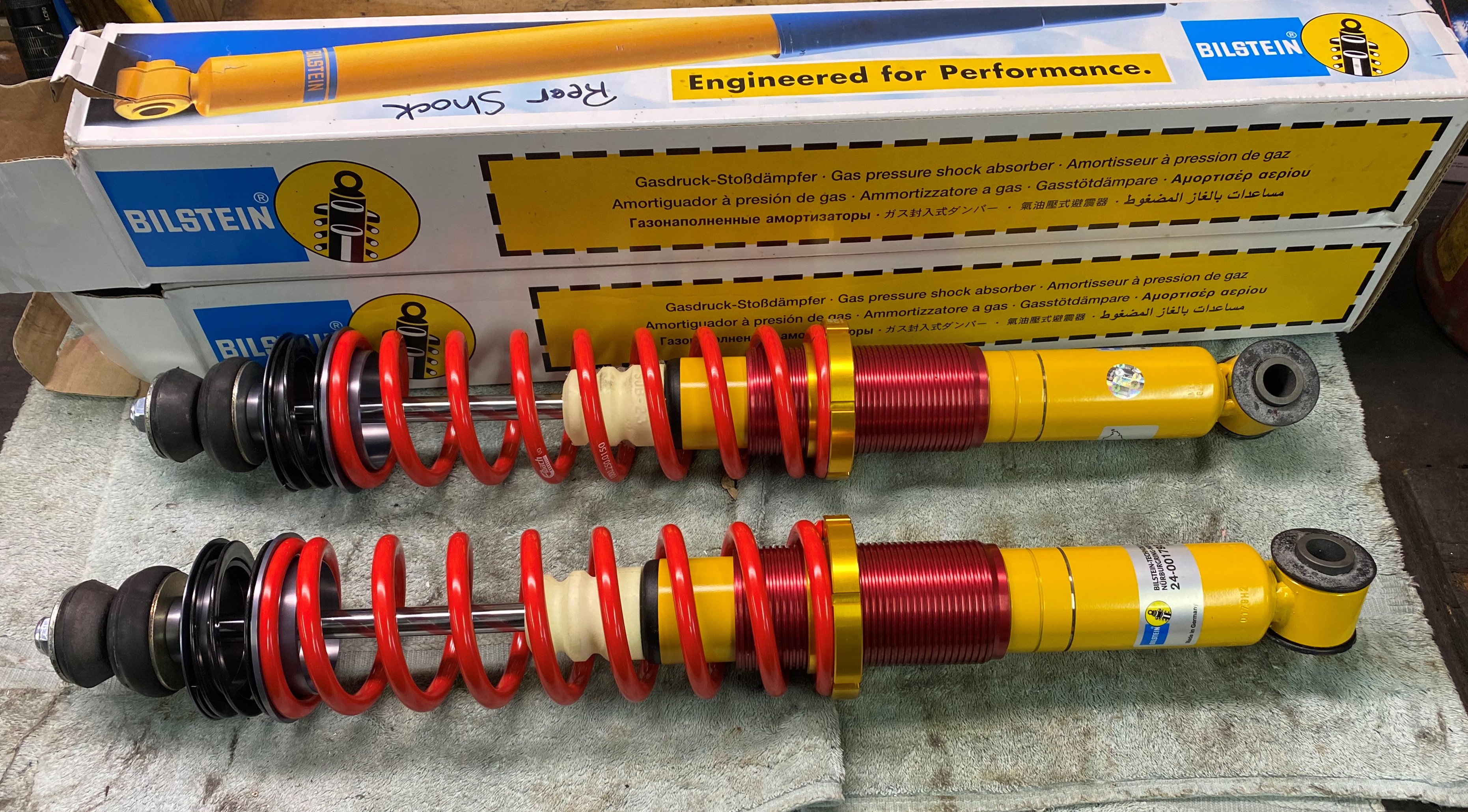

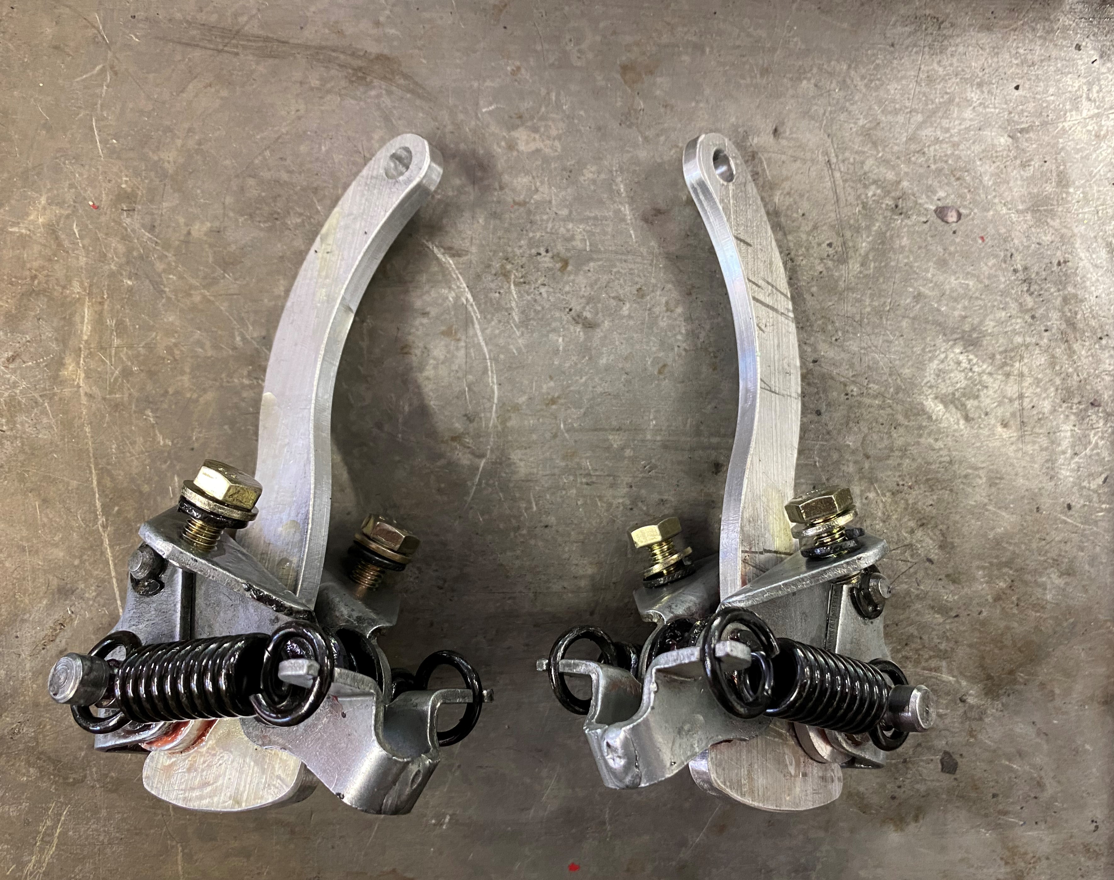

While the chassis rust repair has been ongoing, I have been restoring and procuring the mechanical bits.
Rear springs and shocks. Ground Control adjustable 150 lb coil overs with helper springs and Bilstein HD's
Tom1394racing

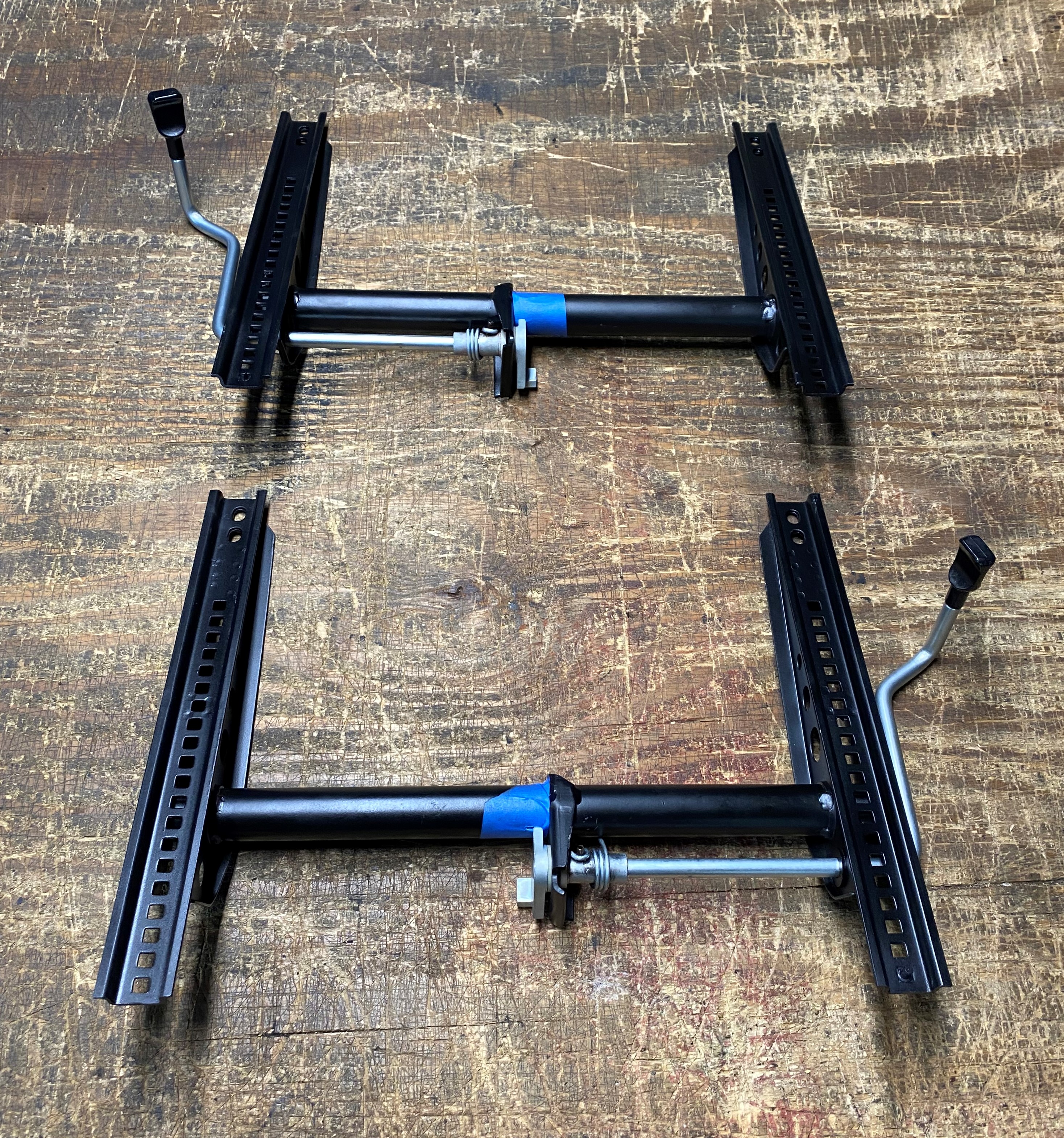

Restored seat rails.
Tom1394racing
Restored pedal cluster.
Tom1394racing

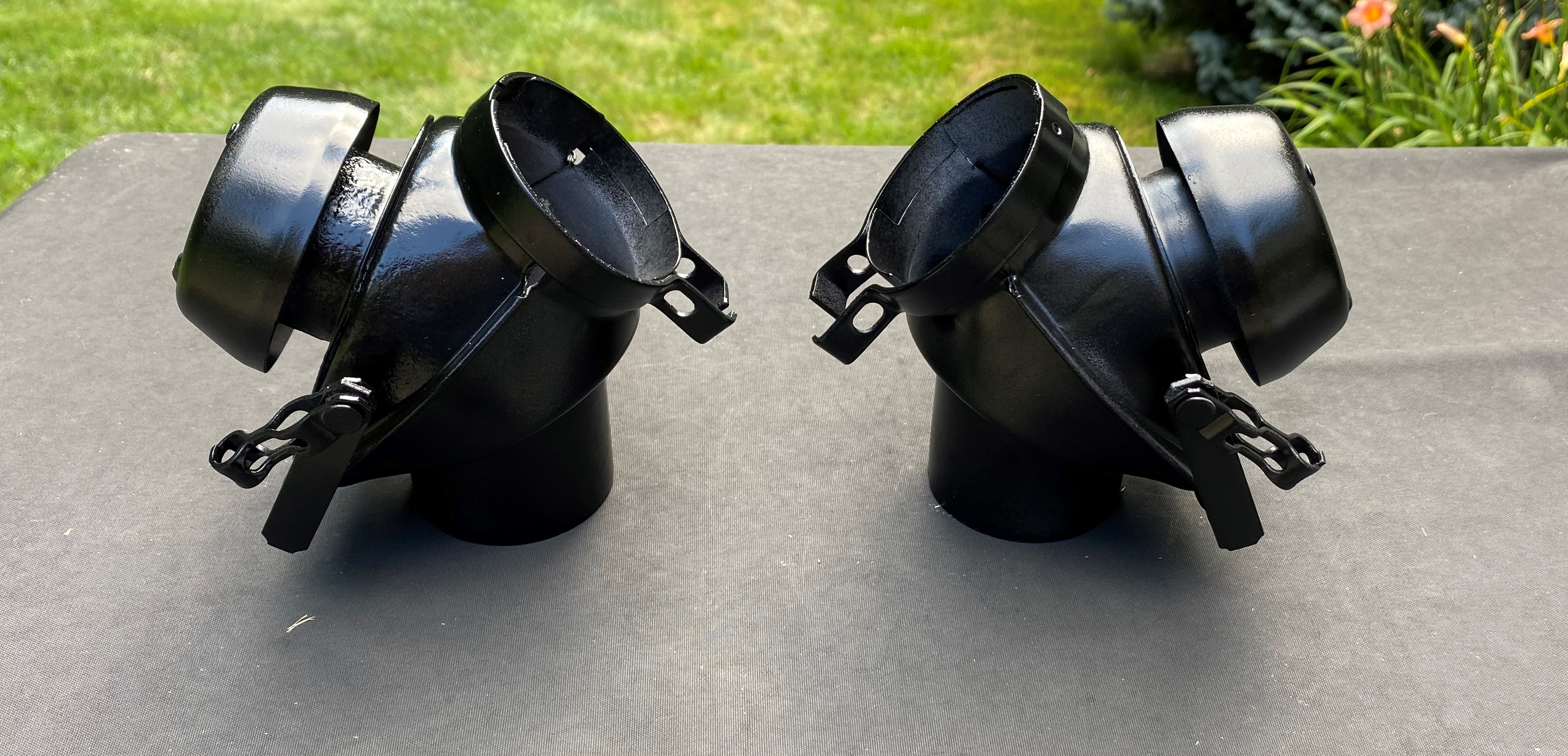

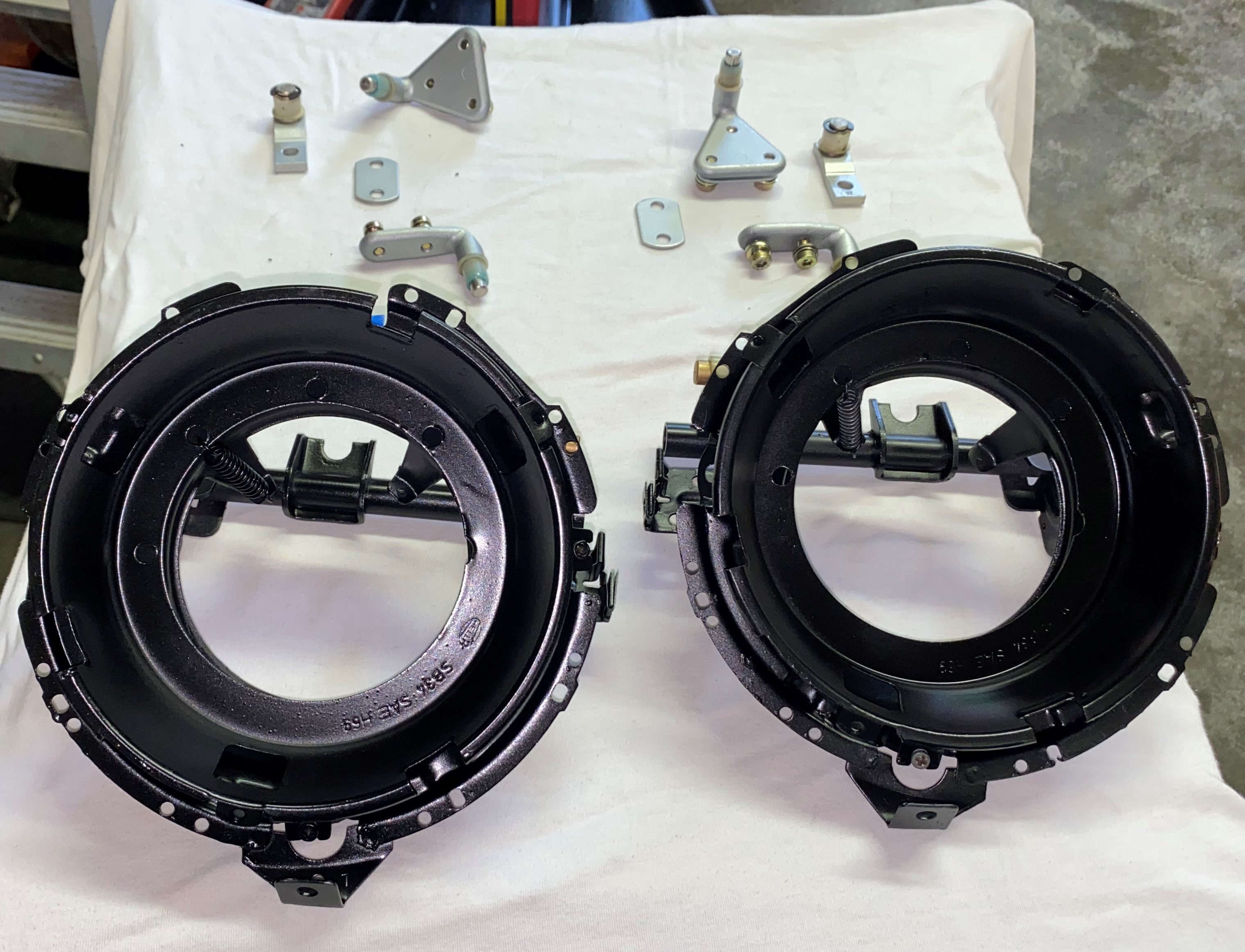

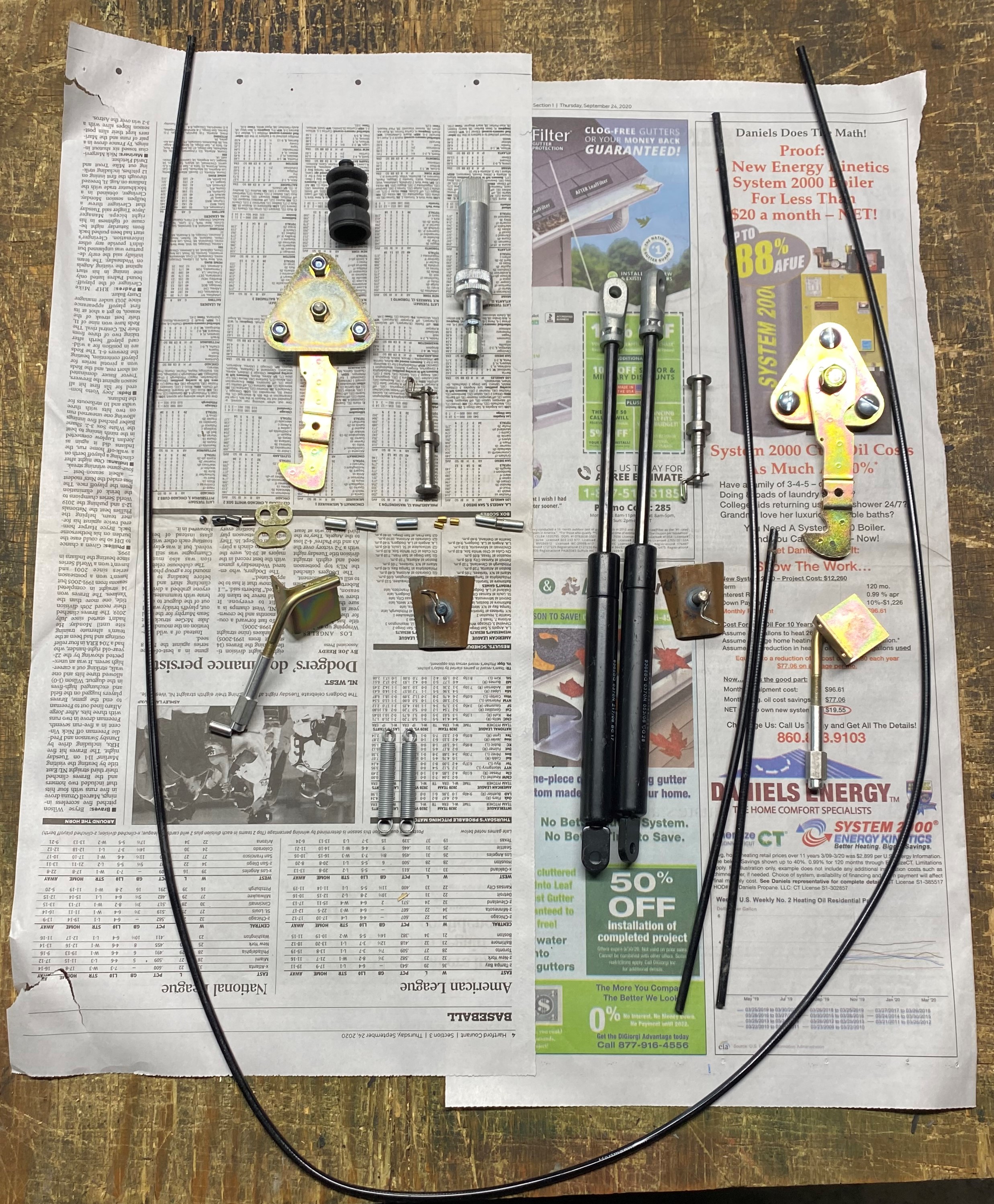

Restored headlight buckets with MittleMotor GT release kit. Auto Associates will do the welding and cutting and test fit in the headlight area before paint.
Tom1394racing
Door stops restored with hardware kit.
Tom1394racing
Bilstein front strut with HD inserts and PMB restored early S calipers.

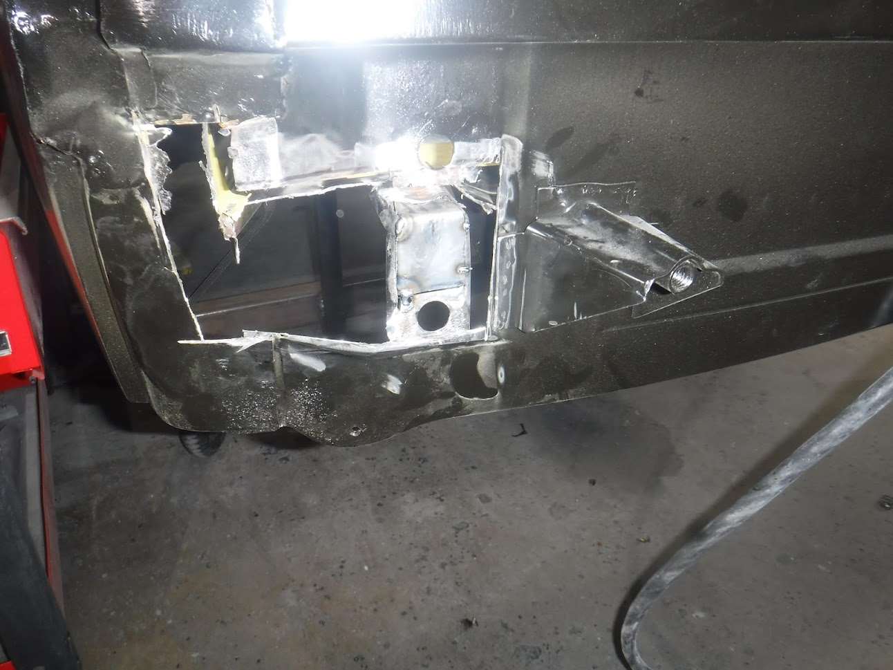

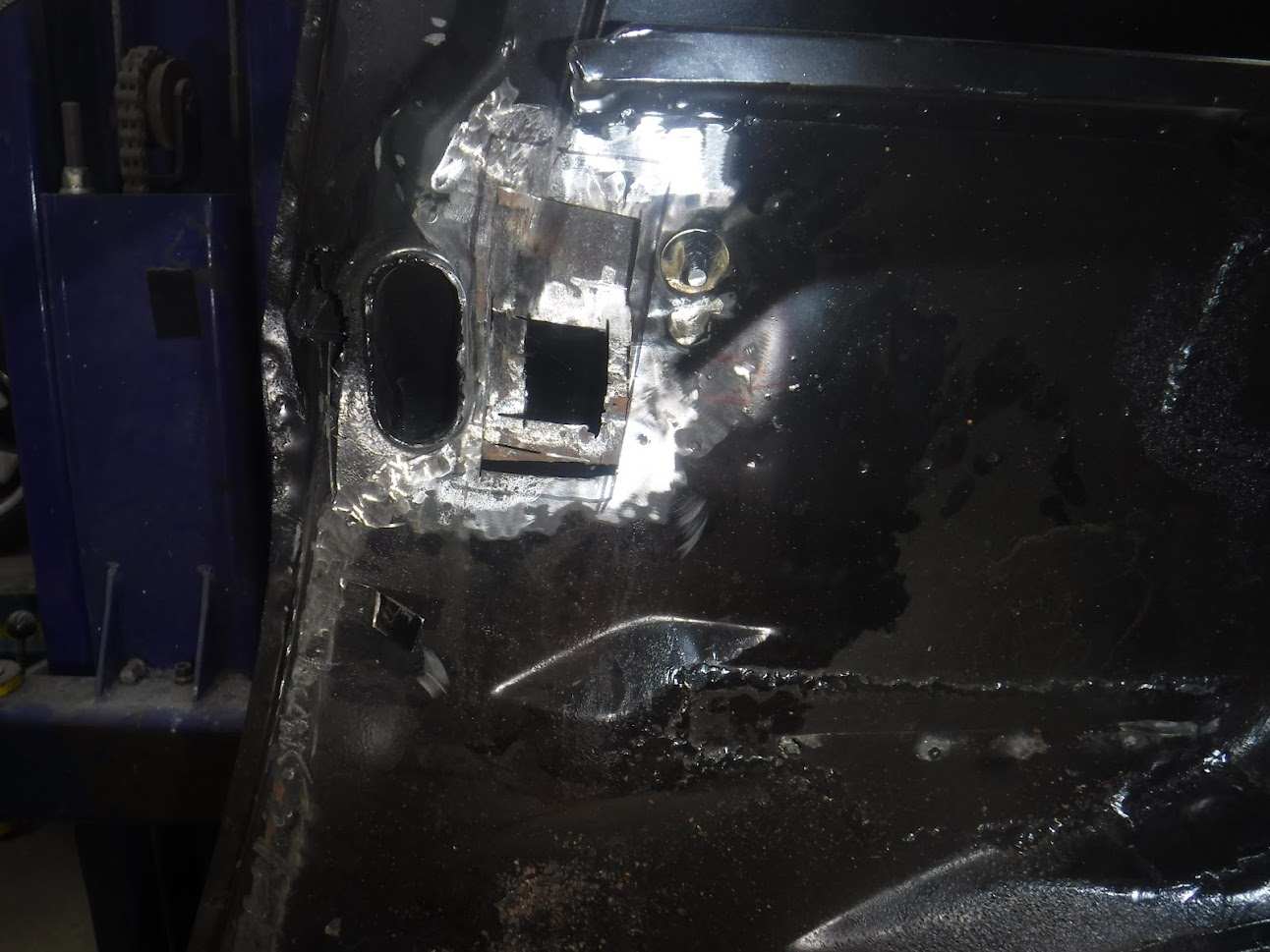

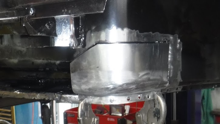

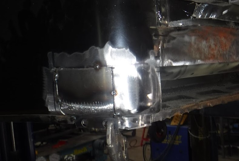

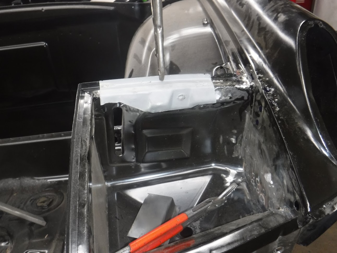

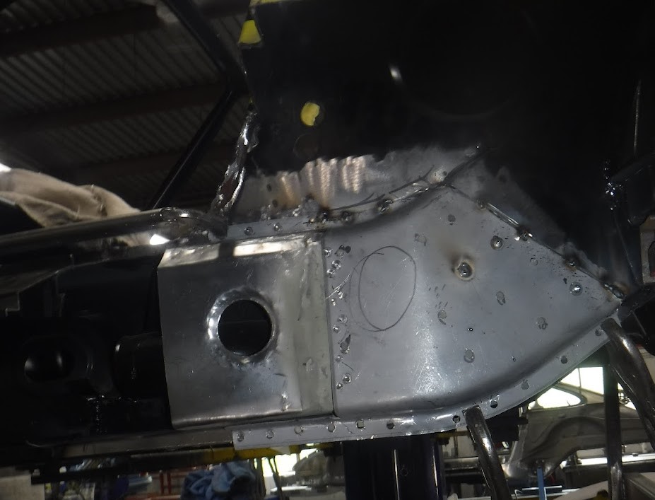

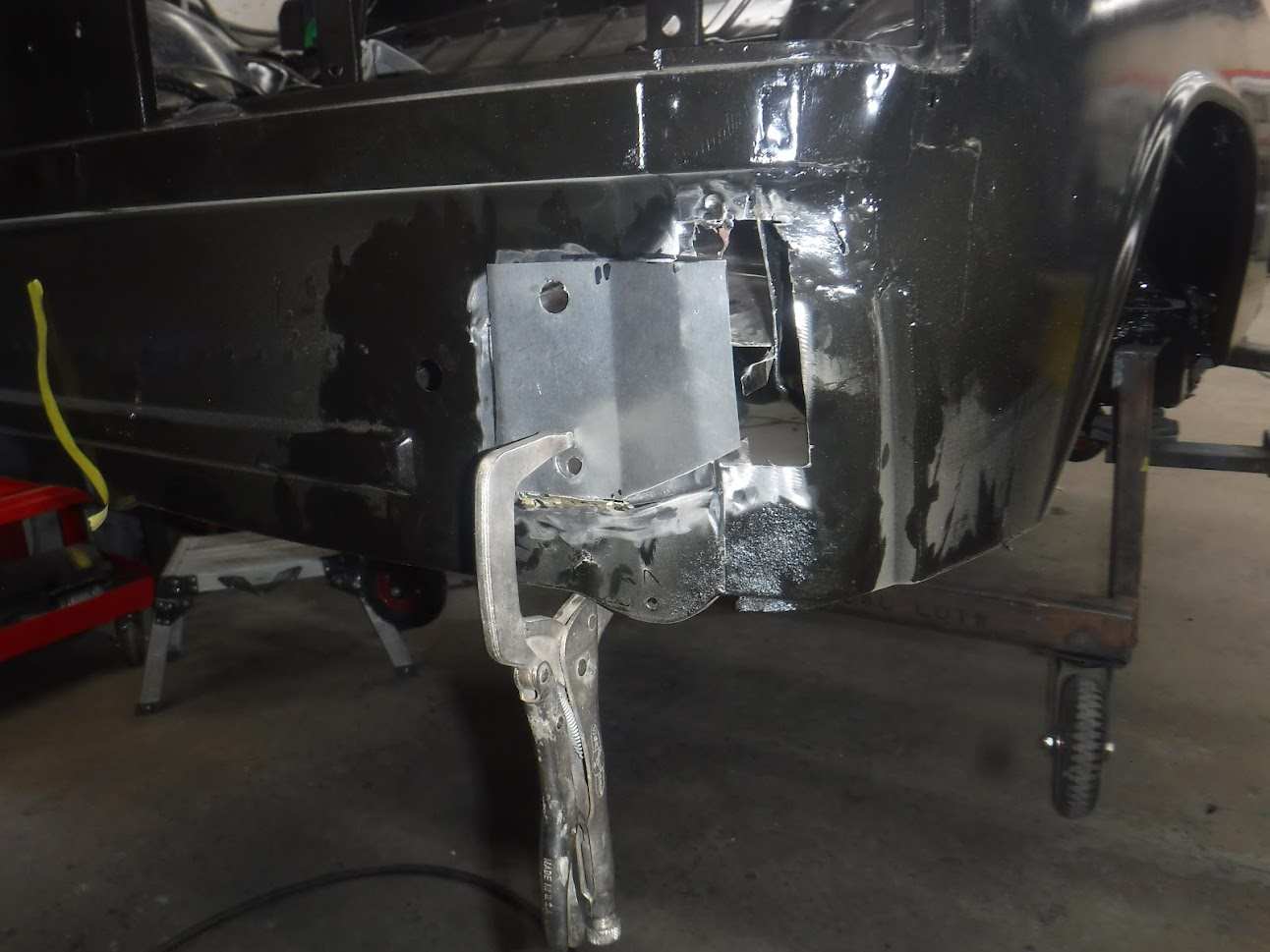

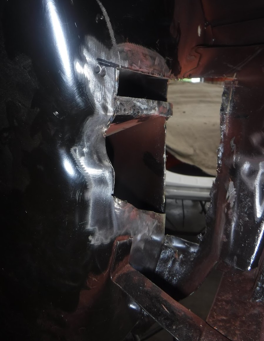

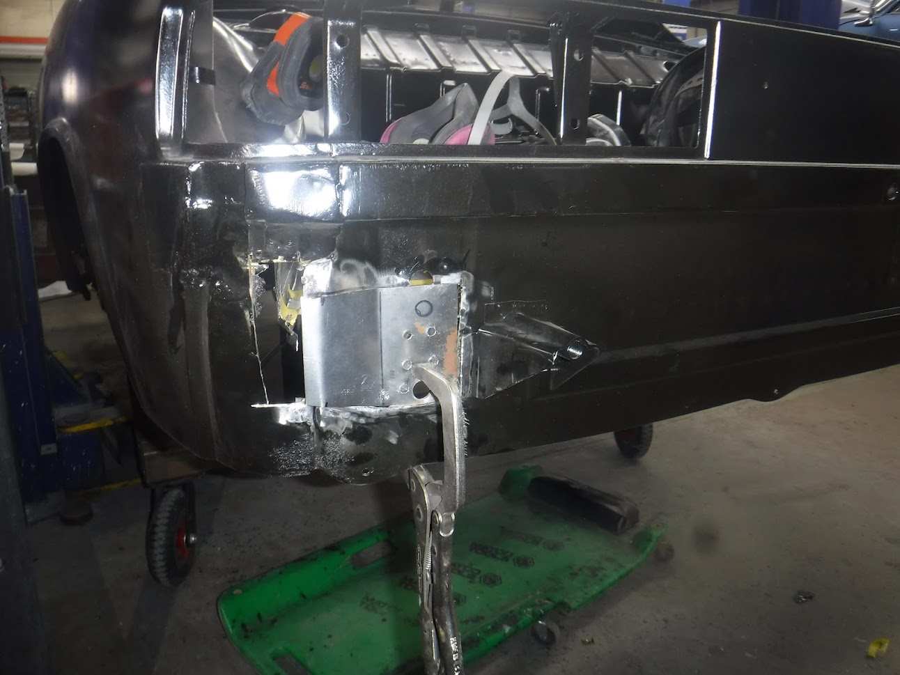

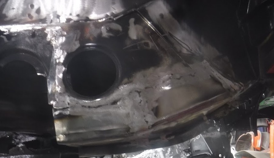

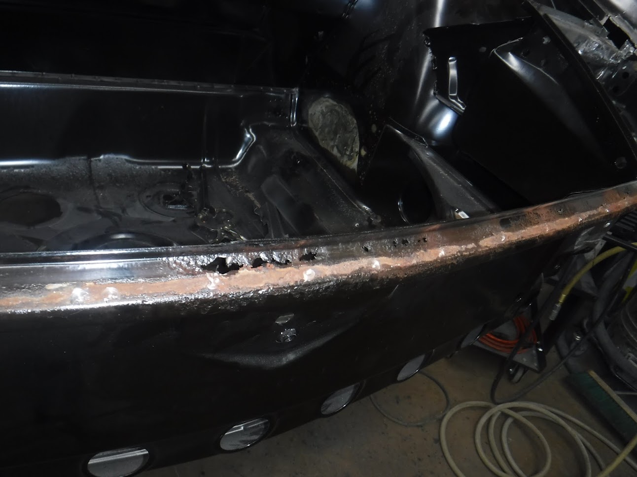

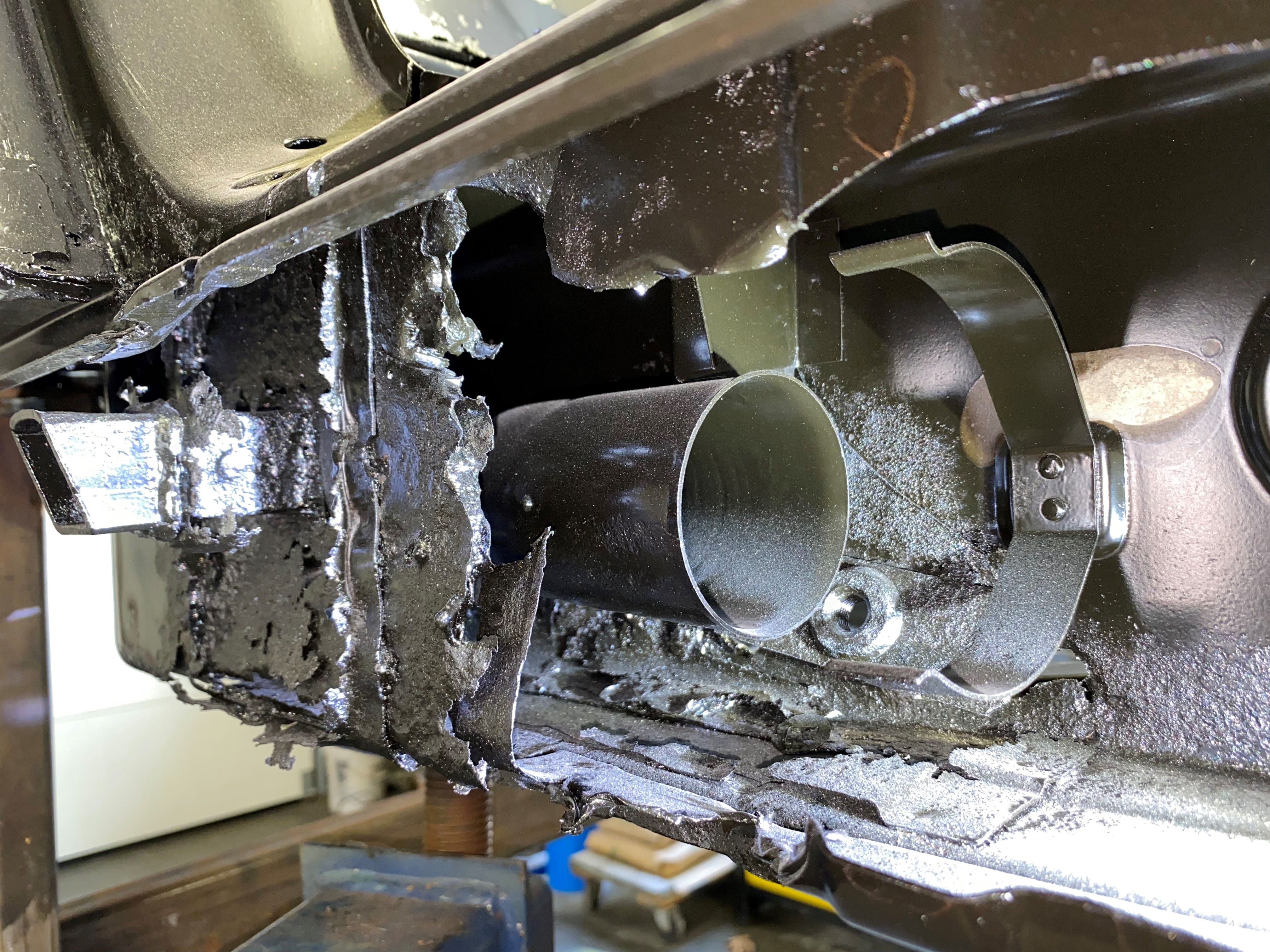

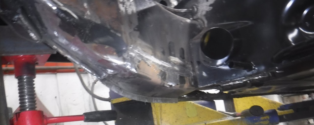

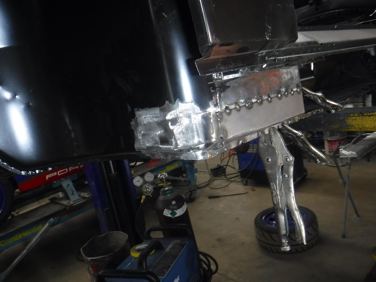

Rust repairs are continuing at Auto Associates. Here is the repair of the L/F bumper support.
Tom1394racing

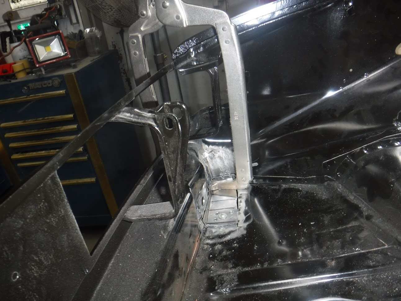

Tom1394racing

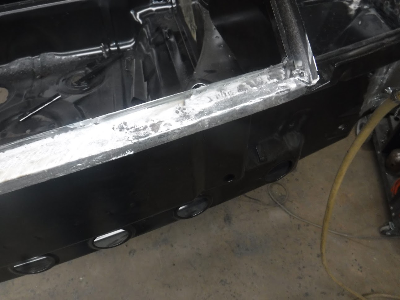

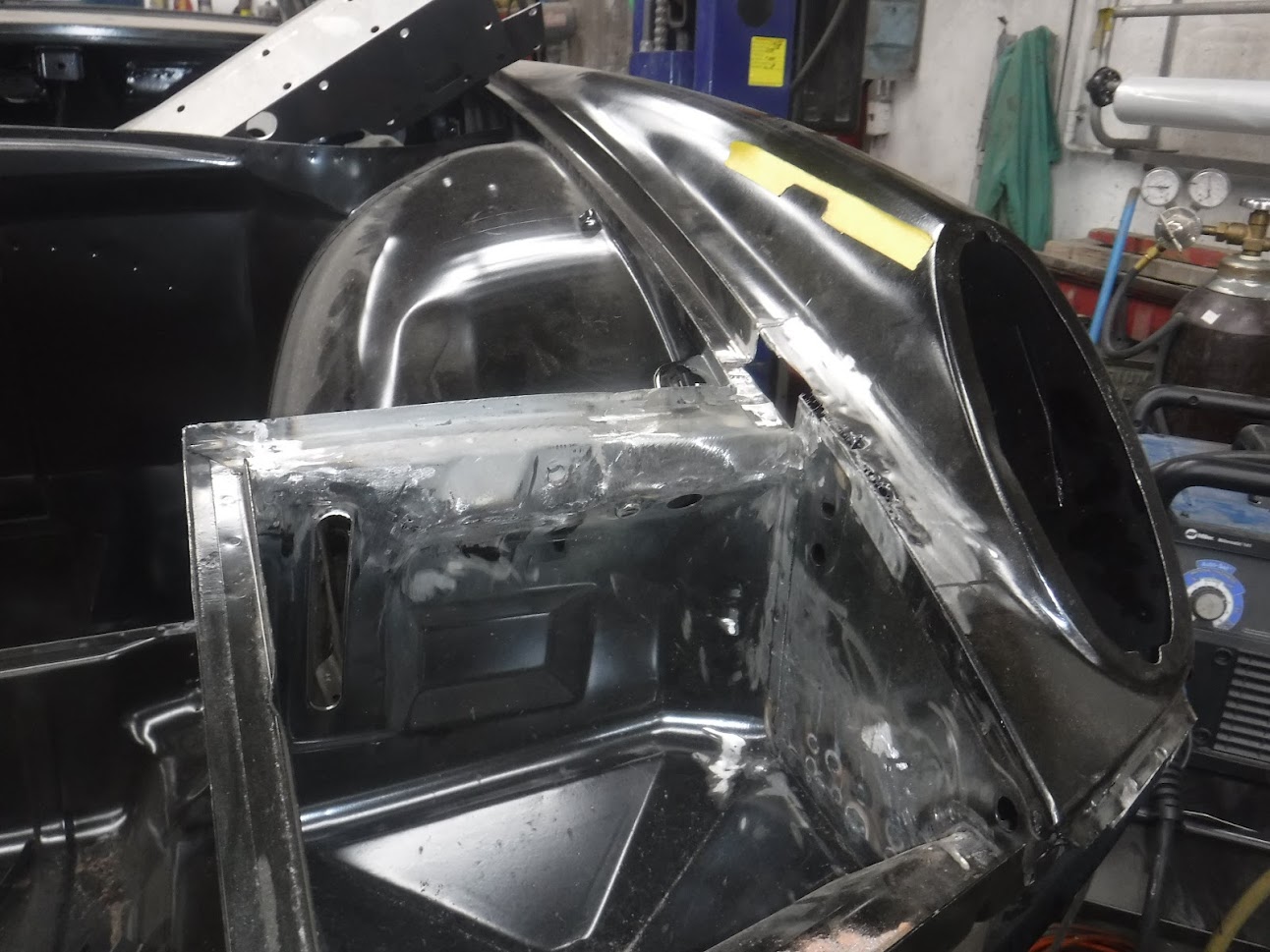

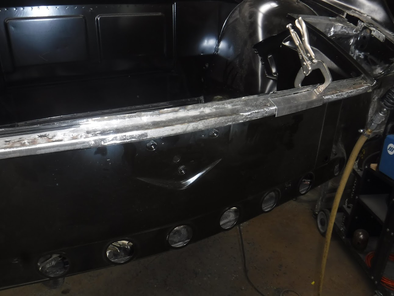

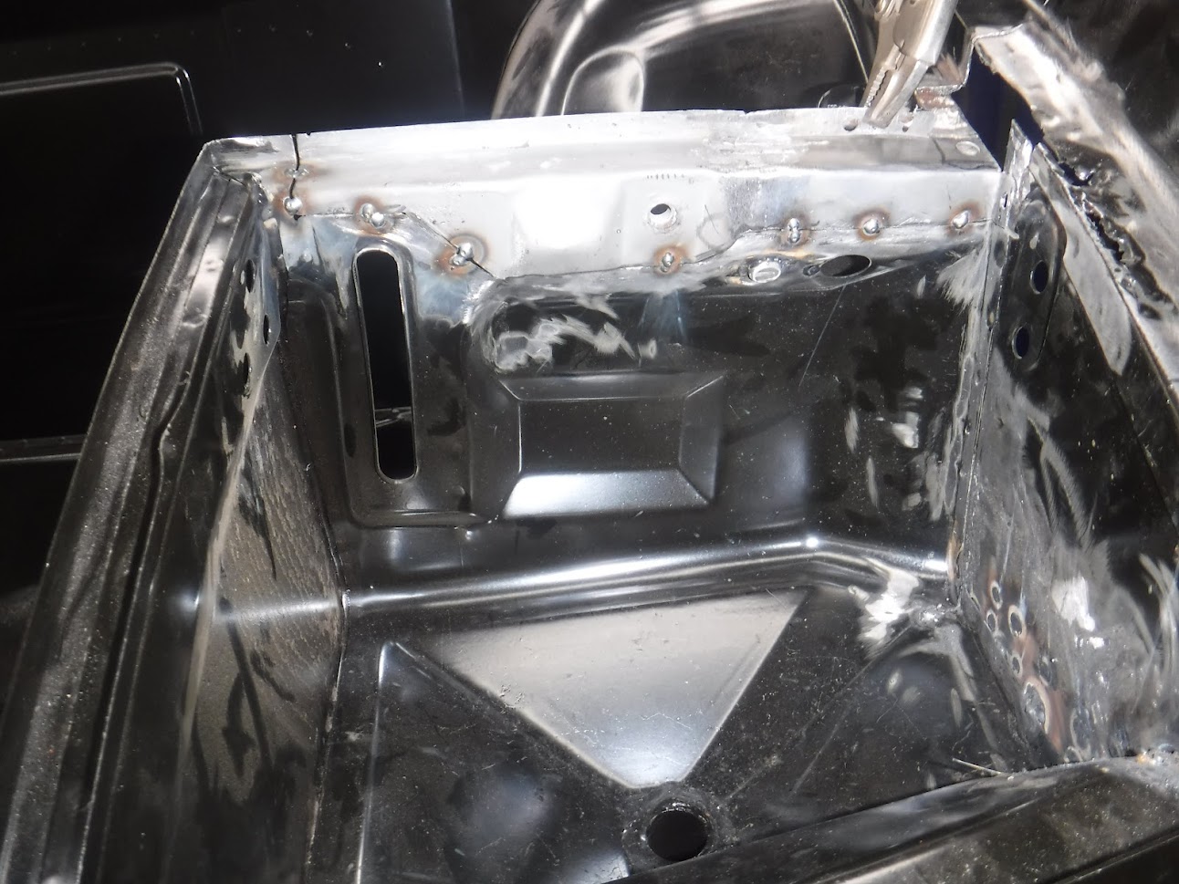

The front lid headlight and trunk seal channels also needed repair. Here is the L/F headlight seal.
Tom1394racing

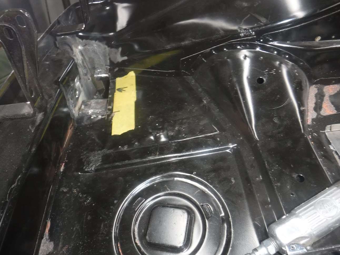

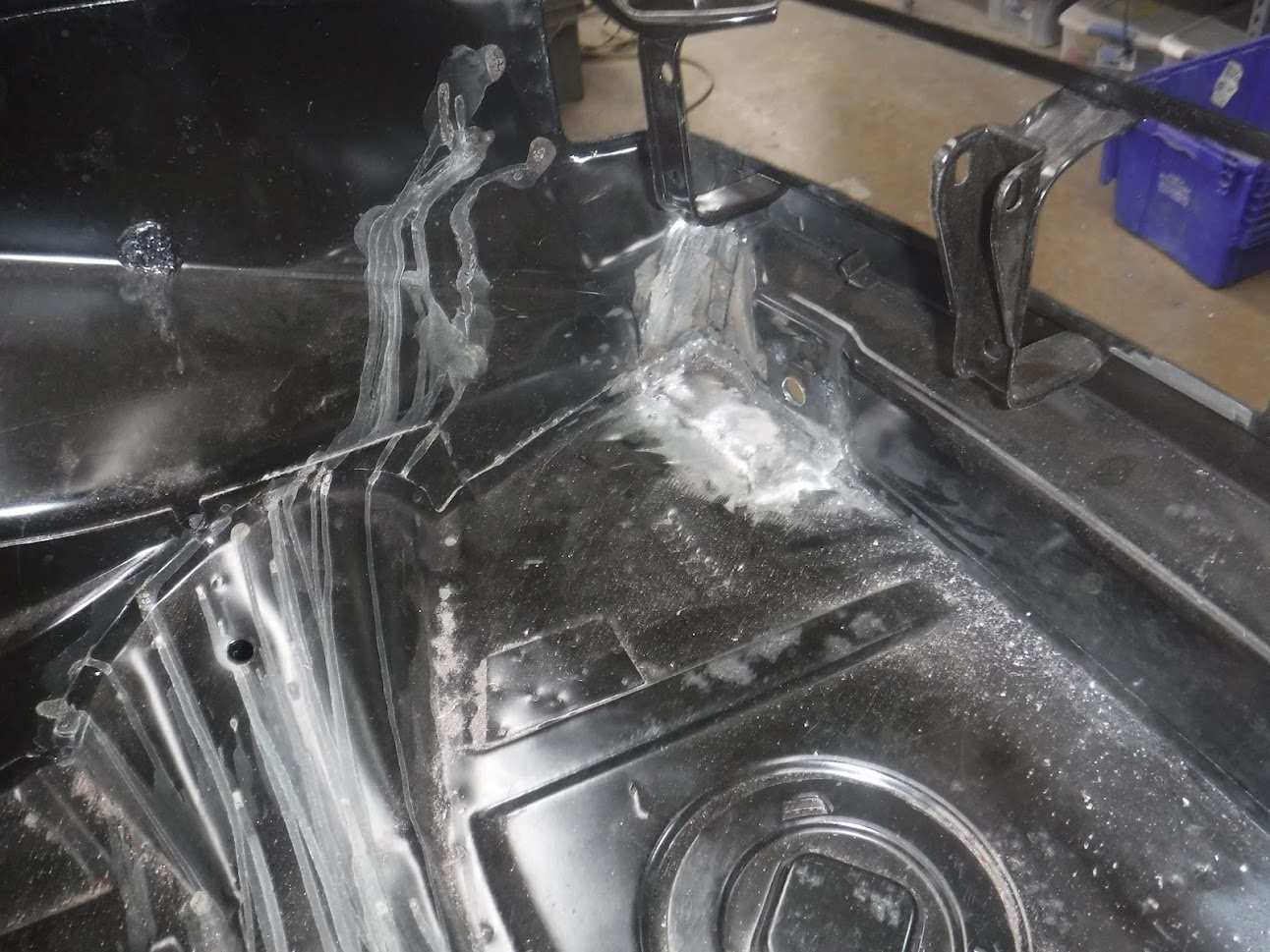

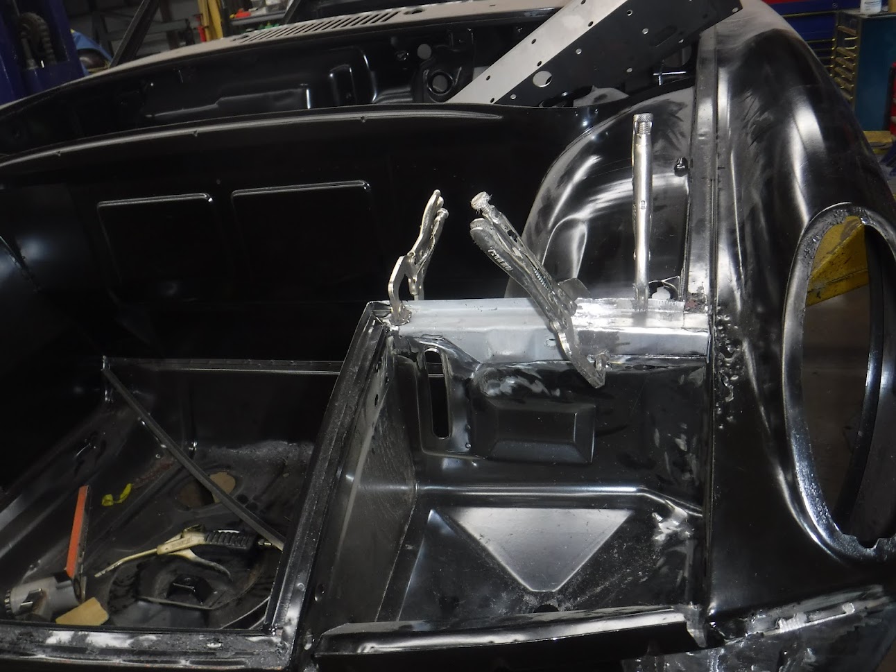

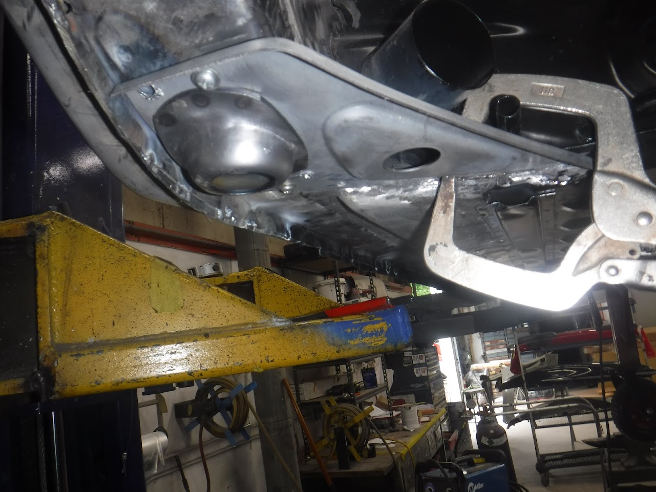

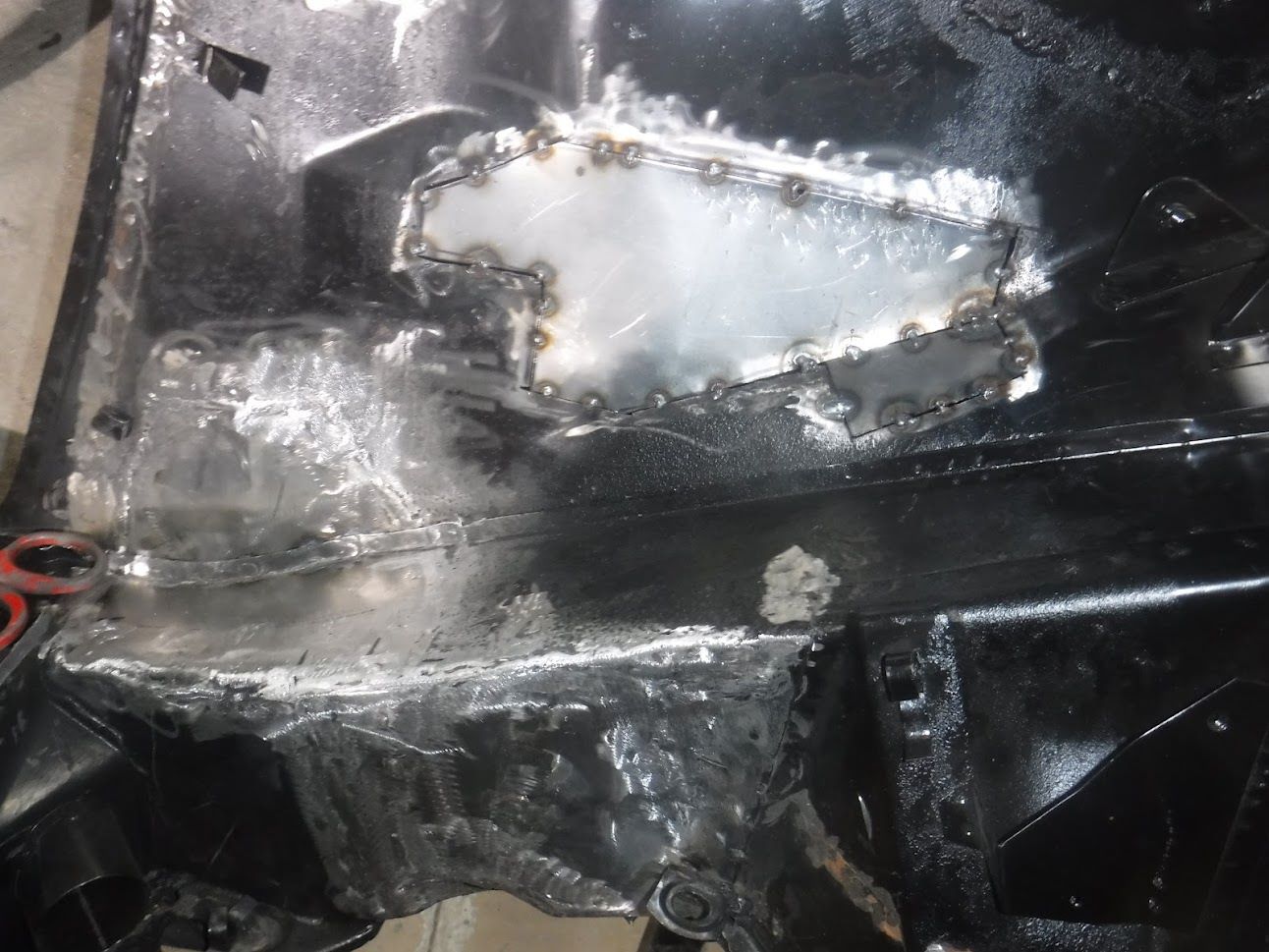

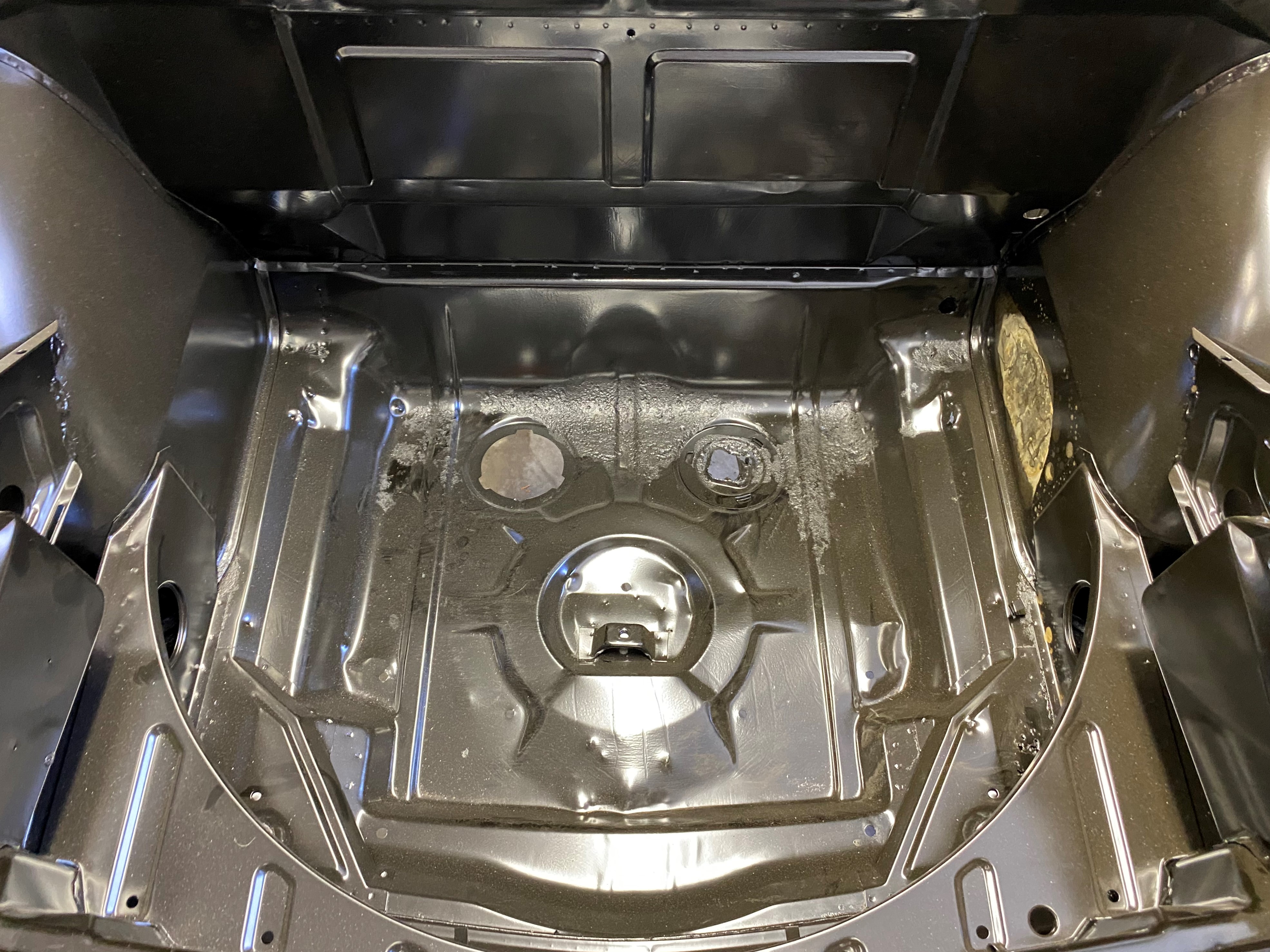

Also, the rear floor in the front trunk compartment needed replacement.

Nice job on those bumper mount areas! I just did mine a couple months ago and it’s a pain in the ass place to work, there’s really no room in there.

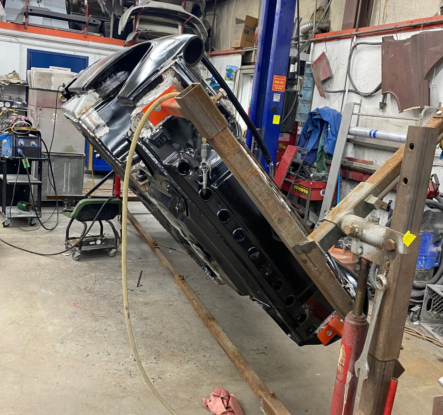

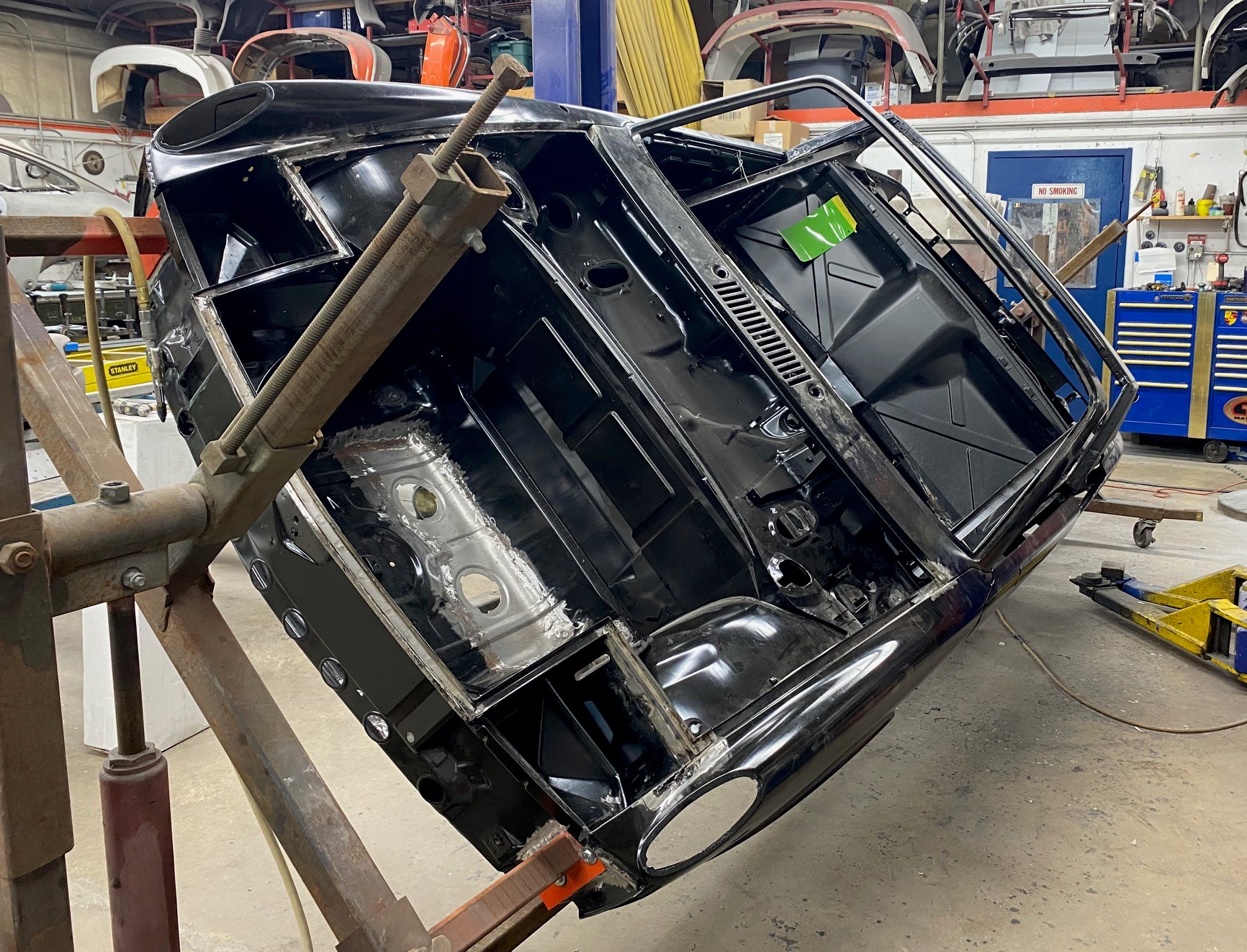

The car is now on the rotisserie and Mad Dog's chassis stiffening parts are being installed.
Tom1394racing
Starting to look like a GT.

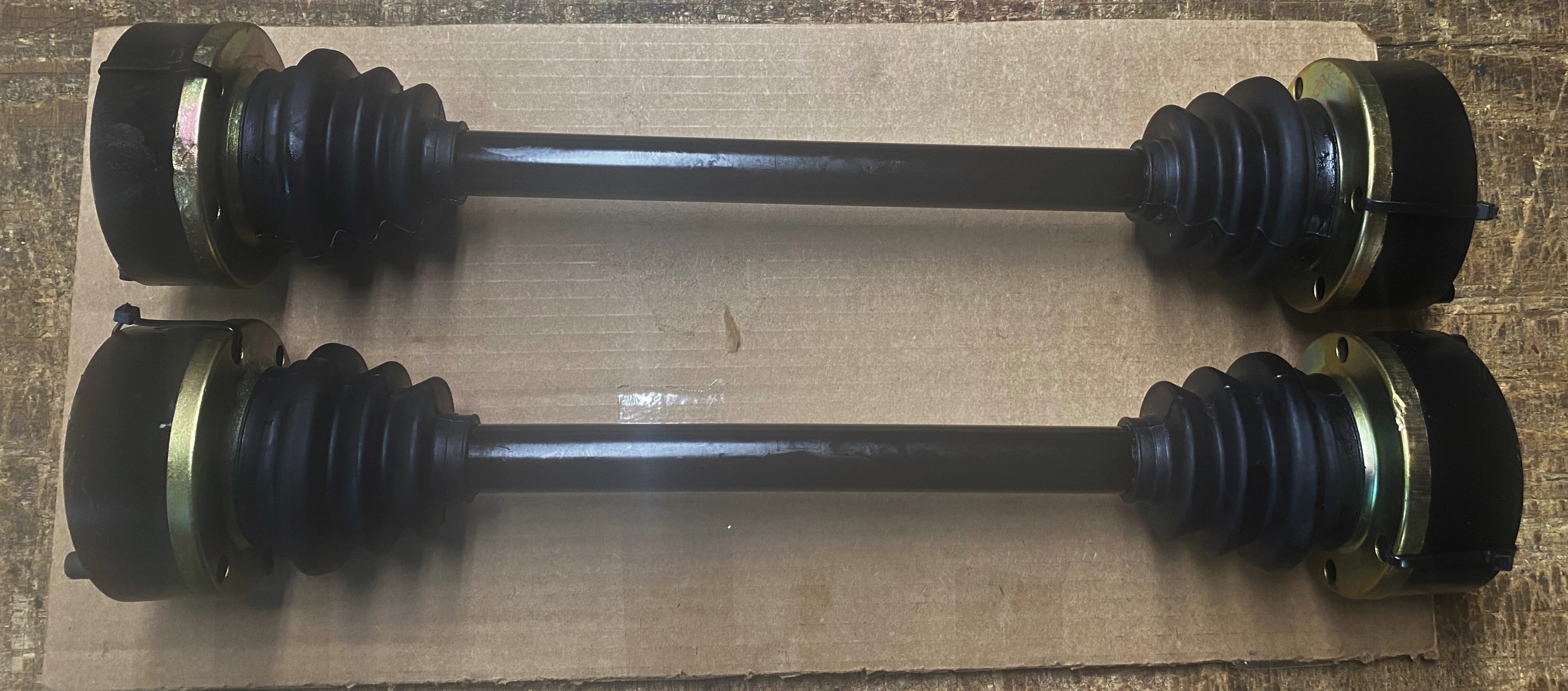

A few more pieces restored and ready for assembly. The axles are the Empi free floating with '69-'73 911 108 mm CV's. These will match up with the same size rear stub axles and differential output shafts.

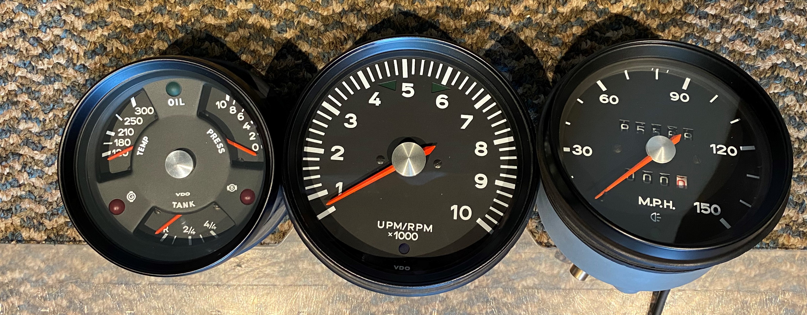

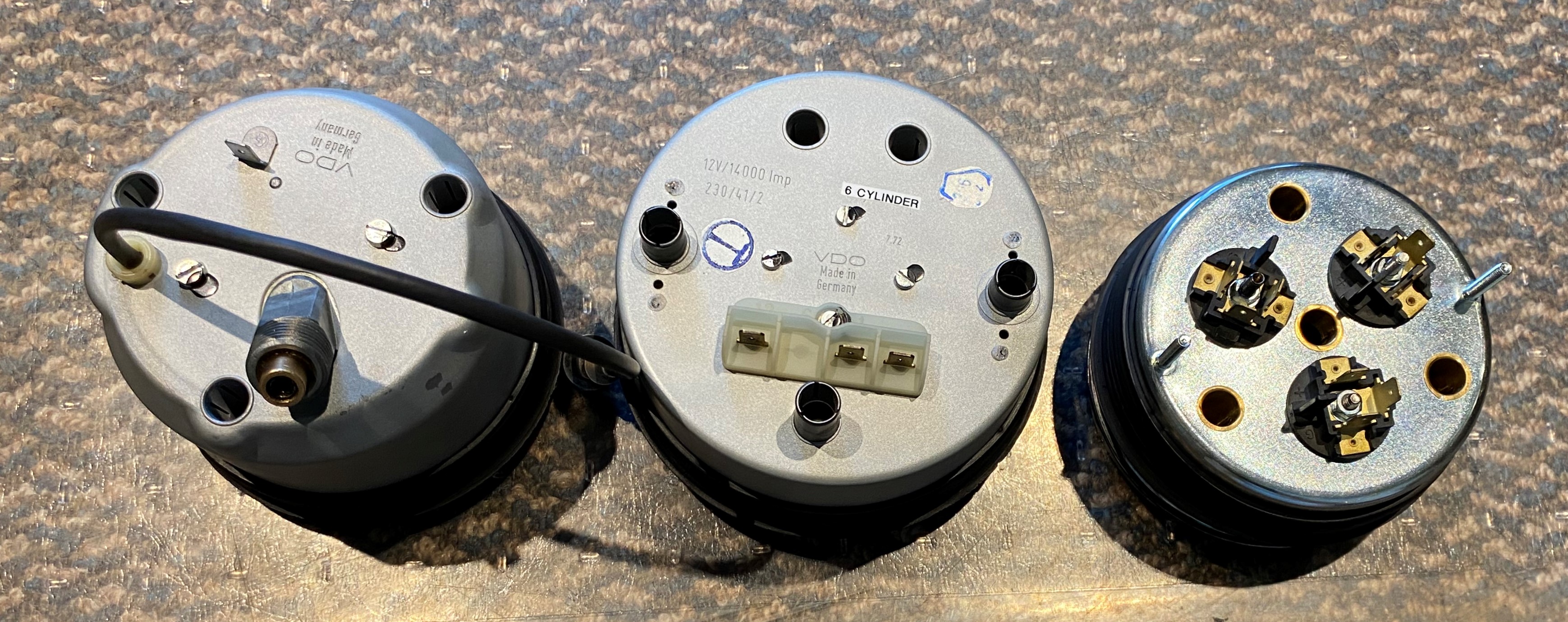

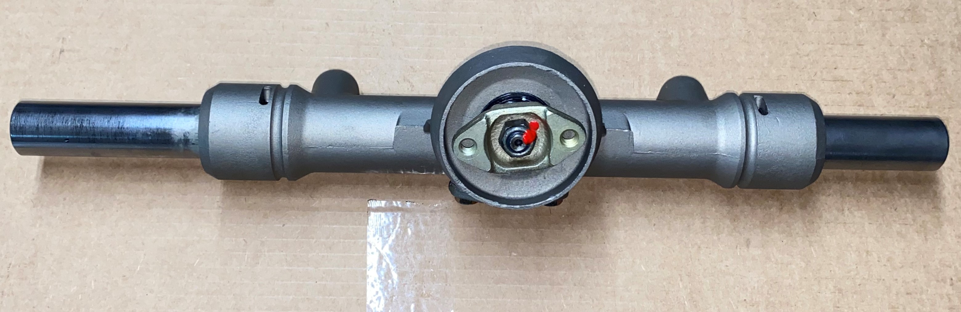

A few more restored parts ready for reassembly.

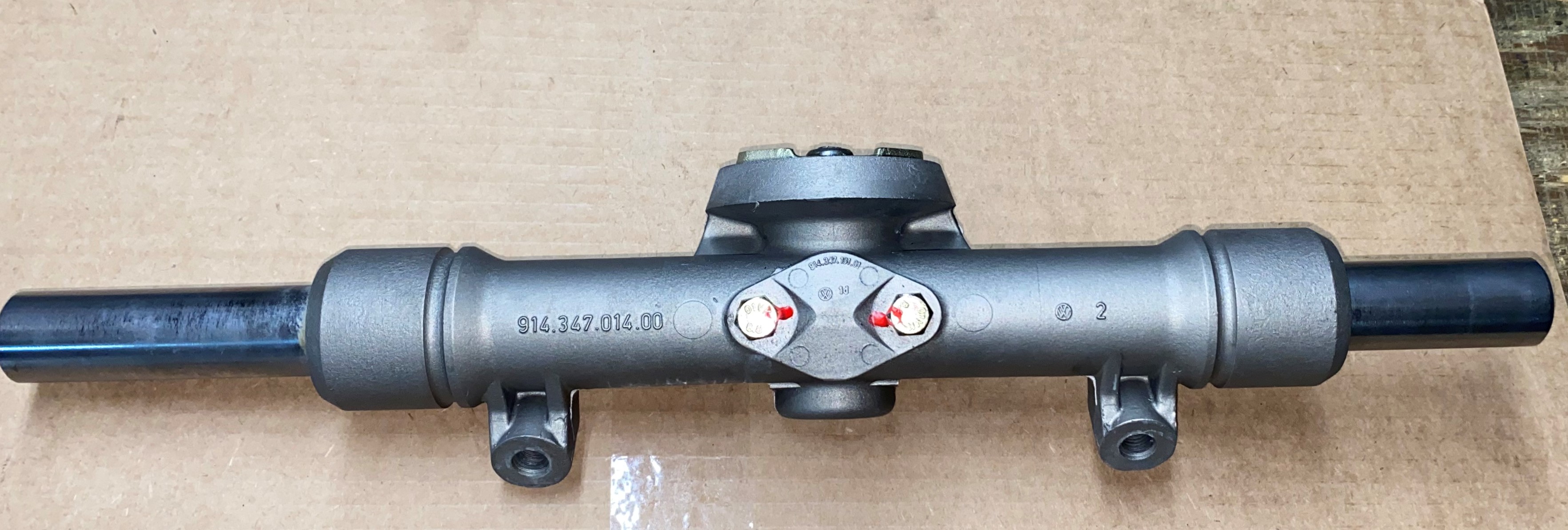

Gauges from North Hollywood and steering rack for 914 Rubber.

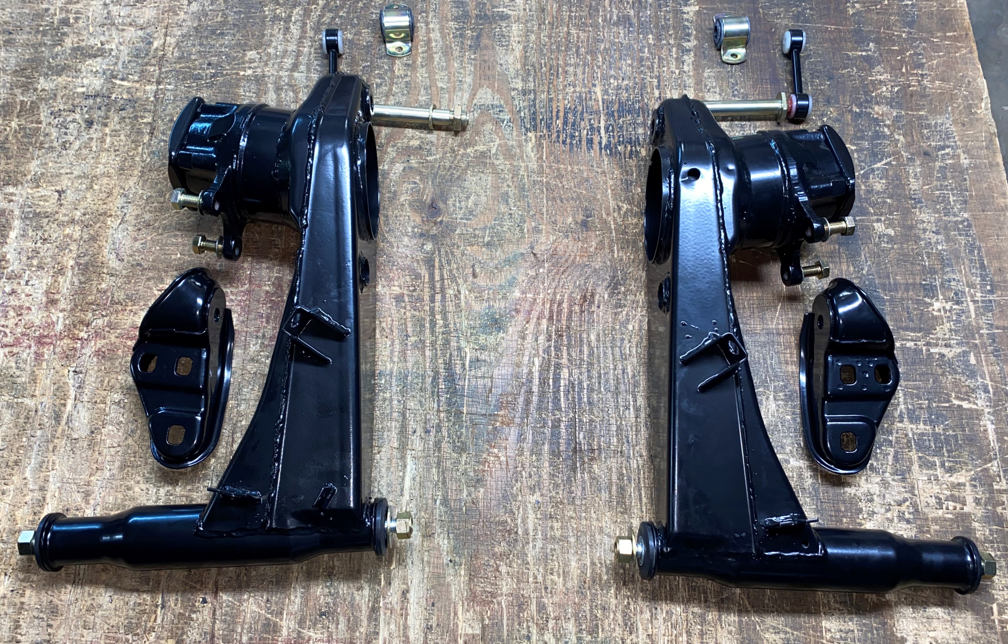

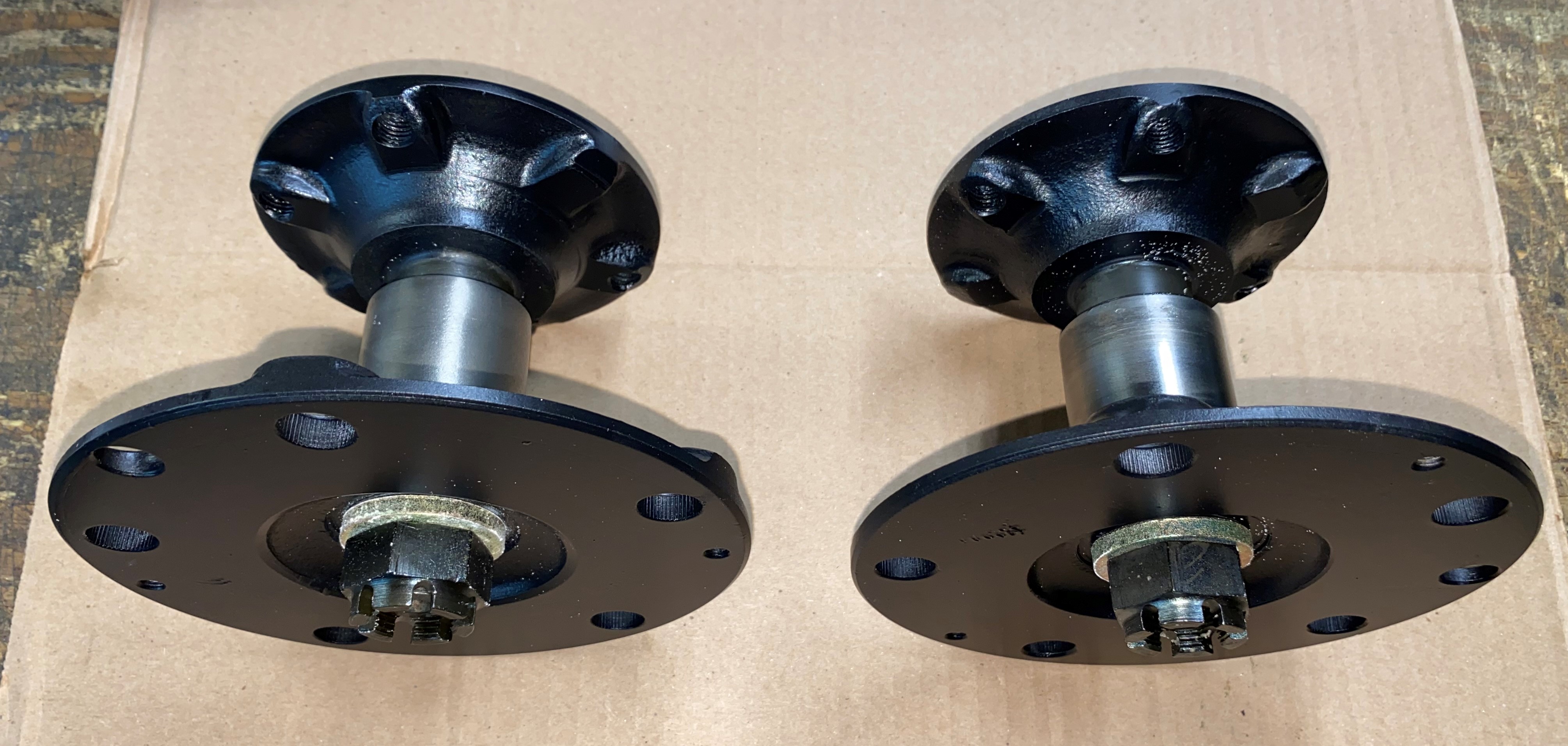

Rear trailing arms along with '69-'73 911 rear hubs and stub axles.

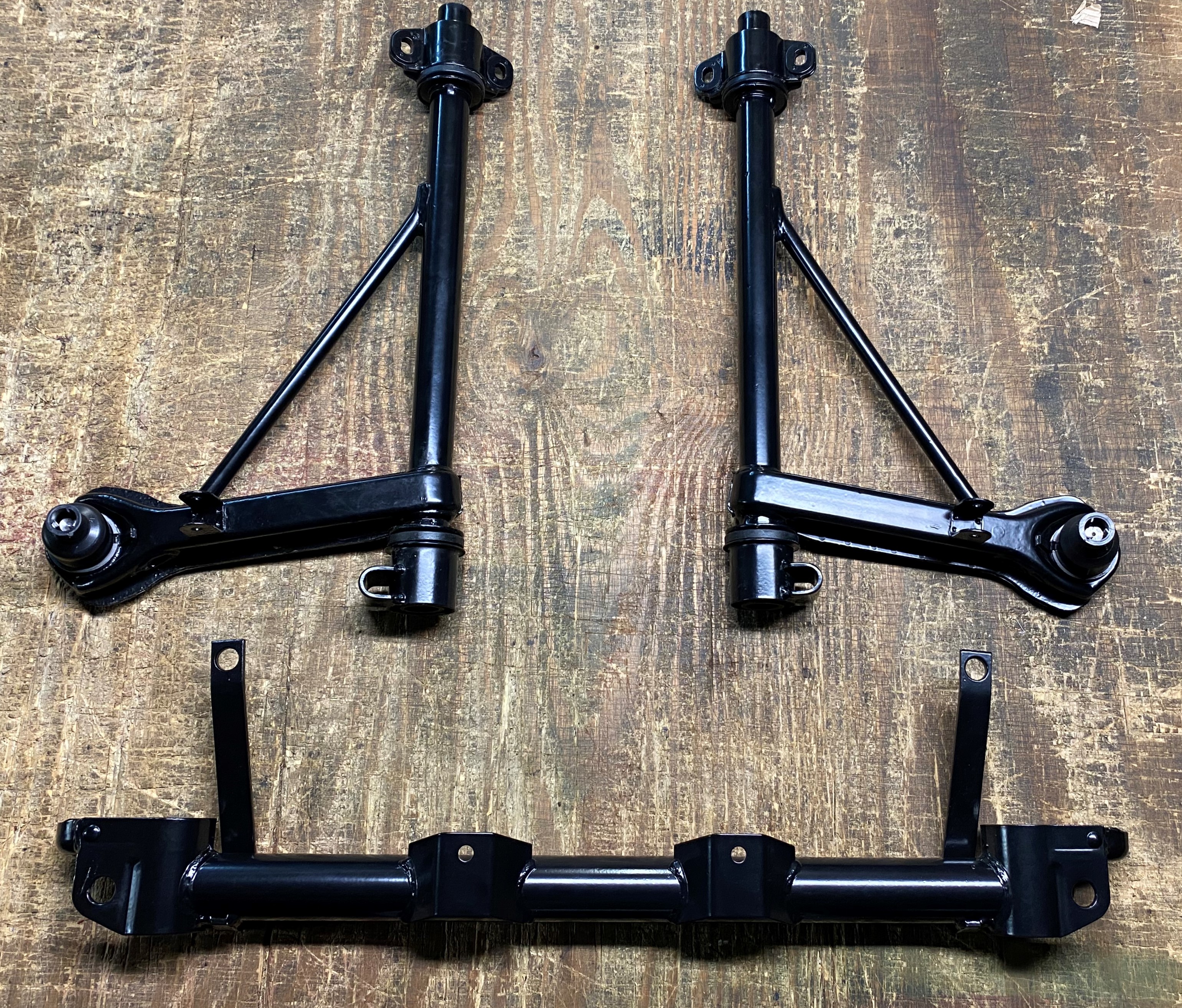

911 A-Arms and 914 crossmember. Elephant racing rubber bushings all around, front and rear.
