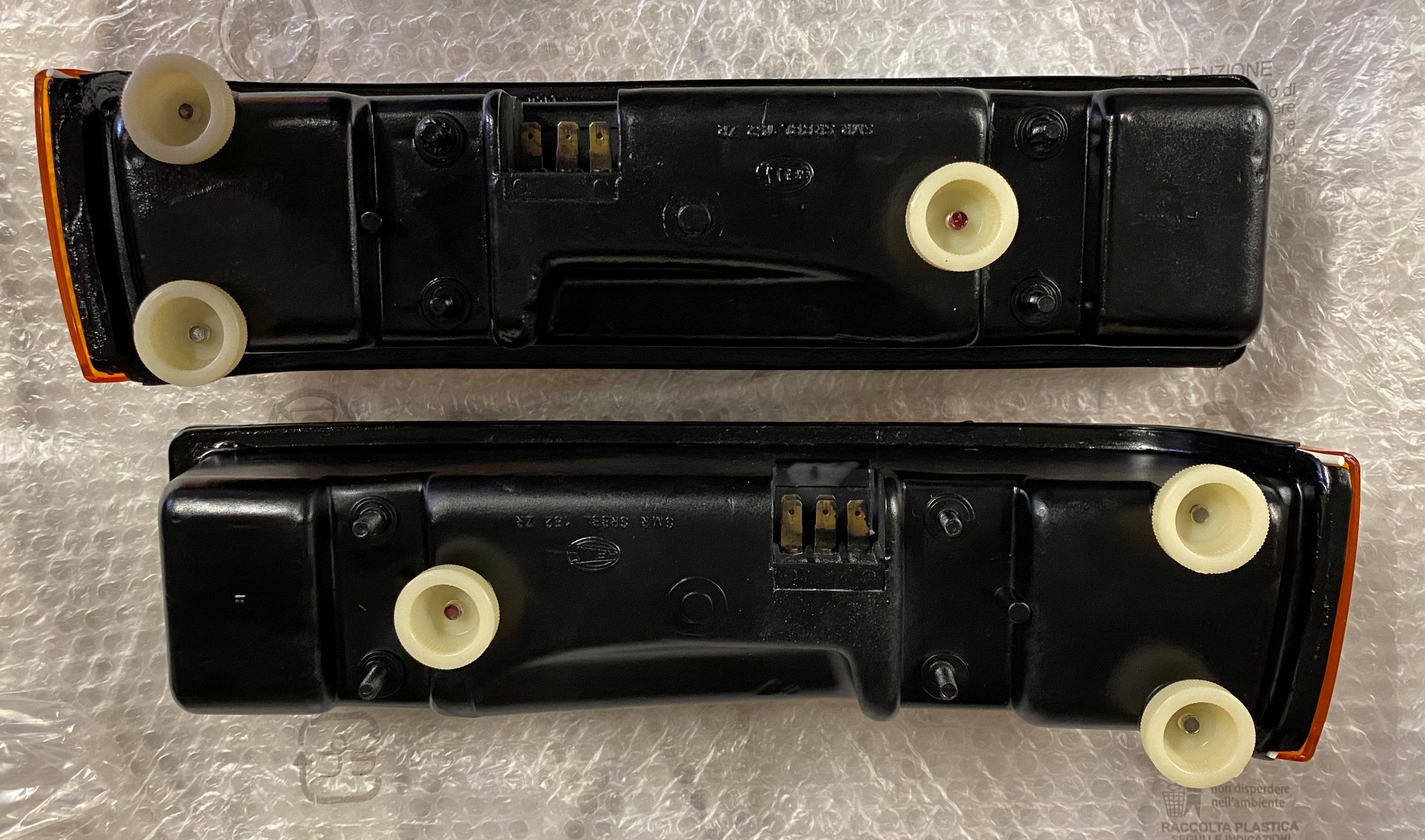

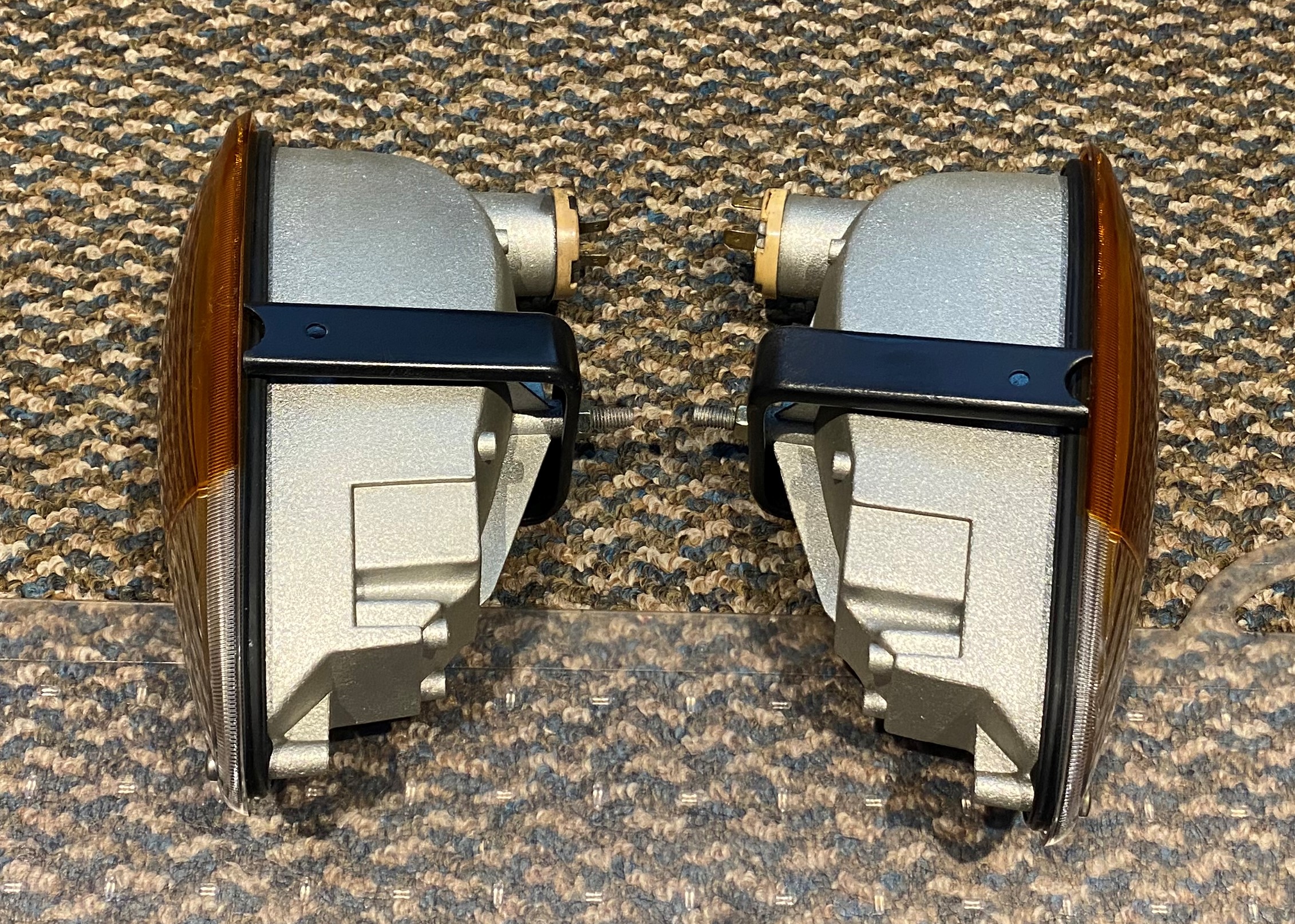

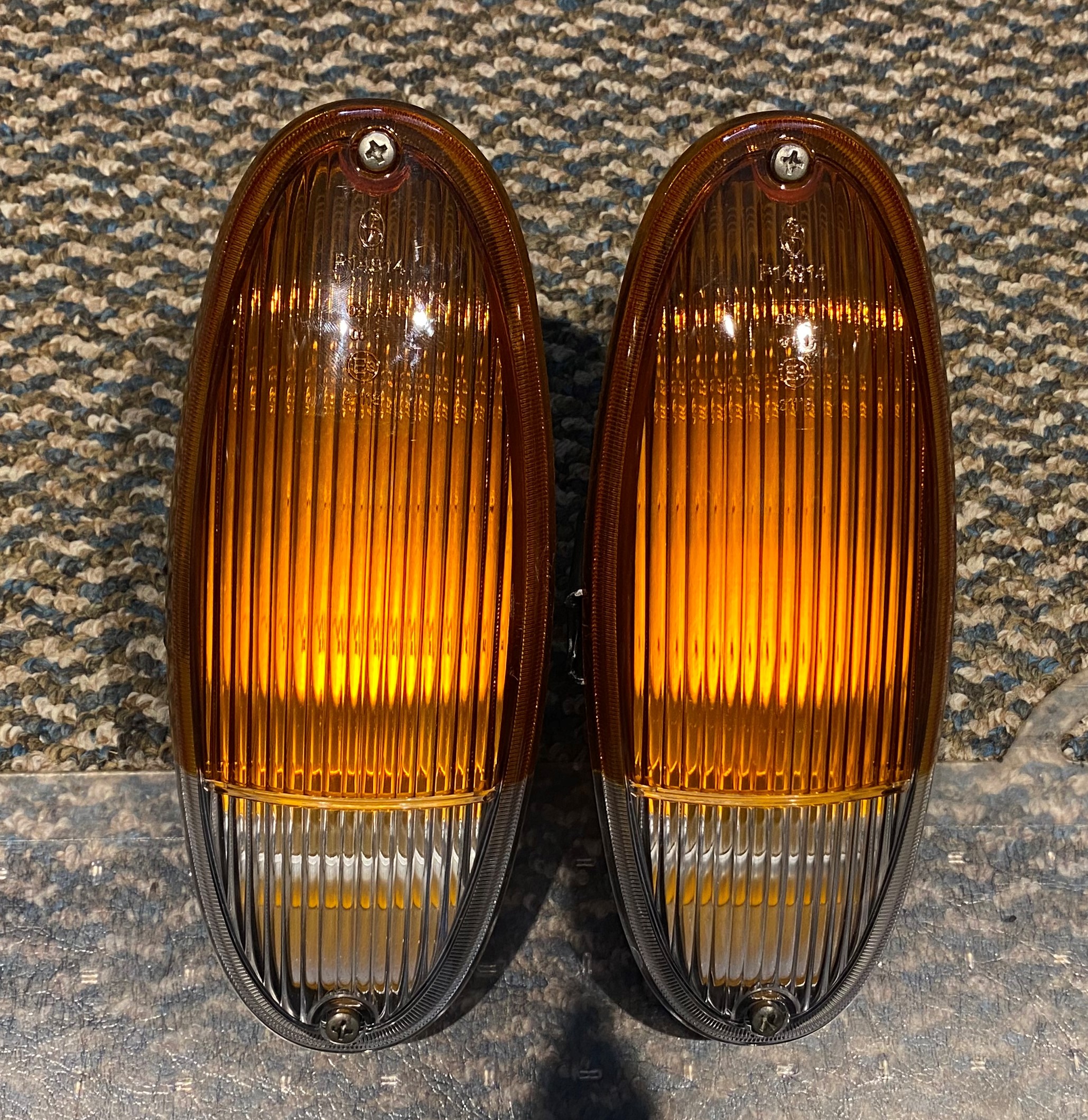

Front turn signals ready to install.

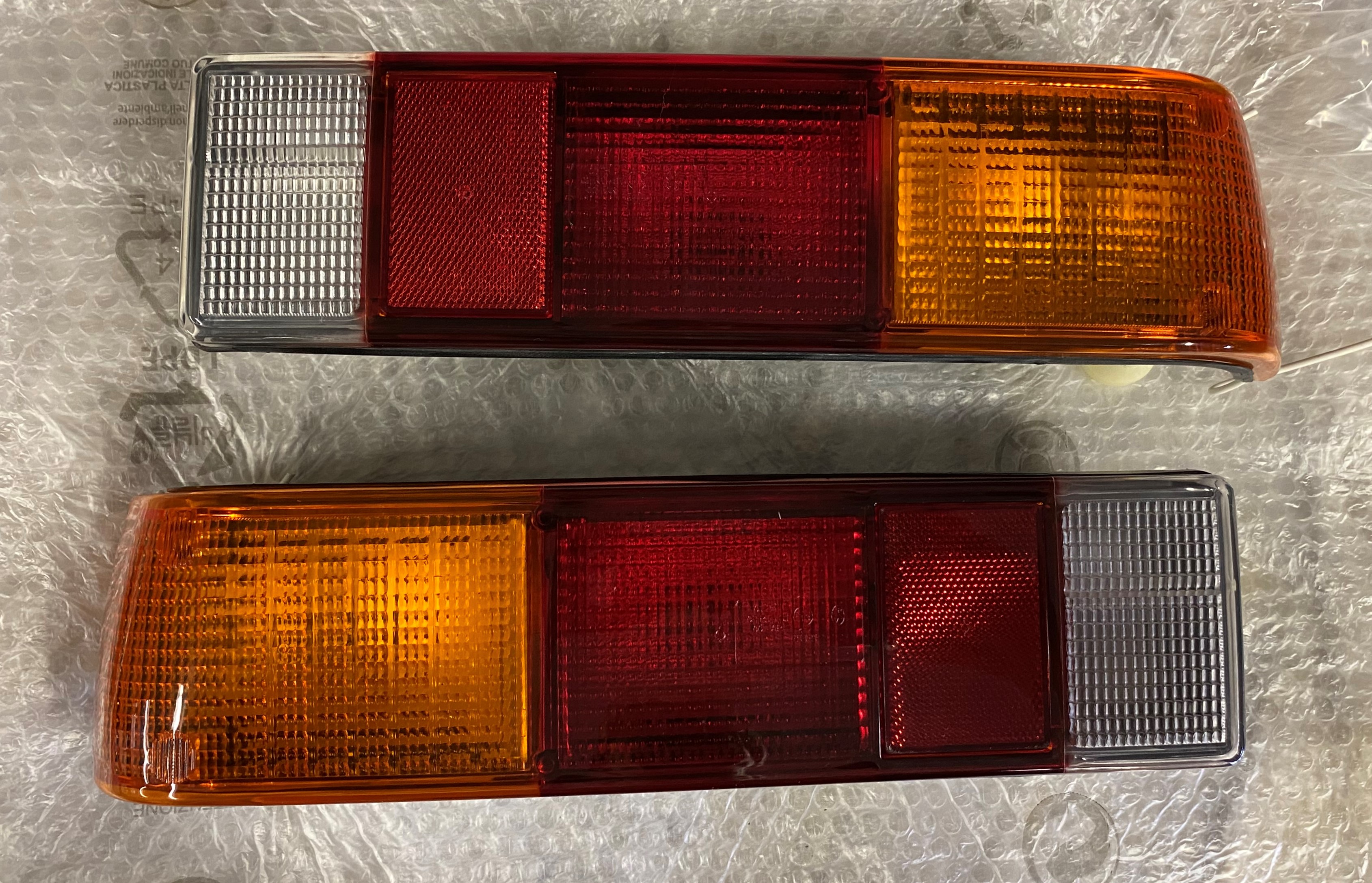

Tom1394racing
Also, the taillights are ready.

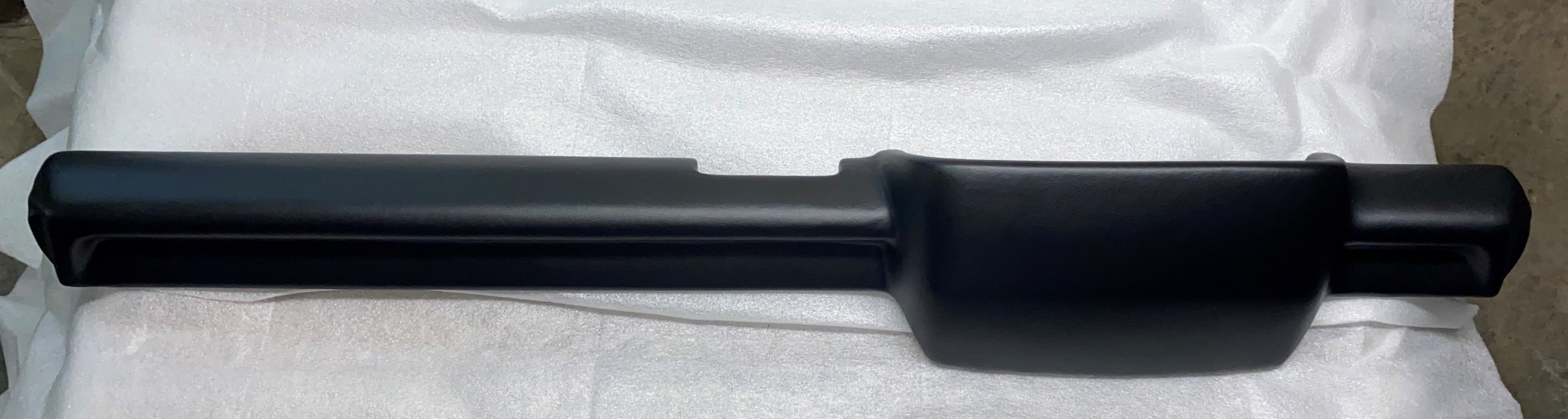

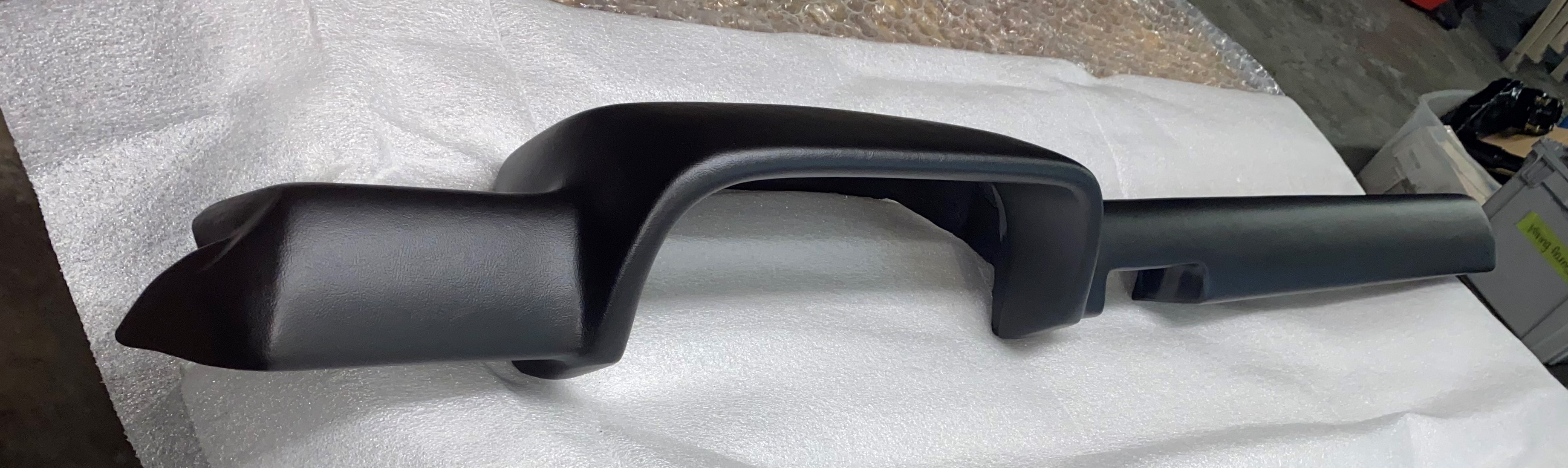

Restored dash from Just Dashes arrived today. Looks flawless as you would expect from them.

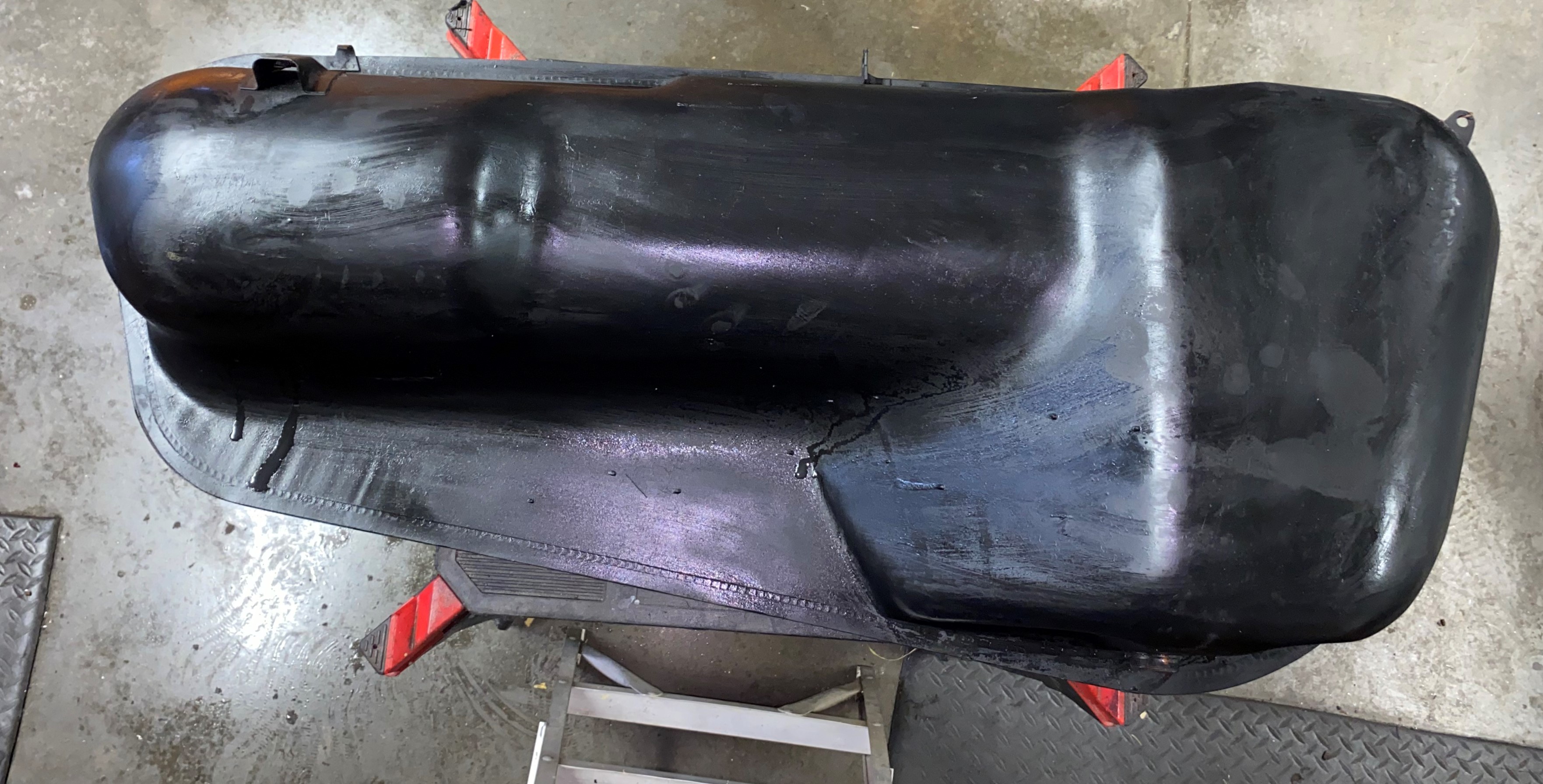

Fuel tank has been cleaned, sealed, pressure tested and painted. I may decide to give it a final satin black coat before install.

The dash looks terrific Tom, what was the cost and turnaround? Any fitment issues?

QUOTE(Bullethead @ Aug 18 2023, 07:03 PM) *
I did only the dash top, not the bottom piece. My bottom piece was in very good shape.
6-month lead-time door to door. $1534 total cost. I had seen their work on a couple of local cars and was convinced of the value as there did not seem to be any good alternatives.

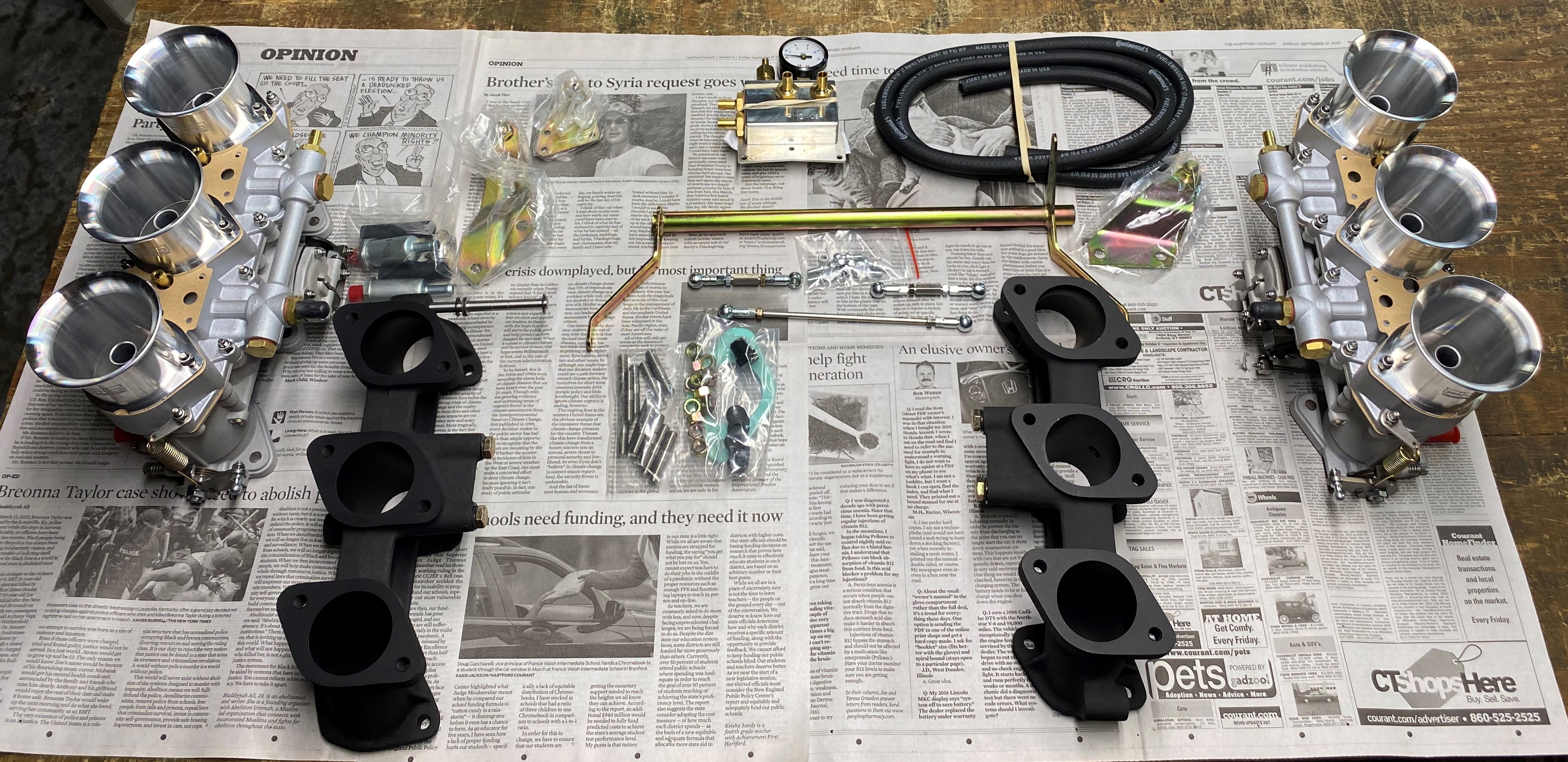

46 mm PMO kit. Once I get the case back from Ollie's, I can start the engine build.

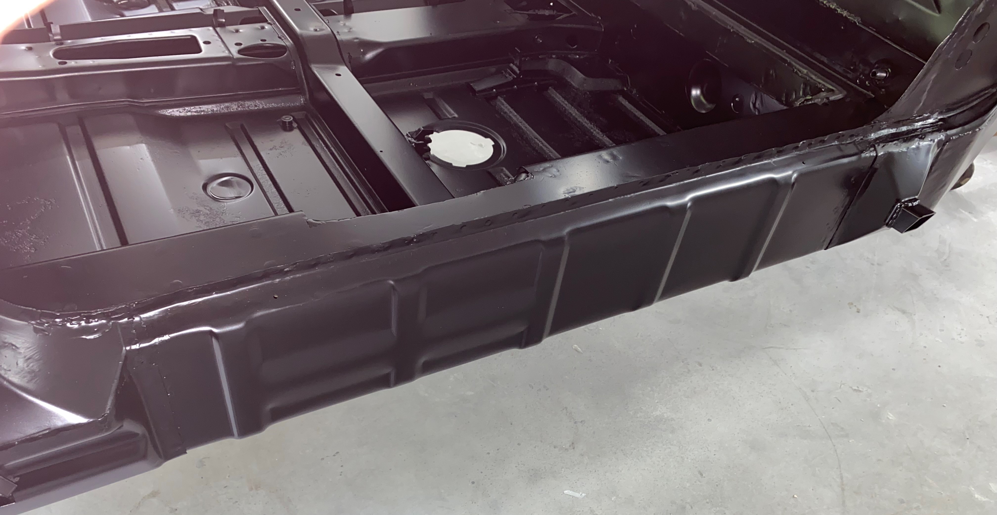

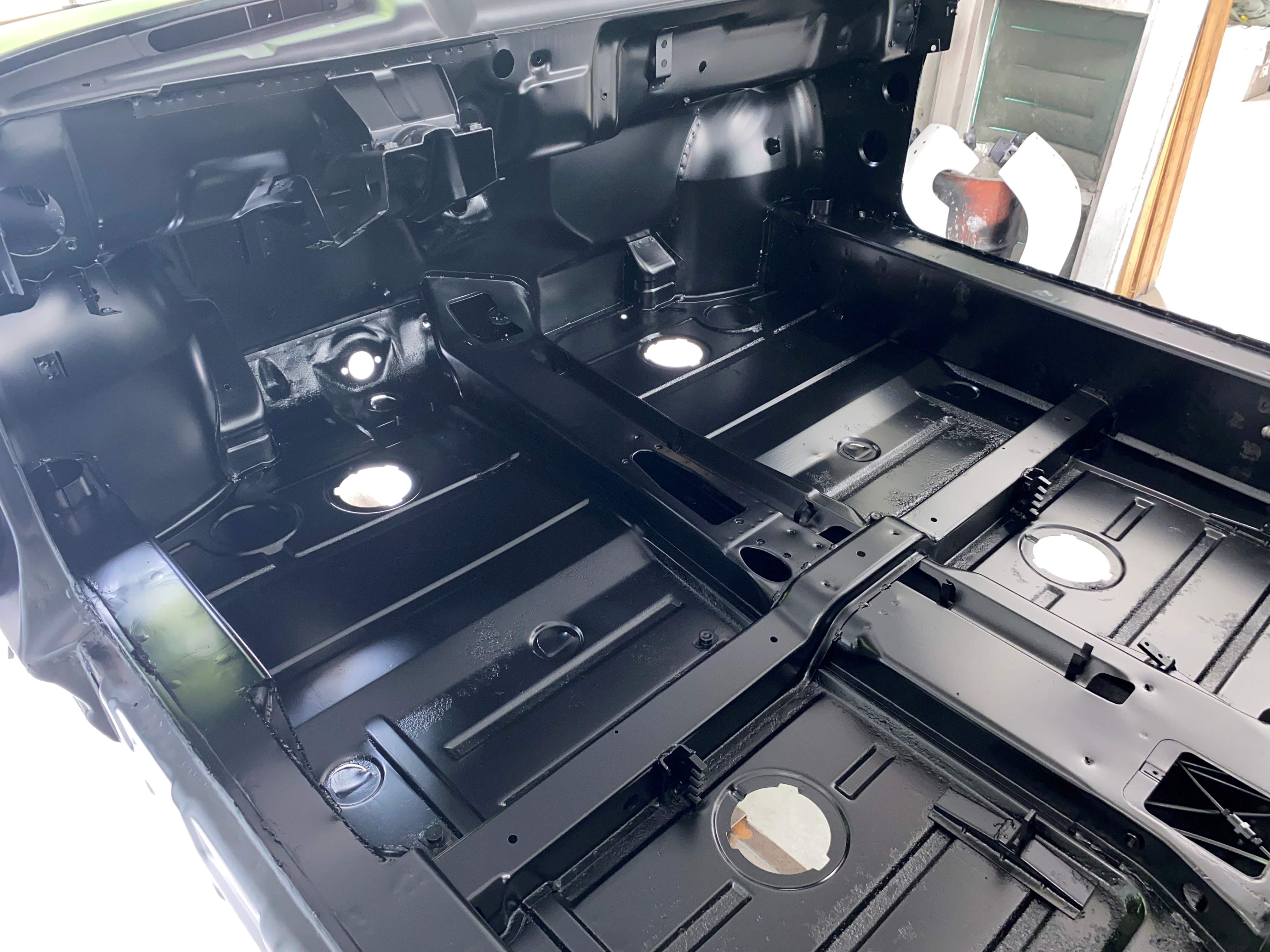

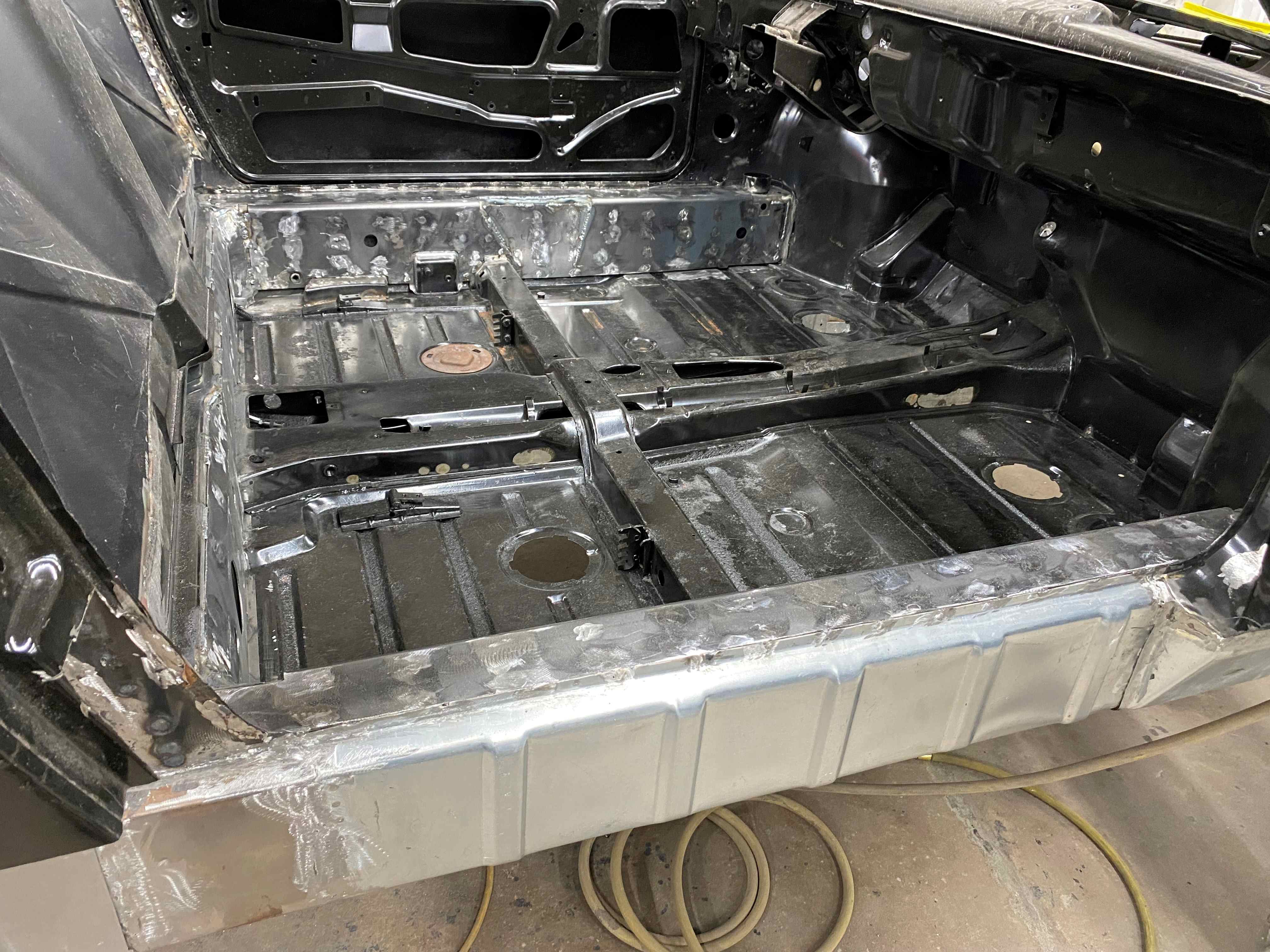

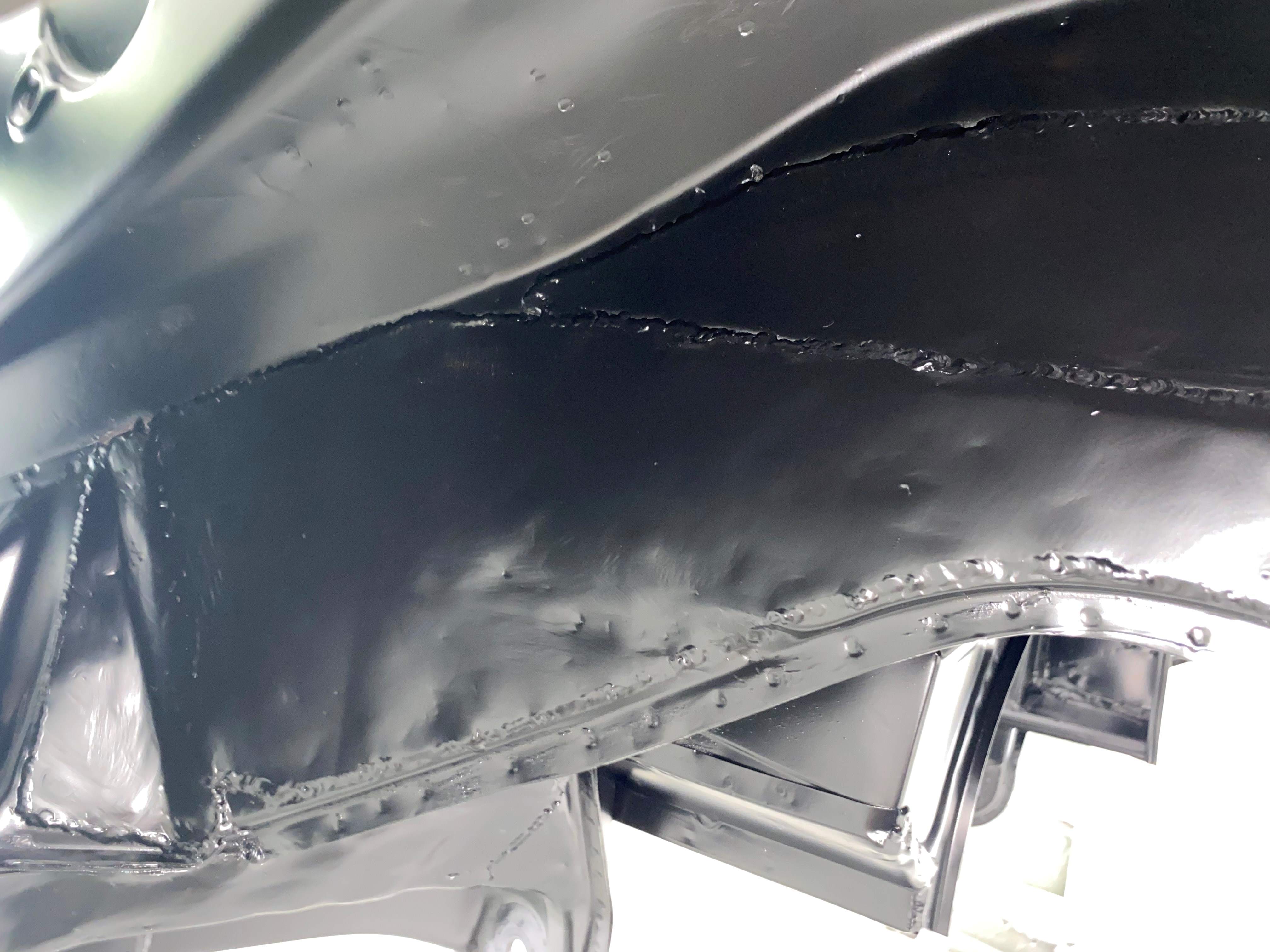

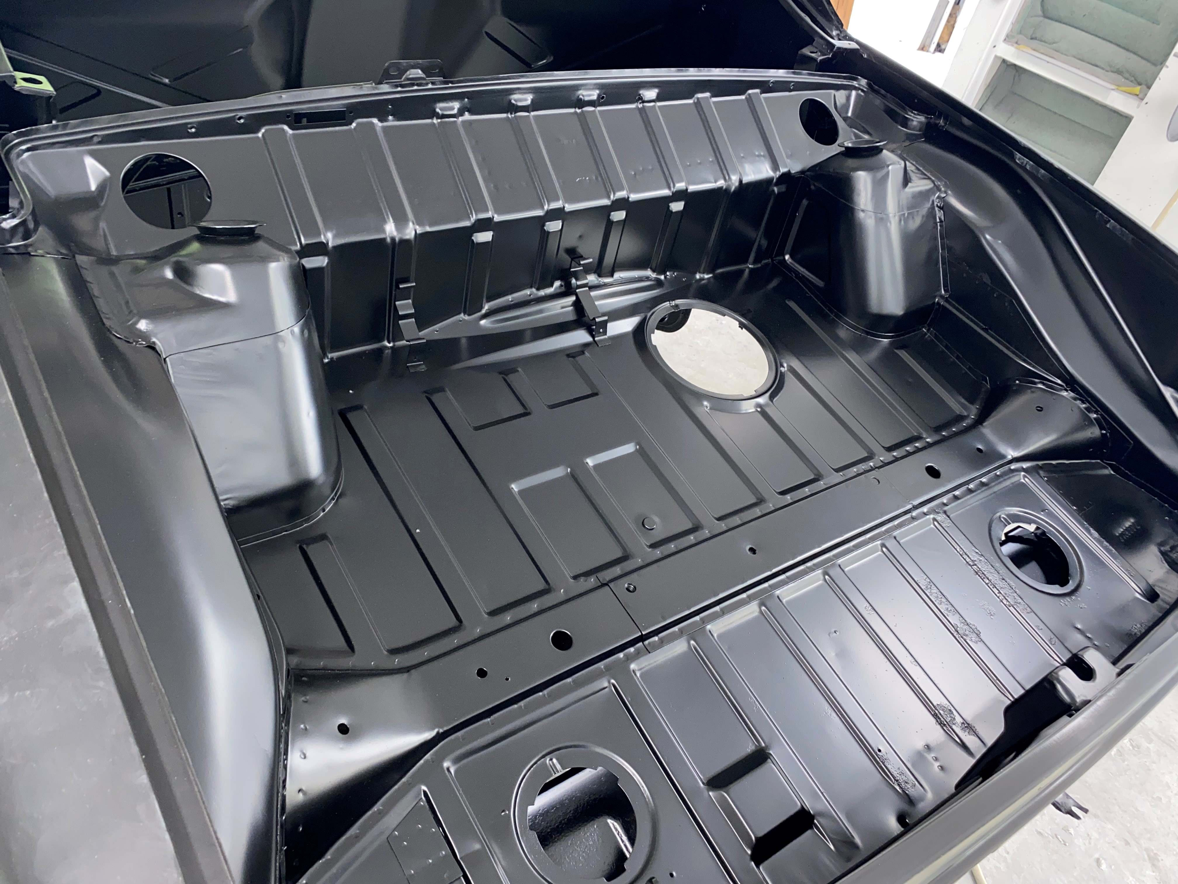

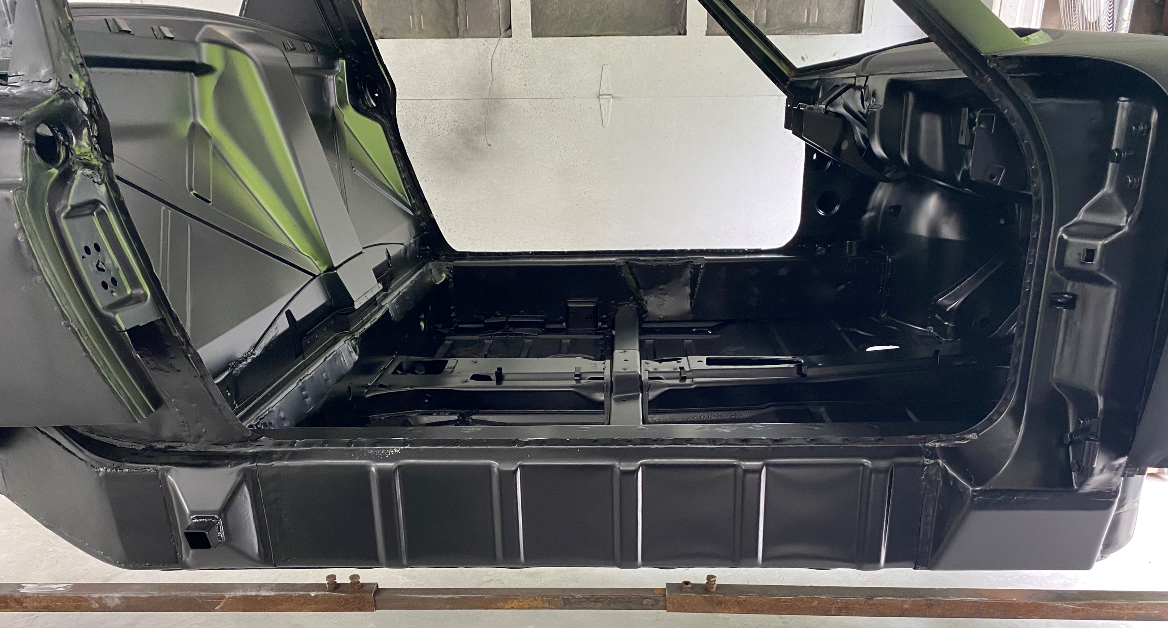

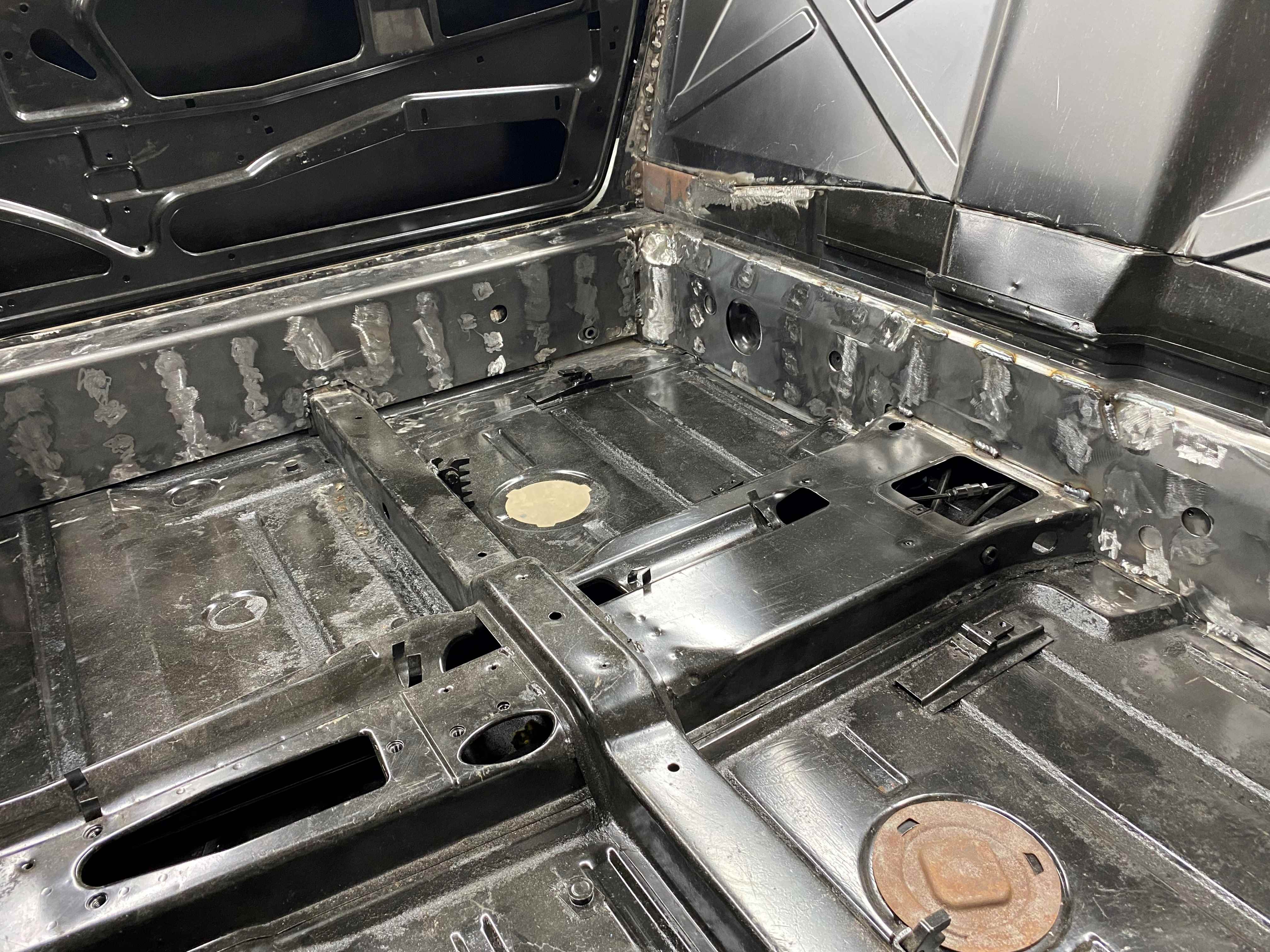

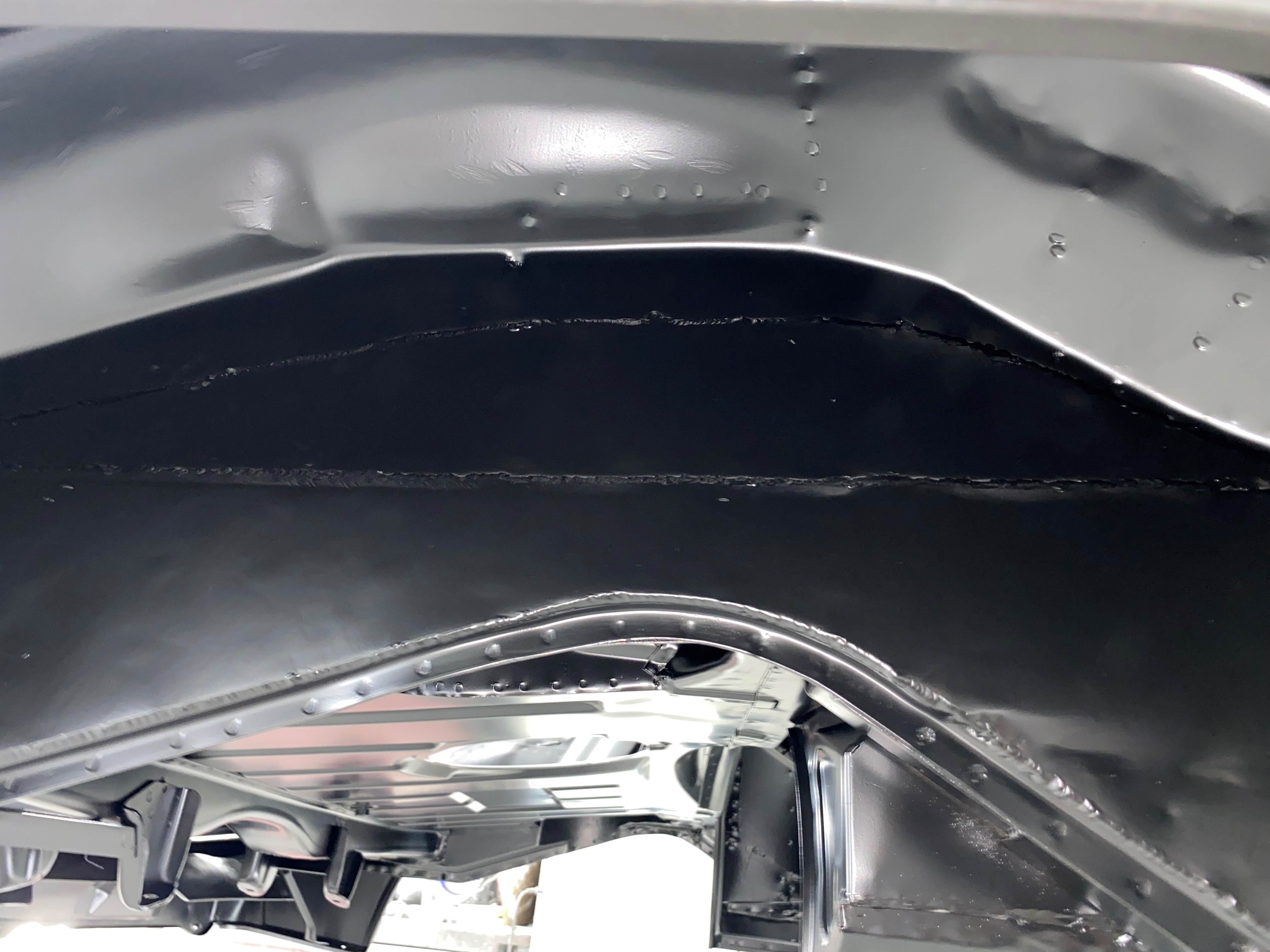

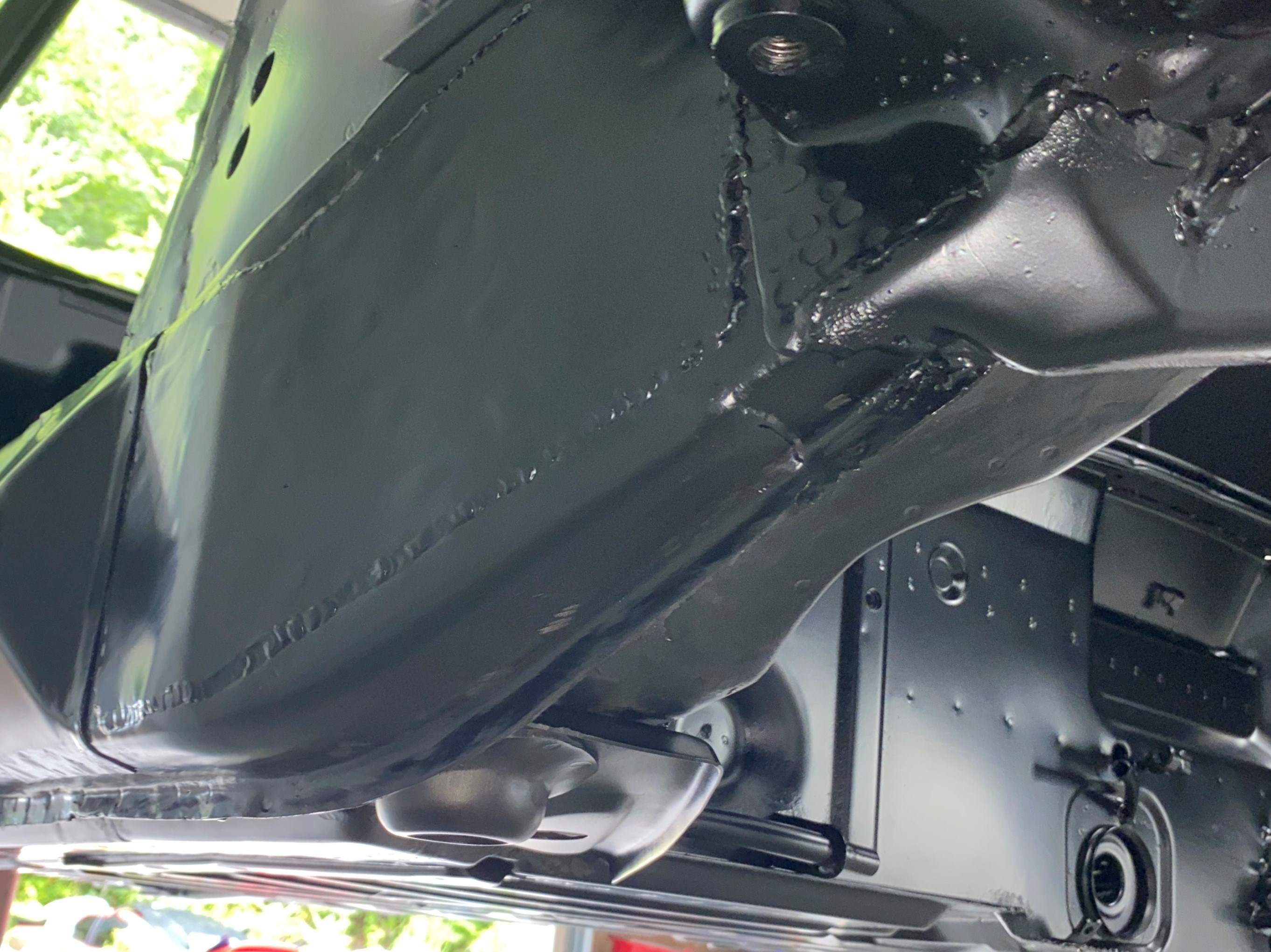

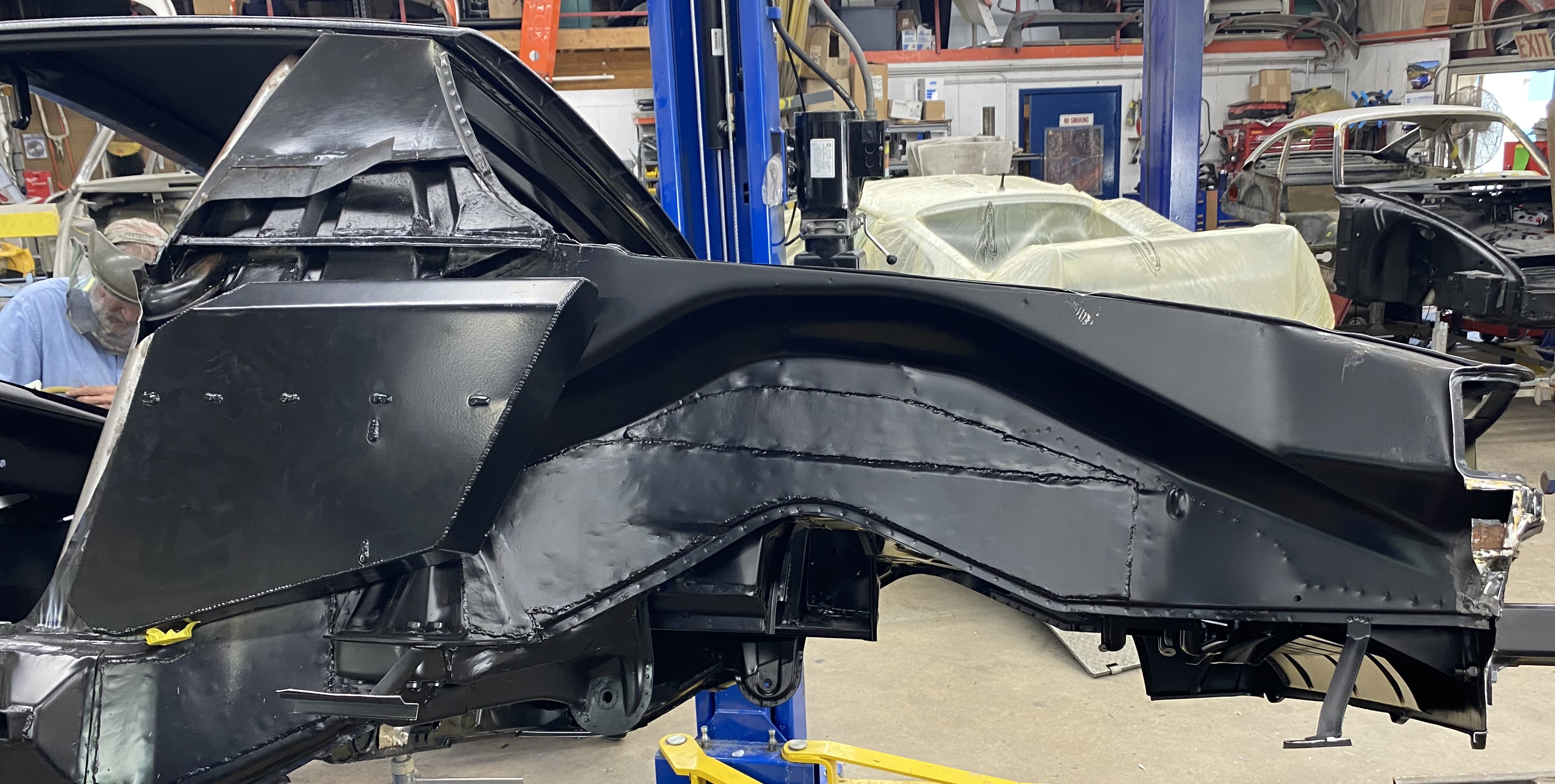

Bottom side rust repairs and chassis stiffening had been completed and the repairs dressed and e-coated.
Tom1394racing

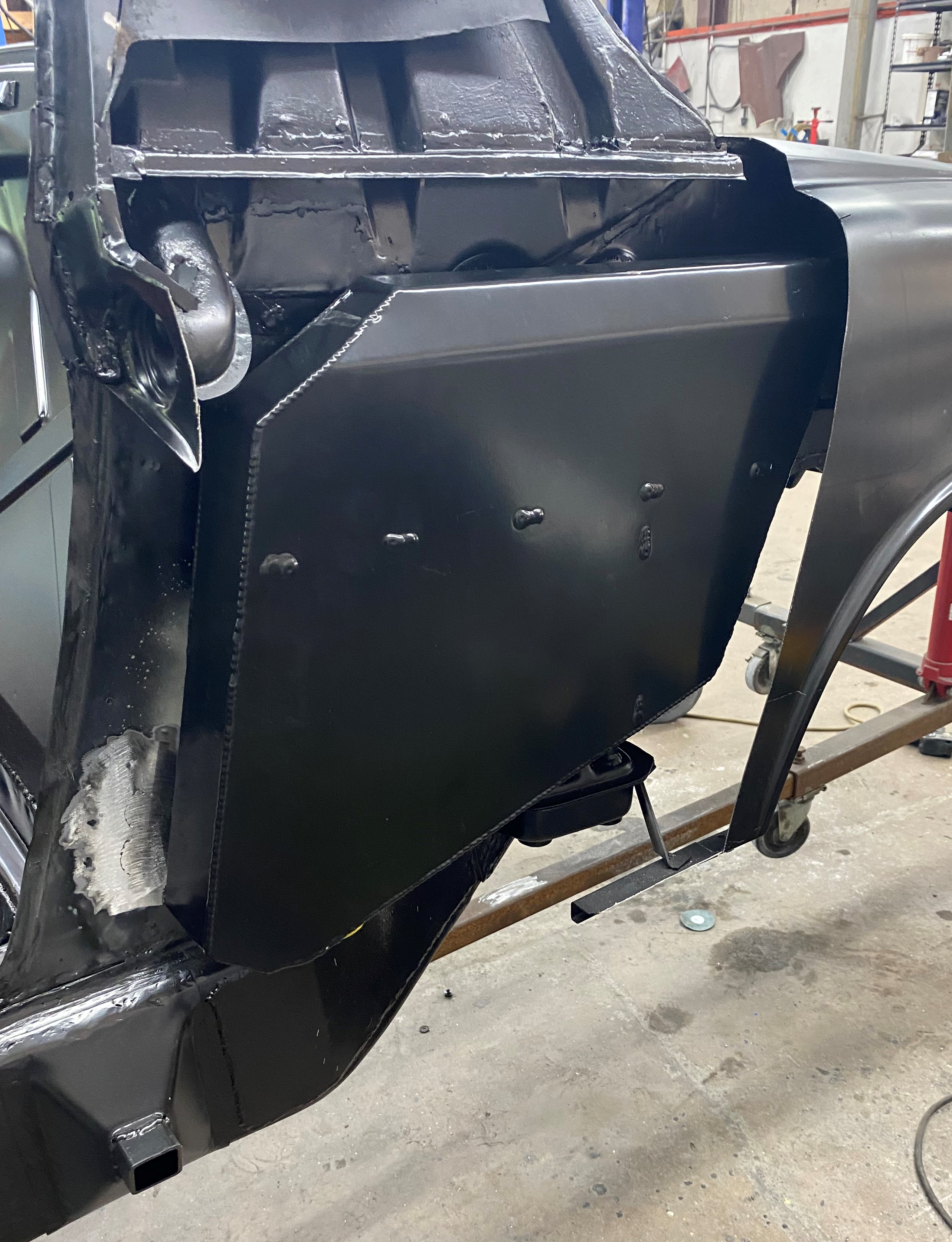

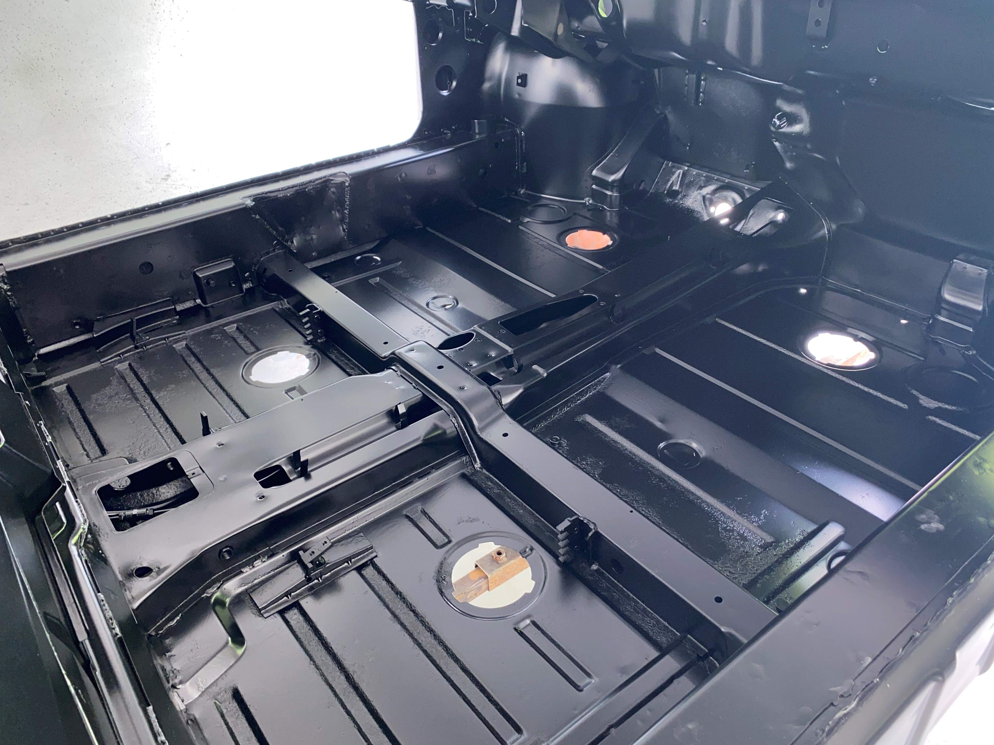

Mad Dog interior chassis stiffening.
Tom1394racing
Mad Dog exterior chassis stiffening.

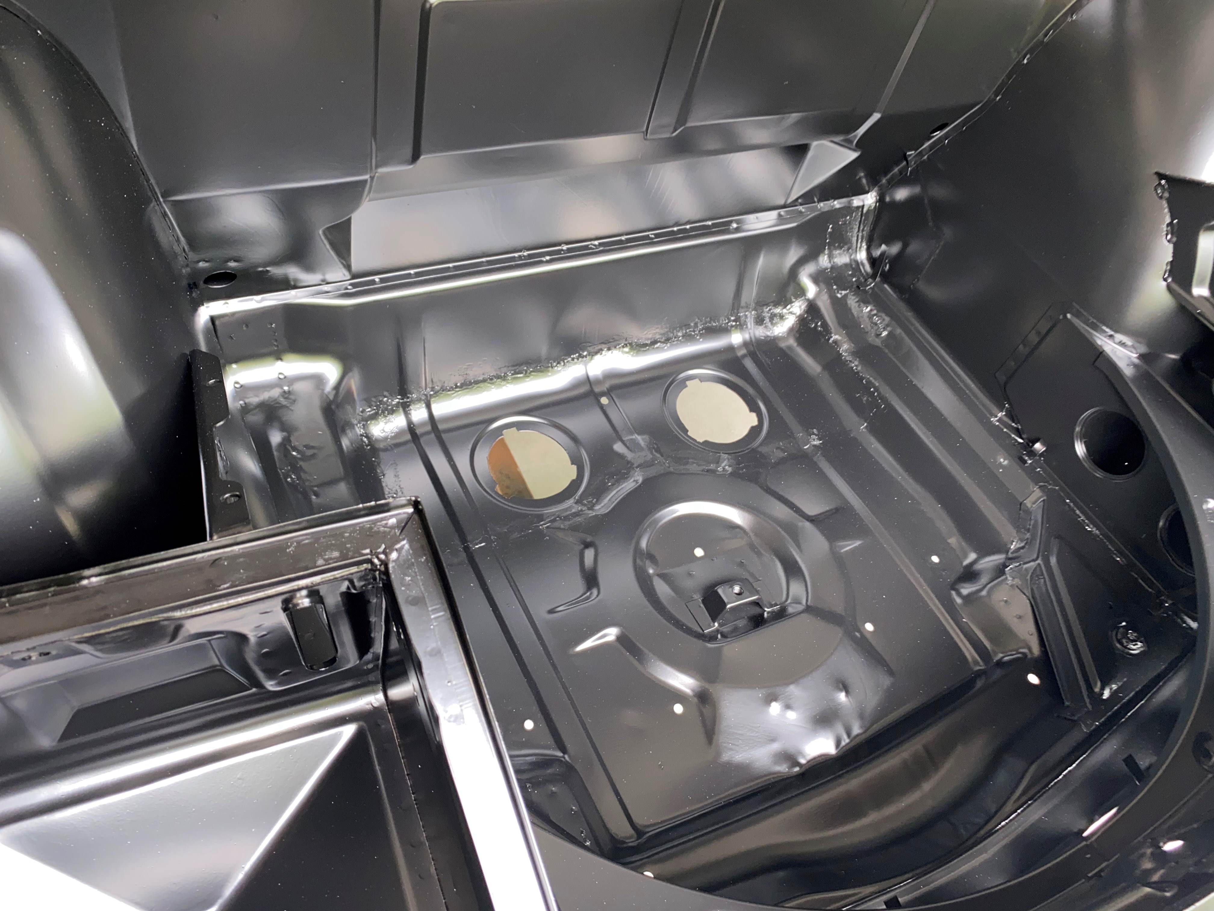

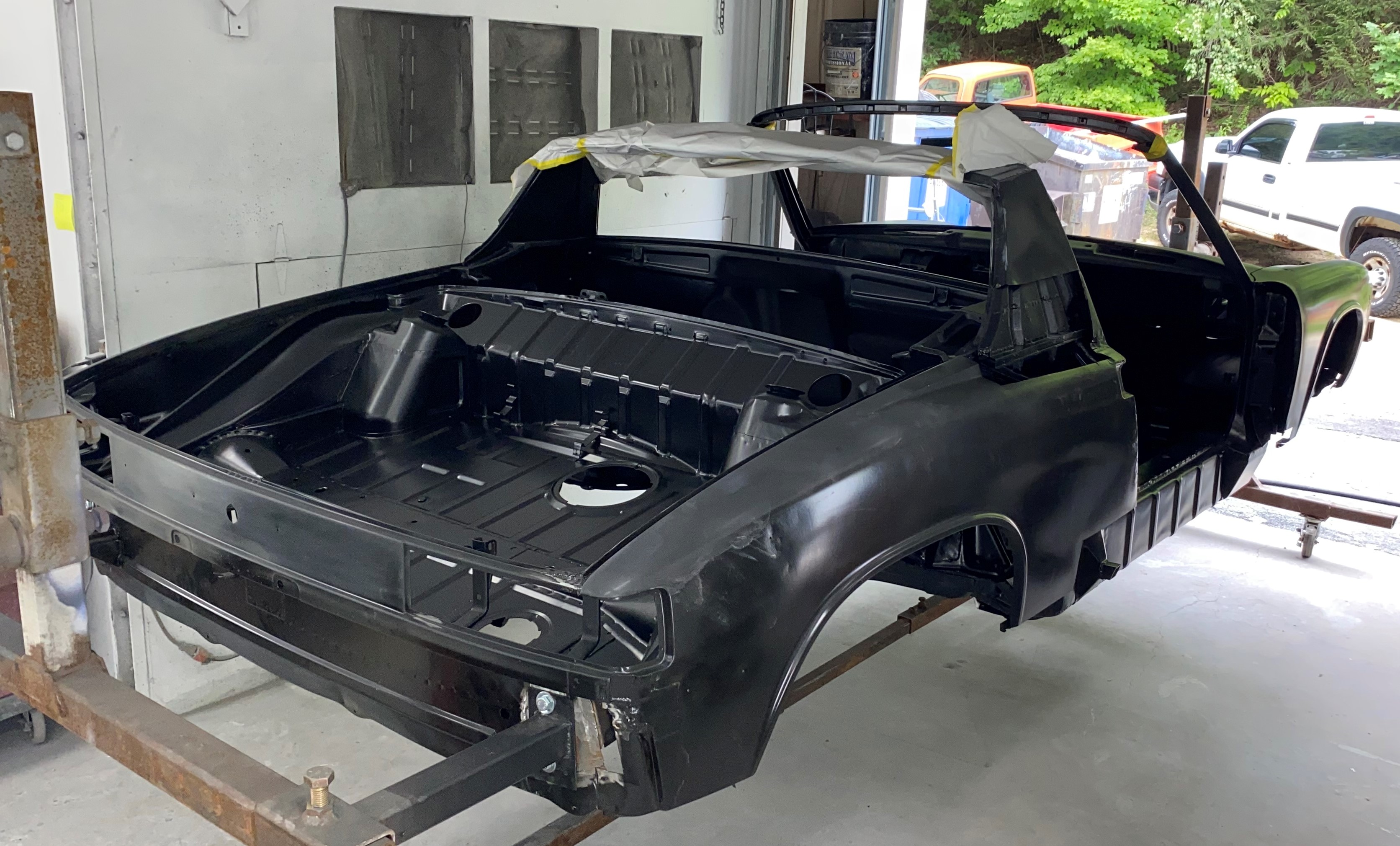

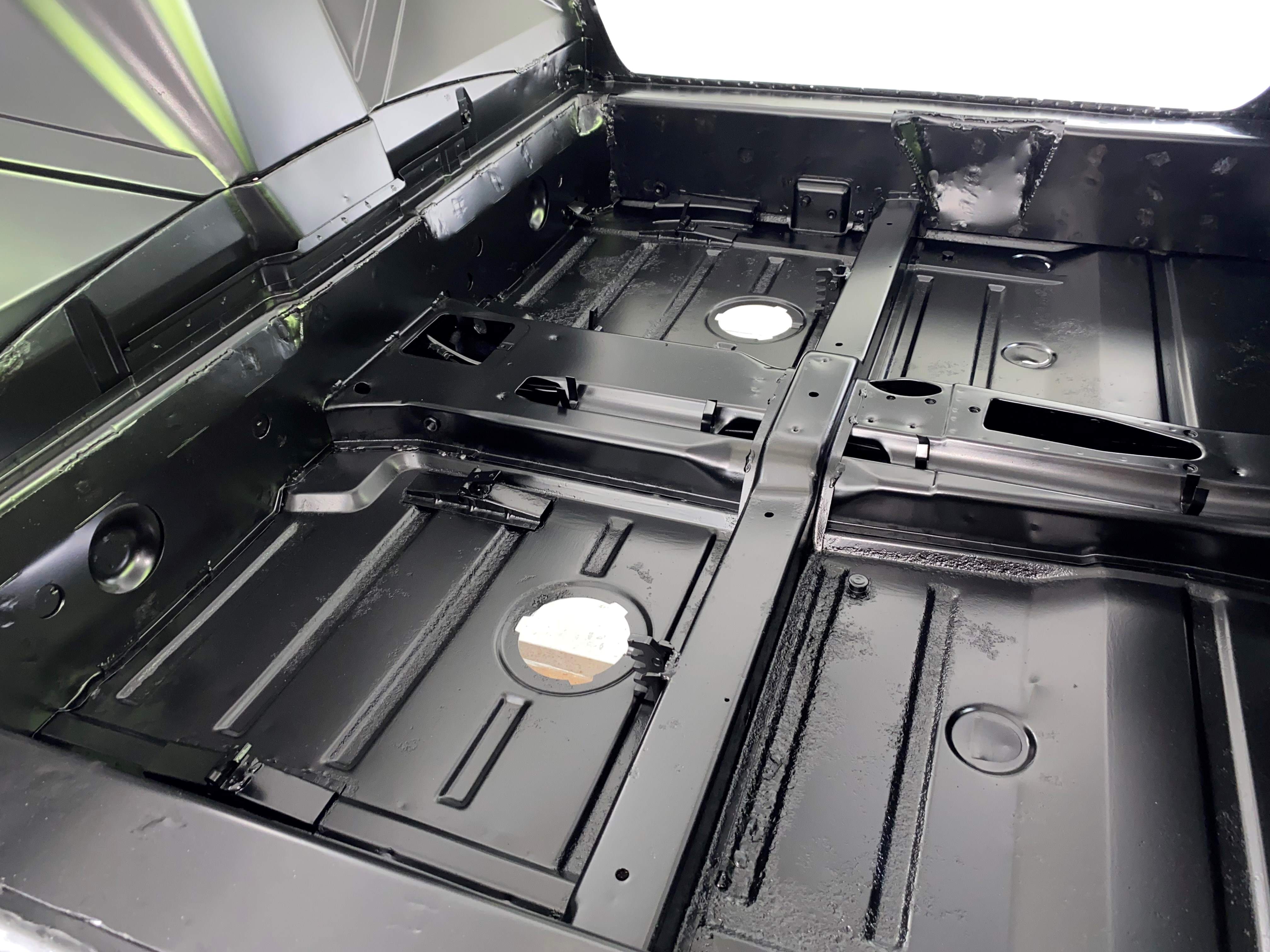

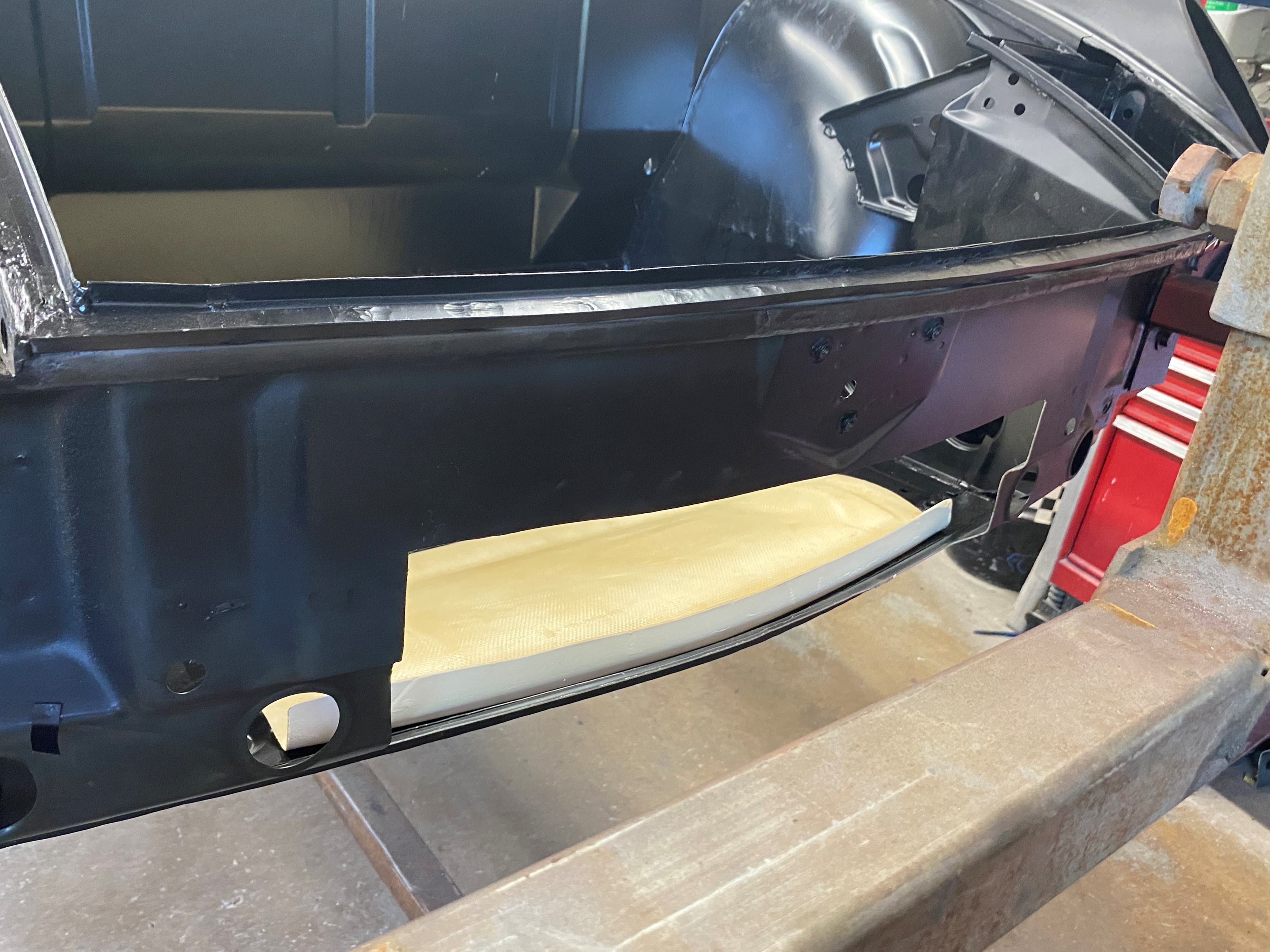

Front and rear trunk compartments. Still to do:
1. GT Roll bar from Tangerine Racing
2. Front cooler ducting
3. -6 Engine mount from Mad Dog
4. Shoulder belt anchors on firewall
5. Engine access panel on firewall
6. Rear suspension pivot point reinforcements
7. Through holes for oil tank & oil cooler lines
8. Front truck mods for Mittlemotor GT headlight cable release system
9. Modify and install 911 steering column
10. Paint bottom side, both trunks and cockpit in Lizard Green
The car will then come back to me for partial reassembly including electricals, engine and gearbox, suspension and interior components. Then back to Auto Associates for mounting of the flares and final body and paint.

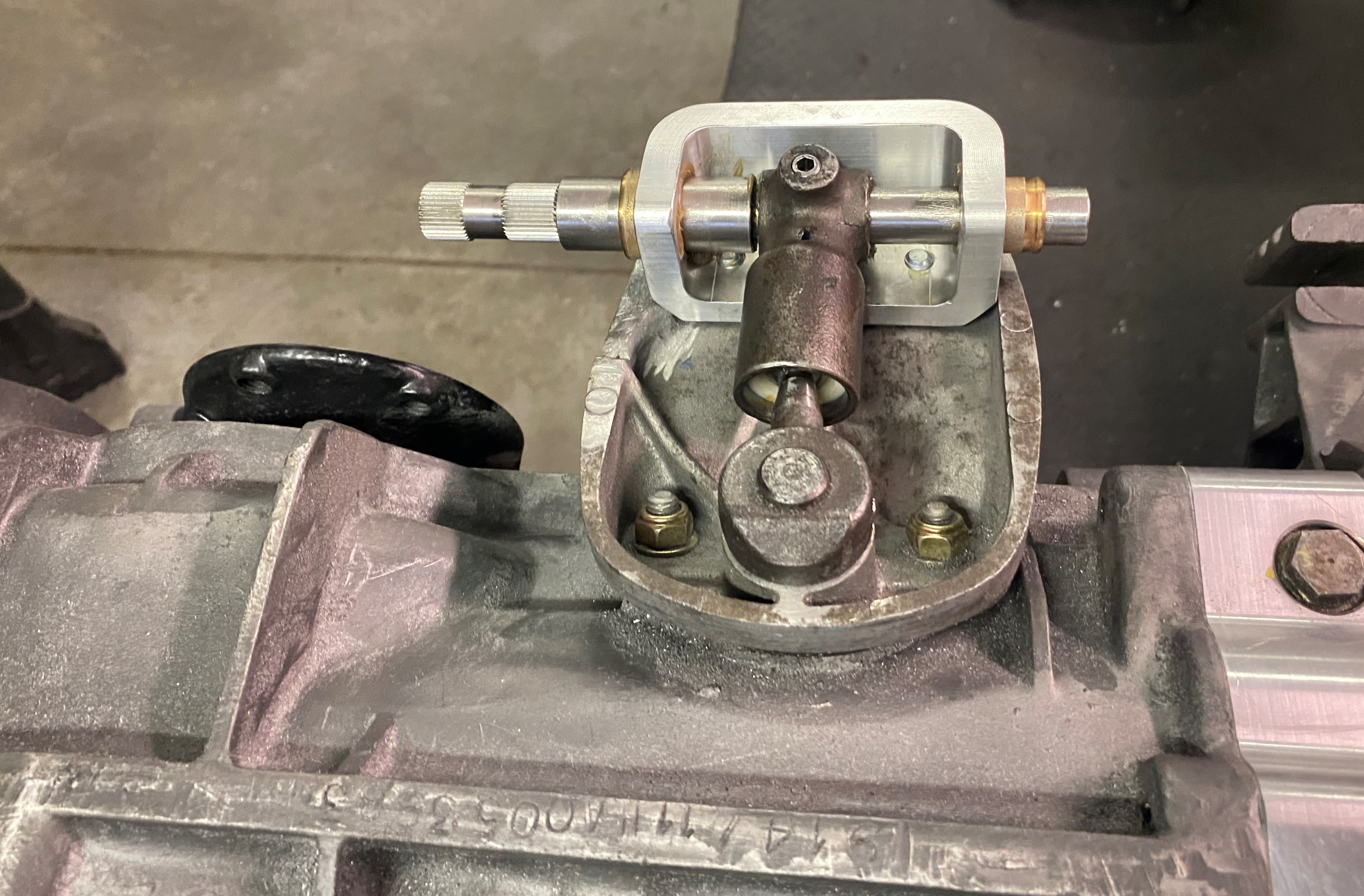

Installed the Tangerine Racing side shift bracket on the gearbox yesterday.

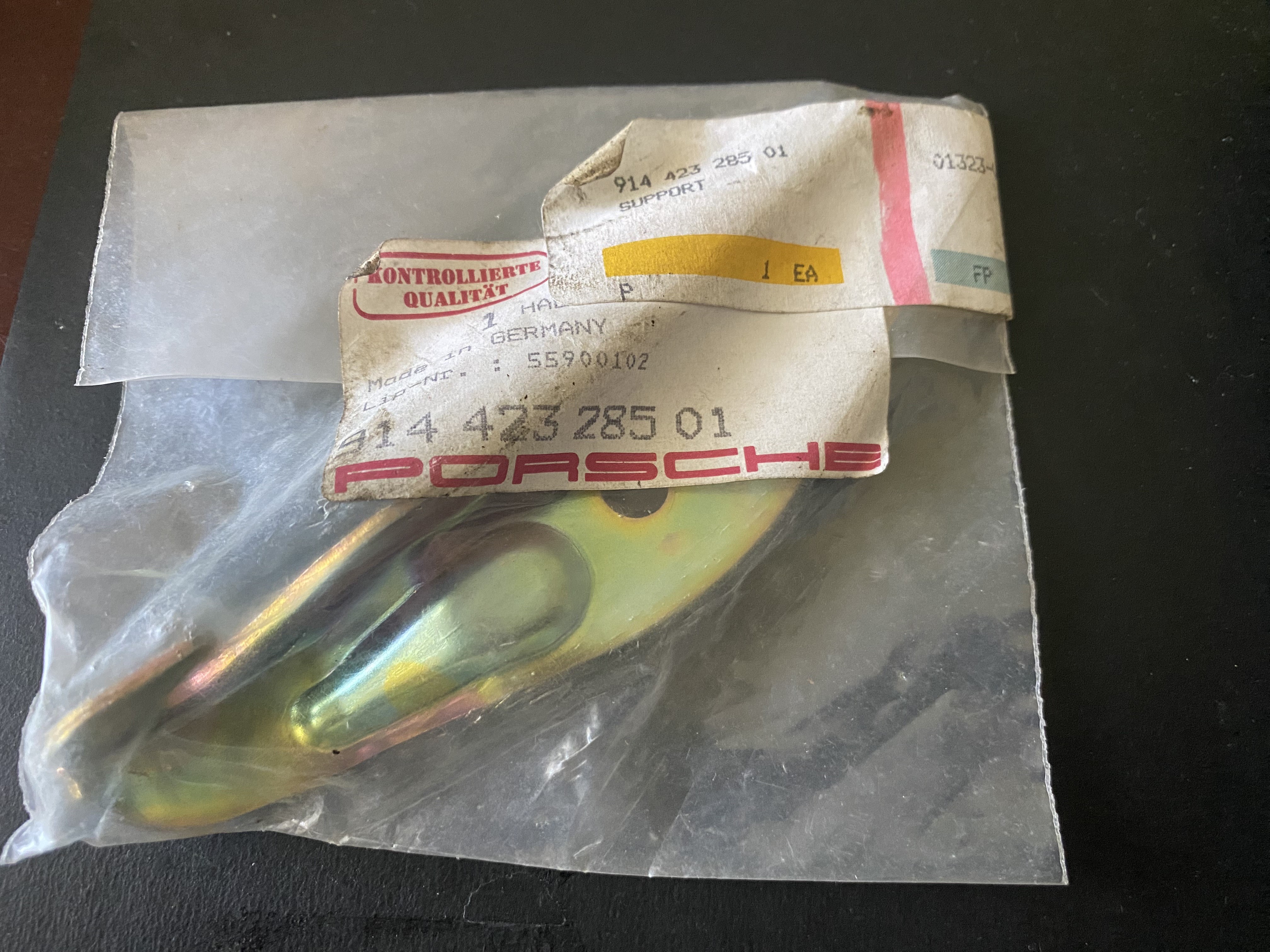

I'll second that! Here is the 914-6 throttle bracket that he pulled out of his attic after I mentioned that I needed one.

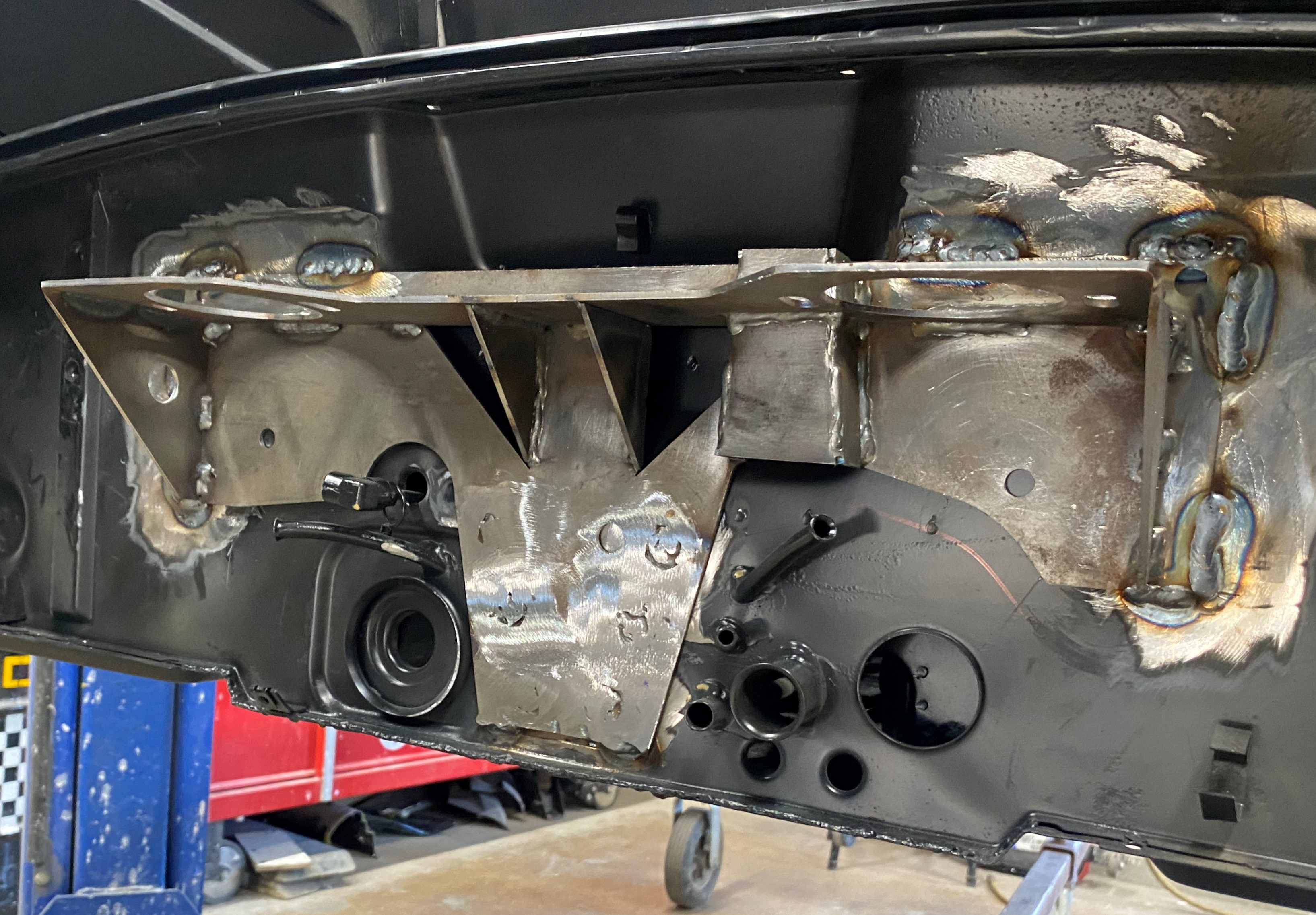

Ben McFarland's oil tank had been installed.
Tom1394racing
Mad Dog's engine mount installed.

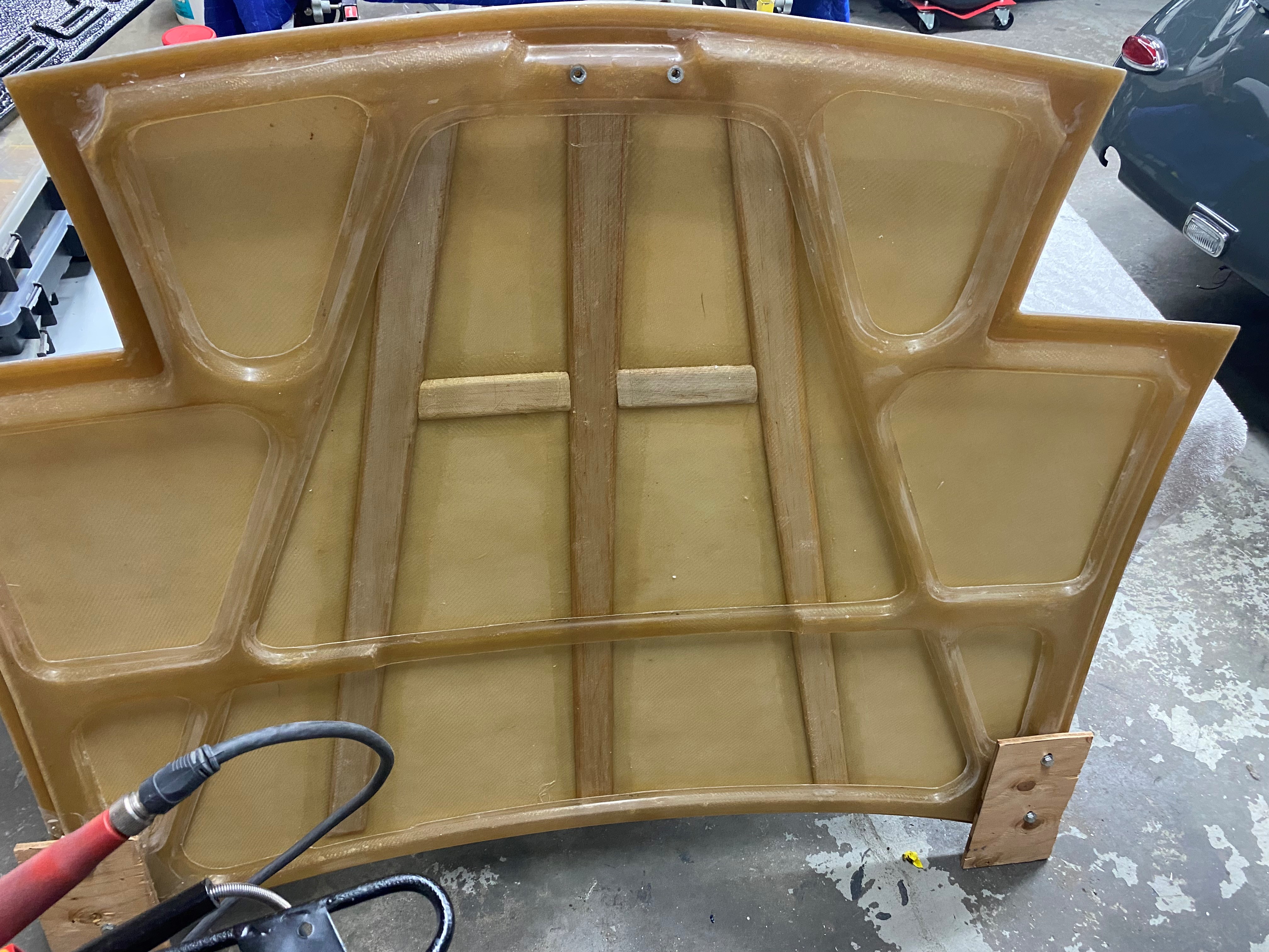

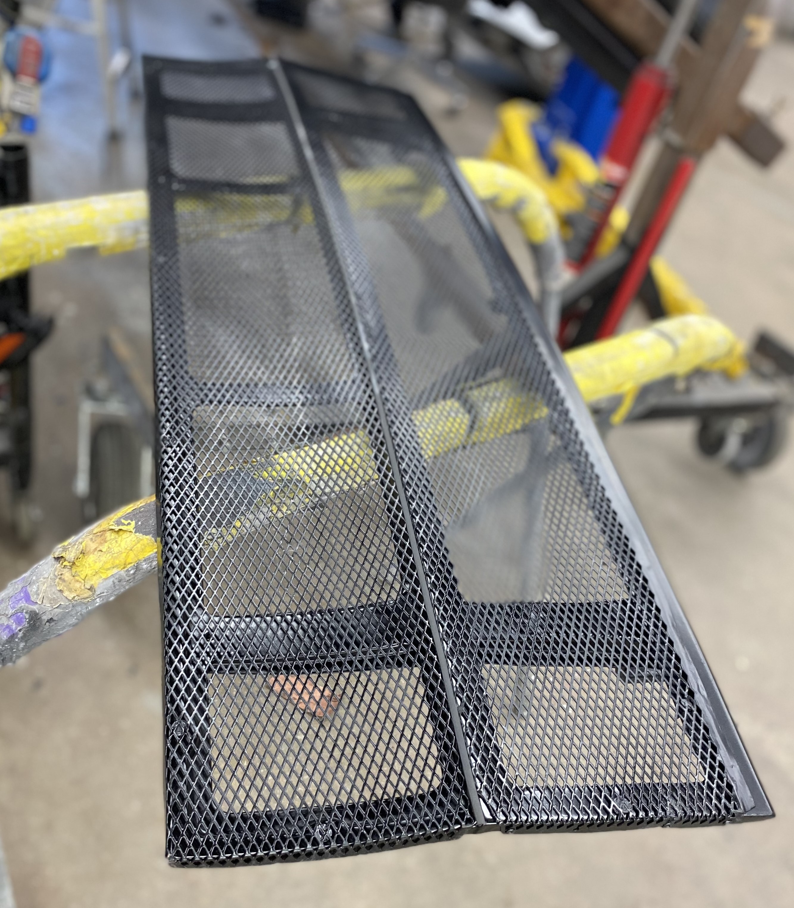

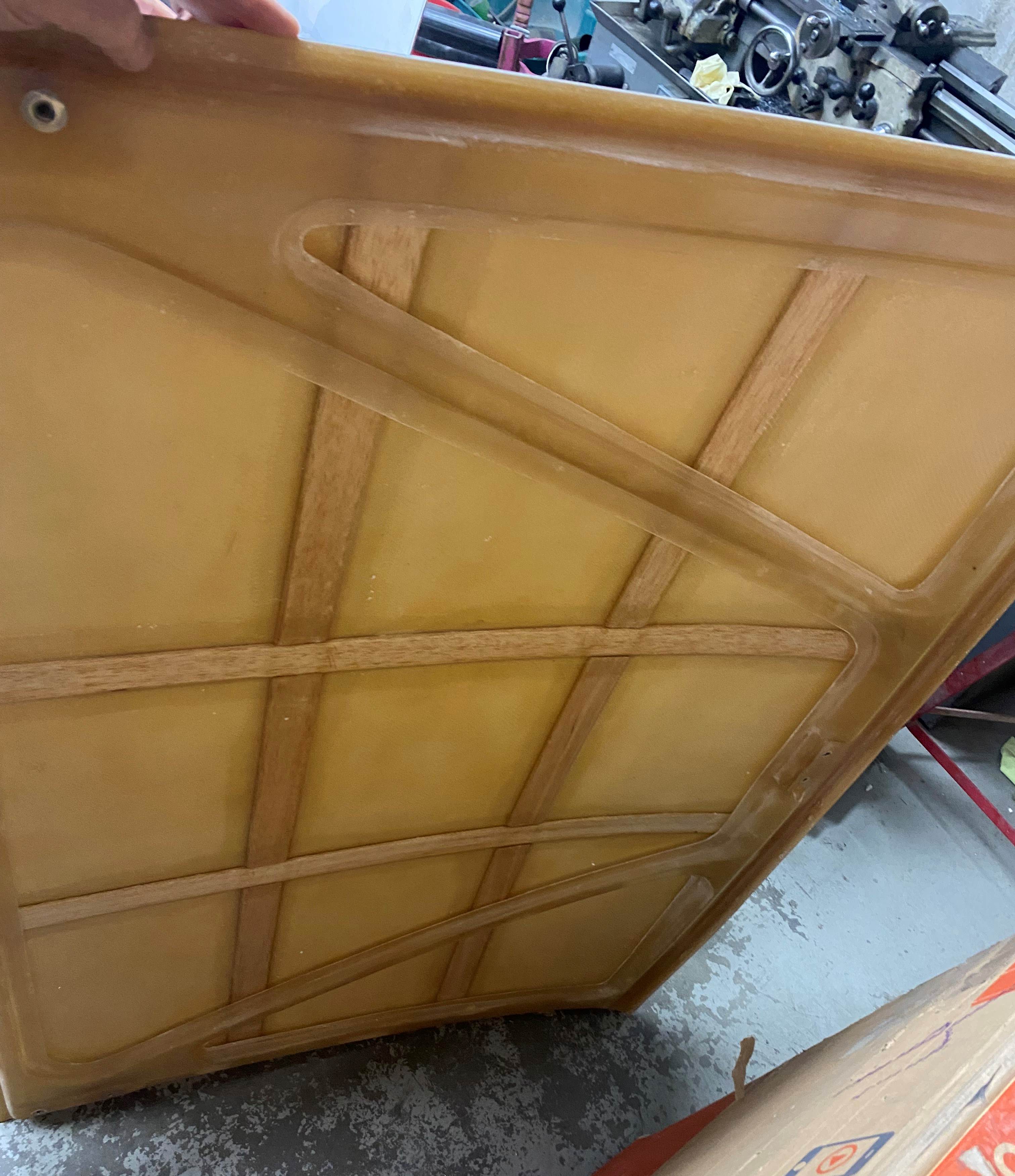

Balsa reinforced front and rear lids from Getty arrived last week.
Tom1394racing

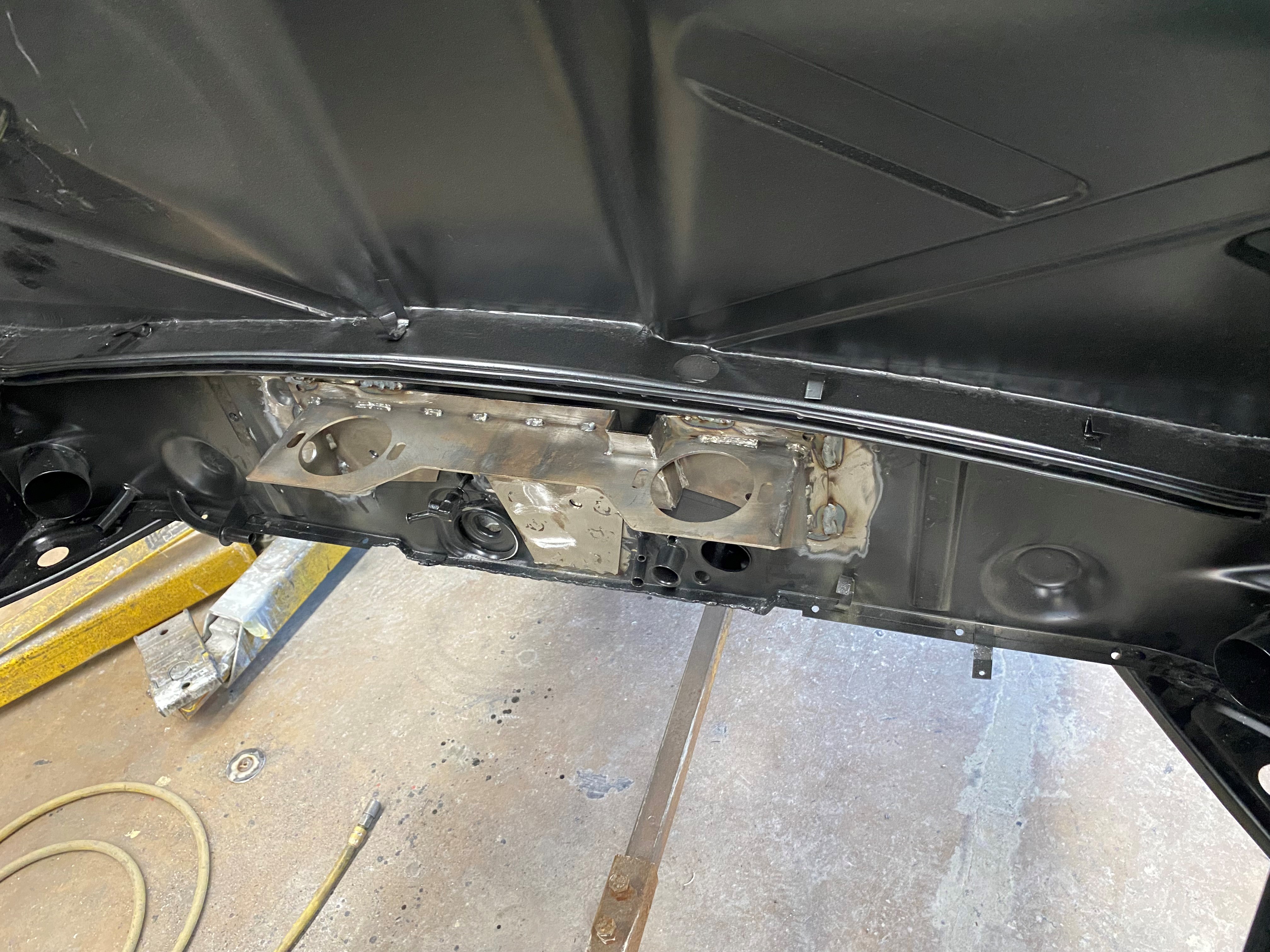

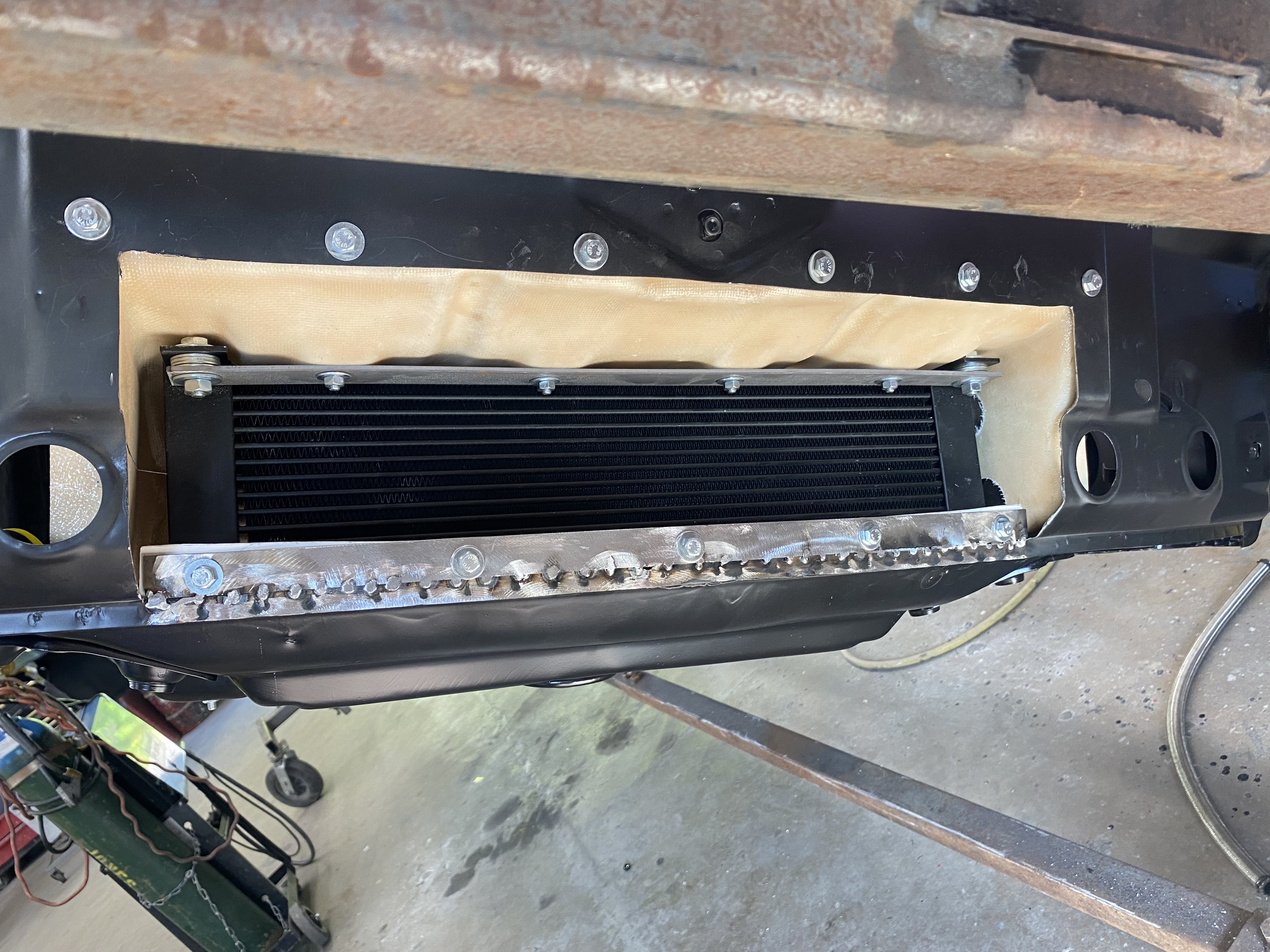

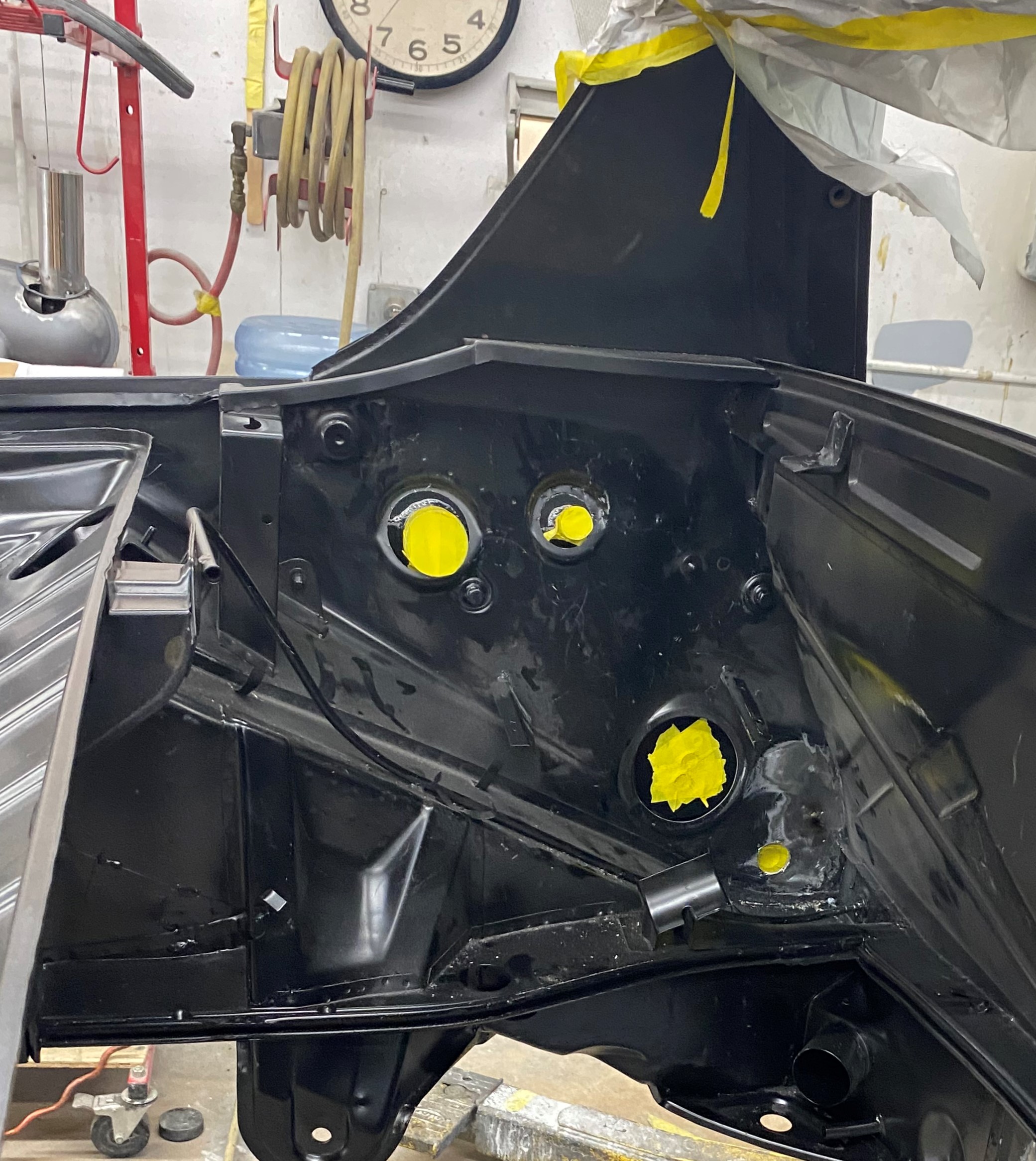

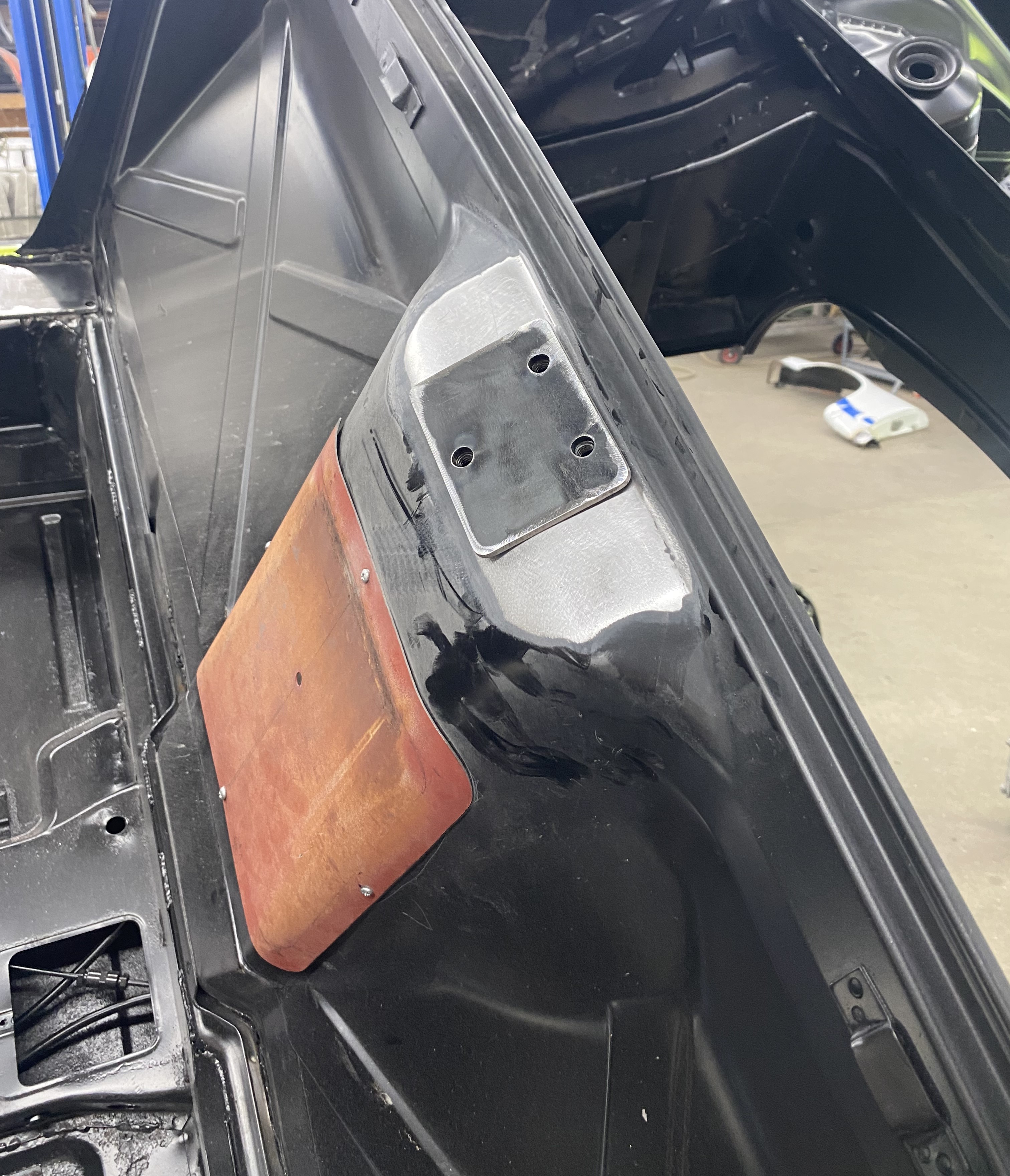

Working on the front cooler and engine access panel.

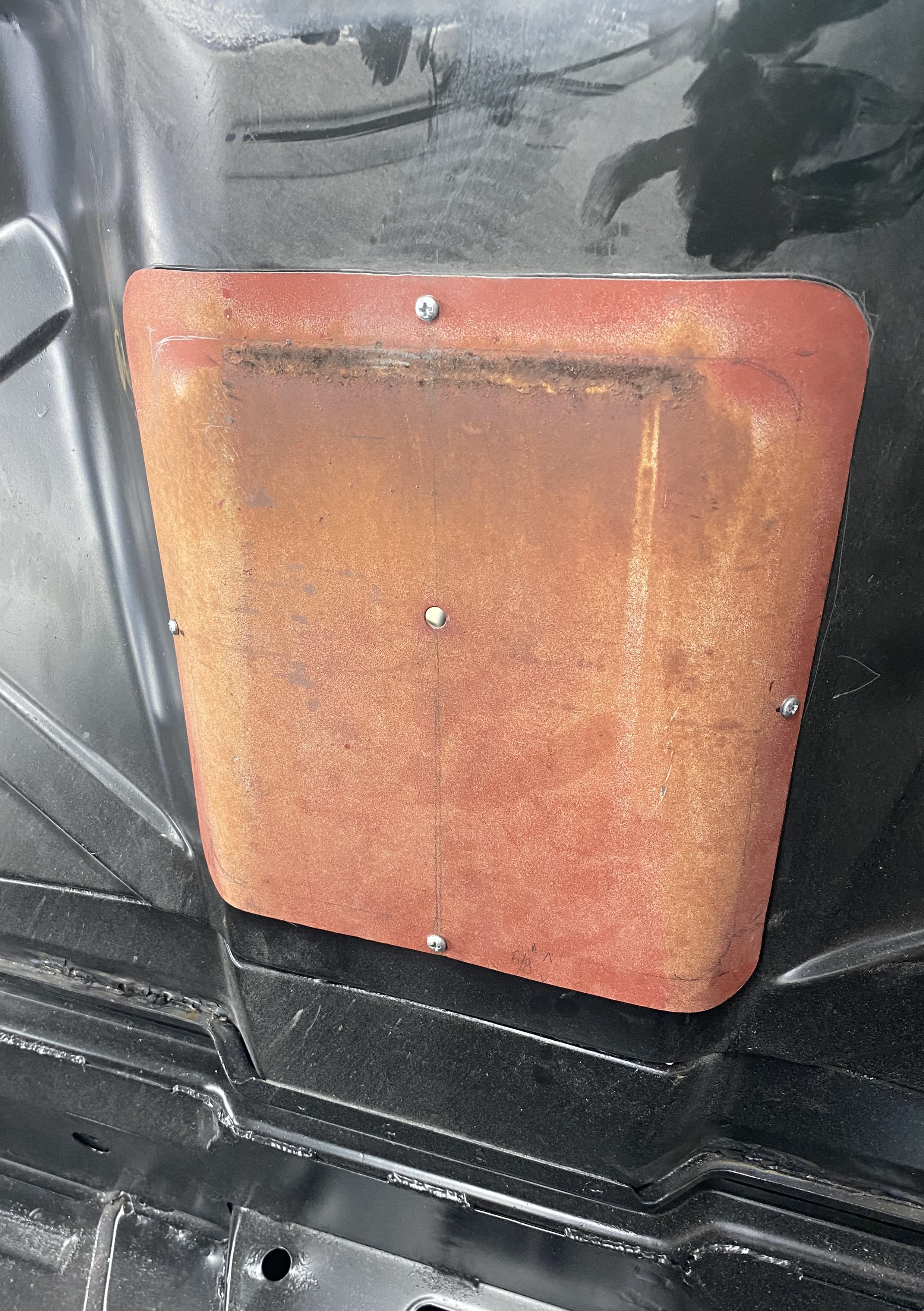

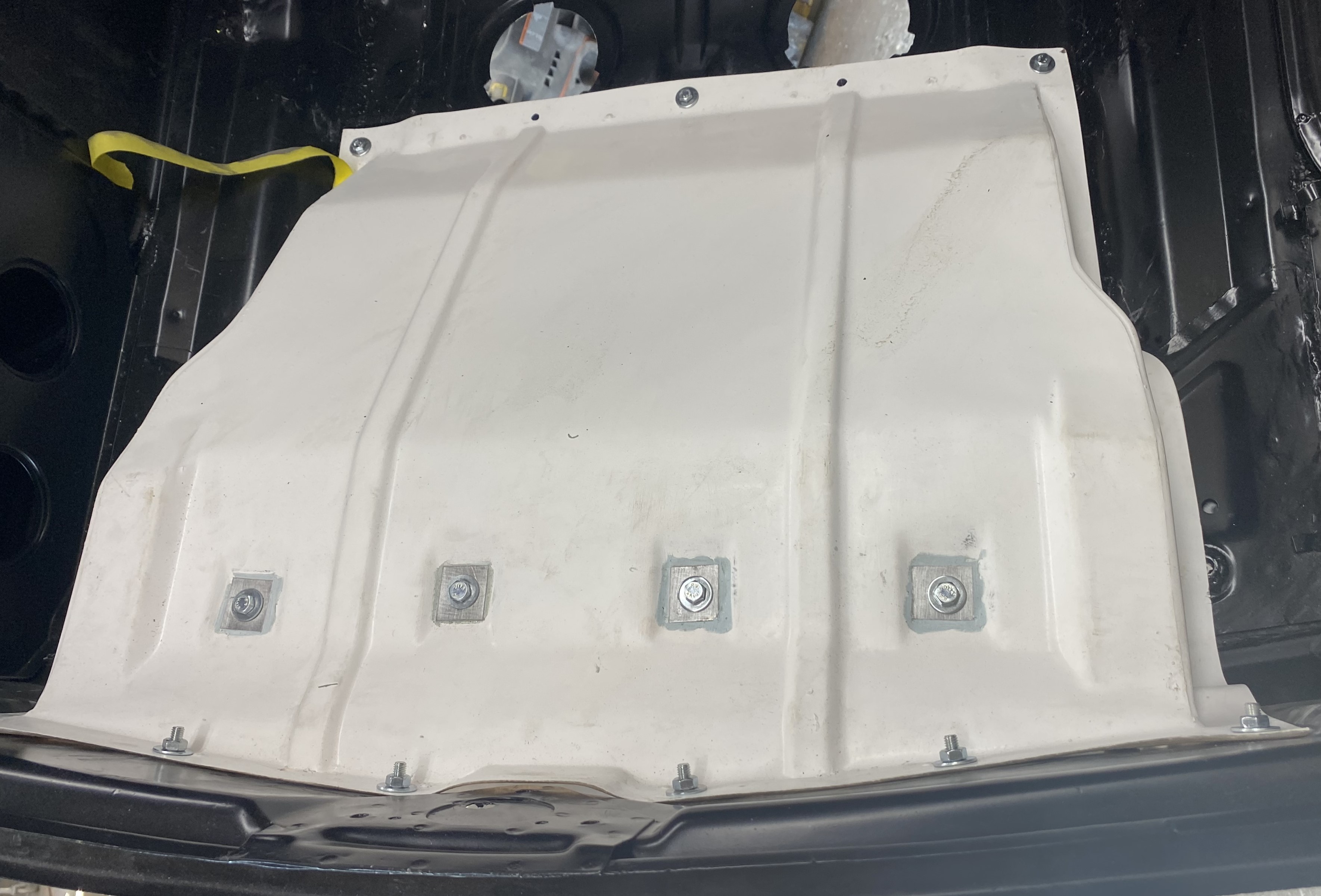

Things are moving forward quickly at Auto Associates. Here is the engine access panel along with the center mount for the GT roll bar.
Tom1394racing
The front cooler reinforcement has been added and the cooler & ducting test fitted.

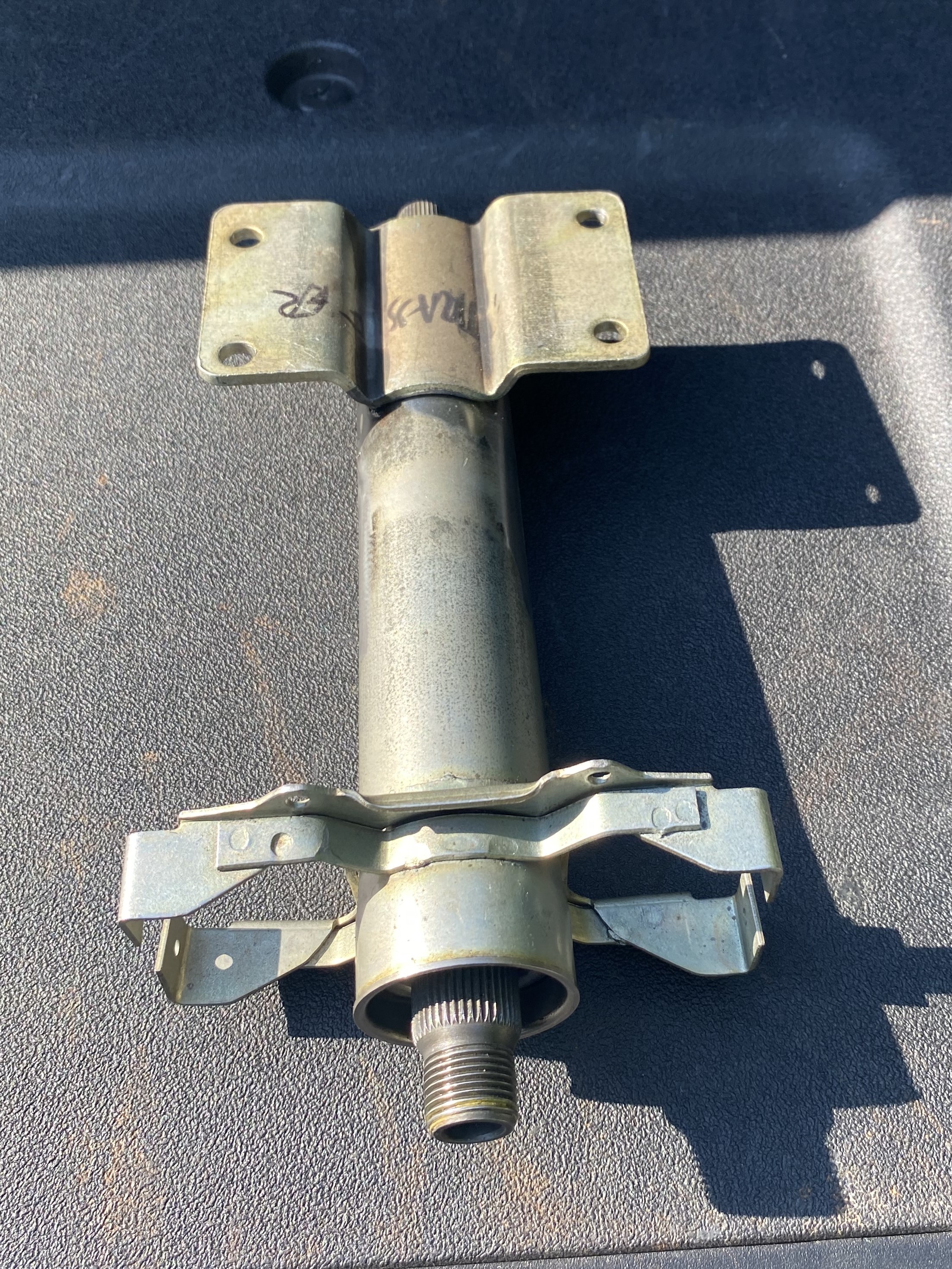

Also, the early 911 steering column has been modified to fit the 914 chassis.

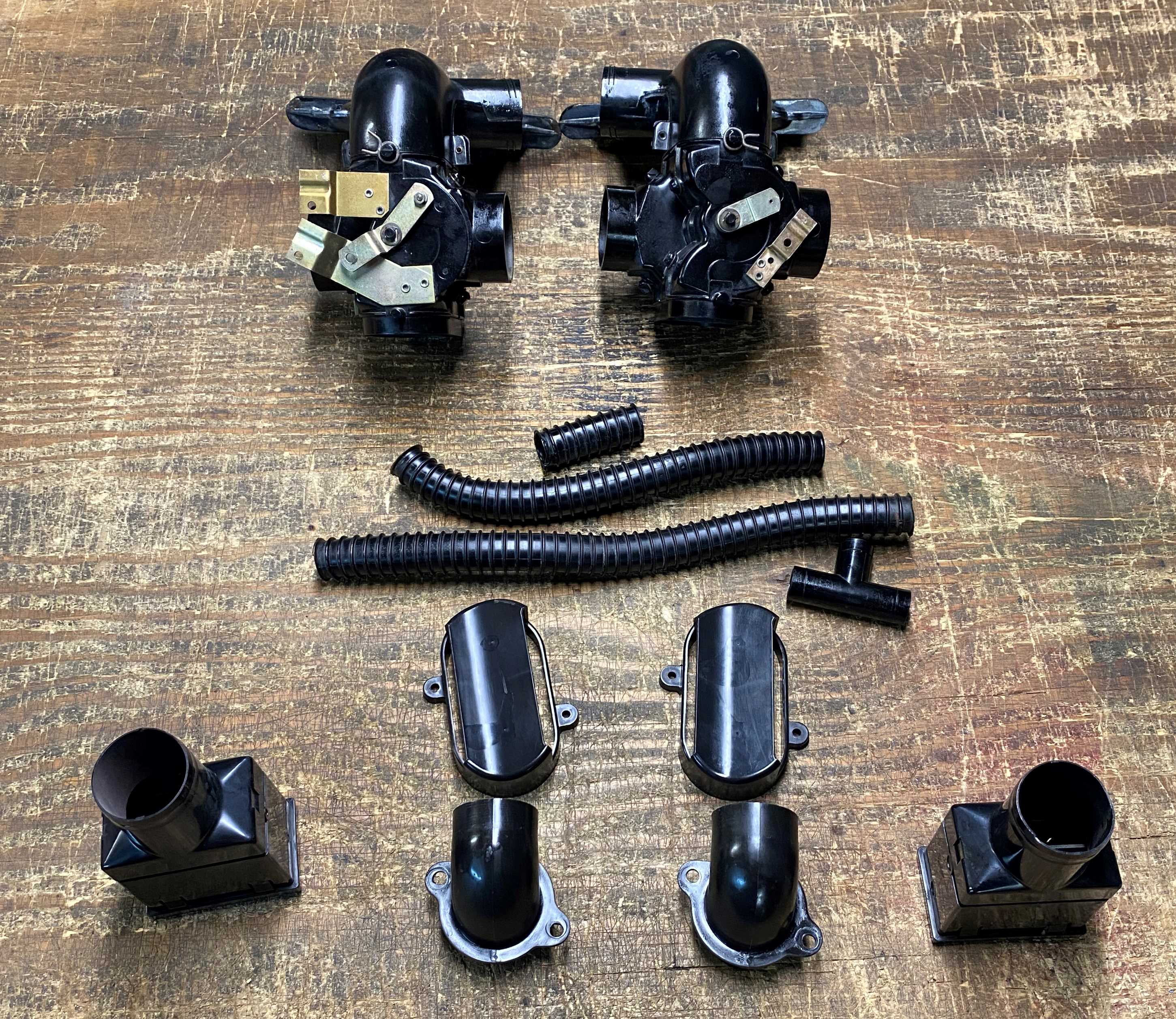

Question……
What was your procedure for restoring plastic parts of ventilation system?

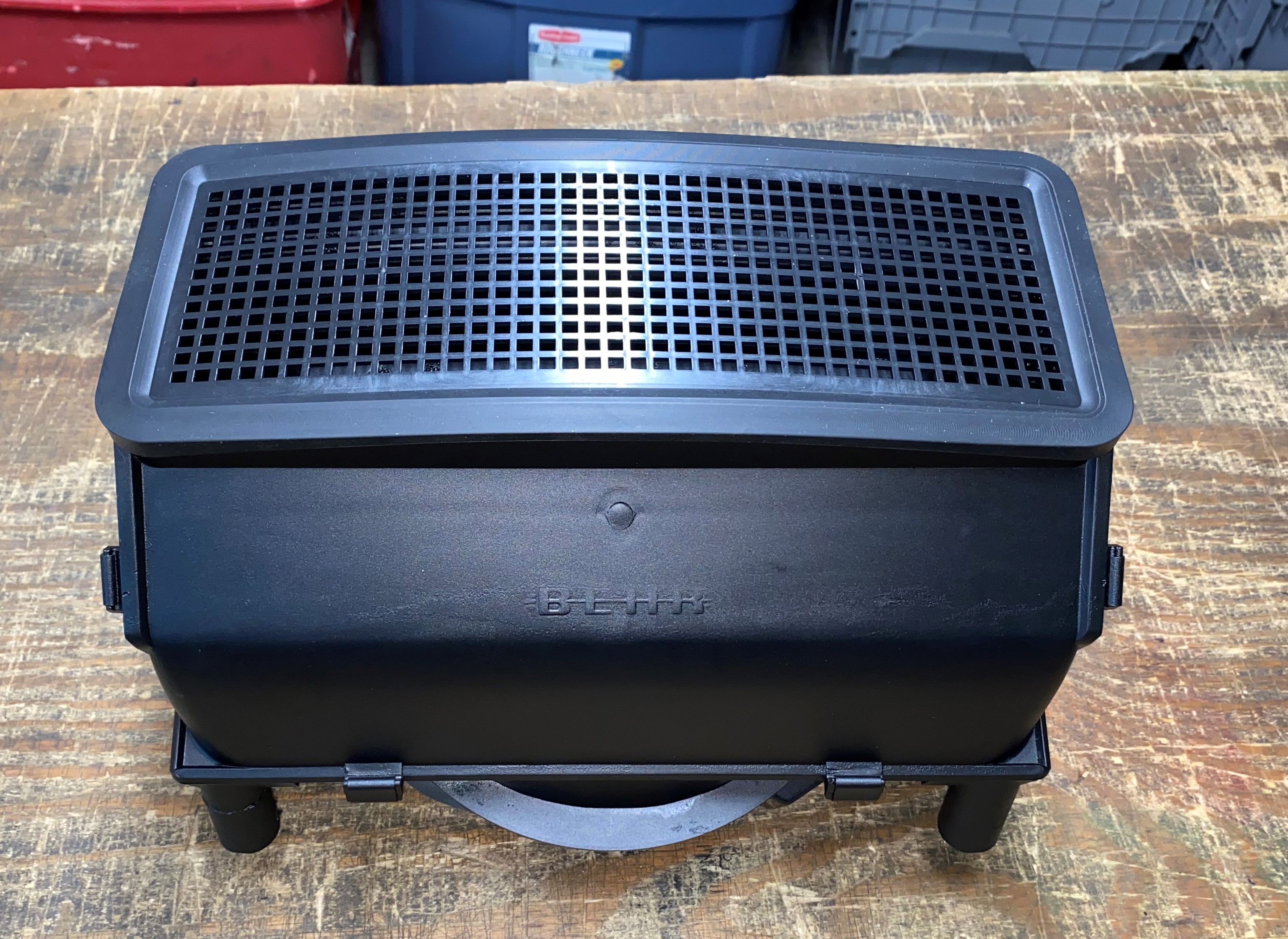

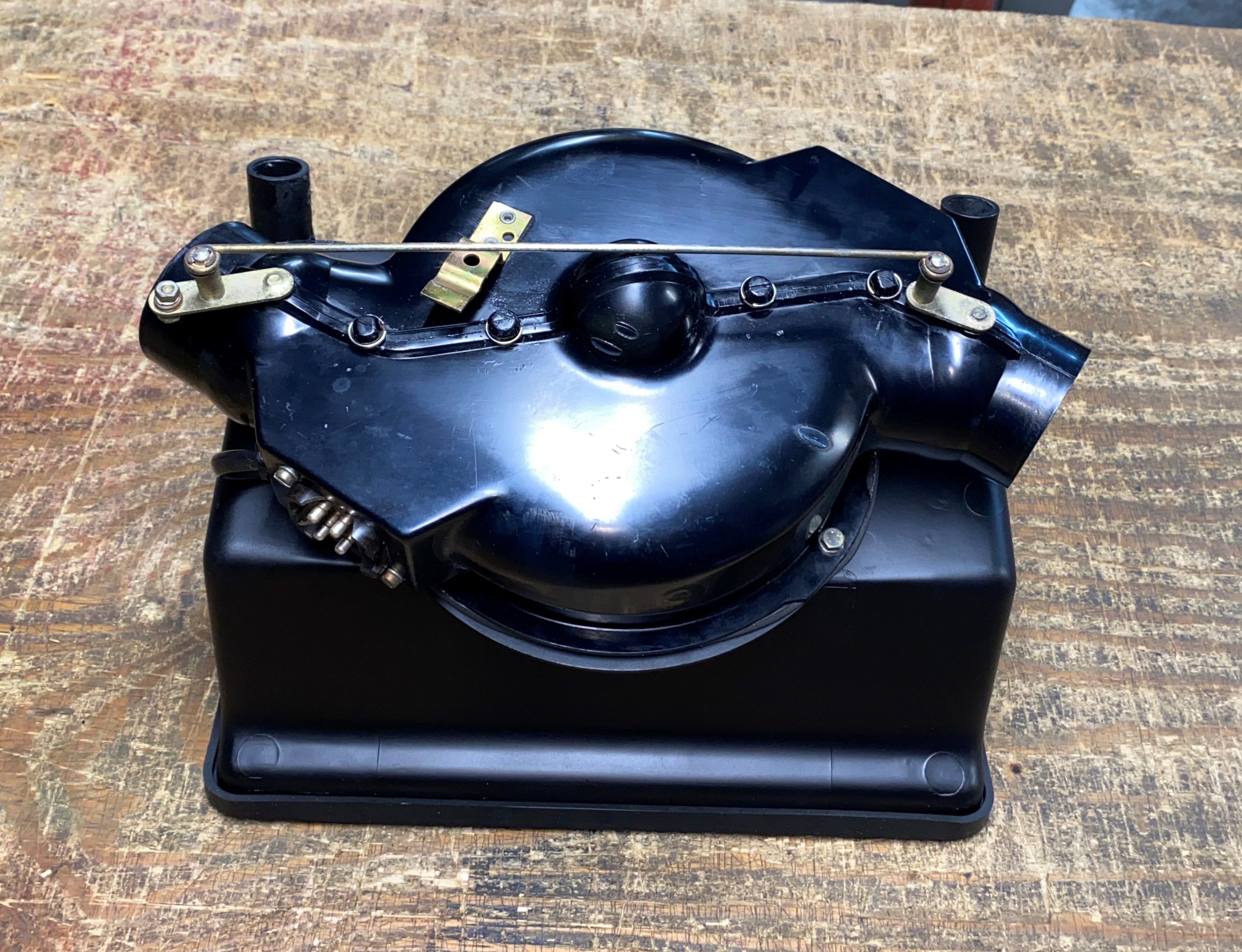

Tom1394racing
QUOTE(sixaddict @ Sep 7 2023, 12:13 PM) *
Tom
Your work on this gives me indigestion………it is above and beyond great! Process shows a level commitment I’m having trouble finding.
Question……
Thanks,
Terry
First, a thorough cleaning with soap and water. Then removal of any, and all overspray with Goo Gone and a soft Scotch-Brite pad. Then I used Maguires Cericoat wipes to restore luster. I did not remove any of the hardware and haven’t re-plated as I was able to polish to my satisfaction.

GREAT info, it gives a normal garage guy hope on similar results.

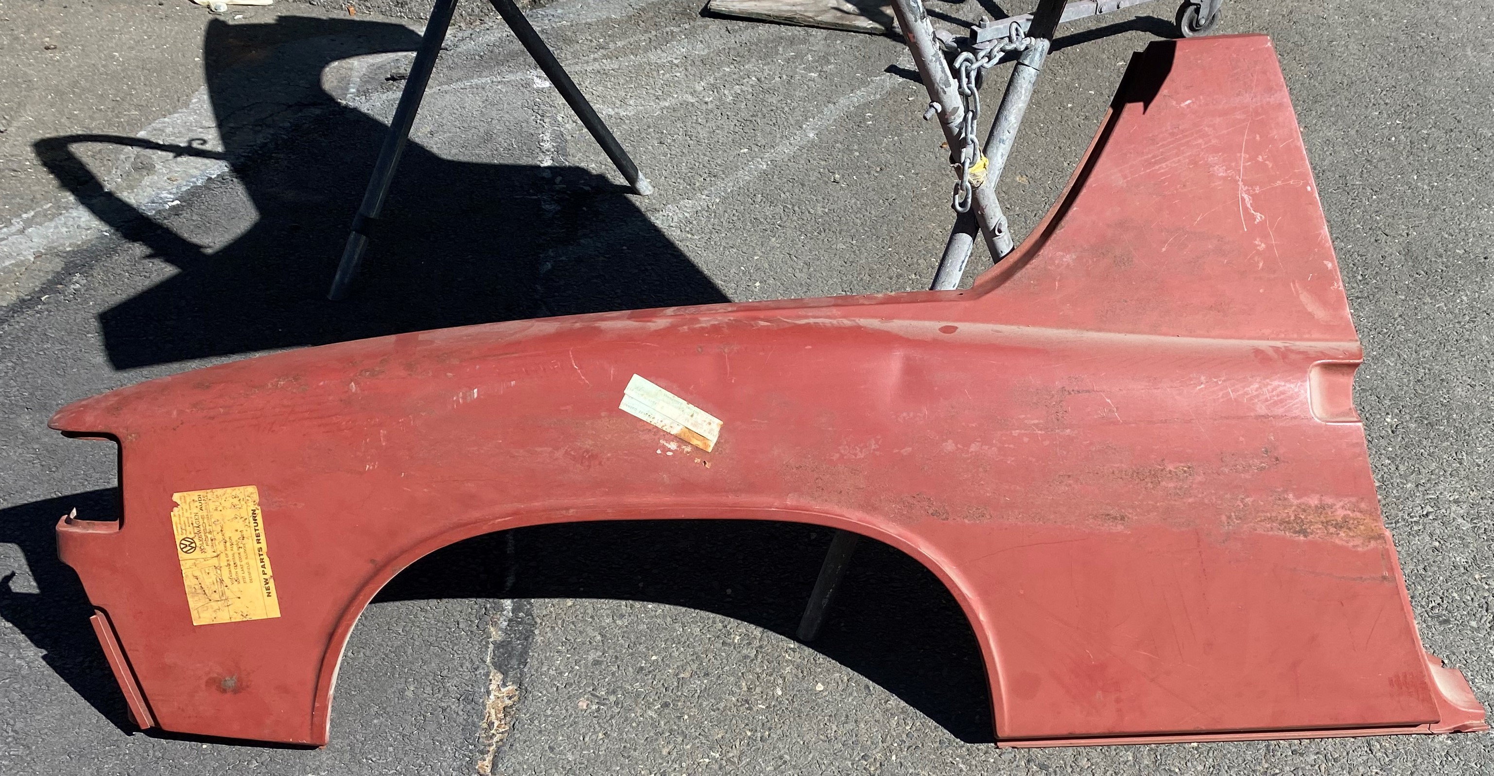

Tom1394racing
Rear quarter prepped for installation of the NOS quarter panel.
Tom1394racing
Sergio's GT engine lid with the diagonal removed for a more authentic GT look.
