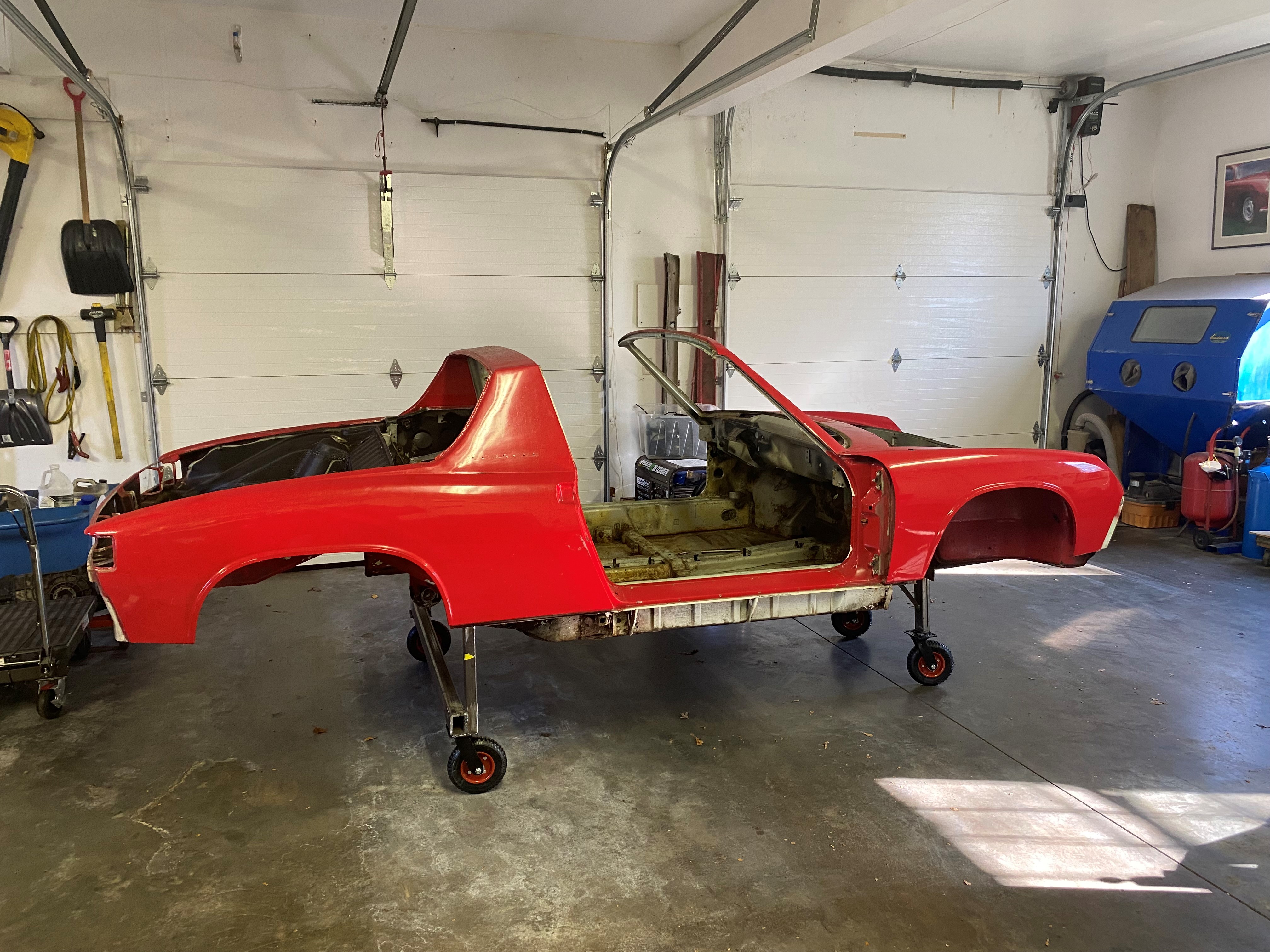

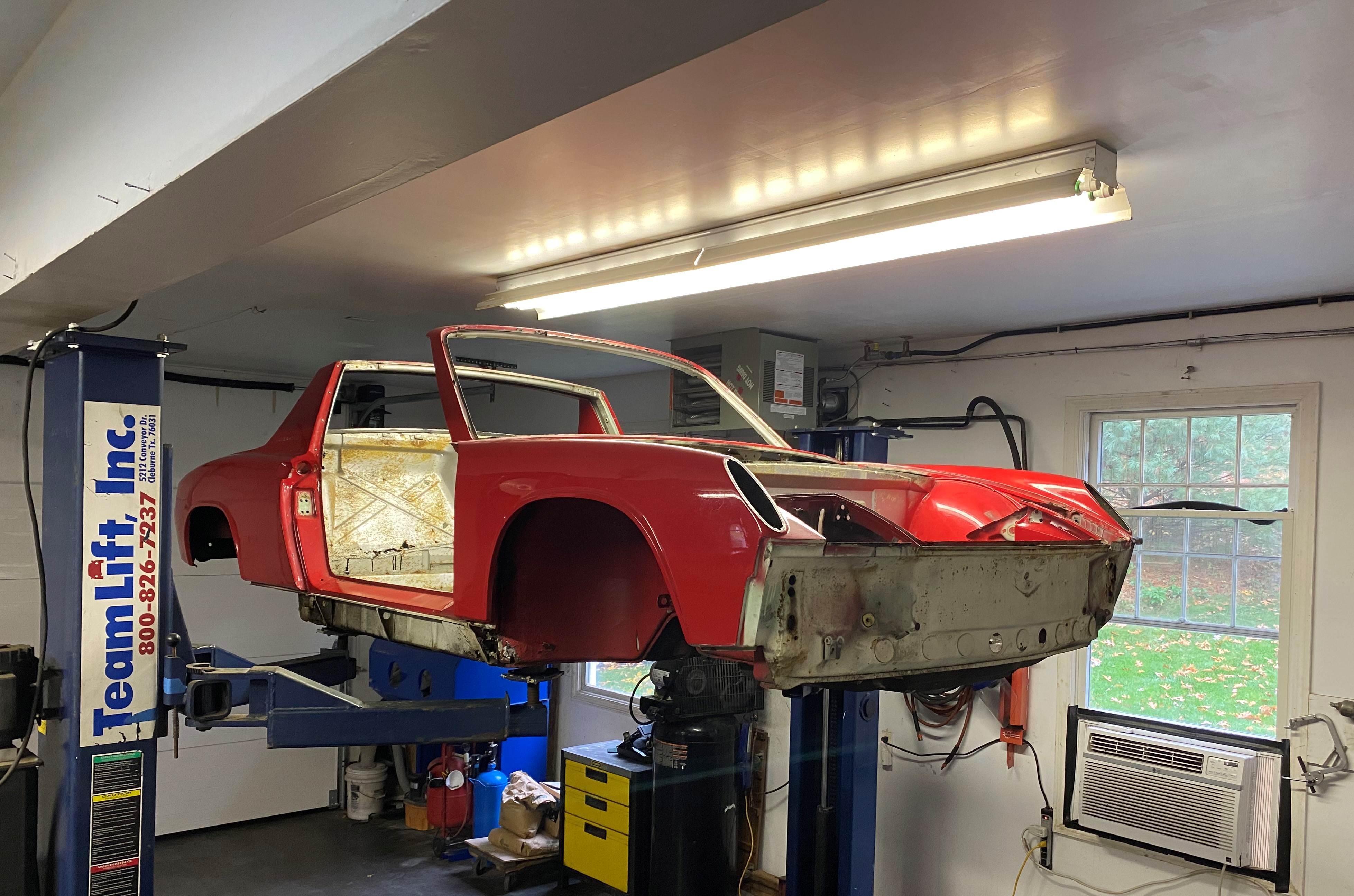

Time for an update on my GT project. After a long delay while waiting to clear garage space, I sold my 1970 911E restoration and moved the 914 from the basement to the garage and onto my lift. The car is now stripped to a bare shell. After consulting with Ken (body shop manager & co-owner) at Auto Associates, we have decided to send the shell out to be dipped, stripped and E-coated prior to starting the chassis restoration at Auto Associates.
Ken recommended a shop in Livonia, MI that does a multi step process consisting of:
1. Hot tank cleaning dip
2. Pressure wash to remove all dirt, gunk and paint
3. Acid dip to dissolve all rust
4. Neutralizing dip to stop the acid process
5. Epoxy primer for rust protection
The hot tank cleaning dip will dissolve anything that is not steel on the shell. This would include the longitudinal heater tubes. So we have decided to cut out the inner longs prior to the dipping and then replace the heater tubes and the longs as part of the chassis restoration. This should give us a chassis that is completely devoid of any rust and is also protected against any further rusting.
This will require an 11 hour one way drive from my home in CT to the shop in MI. I have searched and tried to locate a shop closer to my home that offers the cleaning, de-rusting and E-coating but have not located one. If anyone knows of a shop within a 6 hour radius of Hartford, CT that offers this process, I would be interested in checking them out.
Click to view attachment Click to view attachment

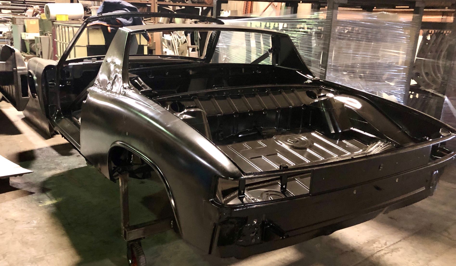

So to get back to my car, the 912 is at the Ecoat place and should be done by the end of the week. It’s a 12 step process to clean the metal of all the flash rust and then e-coat. The chem dip exposed some additional corrosion but we’ll fix it when it gets home. The e-coat process is ~$3,500 and it was $900 each way to ship and $500 to ship between shops. Not cheap at all but I want a solid car that I can trust not to have issues down the road. I wouldn’t have minded trailering it out but having to make a second trip to pick up means I really wouldn’t have saved any money when all was done. Plus that’s a lot of time to make two up and back trips.
The thing that was in my favor on the early 912 is it has steel heater tubes. After 67/68, Porsche moved to the paper tubes.
Pics so far

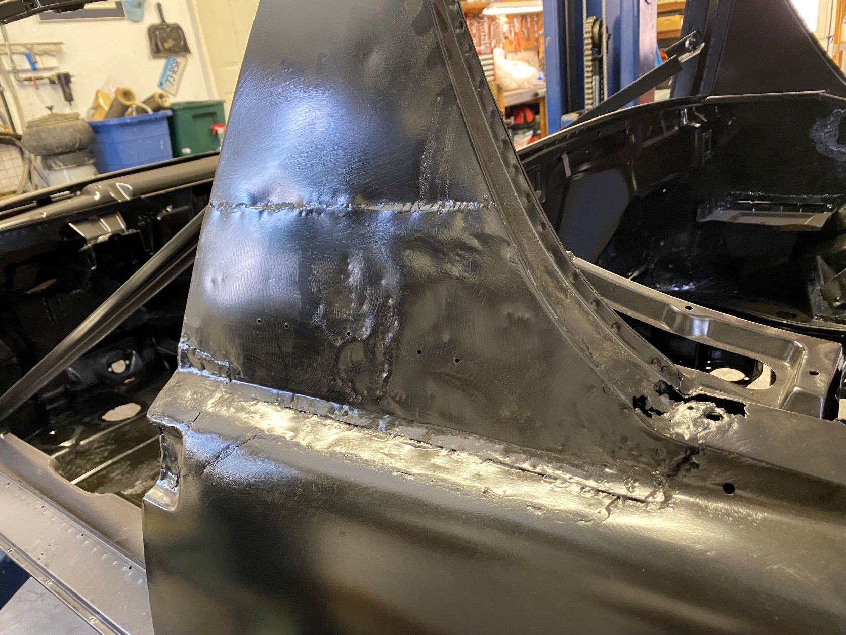

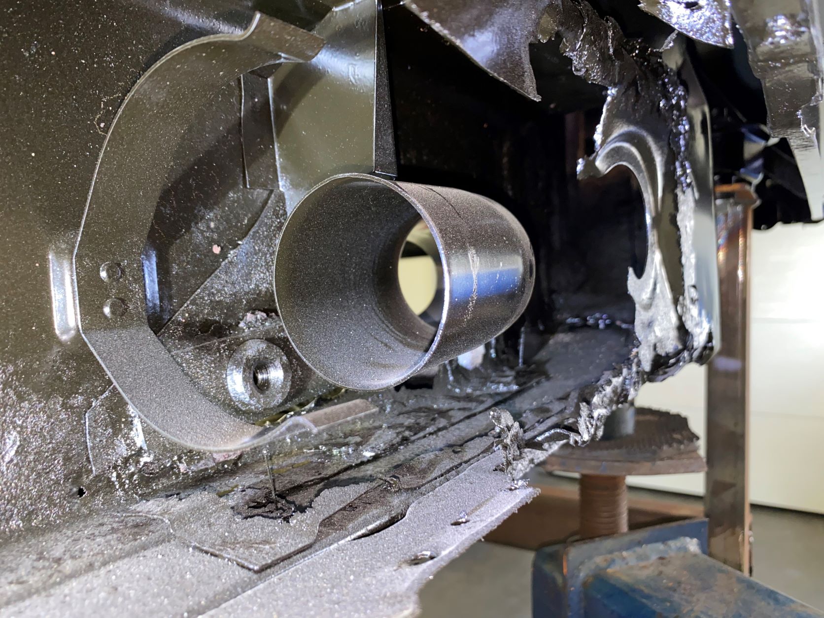

A pretty good f-up on my part was having Jared do the lead work (there’s a good amount on these old cars) before the chemical dip. Now I know the dip removes lead. I just did it that way to give Jared more practice- LOL!
There’s a fair amount of lead on these cars that can’t be replaced with body plastic. We tried it at the old shop and it just cracked. Jared stepped up and learned how to fill with lead beerchug.gif

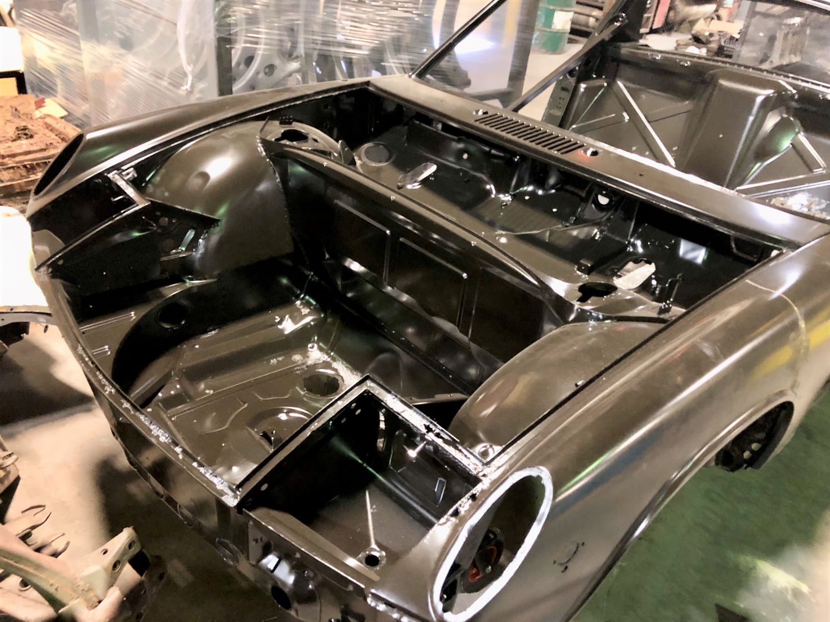

Hey Mark
Thanks for the info on your choices for chemical stripping and E-coating. The shop I am considering in MI quoted me $3600 for hot tank dip/pressure wash/acid dip/neutralizing dip/e-coat dip. They do it all in house. Seems like the best choice for me especially when they are recommended by the shop that will be doing my chassis and paint work. 11 hours will be a long drive to make four times but I think it will be cheaper than shipping.

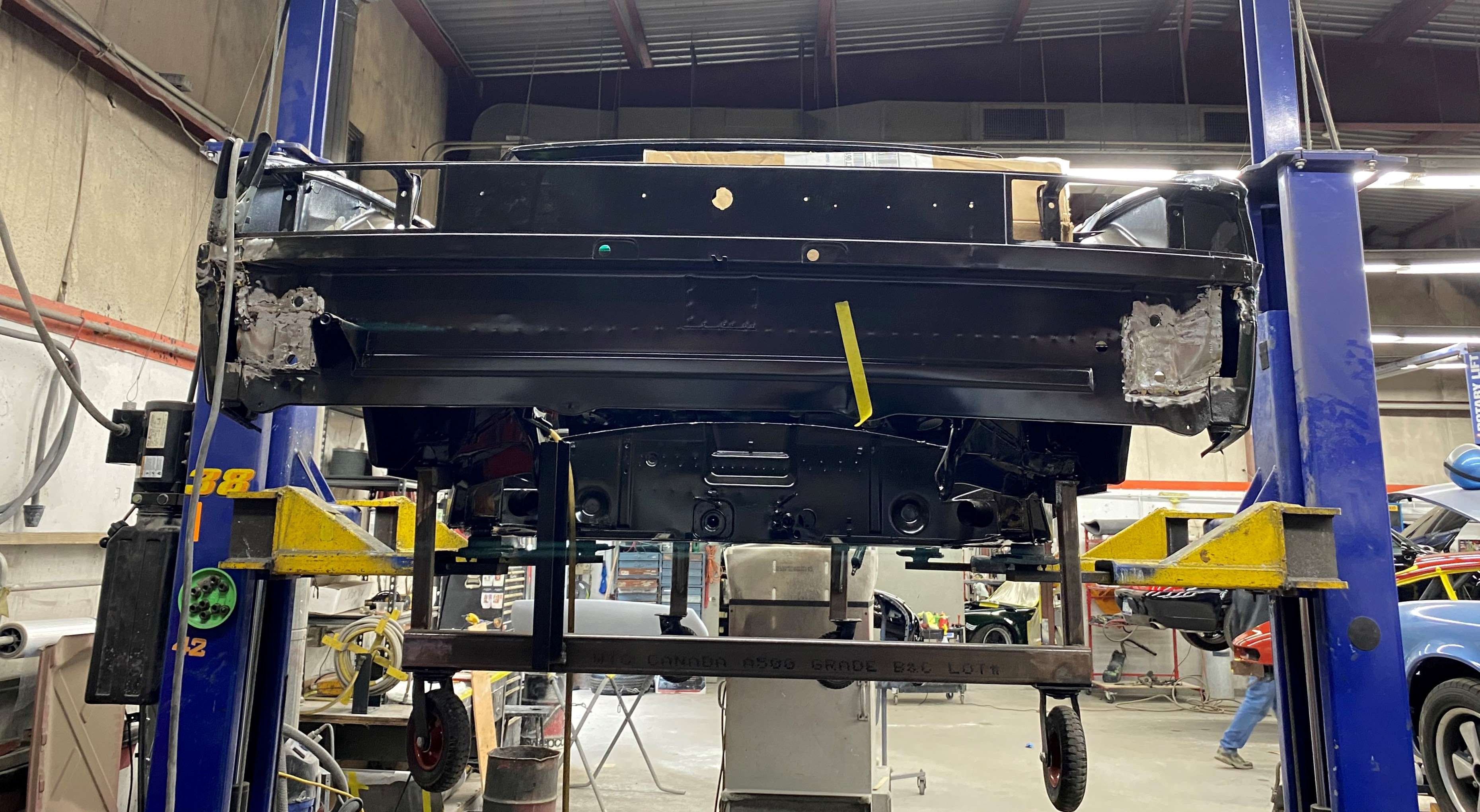

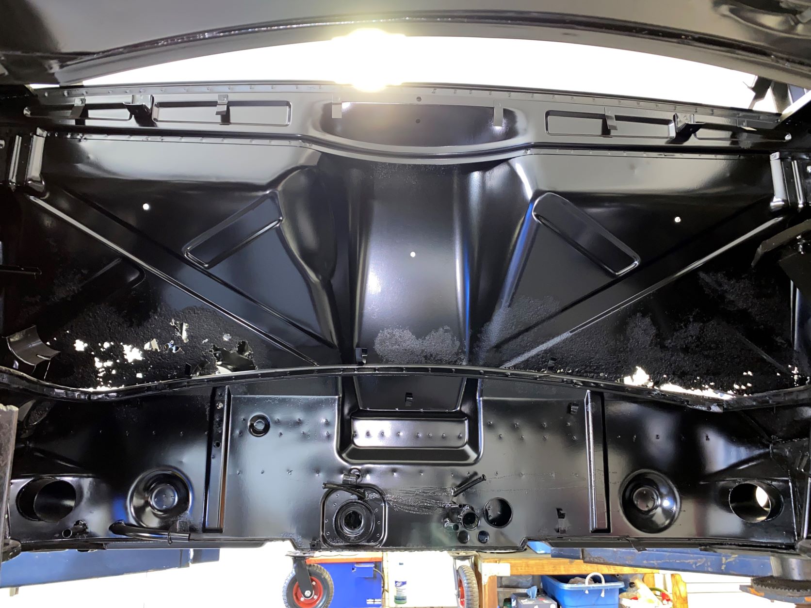

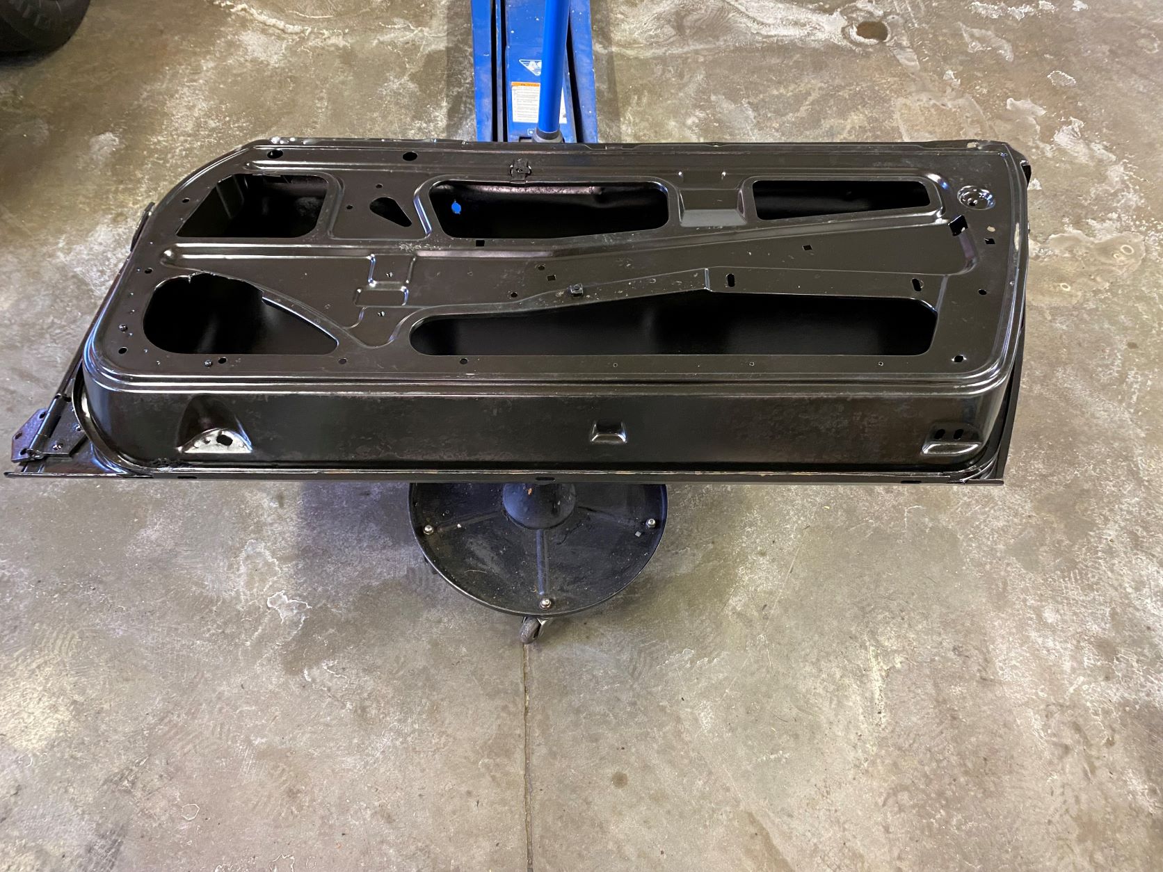

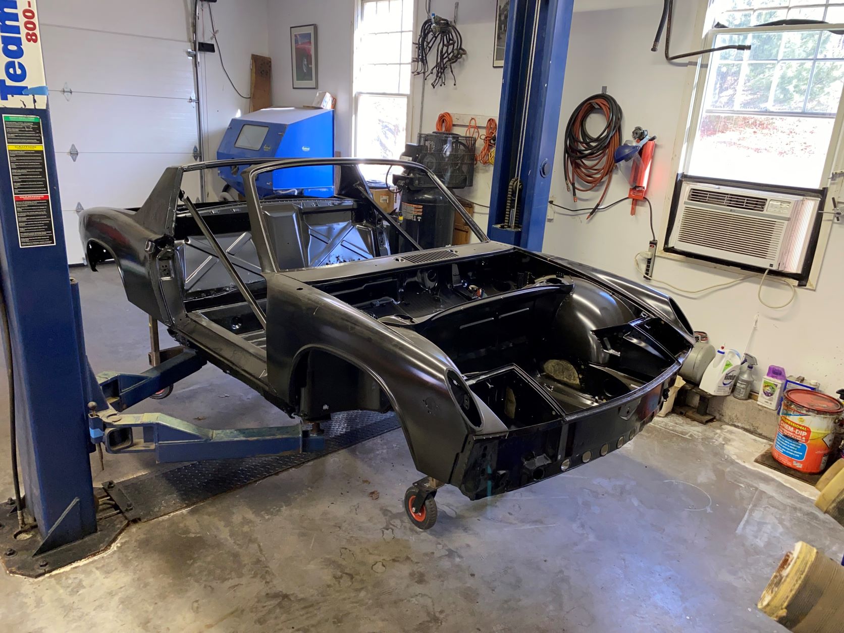

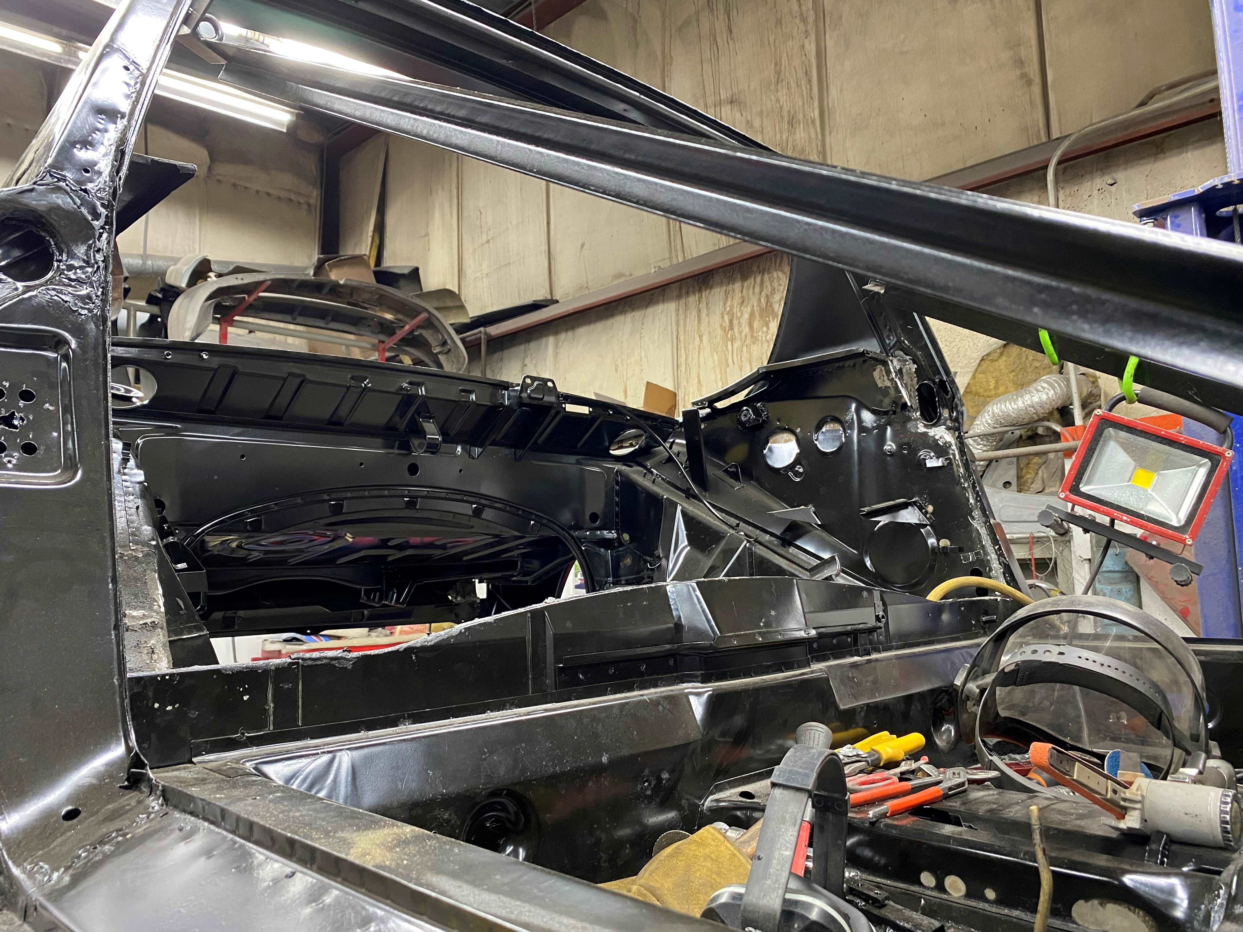

Just got done e-coat
TJB/914
QUOTE(mepstein @ Nov 4 2022, 01:29 PM) *
M
Tom
Cairo94507
rgalla9146
That's beautiful Mark. Absolutely the right way to go.
Structural work and repair has to be done before ?
How is bodywork done from this point forward without damaging the e-coat ?
The body looks like the current OEM replacement panels for 356s and 911s. Brand new.

The e-coat is really just primer that’s thin enough to flow into the seams (helped along by an electrostatic charge, like wet powder coat) and spots that a normal sprayed on primer wouldn’t get to. The very best way to handle chemical dip and e-coat is to dip, do metalwork dip again and then e-coat. But that’s two trips to the chem dip and an extra $5k. I have some touch ups to do. There was at least one spot on a door with holes where someone used a slide hammer. I also need to have some spots leaded in like the original. I actually had the lead done but unknown to me, it dissolves in the Chen dip. Learned a lesson on that. So I did not really care that the surface coating will get damaged. It’s doing its job below the surface. The chassis will probably sit for a while while I finish d a painter and save up to pay for it.

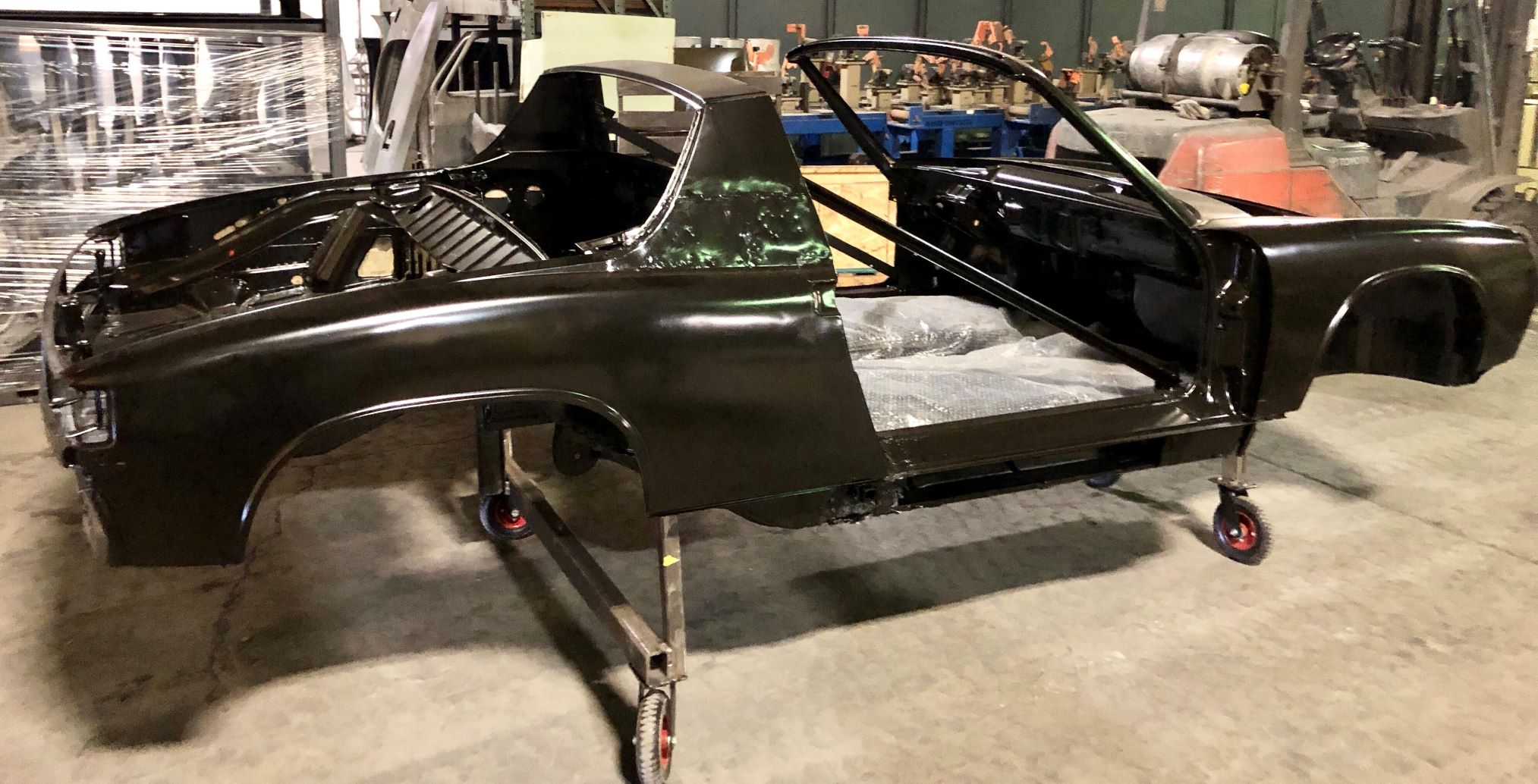

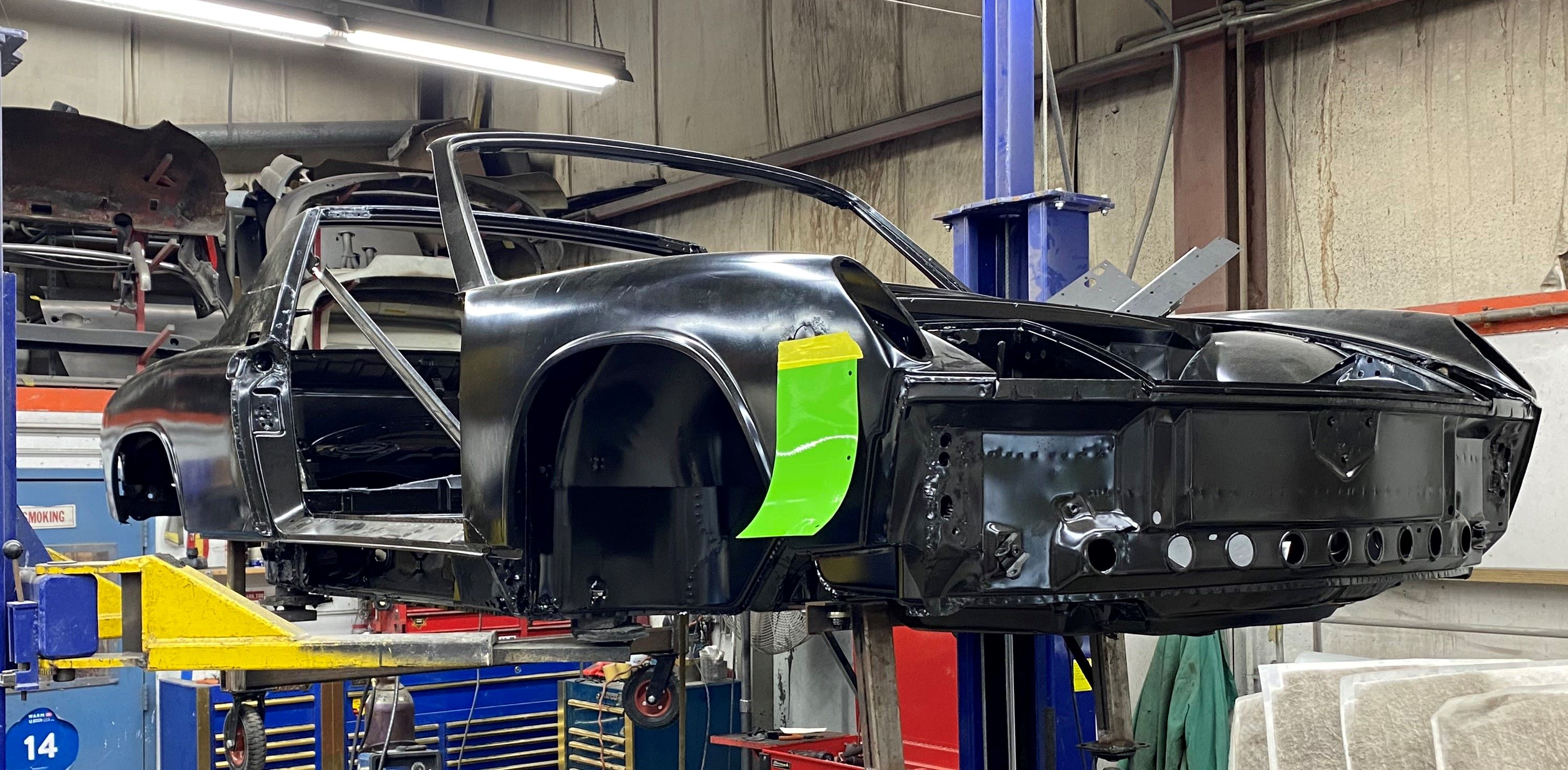

The shell has been stripped and mounted on a custom cart for transport. The car will go next to Auto Associates where the inner longs will be removed along with the Al heater tubes. In addition, they will install longitudinal braces. Then the shell will be shipped to International Paint Stripping in Romulus, MI. They are the closest shop that does the Hot Tank/Acid/E-Coat Dipping all under one roof. Once the dipping has been completed the car will go back to Auto Associates for the chassis restoration and GT conversion.

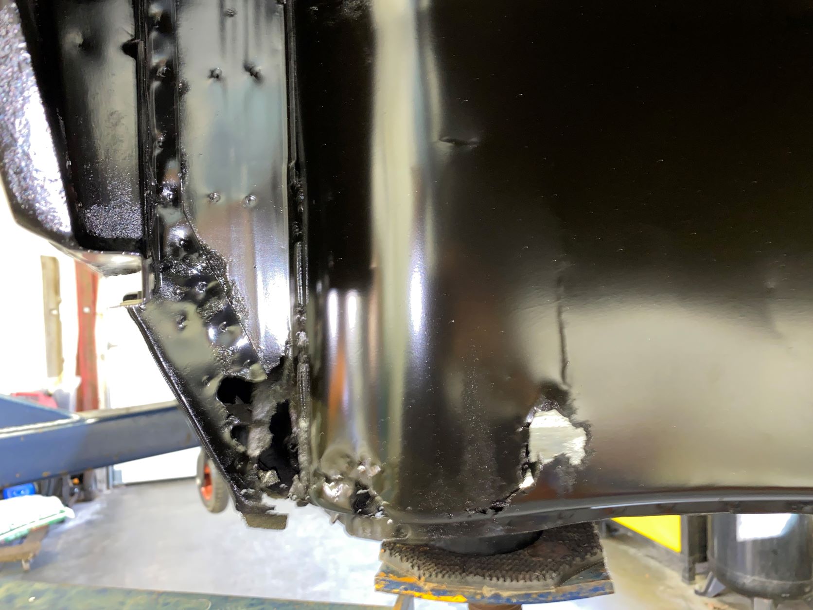

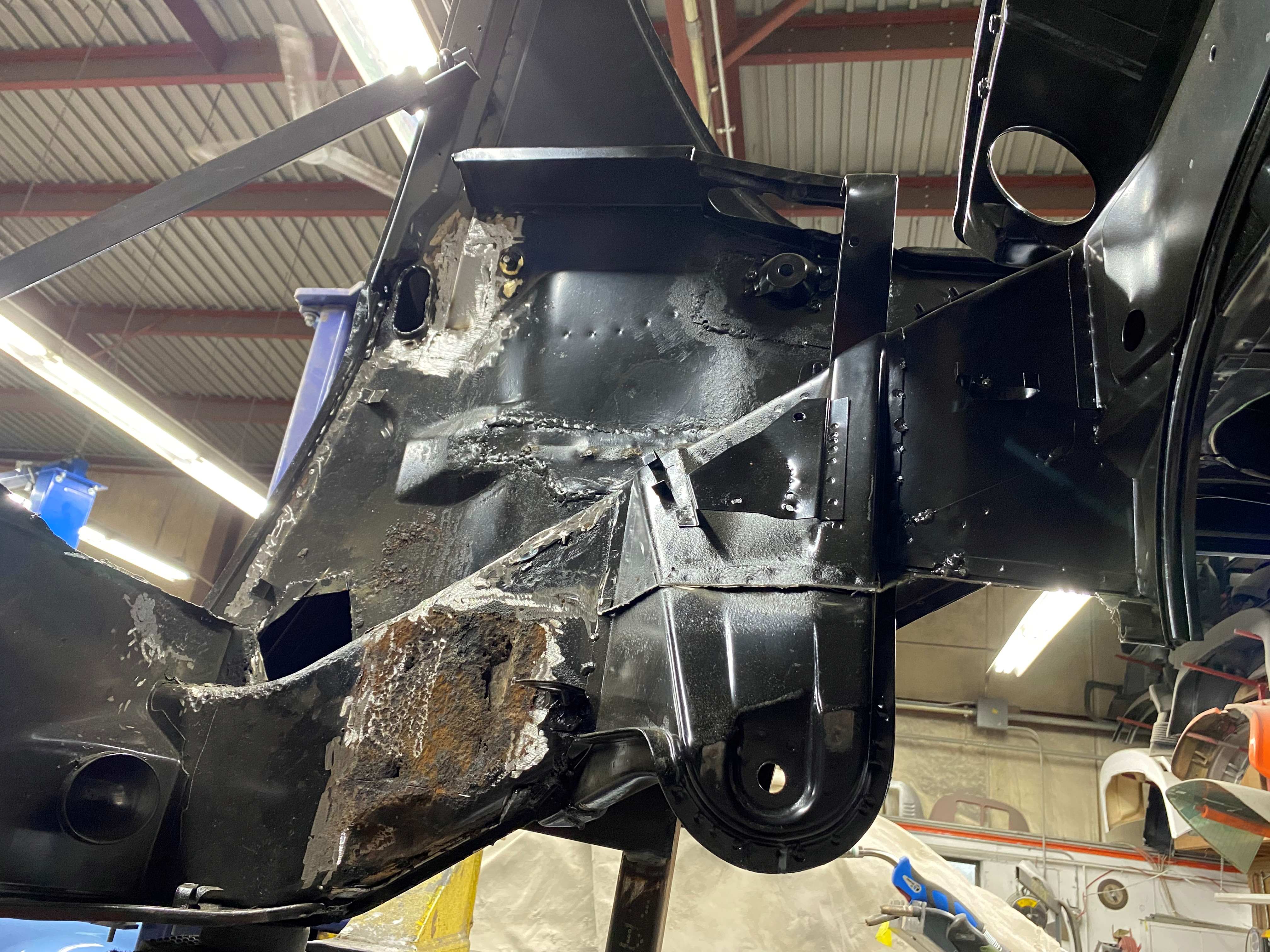

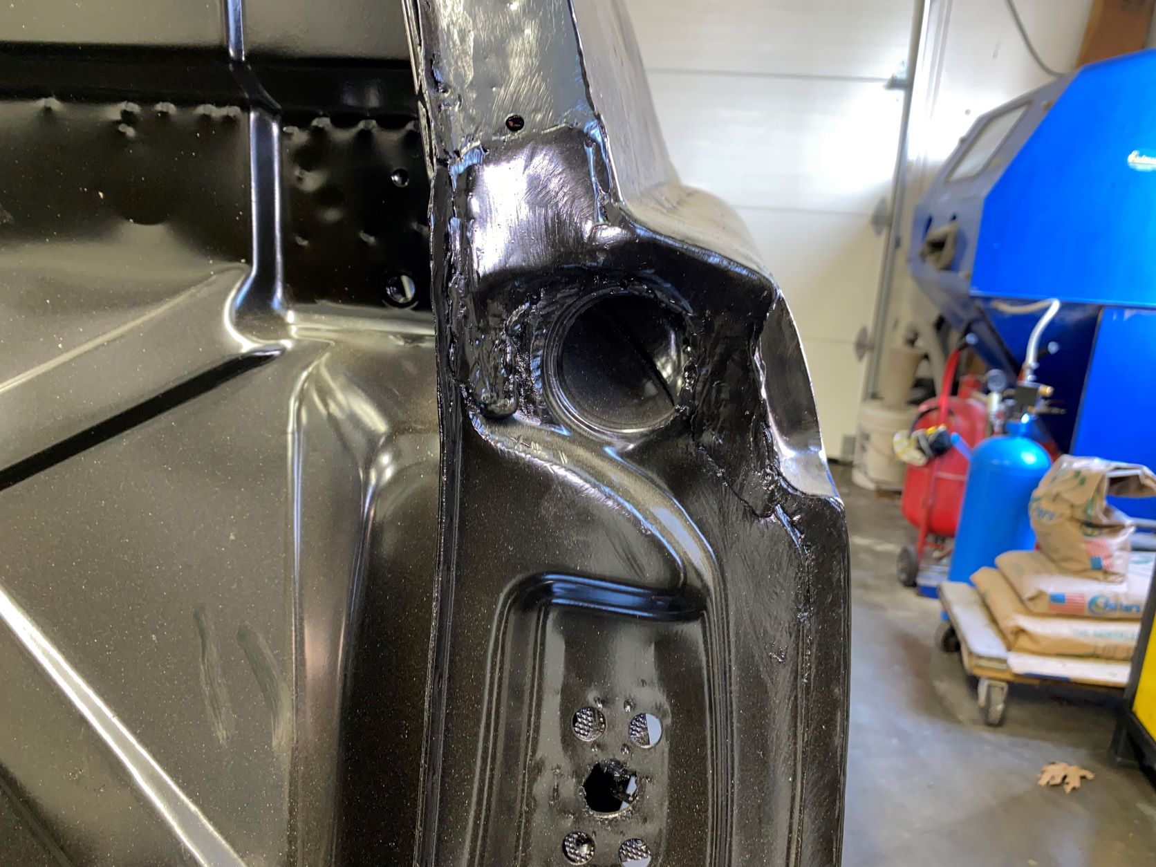

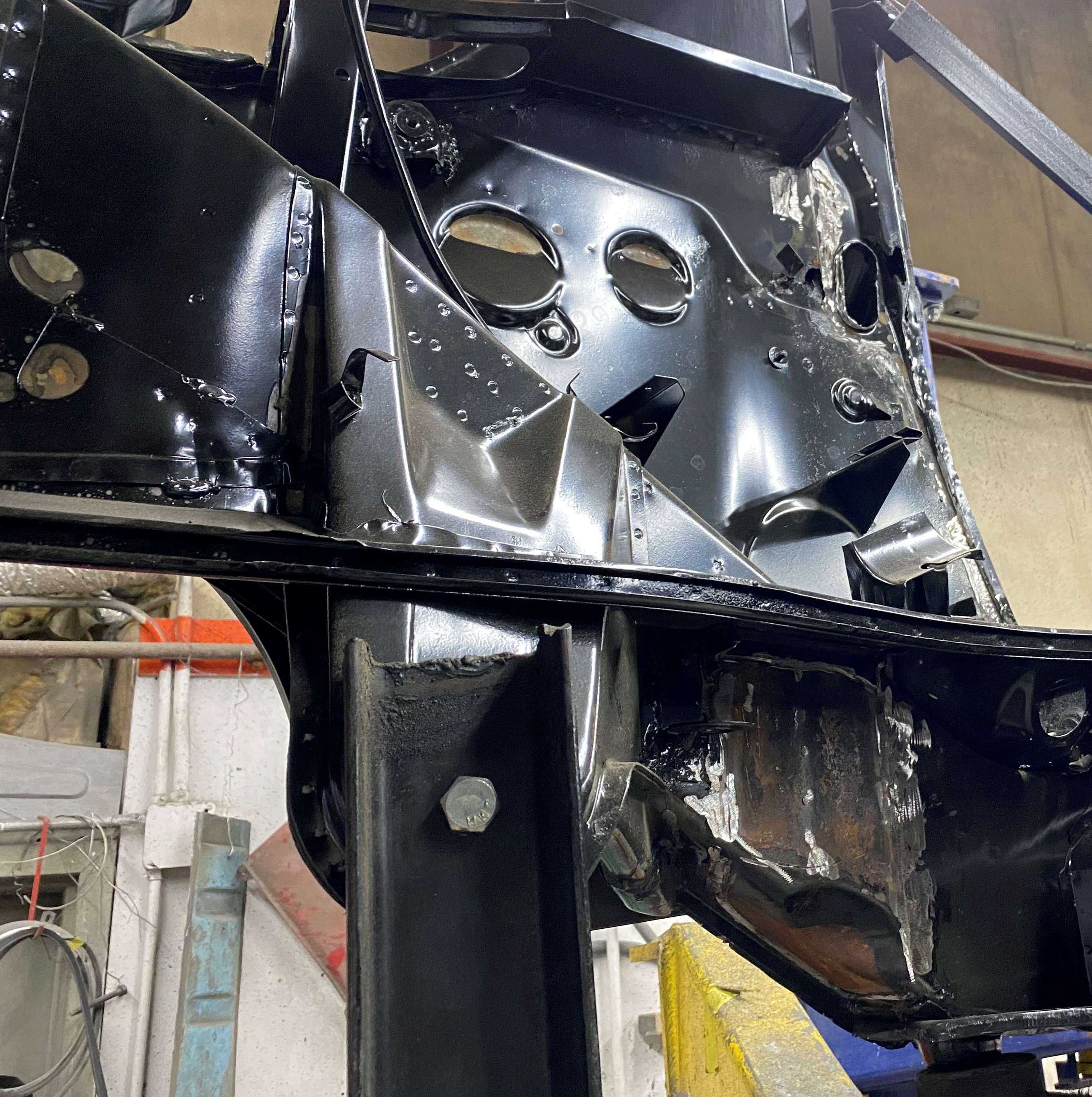

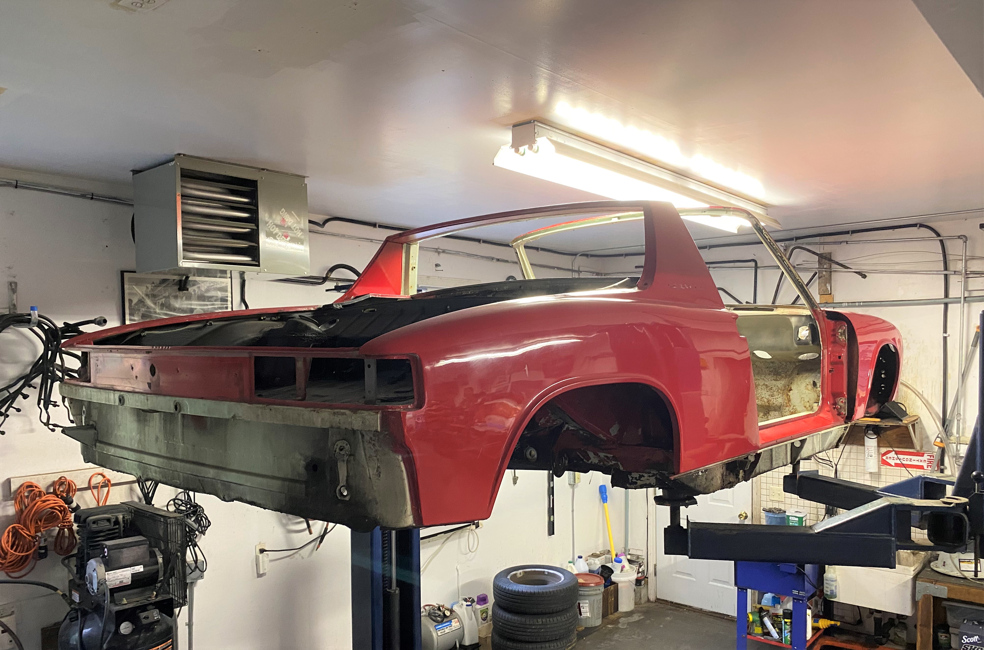

Since my last posting, the external longs were opened up and the heater tubes removed. Stiffening diagonals were also installed and the car was shipped to Livonia, MI for the triple dip process.
Tom1394racing
Inner longs don't look too bad and the heater tubes should be reusable.

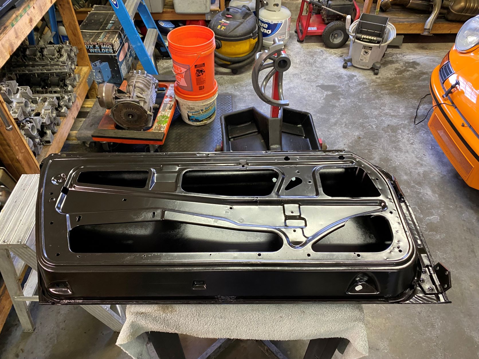

Tom1394racing
The chassis has now completed the dipping/E-coat process. One of our fellow 914 World members was kind enough to drop by the shop in MI to snap a few pics. It will be shipped back to me in the next week or so. So far I am pleased with the overall process. More to come once I get it back home. Anyone who would like details on the shop, please PM me.
Click to view attachment Click to view attachment Click to view attachment Click to view attachment
I just talked to Neil the other day. Our cars might come home together.
Tom1394racing
Yes Mark...I spoke to Neil this afternoon.
We had to take your car off the truck to get to mine. So it’s touched ground in Landenberg PA for a moment. Then back on the truck.
Had to pull mine up my hill to get it into the garage.
Tom1394racing
Mine is back home as well. I am pretty happy with the overall process. Car looks really clean but now all the nasty sins have been exposed.Click to view attachment Click to view attachment Click to view attachment Click to view attachment
Tom1394racing

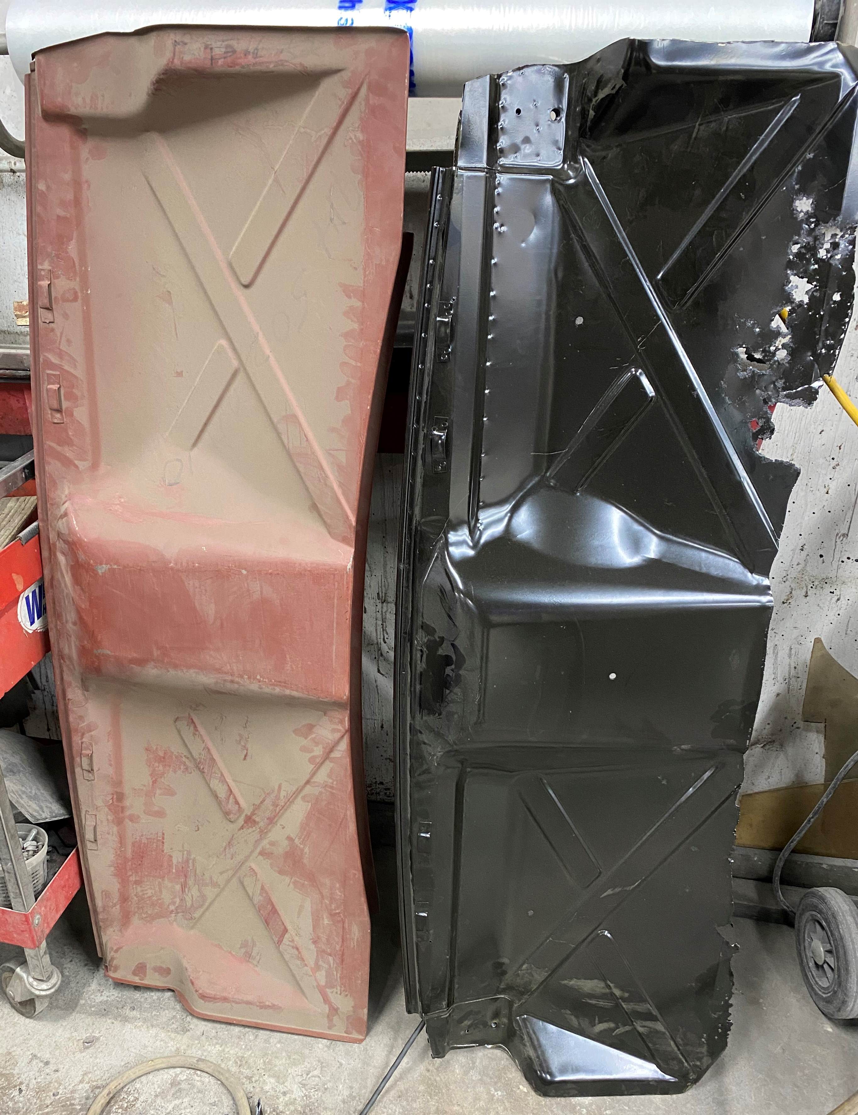

Here are some examples of the nasty hidden sins that will be corrected by Auto Associates
Click to view attachment Click to view attachment Click to view attachment Click to view attachment Click to view attachment Click to view attachment
Tom1394racing
After the extensive rust repair, the GT conversion punch list for Auto Associates looks like this:

The dip and e-coat make the good metal look really clean and the bad metal look terrible. I’m sure it will all look great when you are done. At least you didn’t not have to worry about flash rust while waiting on paint.
We replaced a lot of body panels on my car but there are still some touch ups before paint.
Tom1394racing
Update - The car was delivered to Auto Associates last week along with the chassis stiffening kits and bulkhead motor mount from Mad Dog. First up will be rust repair. This will be followed the GT chassis stiffening and GT mods with the exception of body panels and flares. The plan is for the car to come back to me for mechanical and electrical reassembly before installation of the doors and flares and final paint. Ken (co-owner and Body Shop Manager) would prefer to have wheels and tires mounted to properly install the flares. He also prefers to have the chassis weighted with gearbox and engine to set the door gaps.
Tom1394racing
The rust repair has started with removal of the rusted firewall, 4 cyl engine mounts and the improper repairs to the hell hole area. Luckily, Ken was able to source a NOS replacement firewall panel.
