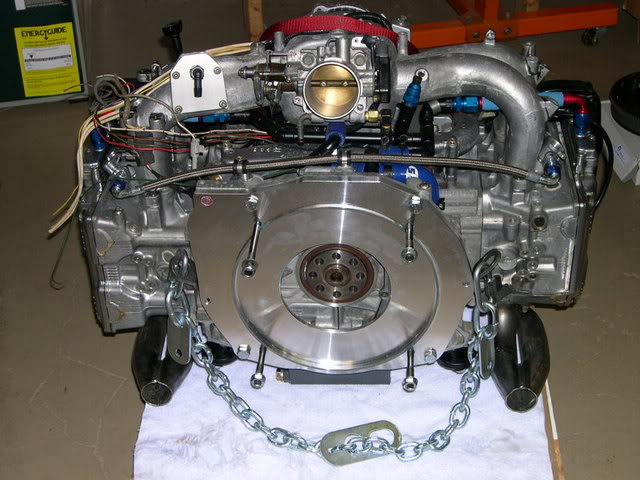

For mating with a 901 transmission, there are three options that I am aware off.
1. Kennedy Engineering (http://www.kennedyeng.com/vw_por.htm)
Package consists of an adaptor plate, flywheel, and pilot bearing.
- 215mm flywheel package for $540 (Clutch Package $431)
- 9" flywheel package for $540 (Clutch Package $354)
(Clutch Package includes Pressure Plate/Disc/Throw-out Bearing)
- Flywheel weighs 19lbs.

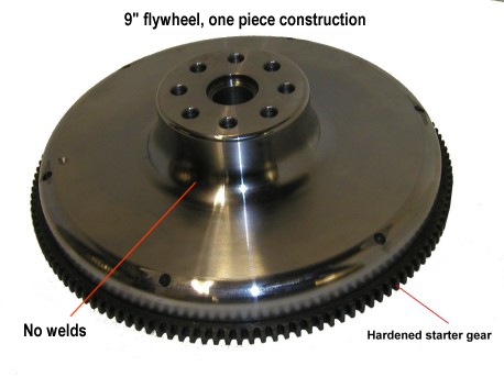

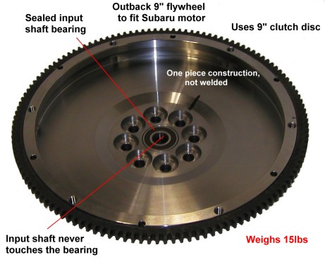

2. OutFront Motorsports (http://www.outfrontmotorsports.com/clutch_flywheel.htm)
Offer a monolithic flywheel (i.e. 1 peice) in both 8" and 9" diameters with adaptor kit for $480
Also have a 2-peice welded flywheel for $440
Multiple clutch packages ranging from $110 to $250 with a 6-puck disc for $80.
Also mention a dual clutch disc set-up for a light pedal.
Flywheel weights between 15lb and 16lbs

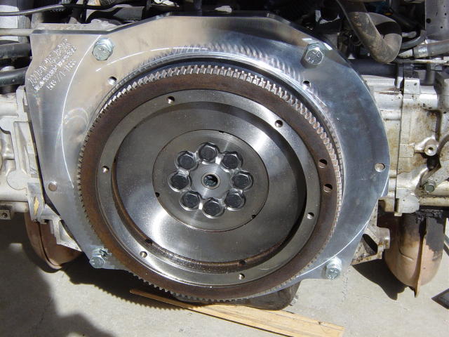

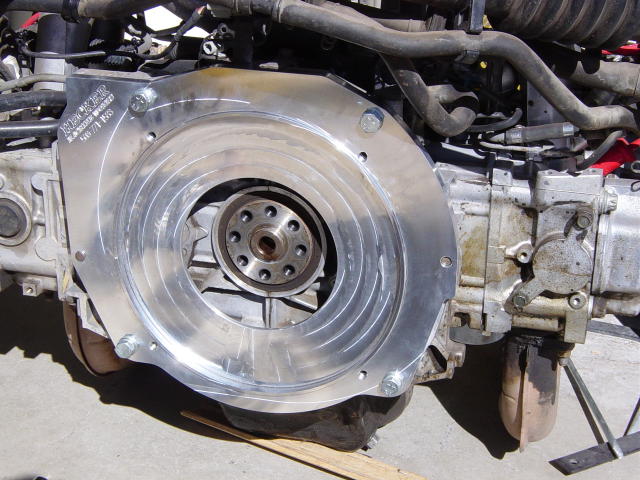

3. Renegage Hybrids (http://www.renegadehybrids.com/)
Don't really break down the adaptor plate seperatly on their website.
Includes Billet Adapter Plate, Custom 9" Flywheel, Kevlar 9" Clutch Disc, Stage Two 9" Pressure Plate
Some random images of adaptor plates, I don't know which manufactures.
