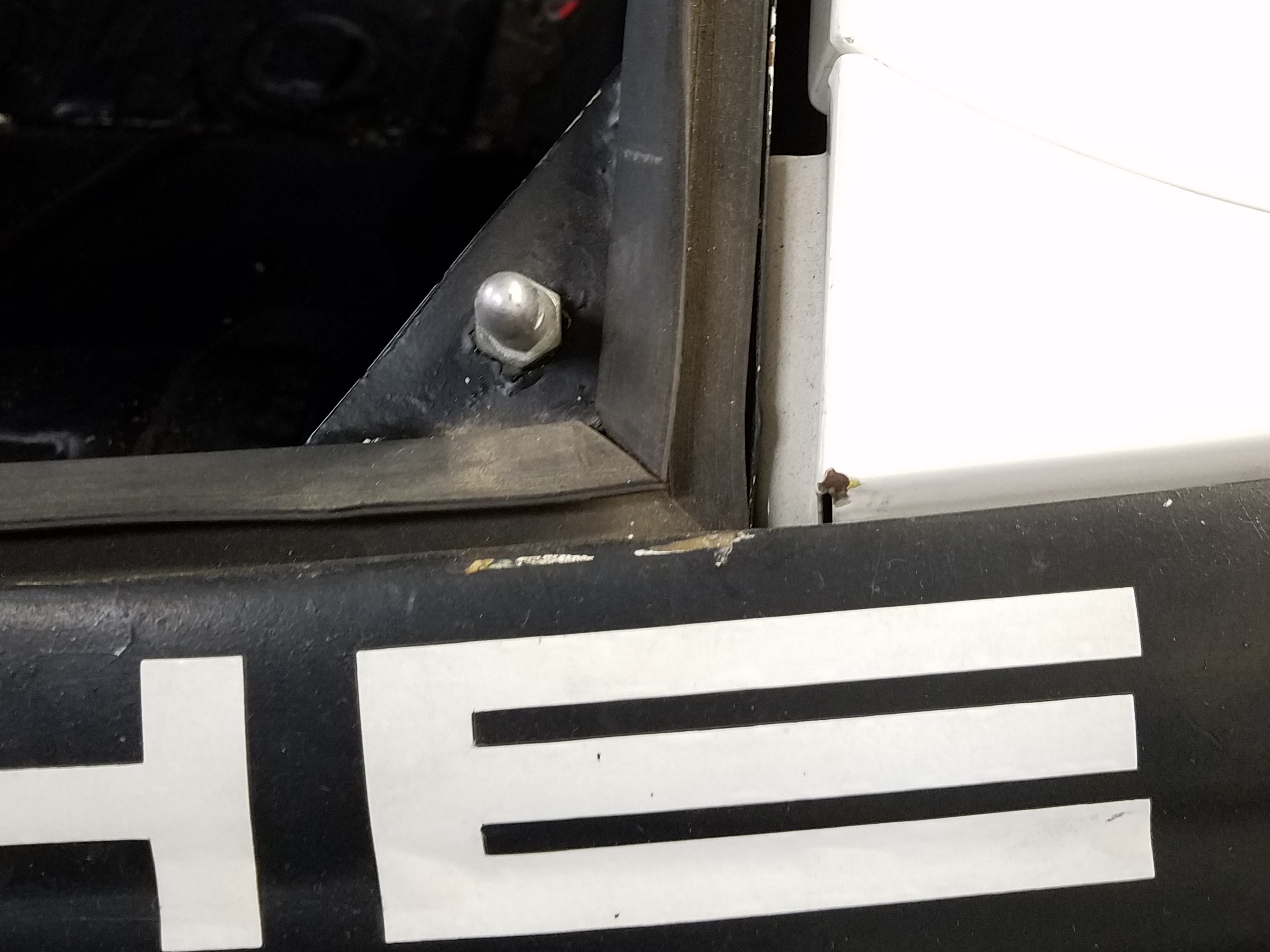

I have a request. I'm doing a GT look resto-mod on a 6, and we are using a GT style fiberglass hood.
I'm working on the hood pins and brackets now. The upper two brackets are pretty straight forward, as the brackets already in place with a hole.
I need a measurement on the front hood pin brackets from the center of the pin to the inside corner of the weatherstrip channel, so I can get the pins in the correct location
Armando has the plates illustrated but no location for the front pins.

Did a little bit of measuring for you today. These are pics and diagrams of the Driver (L) front corner area of front trunk.
" I " is the inside mounting plate, which is welded to the lower edge of the weather-strip channel. " II " is the outer plate that mounts to the exterior of the trunk (L) corner. Use the center -punch hole that I've indicated , and simply transfer down onto the inside mount plate. For Passenger ( R ) side...simply flip the patterns 180°
Maltese Falcon
® corner detail, viewing the fasteners holding the plate above, on exterior of the fiberglass hood.
Maltese Falcon
Handy measurements for you. The hood-pin-plate basicially mounts down to the corner of hood= flush to the 2 leading edges.

Very awesome Sir! I really appreciate your help Marty.

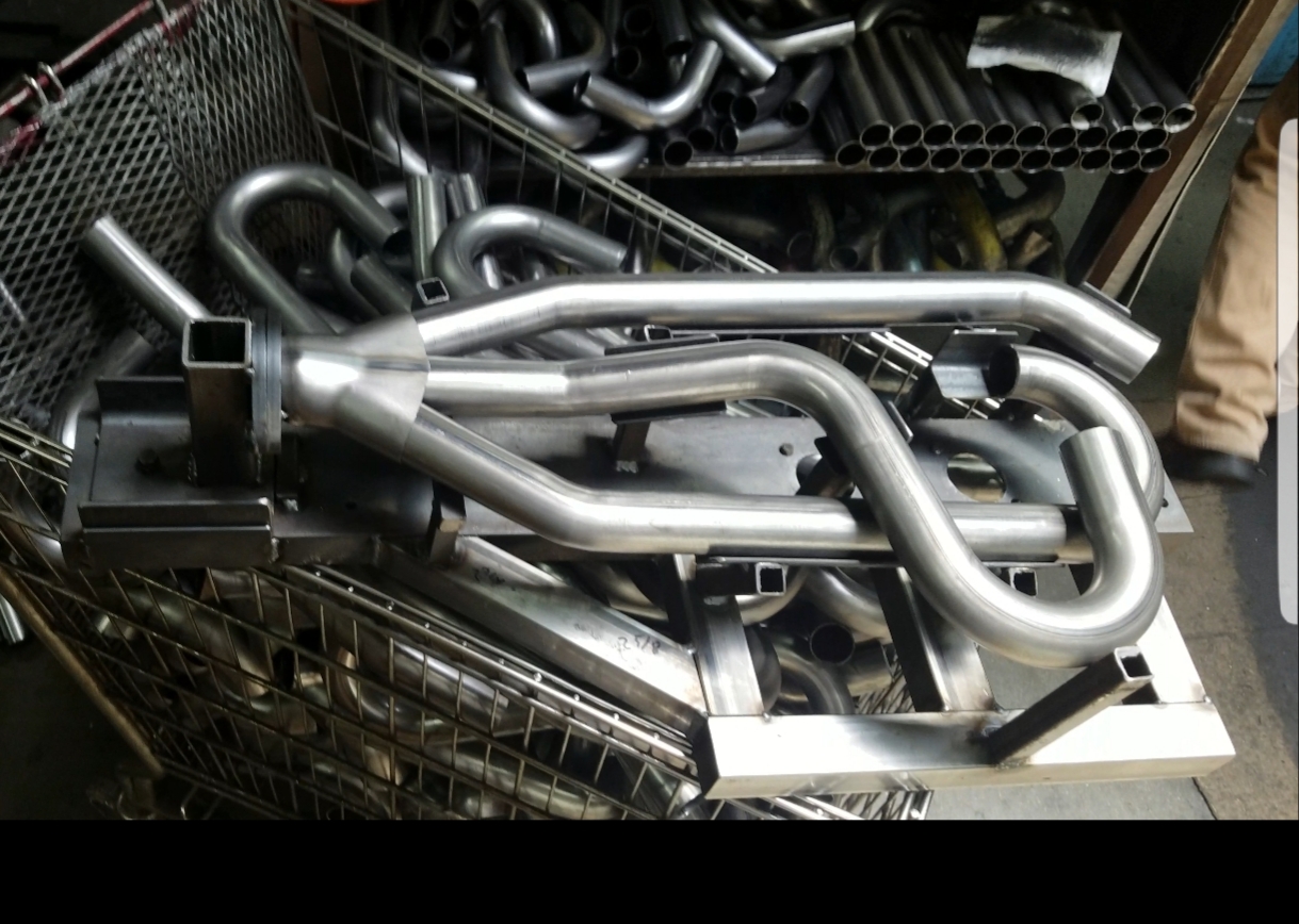

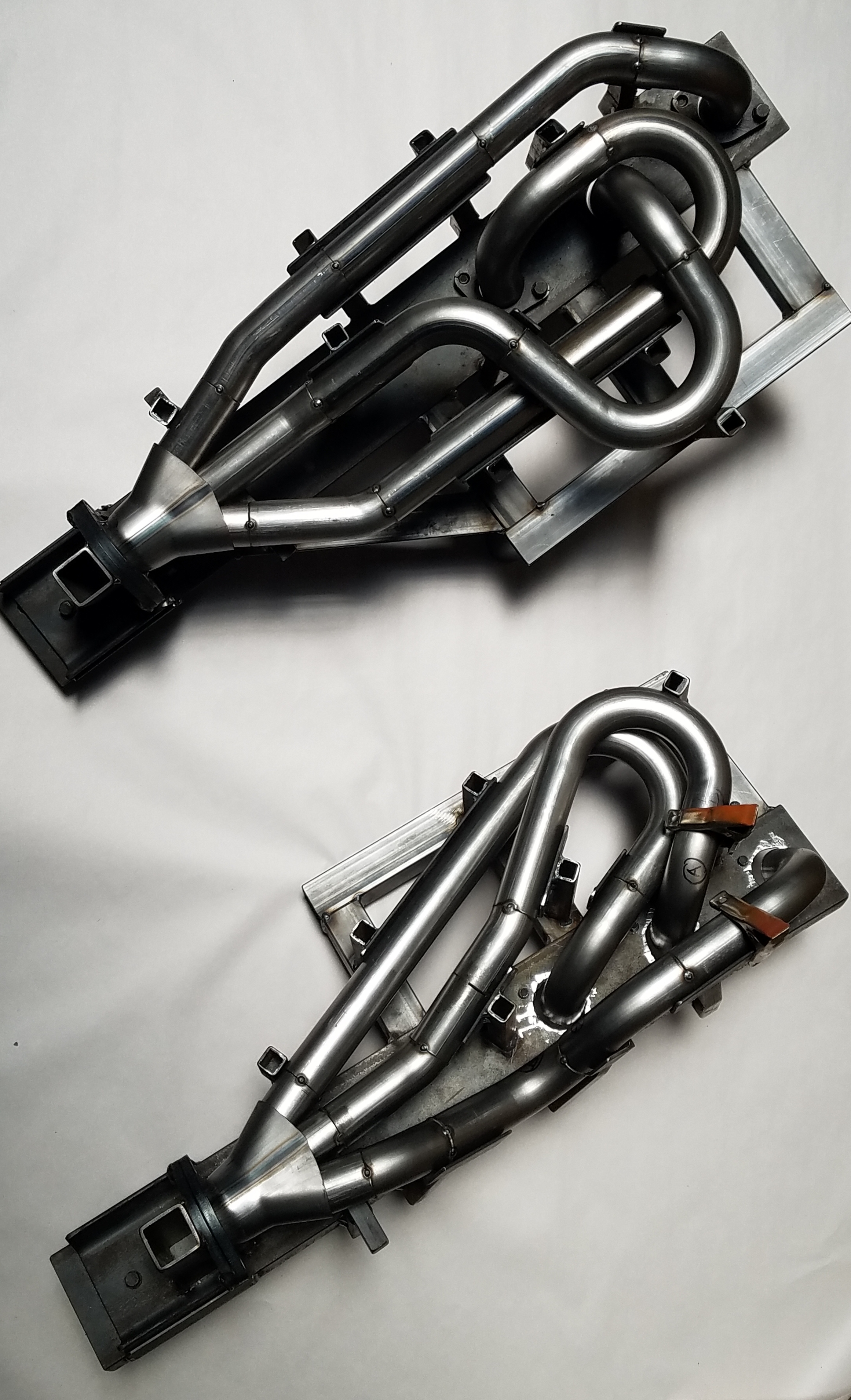

Building the new Left and Right 9146gt header fabrication & mandrel-bending / welding fixtures for an upcoming small production run.
We will also mfg the L + R megaphone " Transitions " into the GT muffler; and also build a Locating Fixture for this style gt muffler (not building mufflers tho). Eventually I'll replicate the tail housing muffler-hanger as well.
The 2 muffler inlets are "Flangeless"...and rely on the Transition megaphones with an id / od slip-fit and gear-clamps to seal.

We have completed the mfg fixtures for the Left and Right 914-6gt racing headers, built directly from the originals (which are in xlnt shape), mandrel bending for the first 12 sets starting this week.
Interfacing Left and Right megaphone-extensions coming up next .

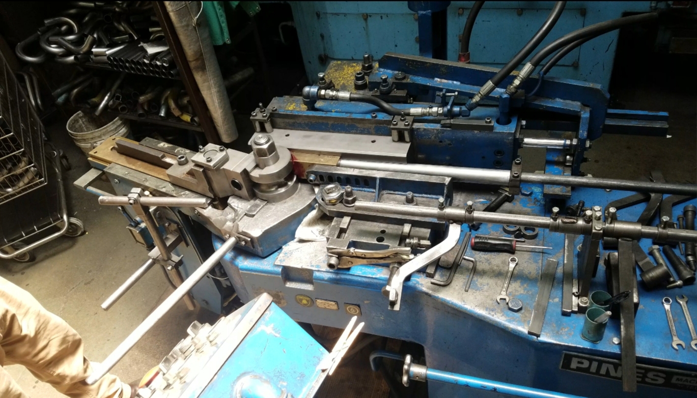

A little time to squeeze in the GT header bending fabrication prototypes. Mandrel bending vid to post soon ¡
Maltese Falcon
My kind of weekend therapy; Pines #2 rotary- hydraulic mandrel bending

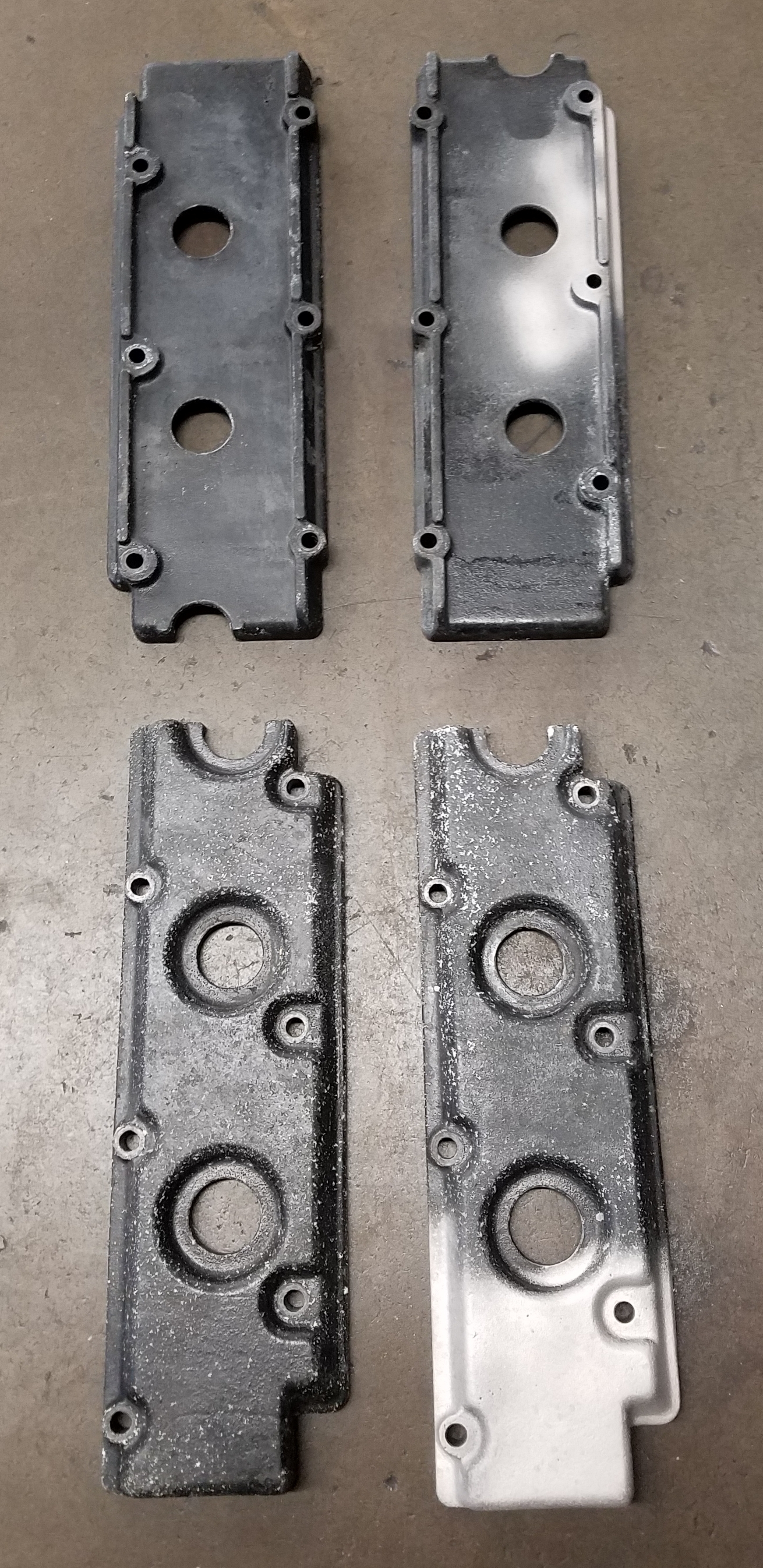

Very early style of 6-bolt magnesium valve covers; uppers are absent of the Porsche name, and lowers have some extra ribbing for strength. Engine type 901/25

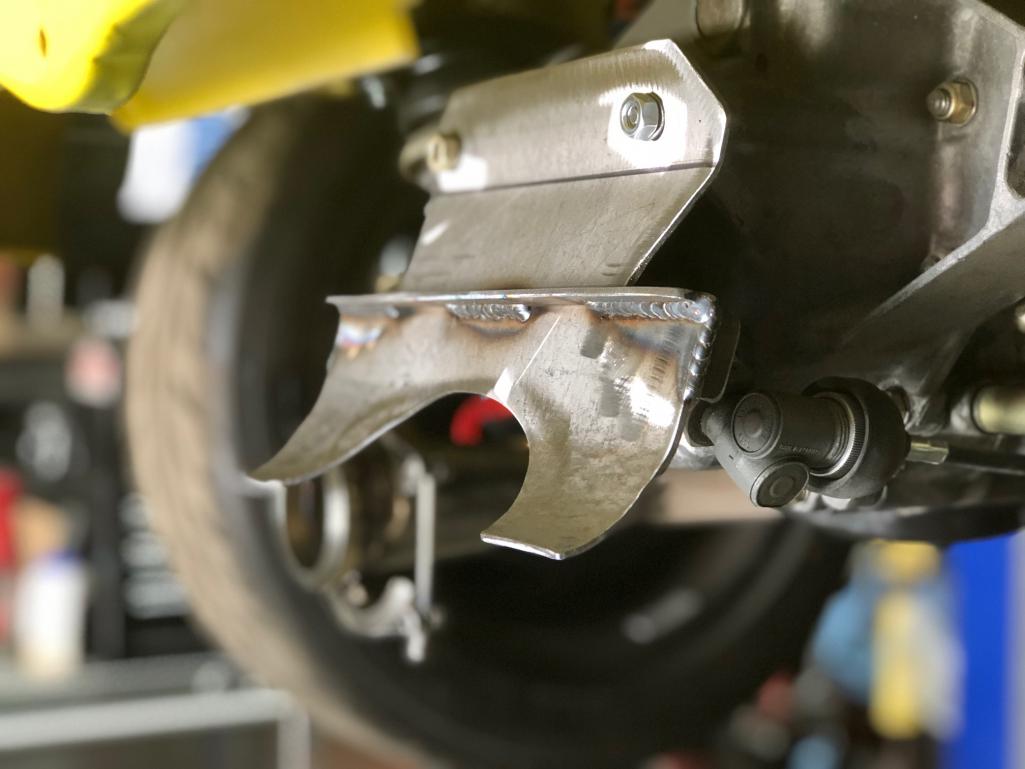

GT muffler bracket attached to the trans nose cone, that allows the 2 band-clamps (911 style) to support the muffler
pete000
QUOTE(Maltese Falcon @ Jun 15 2020, 06:24 PM) *
pete000
Are those Mag covers warped, most are including the ones off my car, they now live in a bin on the shelf. Using Modified Turbo Covers...Keeps the garage floor a bit cleaner lol
Yes I do recall my old 2.7 lower covers, used to constantly put them across a lapping stone to get flat. On these covers (906, 911R style) it looks like these were cast with the additional 1/4" ribs , in order to keep them flat when the engine ran higher temps in competition. These will be restored, then coated with black ceramic...looking to keep the #40 pure to its bones as possible.
Seems simple enough to mfg a short run of these...I'll put it on the list !
