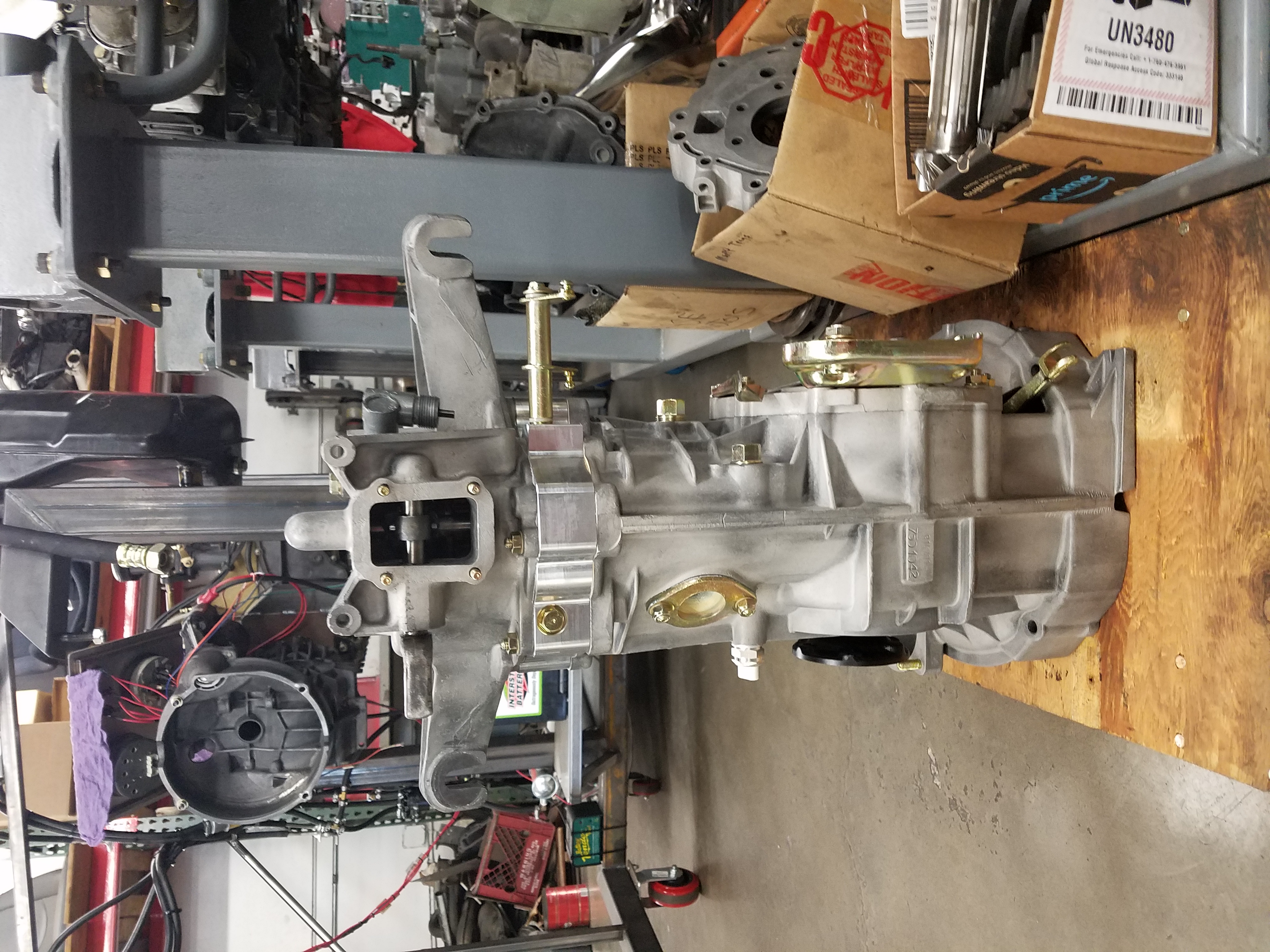

Fresh 901
Maltese Falcon

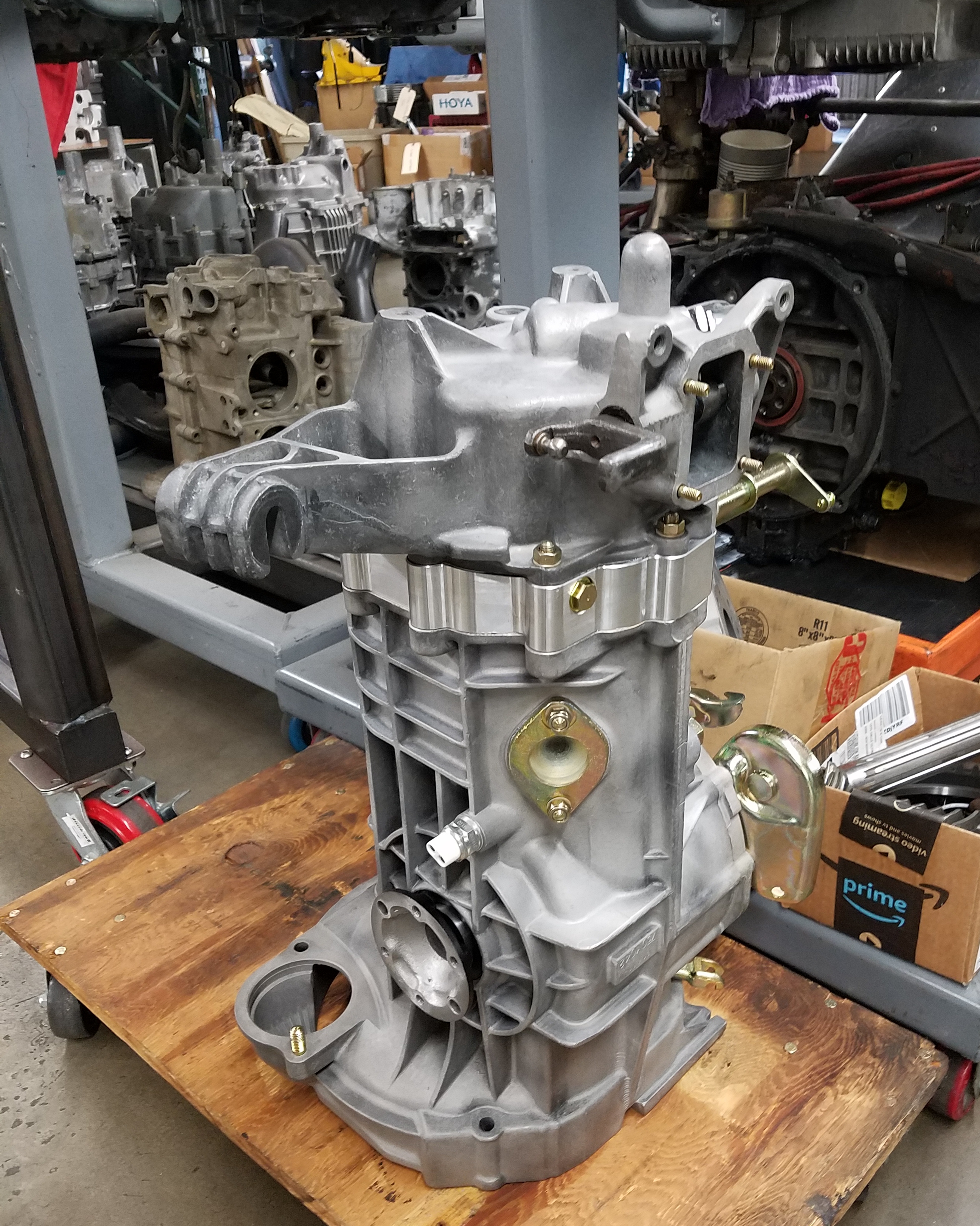

...my 1st tailshifter 914 , keeping the LeMans patina alive.
The Daytona 24hr/ 1971 class winner (J.Duval-Sunoco) GT , built at this (same )shop was equipped with a later style side shifter.
The shop can always upgrade for us (to the side shift), but for now it's the way it shifted on that Long day in June

Marty is that the original trans to the car ?
Amazing.
Shivers
Very nice.
Maltese Falcon
QUOTE(rgalla9146 @ Jan 11 2021, 06:50 PM) *
Amazing.
AFIK yes, and judging by the wear and tear parts we replaced in the trans ...it's been well used. It has been upgraded with the CMS intermediate plate along with new bearings, a different 3rd gear ratio, and a long list of replacement parts.

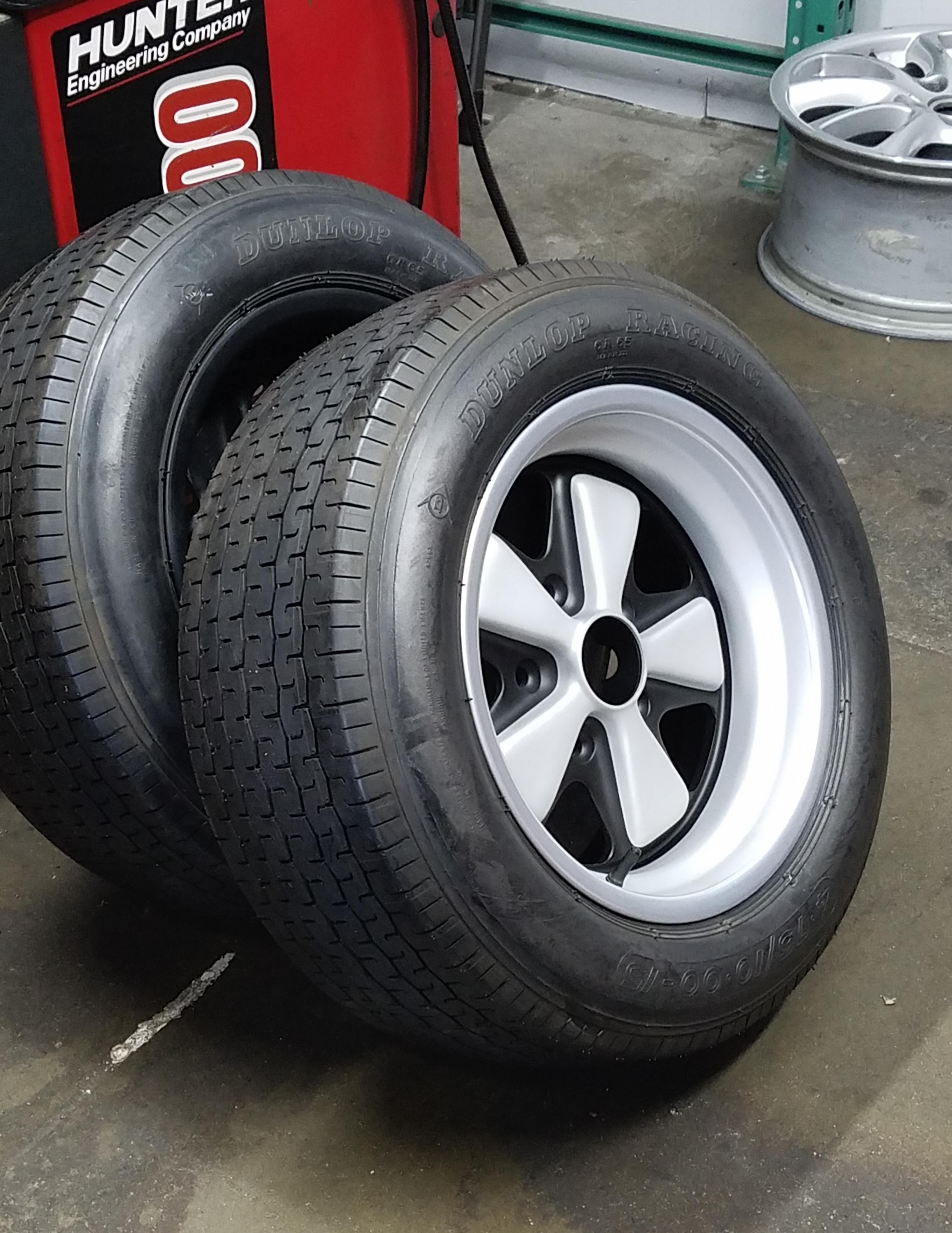

We sourced these Dunlops through Roger Krause Racing in NorCal, very good in matching the period correct "Wets" used in the 70's
horizontally-opposed
^ Great stuff, Marty. Those wheels/tires sure look period correct. wub.gif

Dunpy awaits his place on the rear flares as well @horizontally-opposed !
pete000

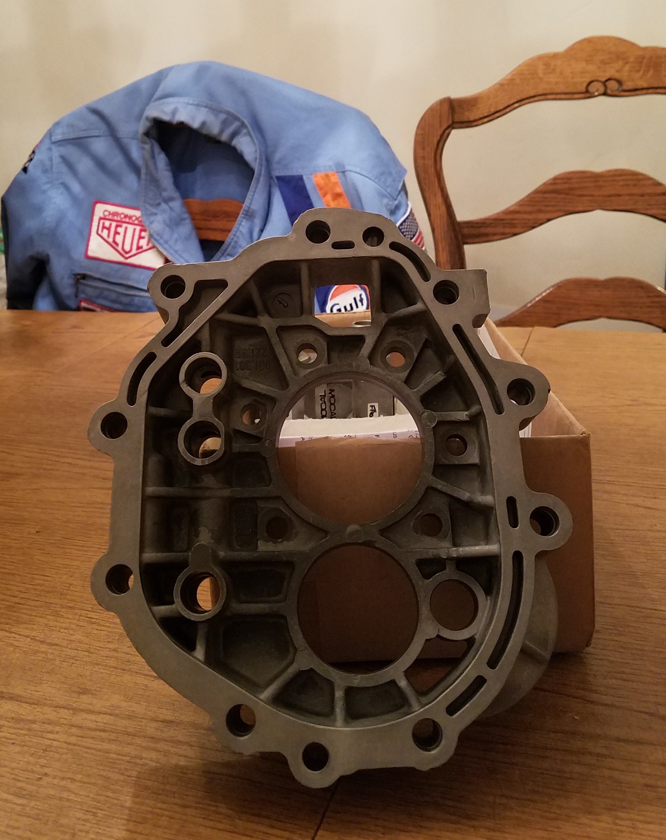

I am surprised you ran the upgraded billet intermediate plate.
They did not have that back then did they?
I would have dulled it up a bit...Looks too new modern !
I want your wheels and tires !!!!
Maltese Falcon
QUOTE(pete000 @ Mar 6 2021, 06:42 PM) *
I've experienced 901 intermediate plate bearing failures...so this upgraded (California Motorsports) unit will just have to get a bit dusty, might match the rest of the mag case smile.gif

pete000
Now I want a CA MS intermediate plate too !
QUOTE(Maltese Falcon @ Mar 6 2021, 09:56 PM) *
Sounds like this car is gonna be seen, heard, and used again. I like it.
And there's a case to be made for cool Le Mans car parts you can see daily…
ClayPerrine
QUOTE(Maltese Falcon @ Jan 11 2021, 07:46 PM) *
I have driven both, and the side shifter is definitely better. But our six has the tail shifter, and after I went through the linkage, it shifts almost as good as a side shifter.
The six is much better than the four for the tail shifter.
I like the period correct shift linkage on it. Keep up the good work!
Clay
JmuRiz
Marty, what do you use to keep the case clean...or is not a big deal out there in CA. Out on the east they get dark and have surface corrosion very quickly.
Maltese Falcon
QUOTE(JmuRiz @ Mar 8 2021, 07:35 AM) *
I have been touching-up the mag surfaces with a scotchbrite pad & a bit of wd40 on it. The original intermediate plate was hot-tanked, rinsed and naturally looks like this. I'm sure it will turn dark grey when the humidity sets in smile.gif
Maltese Falcon
QUOTE(ClayPerrine @ Mar 8 2021, 07:21 AM) *
Clay
Clay, thank you for chiming in with your findings...I am looking forward to Not grinding gears & Not missing shifts. There is something to the "Look" of a tail shifter on this special teener !
The Daytona 24hr (1971) class winner 9146GT did have its tail-shifter switched out to side-shifter long ago, way before its new ownership in 2020, at the Gooding Auction.

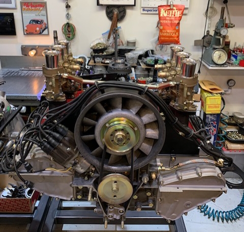

Healthy Carbs this week
Maltese Falcon

Larmo63
Are the Kettle Chips a hidden clue?

Beautiful Cars, who rebuilt them?
Maltese Falcon
QUOTE(pete000 @ Mar 20 2021, 02:16 PM) *
Paul at PerformanceOriented.com in Salem ,Oregon did these. I also send Weber carb work to TopEndPerformance.com in Chatsworth, Ca.

@Larmo63 My engine tech needs his daily dose of Salt + 'Taters chowtime.gif , he suspends the bag on a thin wire and an alligator clip; pesky ants not able to find his snacks !

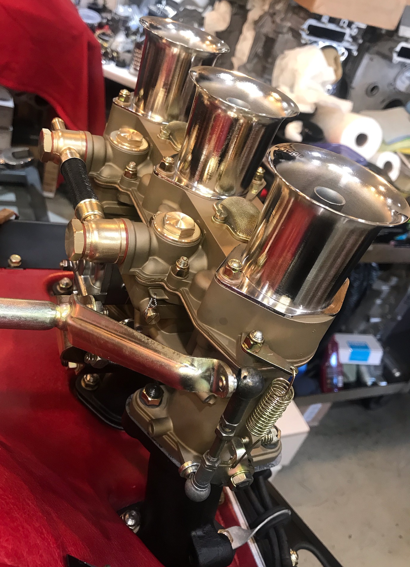

Nice to see correct fuel line "clamps" Italian style.
First I've seen in decades.

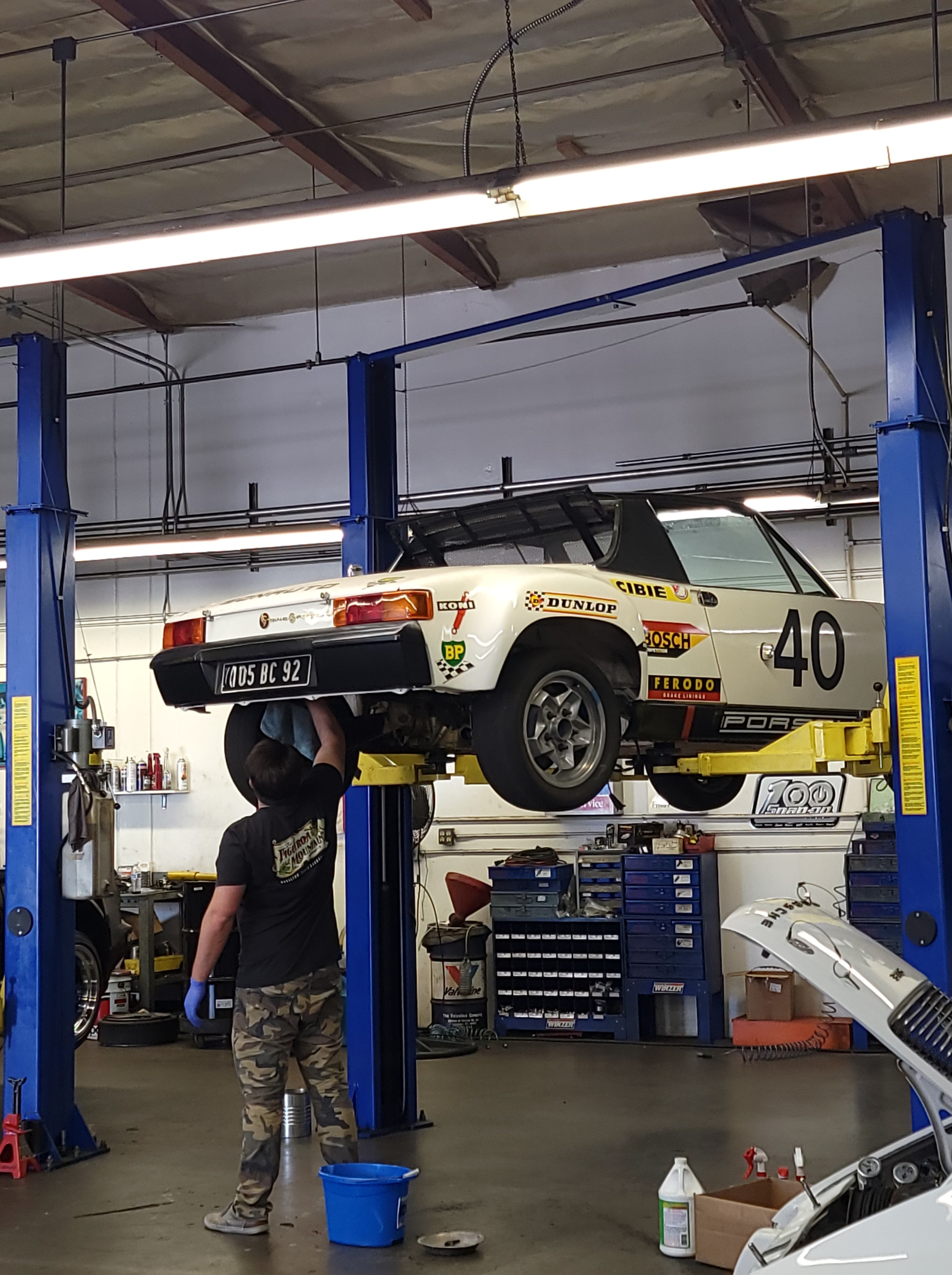

Details, cleaning, Details, cleaning...getting it done !

ClayPerrine
QUOTE(Maltese Falcon @ May 30 2021, 10:52 PM) *
IPB Image
I know you are just using them to roll the car around the shop, but the cookie cutters look so WRONG on that car.
Clay
Maltese Falcon
QUOTE(ClayPerrine @ May 31 2021, 08:46 AM) *
IPB Image
Clay
Yep...just rollers. The tires that came on #40 were ancient cracked and leaked air overnight, became too labor intensive to keep up. So wheels went out for restoration, new (period correct) Dunlops ordered up, and on went the Cookies on scrub slicks for daily push arounds. Cookies look weird but does the trick !
