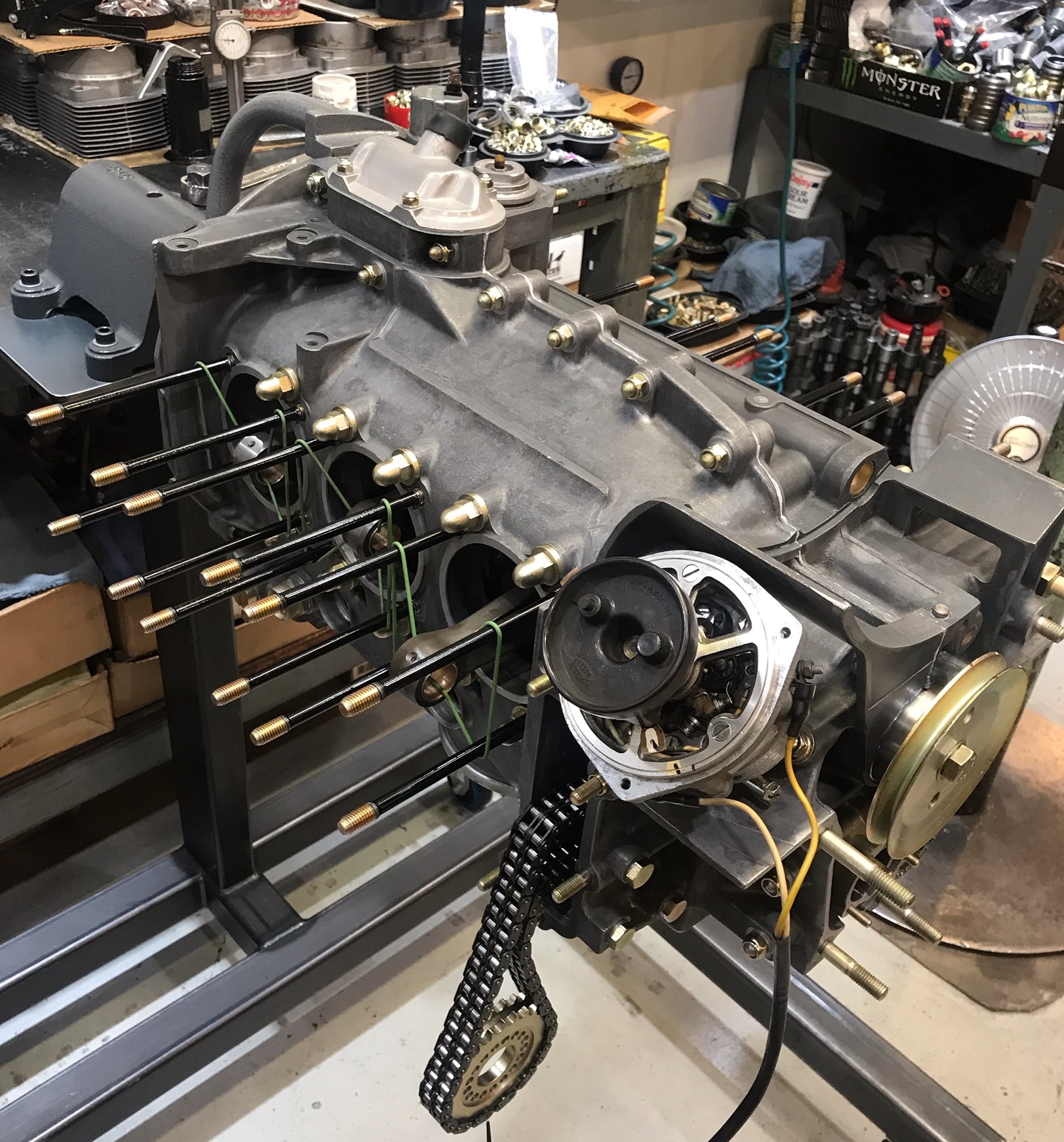

Here's some quick engine update pics. Still some things left to do, then it's reassembly time!

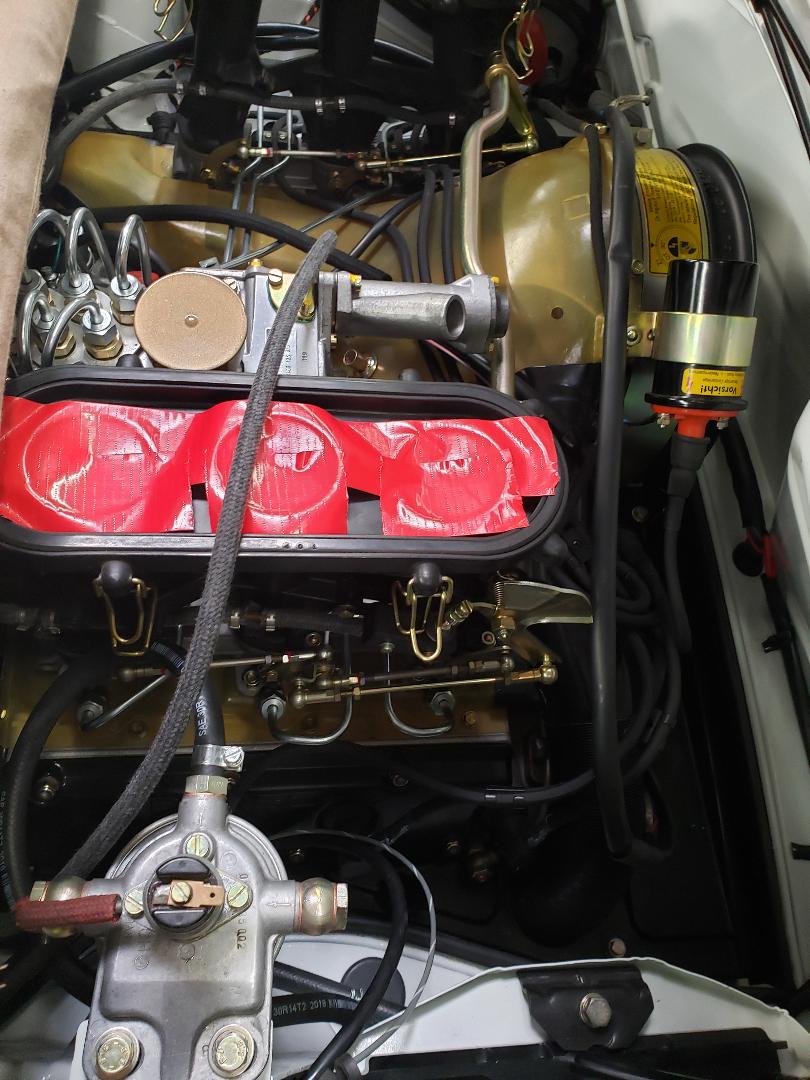

I've got a 2.7 MFI in my 914 using Ben's bigger heat exchangers.
The shop that did the install added a nipple to supply the warm air to the MFI pump so that it leans out when the engine gets up to operating temp.
It starts easily and is perfectly fine on the street.
The "only" downside is that MFI runs on the rich side, so fuel mileage isn't so hot.

That is perfect ! Beautiful !
The heat exchanger looks to have two features that MFI normally requires.
The larger nipple for cold start and the smaller one to air filter intake.
Sway Bar
As mentioned the nipple on the right is for supplying heat to the cold start solenoid on the mfi pump which is a thermostat with a bunch of expanding washers that move the main rack within the pump to lean out or of course enrichen when cold.
The middle chamber will be your regular cabin heat.
The left preheat chamber supplies warm air to the MFI 'flapper box' which preheats the combustion chamber and also has a built in thermostat to close the flapper and supply fresher cool air in for combustion. In most warm air areas people remove this and/or even remove the cold start solenoid.
I love MFI...if in great order it runs awesome, sound even better and has great throttle response...its a 50 plus year old analog computer. I find mileage really good but because of that great throttle none of us drive it for mileage biggrin.gif

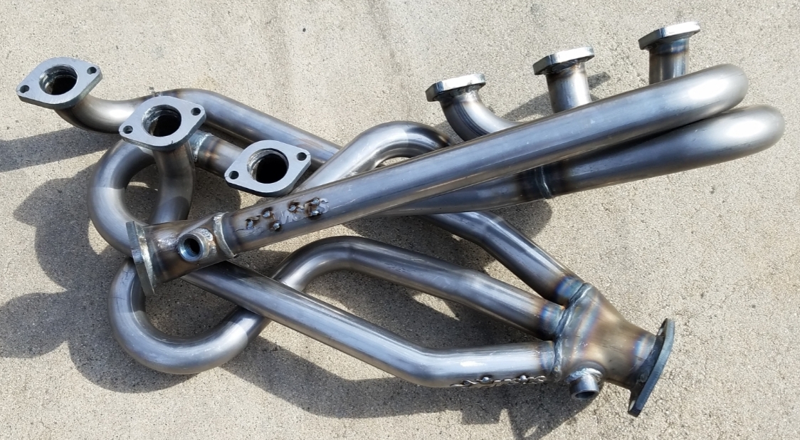

New 9146-gt (FIA style) headers , makes it easier for the engine dyno guy to set a/F ratios. These are now a regular MSDS production part. Just dropped off at the Ceramic coating contractor. Originals are in storage, easy to swap out.
horizontally-opposed
QUOTE(Maltese Falcon @ Oct 26 2020, 05:06 PM) *
New 9146-gt (FIA style) headers , made easier for the engine dyno guy to set a/F ratios. These are now a regular MSDS production part. Just dropped off at the Ceramic coating contractor. Originals are in storage, easy to swap out.

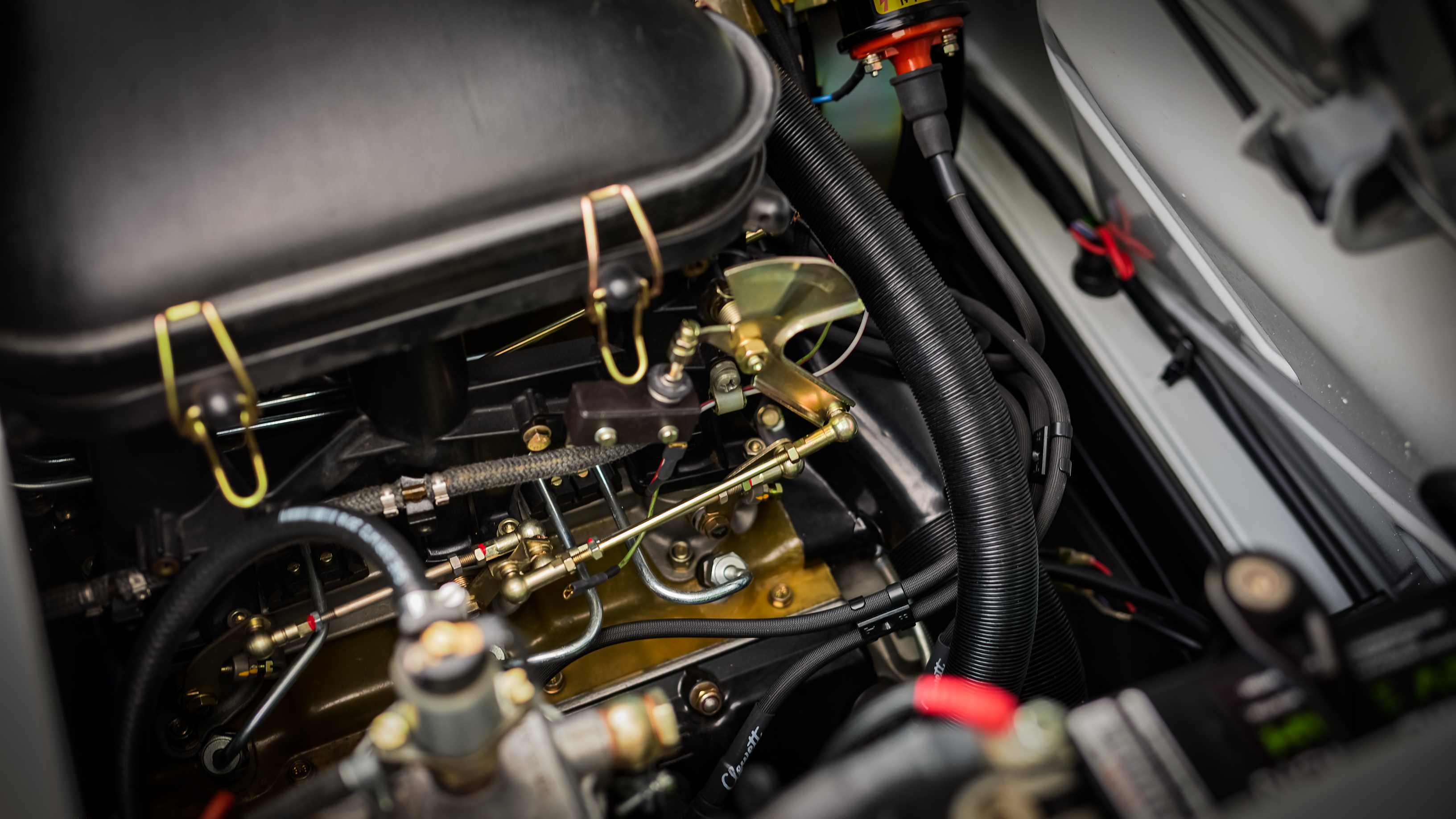

2.4L MFI engine with 195HP:
It is cold out and early on a Sunday morning. I am going to an AX an hour away so I get up 30 minutes earlier than I normally would just to get the 914 started and warmed up. I roll it out of the garage and down the driveway into the street so I don't disturb my neighbors with the Bursch MFI exhaust noise.
The engine has 2.2 mag stacks on it, with K&N watershield air cleaners. But I don't have the "firestarter" cold start system hooked up. So I spray ether under each watershield. Jump in and try to start it. It coughs, spits, and dies. Repeat the ether treatment. It coughs, spits and starts to sputter on 3 cylinders. Set the hand throttle and sit there in the cold car, waiting. Slowly it would start to run on 4, then on 5 and finally on 6. Slowly lower the hand throttle as it warms up.
I can't really give it any throttle because it would be too loud. So I keep the hand throttle up at about 1500 rpm and ease it out of the neighborhood and down the road. I actually have heat exchangers so I can turn on the heat. But not much comes out. 1500 rpm doesn't move much air through the HEs on a cold morning. I finally get out to the main road, and I start driving normally.
A cop stops me and asks why I am going so fast and so loud this early in the morning. I explain that the heat output is tied to the engine fan speed. He chuckles and lets me go with a warning to "keep the noise and the speed down".
At the AX, I work the first run group, and drive the second run group. So I go off and work. When I get done, I have minutes to go through the whole ether and repeated restarts to get a now cold engine fired up and running so I can make my runs. First run is terrible. I don't want to push a cold engine.
I let it sit and idle between runs to get it to operating temp. Second through
I stop for gas on the way home. 16MPG on a good day. Gas is 3.50 a gallon too. AX cost was about 1 3/4 tank of gas.

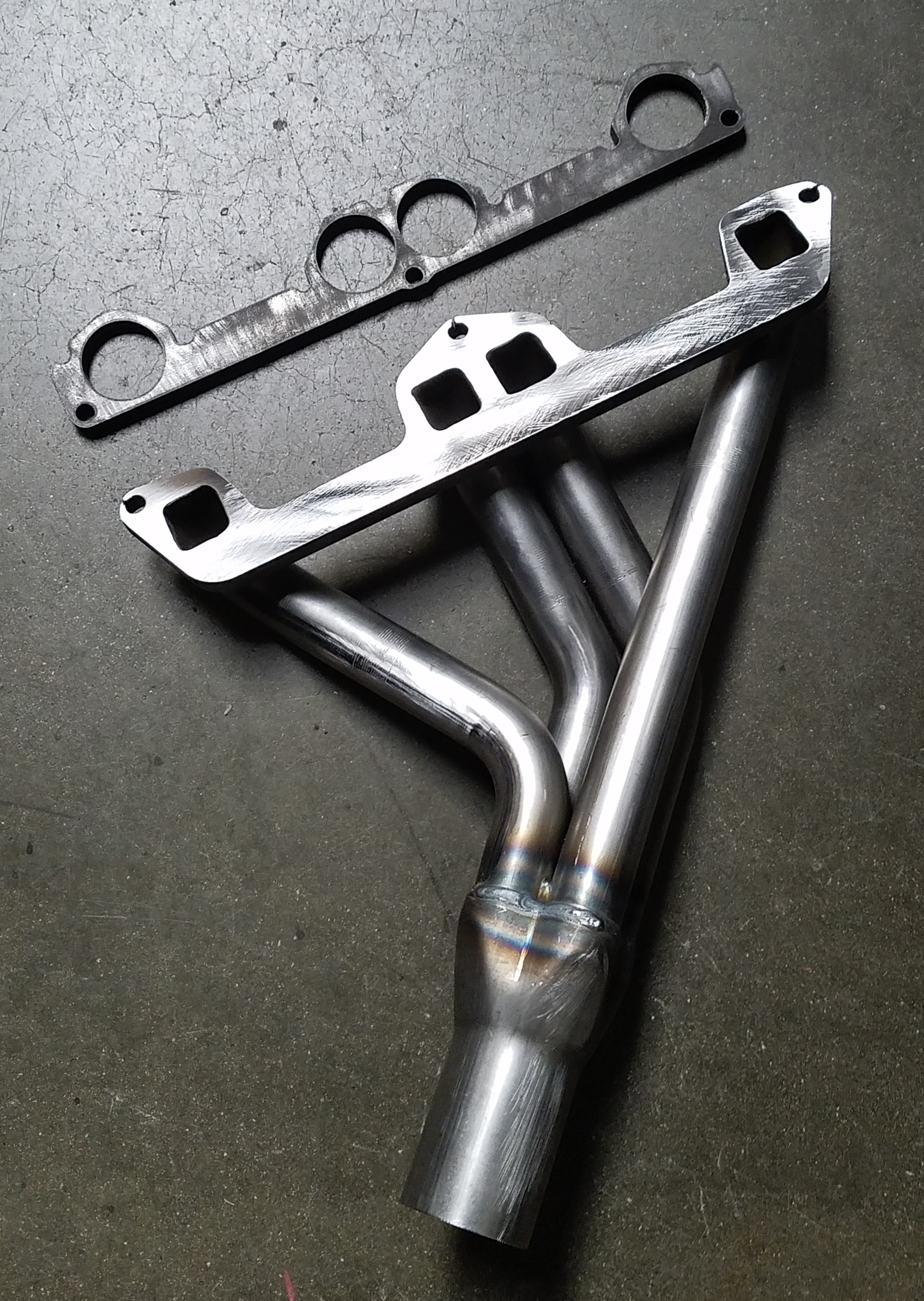

Marty is more than a pillar of the Porsche community. His Datsun headers are the real shit! I've been talking you up on the Datsun forums Marty. Hope you still have some on the shelf!
Maltese Falcon
QUOTE(ConeDodger @ Nov 1 2020, 09:08 AM) *
Thx Rob !

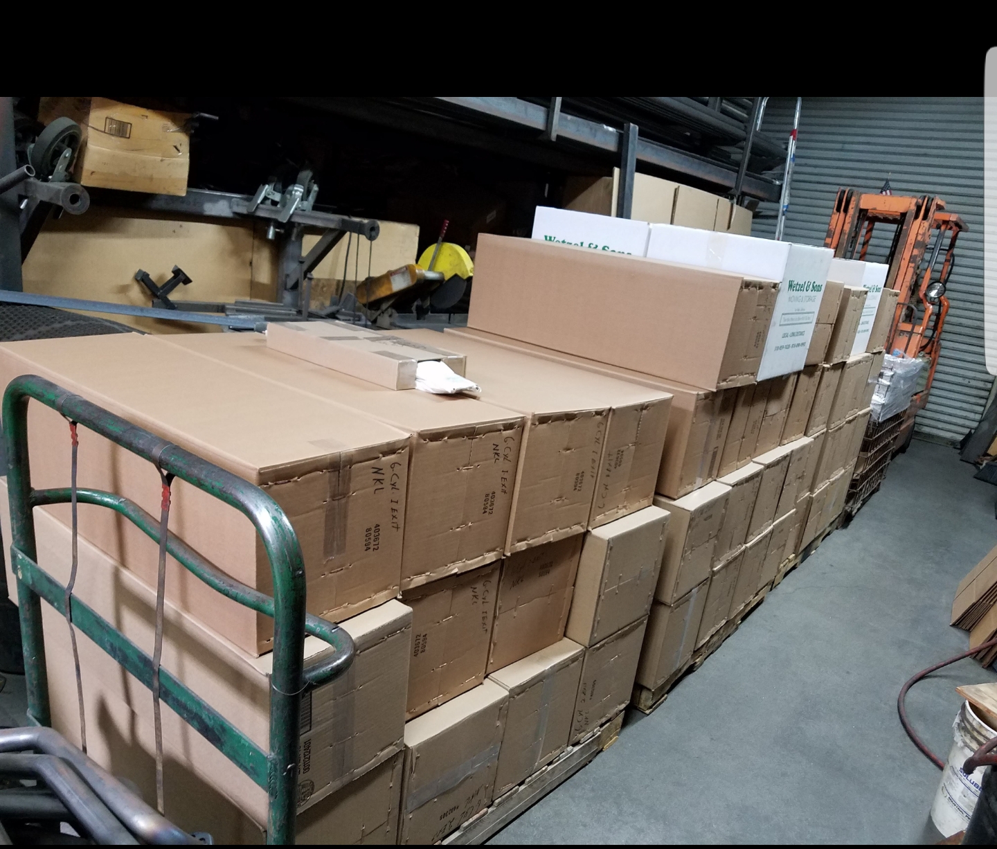

We have decent stock on 510, 240Z and 240Z competition /large tube headers. Shipping still running on time flag.gif
This just makes my heart happy, seeing all those boxed headers ready to go, made right here in CA. And for another reason: 240Zs are cool, and sound insane when uncorked. The best sounding car on the Targa Newfoundland in 2003 was, without question, a vintage 240 with straight pipes. Not the Porsches, BMWs, etc etc.

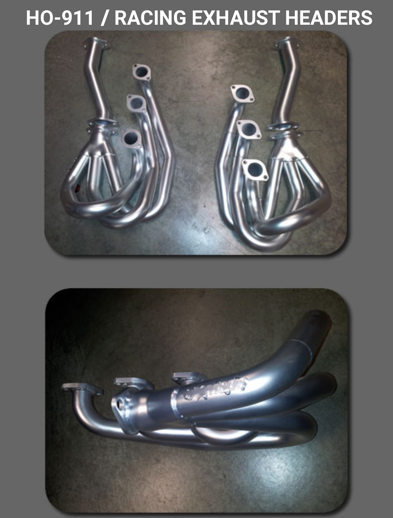

QUOTE(SKL1 @ Nov 2 2020, 03:28 PM) *
Glad I read this thread- I'm looking for headers for my '72 911T targa, stock with MFI. Does it come with the head and muffler gaskets or do I get them separately?
TIA.
Stu, we have you covered with MSDS 911 racing exhaust headers !
Marty

Datsun 510 competition/ FIA exhaust port difference , compared to the 510 street version header ports are day and night.
Don't forget big Cam profiles, larger valves + ported heads, larger venturi carbs, and operating mostly W/O/T will require getting all of that combustion moving out of the exhaust stream a lot quicker !
OD of the FIA header is 1.75", which is the tube size we build headers for a 3.6/3.8/4.0 air cooled flat six welder.gif

Maltese Falcon
Engine room update
Maltese Falcon

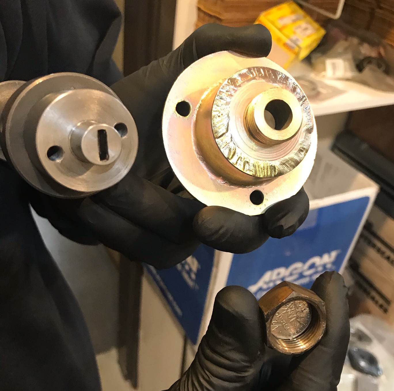

Interesting find in the mfi-drive cover plate; 3 French 1/2 Francs used as shim spacers biggrin.gif
