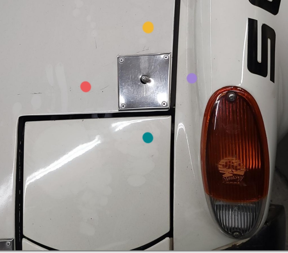

Perry @IronHillRestorations , the upper plates just use the OE corner-pieces (where the rubber adjusters fit). The pin centers are 1.5" center-to-edge (weather-strip) channel...in red.
Hope this helps !
@ Maltese Falcon Thanks Marty, but I was asking about the plate on the hood. You made a nice drawing of the lower hood plate, but I need the upper too.
Sorry for the confusion Perry...but the car only uses these 4 front hood pin locations. The (upper towards cowl ¿¿) pin locations do not exist, as this hood still uses the OE hinges.
Marty
Thanks again for the reply Marty. I'm looking for the dimensions on this one in the center of the pic.
Maltese Falcon
OK, plate dimensions are:
Yellow, Red, Violet = 3.125"
Blue (above headlight) = 2.875"
Flip this outline for the R /passenger side
The edges of the plates also have a beveled contour.

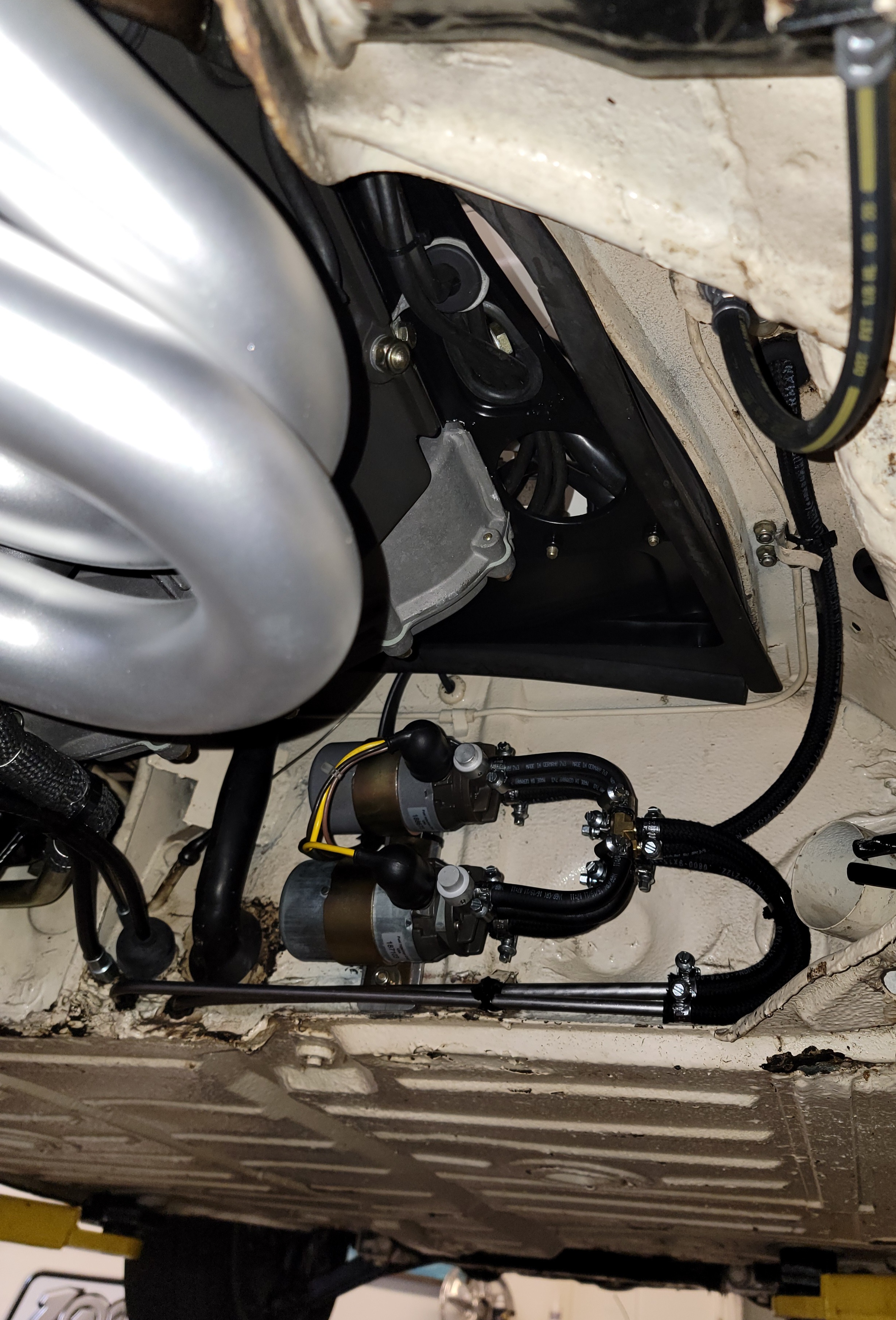

Twin fuel pumps, new wiring, relays, SS fuel lines, brackets, supply + return lines and clamps all in place.

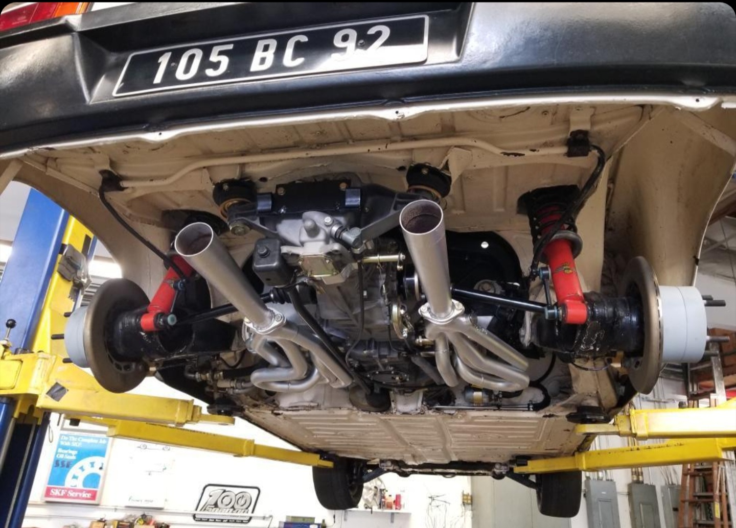

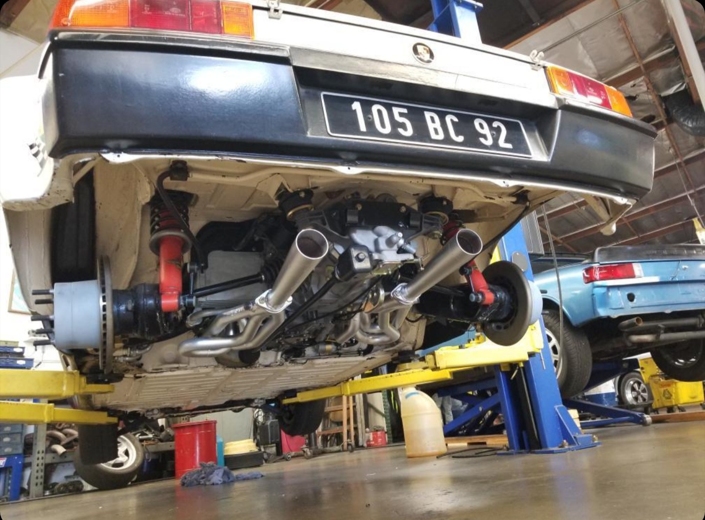

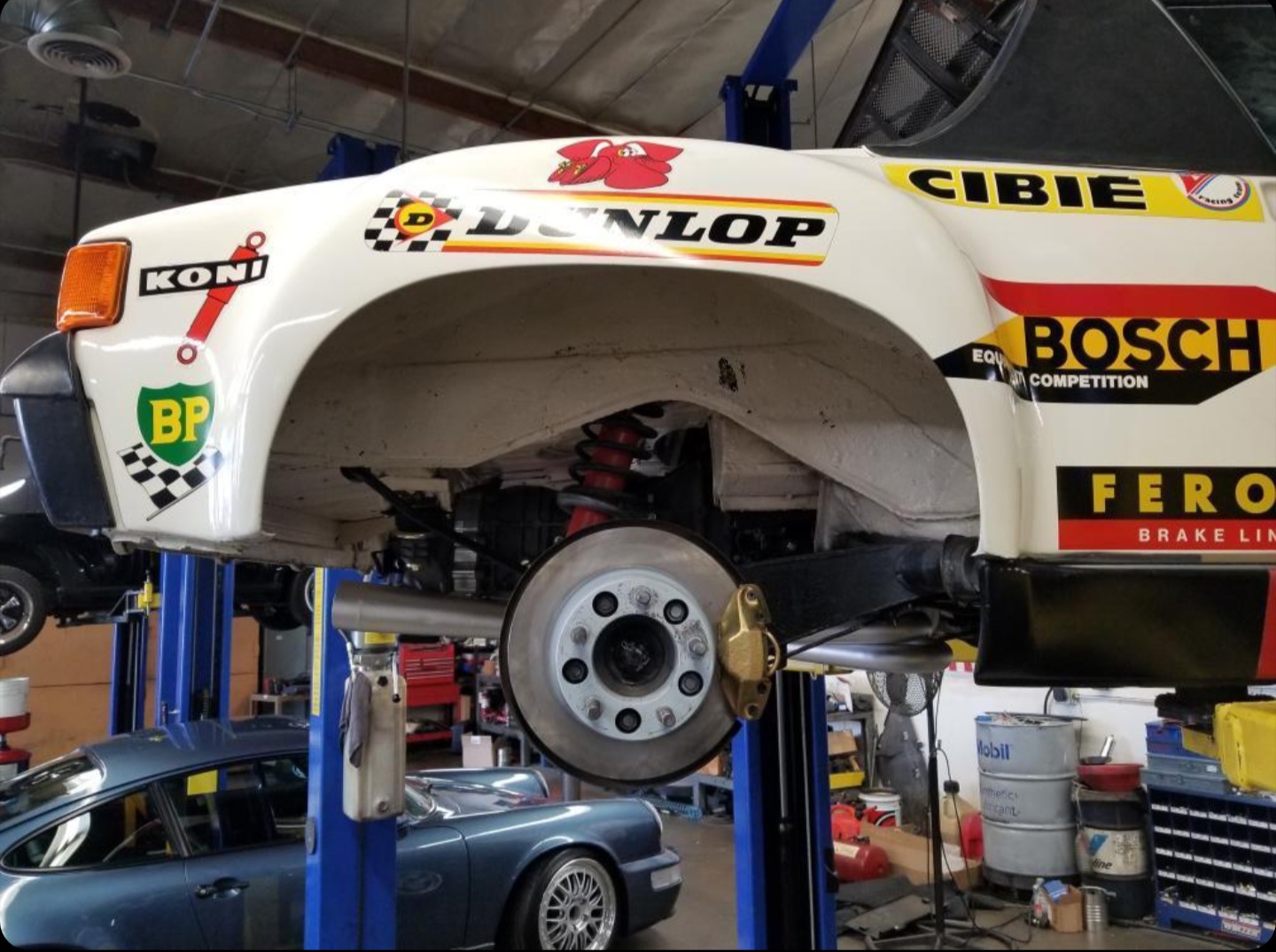

Finalizing the exhaust, our newly manufactured 1.625" od merge collector headers are slightly larger than the original LeMans (1.5" od) headers...but there are -0- clearance issues on surrounding components.
Maltese Falcon
...couple more

Marty will you add a support when running the megaphones ?
Dion
Marty it’s looking so incredible.
That’s a great shot of the business end. How much more width are those flares.
I remember reading that the Marathon de la Route cars(3 of them) all had different width flares. Just curious.
Maltese Falcon
QUOTE(rgalla9146 @ Jan 7 2022, 08:52 AM) *
Rory, the megs that you see in the pics will not be floating around as these will push into the rear muffler (id / od fit), then tightened with a pair of band-clamps.
The main support bracket which bolts to 901 nose-cone and uses a pair of large band clamps (911 style) to support the GT muffler/ with the megs clamped down and along for the ride.
GT nose-cone bracket (blue dot) in the picture.

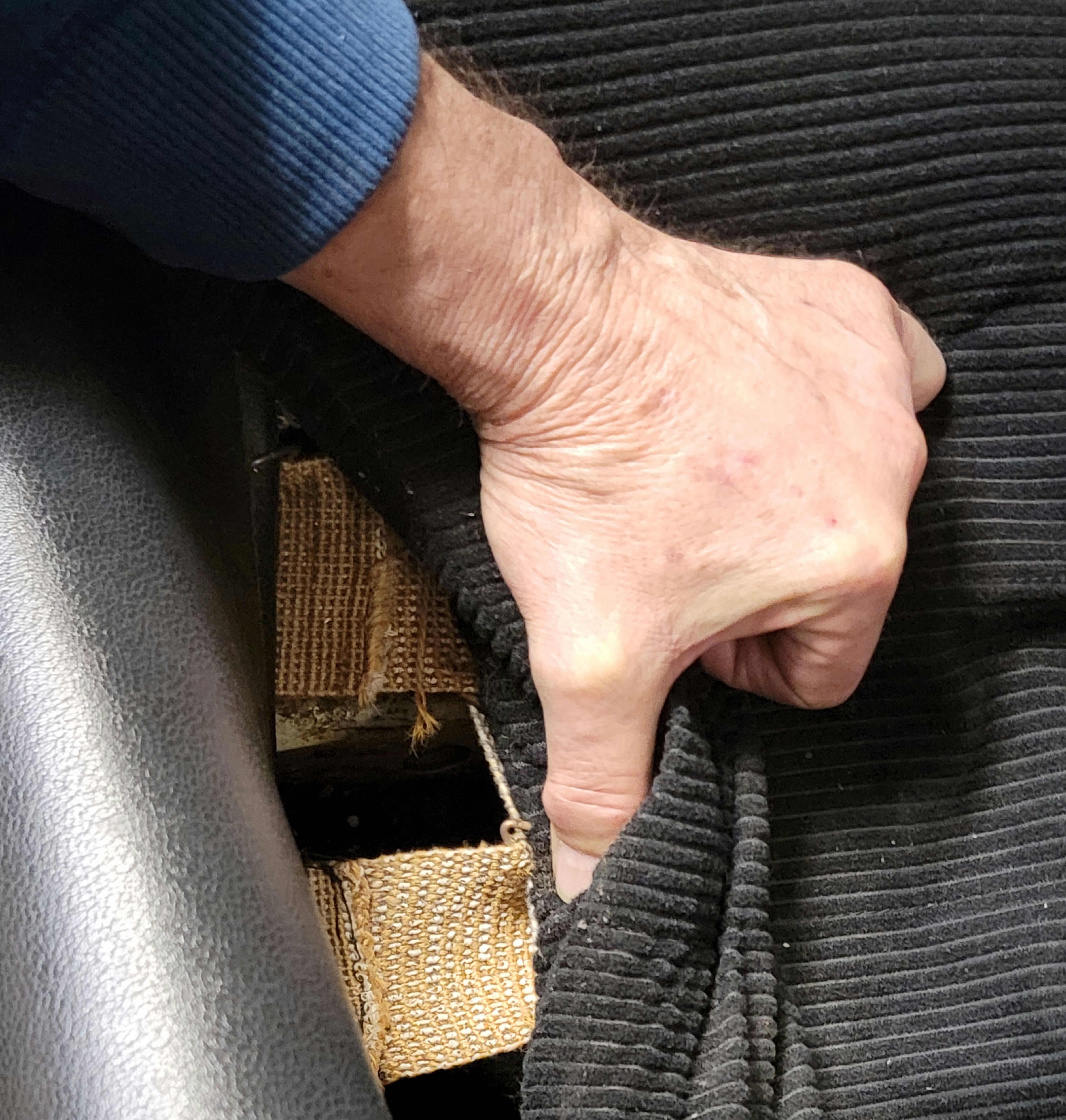

Stretchy Stretchy cloth or fiberglass weave has seen better days; probably the reason I sink to the floorboard while seated in the Scheel. Taking a trip to the upholstery shop , passenger seat will get some TLC as well.

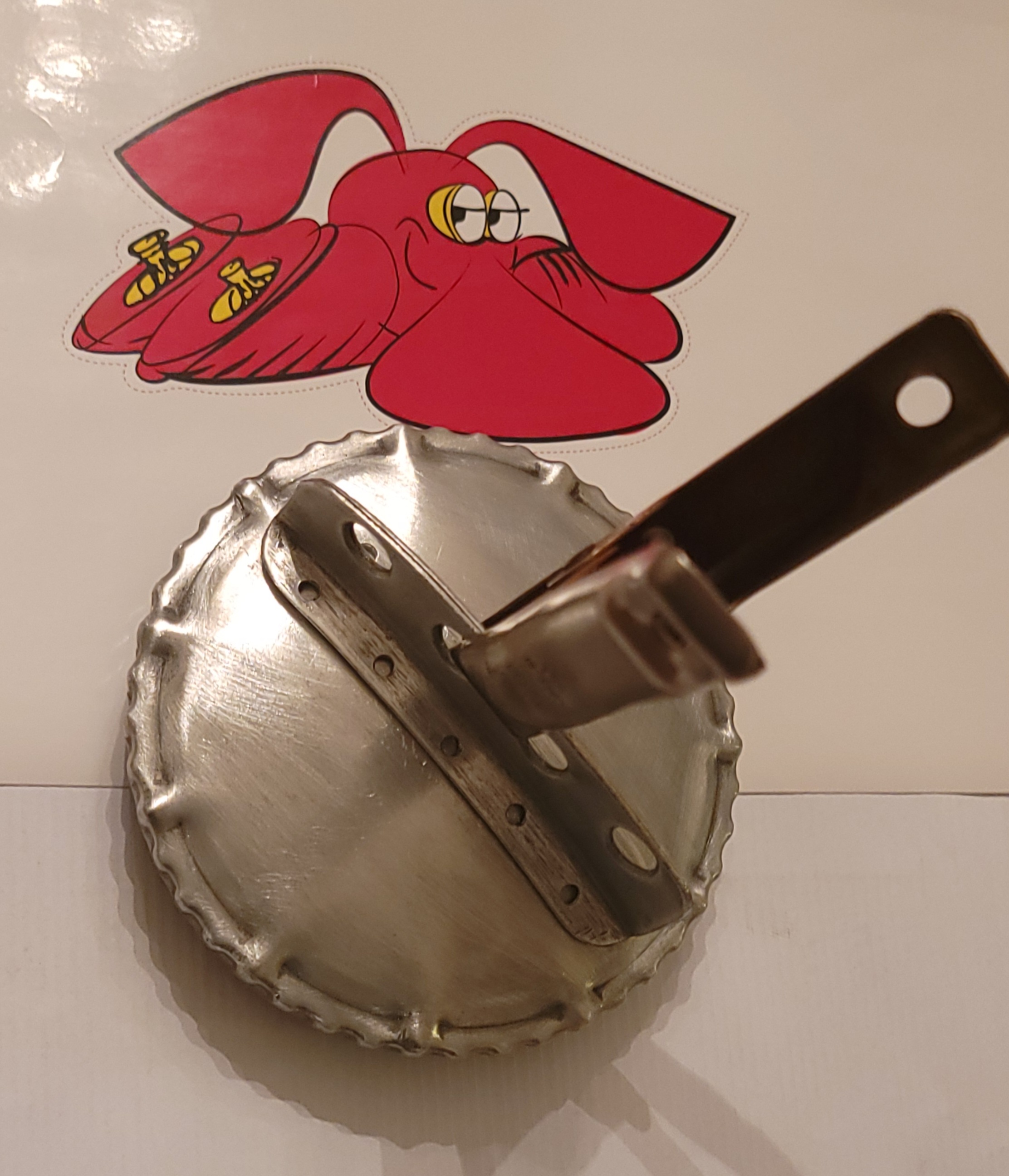

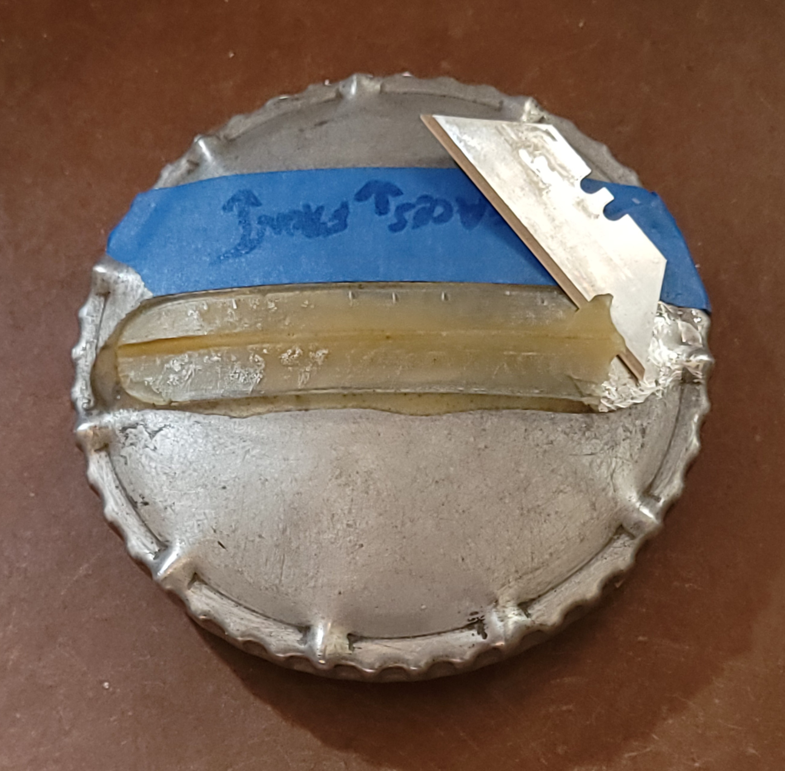

Going to carefully TiG this tired fuel filter cap back together, as the 50+ year old epoxy-glue let go and the top piece left the building blink.gif The glue is adhered pretty good (could have held the canopy on an ME-109 !)...using a sharp razor to demo it.
Maltese Falcon

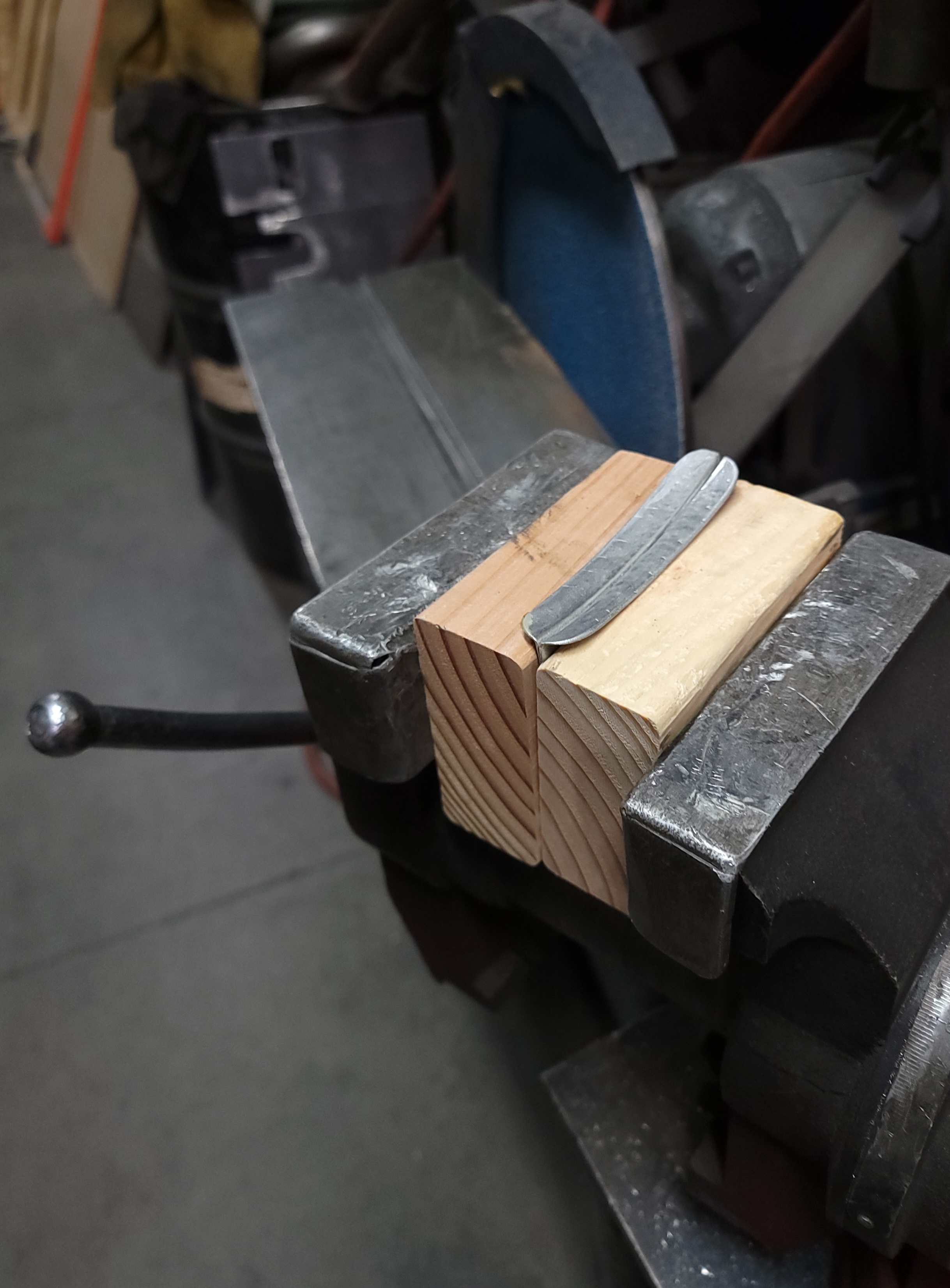

...also straightening out the "Fin" on top of the gt gas filler cap. Through the years it has tweaked + twisted.
A simple persuasion with 2 wood blocks in the vise did wonders. Off to the heliarc for a better attachment than the previous epoxy

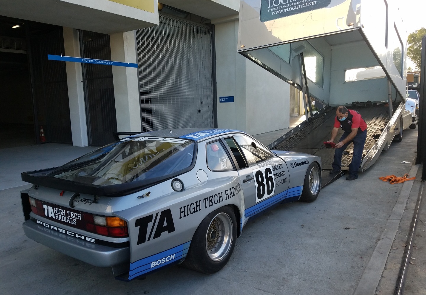

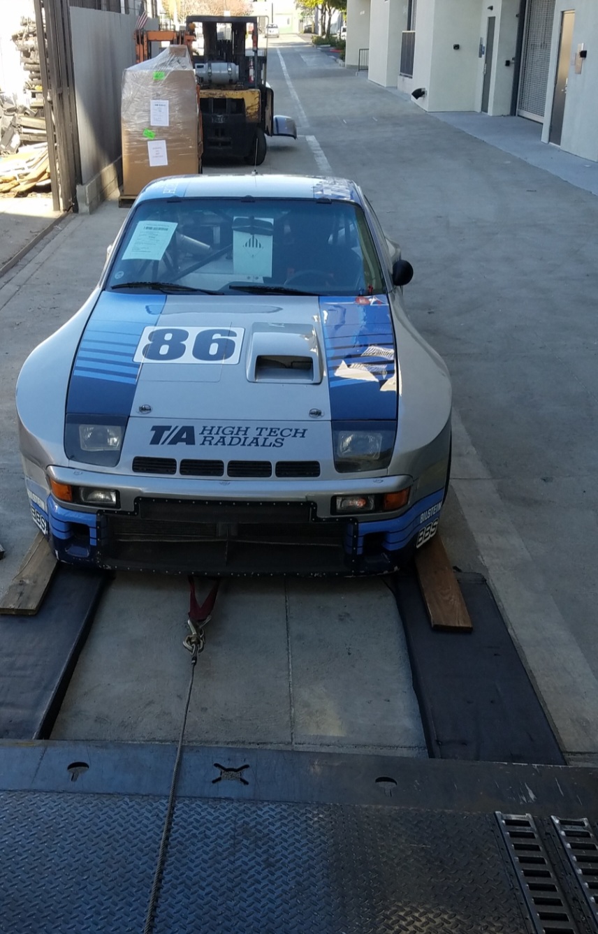

From the 1st page of this thread shows the 2nd car that came in the "Package". It was sold and back in Europe now, the new owners (they have overhauled the gtr) said that they are entering into the '22 Historic LeMans. Here's a pic of the #86 rolling out of the transport at the '82 LeMans forty years ago. The guy kneeling on the bottom right looks like Doc Bundy, and the guy just above him looks like Jim Busby...both co-drove the sister entry #87 (class winner) but slower lap times than the #86.
#86 DNF'd with a centerlock wheel that came loose and fell off (Manfred Schurti driver).
wonkipop
mean looking car. i think its the headlights change the whole persona (ignoring the swollen mudgards (translation = fenders) ).
that and the giant air sucking grille.
photo says they are having a bit of trouble getting it down the ramps? smile.gif
wonder why.
rgalla9146
The 924 was sponsored by Paul Miller Porsche a north New Jersey dealership.
Looks like they're trying to avoid tearing the nose off with those steep ramps.
Maltese Falcon

Maltese Falcon
...almost there
mgp4591
QUOTE(Maltese Falcon @ Mar 5 2022, 11:58 PM) *
Did you make the cap grip? It's probably a silly question but I had to ask...
Maltese Falcon
@mgp4591 I received a pretty tired looking/ GT gas cap on #40...so only repairs being made here. The prev owner spent days trying to remove it from the tank...as gas fumes (during extended storage) probably varnished it to the tank, and would not spin off.
The various ways that he tried to remove it caused the top Grip (2 "Fins") to tweak + bend, and lift off of the epoxy holding agent.
He did manage to modify an oil-filter removal (band type) tool to do the trick.
I'm just repairing here and making a longer lasting cap !

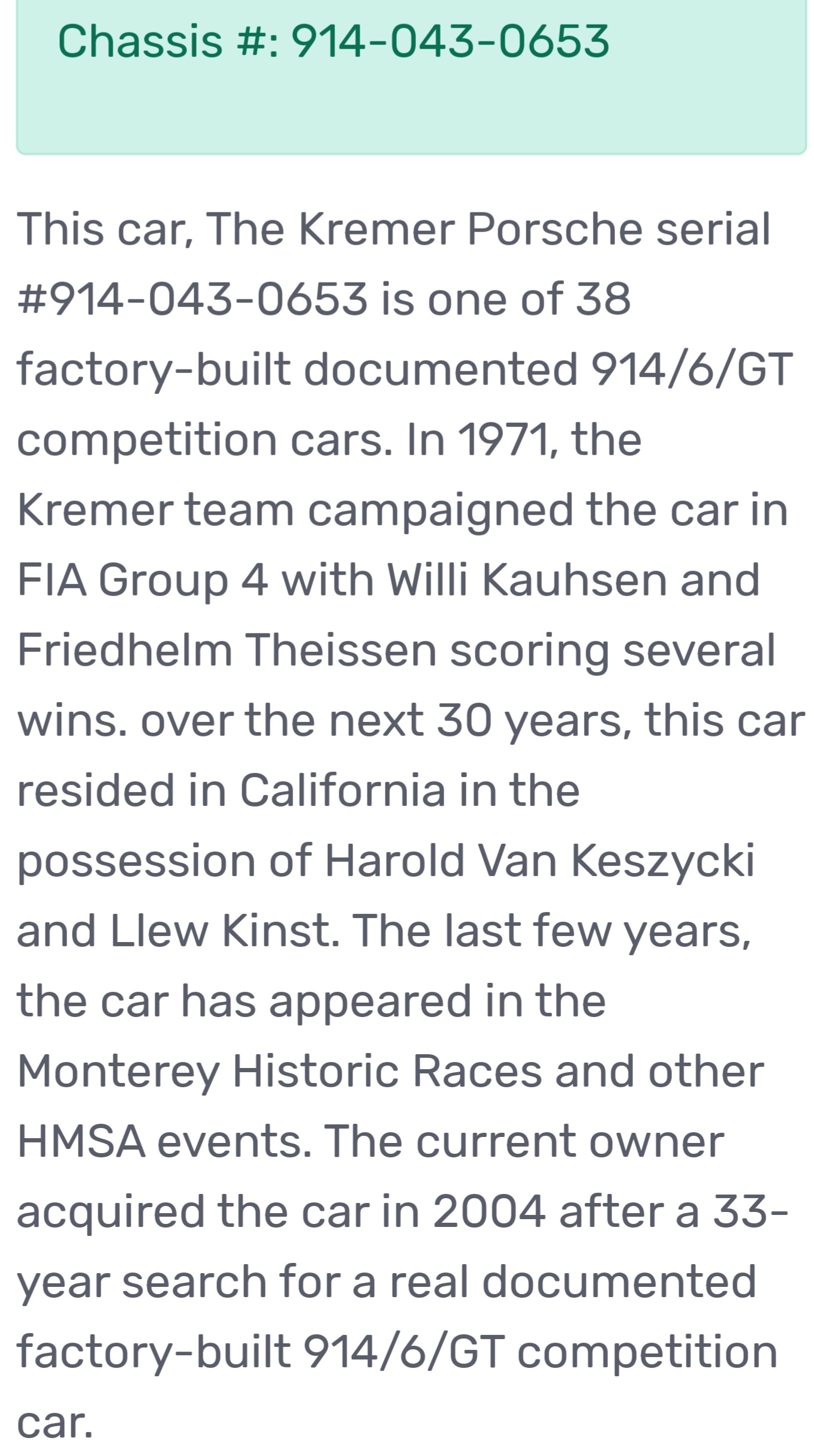

Maltese Falcon
@wonkipop could be the green Kremer prepared m471 that came to the States in the late '70s. Went into the ownership of Harold von K...who turned it into a yellow fire breathing wide body turbo Club Racer.
After that stint, it was sold off to a restorer who put it all back to Kremer specs; which is how it remains today.
I'll get into the Maltese library and see if it's the #58 !

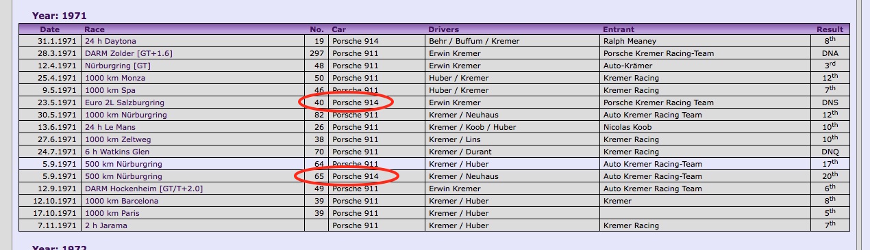

Maltese Falcon
This could be the car, as it links it to Harold's (von K) ownership at a point in time @wonkipop

had a closer look at photos comparing the one i found on facebook to one with my old mechanic. stickers on the front hood are in the same place - was mistaken.
they must have swapped out the numbers on the car before the race.
might have been wearing 58 in practice. then 65 in the race. all the other period photos of the car before von K got it are with 65.
photo i found of it on track looks like its taken in the carousel (or the other concrete banked corner).
my old mechanic is standing in front of the old pit garages which are still there and look the same.
the car only got raced by kremer twice for one year in 1971.
once at salzburgring and once at the nurburgring.
so the photo of my mechanic must have taken at the n-ring 500 in sept 71.
(unless they were at the ring for some other test session or something).
i think the r. meaney car listed at the top of events in 71 is a different car?

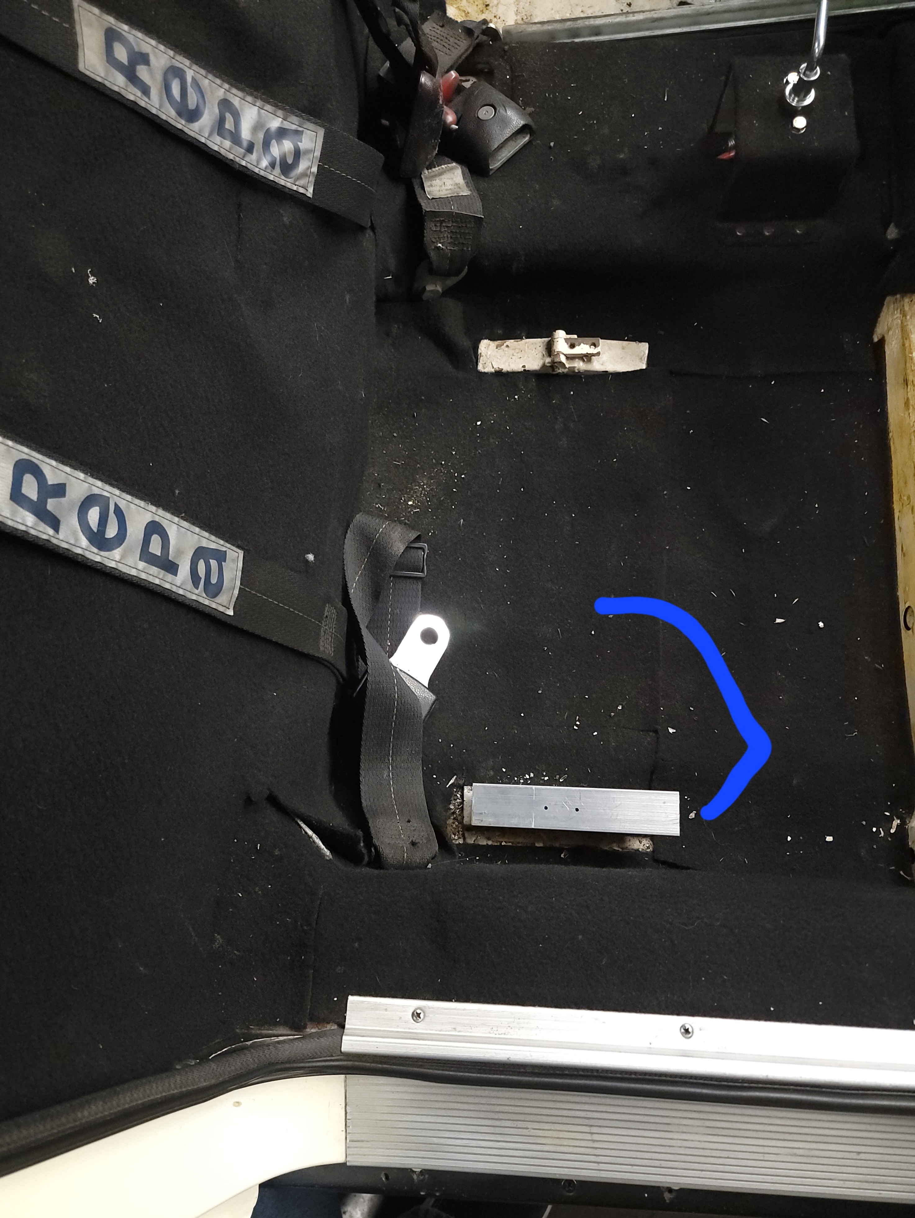

Passenger seat is a non-adjustable affair, with decent forward bracketing that's attached to the floor crossbar.
The Rears were just free floating on .125" gauge metal strips, that are welded to the floor >>with the OE seat rail hinges just there for the ride.
Now making a pair of T6 alum adapter brackets which will secure the rear seats in place.

A lot of "Things" that were just laying around loose in the #40, including this breather catch-tank.
Thanks to a bit of research and confirming with Glenn @gms , I have the correct spot in the rear trunk for mounting number40_914.jpg
