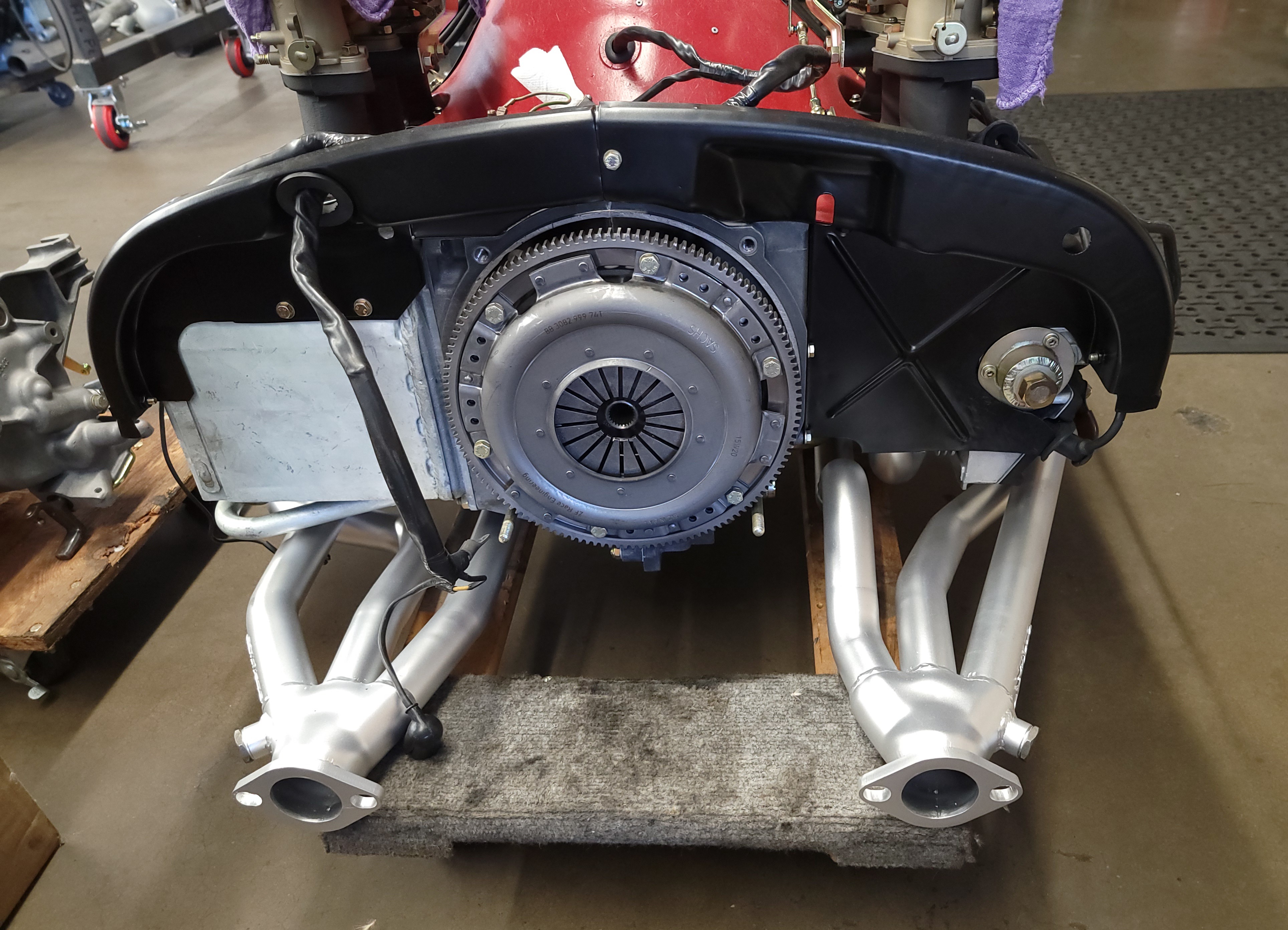

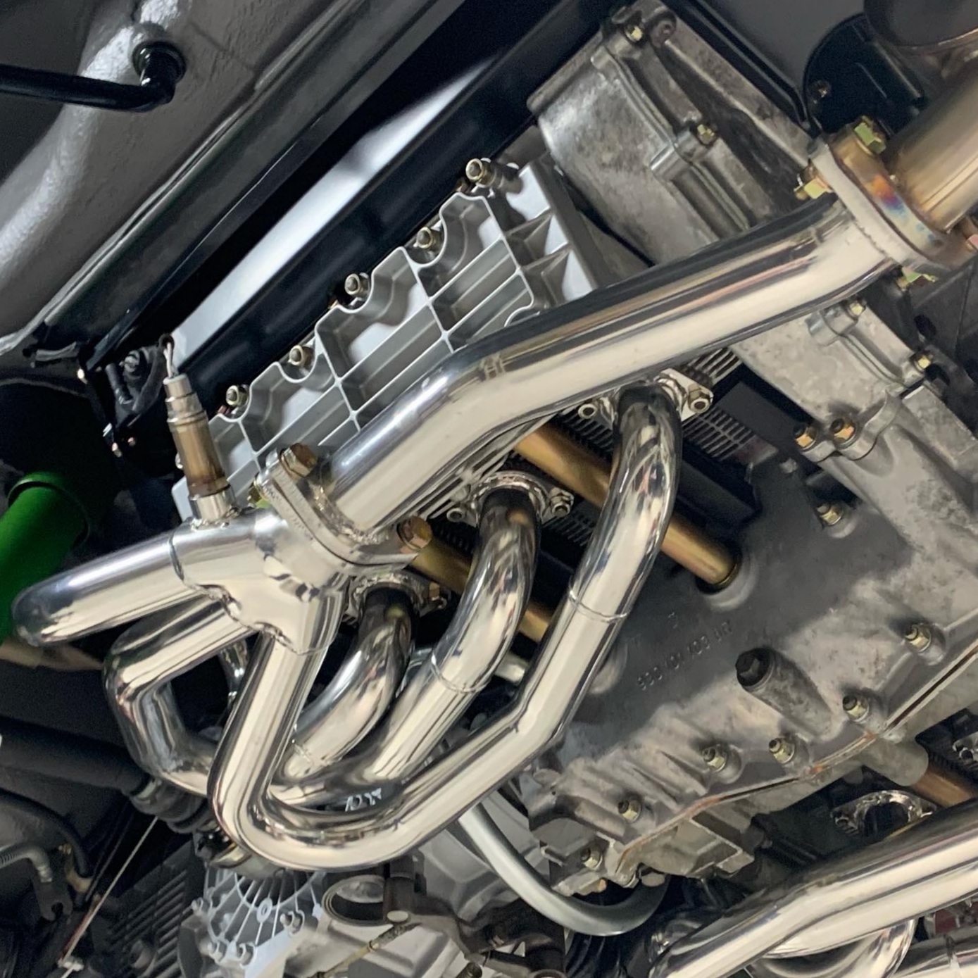

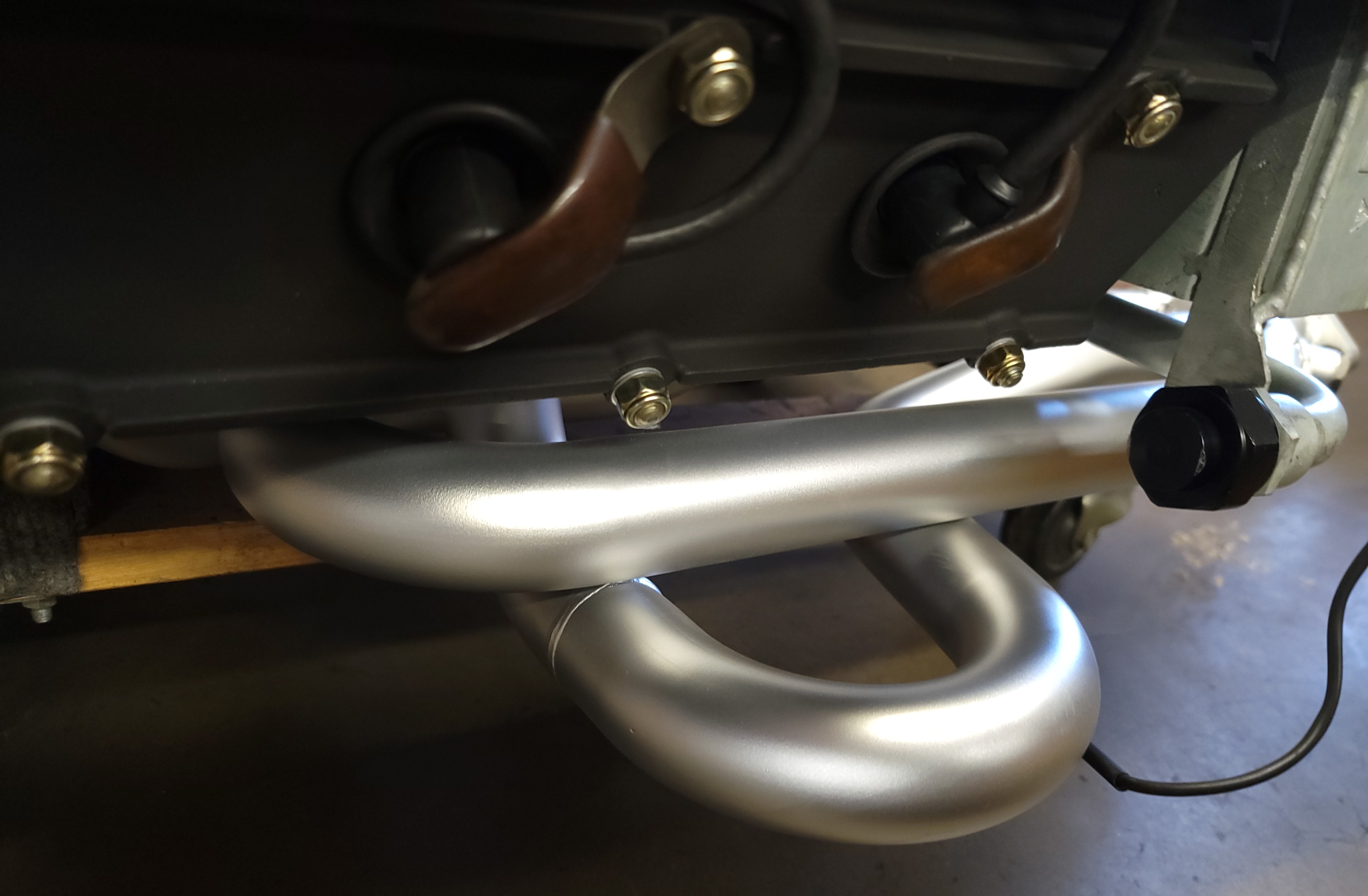

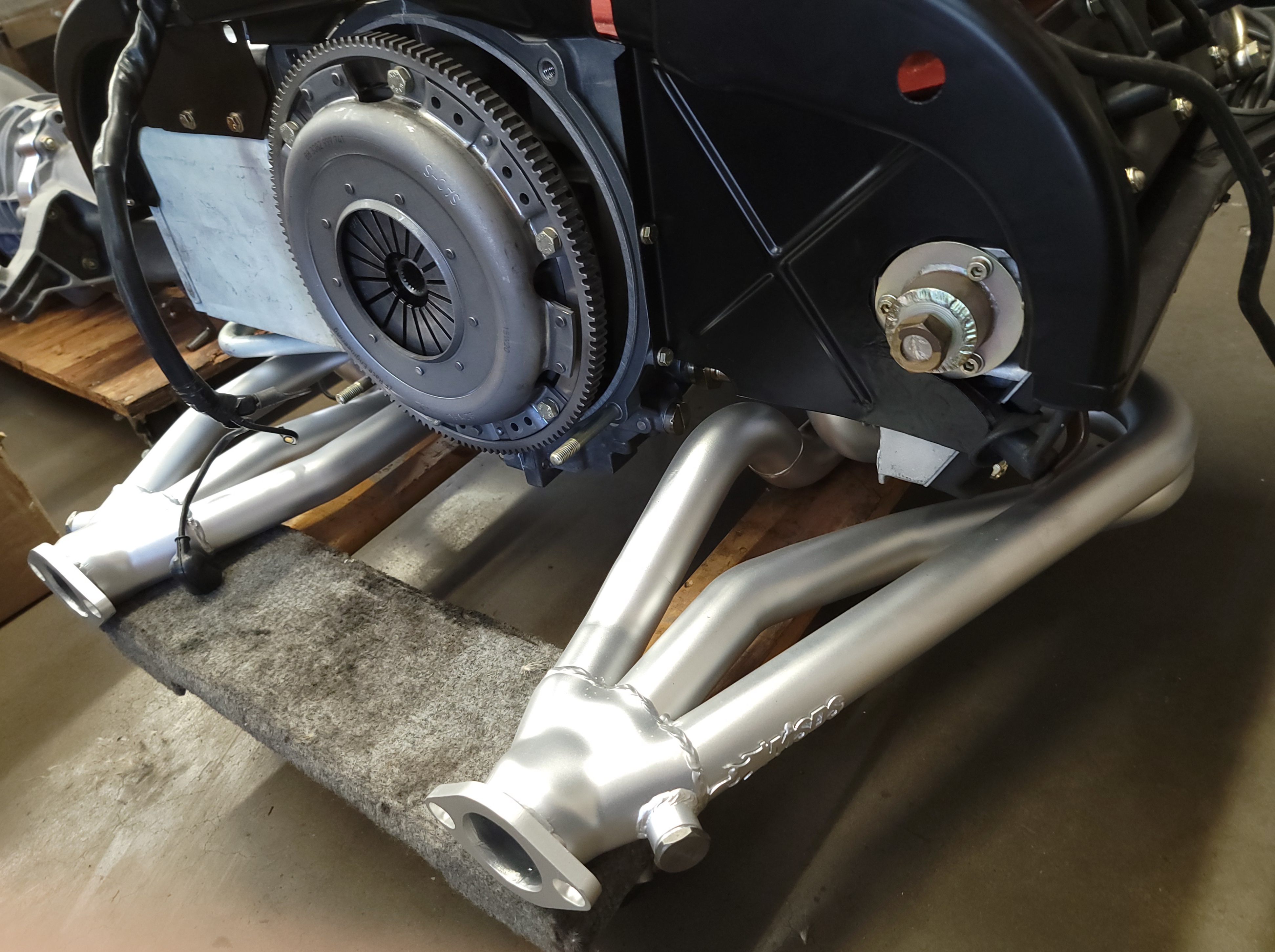

Getting closer, a few pics of our newly manufactured gt style headers; these are 1.625" od and ceramic coated in satin silver
Maltese Falcon
o2 ports for a/F sampling; installed in the left and right collectors.
Maltese Falcon
Drivers side
mb911
QUOTE(Maltese Falcon @ Jul 29 2021, 07:41 PM) *
Wont the o2 bung be to low in the clock position and cause o2 sensor failure?

Clay, just find a local sheet metal shop to form the 18 or 20 gauge "Clam-shells" on the break, and that's 75% of fabbing' the custom HB's. You can easily make the cardboard samples for the shop. There's a good section towards the rear of these headers that are on a flat plane.
There's a set here in large tube 1.75" od (4.0L) with Clay & Betty's name on them; RuF recently took 2 sets for their vintage GT builds number40_914.jpg
Not a problem @mb911 on the lambda probes, as we only insert them on test + tune days, then replace with the threaded port-plugs. Clearance is the issue, so hence the placement of the ports.

QUOTE(mb911 @ Jul 30 2021, 05:25 AM) *
I was curious of the same, from my understanding they should be installed between 10 and 2 O clock for moisture reasons?

Maltese Falcon
We have even kept the o2 ports on the lambda year (approx 1981-up) 911s just "Off of horizontal" angle @930cabman , again for purposes of clearence and allowing the Tech free removal space for the valve cover; without the need to (usually) unscrew a thermal-seized o2 probe .
Never had a client complaint about failed o2 probe(s) due to placement ; and my client experience with Bosch or Denso o2 probes = 50k to 80k miles of good use.
On the FIA style gt (#40) headers, there's probably slim chance of moisture buildup due to the amount of fresh air that immediately enters (upon engine shut off) those twin thermos sized straight through muffler tips/ megaphones , and at approx 24" you're right at the collectors.

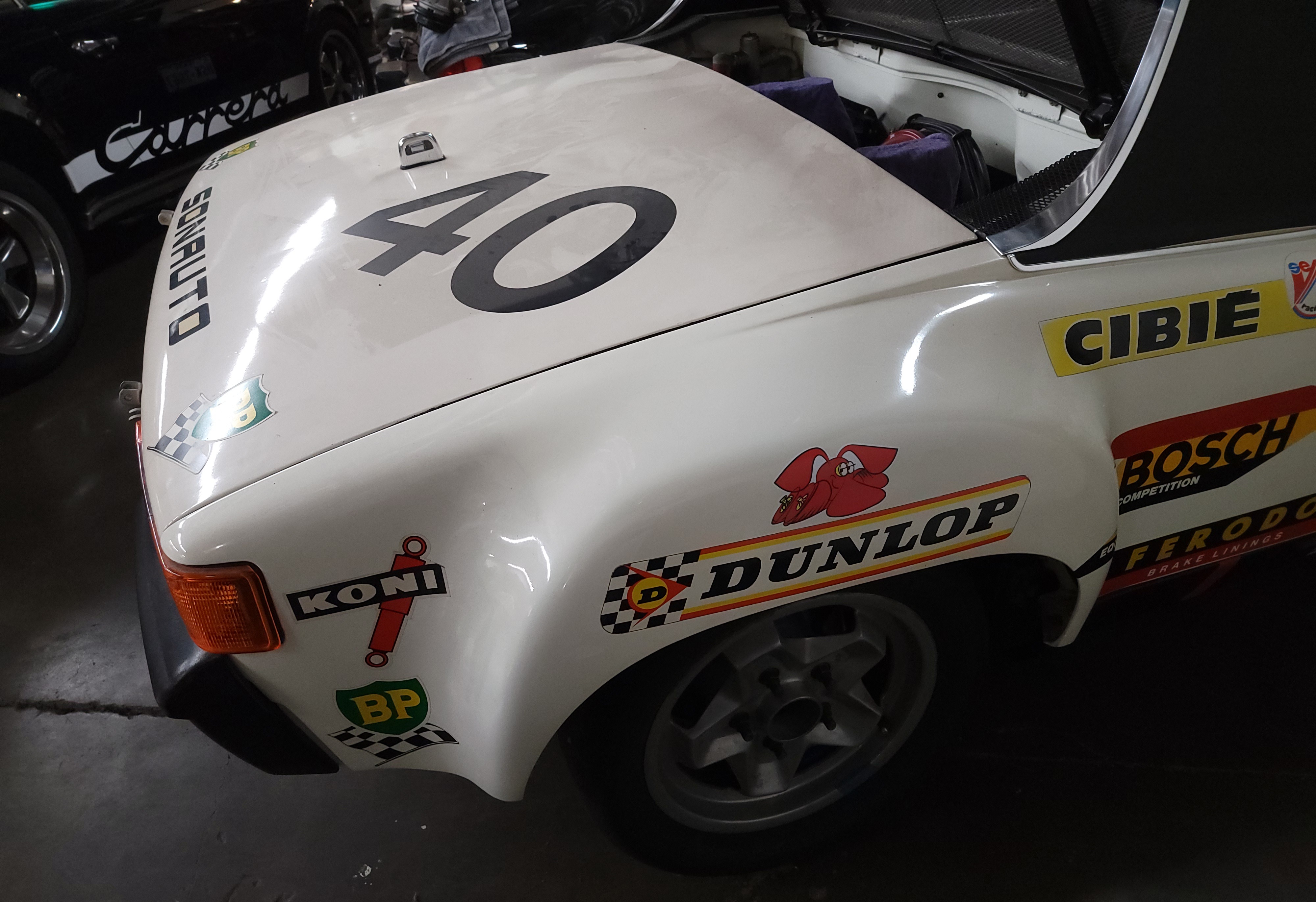

This week's shop action
Maltese Falcon
#40
Maltese Falcon

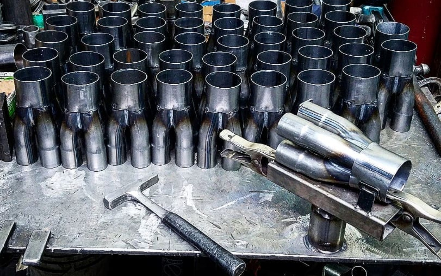

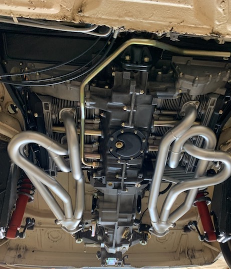

Pipes
Maltese Falcon
Another look at our 1.625" od gt style headers, 1,750° f ceramic coated /satin silver.

horizontally-opposed
QUOTE(Maltese Falcon @ Aug 16 2021, 06:18 PM) *
Rumor has it that the next ('22 ) Historics at WeatherTech Laguna Seca "Featured Marque" will be LeMans cars !
Now, that would be an inspired choice on their part. Let's hope, let's hope—and, either way, I cannot wait to see #40 back on track.
Obviously two very different setups. Marty, what's your take on each?
Obviously one is part of the GT "rally muffler" setup below.
Which has me wondering if those intermediary pipes between the headers and the mufflers could be utilized for catalysts or even cats with heater boxes for those who need or want catalysts in a street car. Suspect cats would supercharge a very small heater box, too. idea.gif

gereed75
Pete, That is a really interesting thought. I have always thought about the application of an aviation style heat muff for our cars as a more simple alternative to the stock heat shrouds. The problem with that is they need an un-obstructed section of straight pipe to fit onto, and that does just not exist on the stock headers or on most other headers. See this
http://www.velocedge.com/Starduster/Projec...ter/Default.asp
But this configuration does provide that straight section. The issue would be getting the blown air routed back to this section and then returning it to the heat pipes.
I think maybe this deserves some further thought and its own thread so as not to detract from #40 worship.
QUOTE(gereed75 @ Aug 19 2021, 06:16 AM) *
Gotta say that #40 is the holy grail and Marty and crew are the perfect custodians. Sometimes life and karma do produce the perfect match!
Agree with all your points—particularly that last one.
Those straight pipes really do provide for some interesting options, and small HEs would be one of the best of them. I would be interested in cats with HEs as I would love to have a cleaner 914—though I'd want to weigh that against the implications for engine oil temps and transaxle oil temps. The heat muffler you linked is very, very interesting—as is the flapper box in the pics, particularly if it seals better than the Porsche flappers. The new ones I bought years ago still bled heat from my SSIs, which was super annoying on hot days. sad.gif
Agree about the question on how to get the heat forward again, to the flapper boxes, but suspect fairly elegant heat return tubes could be made to work. One begins to wonder if the GT headers could also provide an easier way to do valve adjustments, if the straight pipes and muffler could be left in place? How cool would that be? Looking at some of those GT hangars/mounts with increased interest now, as I am wondering if they support the front of the straight pipes? Or if that is even necessary for a valve adjust?
Yes, a separate thread is probably warranted to avoid polluting this one—but this fantastic thread on #40, a 914 that has been inspiring me for more than 30 years and is prominently displayed in the 000 office, prompted the crazy thought. Which gets me back to your last point… beerchug.gif

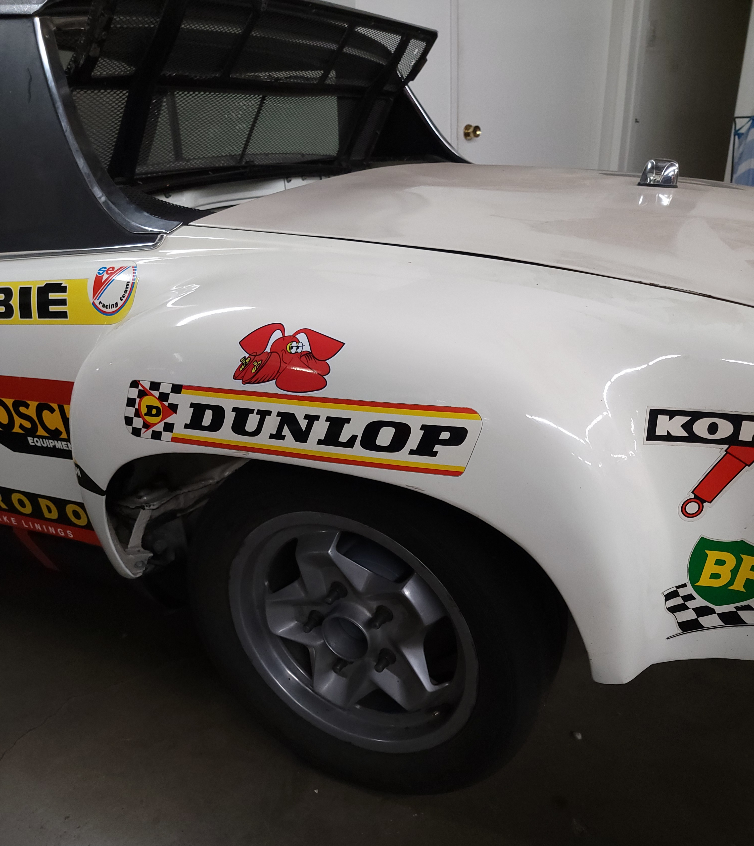

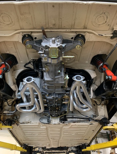

Maltese Falcon
Engine/ transaxle installed, and Dunpy has landed on the rear flares...been MIA for about 50 years !
I've had the Dunpy stickers professionally printed , and have a small stock on hand/ Dm me if you're interested number40_914.jpg

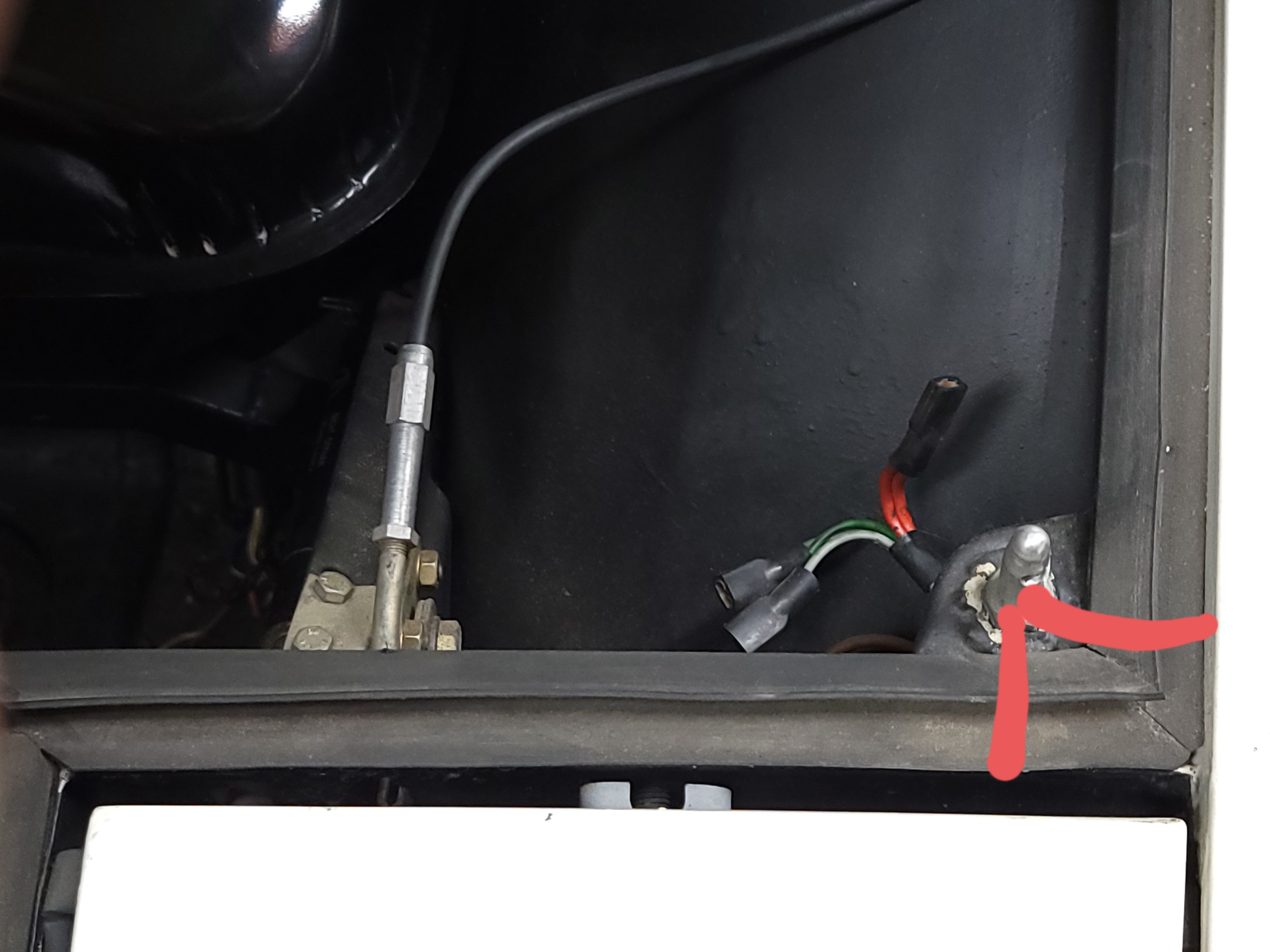

Several months ago Marty took some measurements and made a drawing for me of the lower hood plates. Is there a chance he could make me a drawing for the upper plates too? @Maltese Falcon @MATTYLITE
Thanks! You guys are the best!!

Maltese Falcon
QUOTE(IronHillRestorations @ Oct 11 2021, 05:55 PM) *
Def will pit this on the to-do list for you...sharpening up the #2 pencil !

Maltese Falcon
QUOTE(IronHillRestorations @ Oct 11 2021, 04:55 PM) *
Perry @IronHillRestorations , the upper plates just use the OE corner-pieces (where the rubber adjusters fit). The pin centers are 1.5" center-to-edge (weather-strip) channel...in red.
Hope this helps !

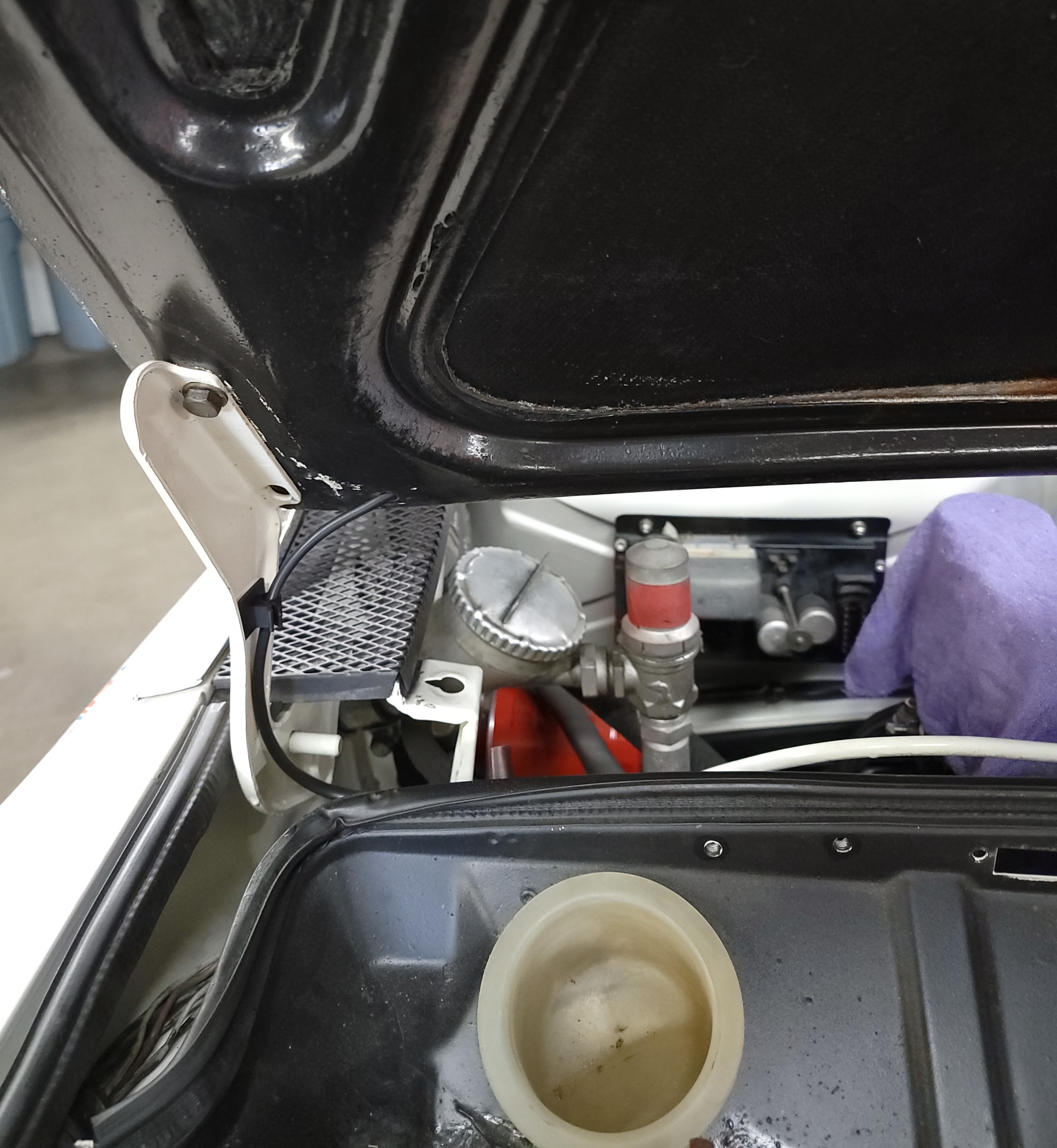

Maltese Falcon
Cleaned up the neglected Lamp wiring for the rear trunk "40" night illumination. It picks up its power from the (former) engine compartment light.
QUOTE(Maltese Falcon @ Nov 17 2021, 09:37 PM) *
Hope this helps !
@ Maltese Falcon Thanks Marty, but I was asking about the plate on the hood. You made a nice drawing of the lower hood plate, but I need the upper too.
