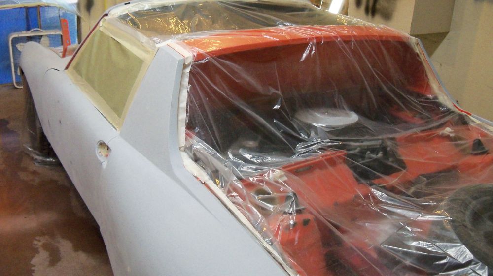

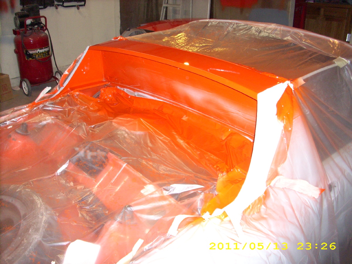

Sanded down the drivers side last night as well. It hit me that I have to paint under the targa bar prior to painting the rest of the car.. Soooo Im going to try and enlist some help tonight to get the car sanded quick enough to paint under the targa bar tonight..

Its either now or after paint on the rest of the car and I figure I'd rather do it now than later as it can sit for 3 days drying then I can properly mask over the paint..
Oh and I found out that dollar tree has 10'x12' (Thin..) painters plastic tarps. They worked well painting the hood, I'll pick up 5 or so for these little spot jobs. Probably use 3 to cover the car for this...

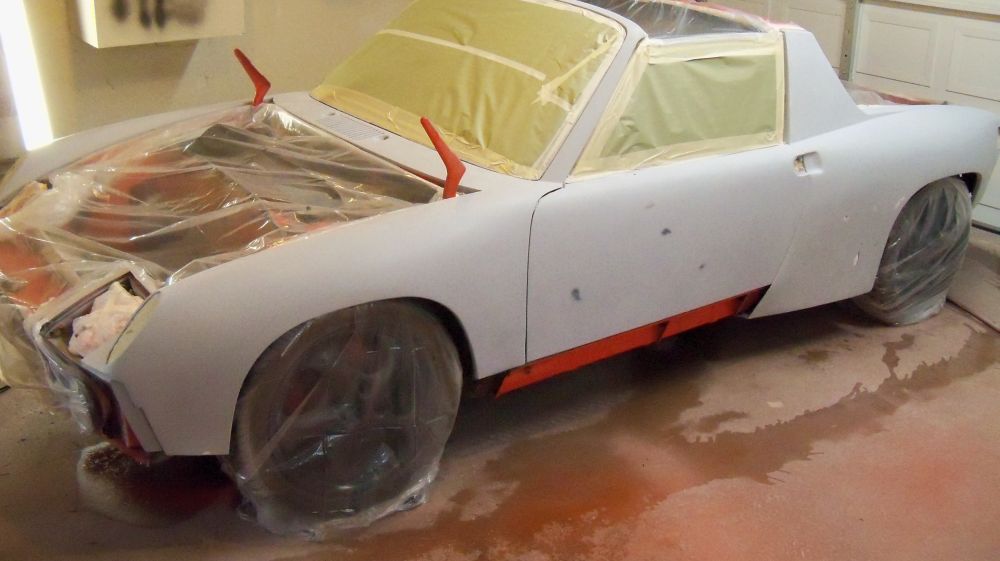

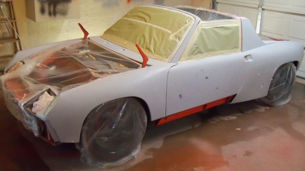

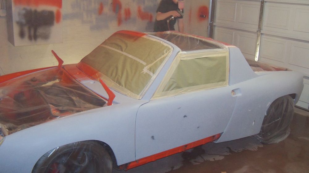

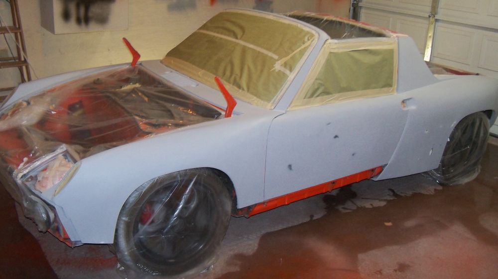

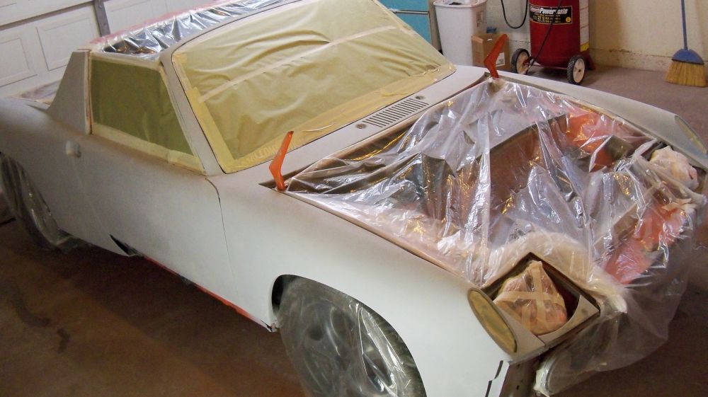

Dad came over this afternoon and helped me get the rest of the car sanded. All set now to start prepping for paint tomorrow and to paint under the targa bar (And paint the front hood, I decided I will paint the front hood off the car as well so I can get to the fenders and the cowl area without worries).
I'll have some time on Friday morning as well so that might be when I paint those area's to keep the bugs away... But then again I might do it tomorrow night (Now that im thinking about it, probably not).

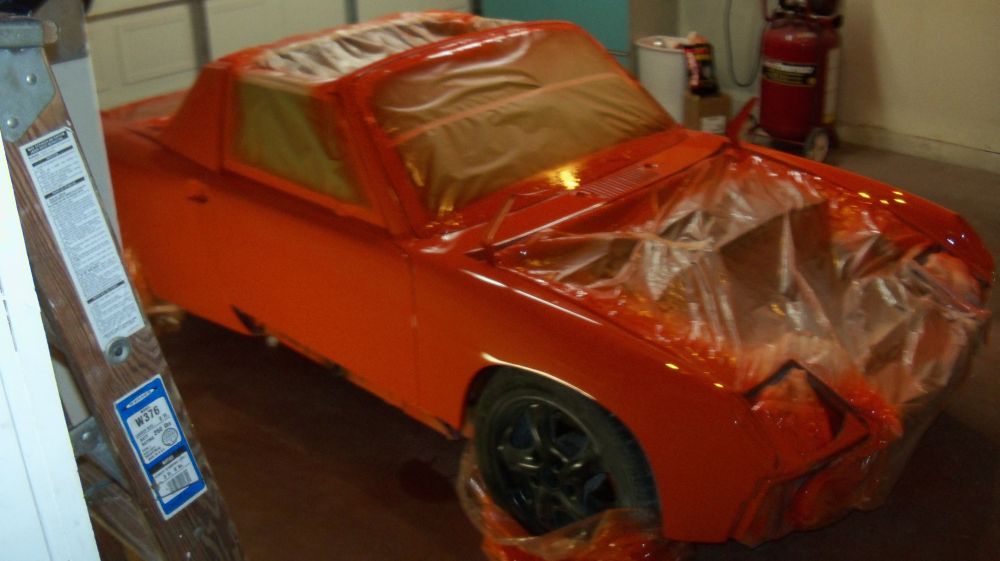

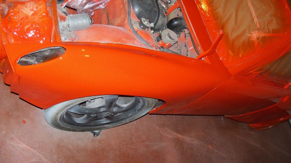

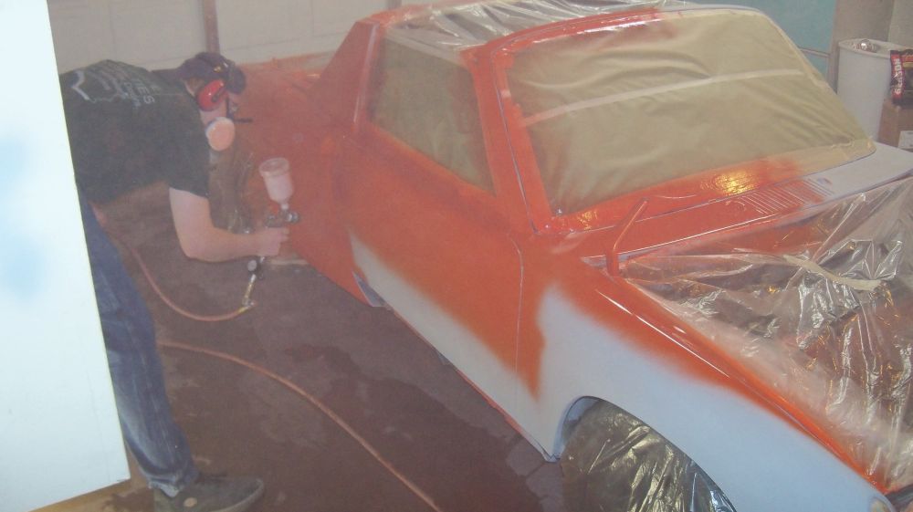

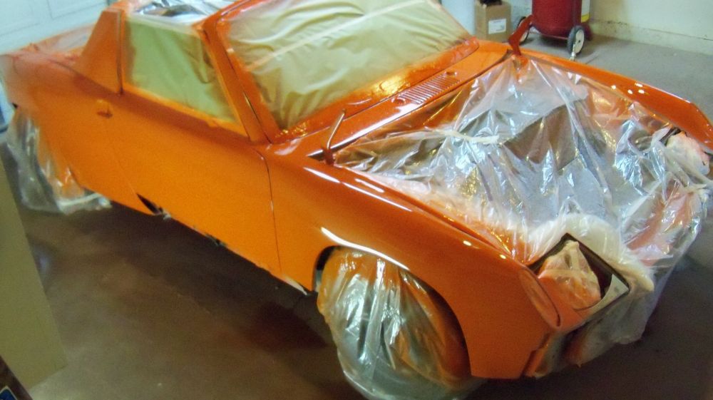

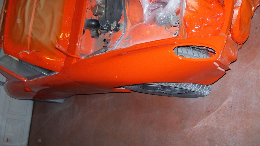

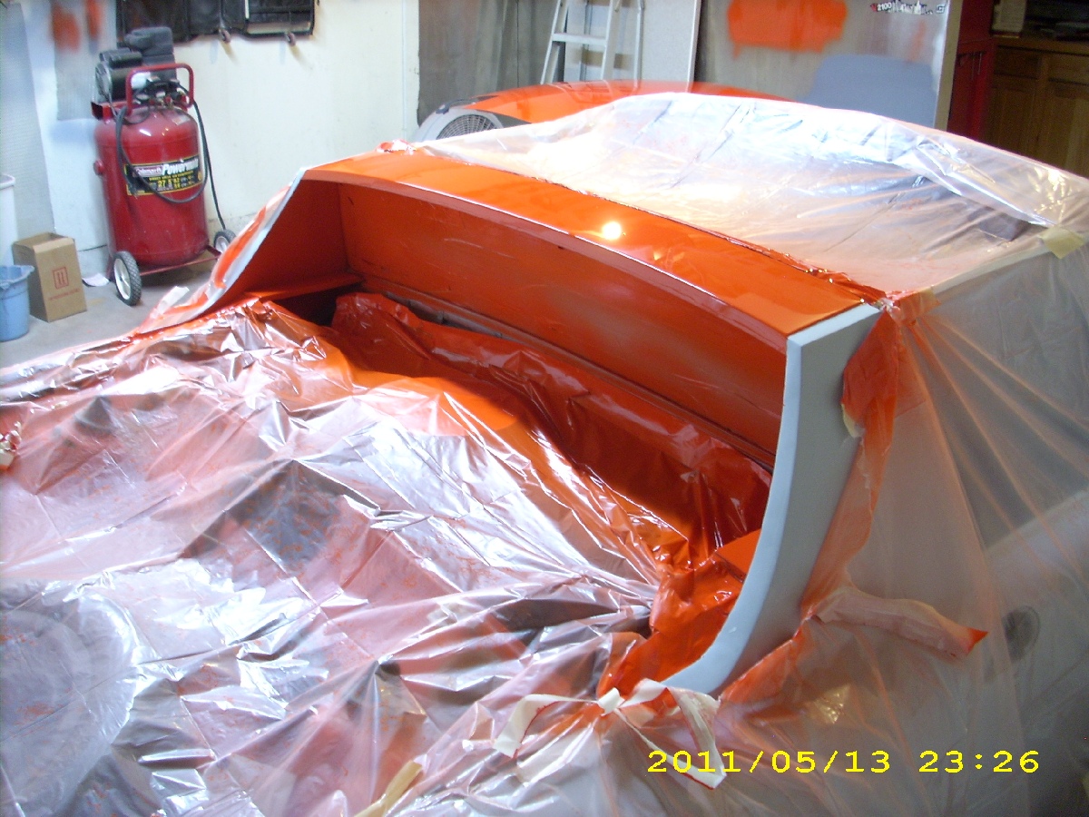

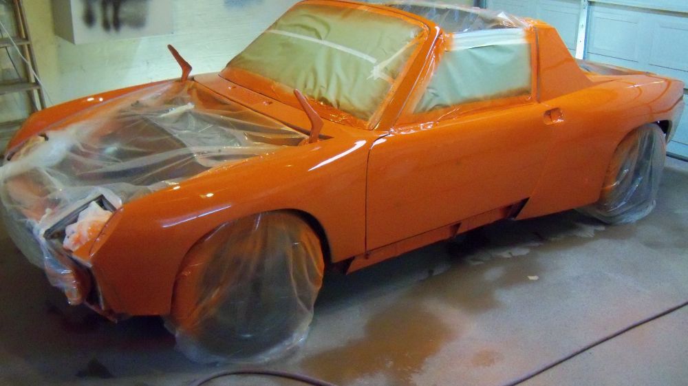

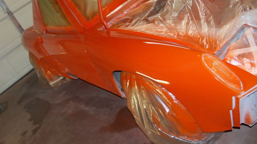

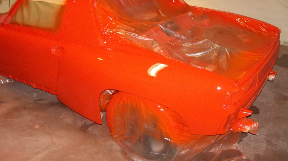

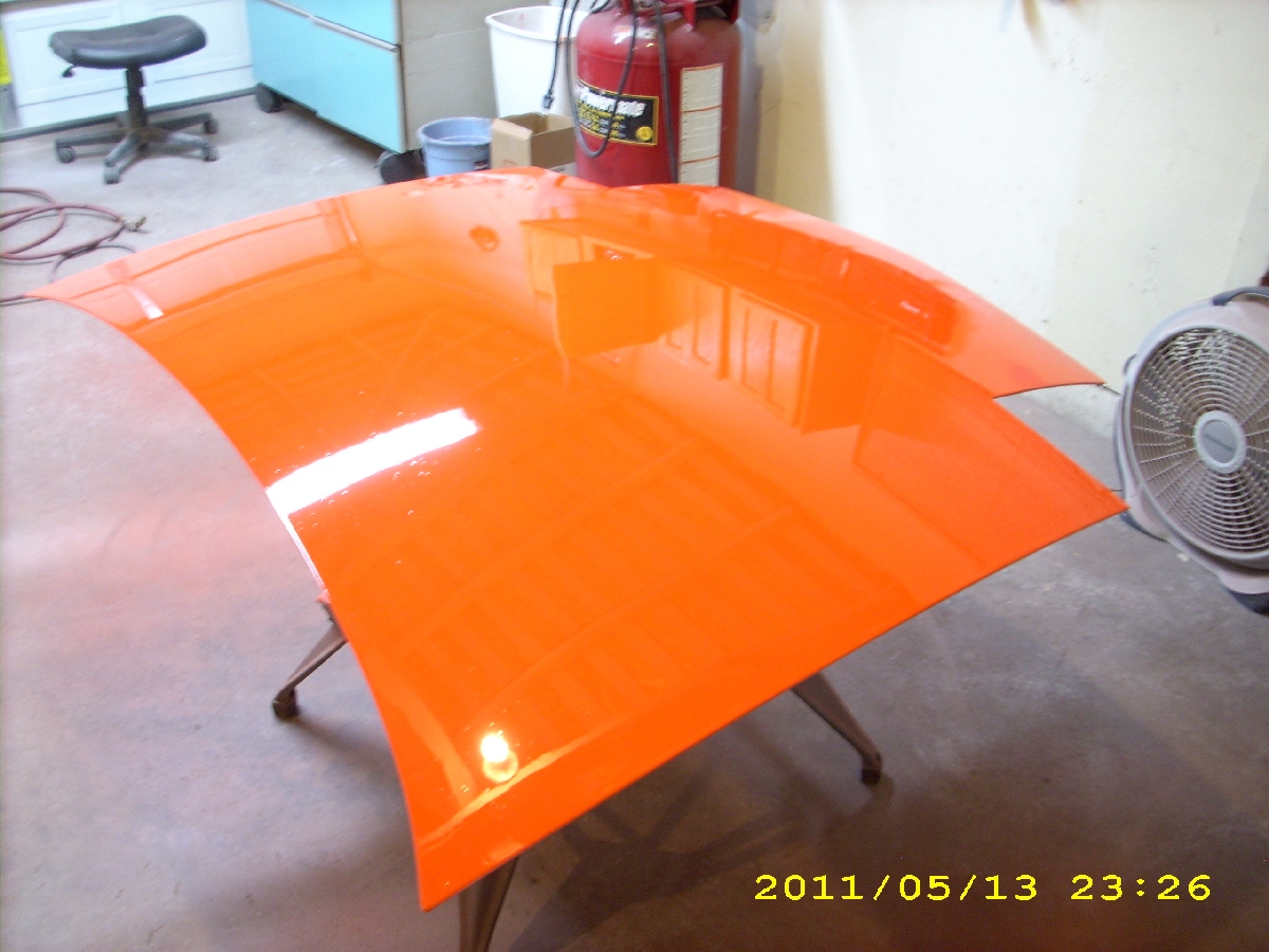

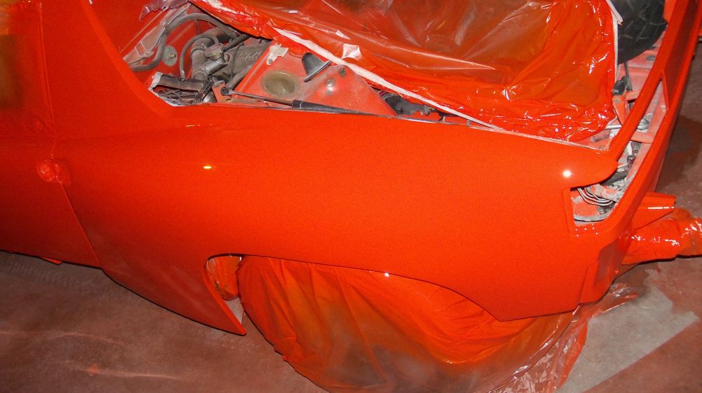

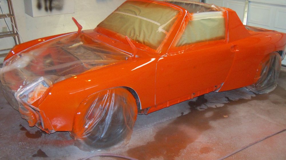

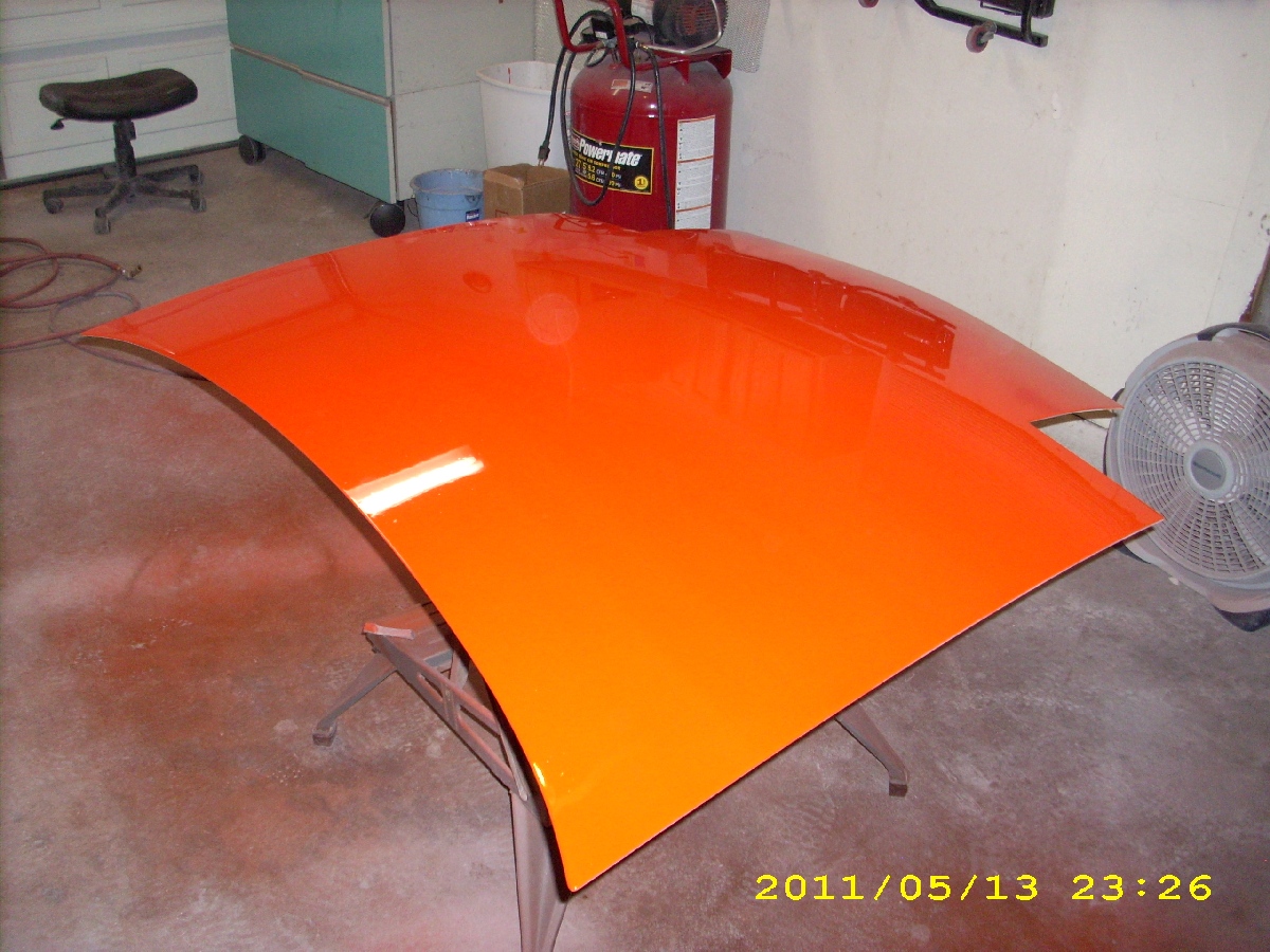

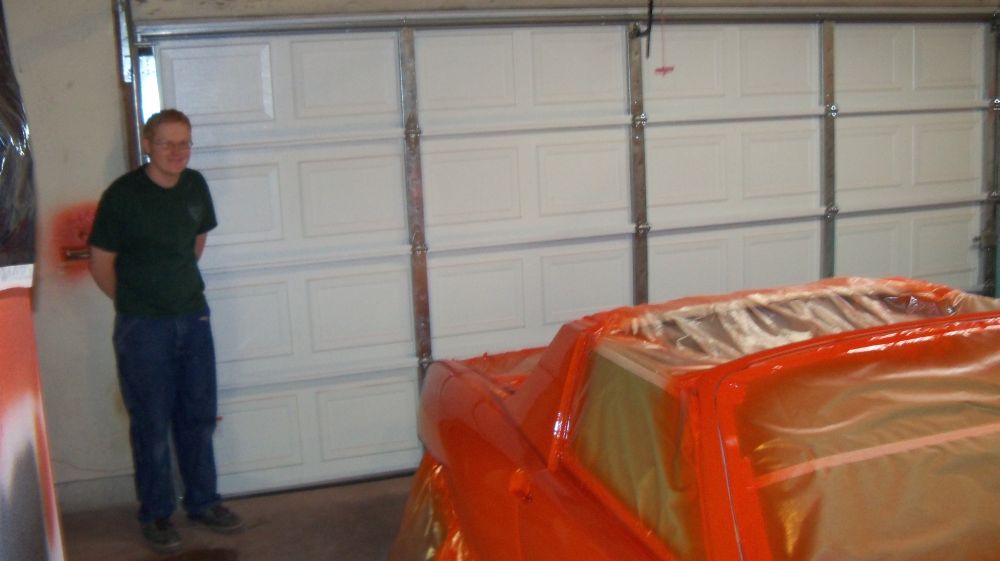

Click to view attachment Done.
Turned out better than I had anticipated. We have very little dust in the top layer of paint. A bunch in the first layer but that was due to the weather strip channels not being prepped properly.
There are a few runs, More than I had hoped, but they started popping up around layer 5. There are 7-8 layers on the car. 5 was required for full coverage over the area's that the black primer broke through, Those got the extra layer. There is less orange peal than I had anticipated which is good, but the runs are not something im looking forward to fixing. It was a lot colder than I wanted to spray in (I had anticipated 70 deg, it was around 65 and dropped to 60 at times. I had my space heater going when I was not spraying to keep the heat up in the garage and I feel that really might have helped (However I overloaded the 20 amp breaker ~ 4 times because of it... Shop lights, compressor, fans, and heater...).
Paint is very glossy and very nice looking. We do have some concerns that my 285 tires might not fit without a bit of a spacer though, I hadnt realized how close to the inner fender my current tires were. So I may need to add a bit of positive camber and maybe some 1/8" spacers. We'll see how that turns out as I will be getting the wheels off the car to get tires mounted.
Still to do. Sand runs off targa top and see if I break through the paint if so respray. Sand rear trunk and respray, sand rocker pannels headlight lids and spray. Wetsand and buff, rest of my list on page one.
PS Im not a big fan of the pic of me grinning like an idiot

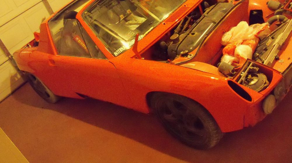

Jun 3 2011, 09:26 AM
Drove to work, My co worker had his project there as well to show me
Still have a lot to do, Lots more wet sanding then hopefully buff it out soon.

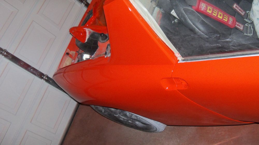

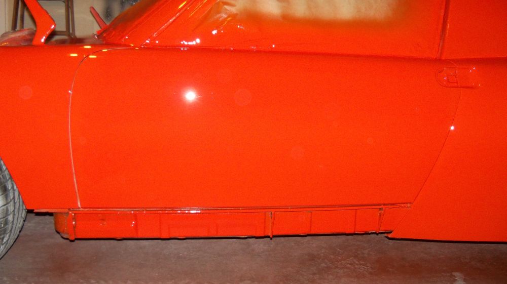

So spent a total of 17(give or take) hours this weekend between me and my dad cutting and buffing the paint. Its been raining all weekend as well so i couldnt get it in the sun for pictures. I'll upload the pictures tomorrow.
On the runs I started with 600 grit, then 1k then 1500. On the rest of the car it was 1k then 1500. On dirt specs I scraped them flat with a curved razor (details in pictures) then 1k and 1500.
Most of the flaws were removed from the paint this way. The fenders look FANTASTIC. This car really shines now. I cant wait to show you guys some in the sun pictures of this thing. (Dad took some, maybe he'll post some).
I am VERY happy. But there is still some buffing to do. I have to buff the hood 2 more times, as the 1500 scratches are still there in some spots.
Tomorrow i'll paint the headlight covers (as i'll be able to roll the car out of the garage finally since the rain is going to die down..) and get them on the car on Tuesday. Weather stripping also starts to go on tomorrow.
