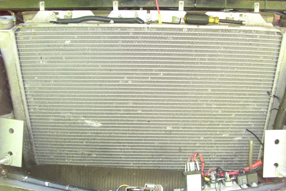

Radiator cutouts in wheel well (And replace hood with stock)

-Lastly, I saw your skillful fixes of the mechanical water pump. While this setup "works", I'd like to suggest going to a remote Electric pump if you continue to have cooling issues. Lord knows Modesto has long hot summers!
Why the electric? Because you get CONSTANT MAX water flow ALL the time. So when you are in traffic with the engine idling, you are getting water flow as though you had the engine revving 4000 (I did the homework on this issue). I've been running my Meziere 55 GPM pump for over 10 years with NO problems. The say it has an MTBF of 30,000 hours and will rebuilt it for around $50.
-One of the BEST things you did for cooling was cut that hole in your front hood, I tried ducted out the bottom for a long time and was always running hot. As soon as I cut my hood vent, all my problems went away, including running at Willow Springs in the upper desert of SOCAL in summer.
