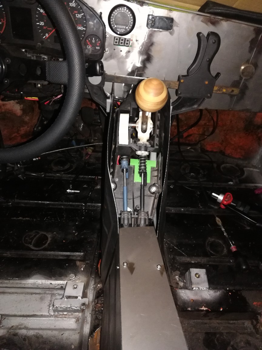

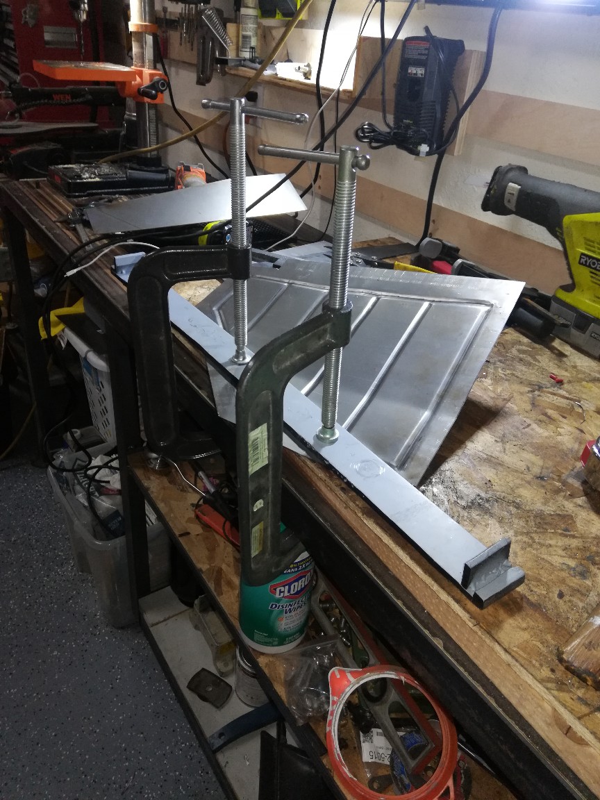

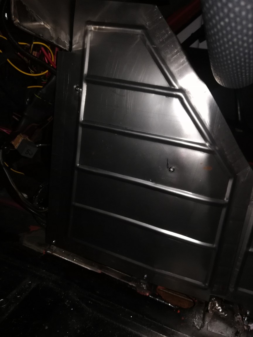

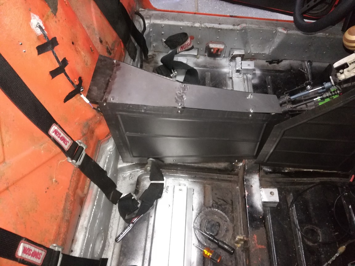

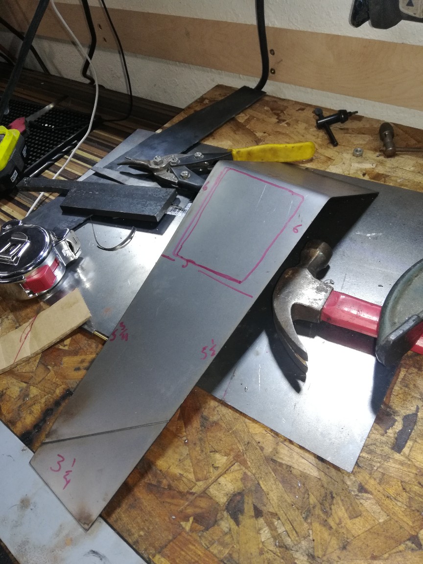

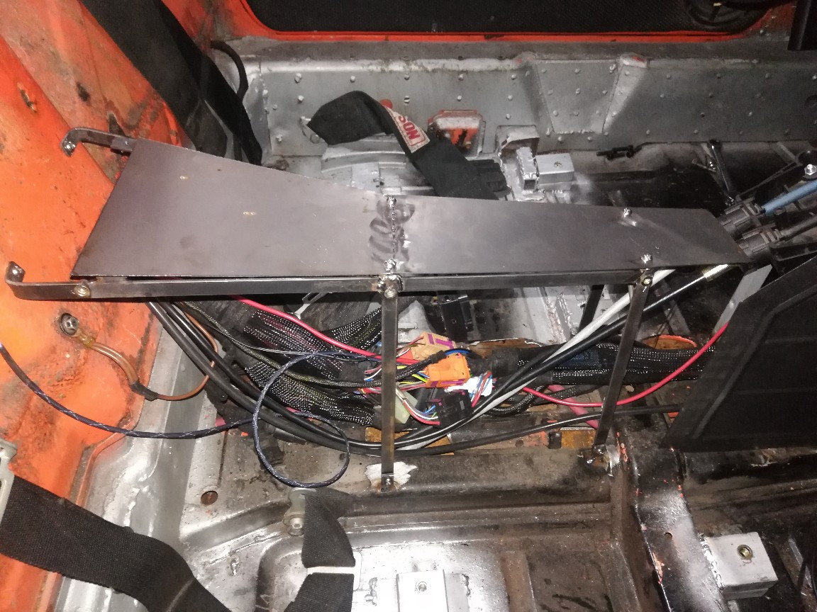

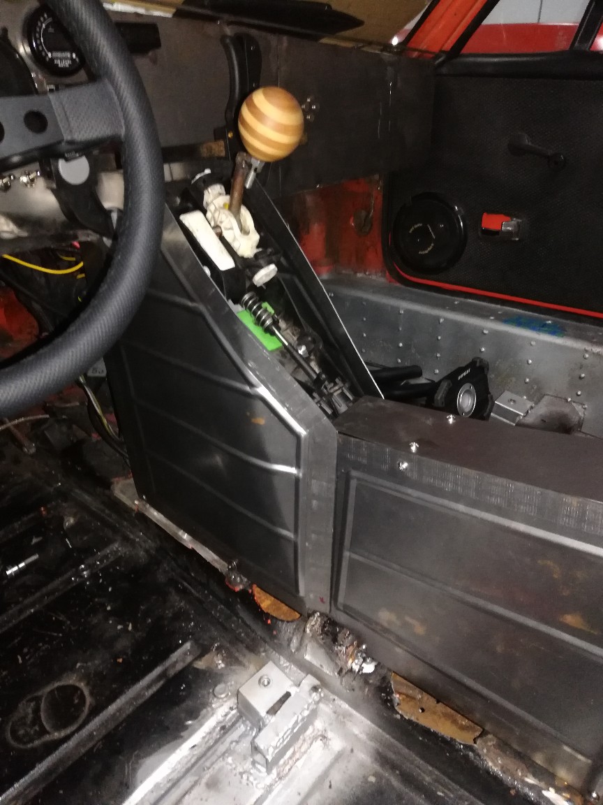

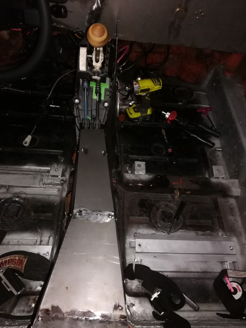

Lots went on this weekend!
Saturday was Build day at The Red Barn hosted by Chris @tygaboy!
http://www.914world.com/bbs2/index.php?showtopic=337633
As per usual I got a lot done but its never enough!
I should really go up there myself for a day and just work with all his tools... Just a killer awesome fab shop he has!

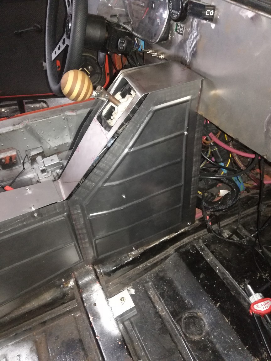

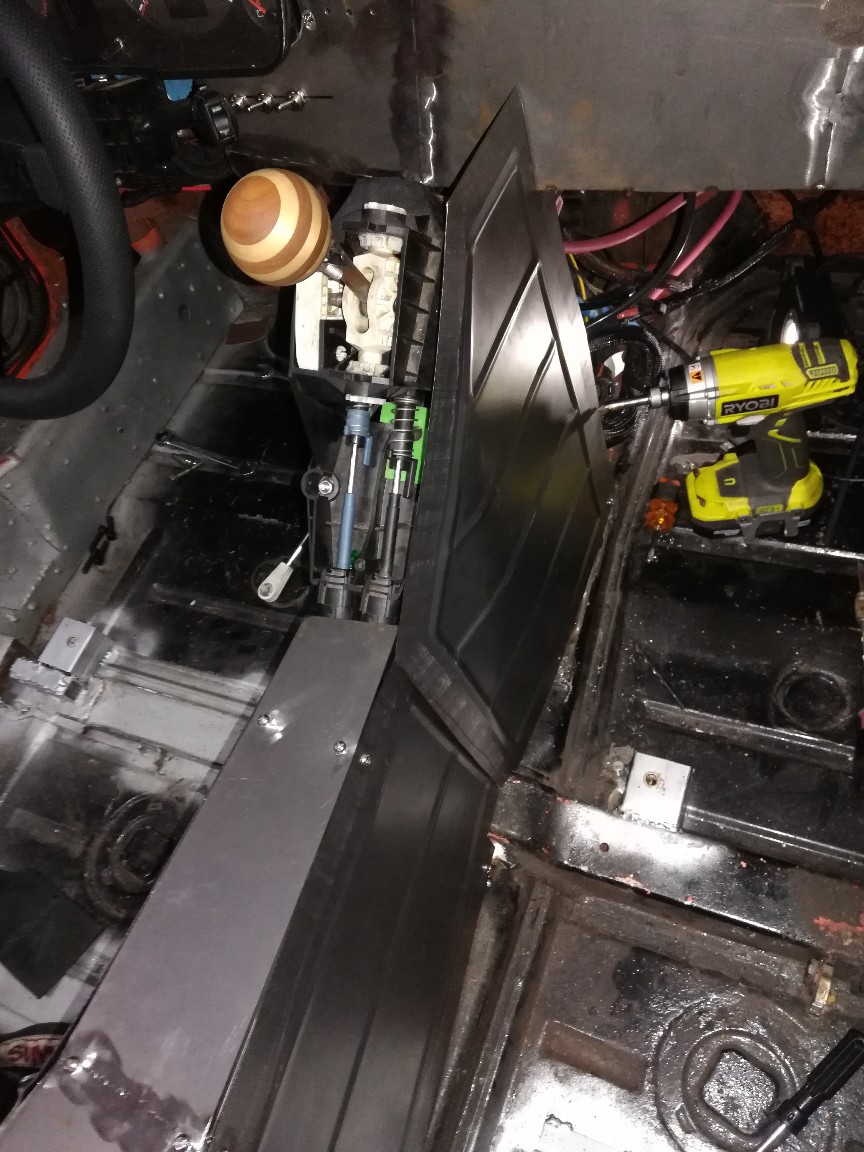

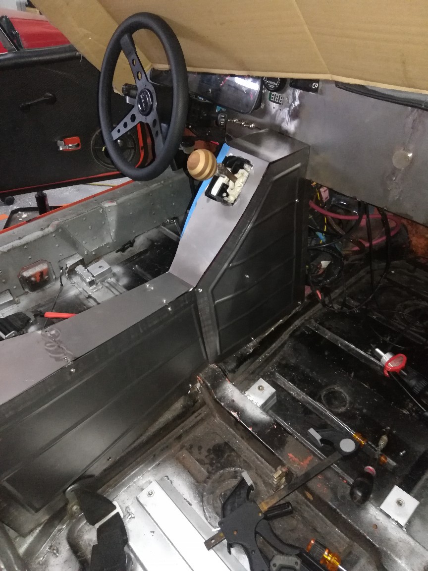

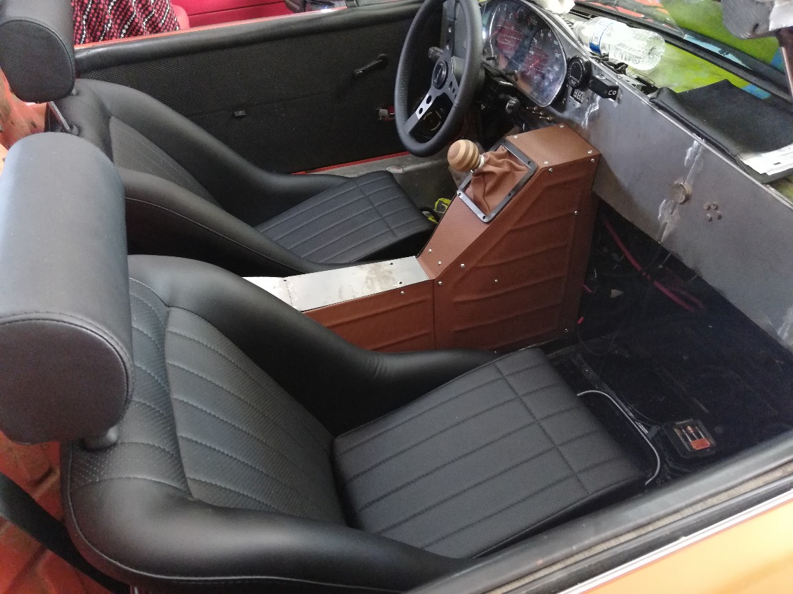

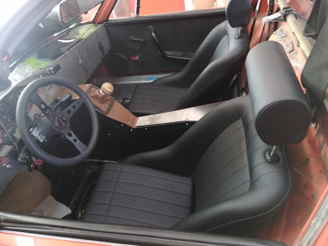

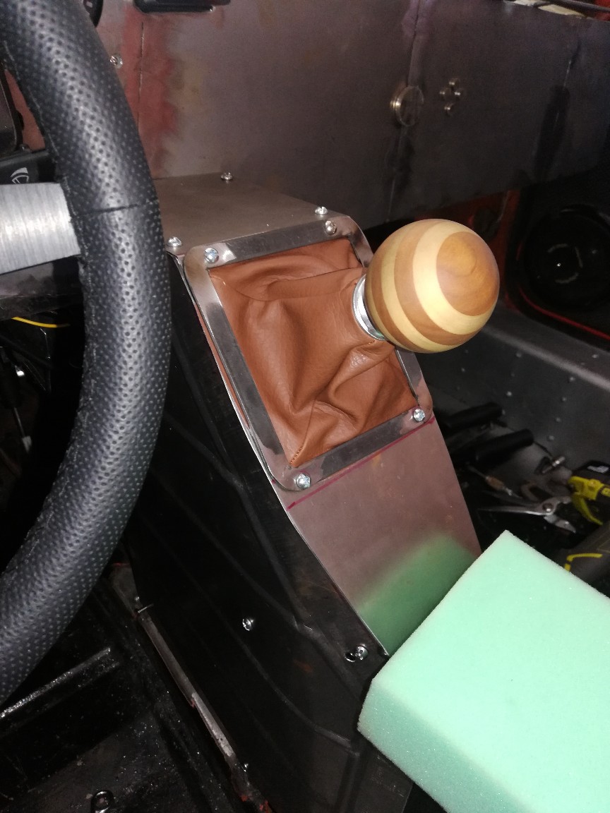

What I made! Center console pieces. They are just laying there right now, I'll be fabricating mounting points for them and trimming the pieces to fit then upholstering them. Not sure if black or brown yet or possibly both.
IPB Image
IPB Image
IPB Image
IPB Image
IPB Image
Very comfortable arm position, Could be higher but uphostery pads will raise it some. As it sits now its a stretch to hold the wheel and rest the elbow at the same time, that will change.

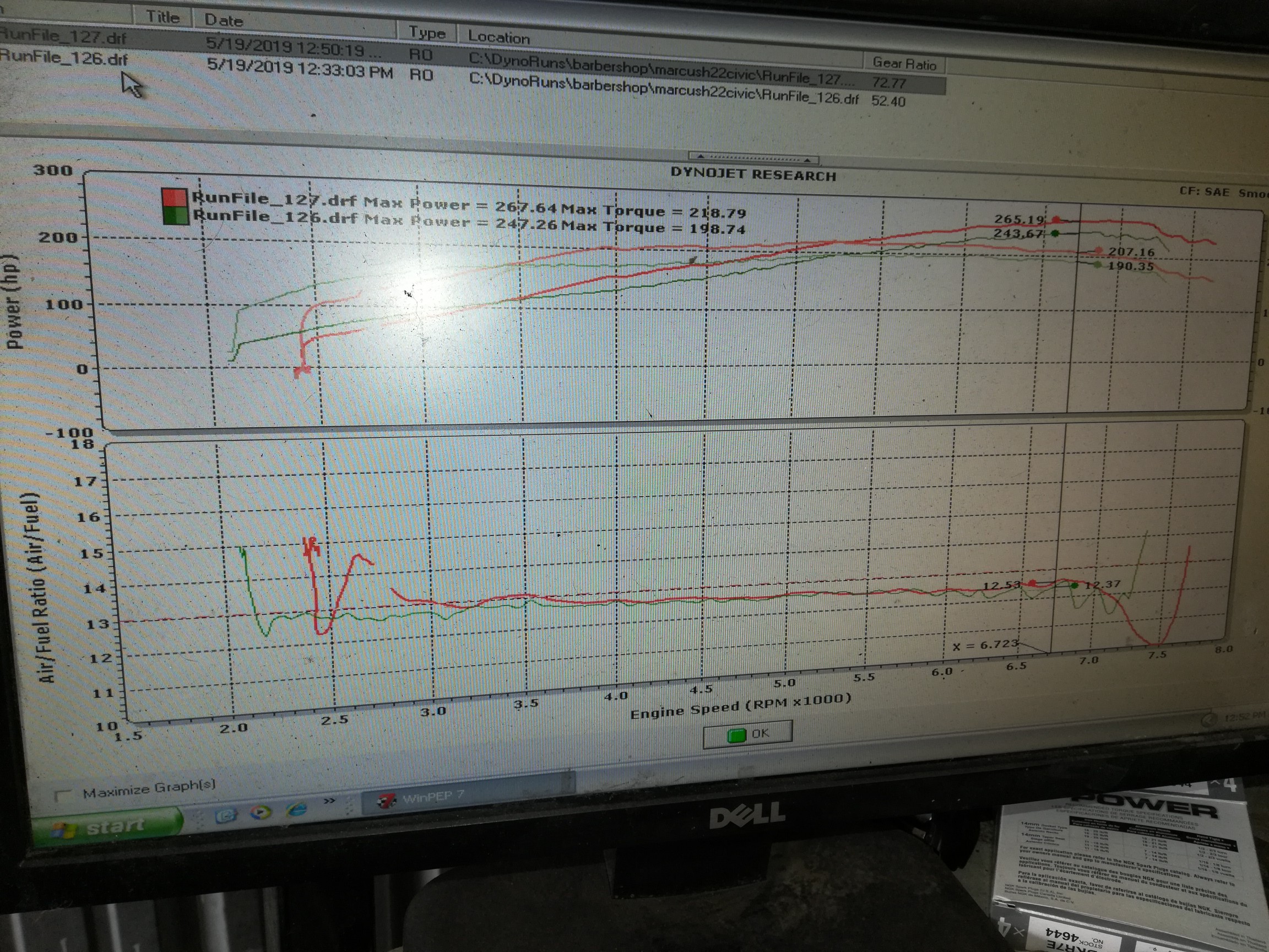

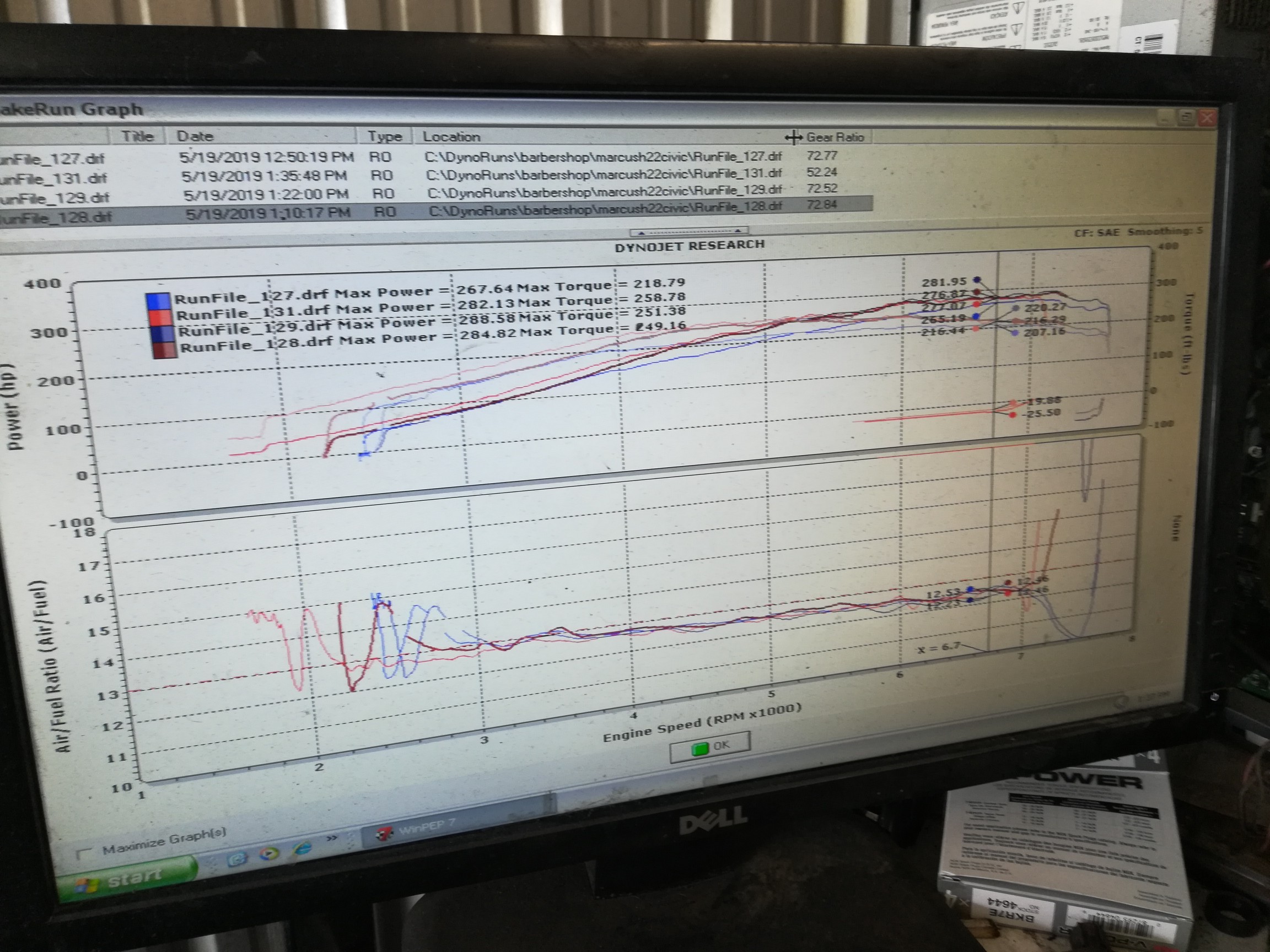

Dyno day on Sunday went pretty well.
Ended up making 8lbs of boost actual manifold pressure on the wastegate and that did 247hp/198tq at the wheels. This was about 50 more than I was expecting which was the highlight of the day smile.gif
My boost controller was reading boost inaccurately so while I was showing 17+lbs of boost I was really only making 14psi. I had some spikes to 16psi but with a 7lb spring in the wastegate as we suspect right now we can only effectively double that and we didnt make any more power/boost after 14psi. So while the setup was ready for us to make 25psi yesterday we werent able to go over 14.
What did that net us?
282HP/258tq at the wheels. Its interesting, that 40ish hp delta between wastegate and max on this actuator feels way more than it actually is.

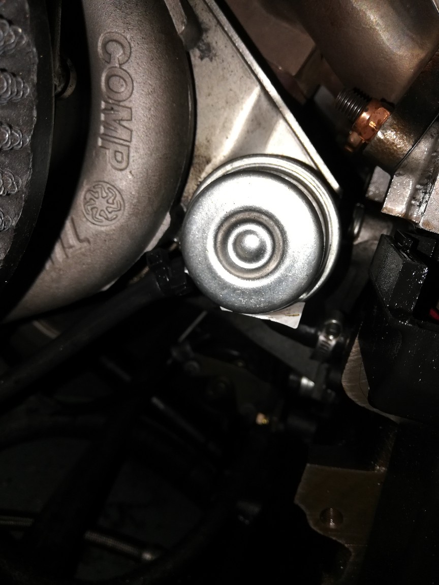

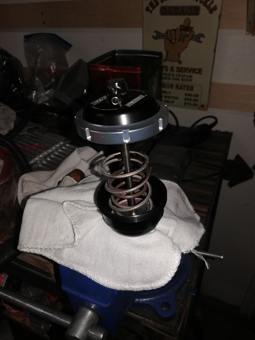

So whats next? I have a dual port internal wastegate actuator on order.
https://www.full-race.com/store/borg-warner...-port-actuator/
I'll put the small 7lb spring in it and then I can run the same 7psi but it will let me bump up the spring to what I want to do (30psi). I figured I could get into the 20's before the wastegate would let me go anymore but we were absolutely wrong.. sad.gif
At that point what will hold me back is the intake manifold and cams. You can see my power curve rolls over about 6600. Which for an engine built to run to 9k and running this large of a turbo is wasted potential. Cams would bump my power curve up but it would also extend it out considerably.
This explains why It fell on its face after 7k. I'll do this next year. This year will be focusing on driving and finishing the majority of the car. Next year we'll go for power.
Side note, If I put cams and an intake on it, we would be into the 500whp territory... blink.gif

QUOTE(Andyrew @ May 20 2019, 12:39 PM) *
Dynos
I personally like the 288/251 number myself. But that number will be surpassed in days to come. if it never does, it will still be a screamer..
76-914
Andyrew
QUOTE(dan10101 @ May 20 2019, 01:05 PM) *
Dynos
It was pulling some timing so we backed the timing off a hair. However Look at the dyno curve. the 282/258 had significantly more power under the curve. It has a more aggressive boost curve programed into it on the low end which is why... But it just wouldnt push more boost in the end.
Its ok. I've been told the tune is safe for 25psi on the street as it sits. Also its a hair rich so I can safely add a gallon of E85 on it and bump the octane significantly.
Side note on all the dyno runs. We didnt see intake air temps over 30deg C for the entire run. Which means the air hitting the cylinders after pressurization was only 85F.... If that doesnt push you turbo guys to air to water intercoolers I dont know what will...

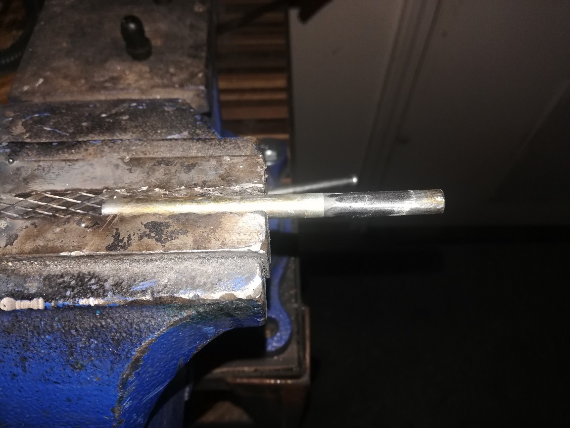

Andyrew

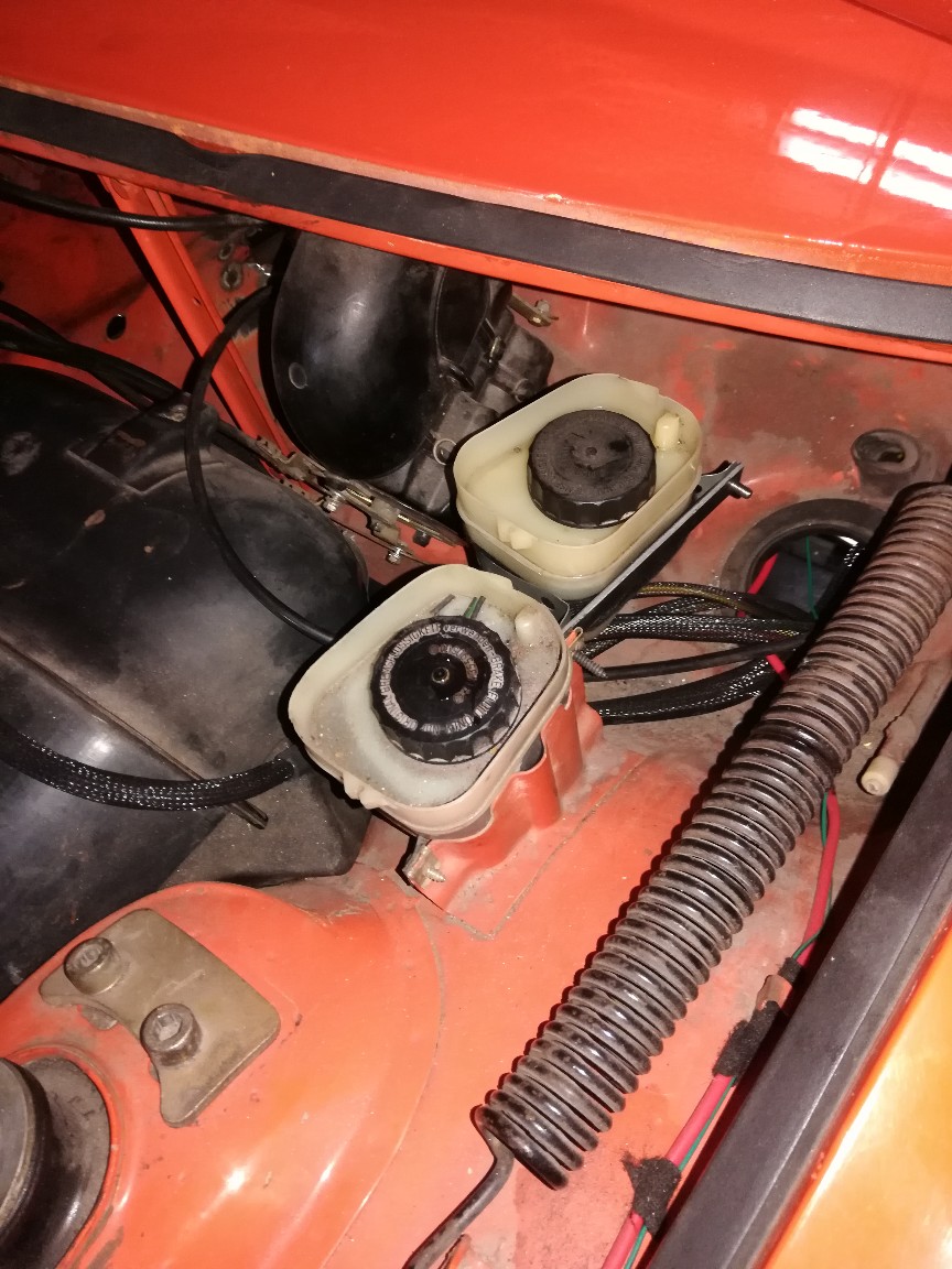

Tried the metal slave cyl. The quality on the unit looks great. But the damn bleed screw is metal on metal.... What idiot thought that would work? Won't hold pressure, bleed screw was cast so I cleaned up the castings and still no go. Damn thing needs a rubber seal. I might experiment with one sometime later but I have a spare plastic slave.
First things first was to try and get fluid to pull through the line... No luck. I'm going to need someone else to help me with this as this fkin thing is not working. I messaged a friend so hopefully tomorrow or Friday I'll have the clutch properly bled.
I can hear some air by the master so who knows.... the whole thing is not well layed out for a good bleeding. Really needs a power bleeder and not s vacuum bleeder.
If this doesn't work I suspect pressure plate needs alignment. If that doesn't work, new clutch/pp. If that doesn't work. Add more lever action to pedal assembly. If that doesn't work....... Pay someone smarter?
Ugh.

QUOTE(Andyrew @ May 22 2019, 11:39 PM) *
Send me a pict of your slave, I have a spare, it's a pull type.
I'll bring my Mityvac pressure bleeder down JIC. I just need to see your reservoir cap.

Its tiny. Think motorcycle. Like 1.5" I was thinking I would get a spare cap, drill a hole in it and put a nipple on it so I can pressurize it.
https://www.ebay.com/itm/For-Audi-Porsche-B...7M/152549321531

Wastegate came in. I took out a spring so it's 7psi now. It's a bit bigger so fitting it will be difficult. We'll have to work on that after WCR. Too bad, I was hoping to pump it up to 400whp when my dad came down so we could have some nice roll racing.

Back to actual progress... I started working on the center console. Biggest problem is I have all the wiring in the car and the new seats all mounted. So I needed to be very careful when handling the steel and any welding. But I got the center cage done. Dimensions based on my steel pieces. I also trimmed them a bit to fit, but more trimming will be necessary when I add carpet and such.. I'll have to redesign the top pieces or at least the back and I'm still figuring out the seam between the two as I'm debating on black sides and brown accent top. Still up in the air.

More progress on the center console... My friend to help me bleed the clutch and my tuner we're a no show. Probably do family things tomorrow and Monday but we'll see. I really need to get the clutch dialed in by Tuesday or know if I need a replacement.
Finished the mounting of the center console base then trimmed the sides to fit.
Then I worked on the top portion and got it squared away and fitting decent.
This was most of my day. Not a lot but the rear section is done as far as the sheet metal is concerned. I will probably drive it to WCR this way.
Frony/middle section with the shifter is difficult due to the curve in the top/base. After a couple tries I got the piece bent that I have and it looks good. I did the lower easy mounts but need to work on the upper mounts. Then I'll need the other side from Chris as well as to do the top portion.

Got home and couldn't resist myself I wanted to see where we were with fitment of the panel.
I knew this one would take some more work... We'll like the other one I needed to bend it and since I don't have nice press brakes I make do smile.gif
Couple go around to get this one right. But happy with it. I need to work on mounting it and the other side. But I pulled them together loosly and checked out the top.
Some measurements and I'll need to make a new piece for the top I think. I'll cut out the shifter hole and see what I think. I also need to figure out how to mount this one. Outside the box thinking might be necessary.

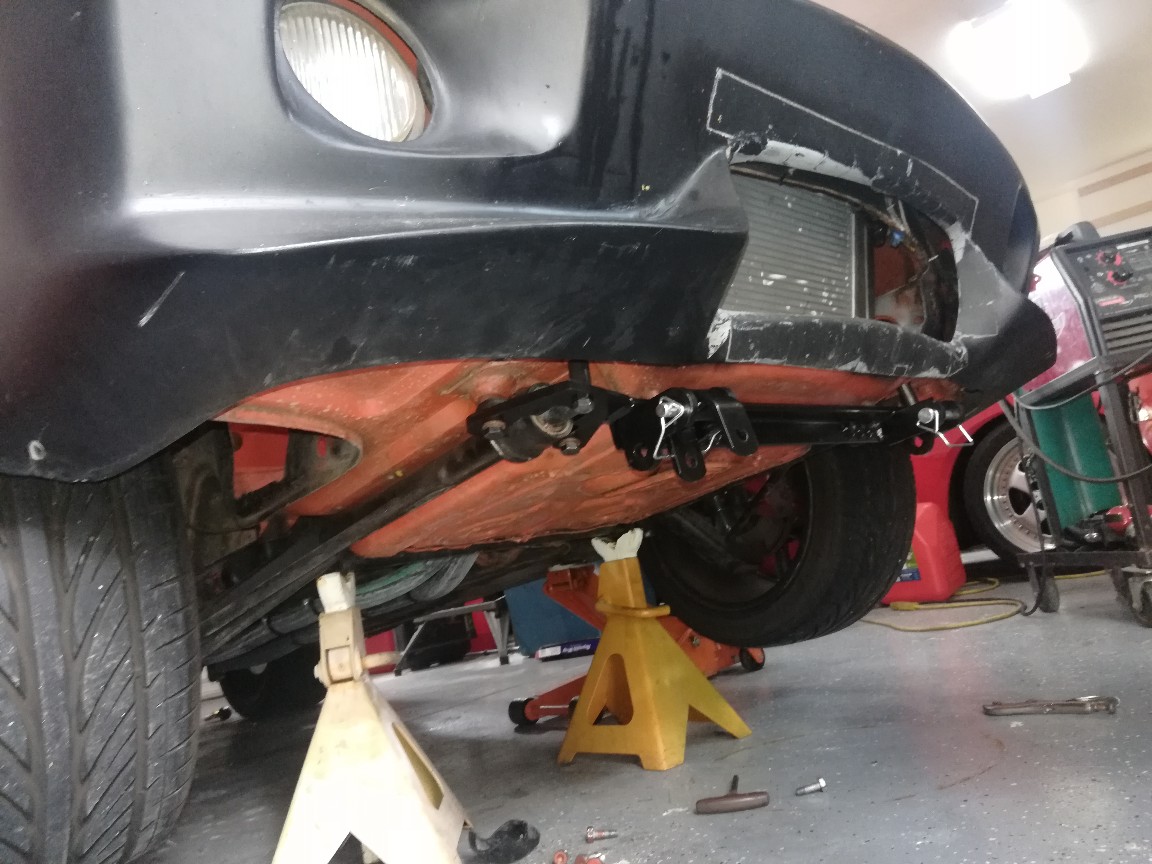

Received my tow bar from @914werks. Nice looking product! Very heavy duty.
Not designed for a 916 bumper so I'll just trim my bumper to fit as its probably going to be changed at some point.
Mounting of the actual pieces. Some shims needed to be made to fit it right. But 4 bolts holding each piece firm.

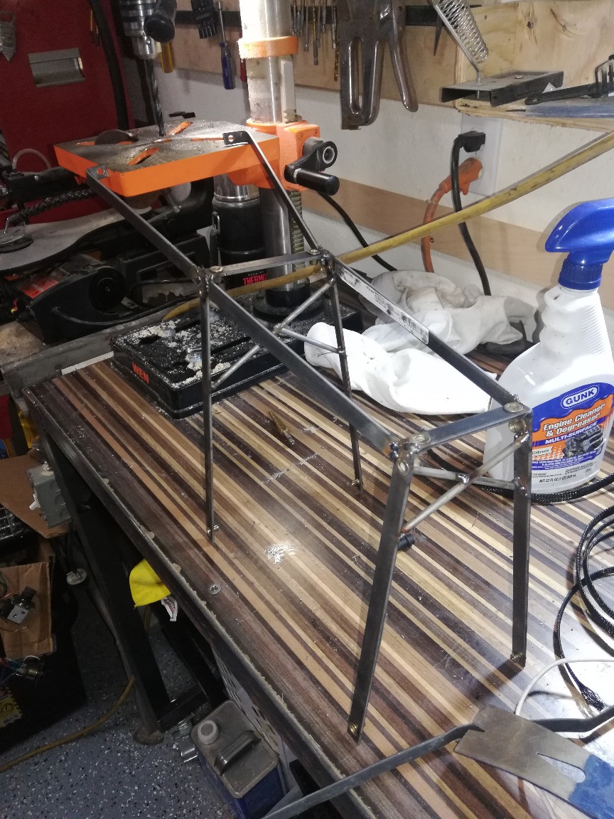

Construction paper to the rescue for the new shifter plate.
And new shifter plate in place, not mounted.
I've determined im going to build a removable upper cage to hold the plate in place, Should be pretty simple to build, probably a couple hours.

Dad and I redid the clutch reservoir and used a spare of his mounted next to the brake. This gave us an easier bleed and we could pressurize it with his system. Not that it helped. It was still a very difficult bleed.
We're going to try bleeding it again. Still difficult to get into first. But it does shift.

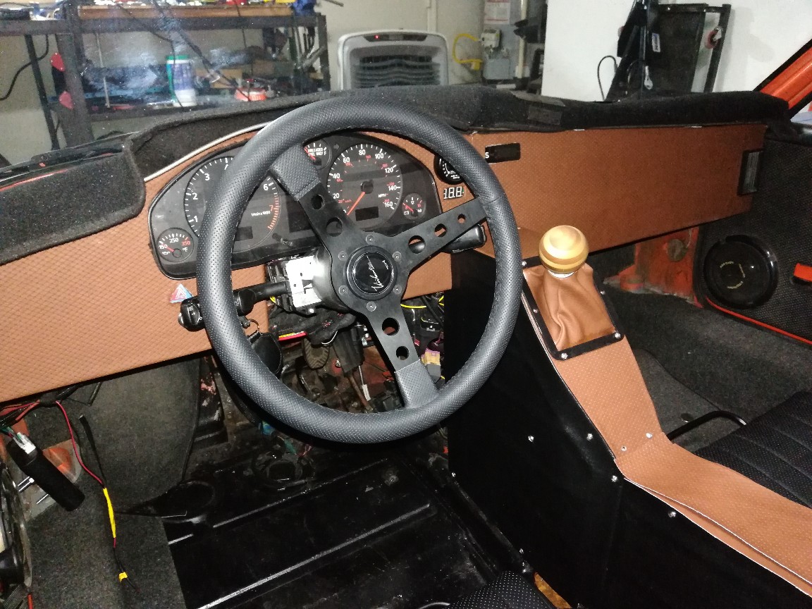

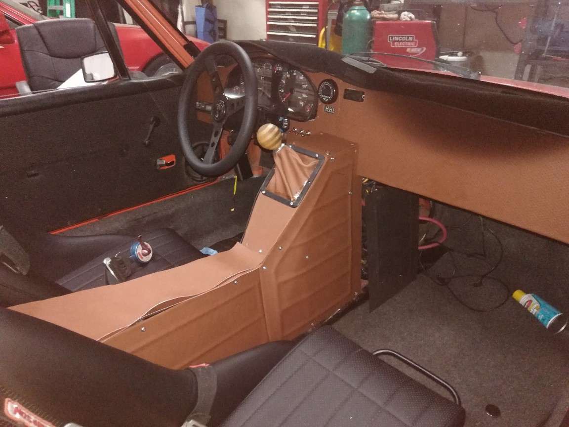

Spent a lot of time on the center console. You can see the shifter solution I made. Really happy with it.
And the big question is black or brown
I'm leaning towards brown. But not sure. I'll powder coat the screws whatever color I need them. Shifter trim will stay black for contrast and the foam arm rest needs to be done still.

tygaboy
Andrew - Looking good! Also good to hear you're making progress on the drive-ability items.
On the console, it's totally a personal taste thing but the brown will likely make the beading detail more noticeable, which I happen to like!
Hi to your dad for me.
Cairo94507
I like the idea of the contrast with the brown. If you cover the console in black it might get kind of lost in all the black. It's nice piece and the brown will look nice. Love the seats BTW. beerchug.gif

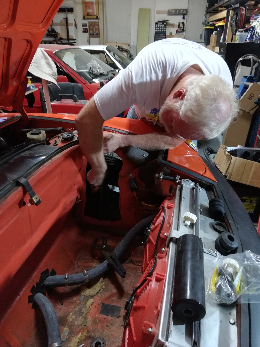

Yesterday my dad worked and prepped the fabric for the dash, removed the dash, and put carpet on the car. Today we put the vinyl on the dash with the basketweve pattern. There is a seam in the middle but I'll figure something for that.
We also worked and tested the tow system. Lots of work to make it better needed. Not the happiest with how clunky flat towing is and we're working on streamlining it.
We also added a trans cooler to the Honda so it shouldn't have any issues pulling up the hill.

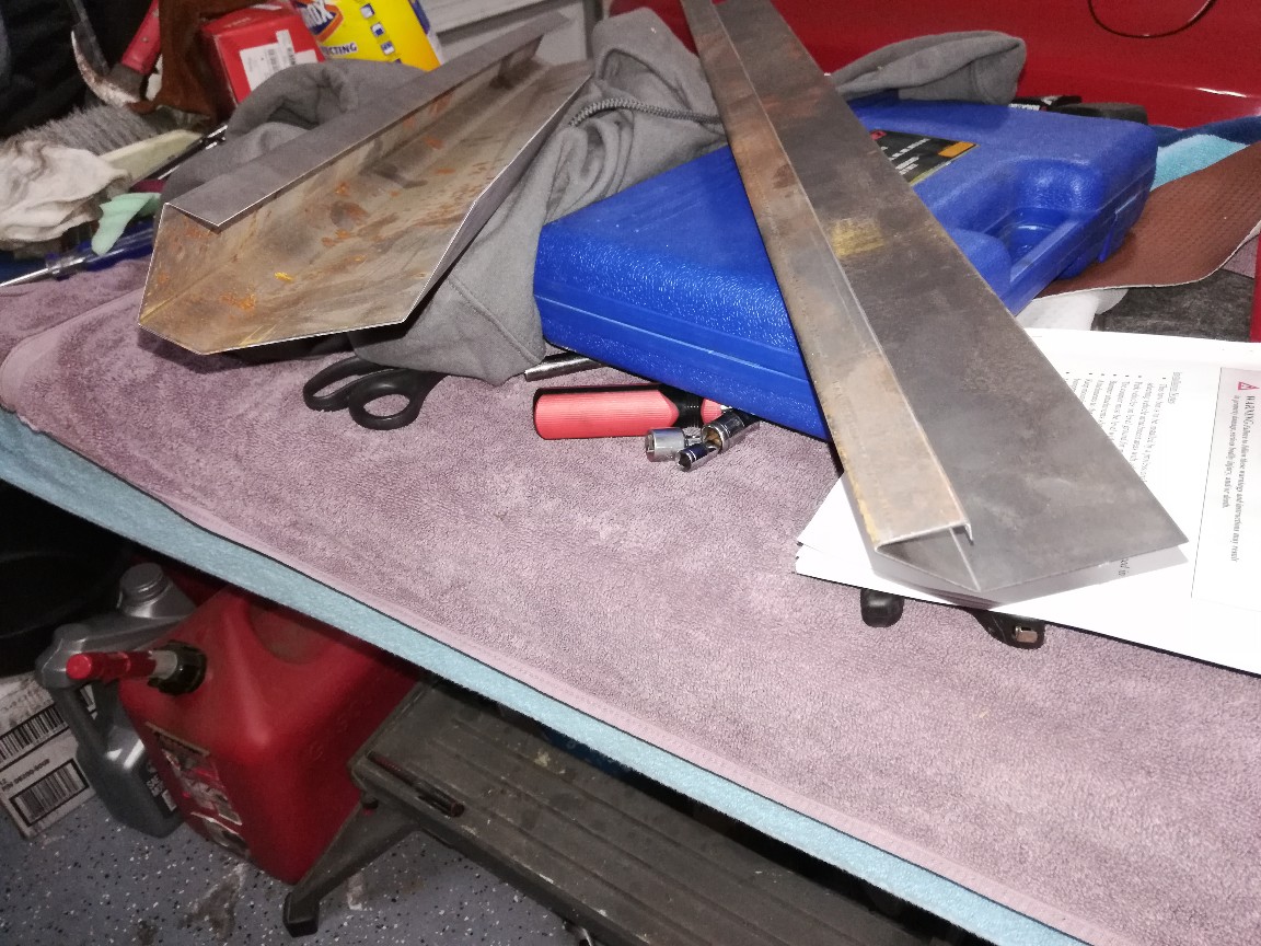

10 internet points if you can figure out what the metal pieces are for.
tygaboy
Andyrew
