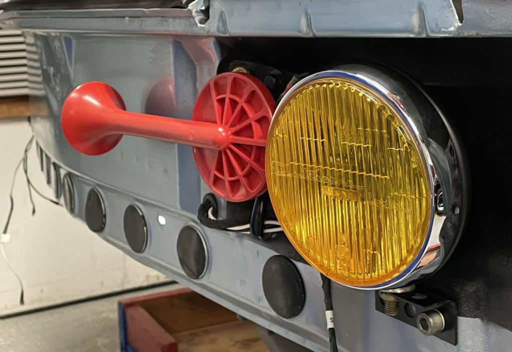

QUOTE(Dion @ Oct 30 2021, 04:30 PM) *
Fogs & horn:
Where did you get that horn from? biggrin.gif What type of mods did you need to do to mount it??
Dion
QUOTE(pete-stevers @ Feb 25 2022, 11:53 PM) *
Fogs & horn:
@pete-stevers I made a small bracket that went into the original horn mount. I purchased that particular horn from a fellow in Sweden. The GT cars ran them. I wanted a piece of the action smile.gif it’s loud.

In addition to the bumper mounted trumpet ( say that 3 times fast), horn. I believe you can’t have too many horns in a small car. So… I added some Italian trumpets under the bonnet. Loud as hell. Plenty of decibels when the lid is shut.
autopro
QUOTE(Dion @ May 14 2022, 11:23 AM) *
