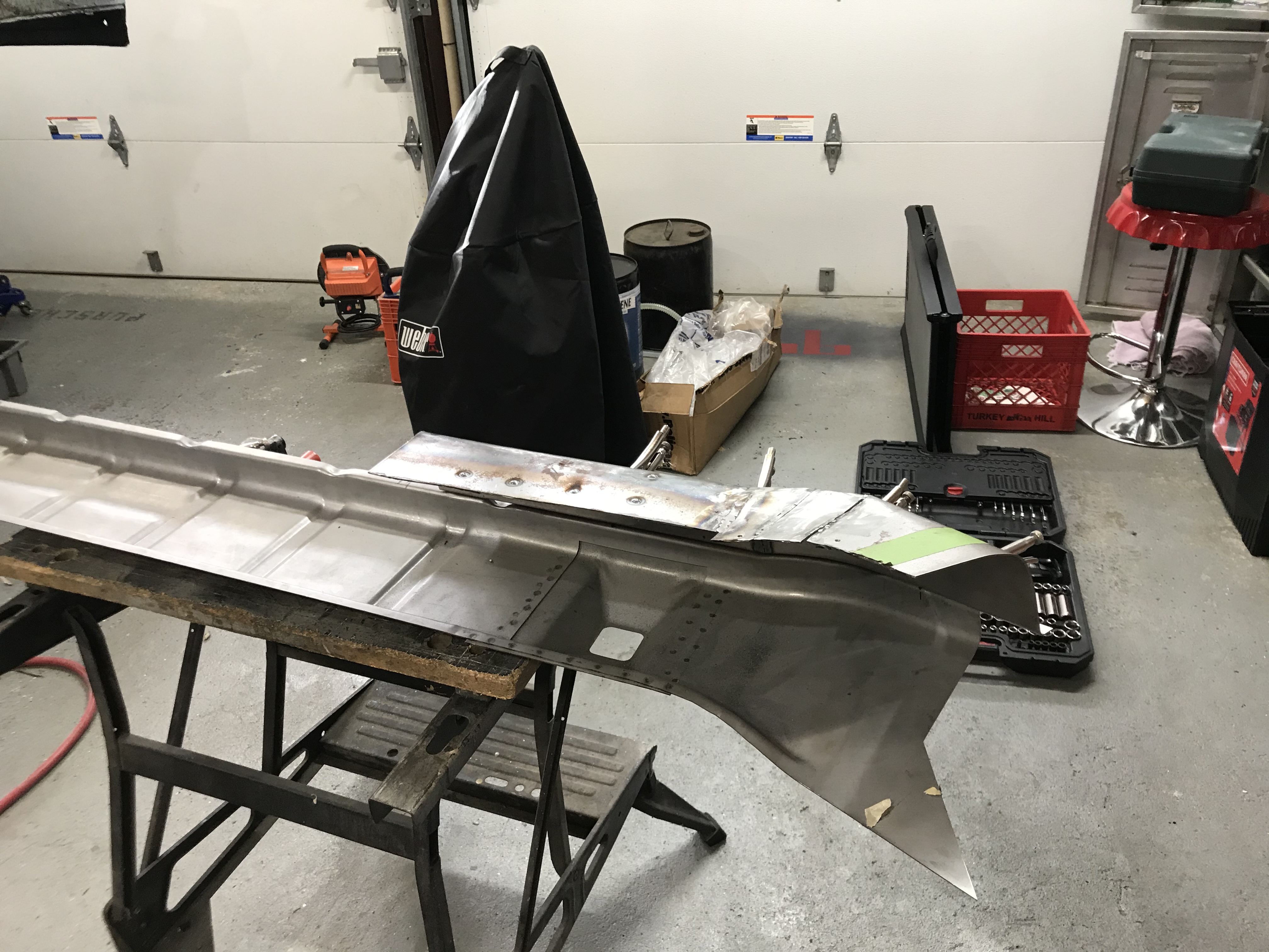

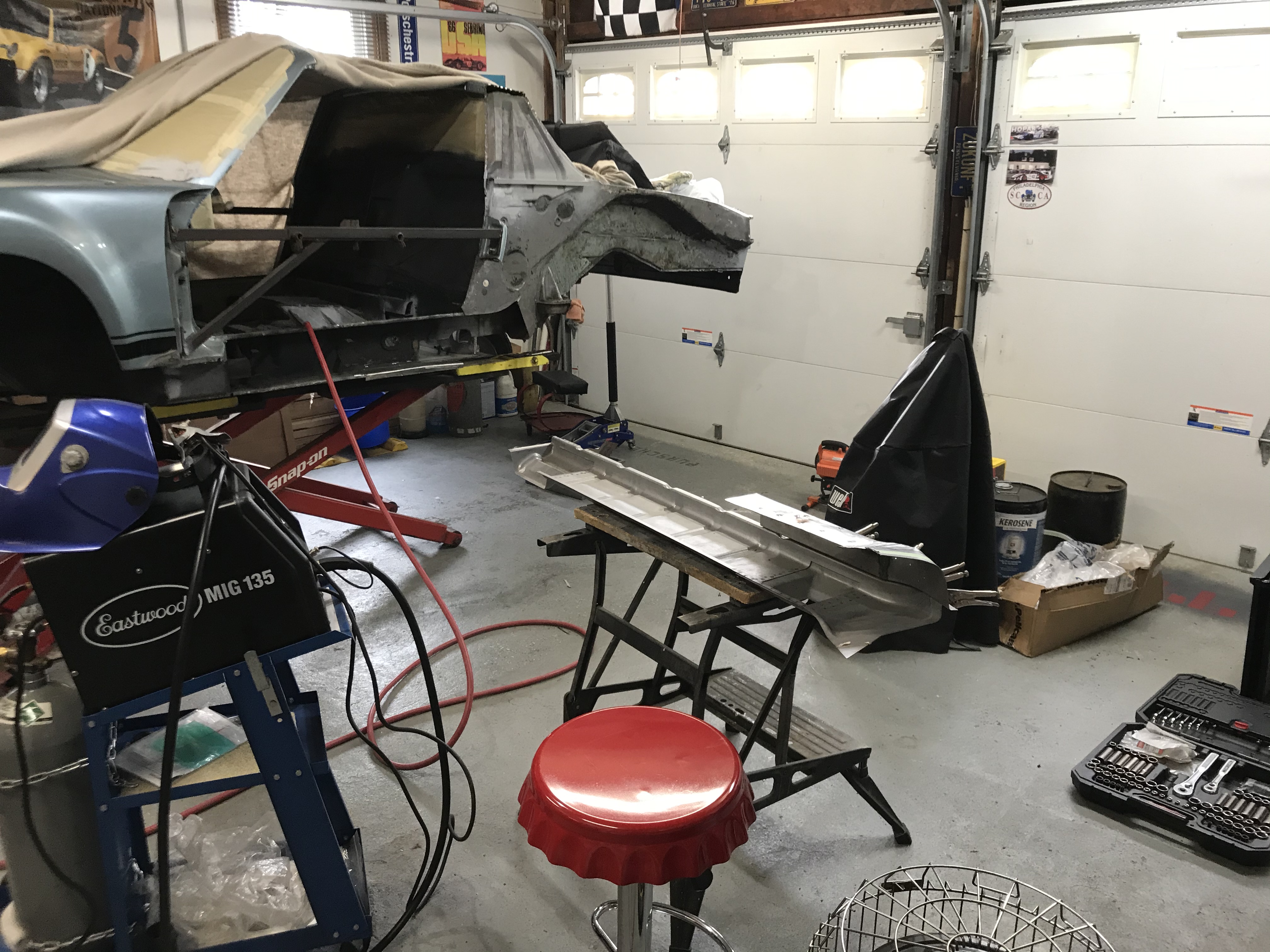

Managed to tackle some chassis work. My bud Dave came by the other day and helped out on the difficult task. When he removed the formed chassis piece from the buck/form
found out real quick on of my welds wasn’t up to the task. Cracked immediately after
due to stresses of the flex. So I cut another straight edge pie cut in that area to be re welded.
Dion
While Dave set up my welders setting found out that maybe one of the reasons the weld didn’t hold (newbie mistakes) the gas flow wasn’t sufficient.
He took to the task of welding up the crack. I went ahead and trimmed up some more of the long to help orient the new piece.
Dion
Trimmed out
Dion
Cut
Dion
Mock up of two pieces together that will form the new “long” kick up.
Dion
Joined temporarily
Dion
Will need more trimming. Getting there.
Progress is progress. Not the most glamorous. More metal needs to be added to this piece. Goal to make sure there will be NO FLEX here. More to come....
