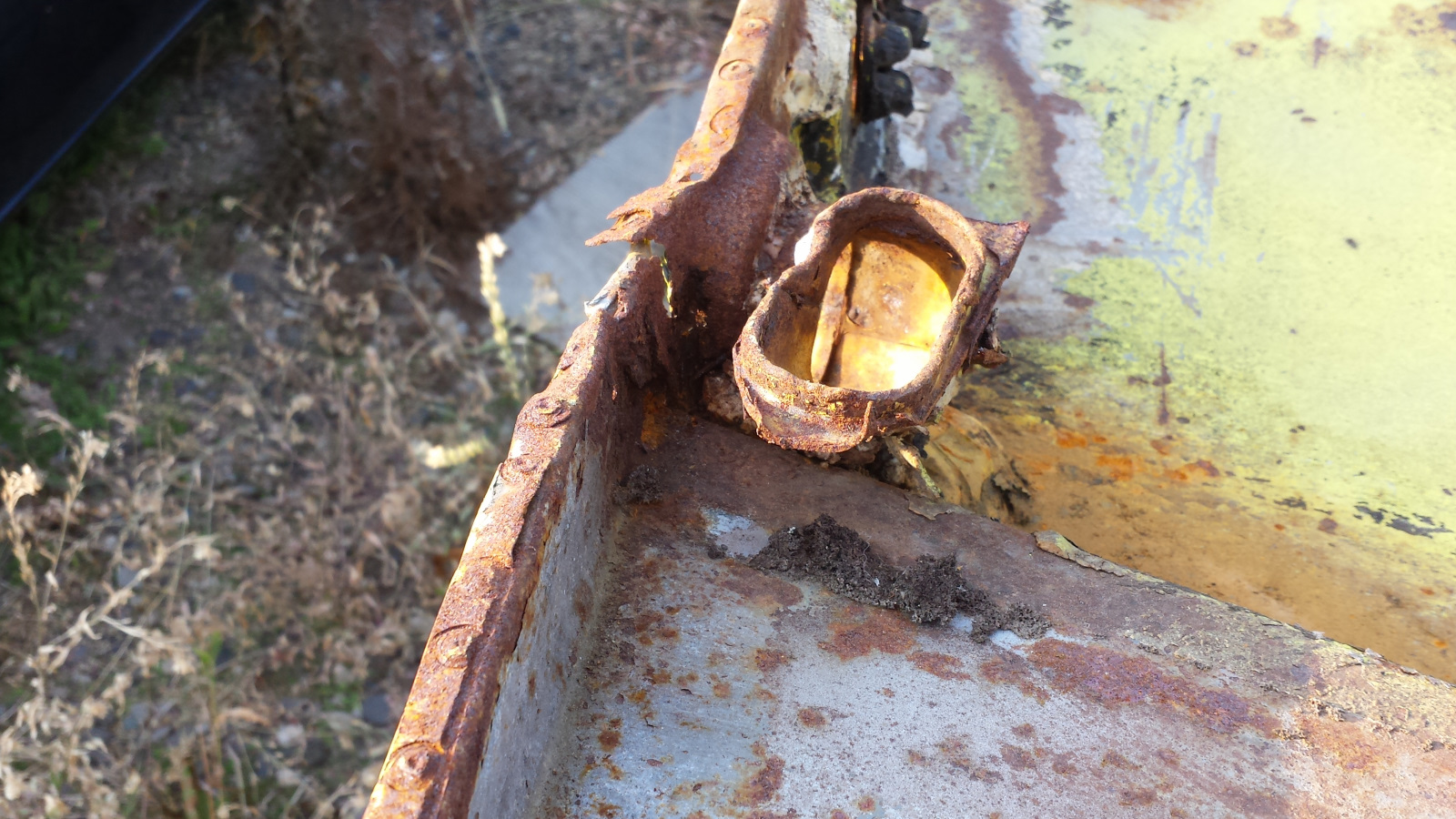

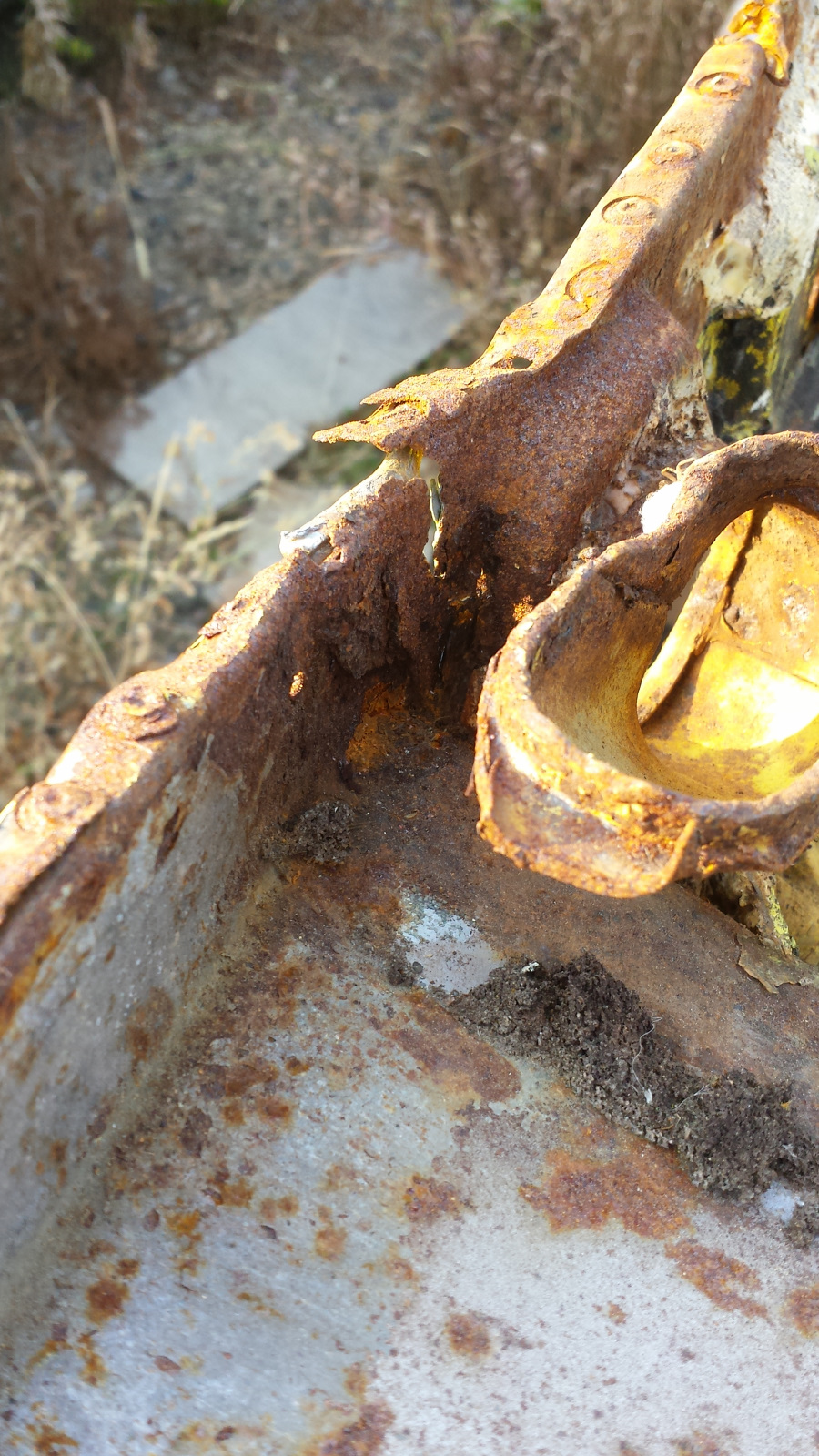

Dion
Ugly metal:

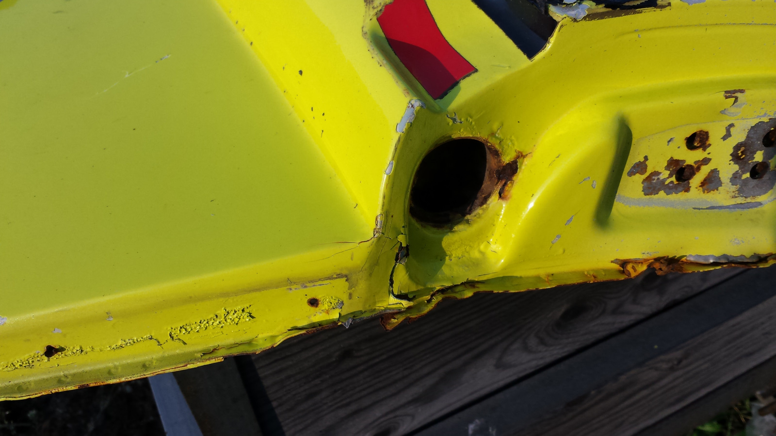

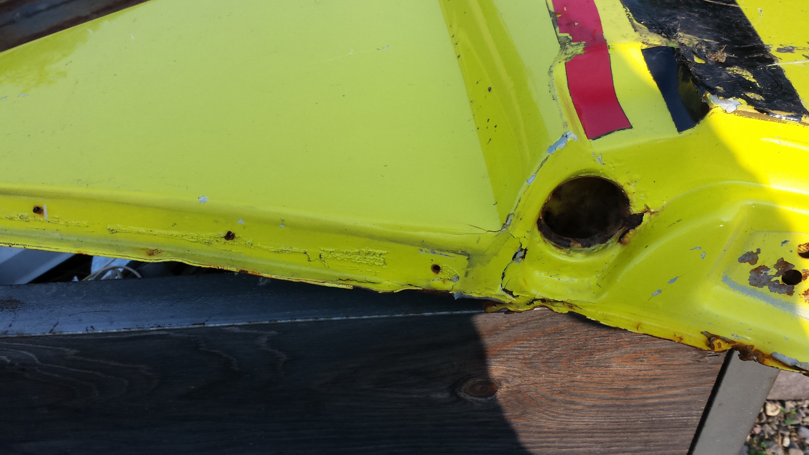

Dion
Sail panel damage
Dion
Panel
Dion
If any one has a compromised panel but not in the area I need to repair
would gladly like to have it so I could make a patch.
Let me know what ya have...thanks for checking in.
bbrock
QUOTE(Dion @ Aug 2 2018, 07:29 PM) *
Let me check the scrap pile in the morning. I had a pair of extra sail panels that were too far gone to use to replace mine, but I don't remember where they were damaged. We might get lucky.

bbrock
Pulled it out of the scrap pile. It's a bit crusty under vent tube but looks like it might clean up and cover the area you need to patch. If you think it has promise, I can hit it with the media blaster this evening and send more pics. If you decide you want it, pm me with your address and how much you want cut off and it's yours.
Dion
Brent that should do the trick. Will save me trying to duplicate that contour. Thanks buddy!
