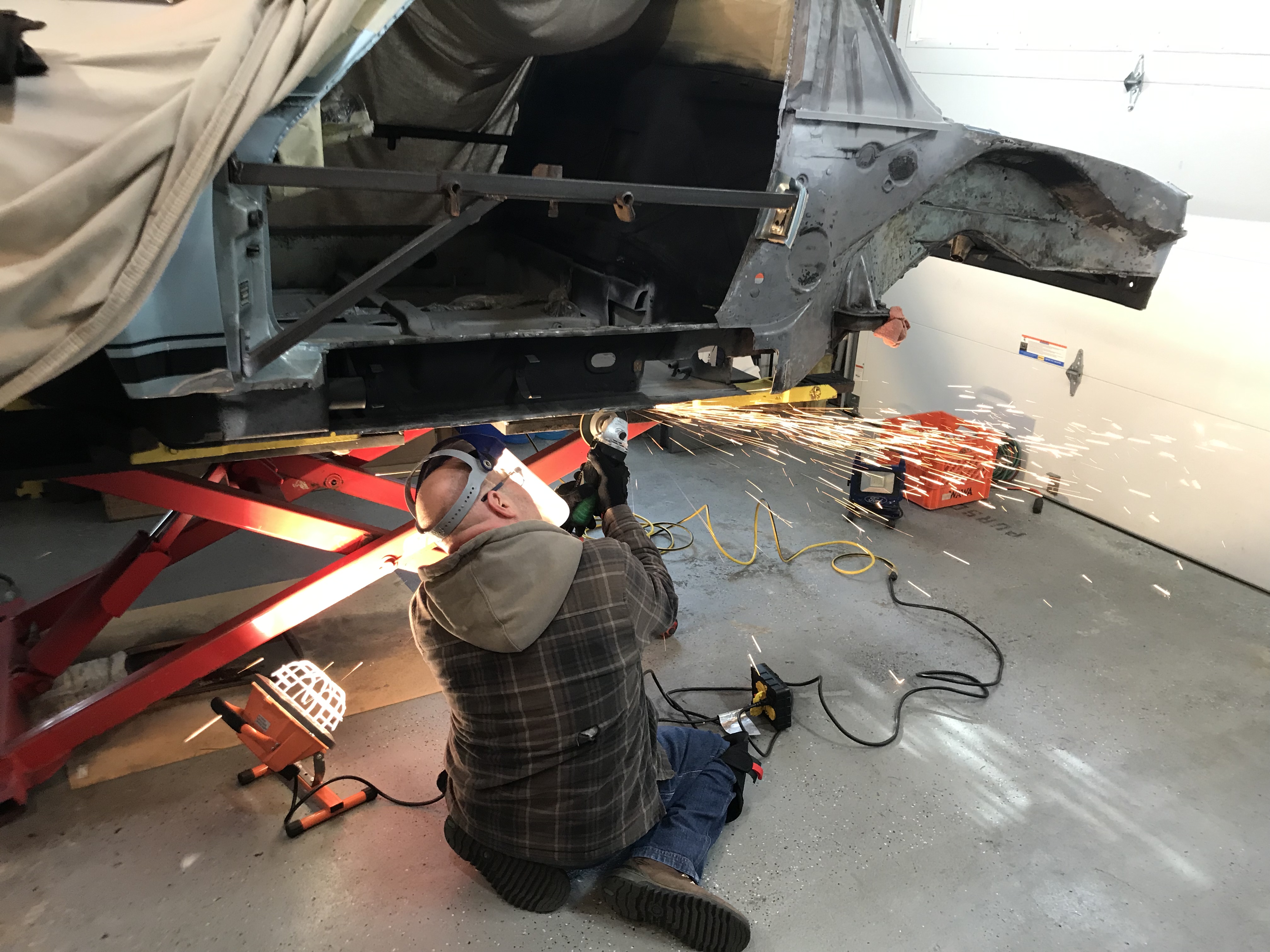

914dave
Dion hard at work removing a sketchy patch. Click to view attachment
