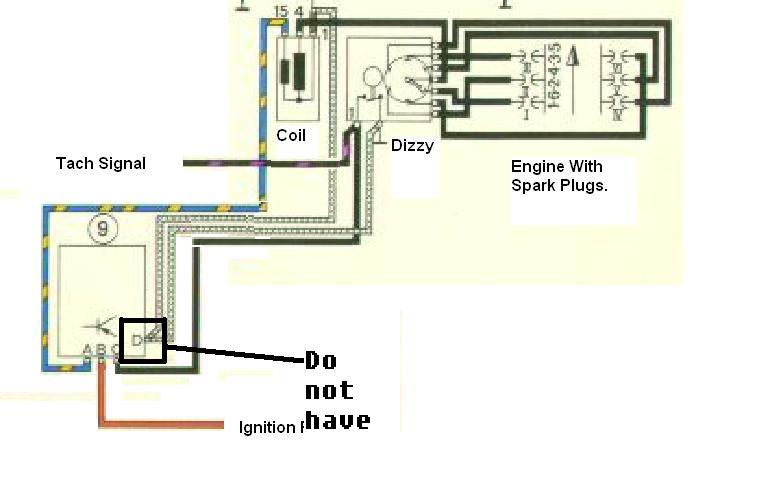

This may help with the ignition wiring.
IPB Image
I put this diagram together years ago, and lost the original. I found this searching the board. The drawing was modified by the person reposting it.
Here's the original thread on it.
http://www.914world.com/bbs2/index.php?sho...p;p=749463&
Hope that helps!
Clay

@ClayPerrine Clay thanks for that. You sent me one similar earlier. I’m going to read that link very well. Appreciate it! I’m pretty sure I have the basic layout correct. Just need to verify and double check the Tach feed.
Thanks again.
