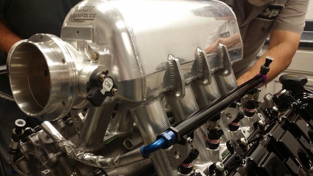

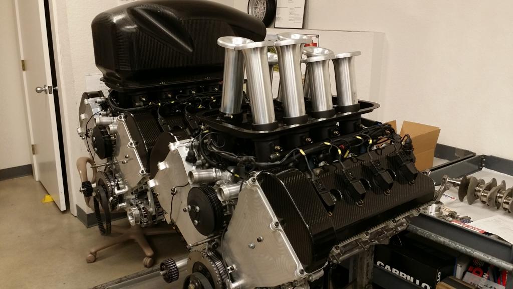

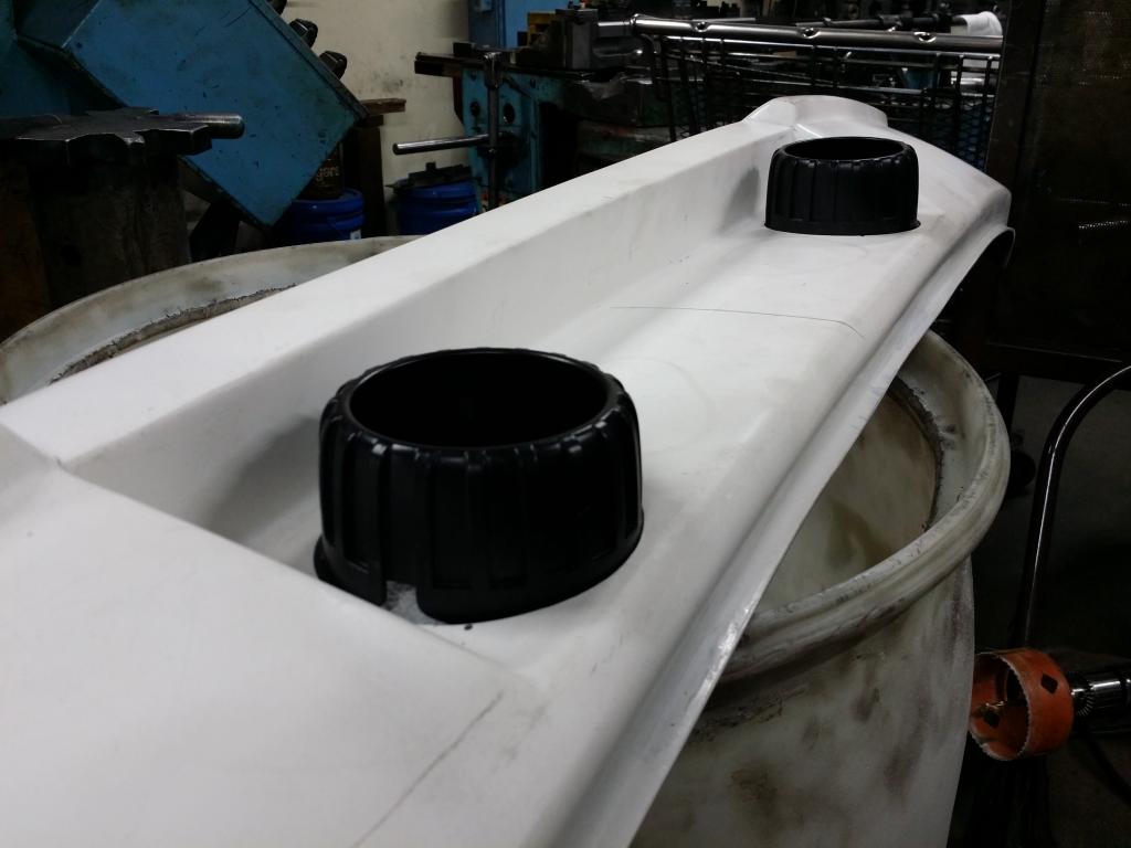

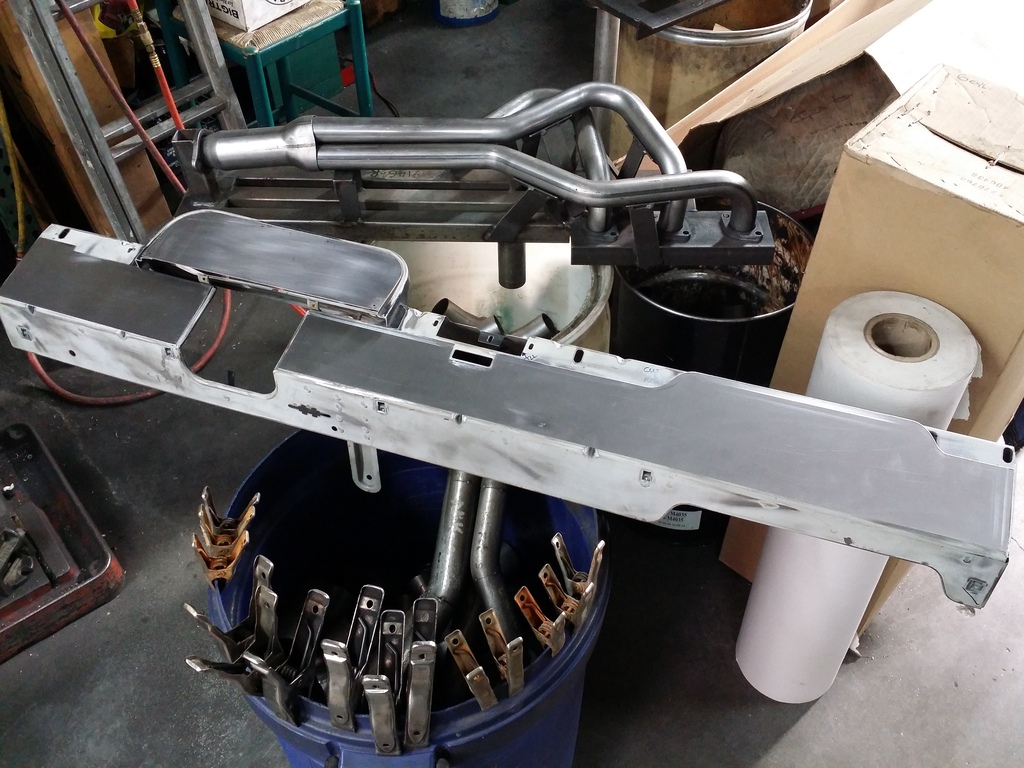

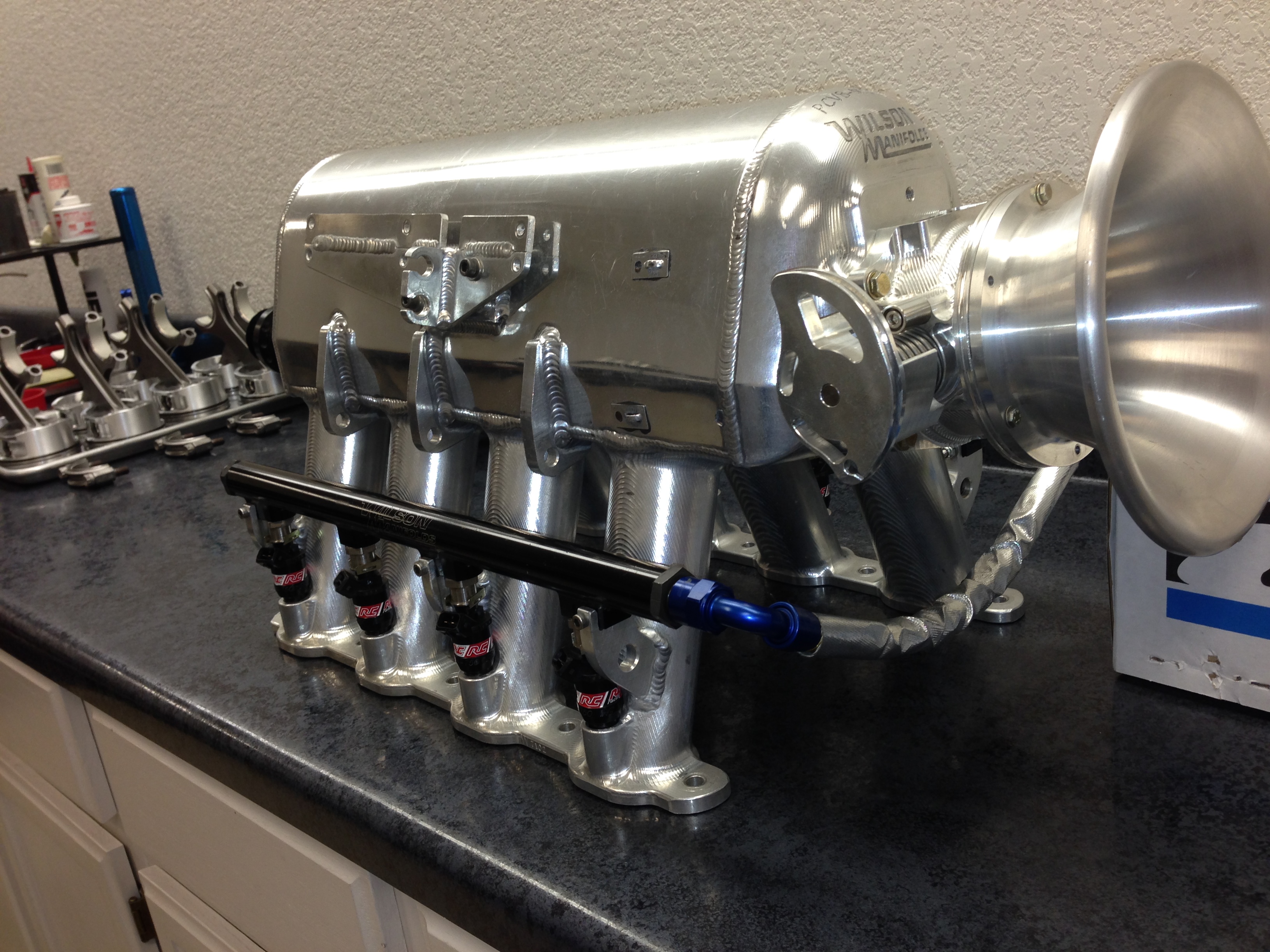

Intake now finished up with RC injectors, rails, throttle body, tps. Aka the "Flying Mailbox" !
The Daytona velocity stack will not be used in our forced induction engine.Click to view attachment

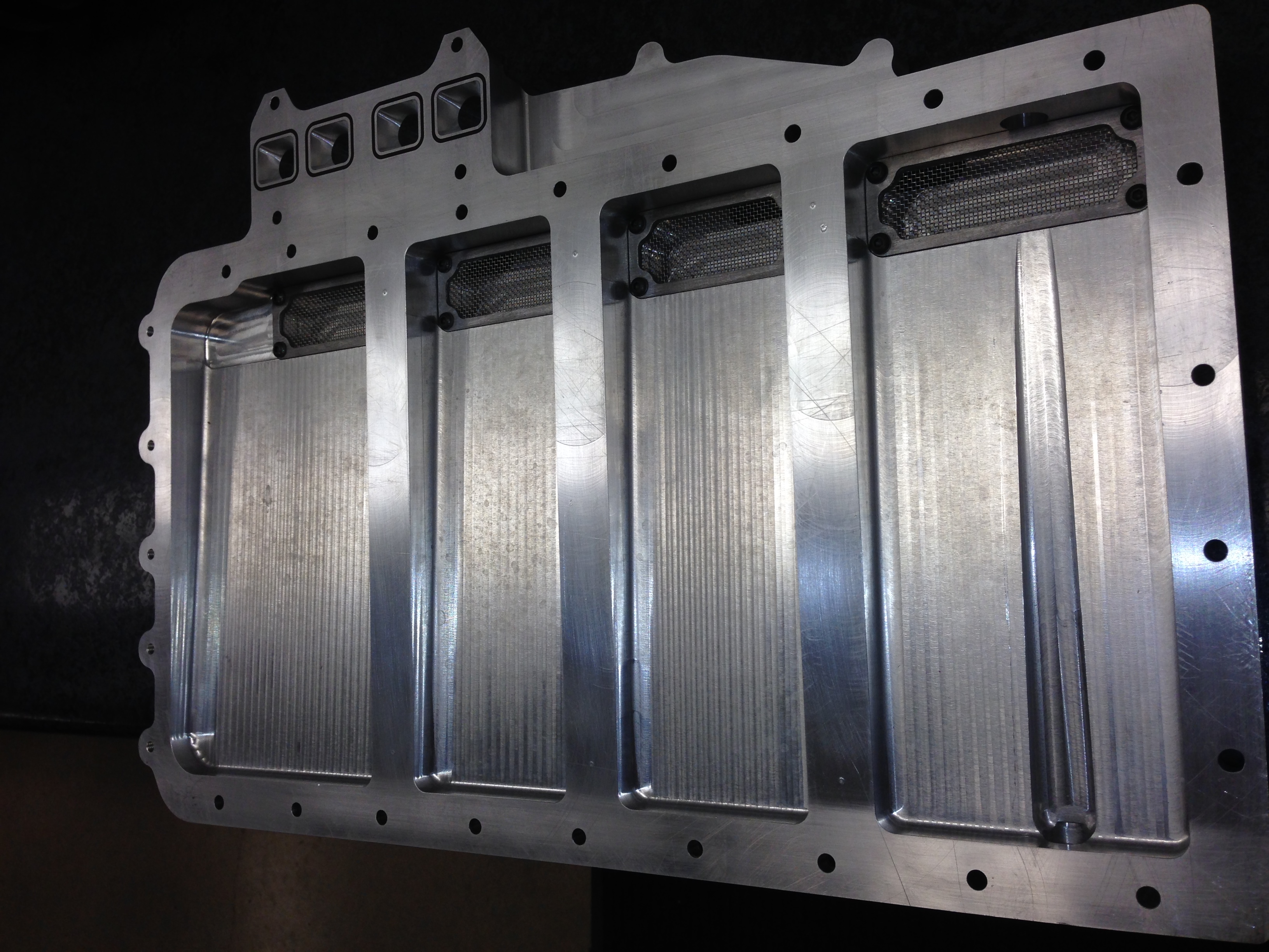

Maltese Falcon
Windage screens installed in the cnc dry sump oil pan...Click to view attachment
Mike Bellis
QUOTE(Maltese Falcon @ Apr 26 2014, 01:06 AM) *

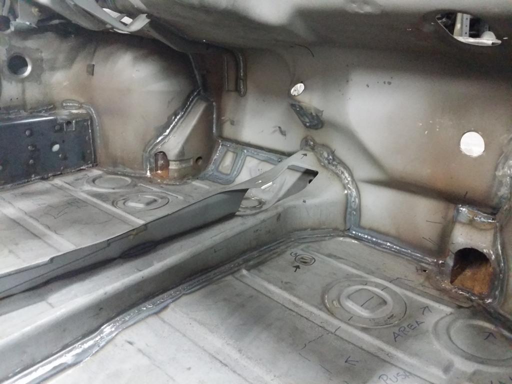

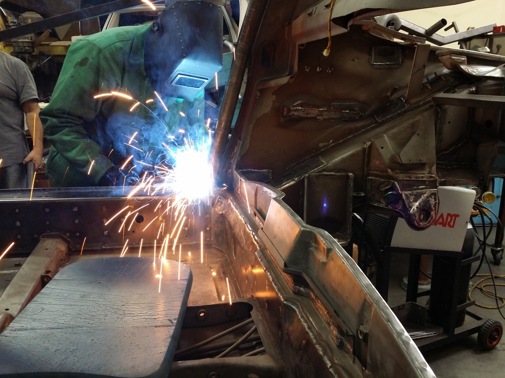

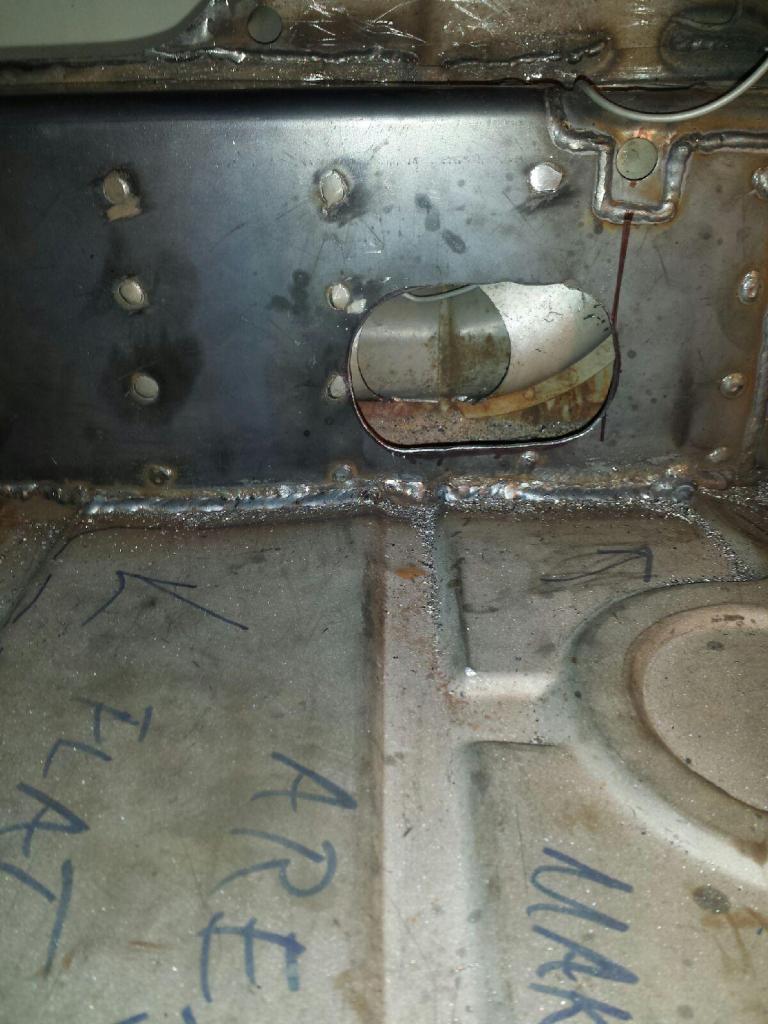

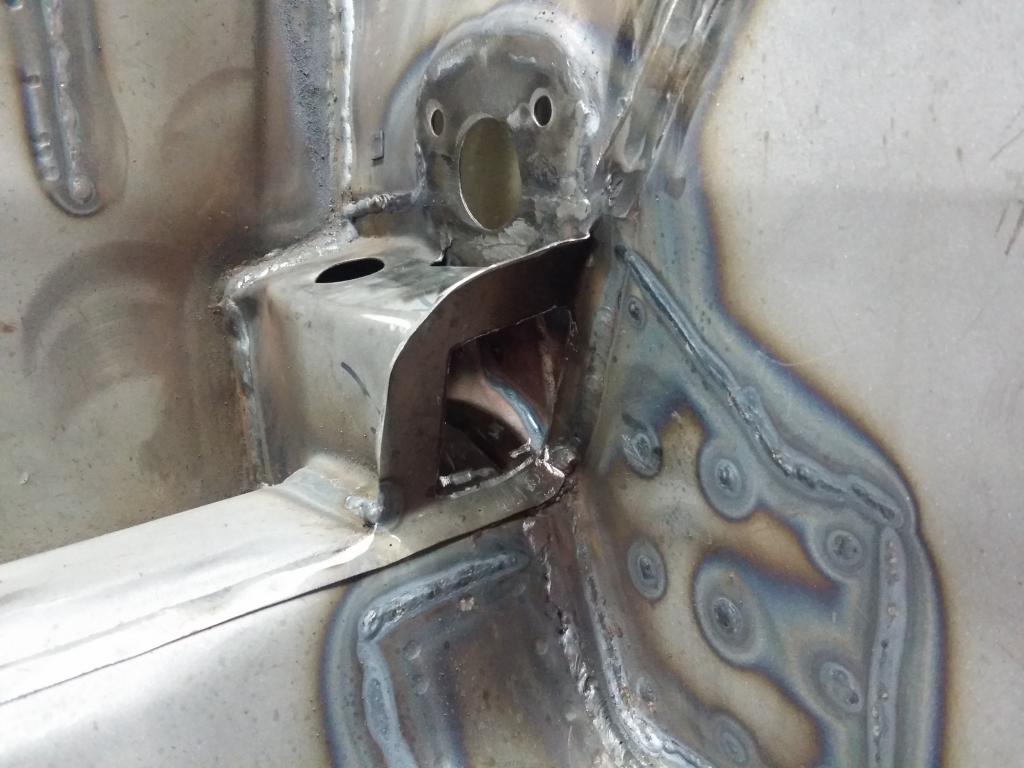

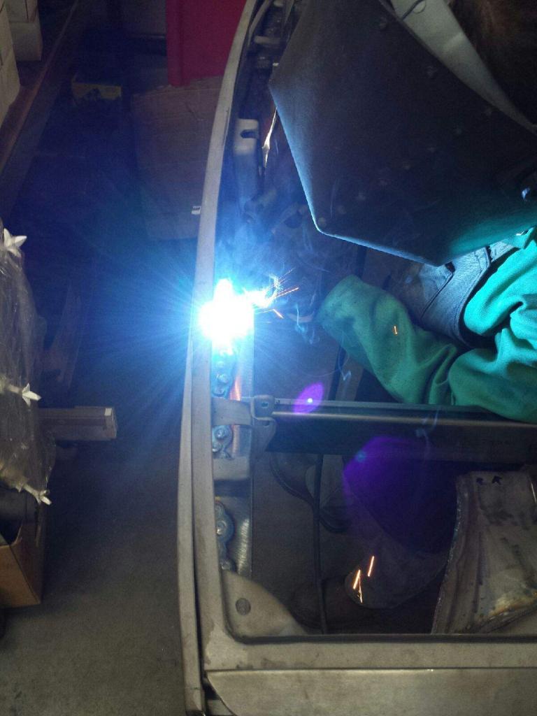

Seam welding every part of the car:
IPB Image
IPB Image
As you can see in the background in the car, every seam has been welded:
IPB Image

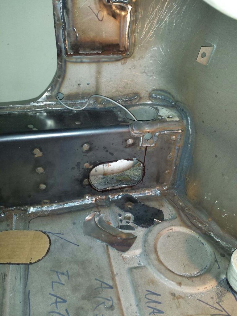

Finally, after several weeks of welding, all the seams are now fully welded:
IPB Image
IPB Image

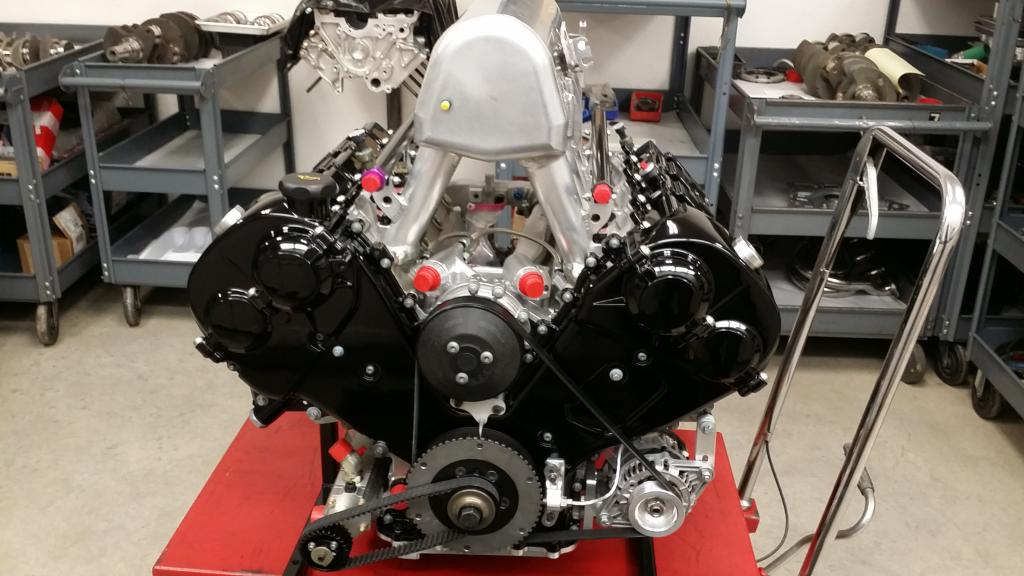

AND THE GRAND FINALLY!! WHAT YOU'VE ALL BEEN WAITING FOR... (well at least 14 months for me):

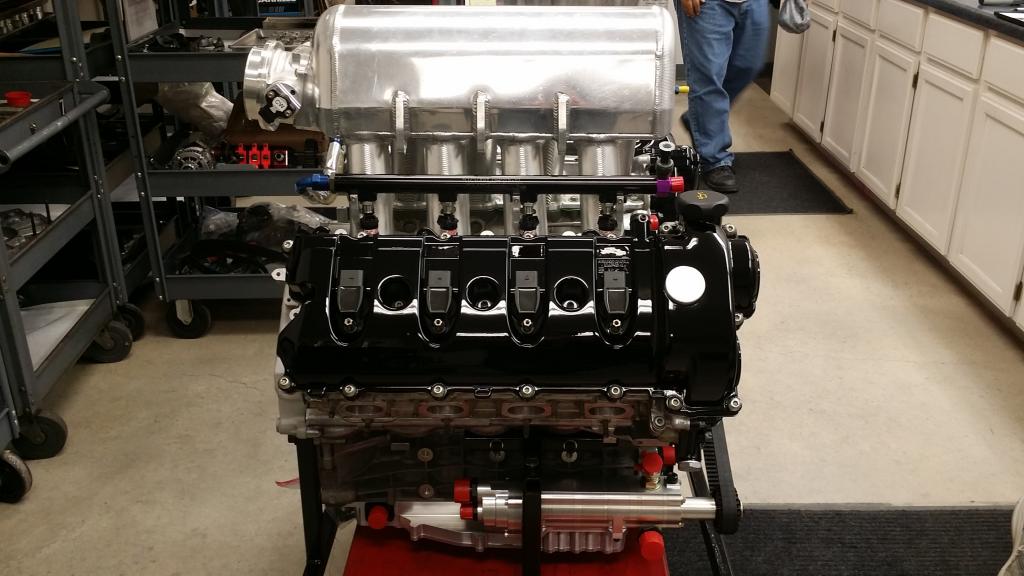

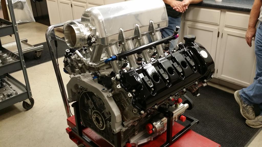

The engine in its completion!
Quick specs:
2005 Cayenne Twin Turbo motor, bored out from 4.5 to 5.0 Litre.
All new / upgraded everything internally.
Wilson Intake Manifold (yes the same intake manifold used on the 2010 Winning 24 Hour of Daytona, Prototype Cayenne V8 N/A powered car!)
IPB Image
IPB Image
IPB Image

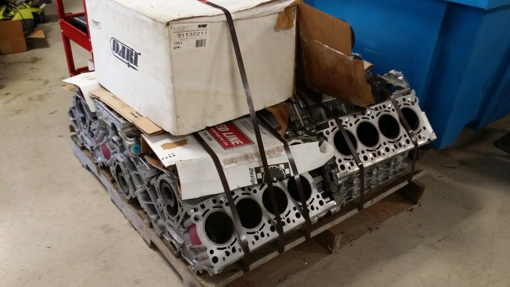

While we were there, we were treated to some of their other projects that were around their place of business.
2 ready to race Cayenne V8 N/A Daytona Spec Engines:
IPB Image
Used Cayenne V8 Engine Blocks:
IPB Image
IPB Image
IPB Image

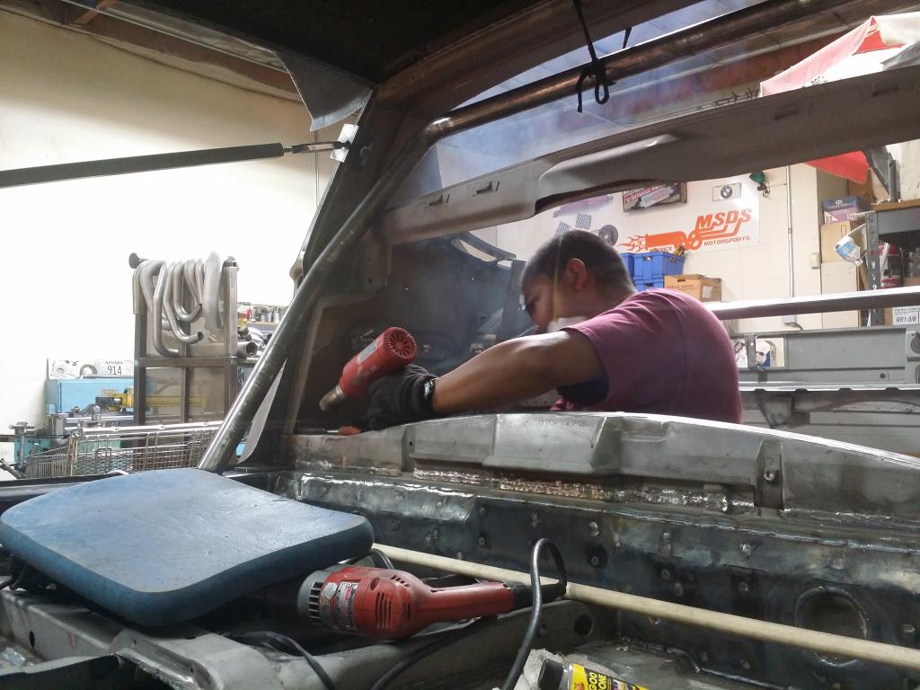

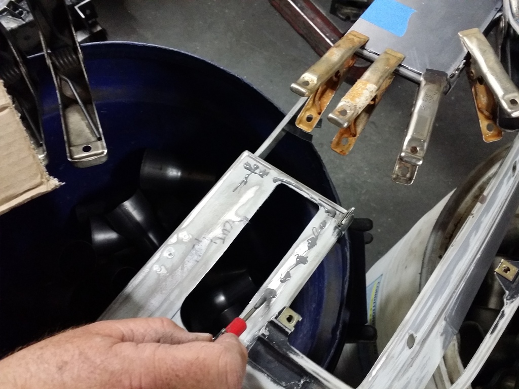

After leaving Texas, it was time to get back to work. Here we cut out some of the metal in the body to feed the radiator lines through the front into the inner longs and out the rear into the engine compartment.
IPB Image
IPB Image
Removing all of the caulking in the vehicle. At least 8 – 10lbs of caulking removed in total.

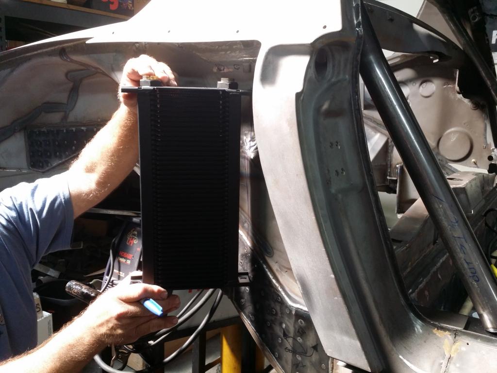

Oil Cooler mock – up: There will be 2, one on each side.
IPB Image
IPB Image

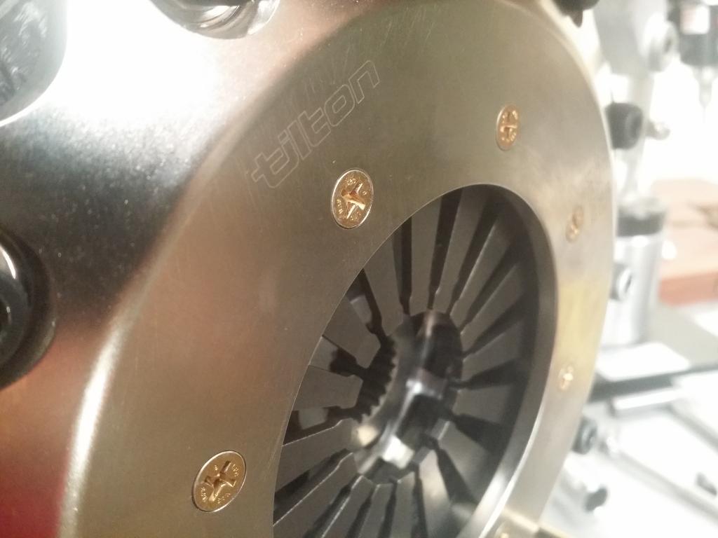

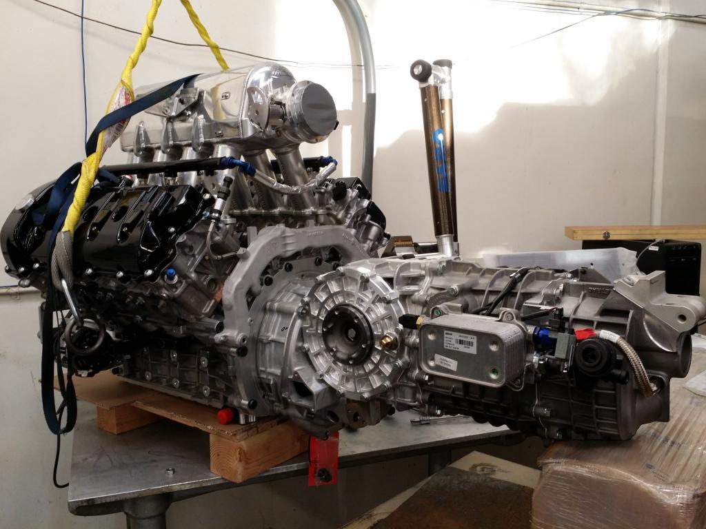

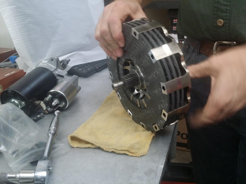

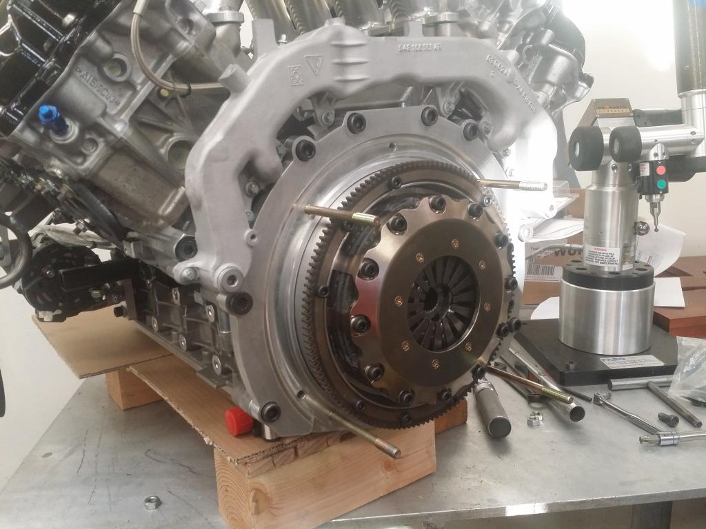

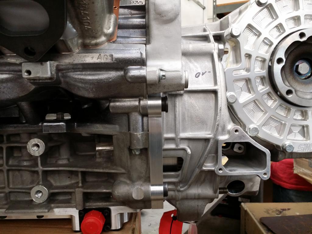

Once the engine arrived back at our headquarters in California, we immediately shipped it to our long time associates over at AASCO Motorsports for the necessary mating hardware.
Tilton Triple Carbon / Carbon Clutch:
IPB Image
IPB Image
IPB Image

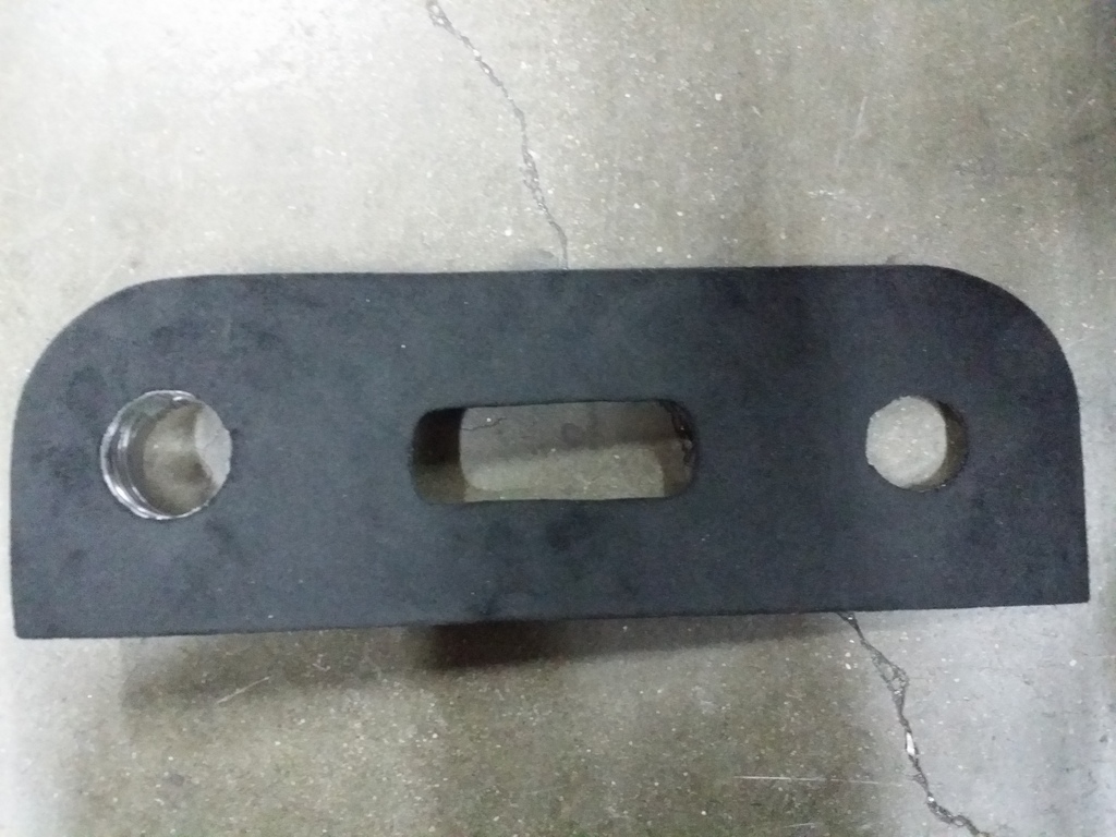

And the mating plate itself:
IPB Image
Just over an inch in width:
IPB Image
And Voila! A World’s first. Cayenne V8 TT mated to an inverted 996 GT2 Transaxle. A moment we’ve waited for, for so long, that we stayed way after closing time for the guys at AASCO. Sorry Vince, hope you can understand!
IPB Image

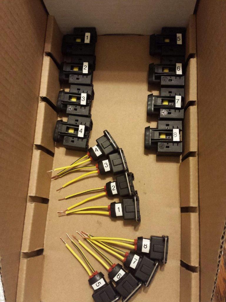

And a quick glimpse of the wiring progress so far. Who would've thought Mercedes Benz made parts for Porsche? Well, it wouldn't be the first time..
IPB Image
Many more pictures to follow!

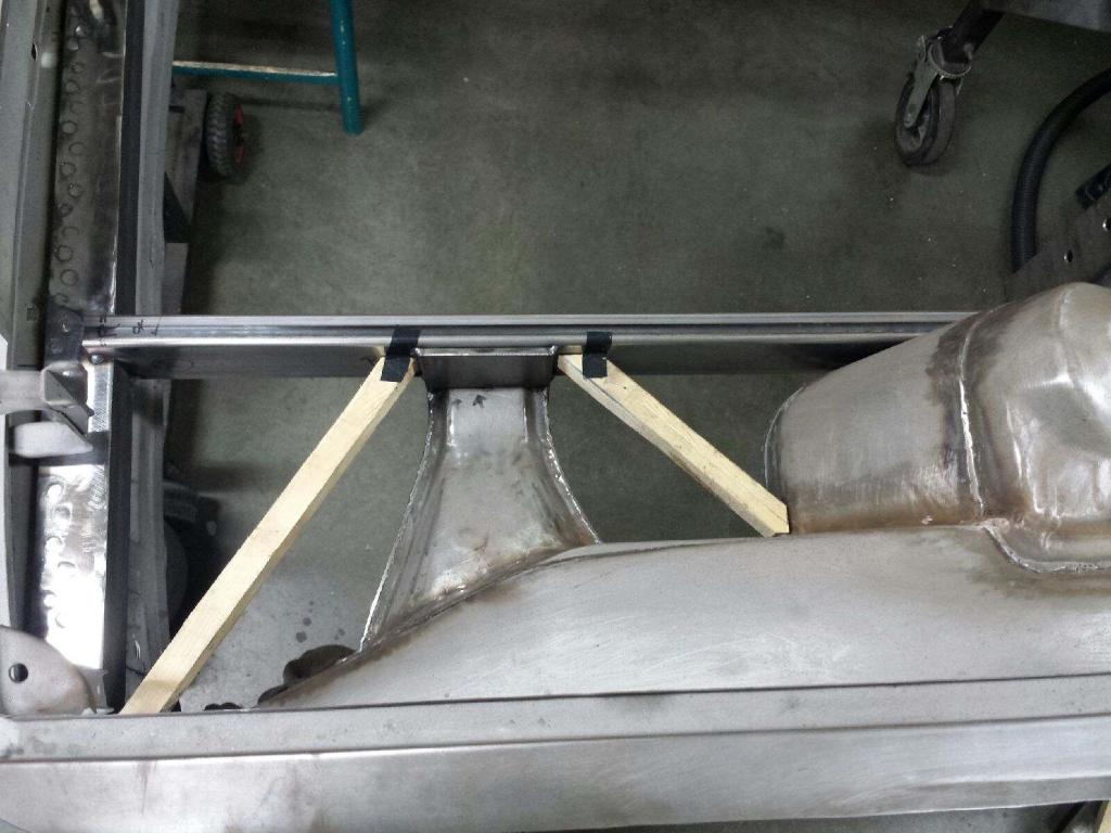

Here you can see the wooden mock up for the rear support bars. This was then cut to fit in metal and welded in.
IPB Image
IPB Image

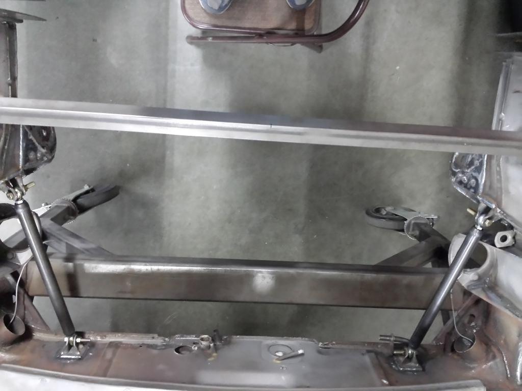

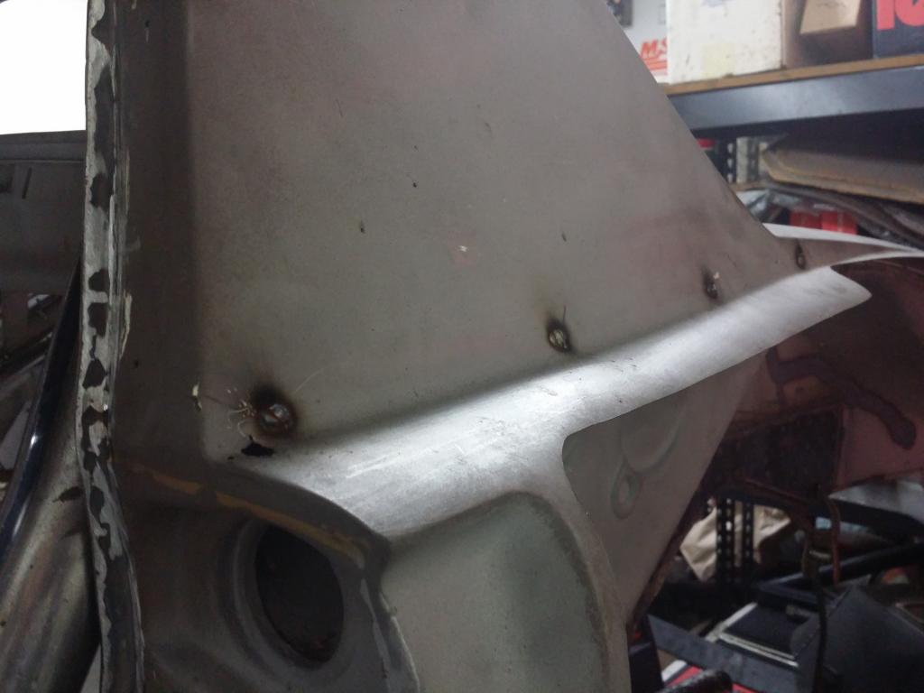

The Tangerine Racing Heim Rod Braces have been welded in.
IPB Image

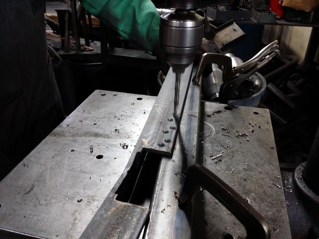

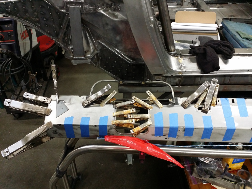

The inner longs were then cut open so we can send the radiator lines through them from the front to the rear.
IPB Image
IPB Image

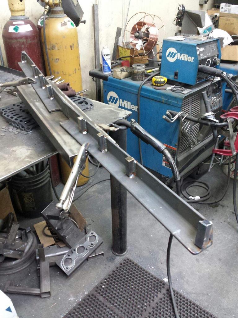

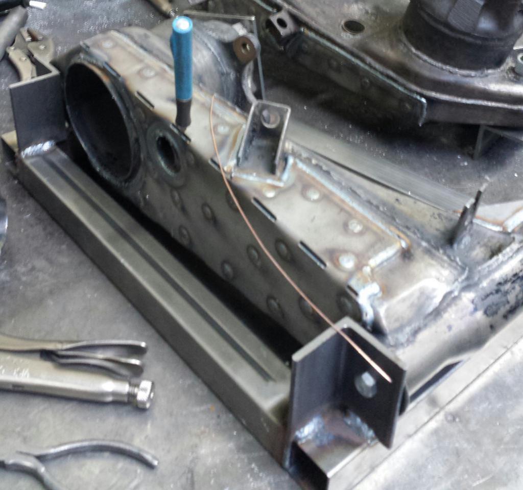

The trailing arms were welded to their stiffening kits. We custom built the jigs for them while they were being welded to reduce any structural movements when they were expanding and contracting from the welder's heat.
IPB Image
IPB Image

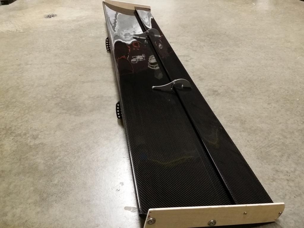

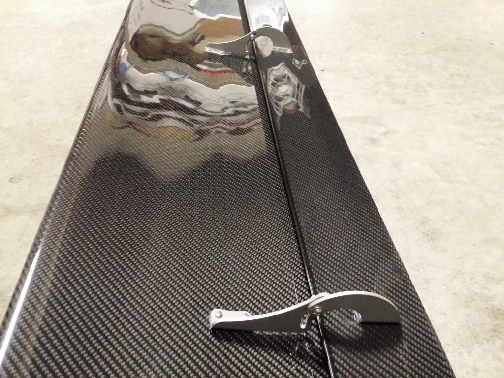

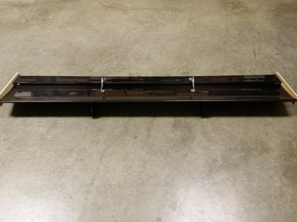

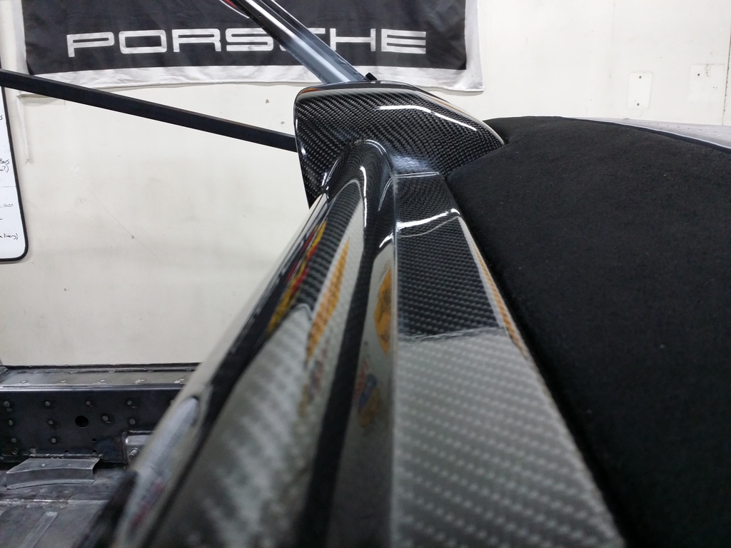

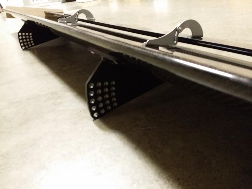

The Dual Element carbon fiber wing from APR came in as well. It measures 71 inches across and is a really neat piece that we can't wait to attach to the car.
IPB Image
IPB Image
IPB Image
IPB Image
IPB Image
IPB Image

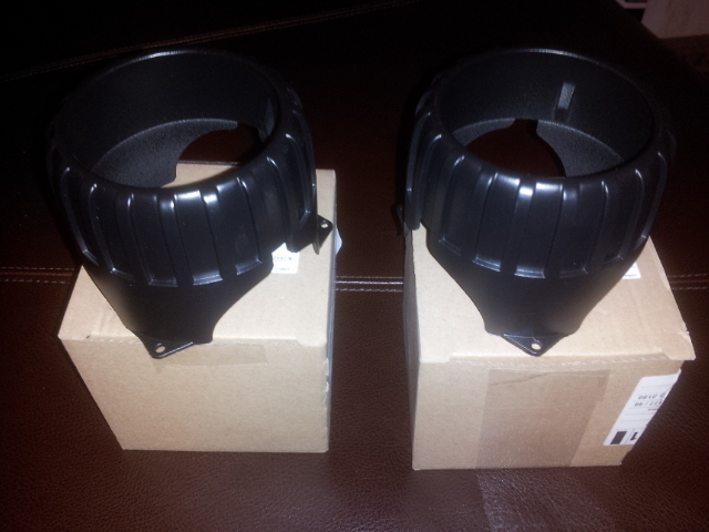

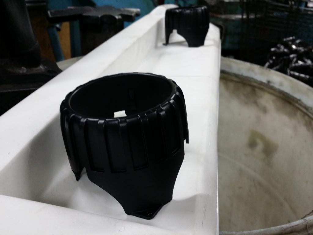

Also had sometime to install the Carrera GT exhaust tips into the bumper.
(For reference)
IPB Image
IPB Image
IPB Image
IPB Image
IPB Image

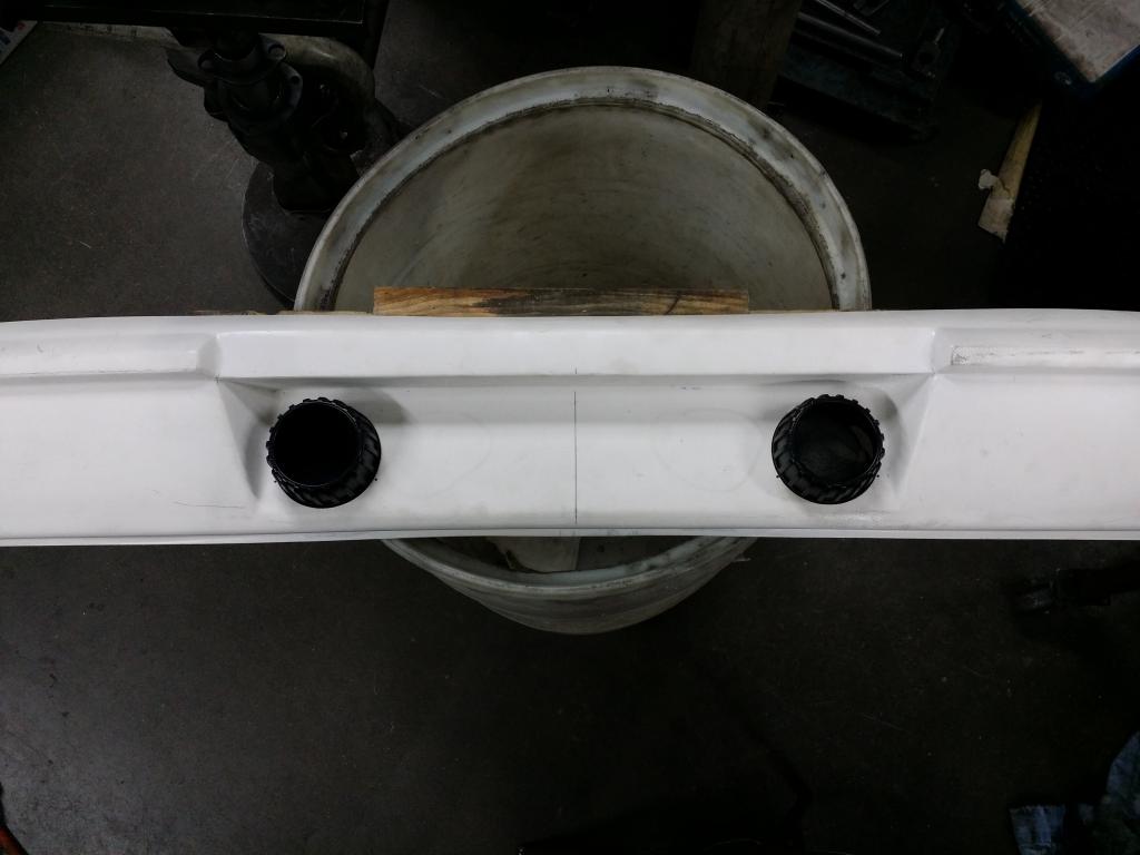

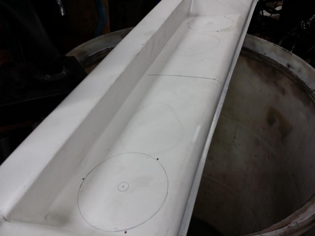

Thankfully the fiberglass rear bumper is European spec so we we're able to have a wider spread between the exhaust tips.
IPB Image
IPB Image
IPB Image
IPB Image
There will be an inner extension of exhaust tubing the comes out from the Carrera GT tips. Pics of this later.

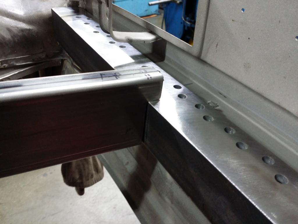

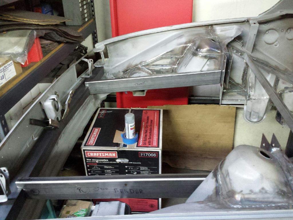

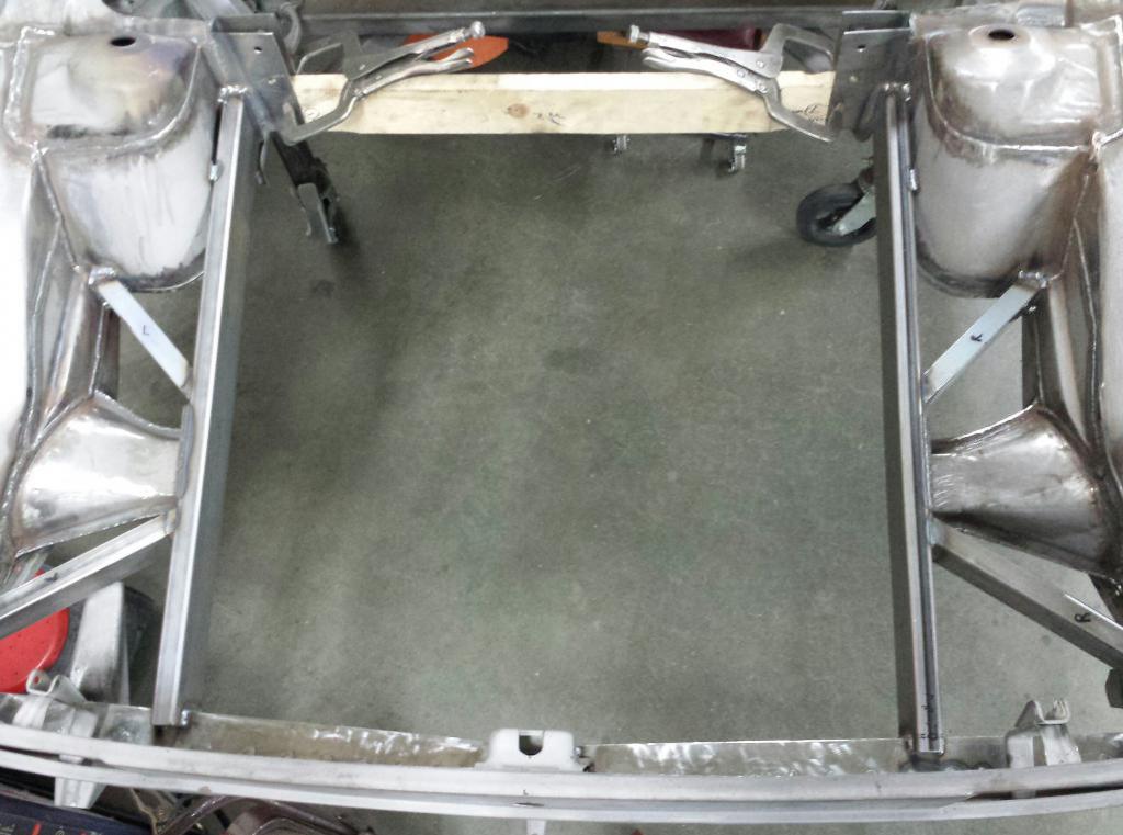

Beautiful build! What size rectangular tubing is your rear chassis supports? They look strong enough to handle what you're doing to it! popcorn[1].gif
krazykonrad
popcorn[1].gif This has always been a dream build of mine. Very cool.
Konrad
Maltese Falcon
QUOTE(mgp4591 @ Feb 10 2015, 08:35 AM) *
Thank you for your comment...the left +right longitude are
1×4 , the smaller side pieces are 1x3; both are .120" ga.
The mating back piece that is welded along the rear trunk section is 2x2 angle @ .250" ga.

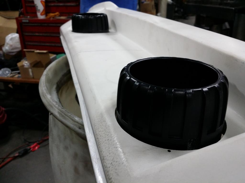

Maltese Falcon

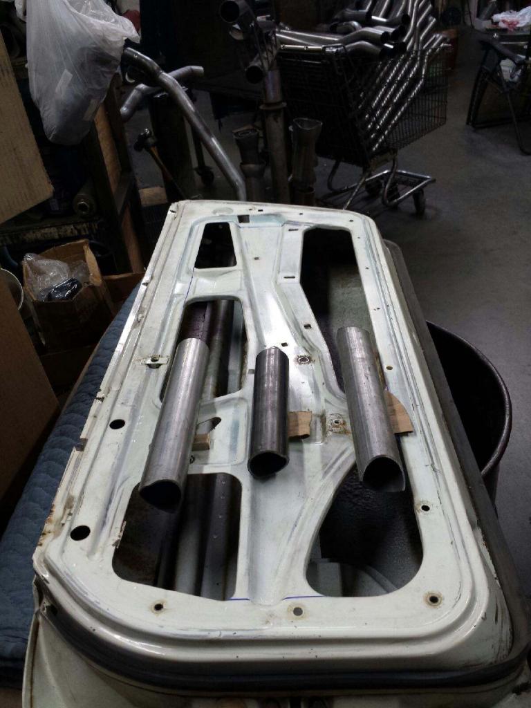

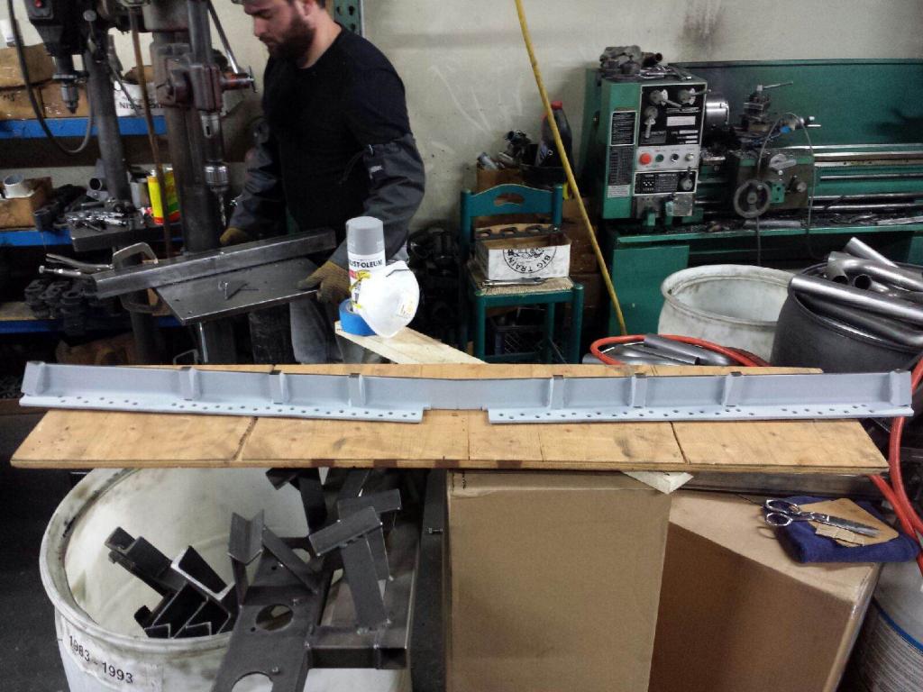

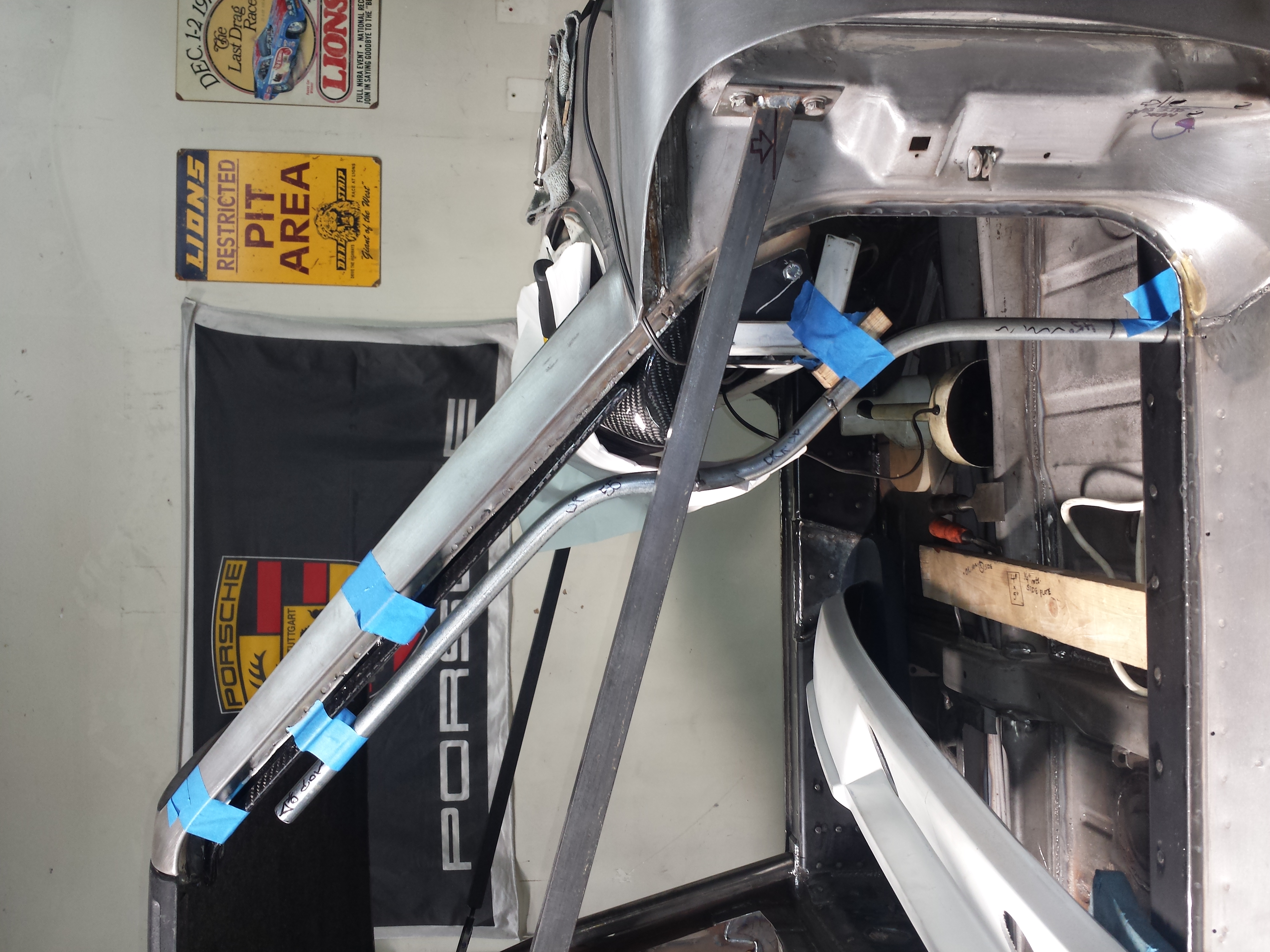

I use a contractors EMT bender and tubing to create the sample bends for the cage work. Then the samples are used for the real bends which are mandrel formed in 1.750 x .120" wall.Click to view attachment
Marty

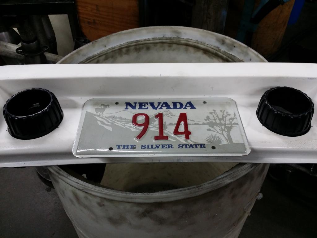

Mueller
Awesome build....
The license plate is just PERFECT .... I'd rivet that sucker on so it doesn't end up on someones garage wall!

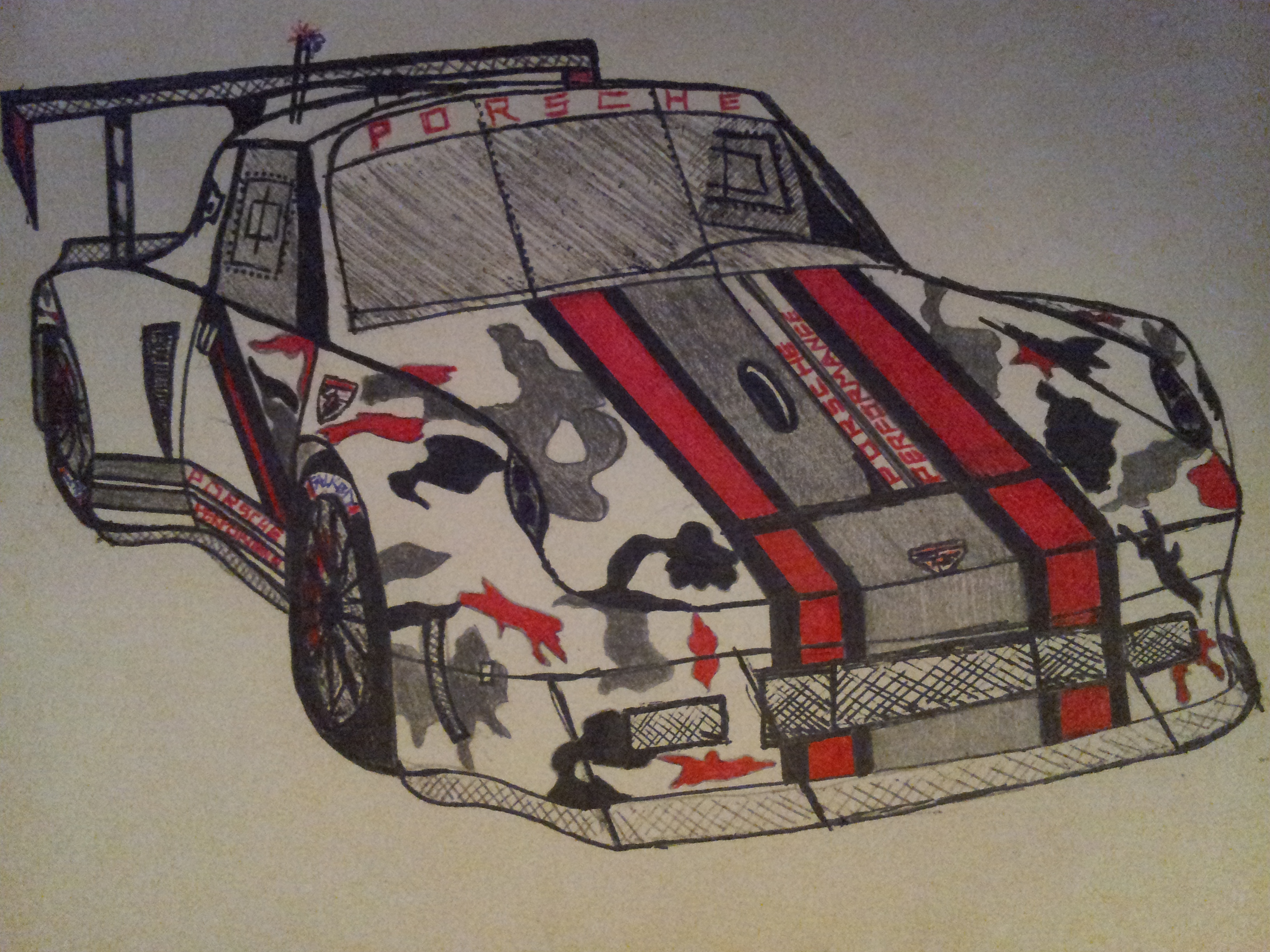

When the Cayenne was introduced, Matt sketched this concept on a paper napkin at Big Sur campgrounds. The final livery will be penned in a few months.

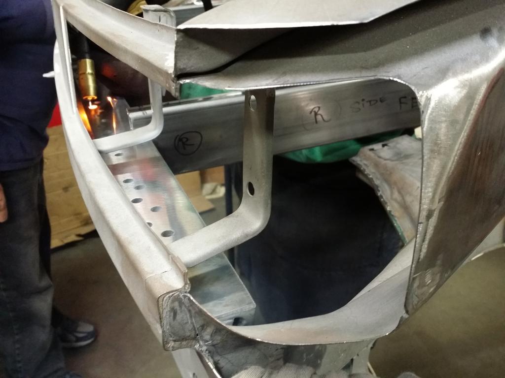

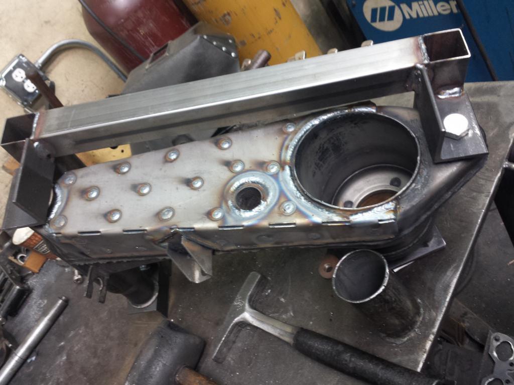

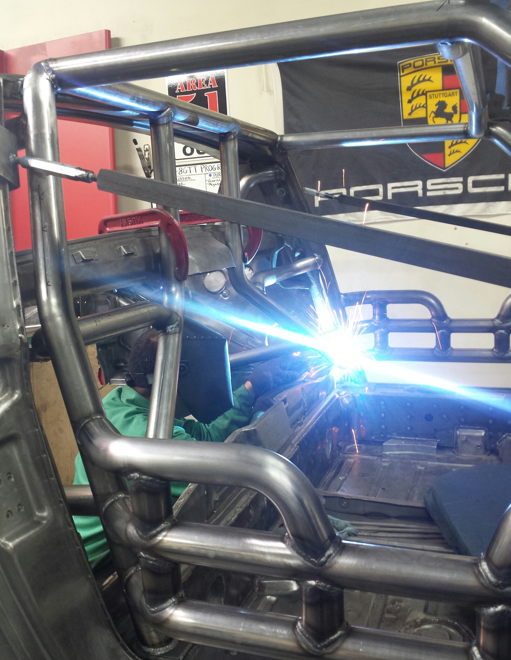

More welding chores this weekend:

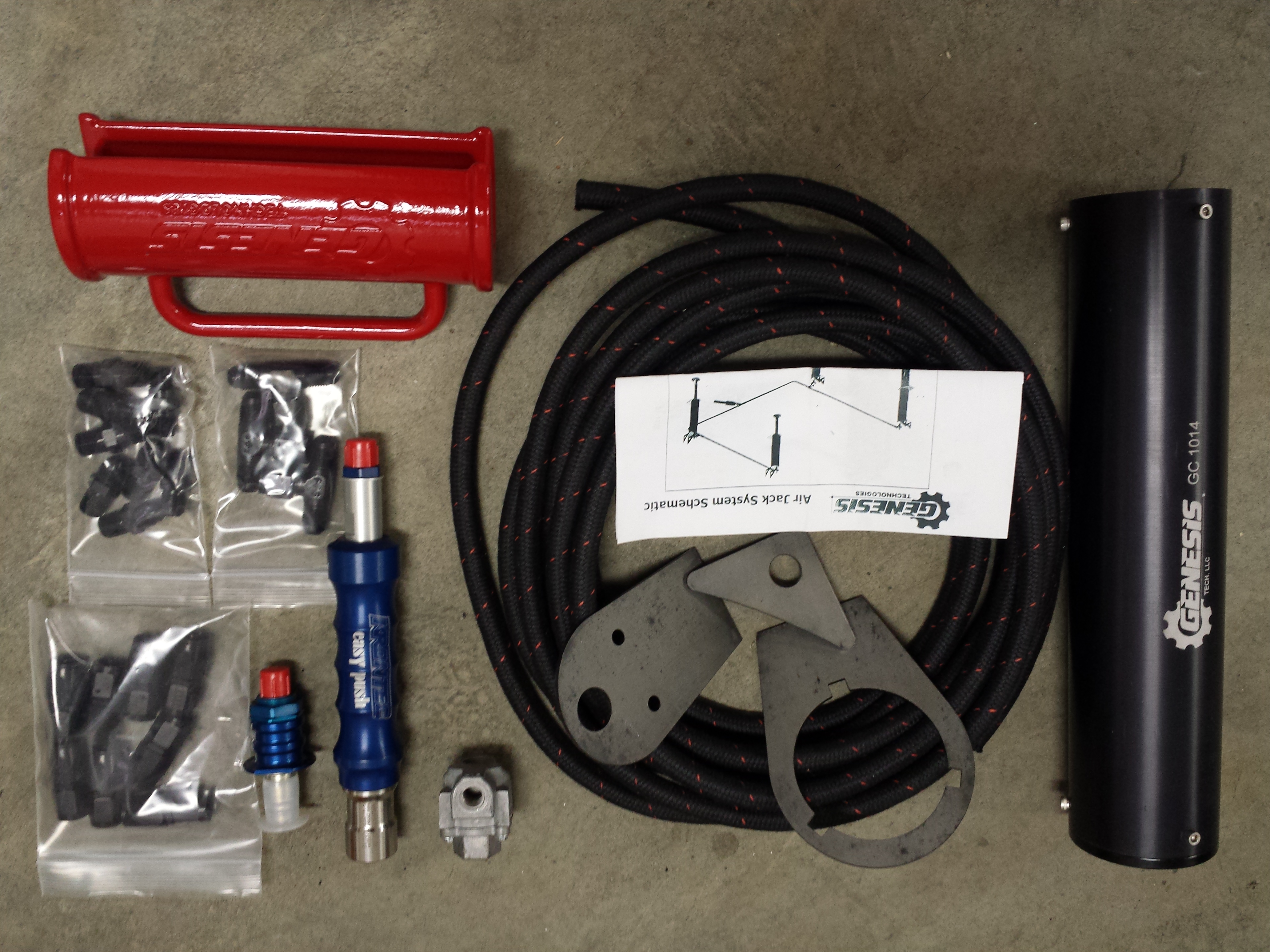

On board air jack system, our car uses 3 total. The red looking "Beer stein" is a pit jack-stand that adds extra security during longer pitting. The air jack piston travels downwards approx.9" . With the car at 5" ride clearence, we should get another 4" ground clearence for tire changing. welder.gif Click to view attachment

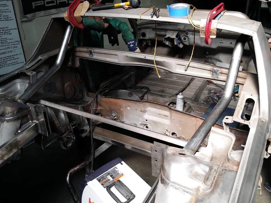

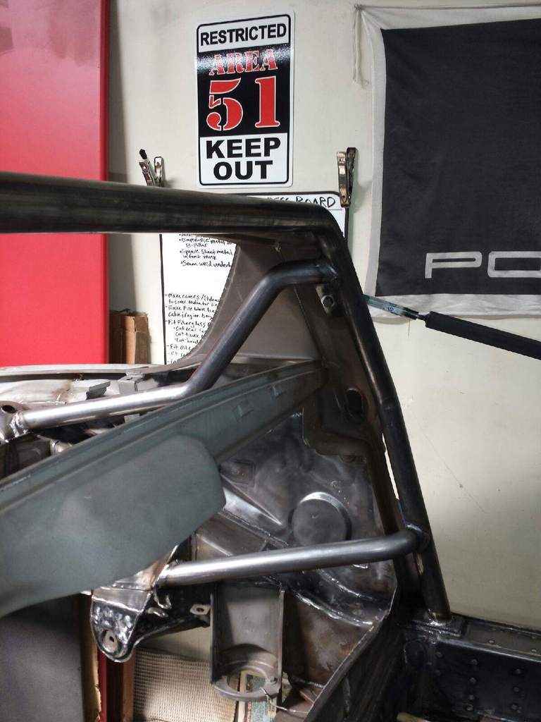

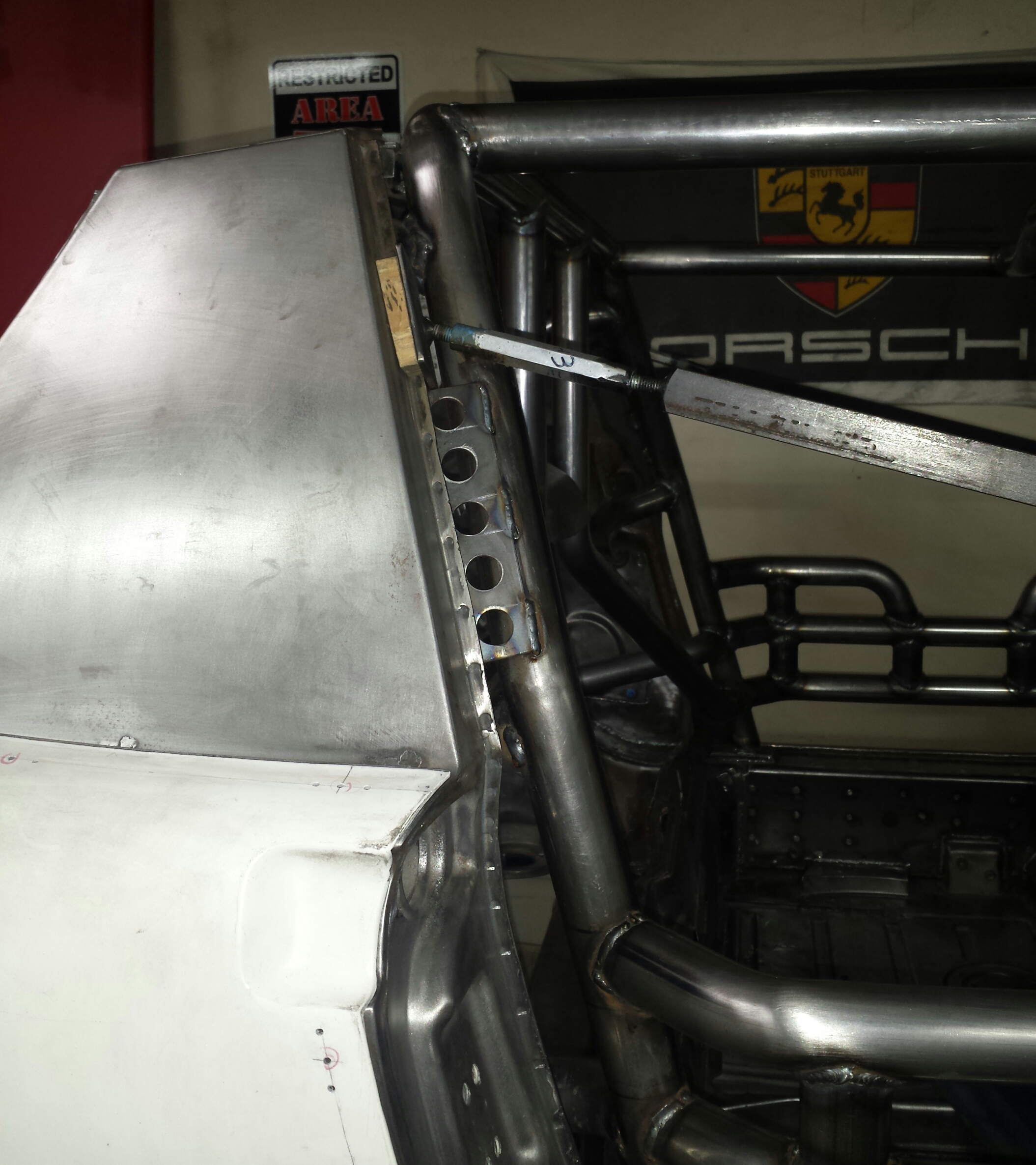

We are continuously welding in the roll cage pieces. Here you can see the finishing touches on the cabin to rear pieces.

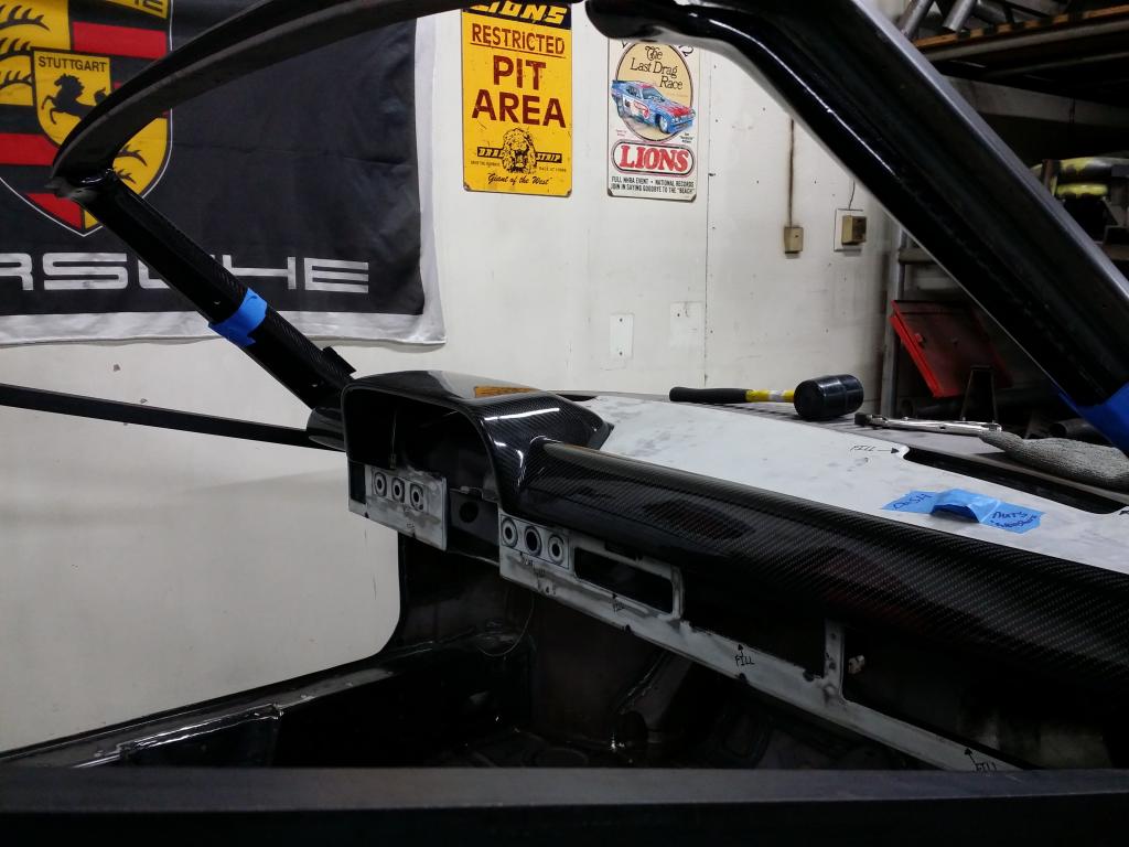

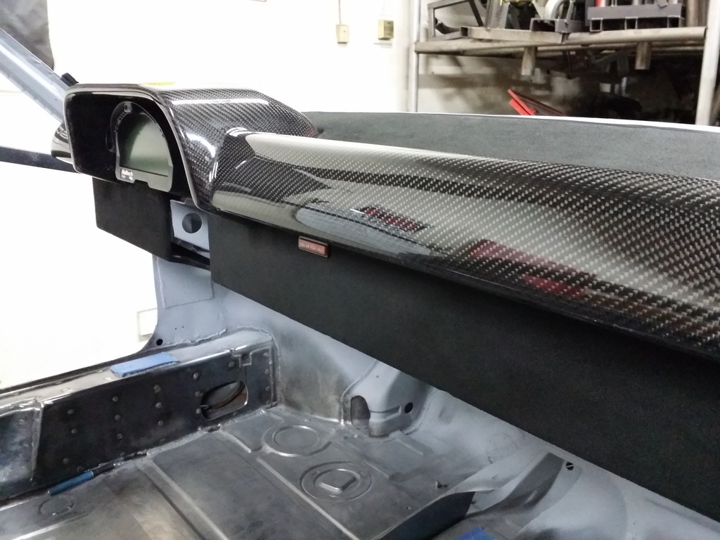

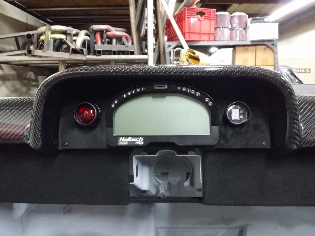

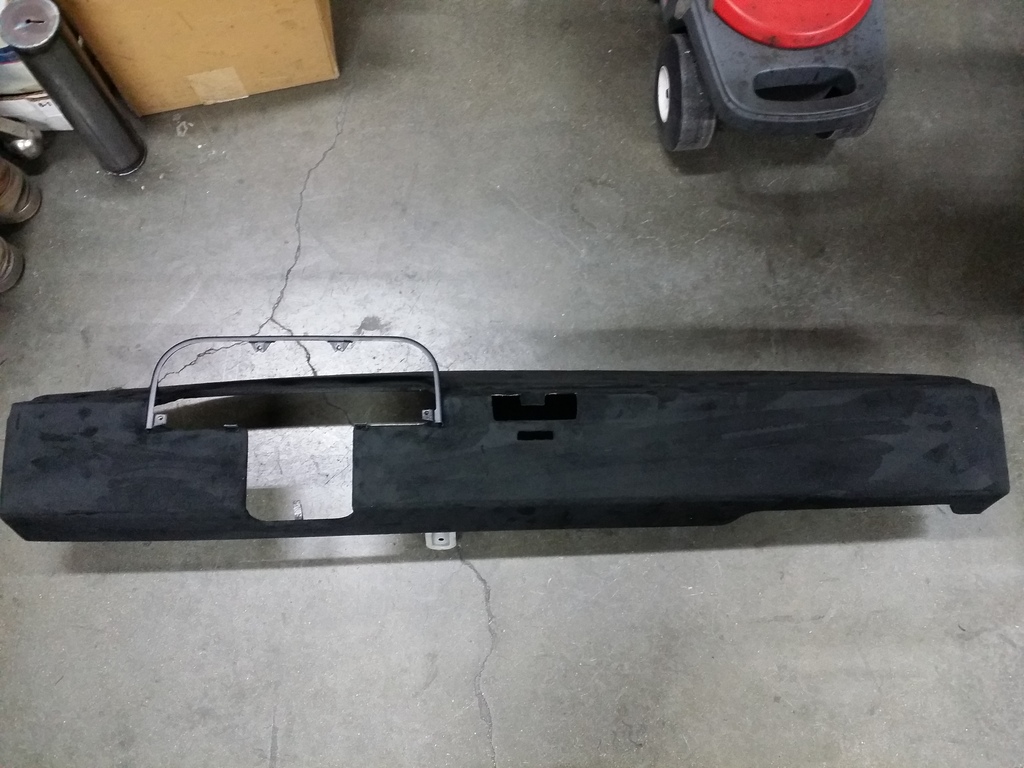

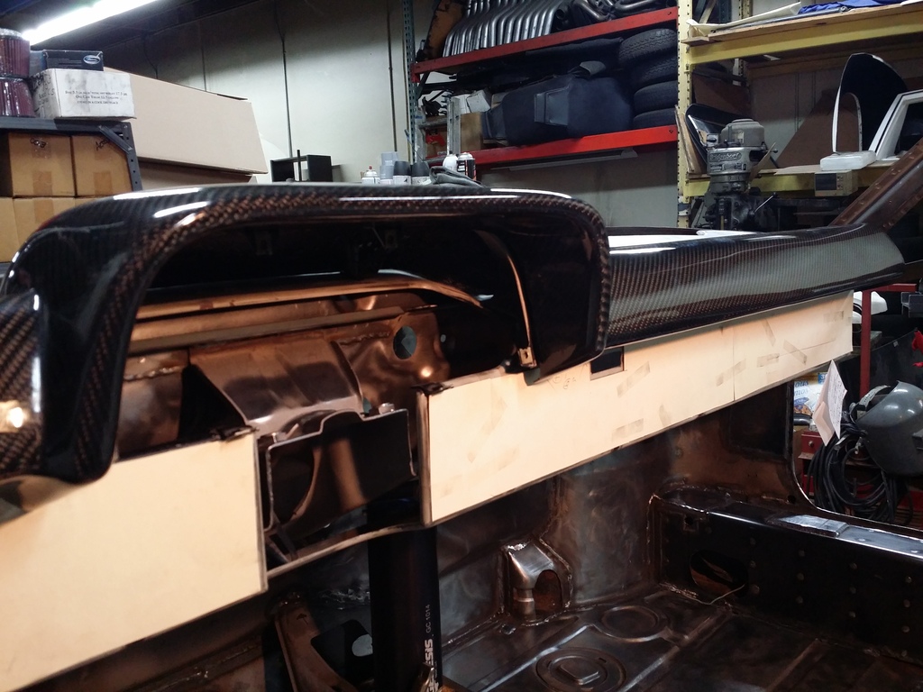

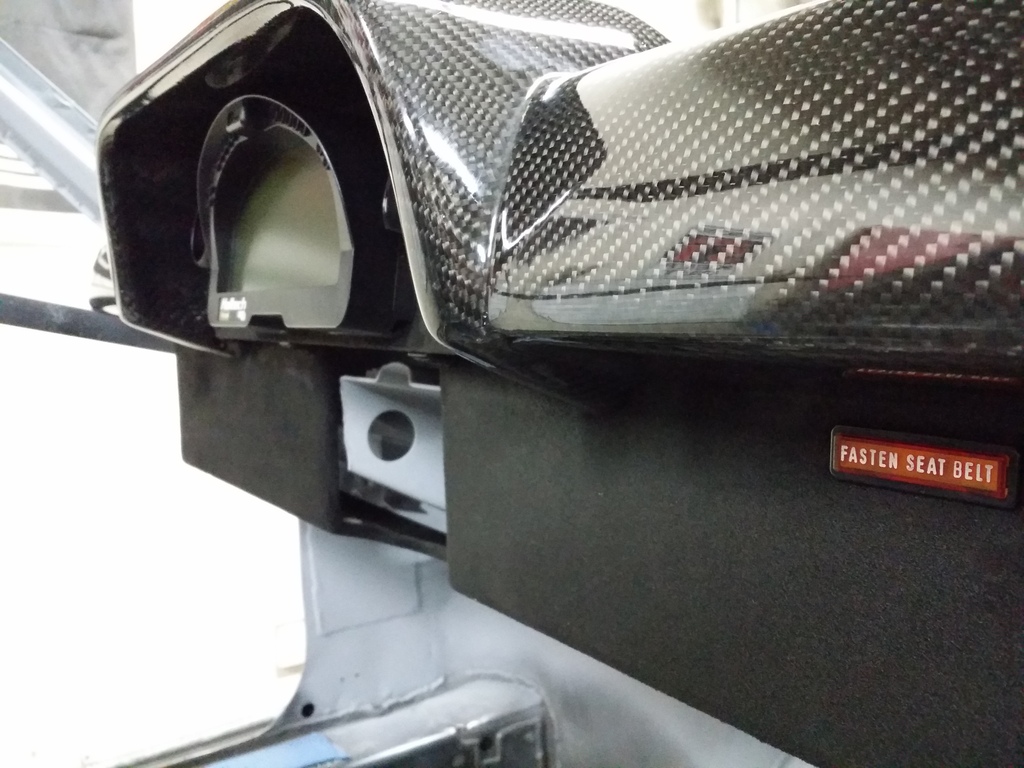

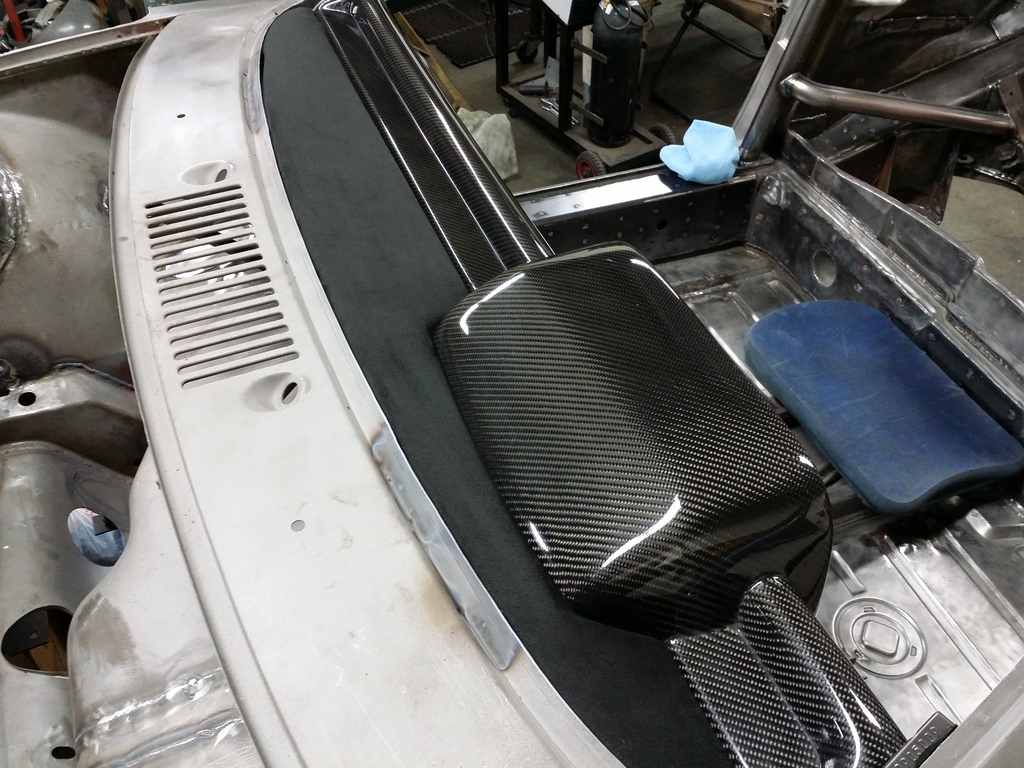

Next up is the dash. Upon further inspection, we hit a road block when it came to finishing the interior roll cage work because we were unable to fit the dash in after the roll cage would’ve been welded. So, we had to complete the dash in its entirety before we were able to continue the interior cabin roll cage work.
The idea for this dash was literally 3 years in the making and I’m very happy how it turned out. The idea behind the look of it came from GT racing cars, where they use what looks like the OEM dash, but highly modified for the car’s racing needs. We used alcantara and carbon fiber, sourced from a fellow board member. You know who you are! And thank you for helping us achieve such a design masterpiece. There will be a carbon fiber lower dash addition (not pictured) to hold all the switches.
IPB Image
IPB Image
IPB Image
IPB Image
And back from the upholster:
IPB Image
IPB Image
And installed:
IPB Image
IPB Image
IPB Image
IPB Image
FASTEN SEAT BELT!!

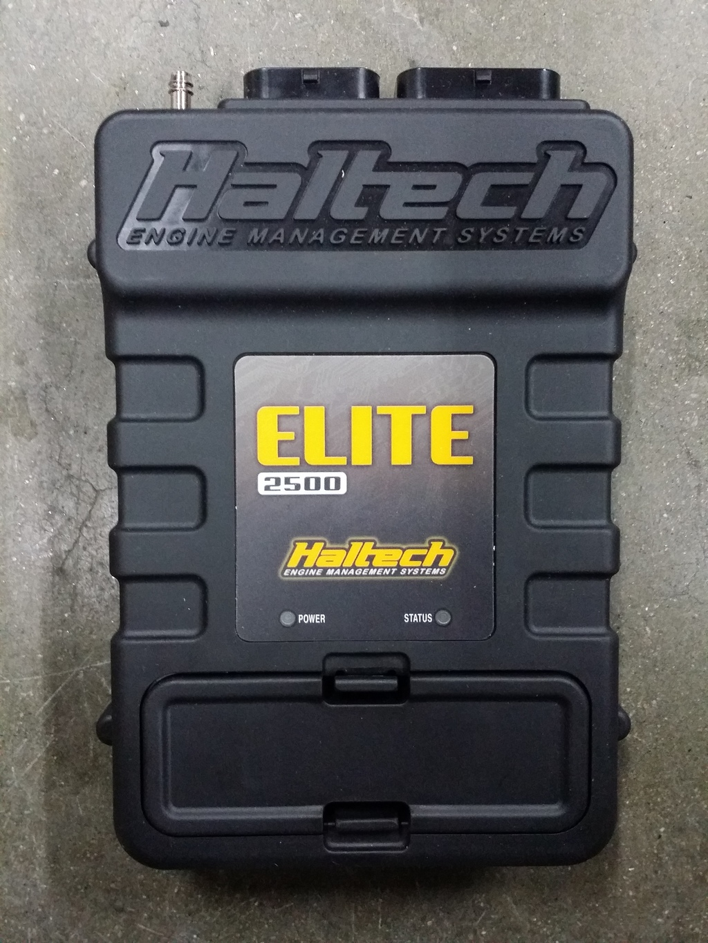

The Haltech Engine Management Elite 2500 came in. This supersedes our older Platinum 2000 unit and will offer us more tuning capabilities:
IPB Image
It even comes with a USB Key!
IPB Image

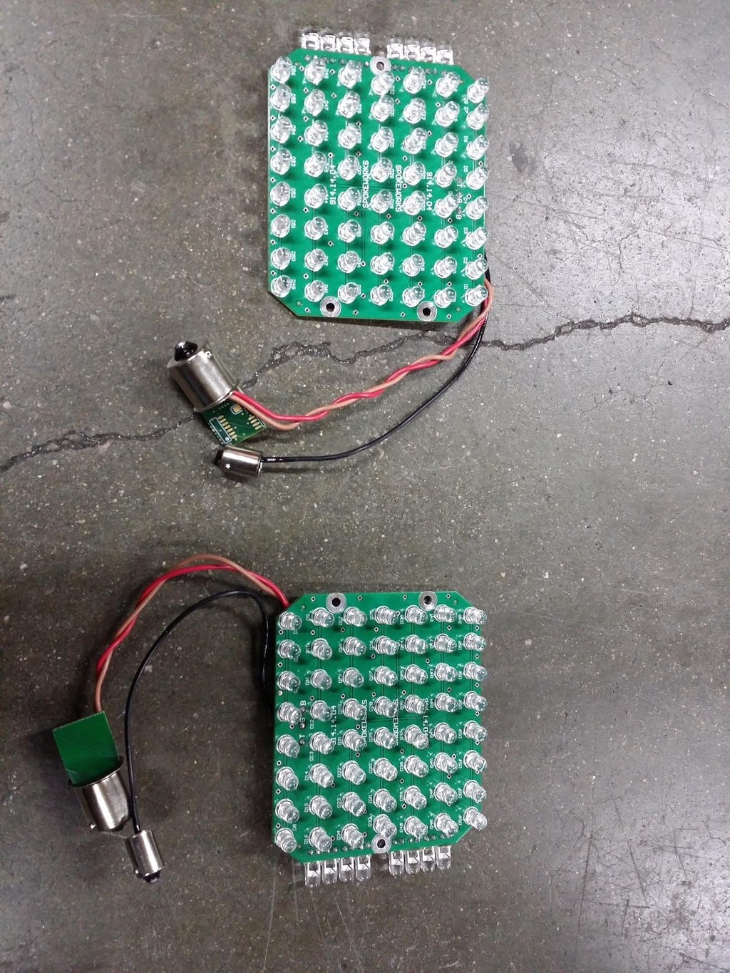

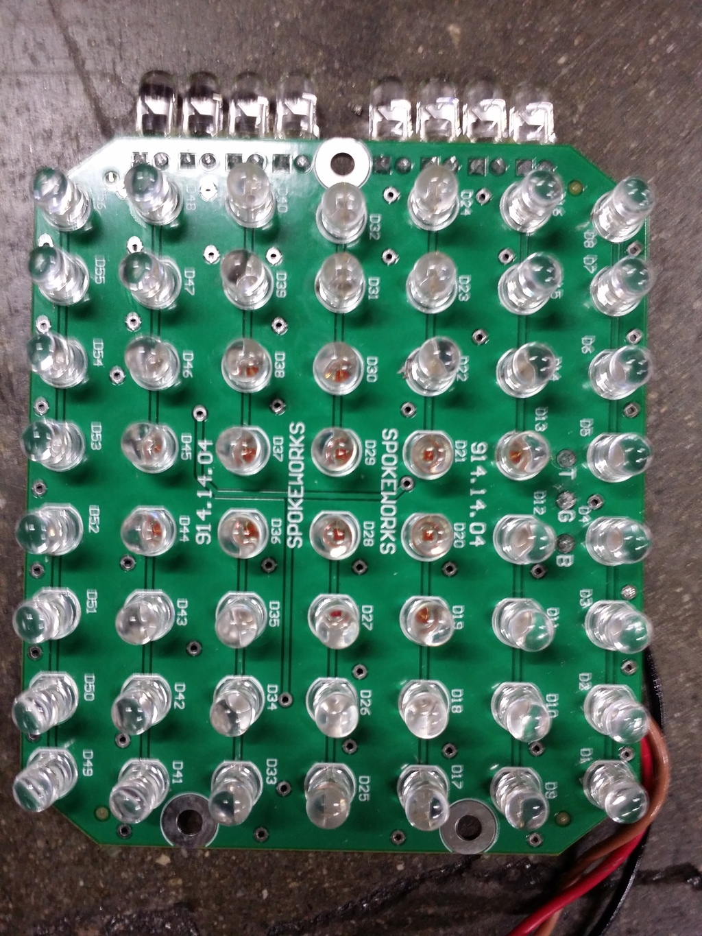

The LED taillights came in from Spoke too!
IPB Image
IPB Image

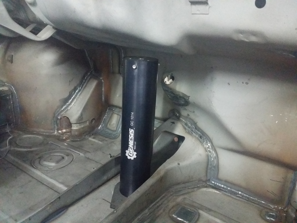

Once the roll cage work is done, we will be moving on to Air Jack placement :
IPB Image
That’s it for now!
-Matt
Jeff Hail
9 inch airjacks, 5 inches of clearance and a 4 inches or ram stroke left over? Aint gonna work with full suspension droop to get the tires off the ground unless you limit the droop with straps. With straps at all 4 corners you creating another conundrum; tire lift when you really don't want lift. Straps on the rear ok, on the front its gonna go from sticky to no steering faster than you can pucker.
I love the dash!

Not posting much on the build right now...but here's one Click to view attachment
Maltese Falcon
...one moreClick to view attachment
Mueller
wow...that is one-helluva cage...the tubing is bigger than my exhaust!
Sweet!
matthepcat
You should build in pivots on the entry and exit of the cage to make easier access.
