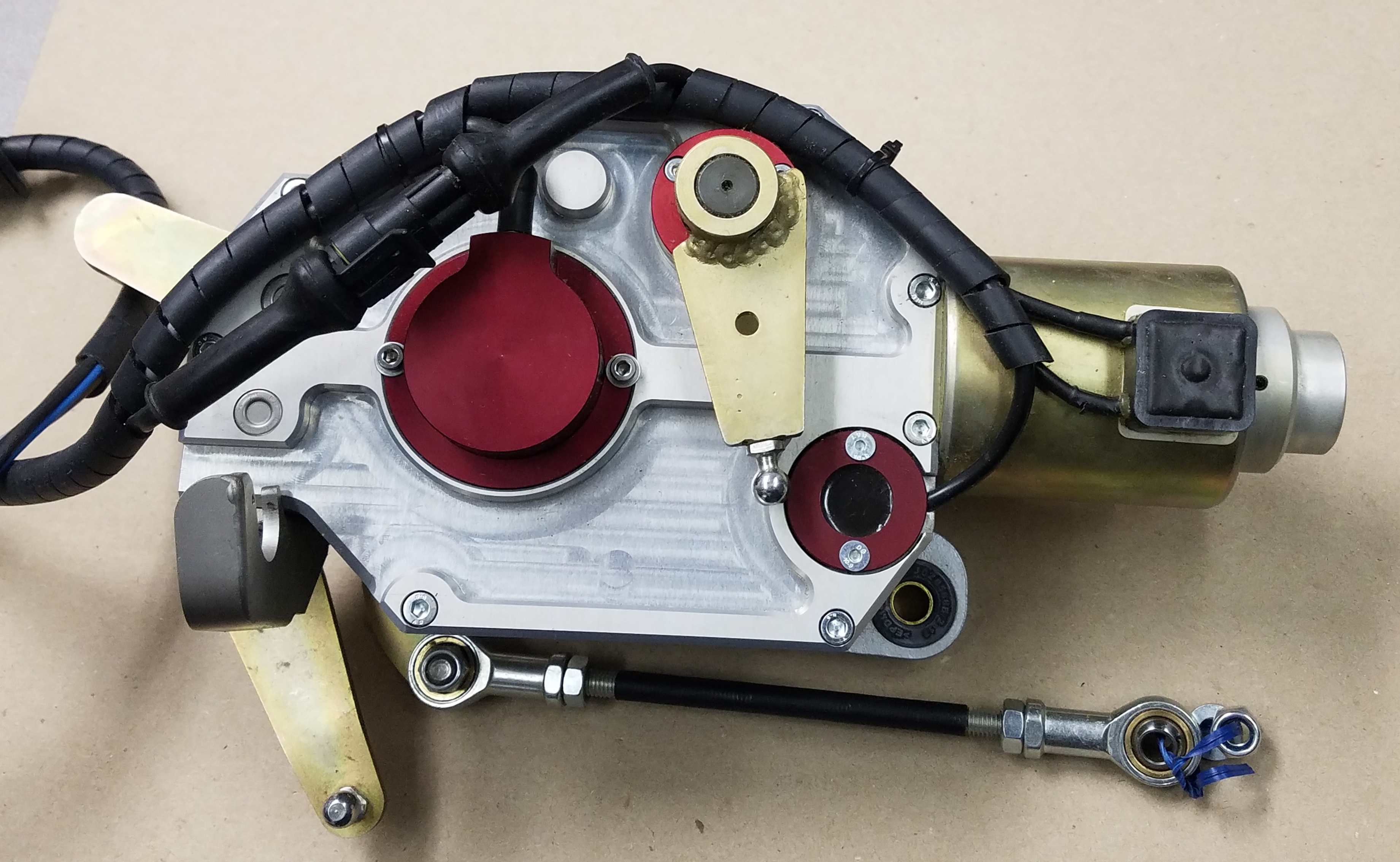

Getting back into assembly of specialty equipment to the project; starting with the SQS sequential shifter moduleClick to view attachment
I bet some trick engineering went into designing and making that puppy. Wow.
SQS makes a large selection (various vehicles brands) of sequential shifter kits. They are good at what they design + mfg. The module is basically a blend of human input (you move the stick), changes into electronic command to solenoids which create shift linkage movement from the H pattern into a Linear pattern.

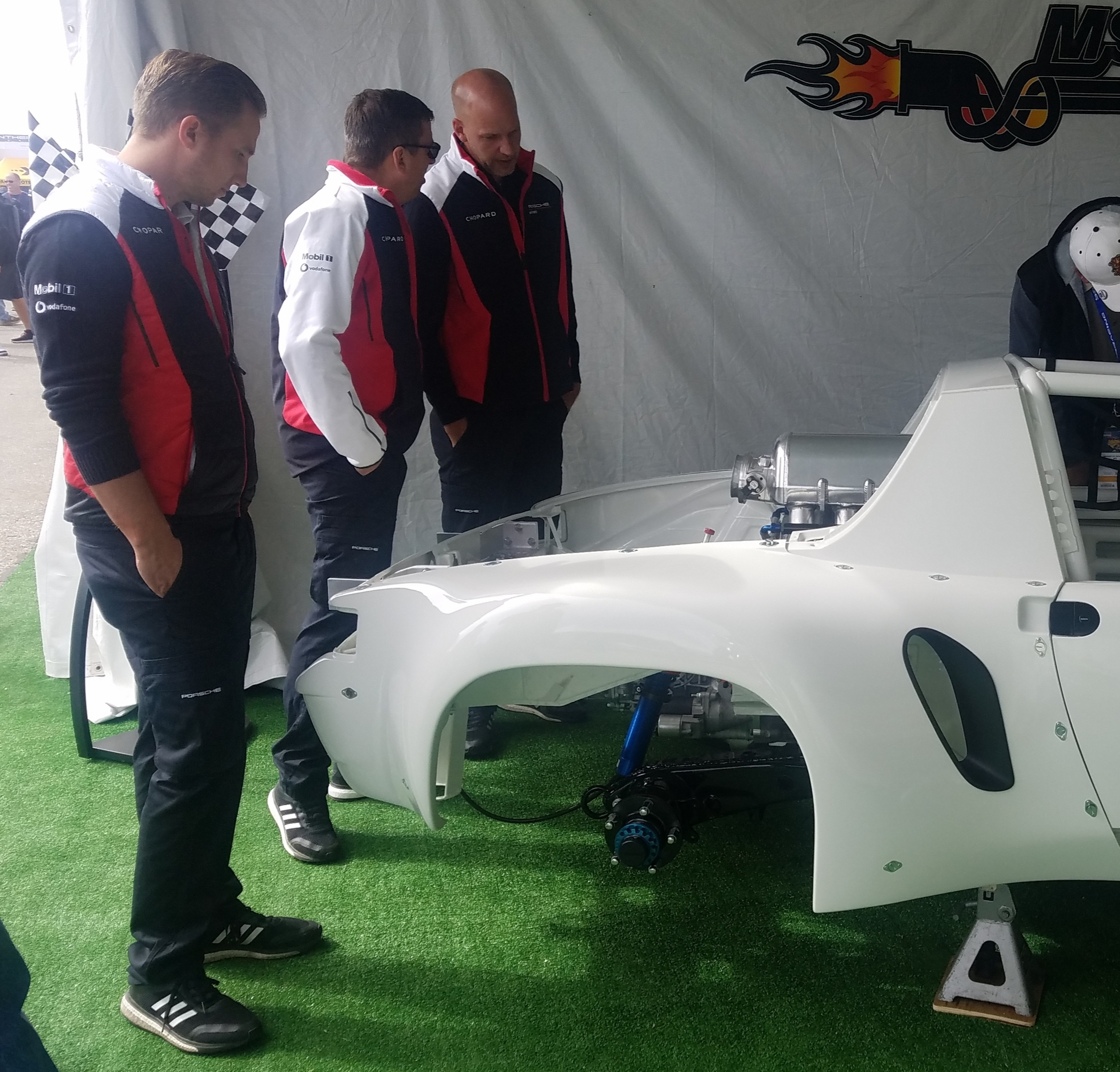

At Rennsport6, the 914 project drew some good reviews from the Porsche boys at Weissach !¡

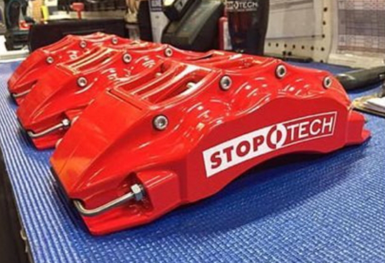

Moving on to the brakes, StopTech will be on our build. They are local to us in SoCal, offering us hands on engineering and design input on the project. I've been to their plants (2 in So Bay area) and the customer service is spot on.
Front calipers are their 6 piston units with 380mm x 32mm vented / floating discs that are built to bolt on to the 911 strut with 3 1/2" bolt spacing. The finish on the calipers will be their electroless-nickel, not red as in this factory pic. Minimum wheel dia is 18" with this brake setup and the 935 bits we have installed

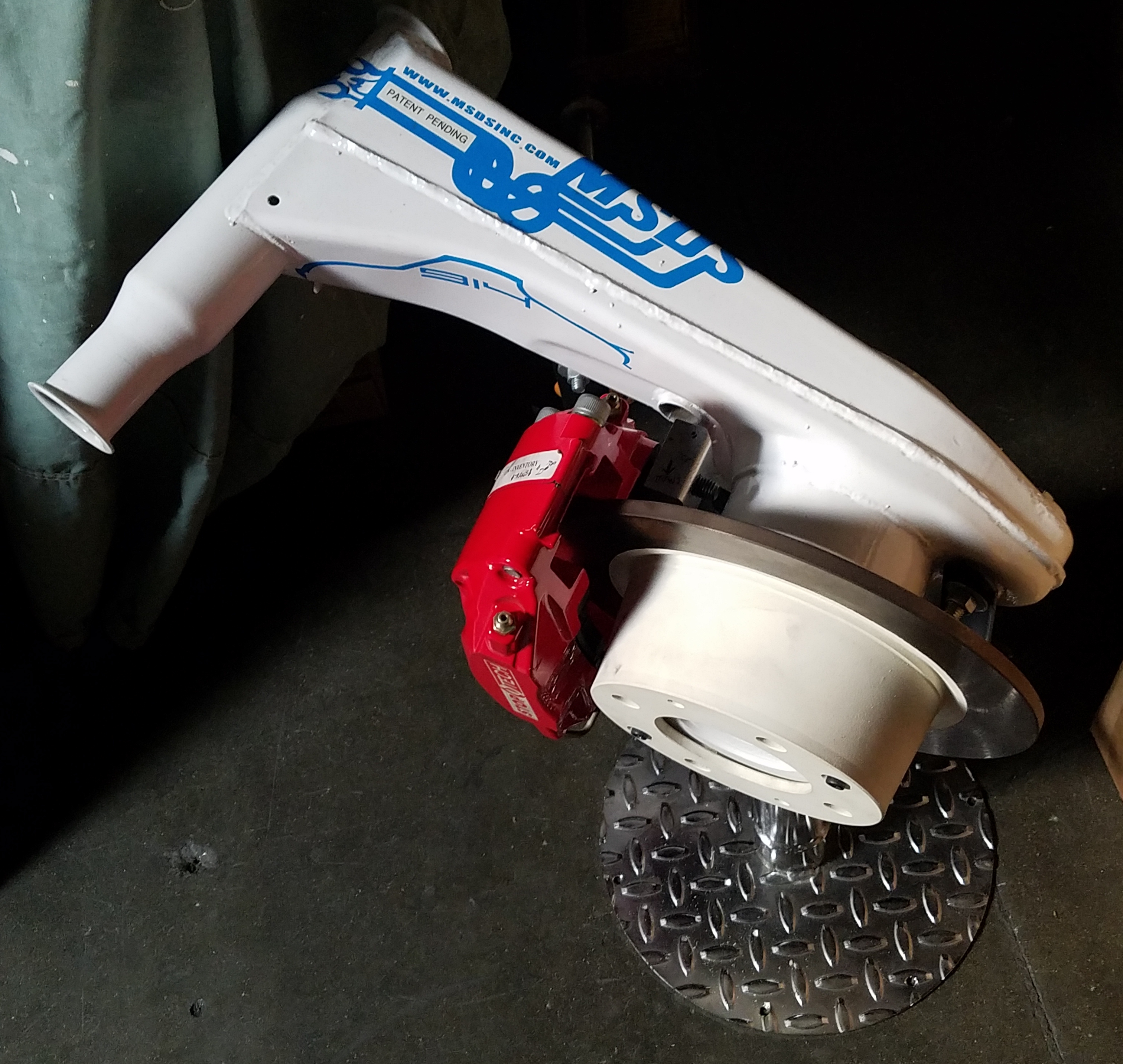

Rear StopTechs are their #ST40 4 piston model. Using the Rich Johnson style 986 Boxster adapters, the ST-40's are 99% in position on the trailing arm. I'll use 12mm washers to shim the caliper into final position, then remake the aluminum blocks to the new fitment spec. The white trailing arm in the pic (use it at trade shows) is my workhorse for the rear prototype; so dont mind the solid rotor in place>> just being used for reference. The final rear rotors are 355mm x 32mm vented floating discs.

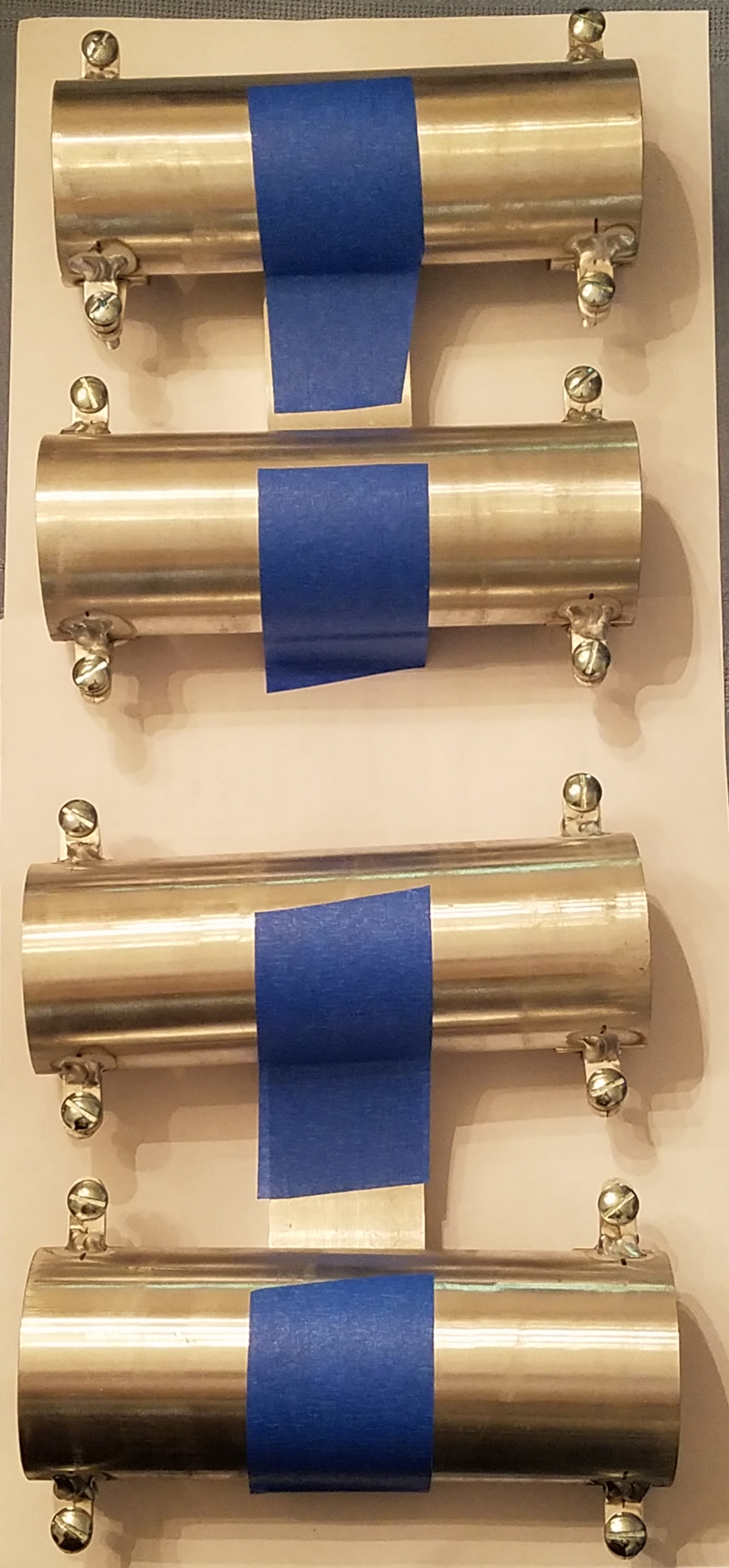

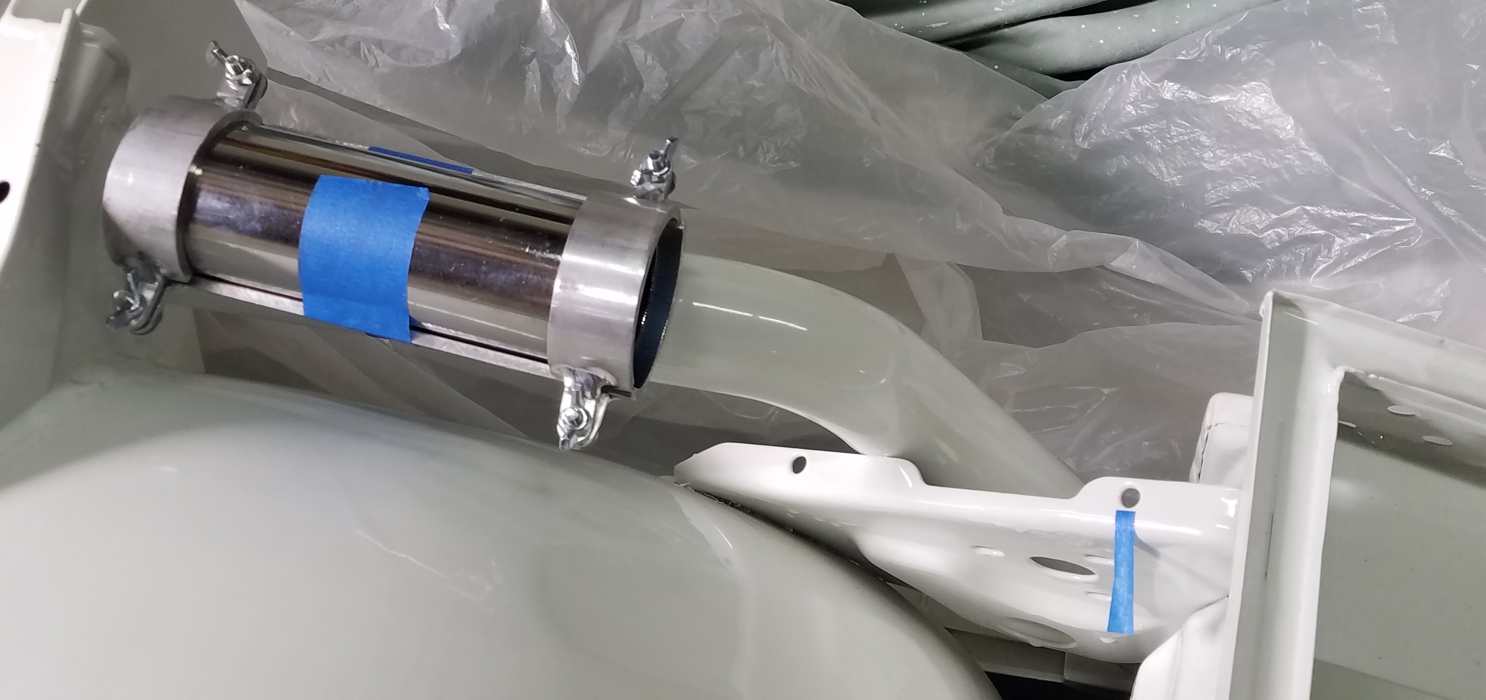

Things to do while waiting on StopTech brake order...finish up the JRZ nitrogen cannister brackets. Once the brakes are received and mounted, I can then determine the offset measurements for the custom wheel order. Lots to do while waiting for special order parts...

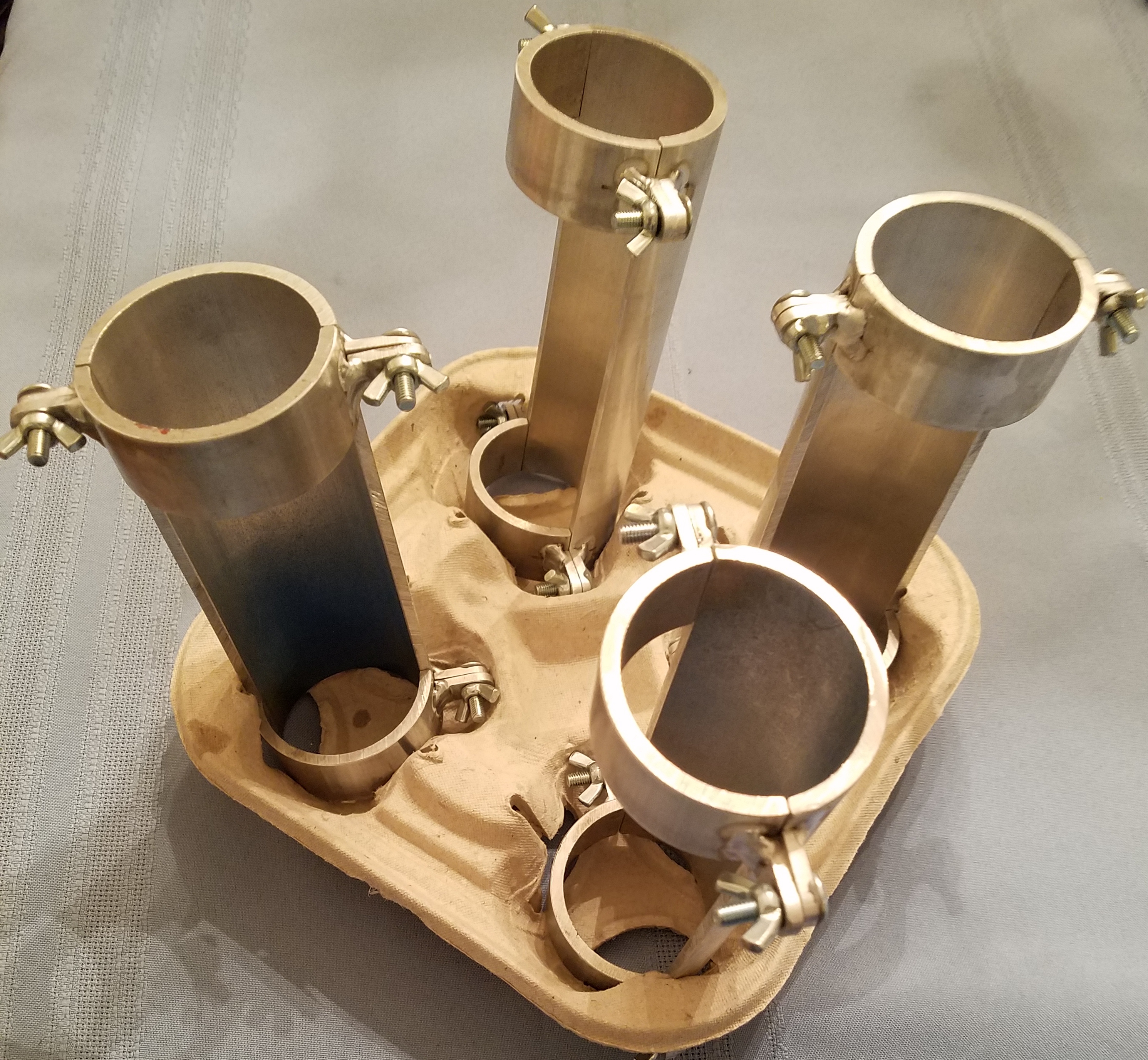

4 JRZ cannister brackets walk into a Starbucks...Click to view attachment

KELTY360
QUOTE(Maltese Falcon @ Mar 2 2019, 06:02 PM) *
......and?

Mayne
QUOTE(Maltese Falcon @ Mar 2 2019, 09:02 PM) *
That’s a latte fabrication.
Maltese Falcon
QUOTE(Mayne @ Mar 3 2019, 06:29 AM) *
biggrin.gif ...the caffeine does help !
Kelty360...
Barista says : "I will need to keep the 4 of you in this tray so you don't Shock the customers"

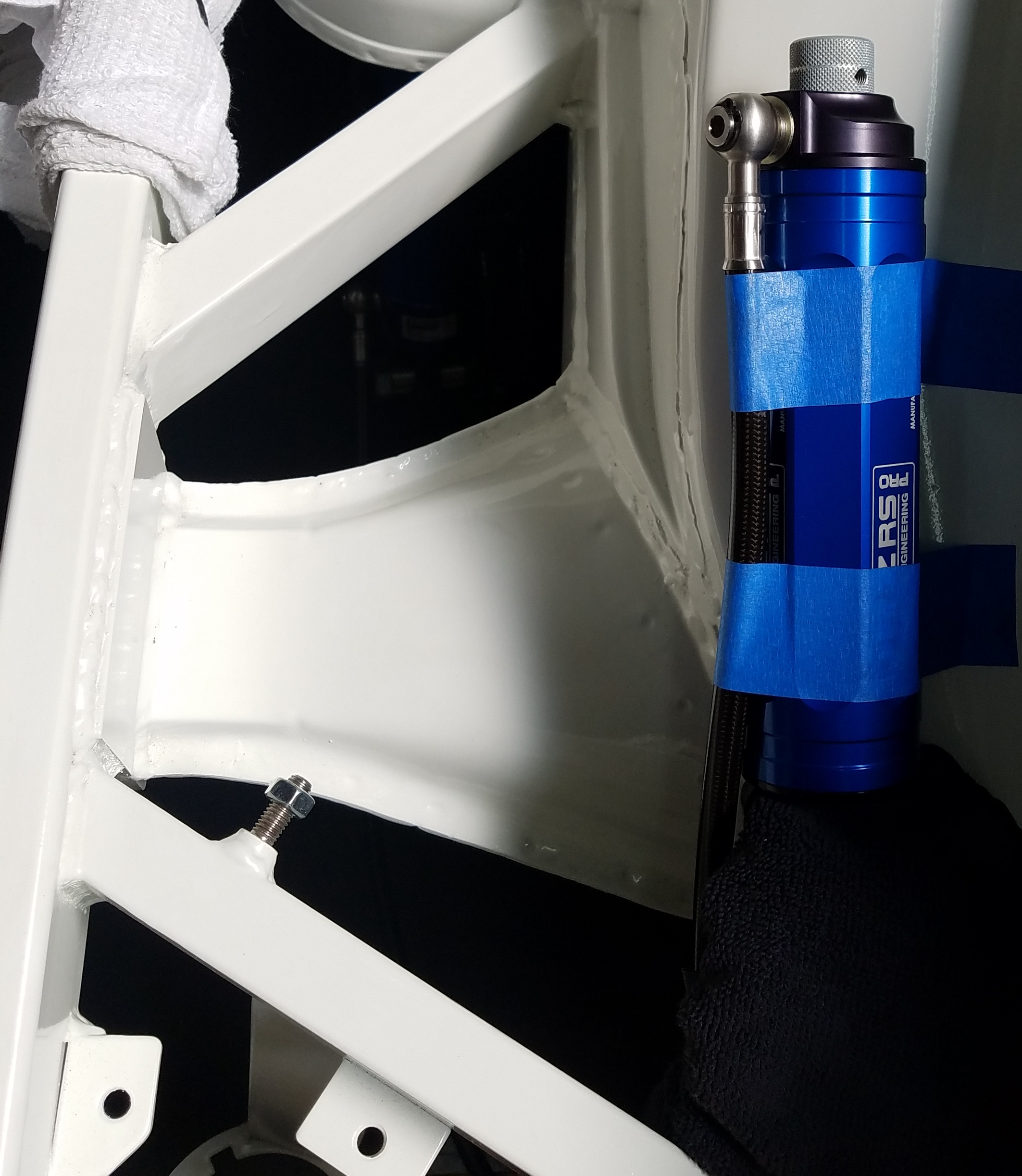

Looking for JRZ mounting areas...front is good , rear should work tucked in a corner

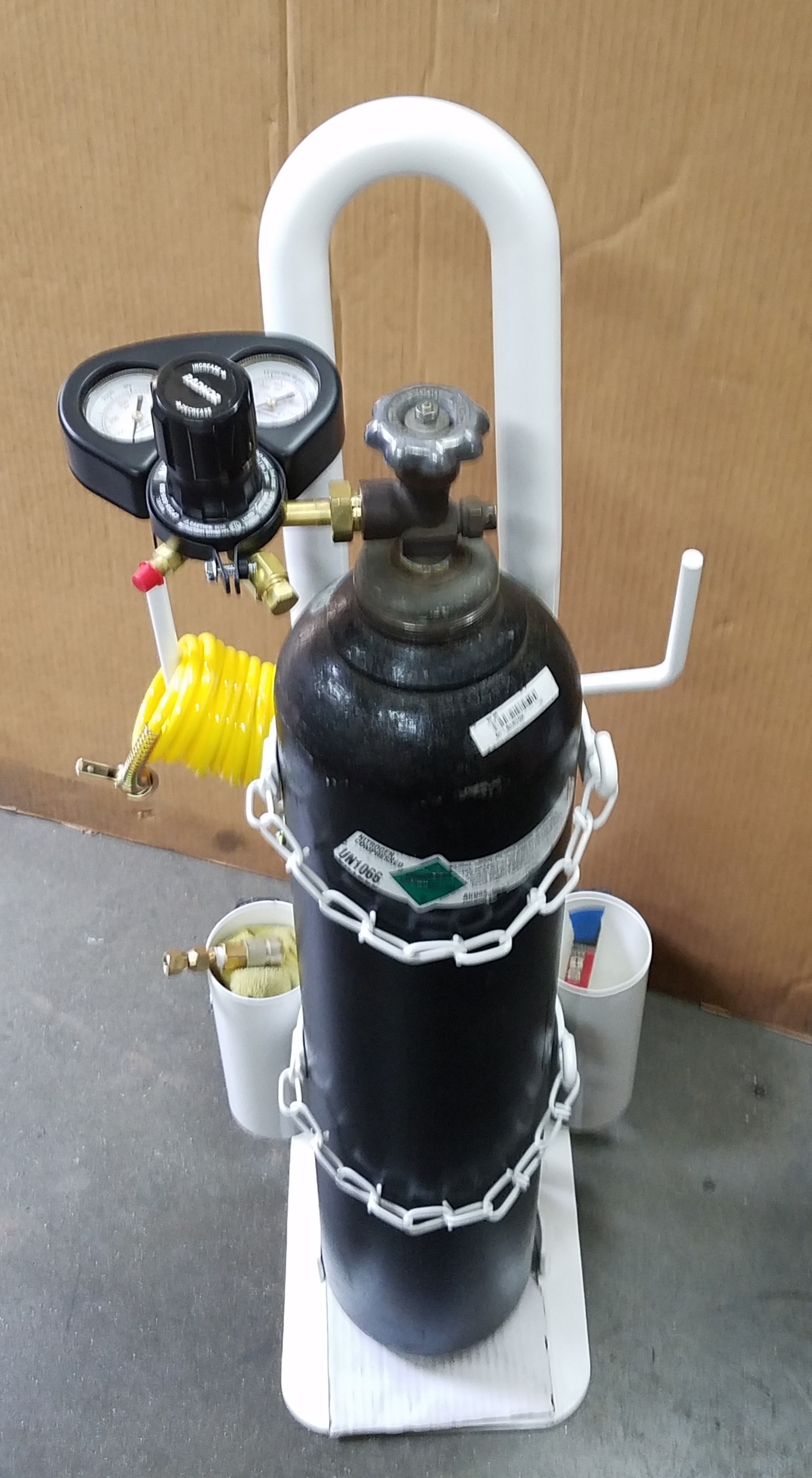

Harbor Freight didn't have a small dolly for the nitrogen tank, so had to custom make one with coffee cup holders smile.gif

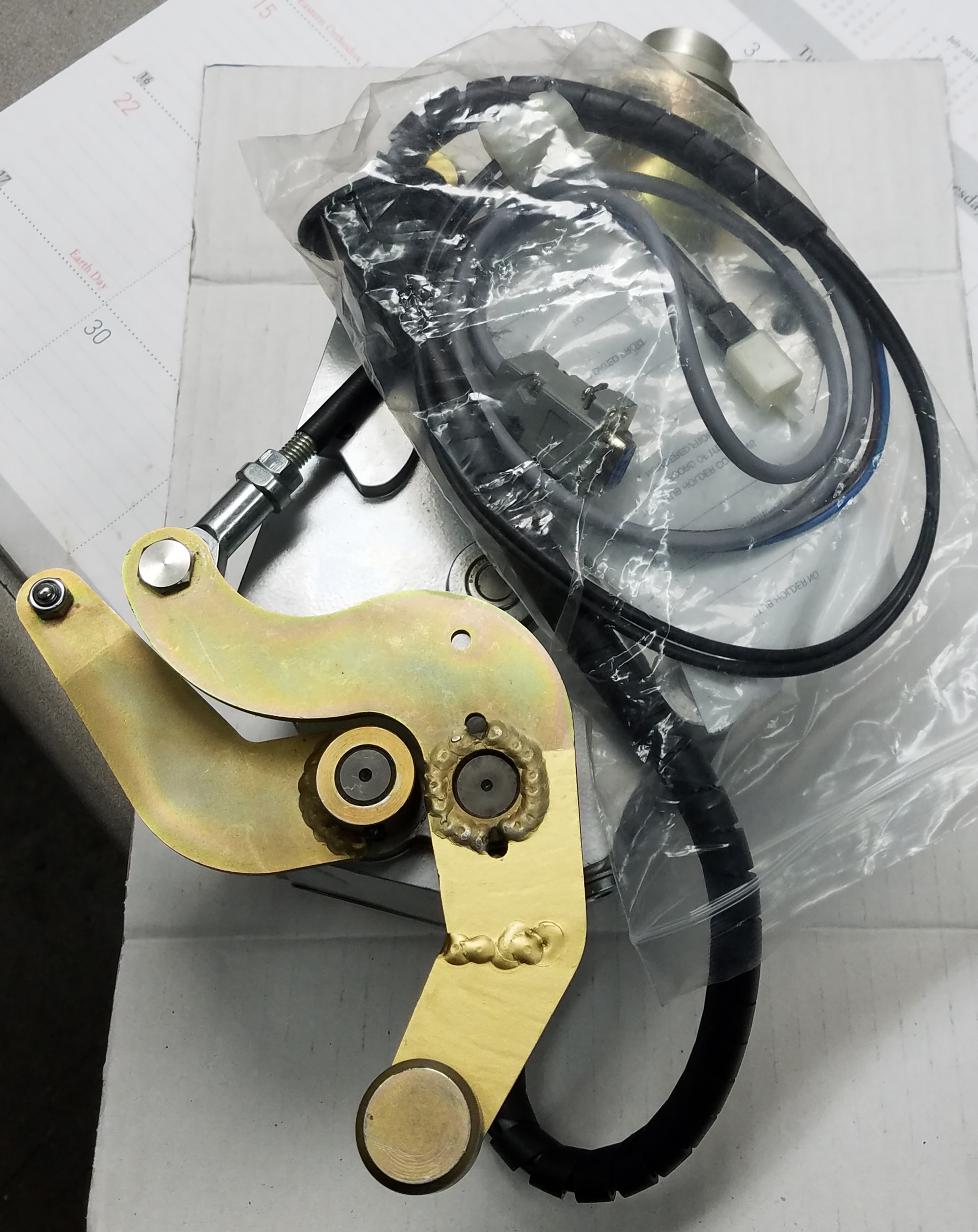

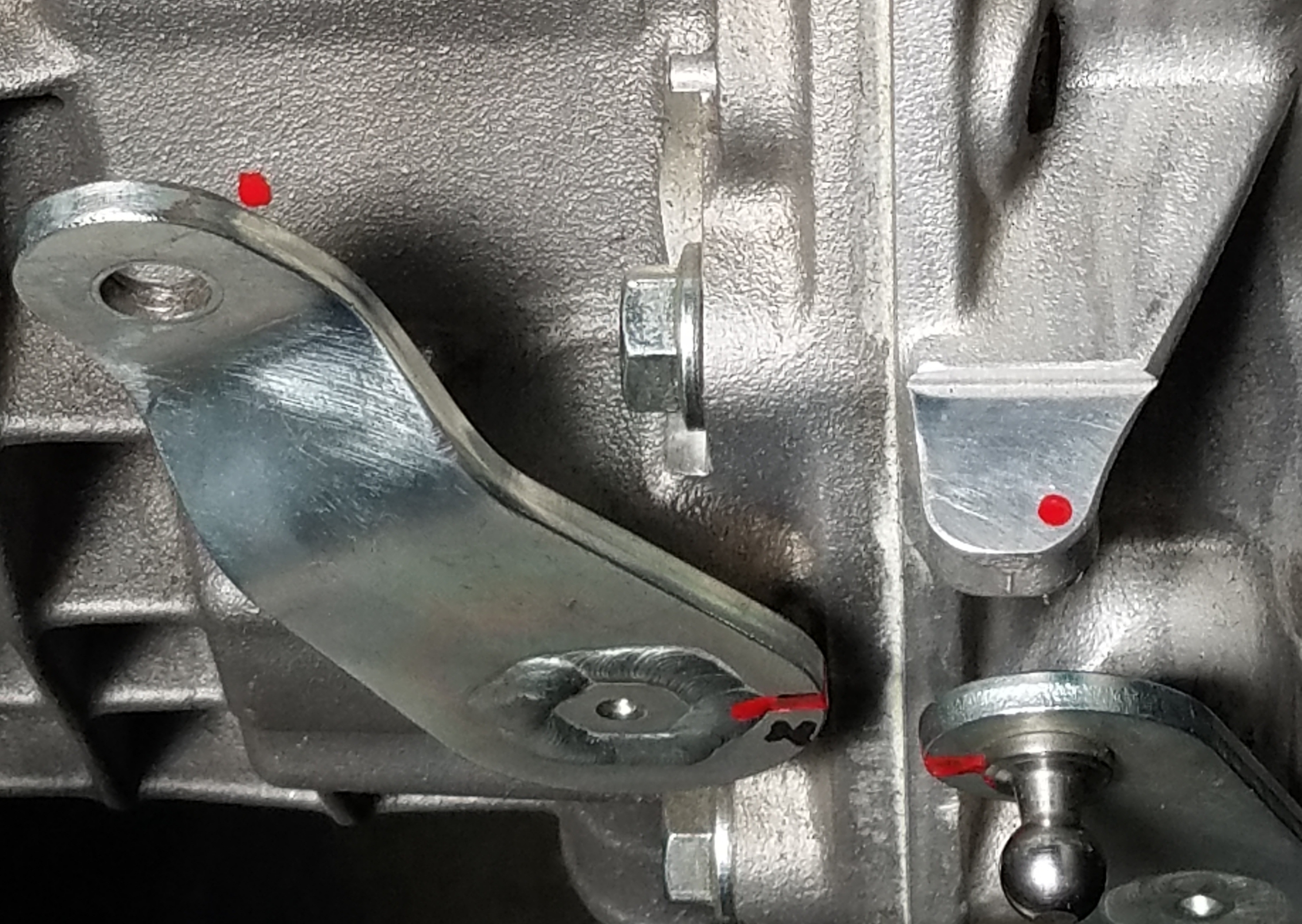

Last mod needed on the SQS sequential shift module; a bit of an angle change to one of the brackets

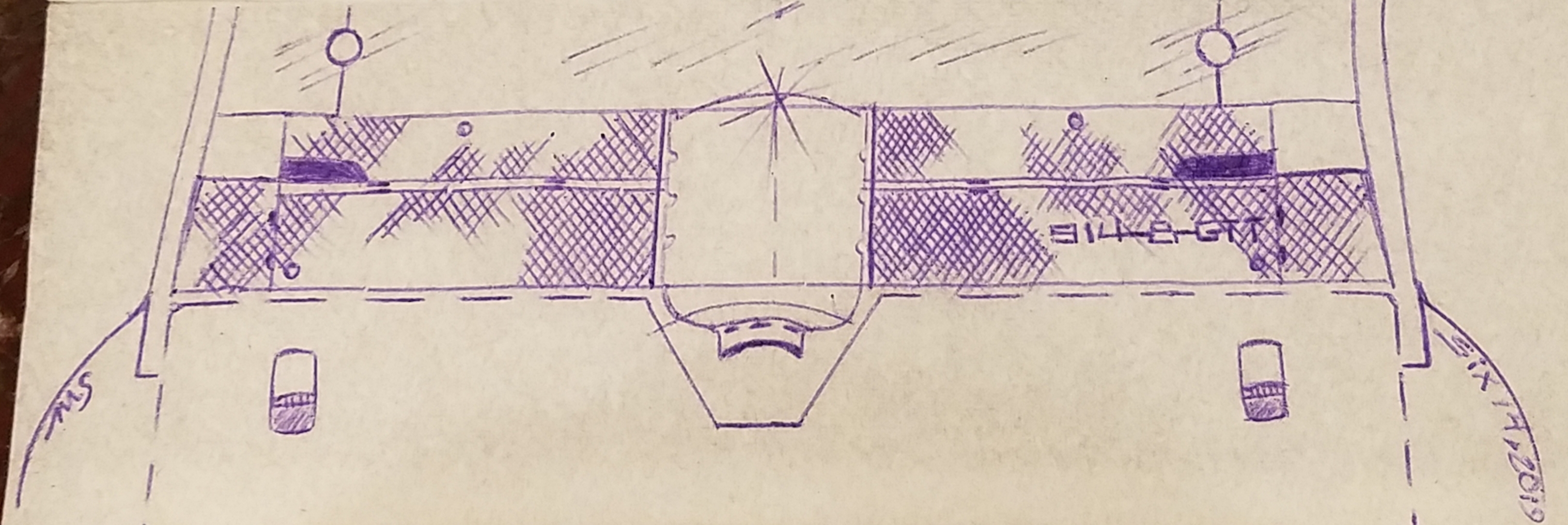

QUOTE(JRust @ Nov 15 2014, 10:48 AM) *
OMG blink.gif . I can't wait to see how that sits in the car. How do you plan to do the engine lid? That is obviously going to stick out the top. Not that I care as I know you have some killer plan. I can't wait to see it man. Seriously sick build aktion035.gif
....somewhat close to this (top view) ball point/napkin sketch; Left and Right grille sections remove independently. Thank you Bruce Stone & Garold for the engine lid grilles, & Chi-town for some misc brake fittings....and Montreal 914 for the targa bar trim biggrin.gif

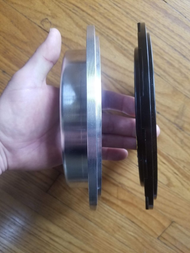

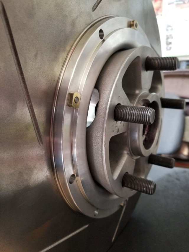

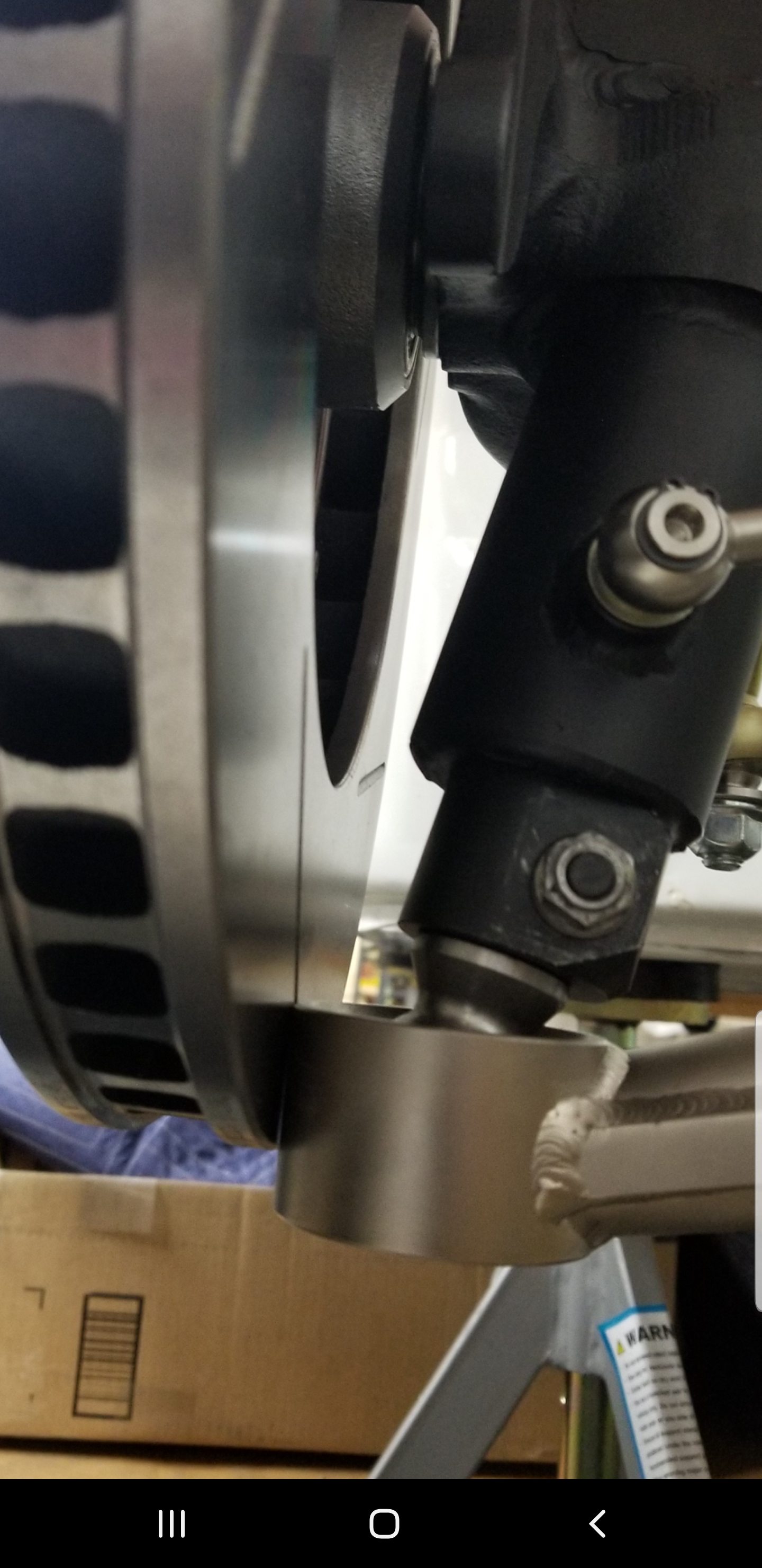

Small bump in the front suspension progress; Stoptech rotors not happy with the ERP/ 935 style ball joints...
Maltese Falcon
Cary over at Eisenlohr Racing Products (ERP) to the rescue with a pair of custom machined offset rotor-hats, sample on the Left .

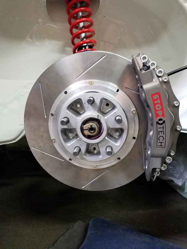

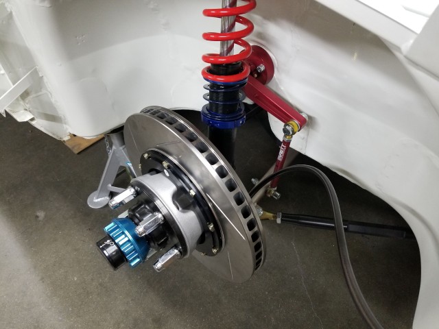

As Marty has mentioned, we're currently dealing with brake fitment.
We had Cary at ERP custom machine us the front hats to extend the rotor outward / away from the lower ball joint for clearance. Now that that issue is behind us, we've centered everything up, and we'll be moving on to wheel measurement!
Disclaimer:The below pictures are from fitting purposes. Missing hardware will not be missing during final install.

Original Hat:
IPB Image
ERP Hat:
IPB Image
ERP Hat clearance:

Caliper fitting:
IPB Image

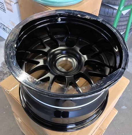

Small updates for now: our Forgeline GW3R centerlock wheels have arrived at Wheel Enhancement/ L.A.
Will proceed to fine-tune the clearence in the wheel wells, might trim out some excess fiberglass inner-lip of the Sheridan fenders.
12x18" rears and 9.5x18" fronts.
Cairo94507
dan10101
QUOTE(Maltese Falcon @ Sep 21 2019, 04:00 AM) *
My dream wheels for sure.
I was just trimming my rear fender yesterday to clear my 11x18 with 295 Hoosier tires. But my fenders are bonded and fixed.
Maltese Falcon
QUOTE(Cairo94507 @ Sep 21 2019, 06:17 AM) *
Many variants of Forgeline wheels we had to choose from, Thank you Sir ¡
Maltese Falcon
QUOTE(dan10101 @ Sep 21 2019, 08:45 AM) *
Having dzus fastened Sheridan fenders and Qtr panels...makes the trimming process that much easier; Deep dish like Chicago pizza / the big meats like Arby's laugh.gif

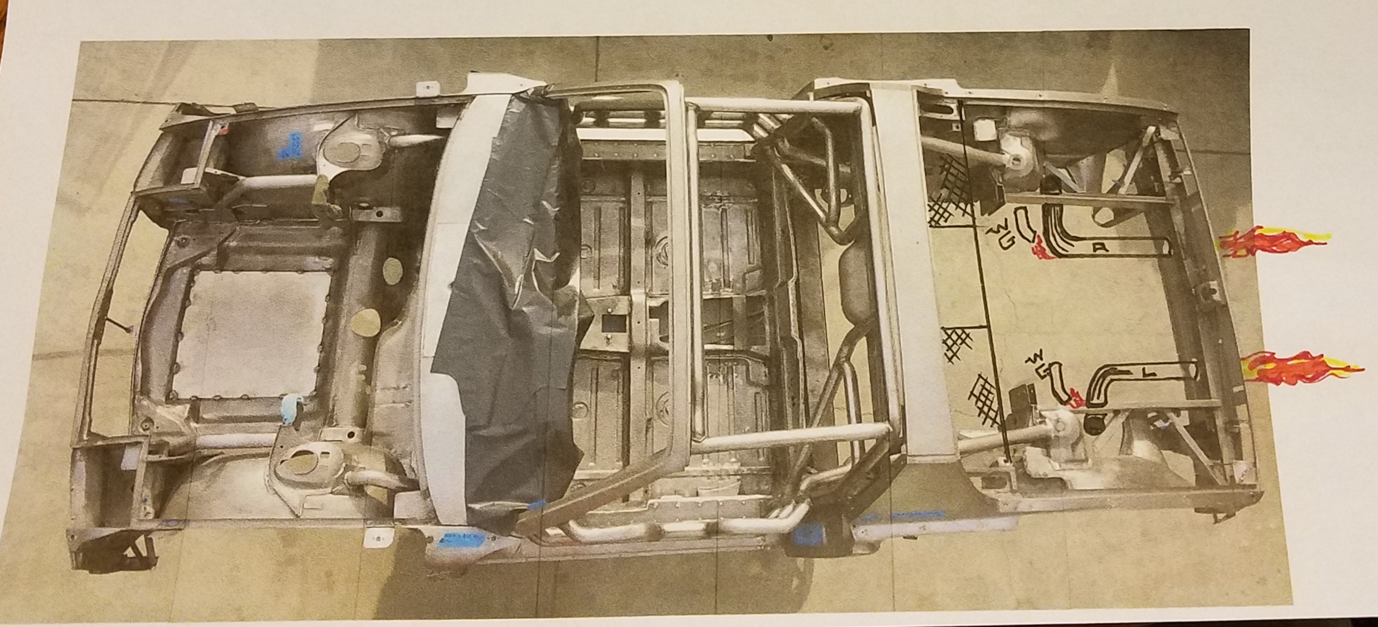

Sketching some of the turbo exhaust routing/ Zork pipes of courseClick to view attachment

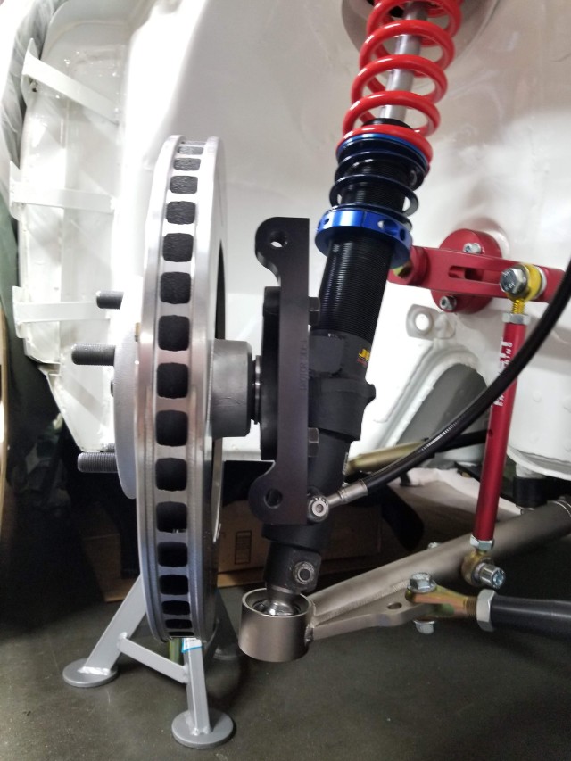

Thanks for the updates on this thread. Has to be one of the all-time coolest 914 builds, and the car as well as the creative thinking continues to stun me. Love it!!
QUOTE(MATTYLITE @ Jun 25 2019, 12:29 PM) *
ERP Hat clearance:
IPB Image
^ This pic stuck out to me, as it brought up a point made by Porsche engineer recently re: the size of 996 wheel bearings (ring design vs central bearing), and that Porsche really started having problems with wheel bearings on its air-cooled race cars when they went to 17- and then 18-inch wheels. Reason: The front tires, wheels, and brake sizes were asking a lot of a wheel bearing design that dated back to 1963-1964.
If I look at this pic, there's a lot of leverage on that wheel bearing, and while that's true for a 185 or 205 or even 225 front tire, I suspect you'll be at 245-285? There are probably people smarter than me with regards to this, and I suspect race cars with slicks are/were a different proposition—but this is one of those things you just want to be sure you're all good on because it's your safety in the car. Maybe a non issue, but raising it respectfully.
