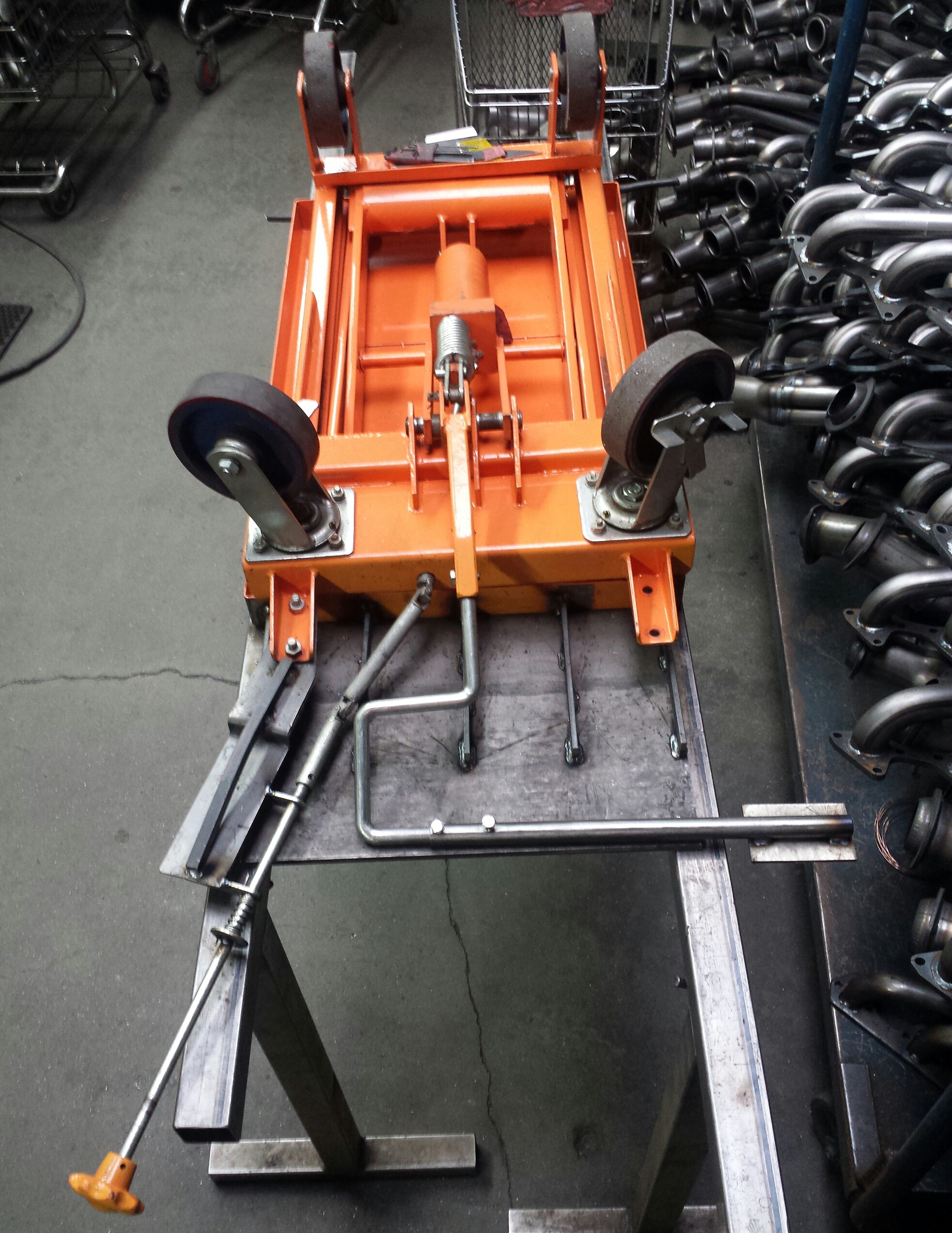

Here's the drive train hoist that we fabricated for about 625 lbs.of engine/Trans placement.
Bottom view; foot pedal, hand control and extended base.Click to view attachment

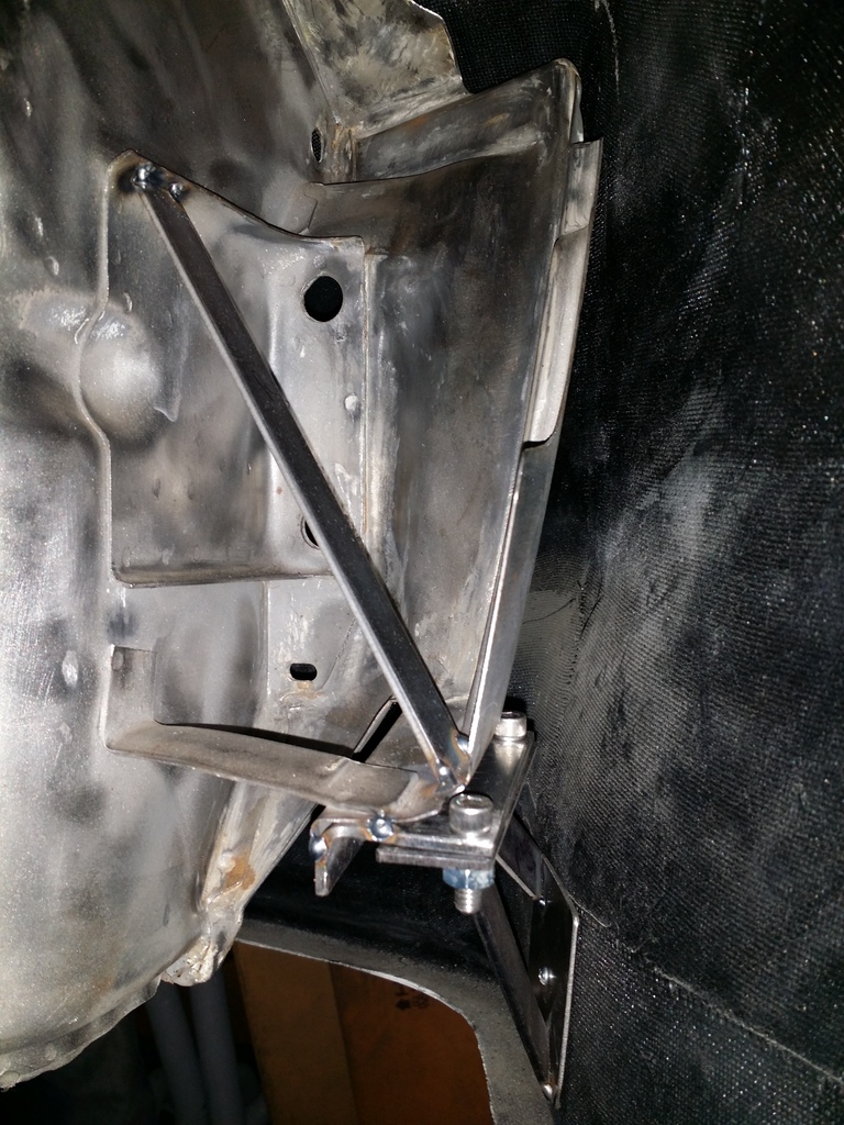

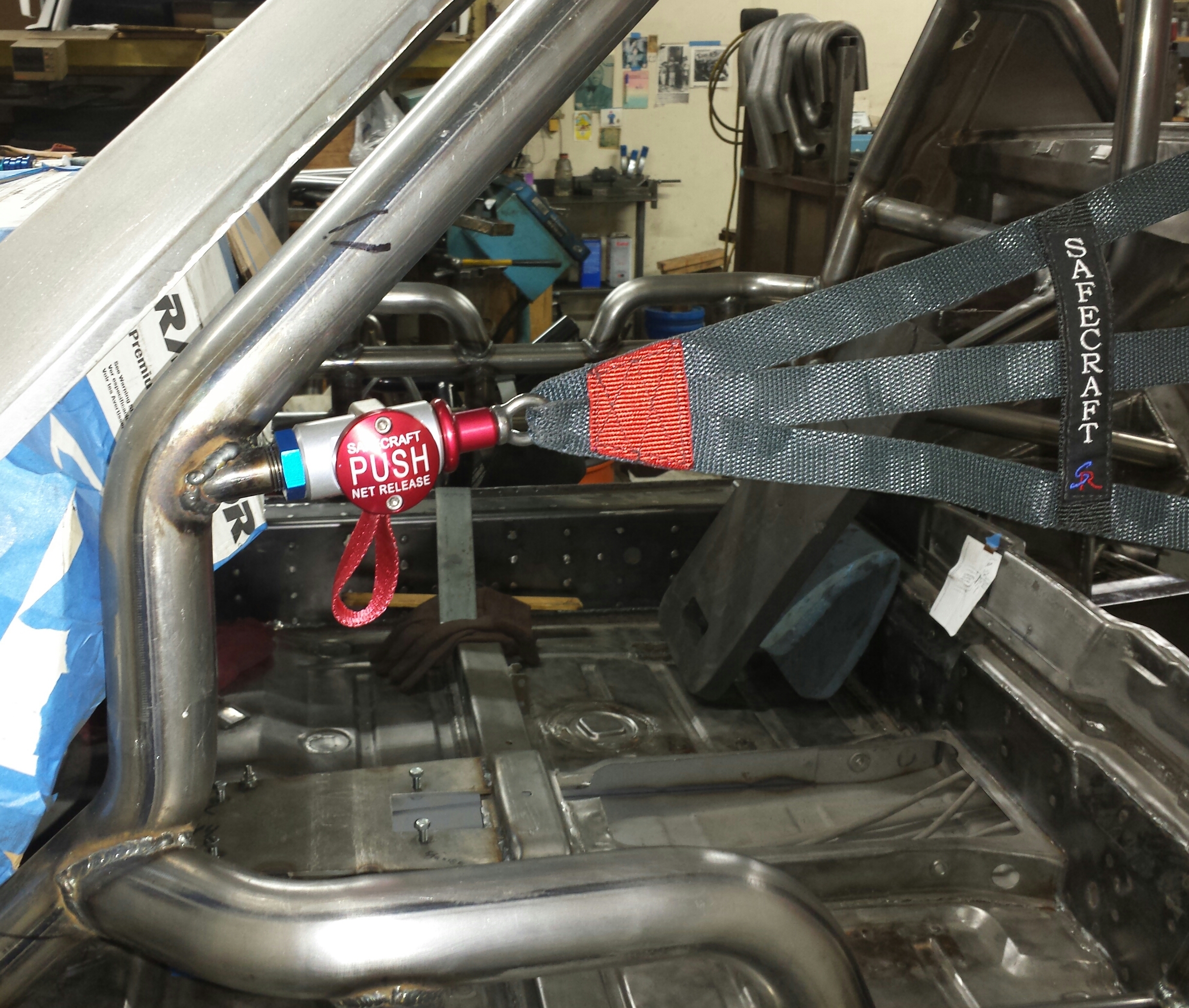

Another view of the quick release for the Safecraft netClick to view attachment

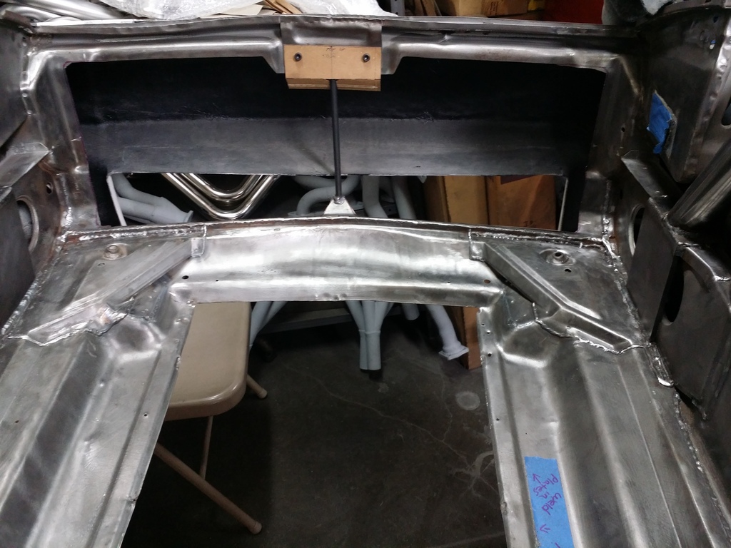

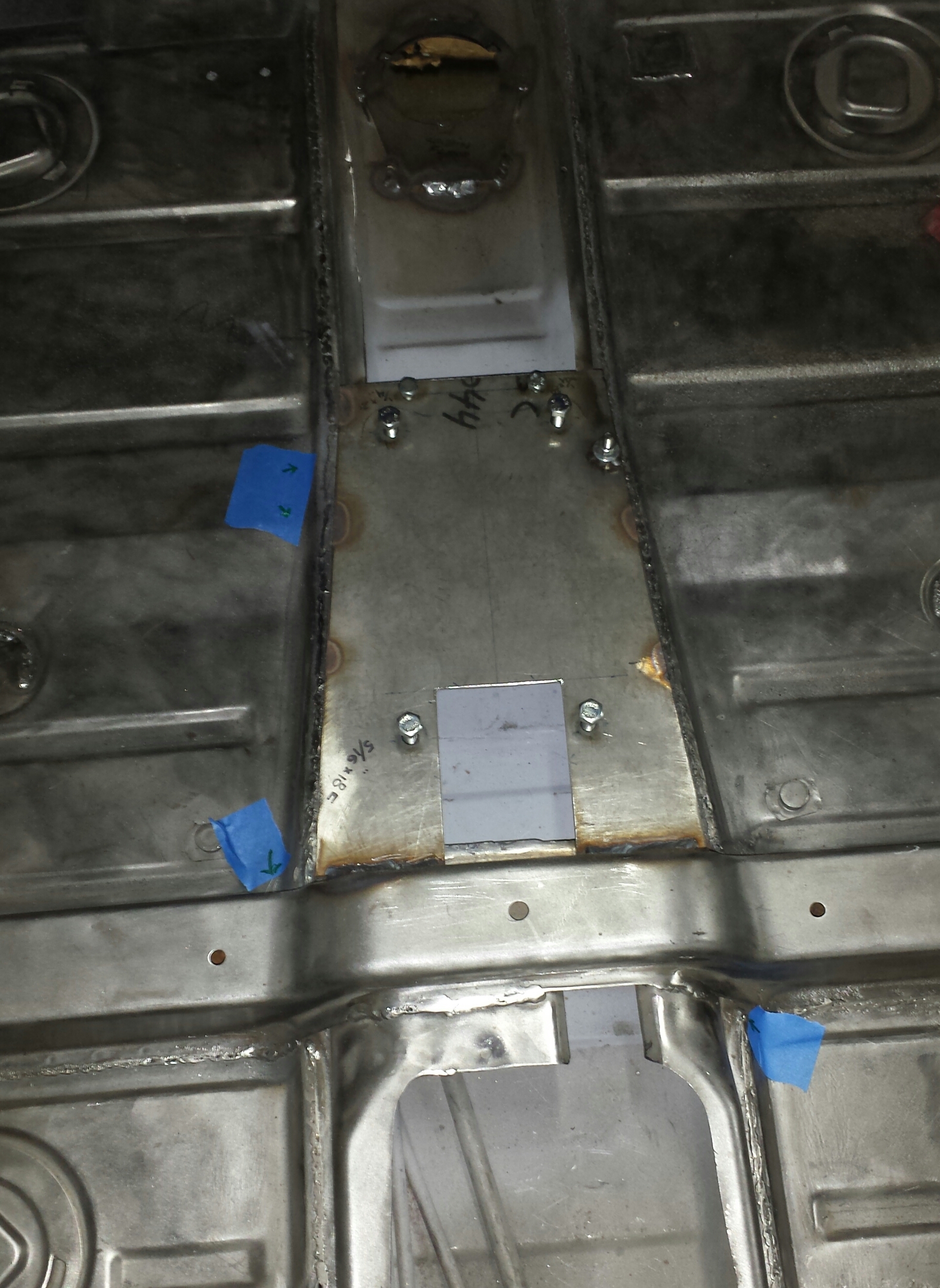

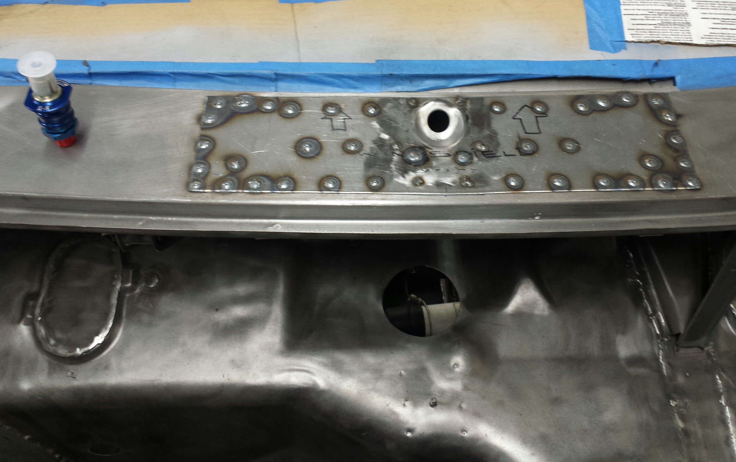

Stainless steel shift tower plate (.250") welded in place, across the tunnel.Click to view attachment
Maltese Falcon
Mono wiper plate now welded down to the cowl.Click to view attachment

Marty,
I was just thinking the other day I probably need a net...I hope my copy-cat is taken as flattery. Would you kindly post a picture of how you fabricated the rearward mounts? Thank you in advance!

Maltese Falcon
Tony, they make the net-strap end real simple to install.
Each of the 3 horizontal straps wrap around the vertical section of the roll bar.
Each strap is held in place with a buckle, similar to the type used on your helmet strap (just wider for this net-strap). No welding at all, makes a real clean installation.

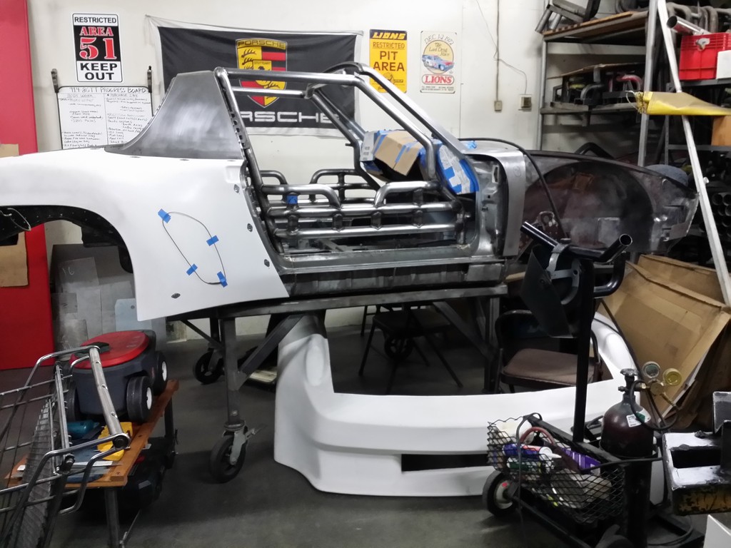

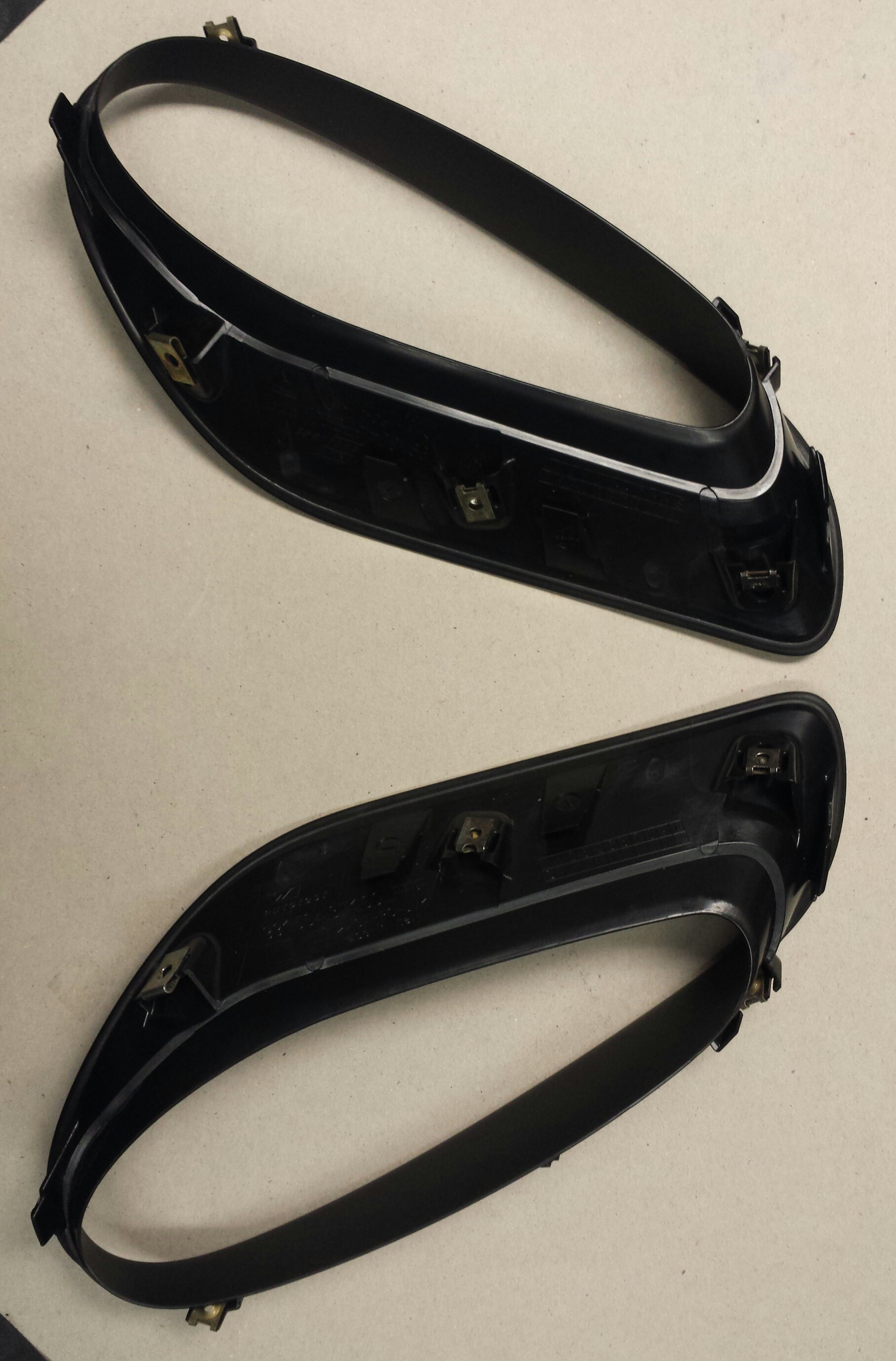

Took a measurement and made an outline off of a gt3RS quarter . I'll sketch it into the rear Sheridan 914 quarters, and install the factory gt3RS ducts.
These will feed air to the left + right rear oil coolers. Always handy to have another Porsche nut in the neighborhood blink.gif

Here's the layout on the quarter panel itself.

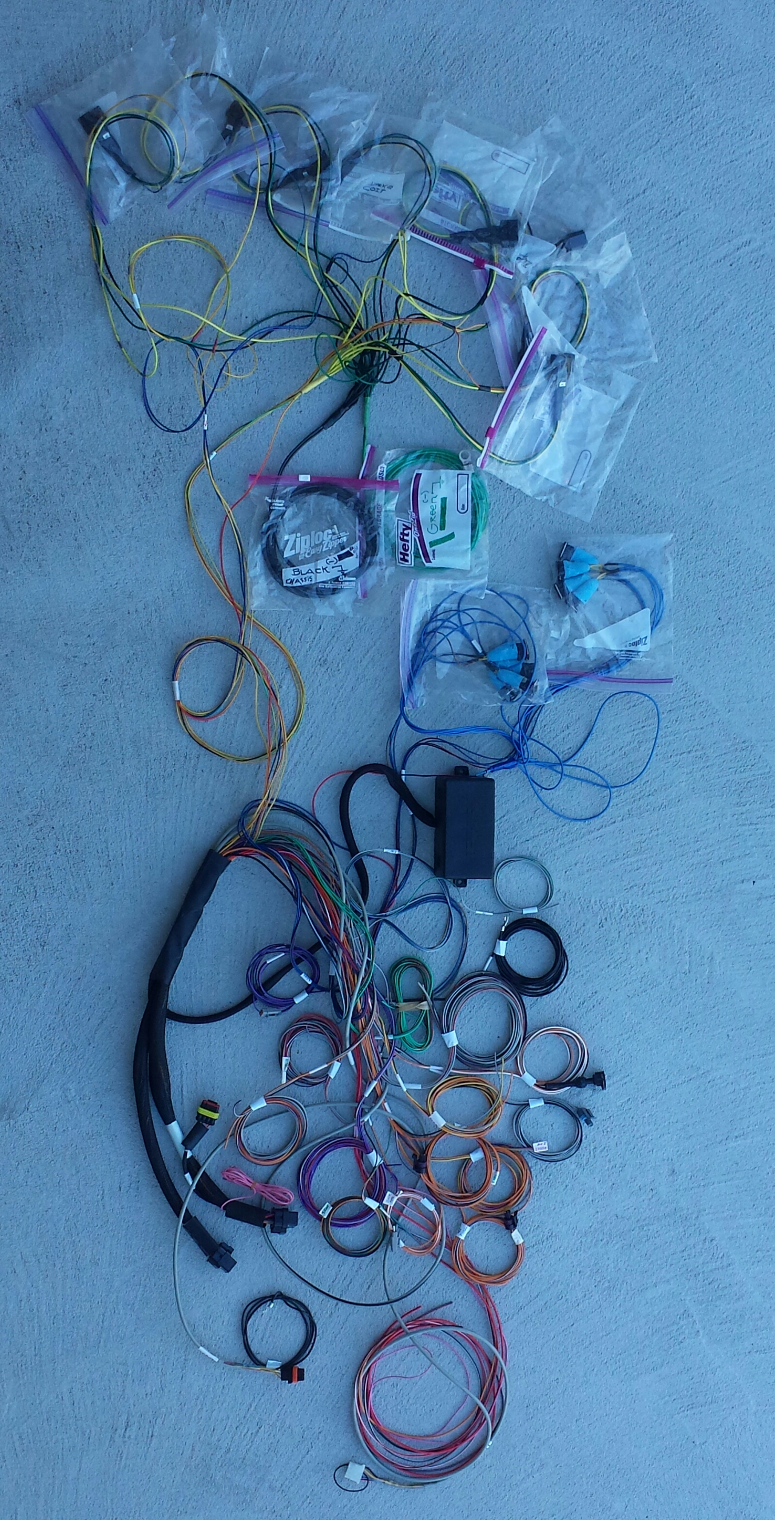

One more item completed; hand built ecu harness for the Haltech Elite 2500 management system. Designing the custom schematic and the harness build was fun , the Weller soldering gun got her done ! The Porsche Cayenne TT ecu is not tuneable for anywhere near the needs of this 5.0Click to view attachment
Cracker
Very nice Marty...I'm glad those days are over!

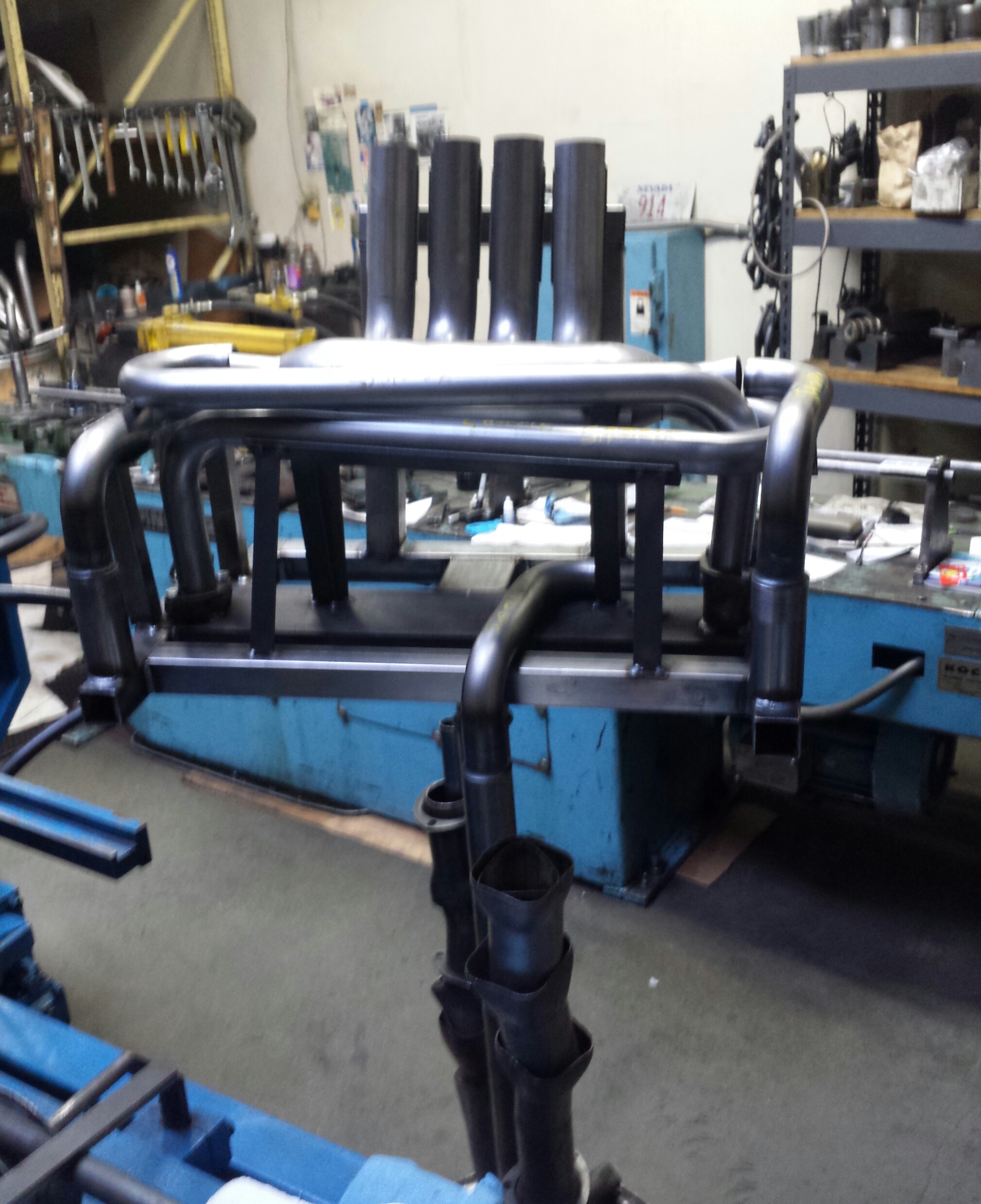

Alphaogre
What bender are you using? You got some mad bending skills! pray.gif lookin good!
Maltese Falcon
QUOTE(Alphaogre @ Apr 2 2016, 08:55 PM) *
Using our Teledyne-Pines N° 2 rotary hydraulic mandrel tube bender. After I sketch out the design, I use 3/4" dia. emt tubing / bend up with a contractors conduit bender. Then take the samples to the mandrel machine and produce the 1 3/4" dia ×".120 wall bends. The rest is cutting, and finishing to spec-fit, welding, repeat for the other side.
It's also what I've been doing since 1976...so it's kind of my craft...definitely no short cuts to it !

Here is a "Continuation " product that I haven't made in about 35+ years, some customers want these again. For the Manx + dune buggy guys, the MSDS Baja Eliminator.
Cool angles and precise bending going on here in the extractor header, and 4 over the top exhaust tips. Click to view attachment

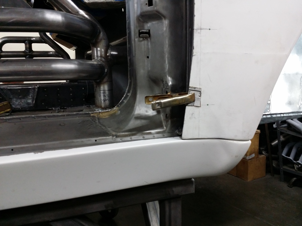

IPB Image
IPB Image
IPB Image
The nuts and bolts behind the fiberglass fitment:
IPB Image

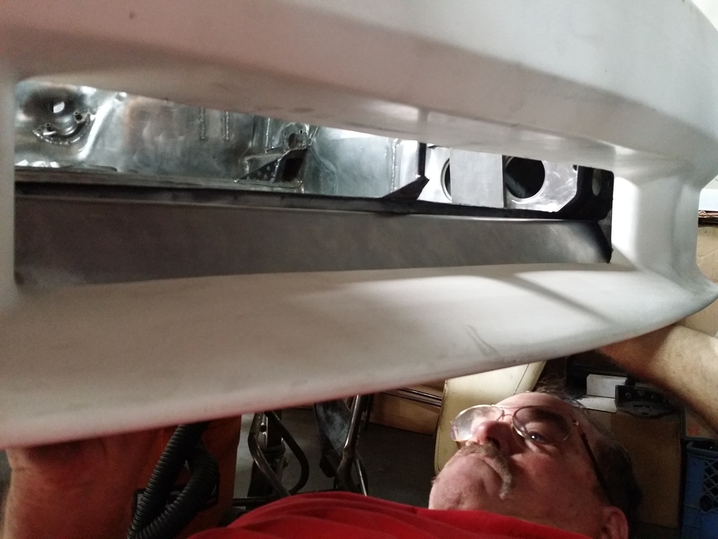

The wide opening intake for the radiator (note, the square opening on the bottom will be welded up):
IPB Image
The intake end for the radiator air flow with the maestro at work:
IPB Image

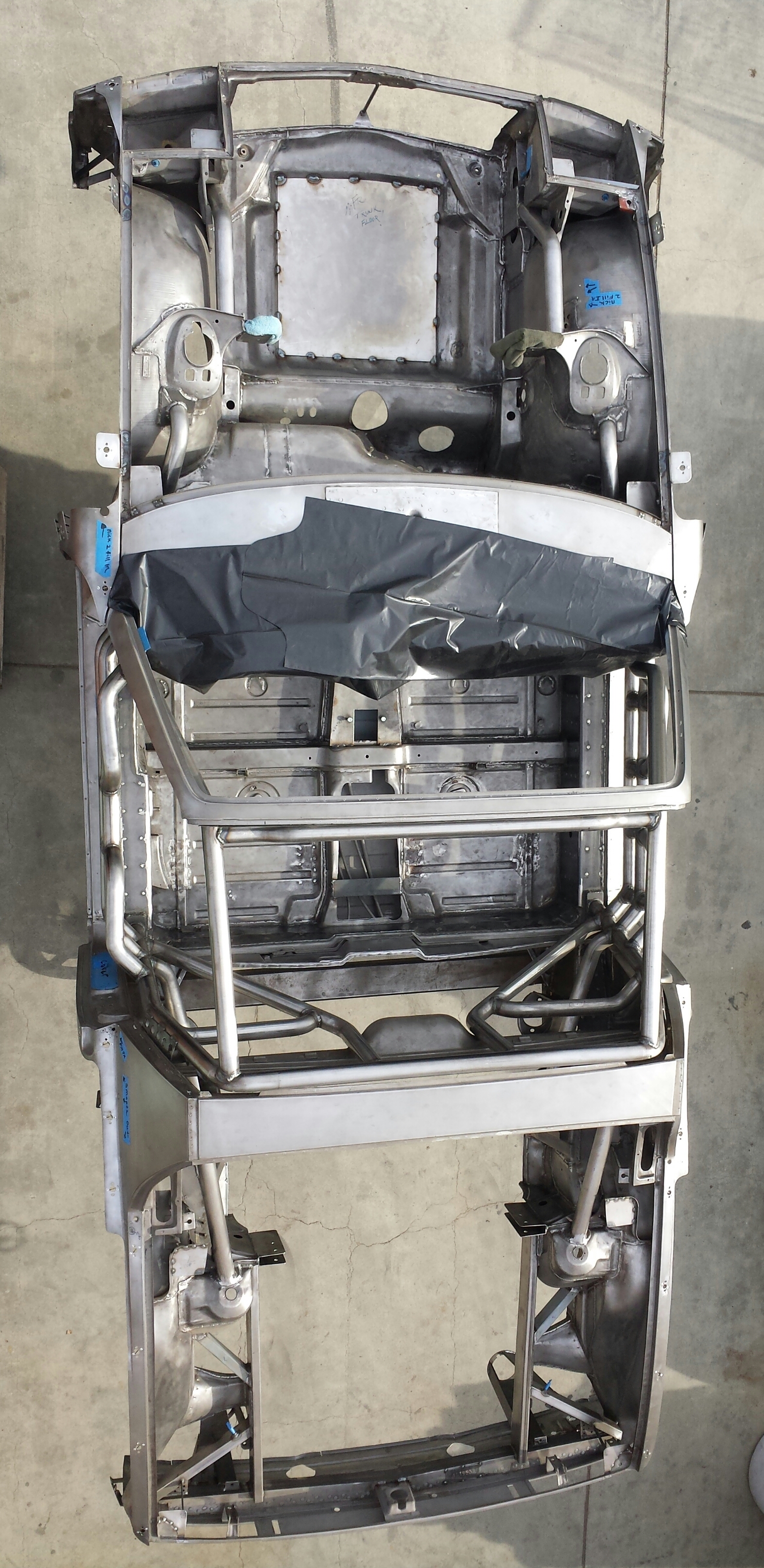

Some aerial photography today...off to the paint shop now. Don't you just love Body Shops blink.gif ?Click to view attachment

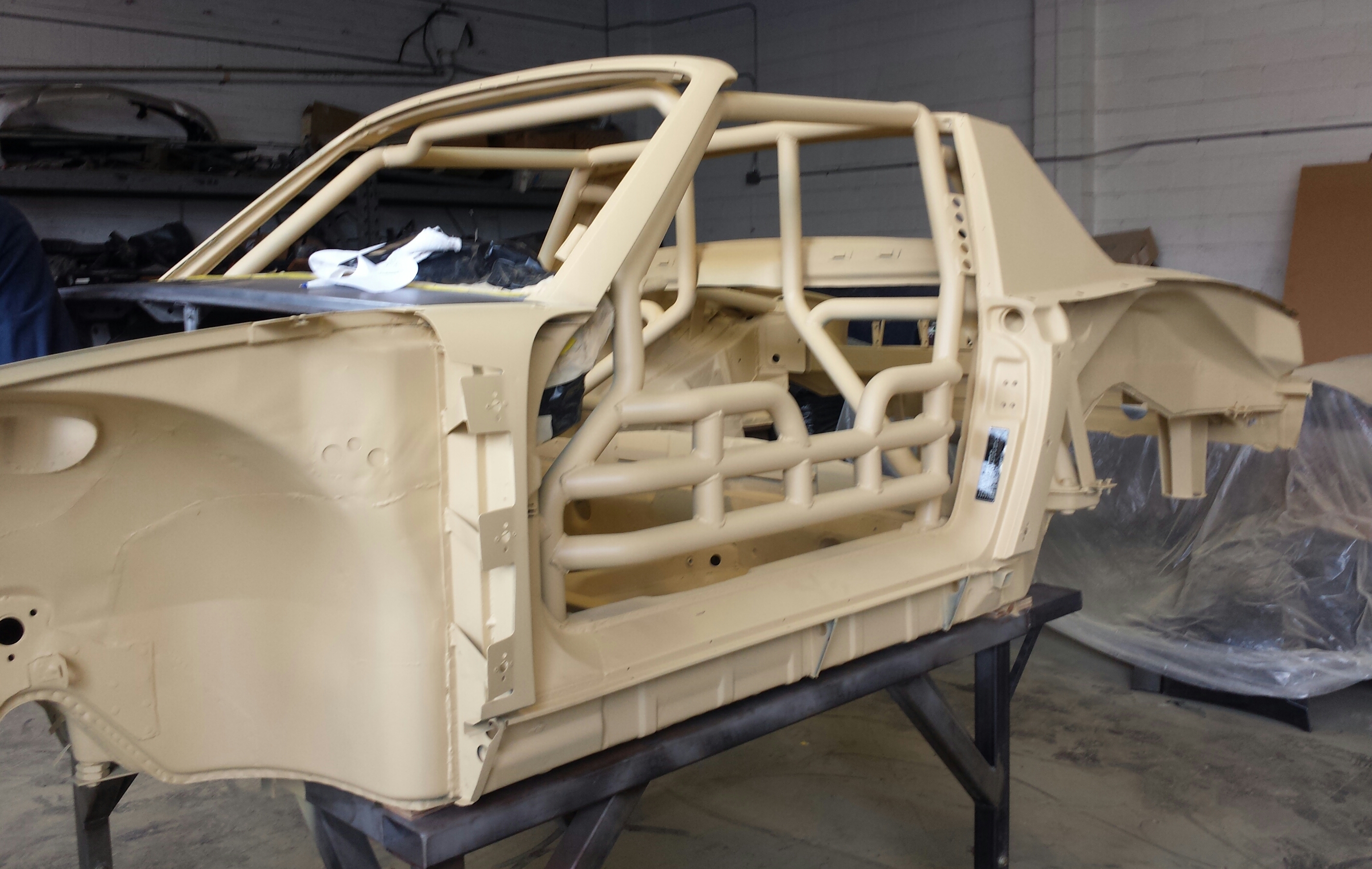

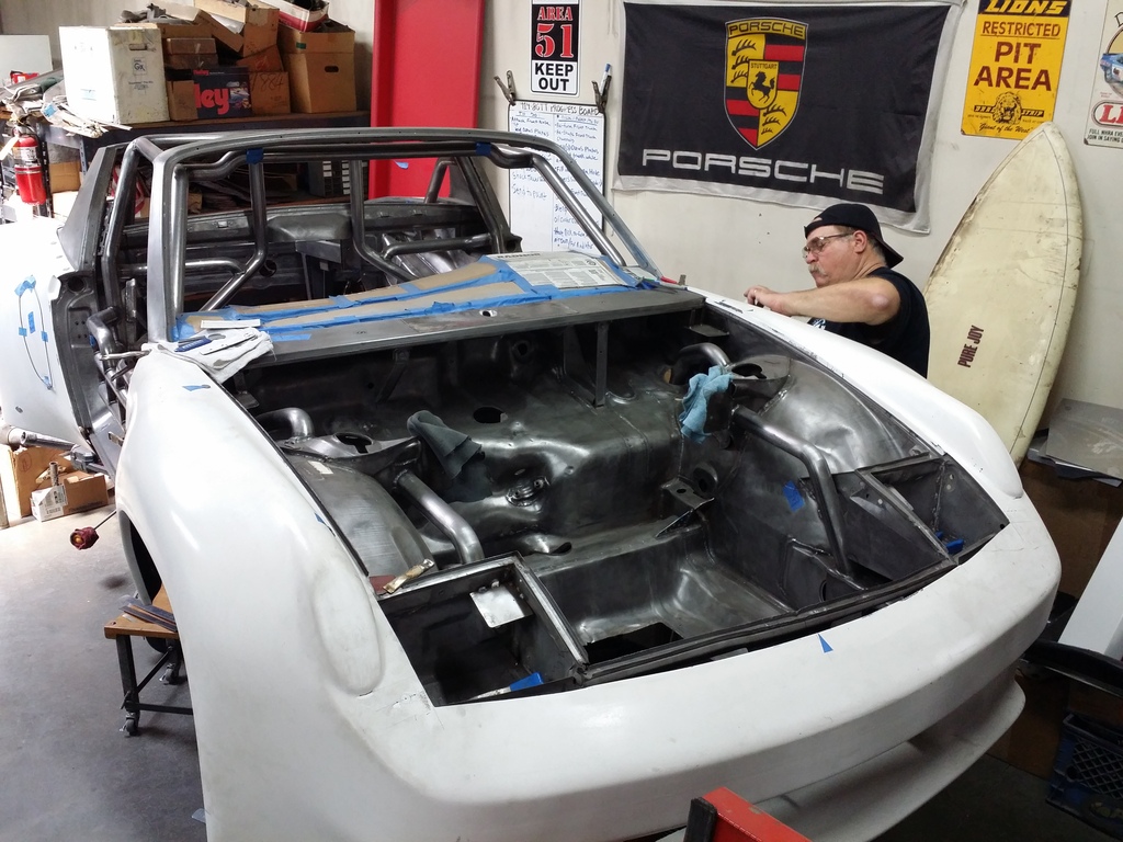

914 meets primerClick to view attachment

Maltese Falcon

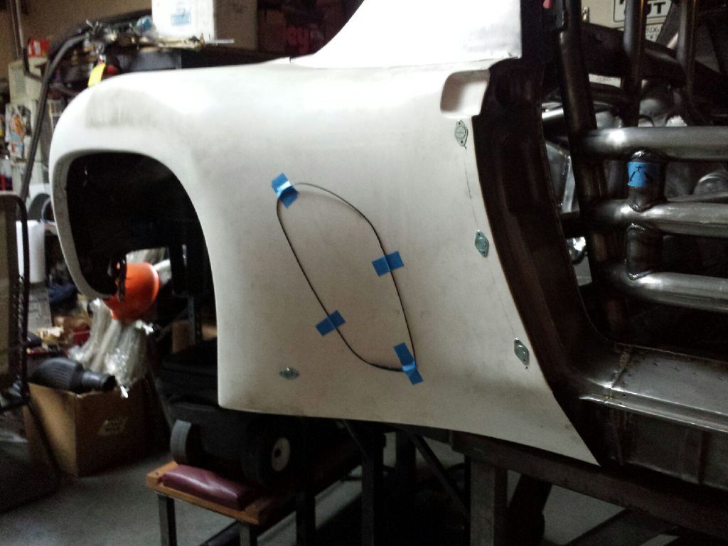

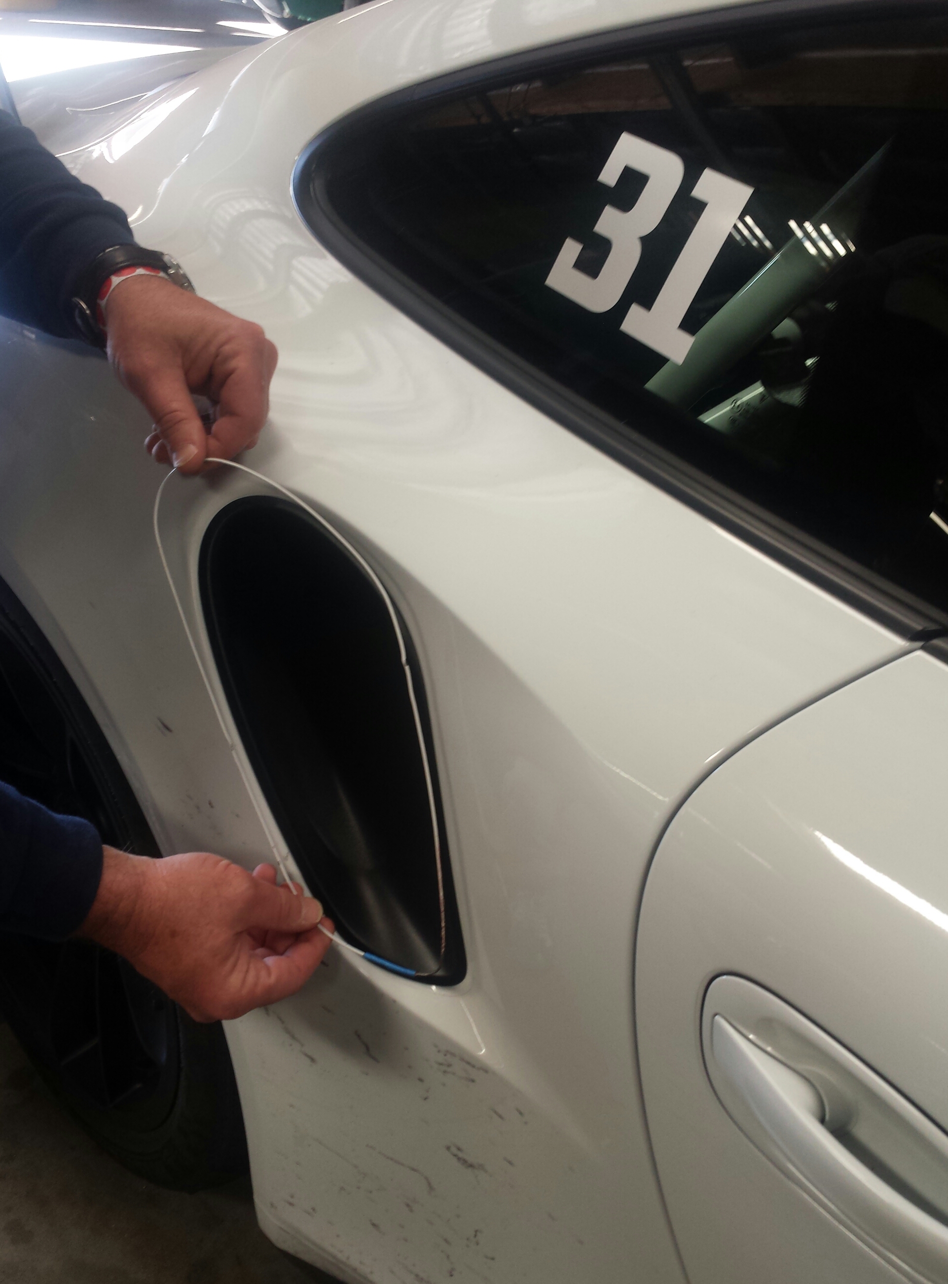

Simple clip/screw attachment to the GT3RS fender ducts, this will keep them in place on the Sheridan quarter panels. After placing my template down to the fenders, I only had one chance to correctly cut the fiberglass...and I nailed it smile.gif Click to view attachment

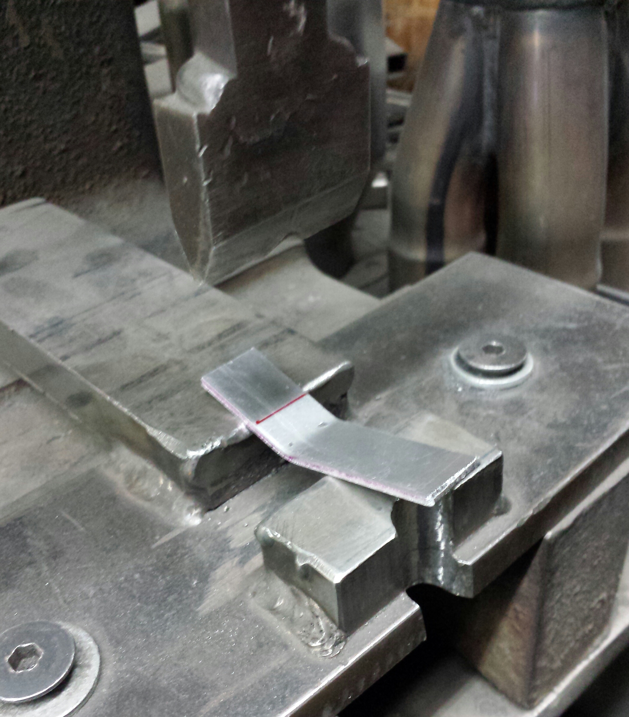

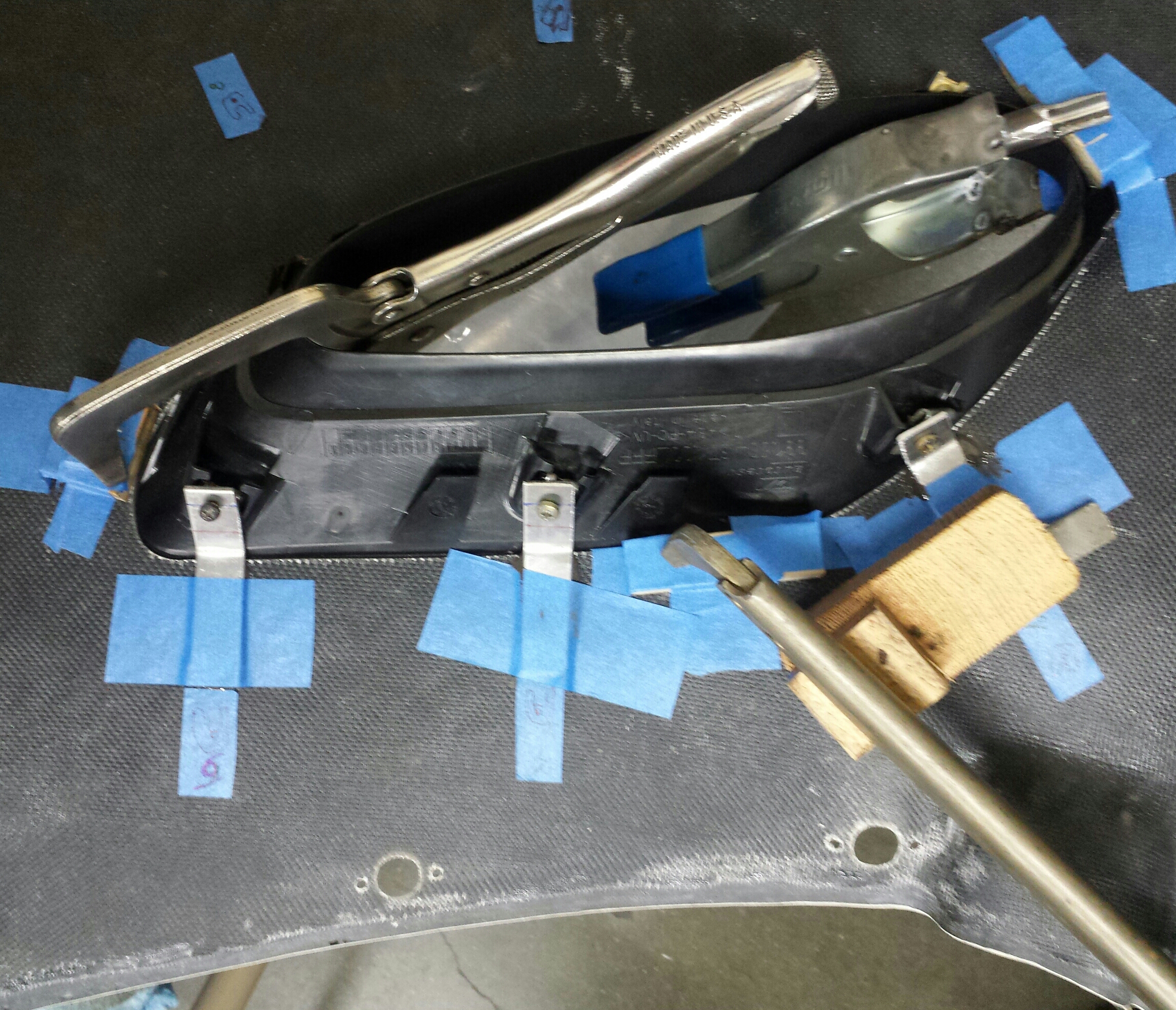

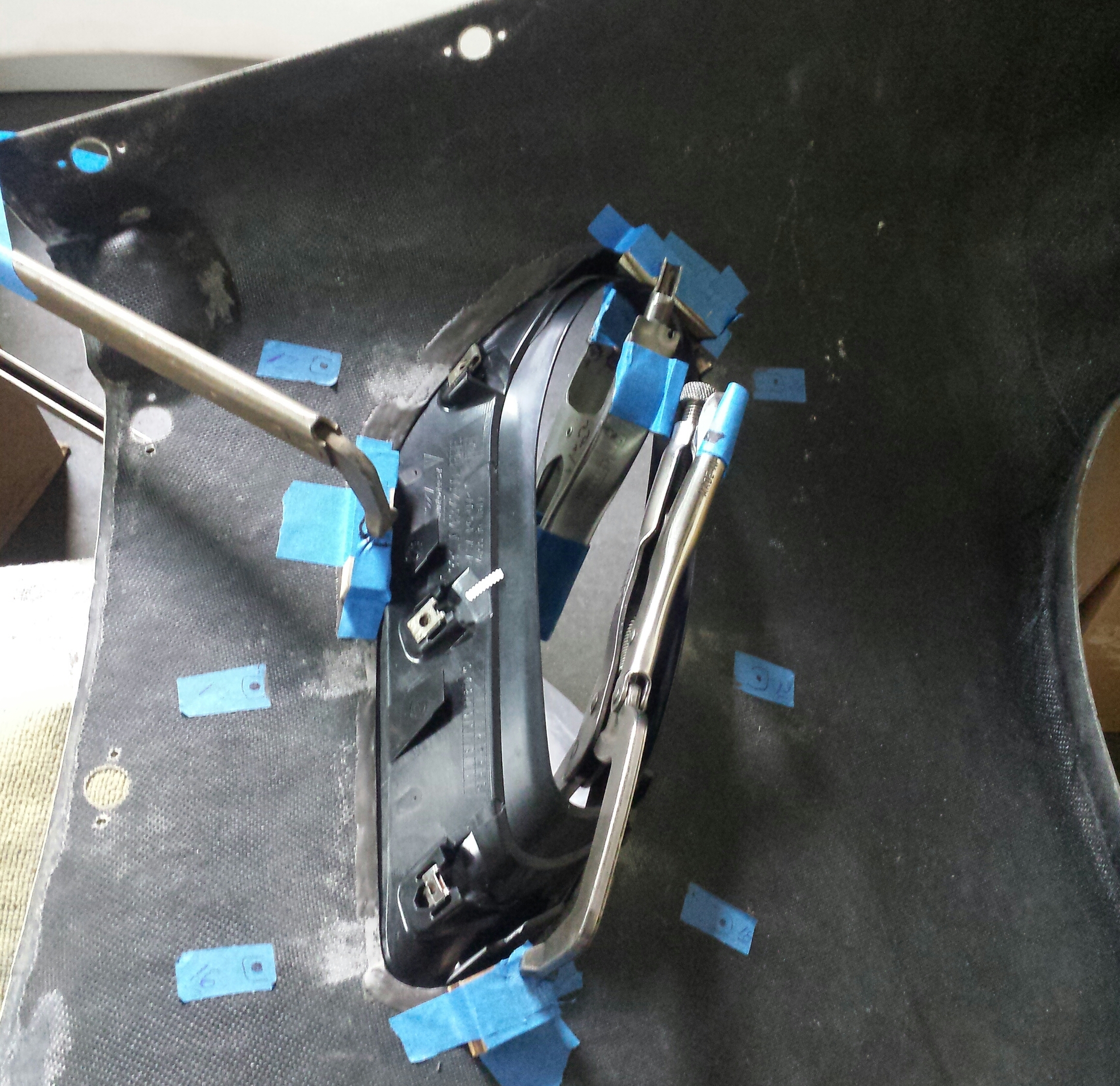

Fabricating the support brackets for gt3rs air ducts ; installing into rear Sheridan quarter panelsClick to view attachment
Maltese Falcon
The set- up with rubber tipped vise grips, clamp; the contours of the ducts are made for 991 fitment; clamps help relax the duct into the Sheridan fender, which has a real close contour to the 991 but not exact. Each bracket (6 tot) has its own mating angle to the duct fastener. Simple JB epoxy and a 24 hour set up time, and complete.
Maltese Falcon

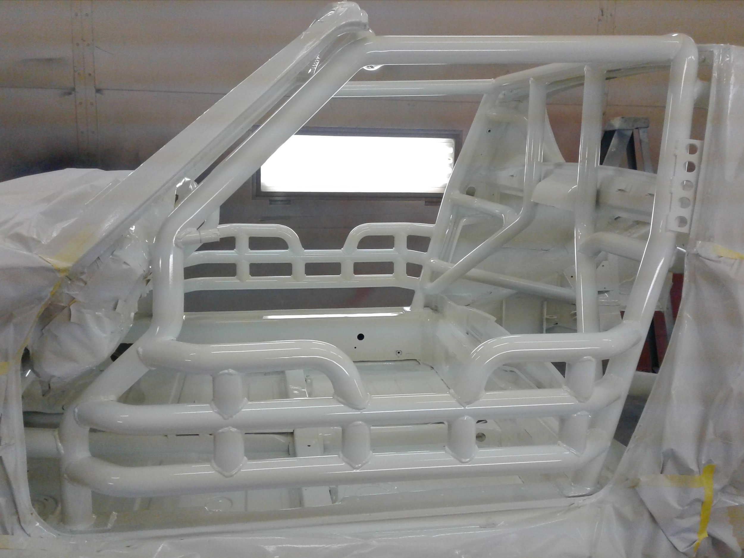

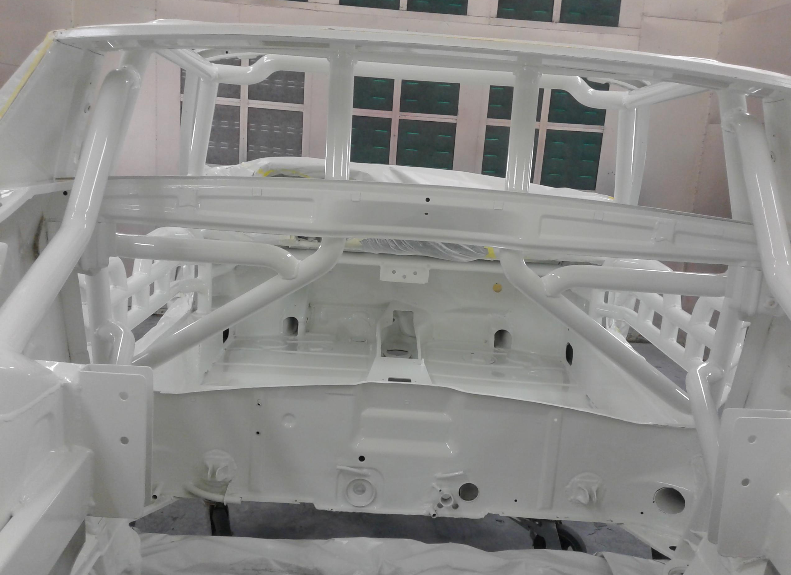

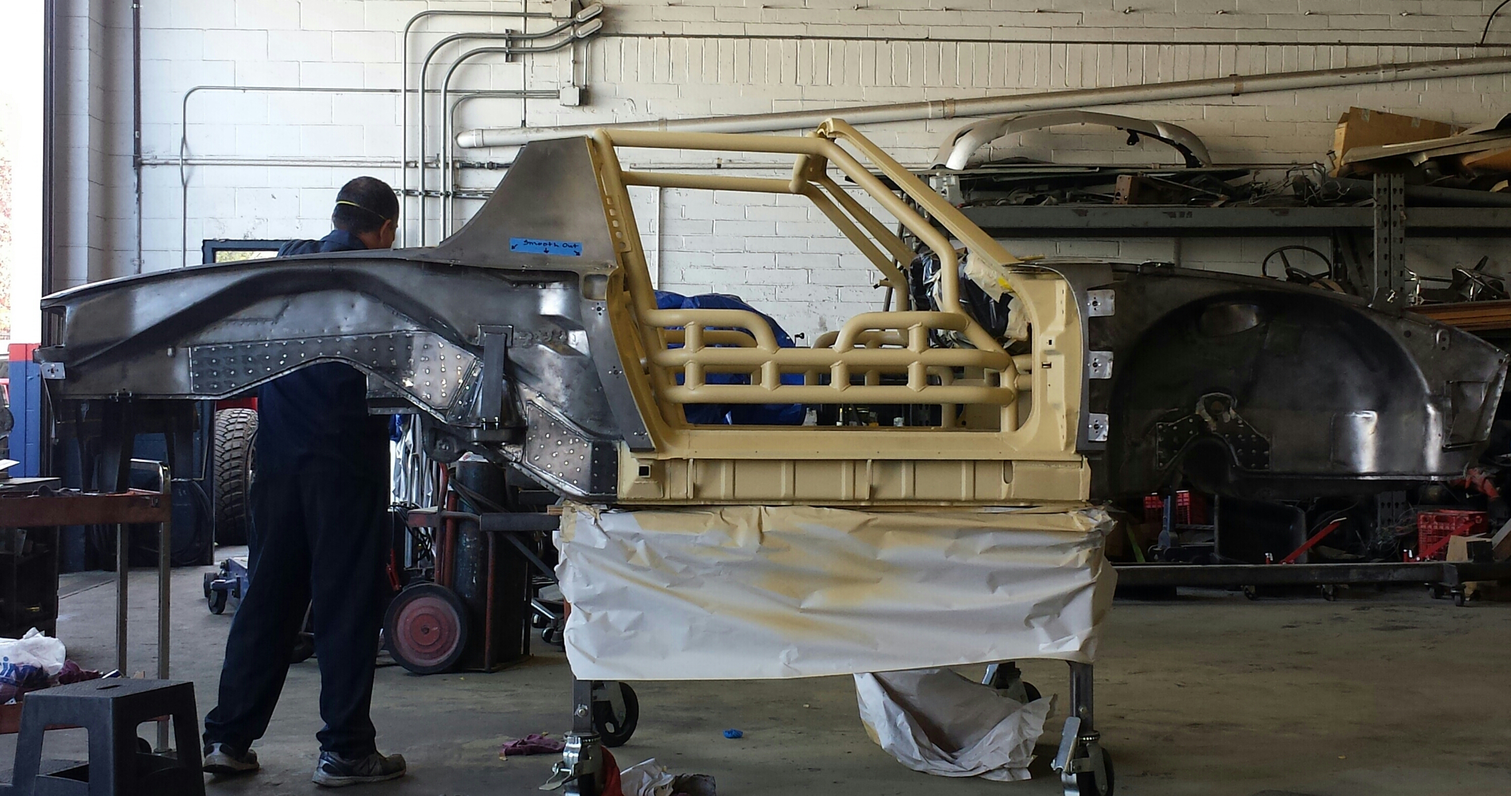

Some action in the paint booth : GP whiteClick to view attachment
Maltese Falcon
...one more GP whiteClick to view attachment

that's a frame for a 1000HP engine!

Thanks guys for your comments ! Another view from the paint dept.Click to view attachment
My 914
I don't think you'll have any problems with twisting.
Maltese Falcon
QUOTE(My 914 @ May 23 2017, 01:59 PM) *
Twisting is Verboten ¡!
