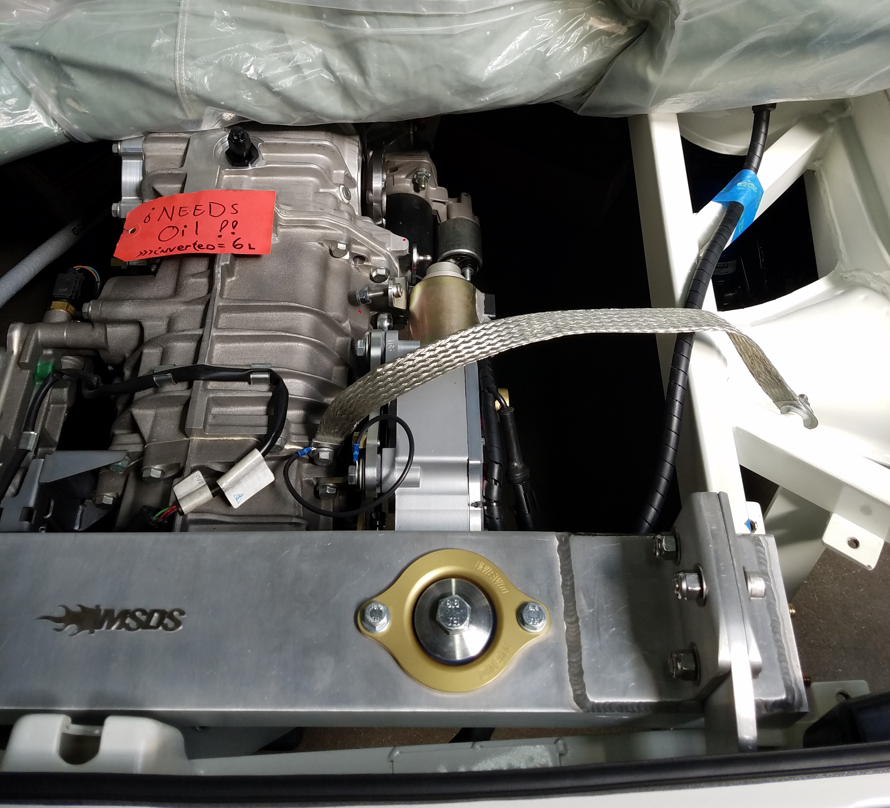

Ground strap

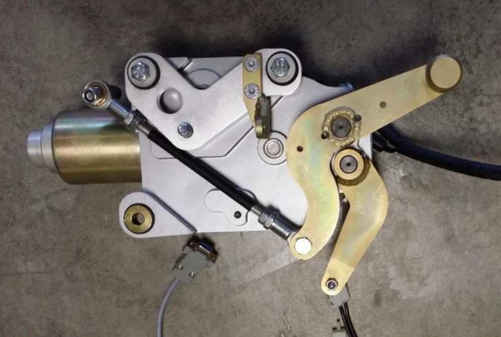

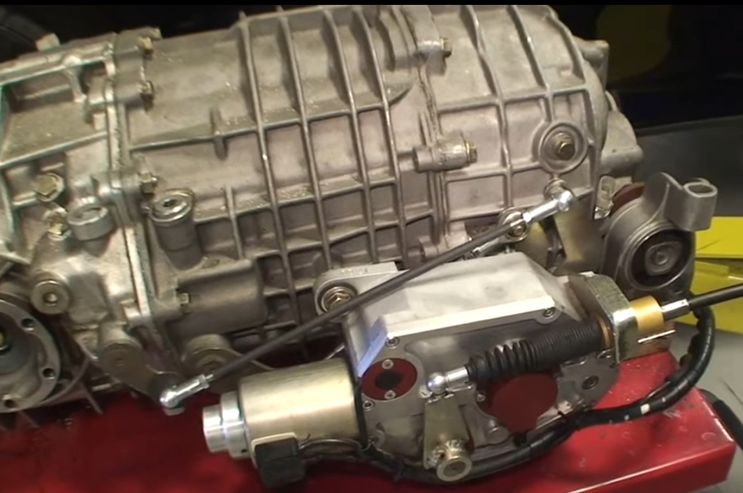

SQS shift-solenoid module...as it comes out of the box , before modifying the counterweight for (mid engine) trans mount clearance
Maltese Falcon
Mounted on the gt2 transaxle

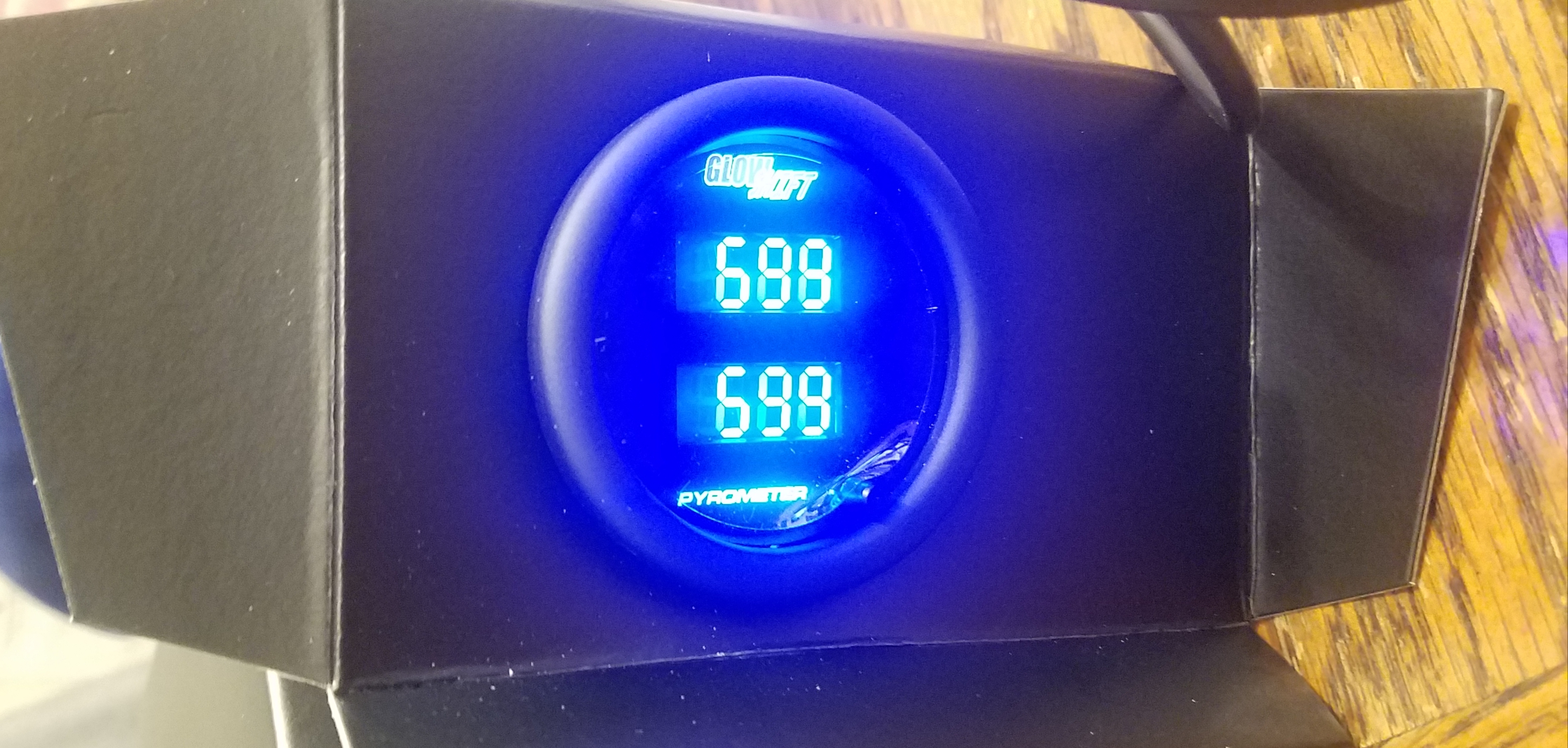

New arrival: GlowShift (brand) dual egt pyrometer, we can monitor both Left and Right bank exhaust temps at a glance

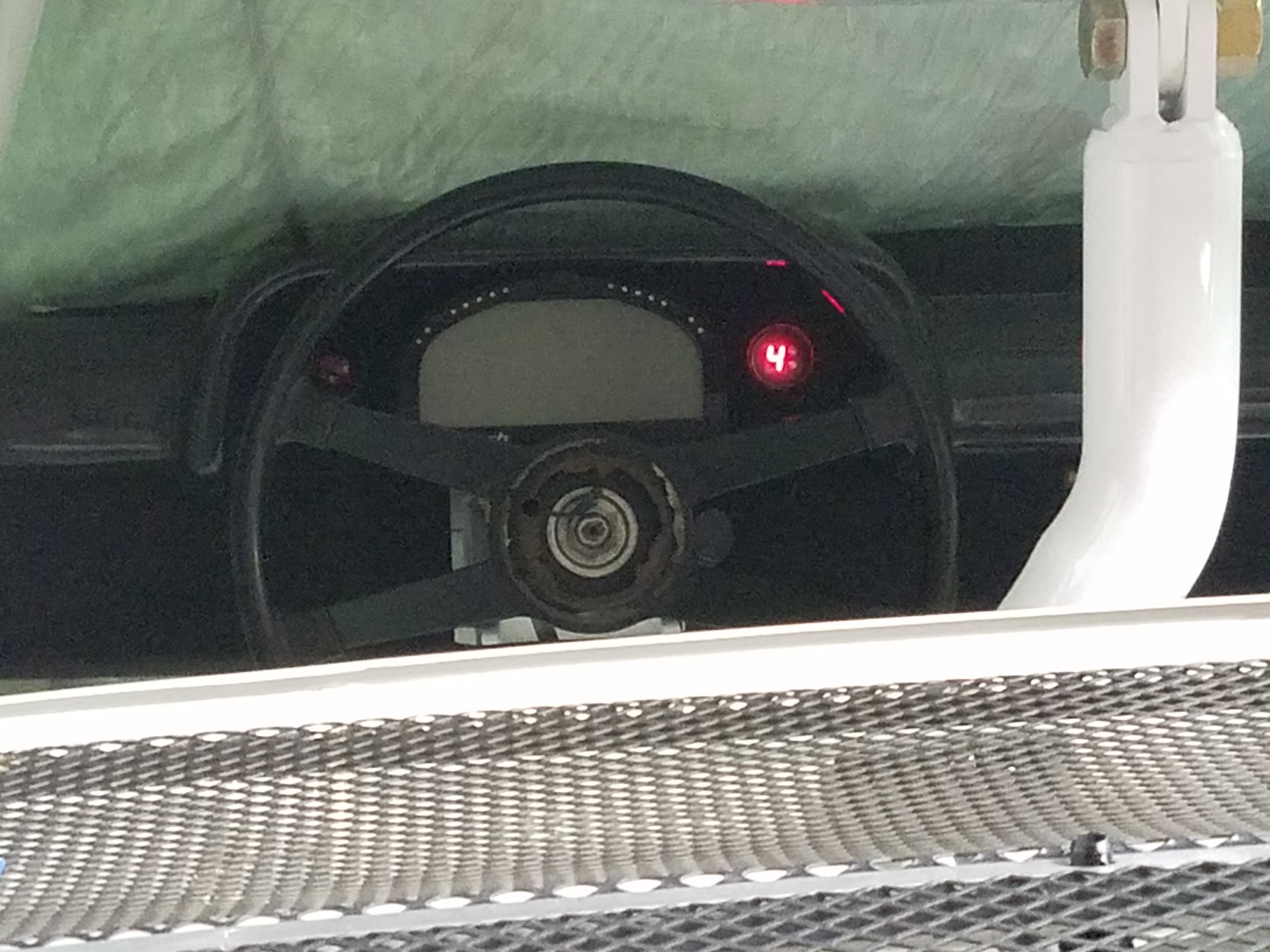

SQS gear display...looks like 4th

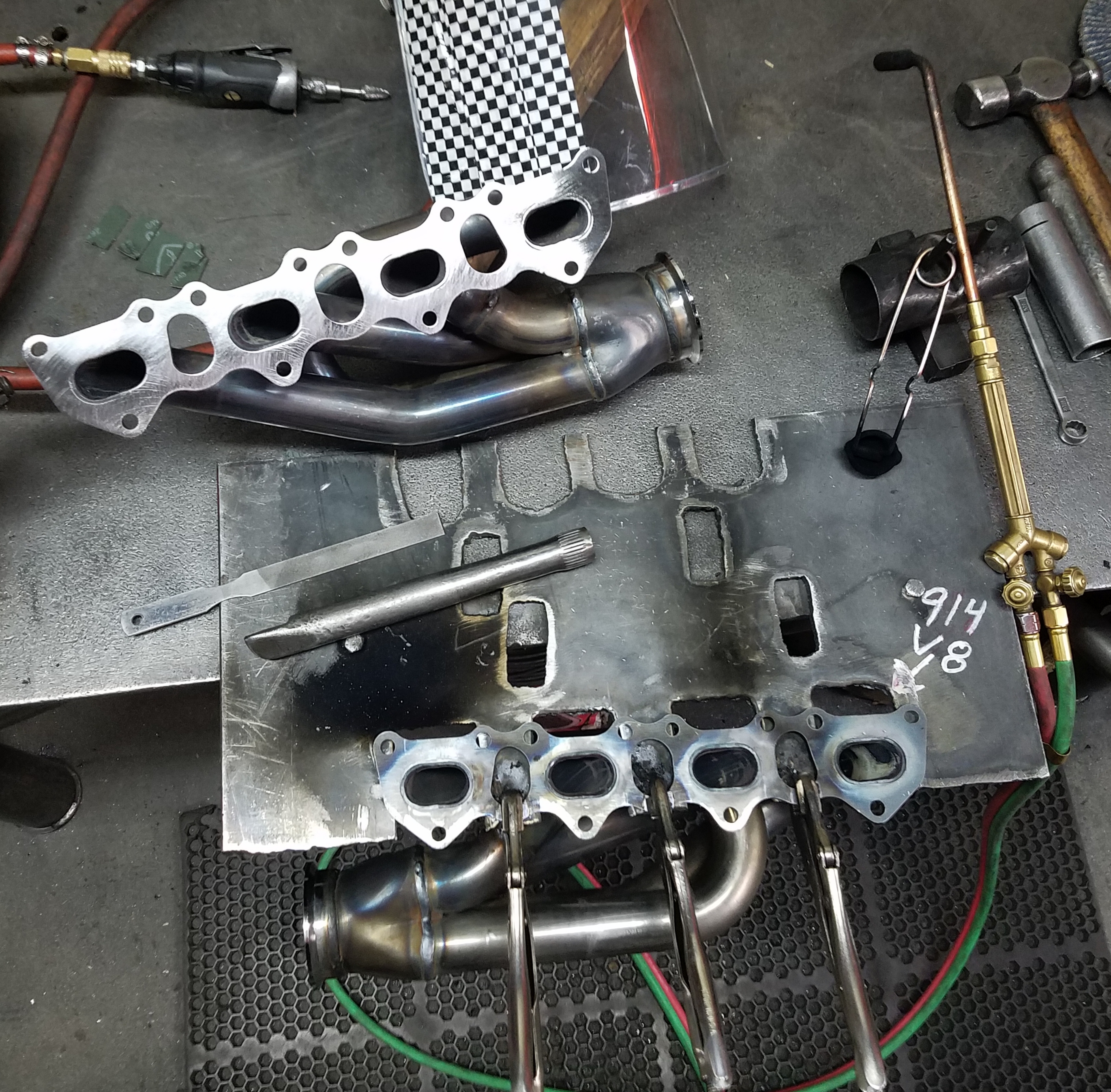

Daily grind...several steps in getting the flange surfaces flat

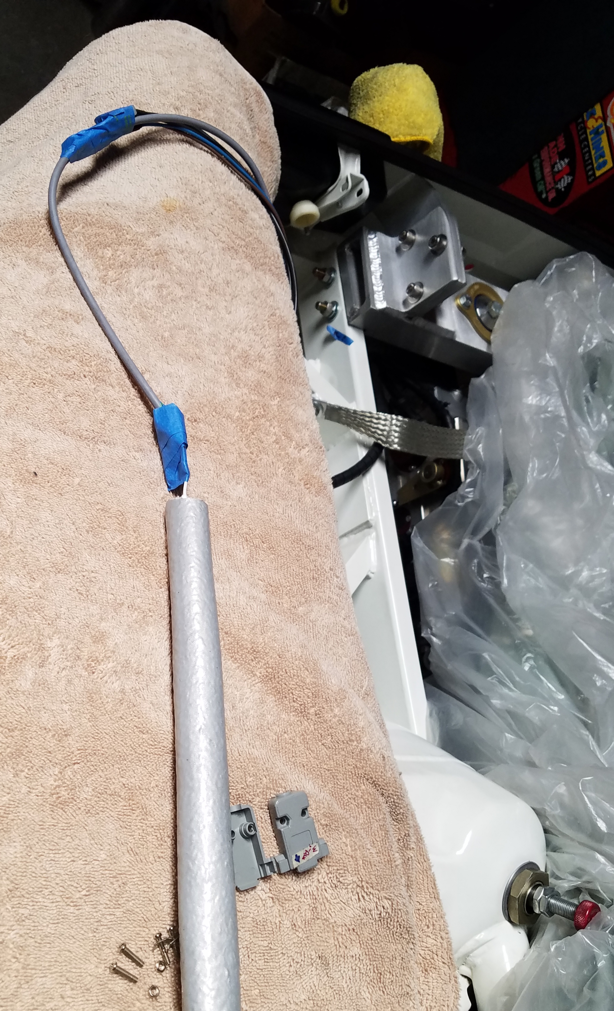

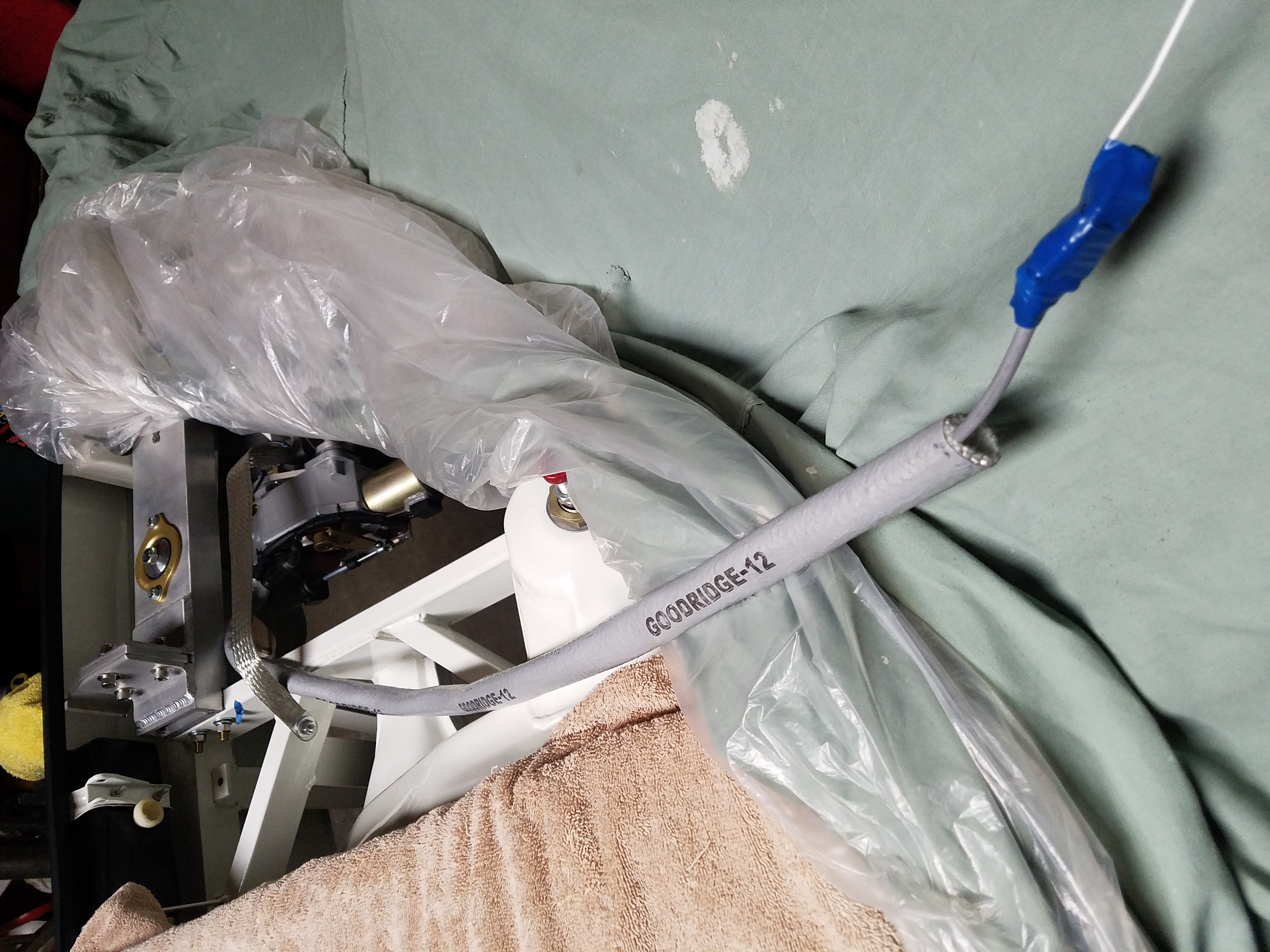

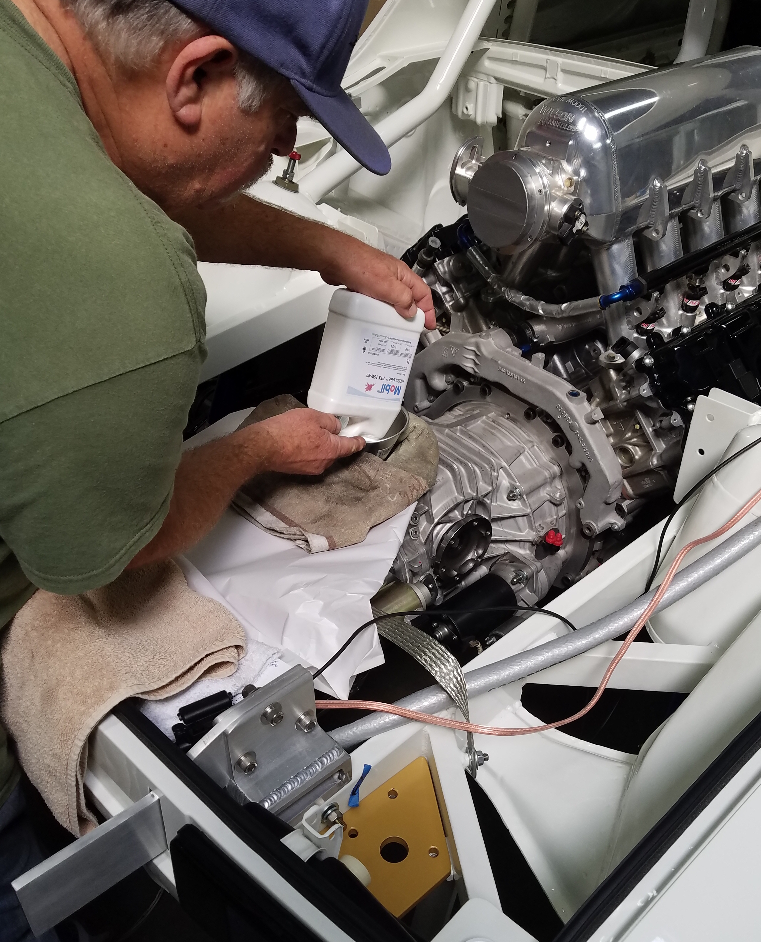

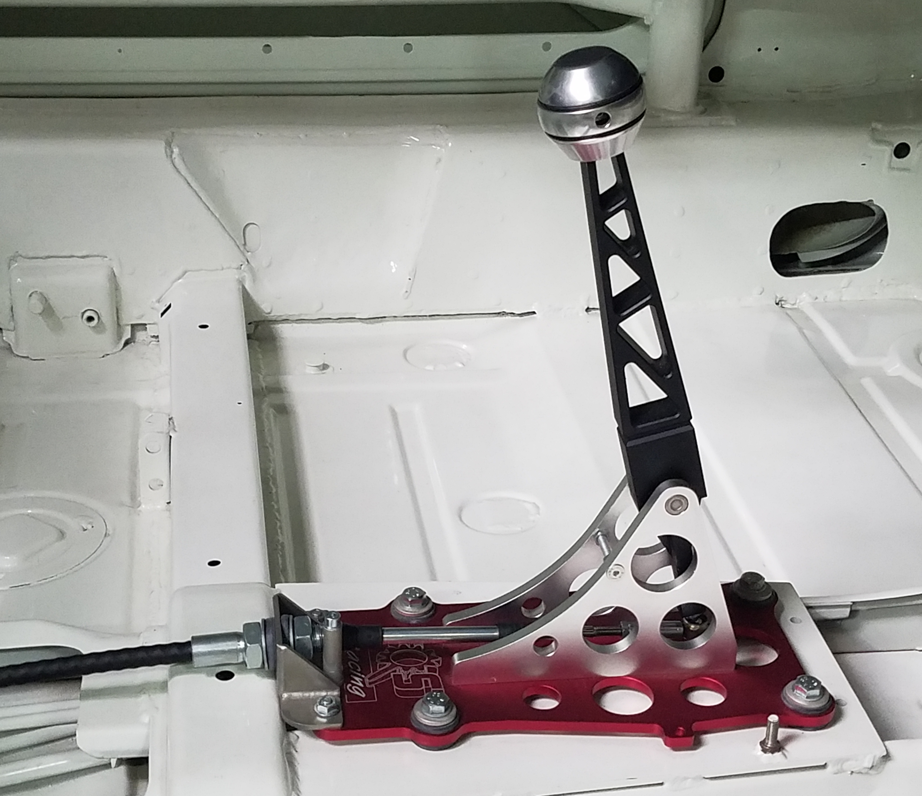

Some small details this week...finalized the SQS cable shifter in the cabin and at the transaxle, now on to filling the trans with 6L of Mobil ptx. The shift action is smooth as butter and only a 1" throw; upshift or downshift.

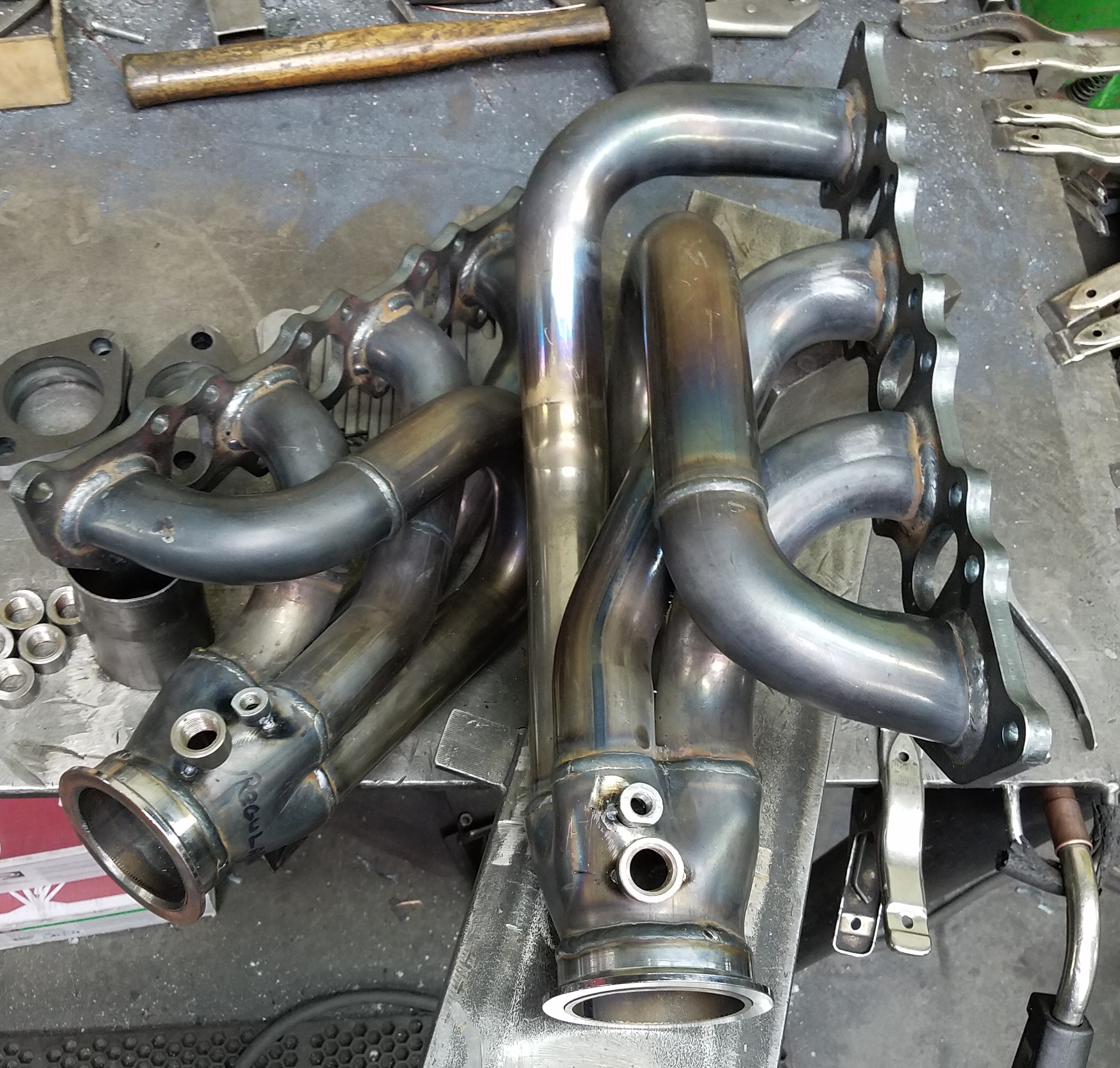

Pyrometer and Wideband o2 ports added to the shorty turbo headers

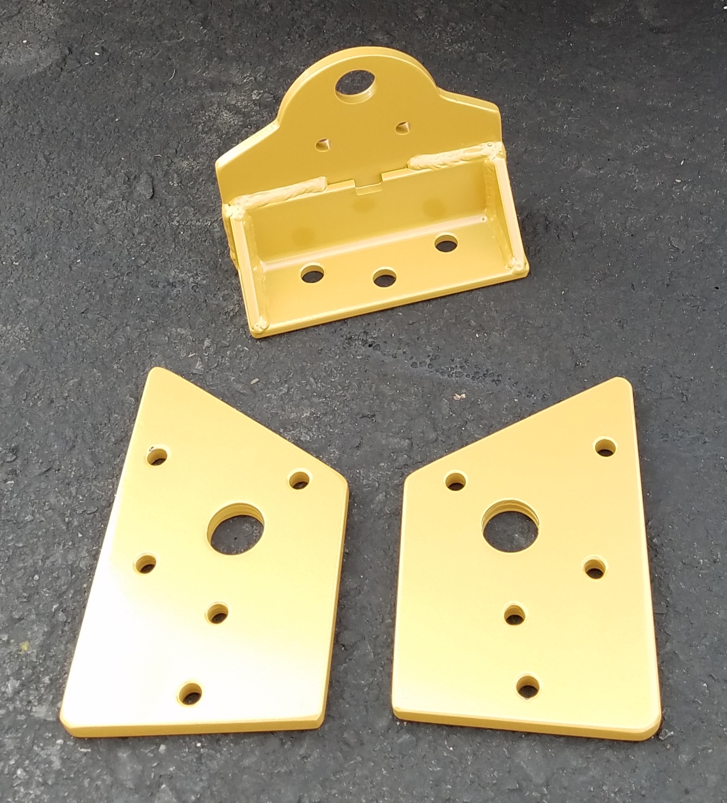

Air-jack attachment plates: Left rear/ Right rear/ forward Cabin, back from the powder painter. I like this hue aginst the GP white unibody biggrin.gif

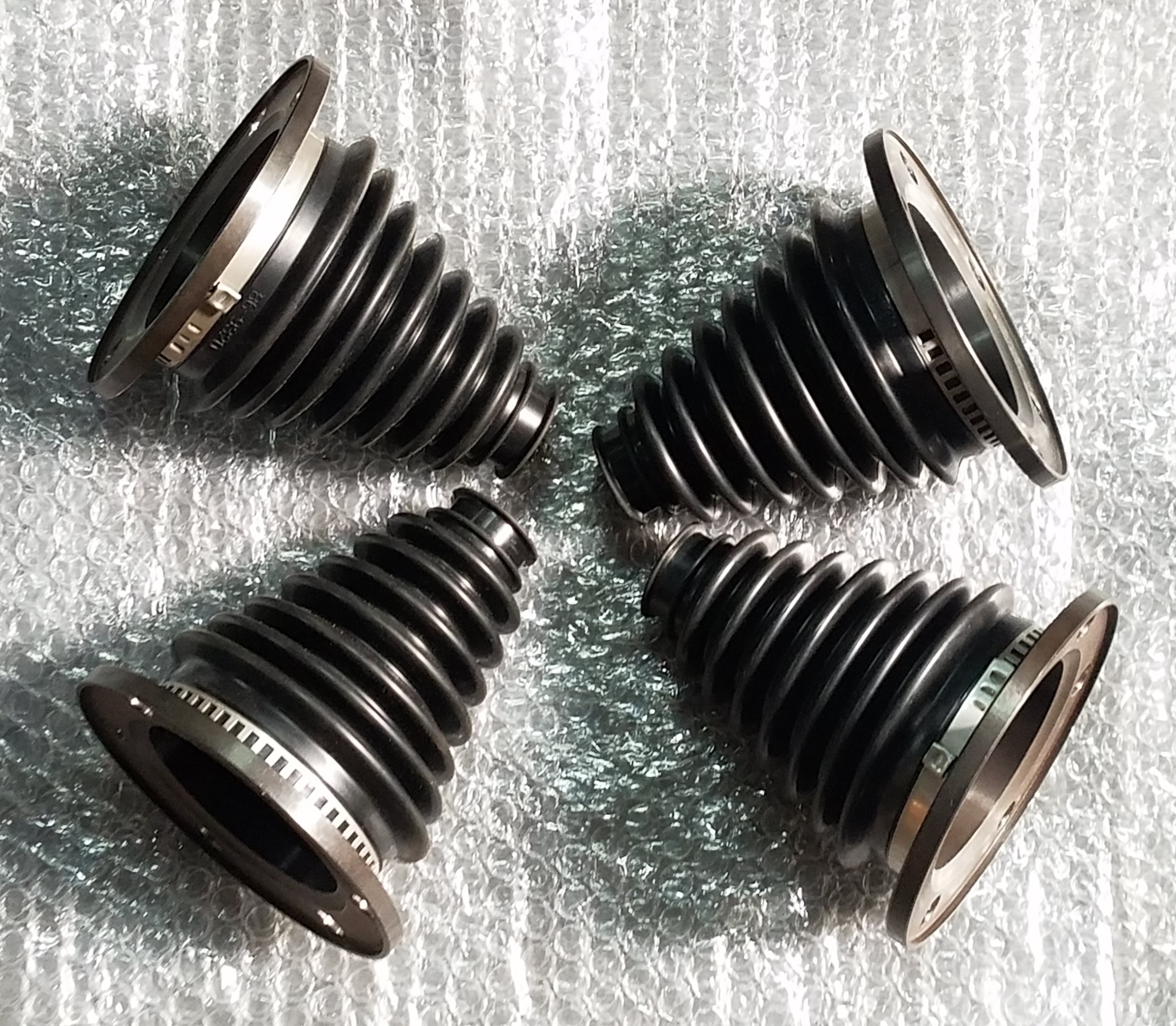

CV boot prep

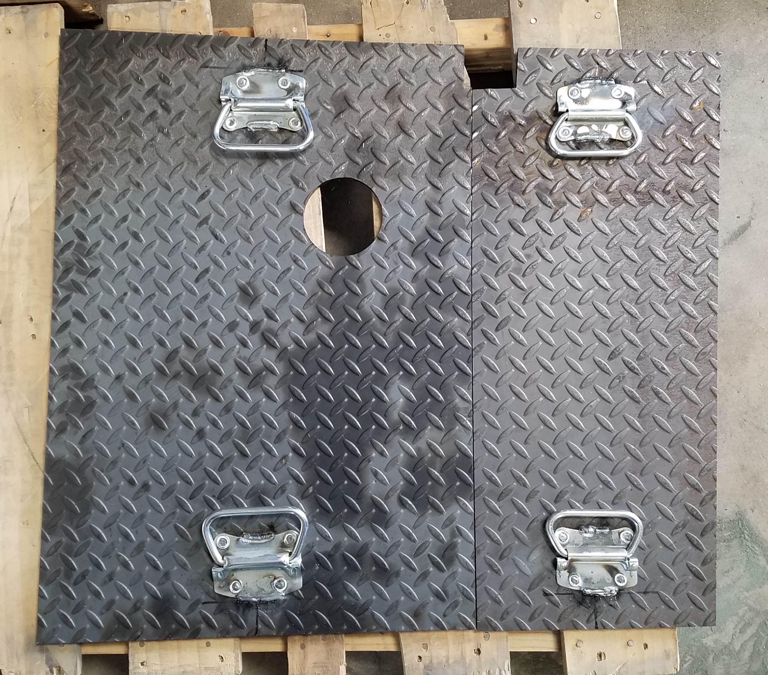

Quick O/T proj this week...while at the Laser Cutting shop; had this fresh 2-piece sump cover plate made for the driveway, winter season might bring Cali some rain welder.gif

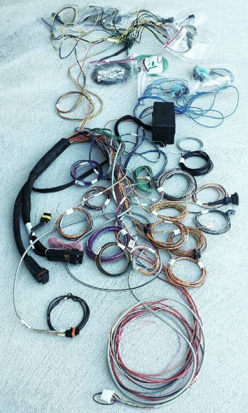

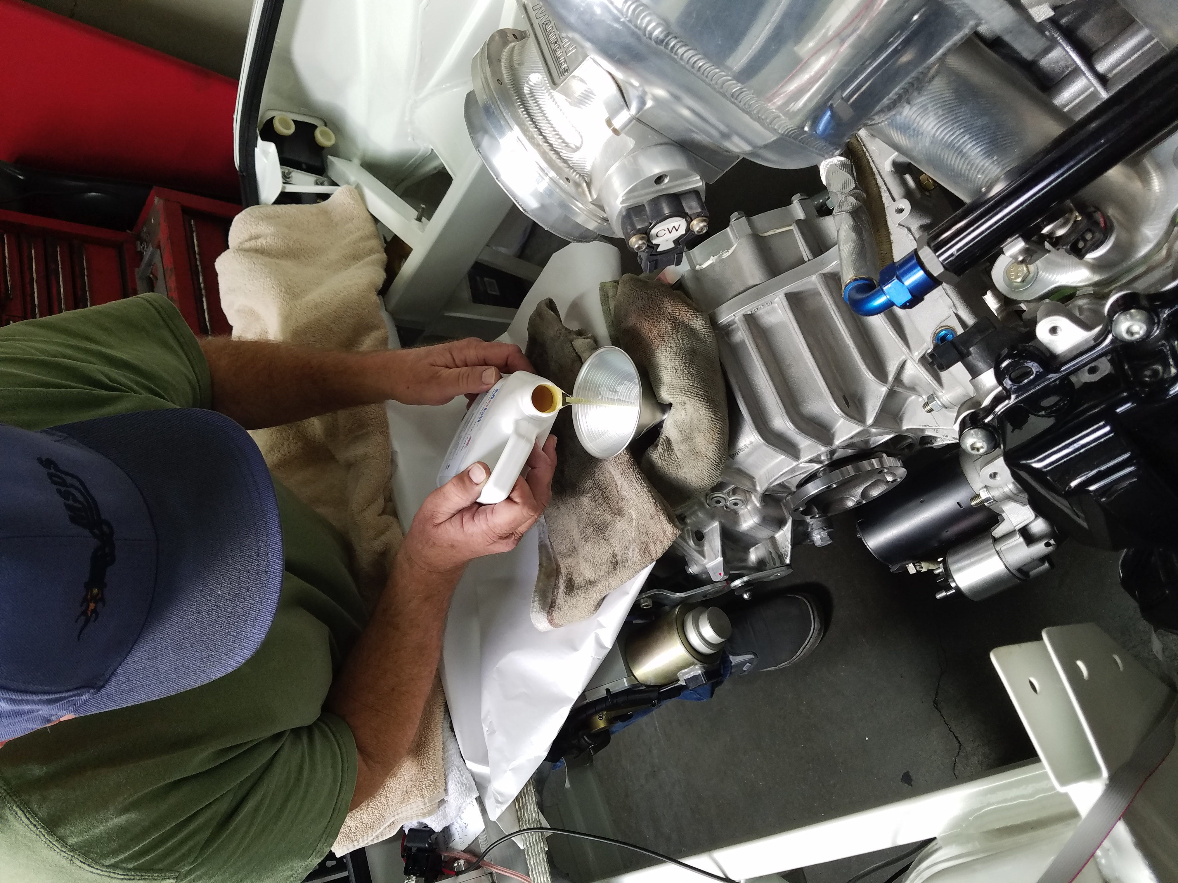

This phase of the 8gtt assembly deals with many items that we have already built early on and put aside until needed; the trans oil needs to be filled, as we wouldn't want to test shift the gearbox (while setting the SQS shift rods) if dry. Building the full Haltech management wiring harness was a 6 week project...but can now be dropped into the car in a few hours. I jump around different areas of the build, depending on the amount of time that I can spend on it...otherwise working on customer orders in the shop welder.gif

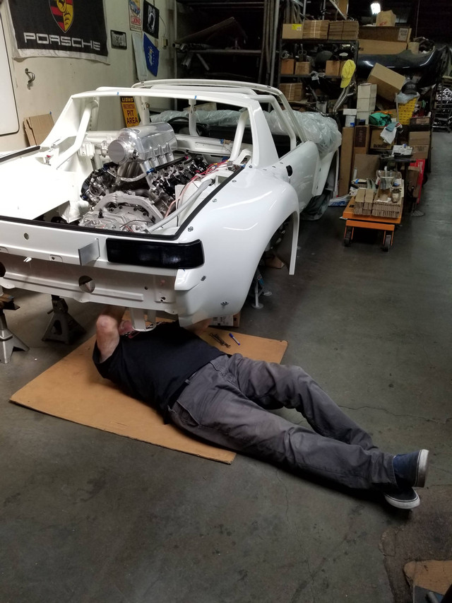

Of course, we had to put in some hours on the build..

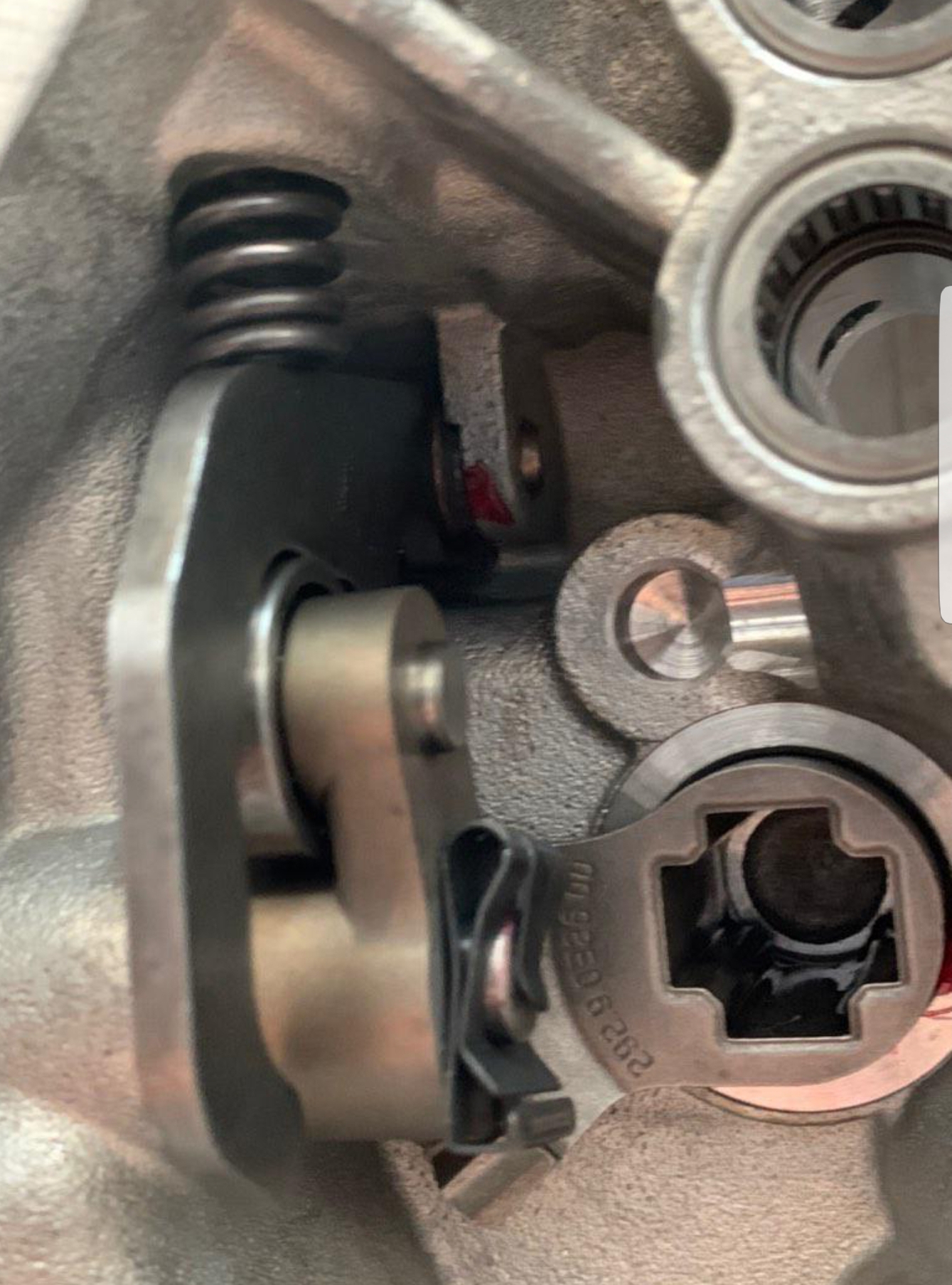

For those who need to see the inside of the gt2 trans this is the spring-loaded selector which has 3 positions; at rest= neutral, up= 1,3,5,R and down= 2,4,6

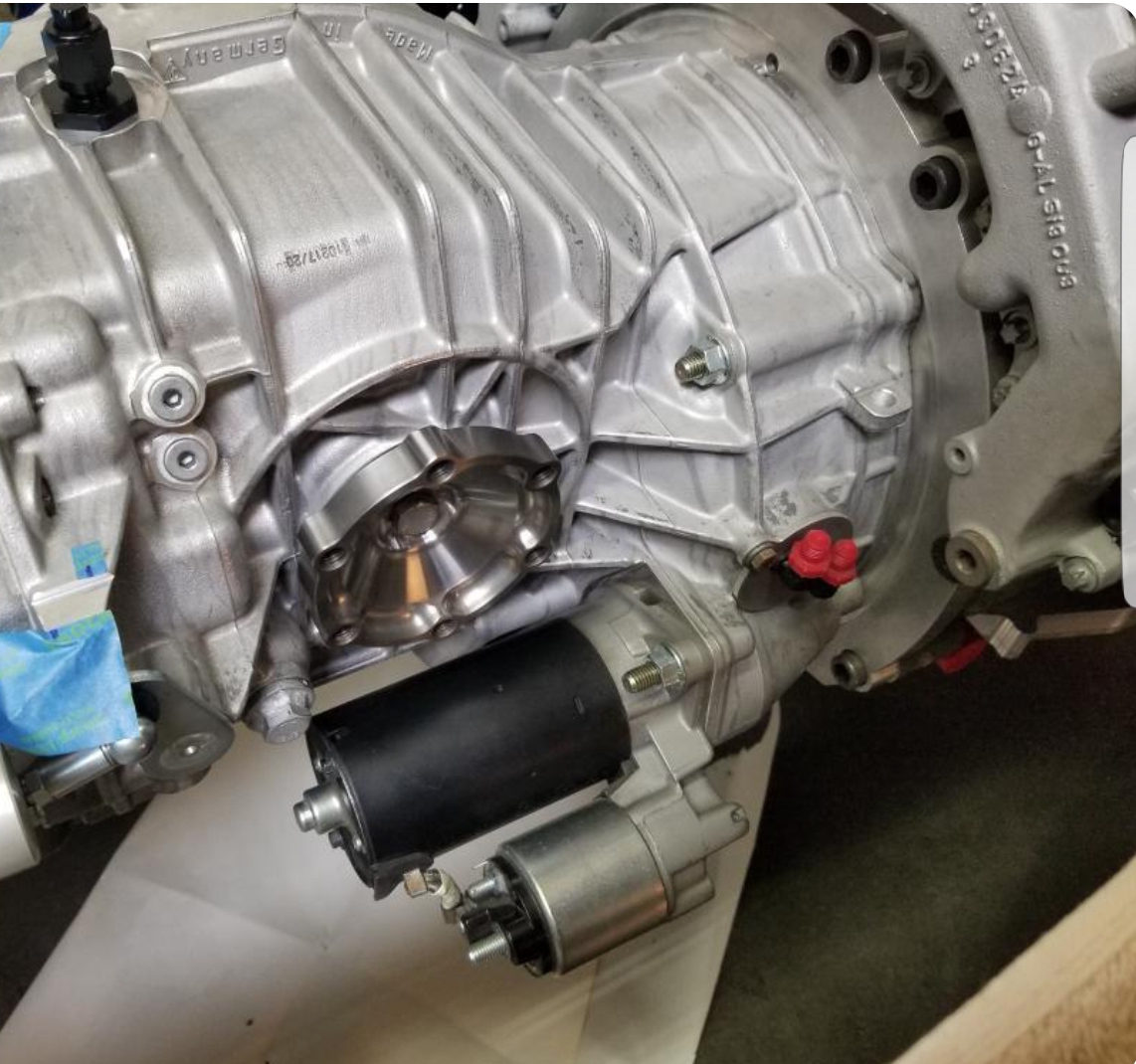

another view...

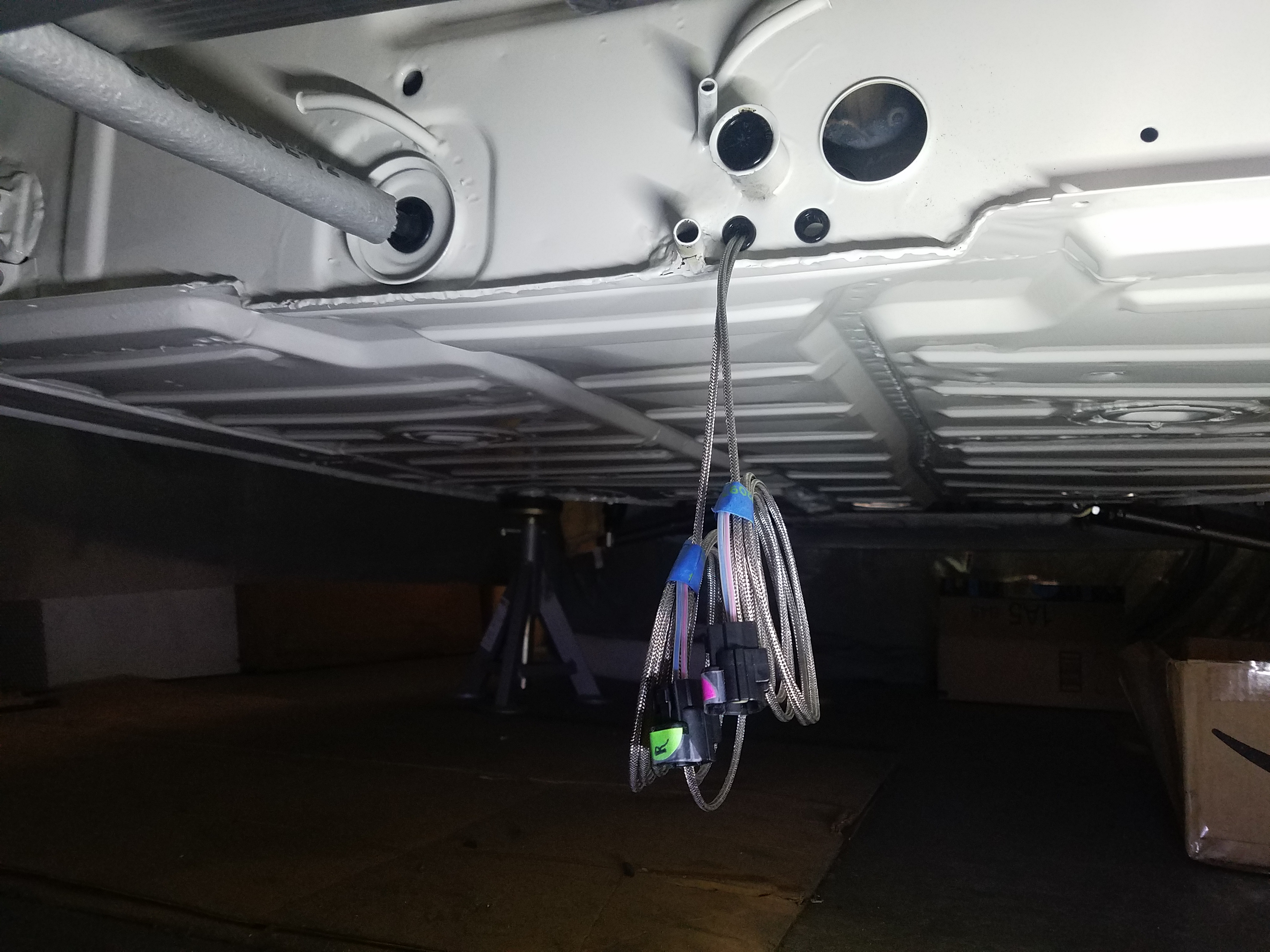

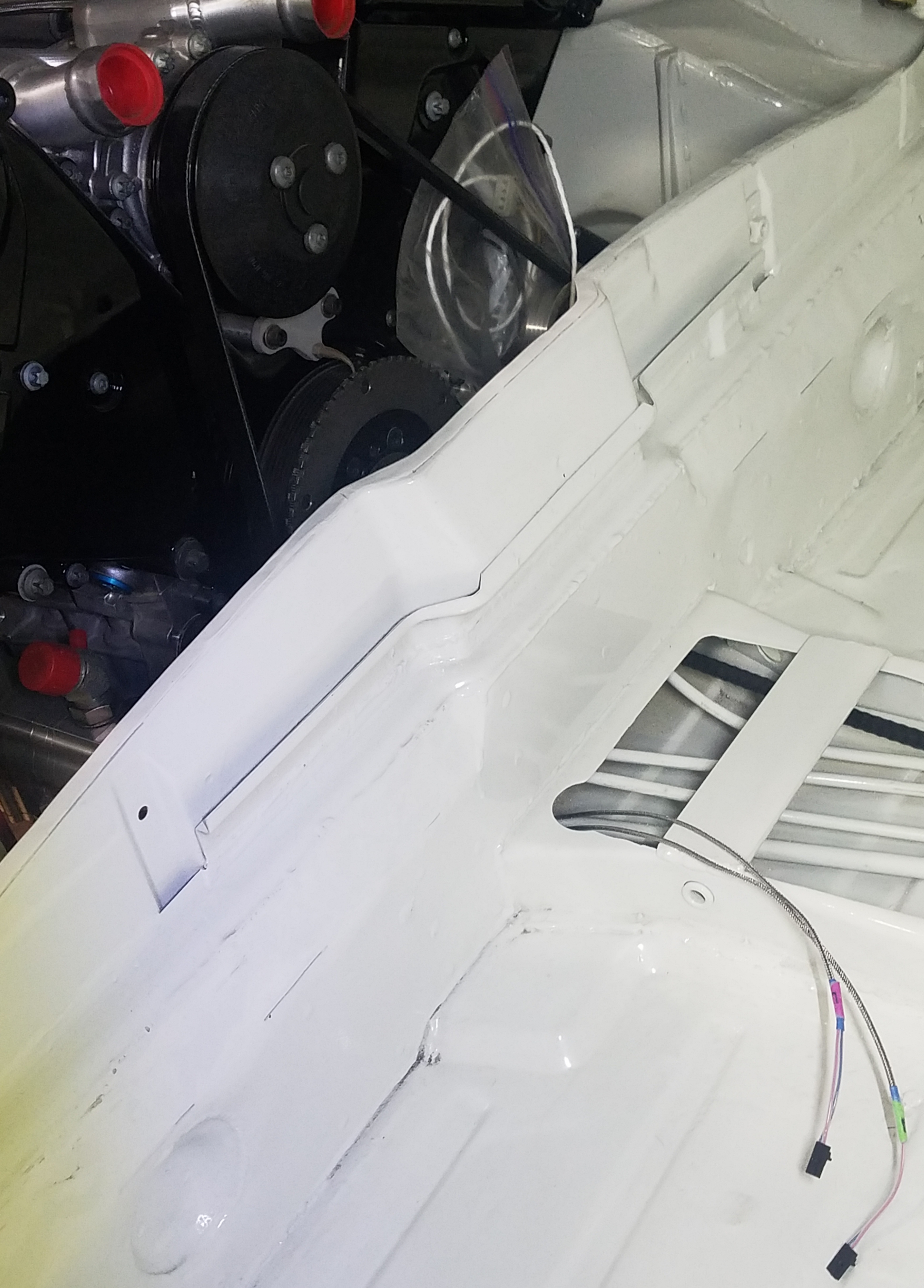

Making use of all of the OE lower firewall passageways

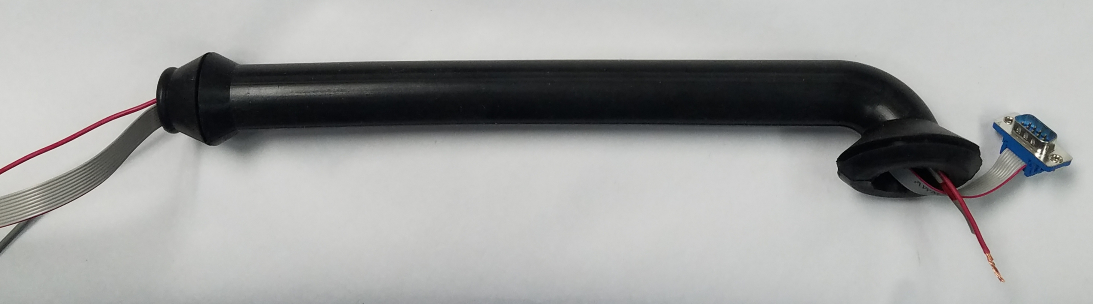

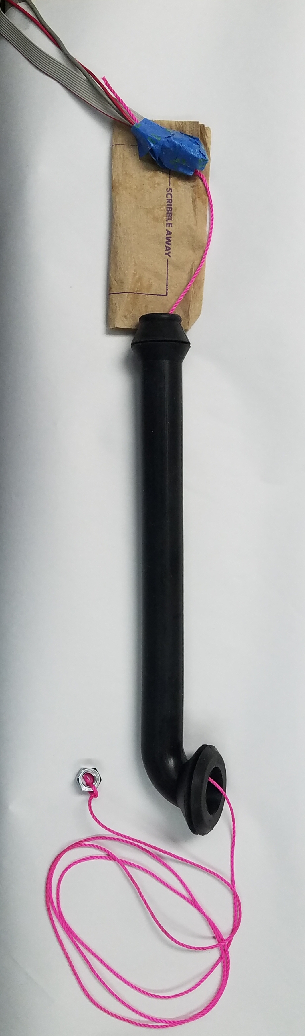

Mr. Snorkel taking on some new residents
Maltese Falcon
A couple of SQS control wires, and a 9-lead connector cable, easily pulled through. Still have more room in the Snorkel; keeping some OG style in the engine bay smile.gif

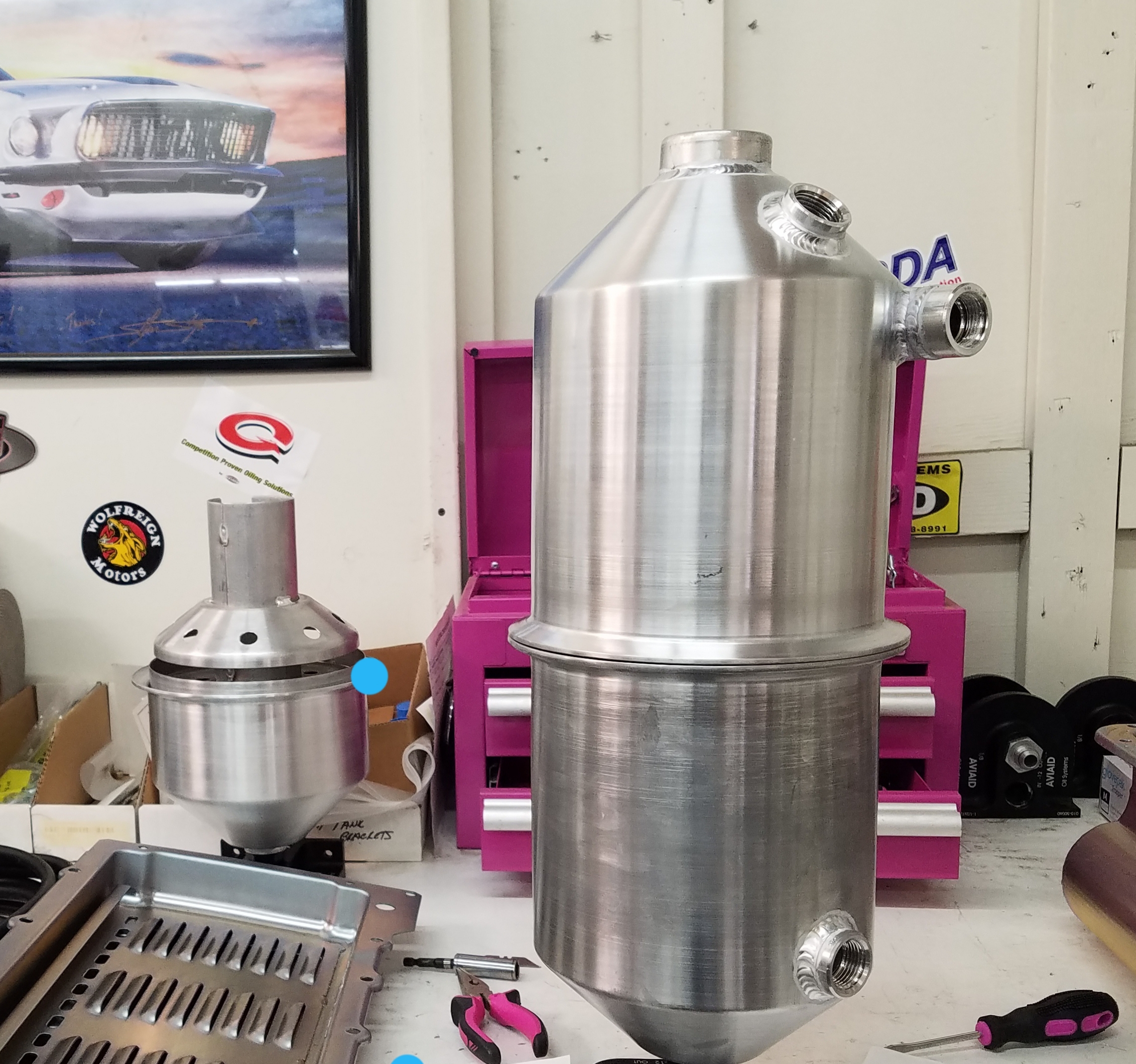

Aviaid Oil Systems is finishing up our 3 gallon dry sump tank; also using their in-tank oil heater, breather/ catch can, and filter stand.
Impressed with their QC !

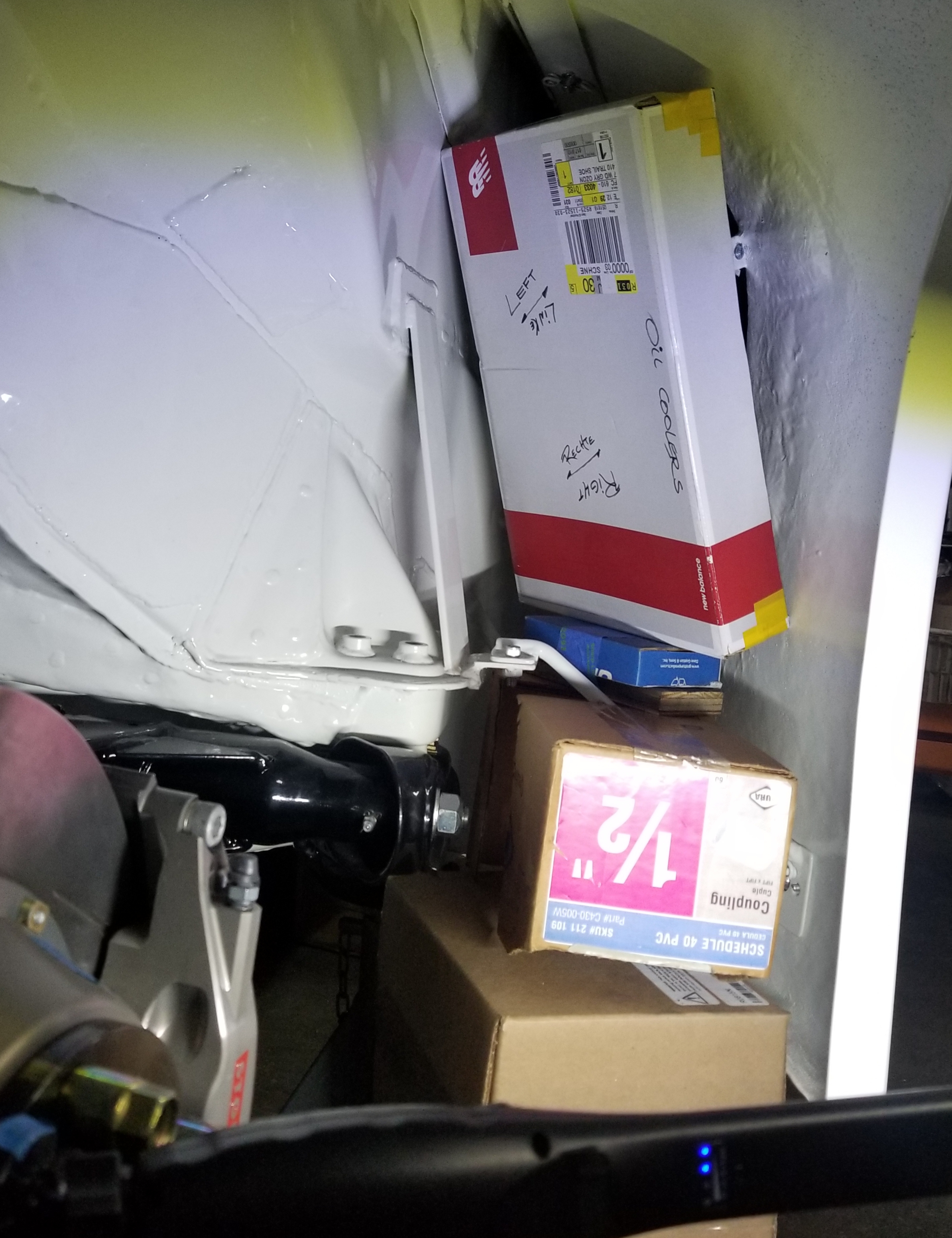

Locating brackets, and clearance areas for #12 oil cooler lines in the quarter panels

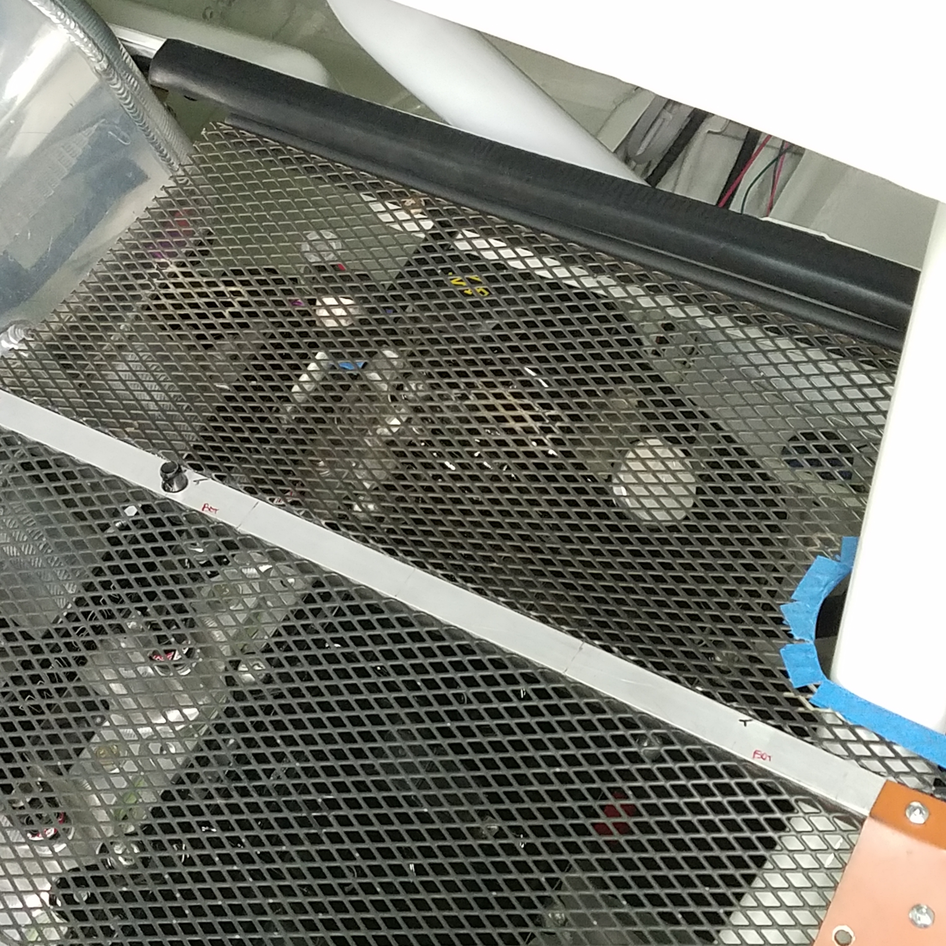

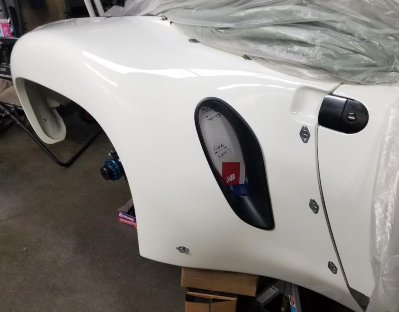

Exterior view, final fit will have mesh screen in this vent

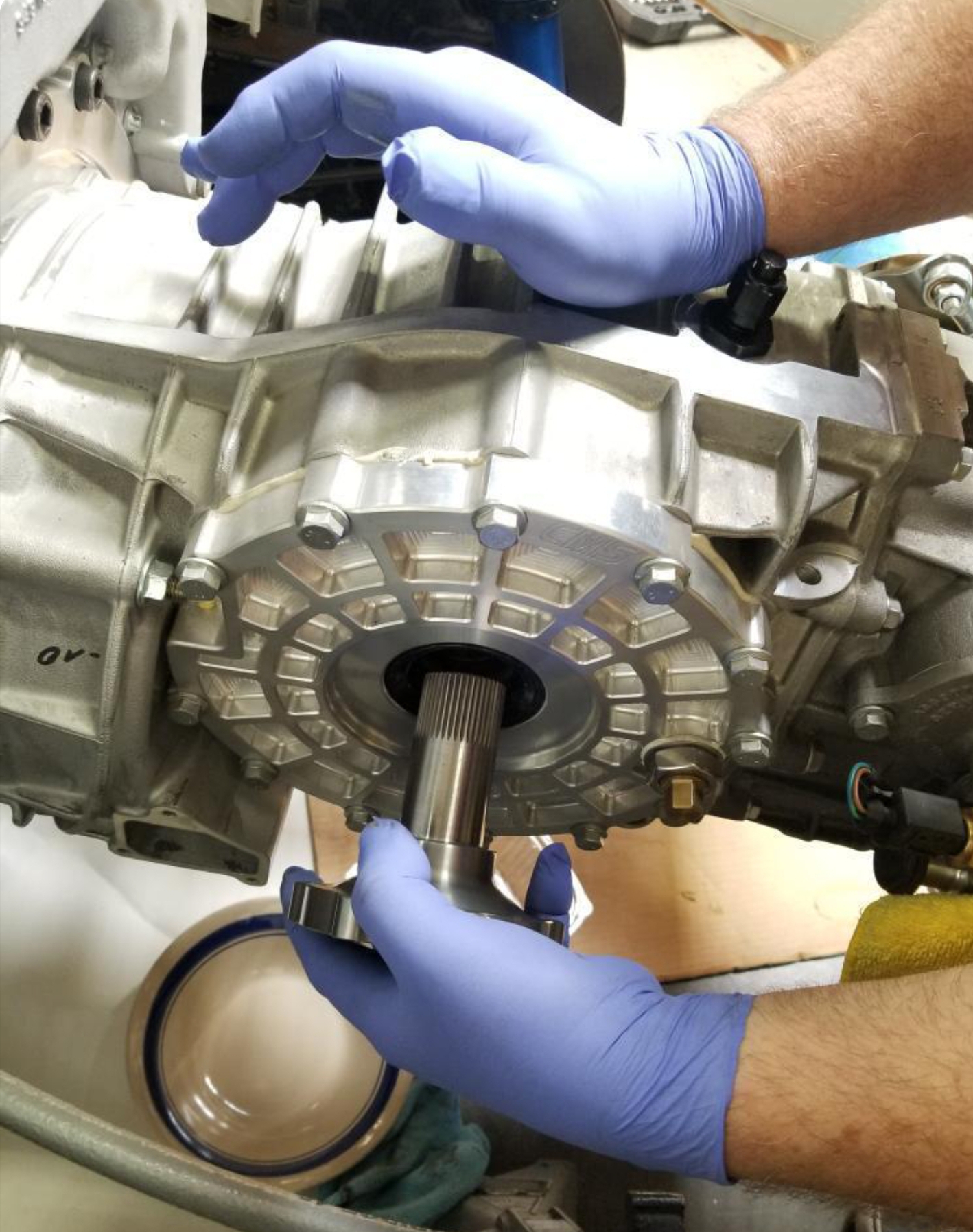

New product from California Motorsports: billet drive-flanges for the GT-2 transaxle; just a bit more insurance for our drive train
Maltese Falcon
Good for 1,000 bhp...according to CMS

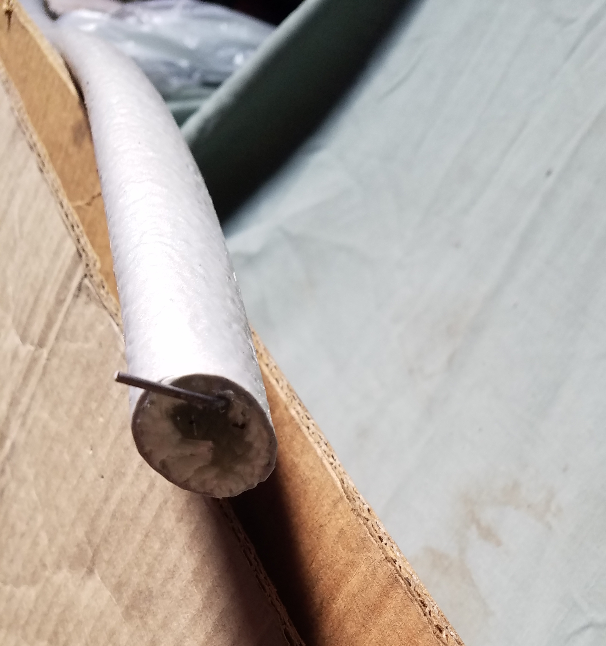

Sourced some cool weatherstrips for filling the gap on the custom engine grills; 1 piece at the targa window edge, and 1 at the grill edge
