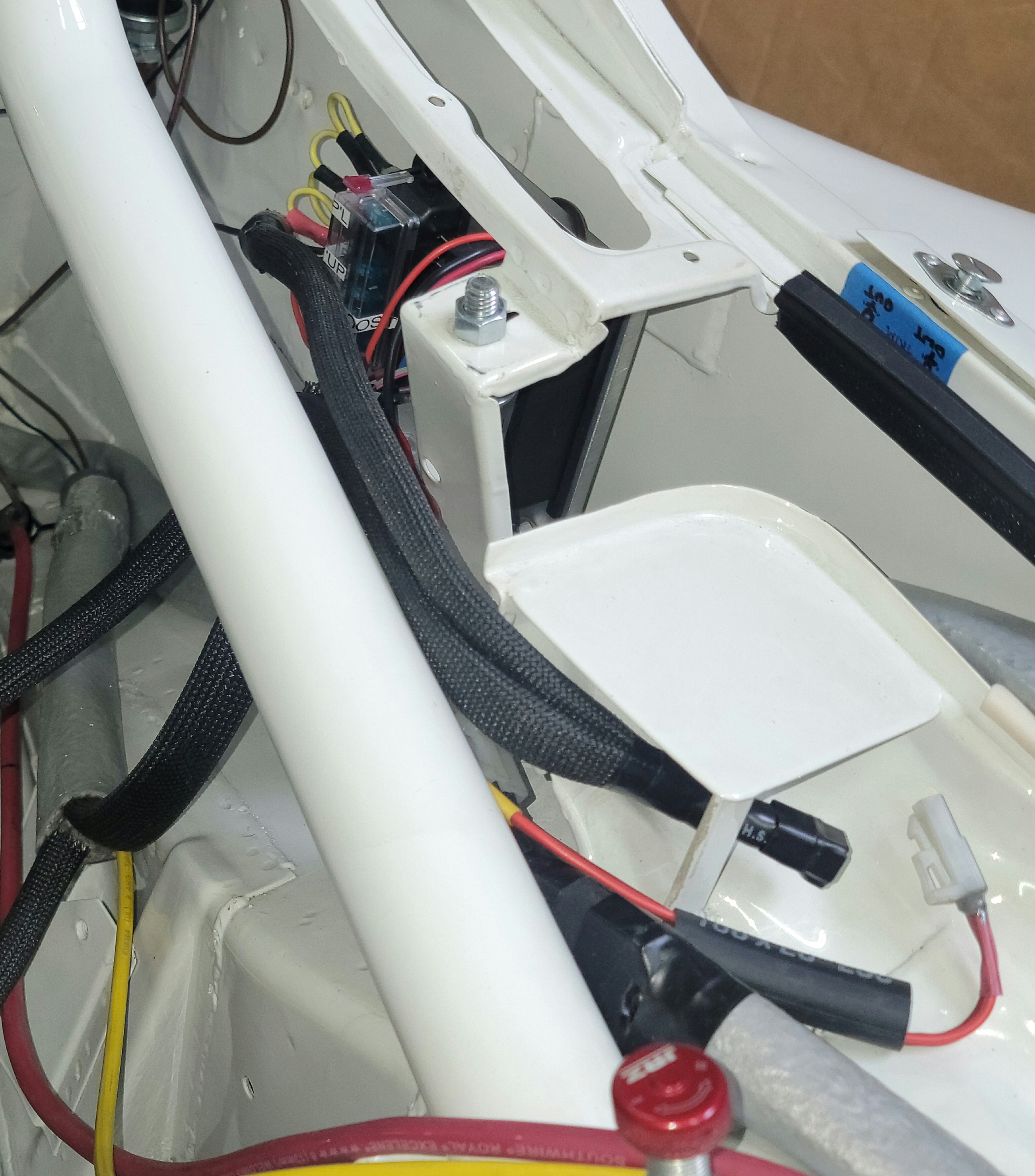

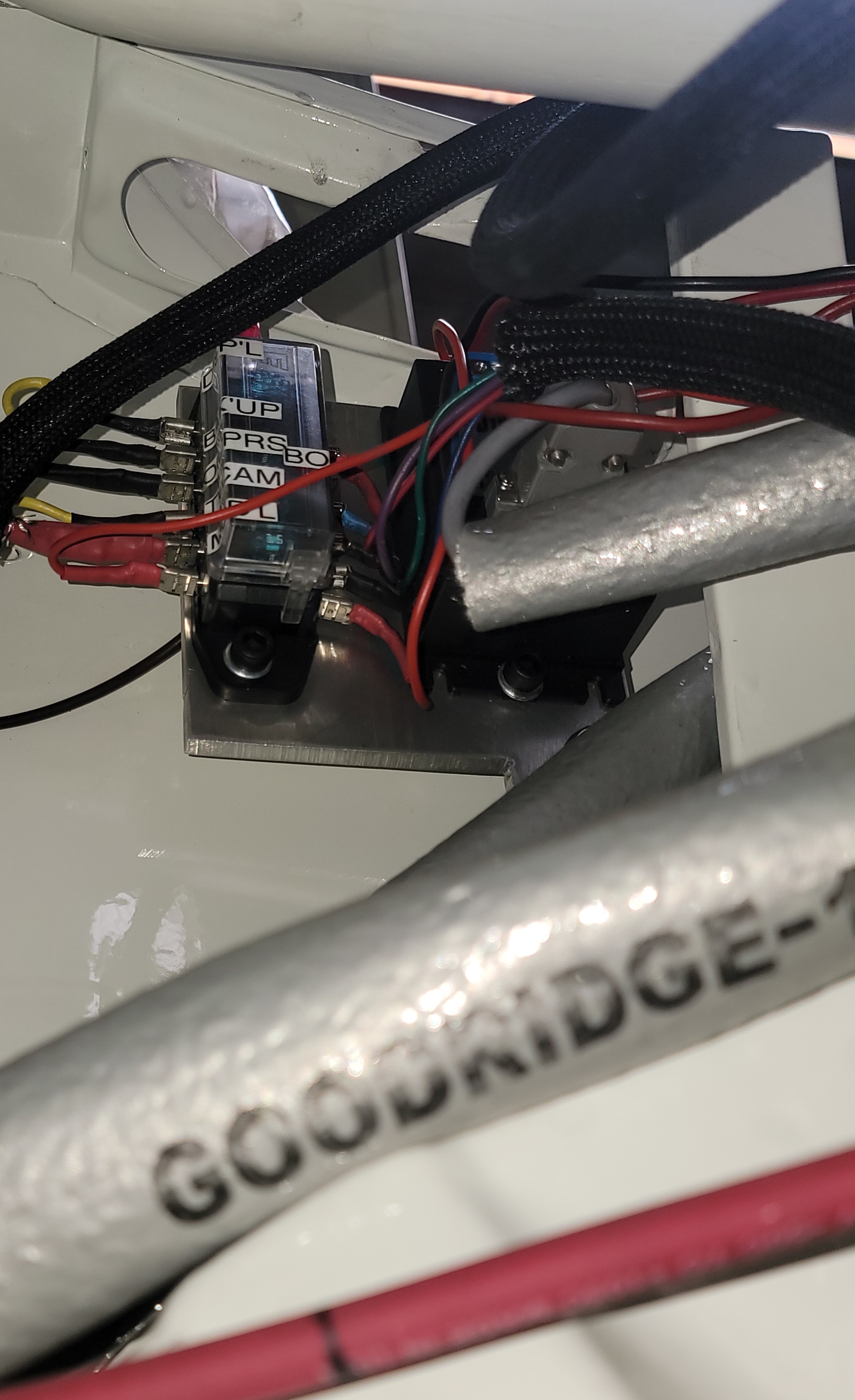

Maltese Falcon
Small 6-gang fuse & SQS shifter-module sub-panel in engine ; this was the prev 12v battery area.
Maltese Falcon
Top view, quick-disconnect is to isolate the SQS shift-module from B+ during jump starting (if needed).

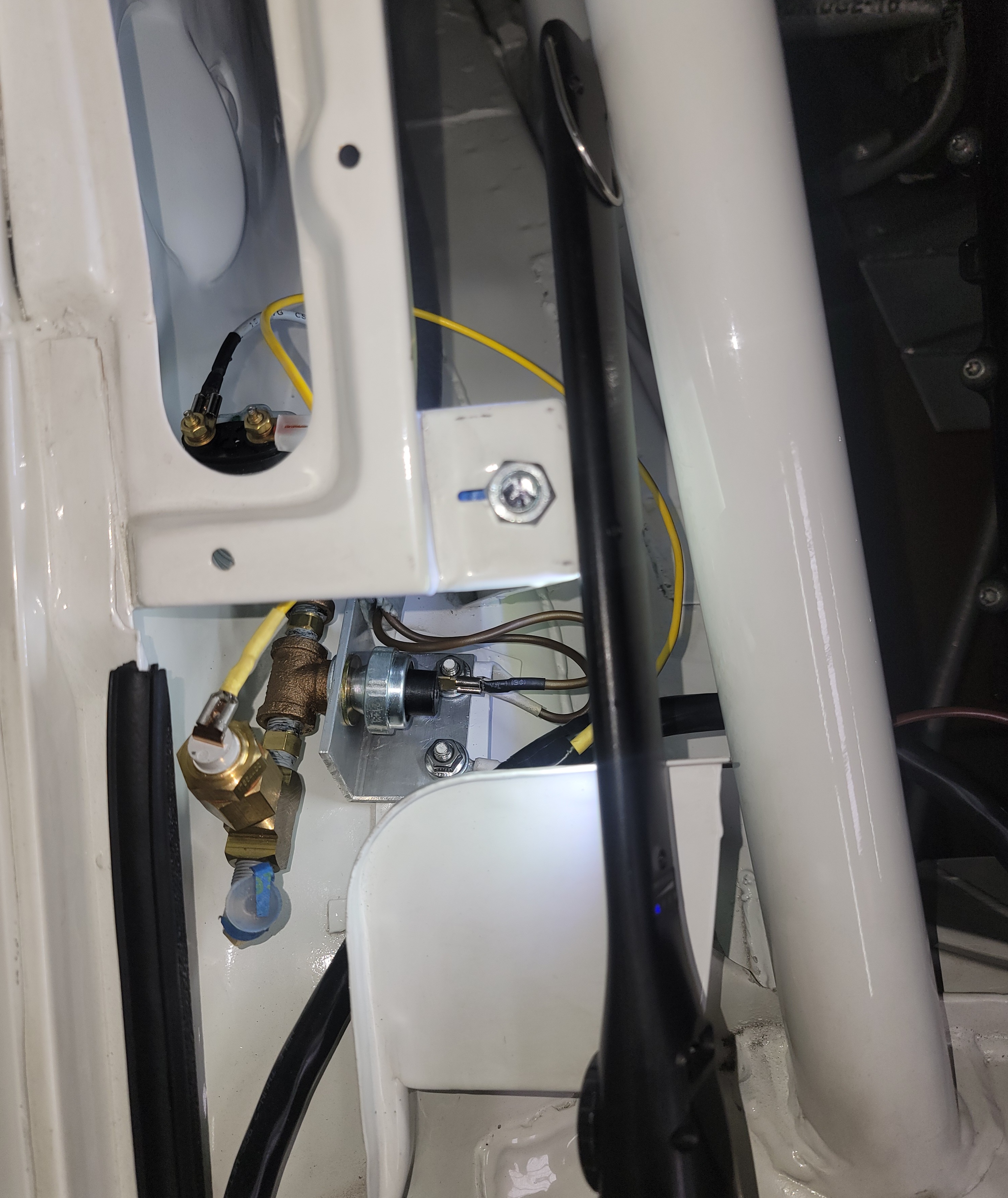

Oil control "Junction" located just below left end of engine grill, now hooked up to the custom chassis wire harness. These senders go to the oil-pressure + oil-temp gauges/ low oil-pressure warning light.
The Haltech Elite engine management also displays this info, but I do like several analog gauges to quickly glance while under way at speed.
Click to view attachmentt
Maltese Falcon

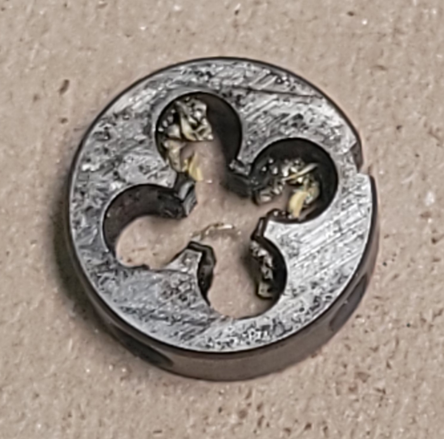

Body shop forgot to mask-up a few chassis studs, including these two where I was installing a bracket for these oil pressure/ temp senders. Tight quarters...but got the 6x1mm thread die in there for a proper clean up !
Maltese Falcon
Body shop def did not skimp on the paint thickness, lots of debris packed on those studs

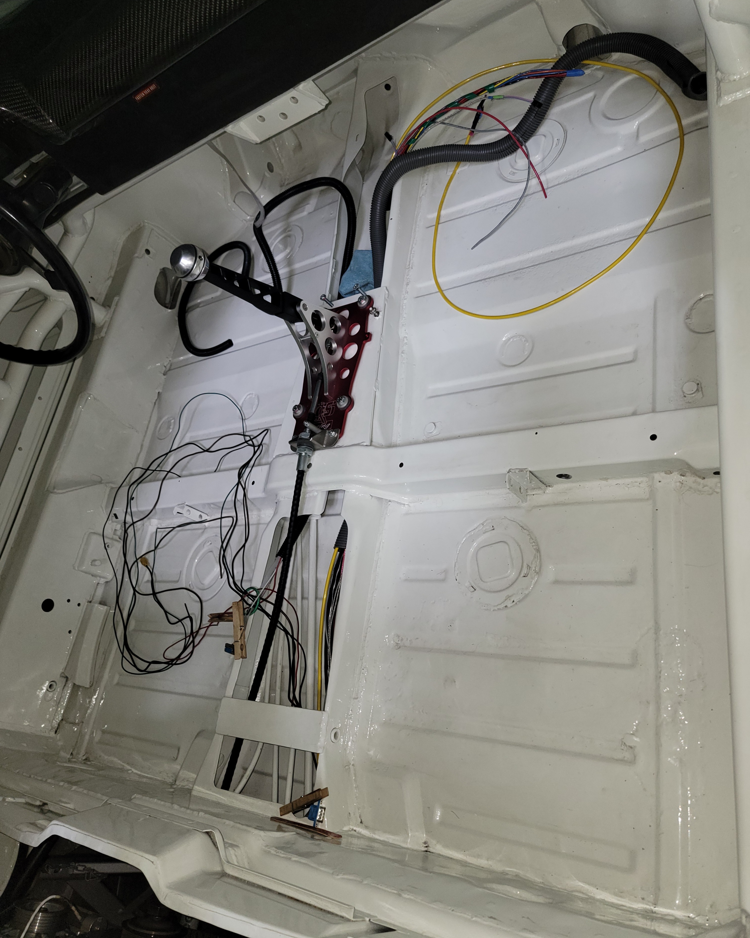

Tidying up electric cables running into cabin

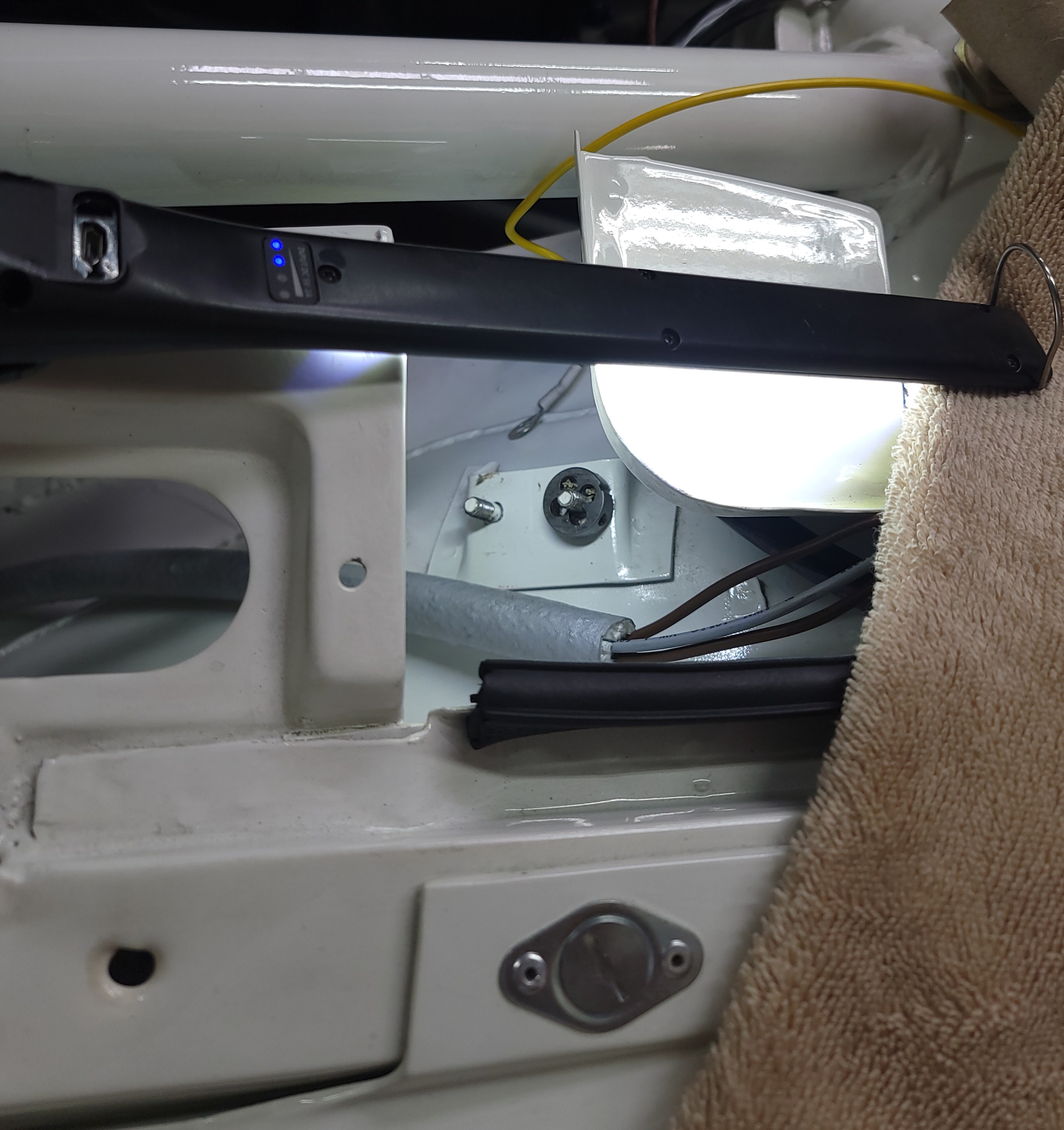

Maltese Falcon

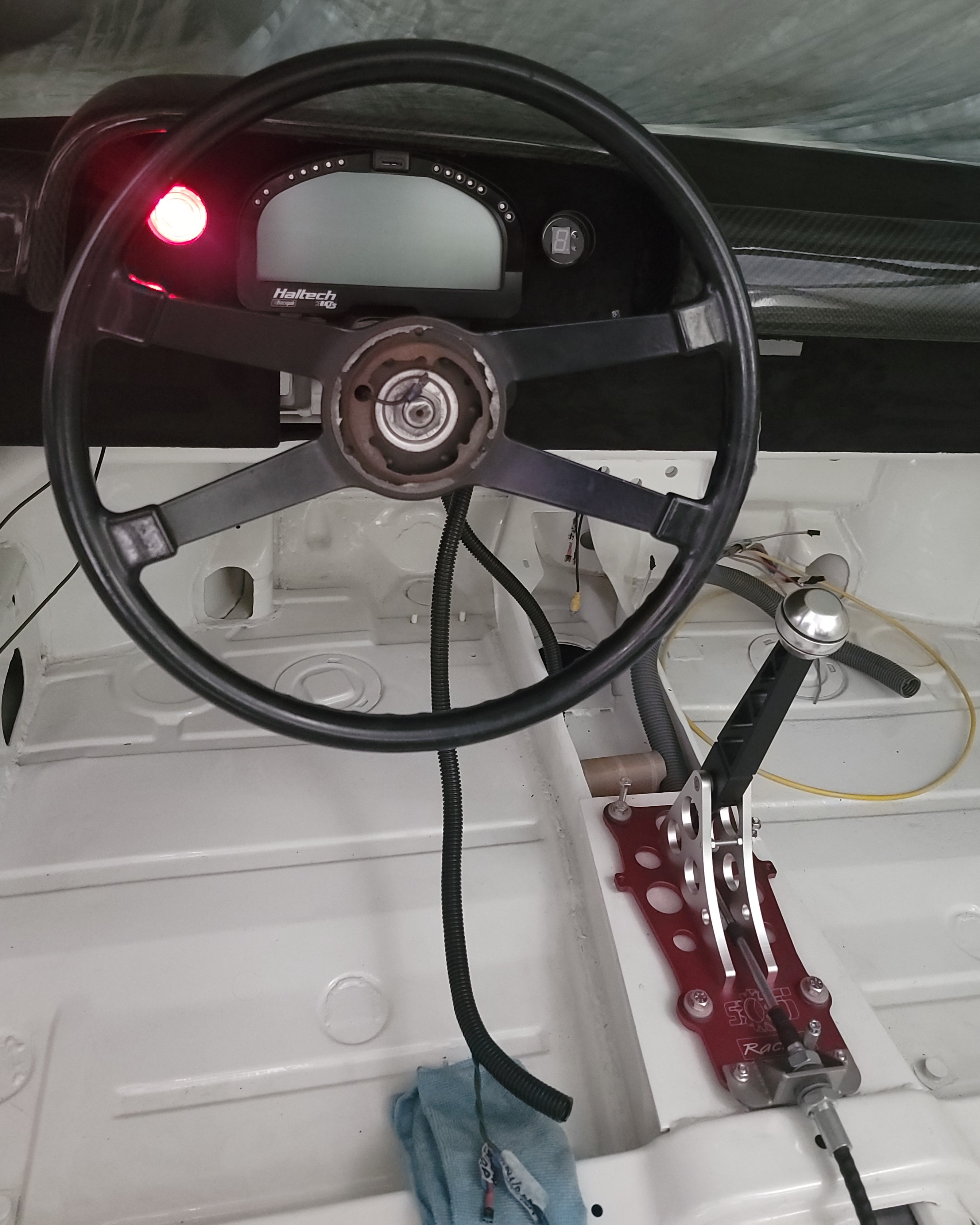

Checking operation of low Oil Press warning light
Maltese Falcon

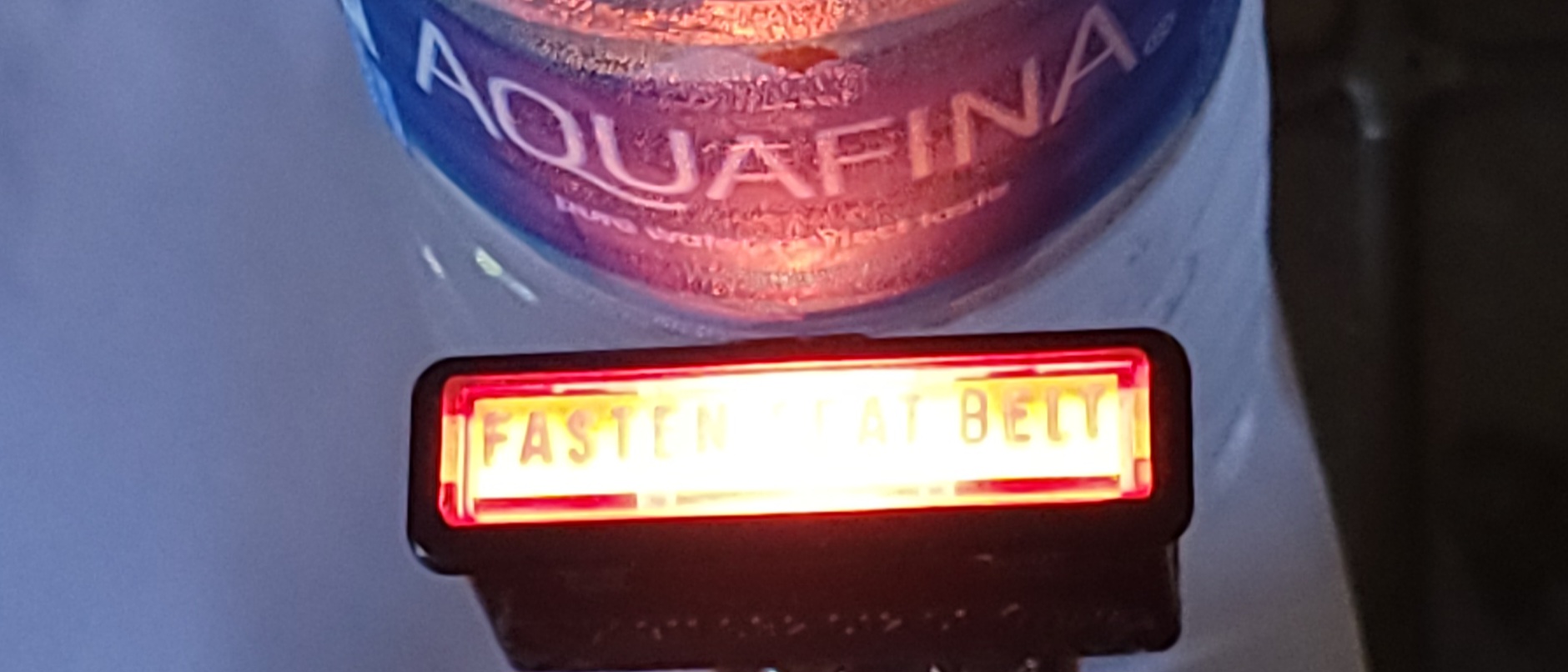

Testing the 49 year old Fasten Seat Belt light...this will illuminate with onset of 7 psi of turbo boost smile.gif

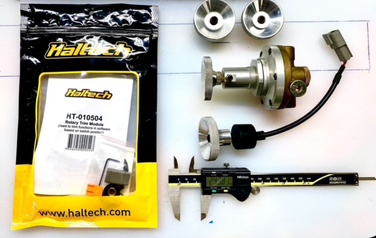

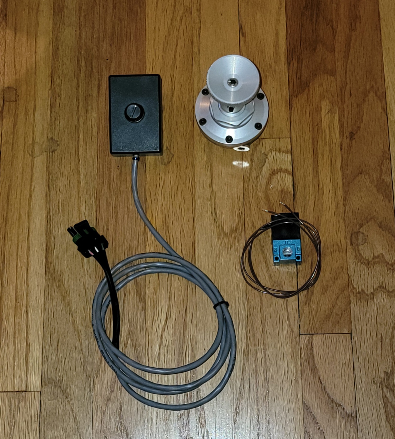

I have this "Mechanical" 962 style boost adjustment unit (dampf-rad) but not going to integrate with our Haltec management ecu; as the ecu monitors + adjusts wastegate boost limits via electronic potentiometer + solenoid activation. So I've found a machinist who makes extra Top adjustment knobs> so I won't need to steal one off of my complete 962 valve which is going on the flat-fan biturbo.
Maltese Falcon
962 style adjustment knob, now grafted to the variable pot'. This will operate 2 solenoids wired to operate 2 Tial wastegates, as this is a twin turbo build.

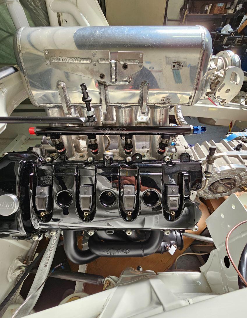

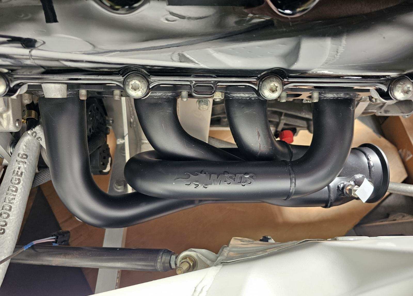

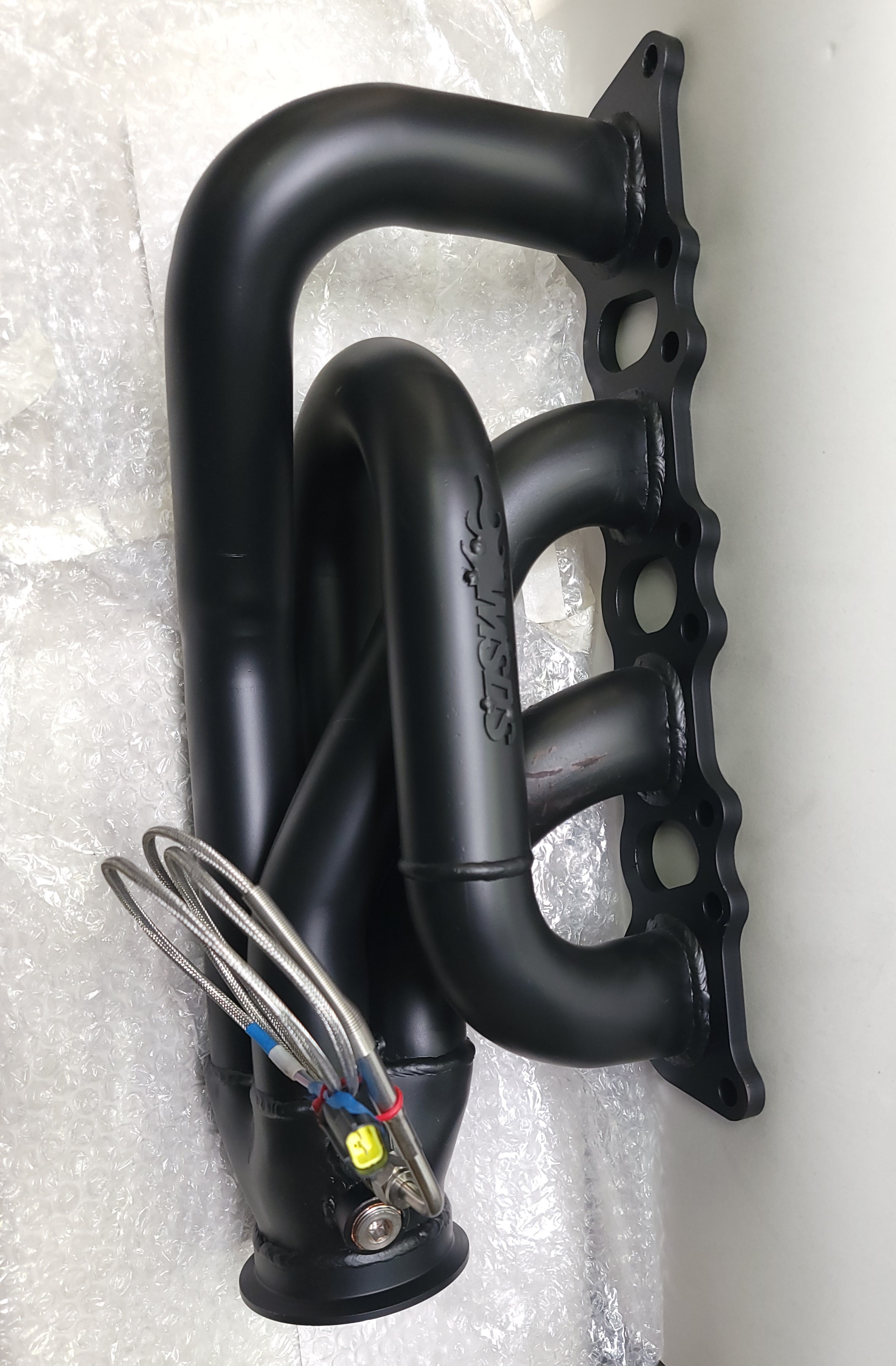

Left side shorty turbo header in place
Maltese Falcon
Header finished in high temp Satin Black ceramic coat.
Maltese Falcon

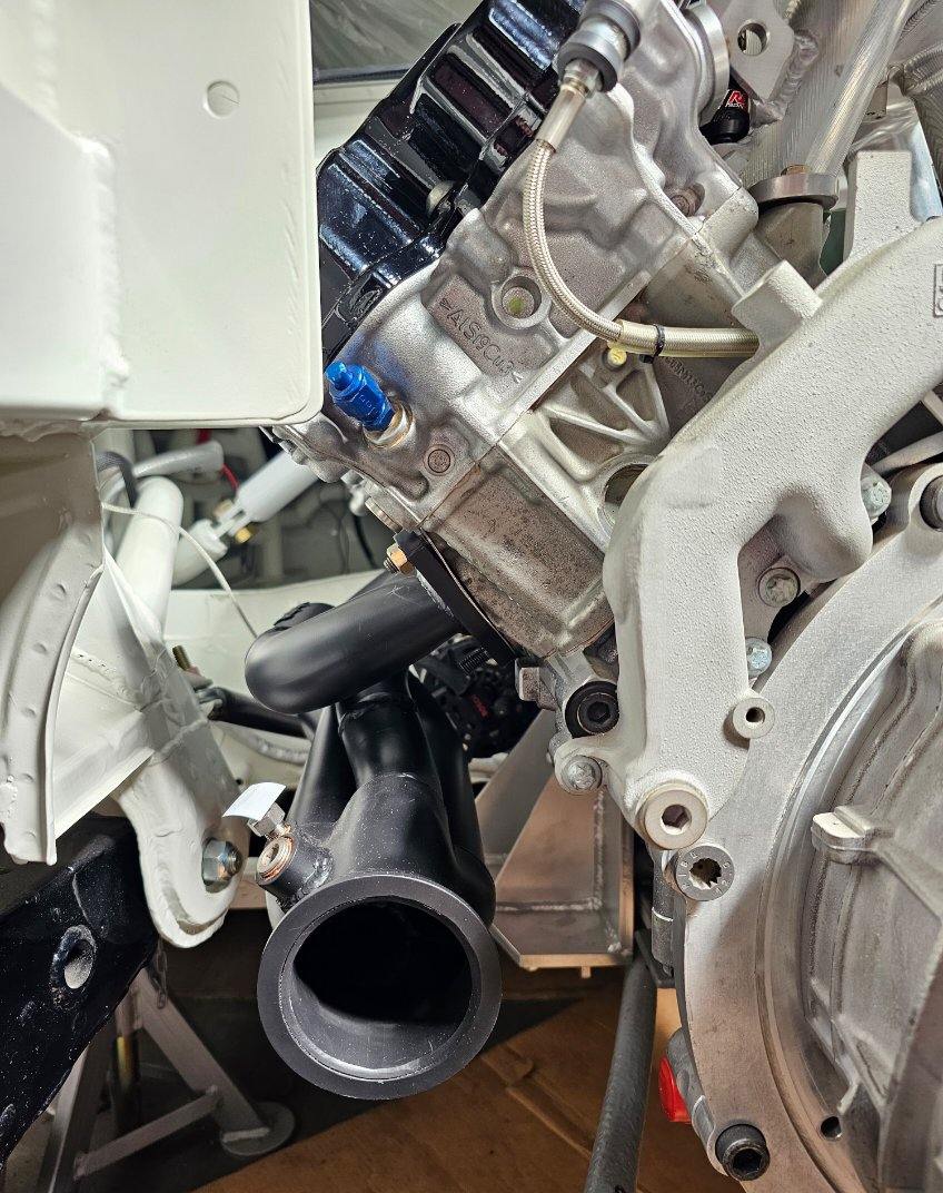

Under shot pic
Maltese Falcon
EGT probe, o2 port/ pre-exhaust turbine sampling location. Secondary o2 ports go on the turbine outlet exhaust pipes.

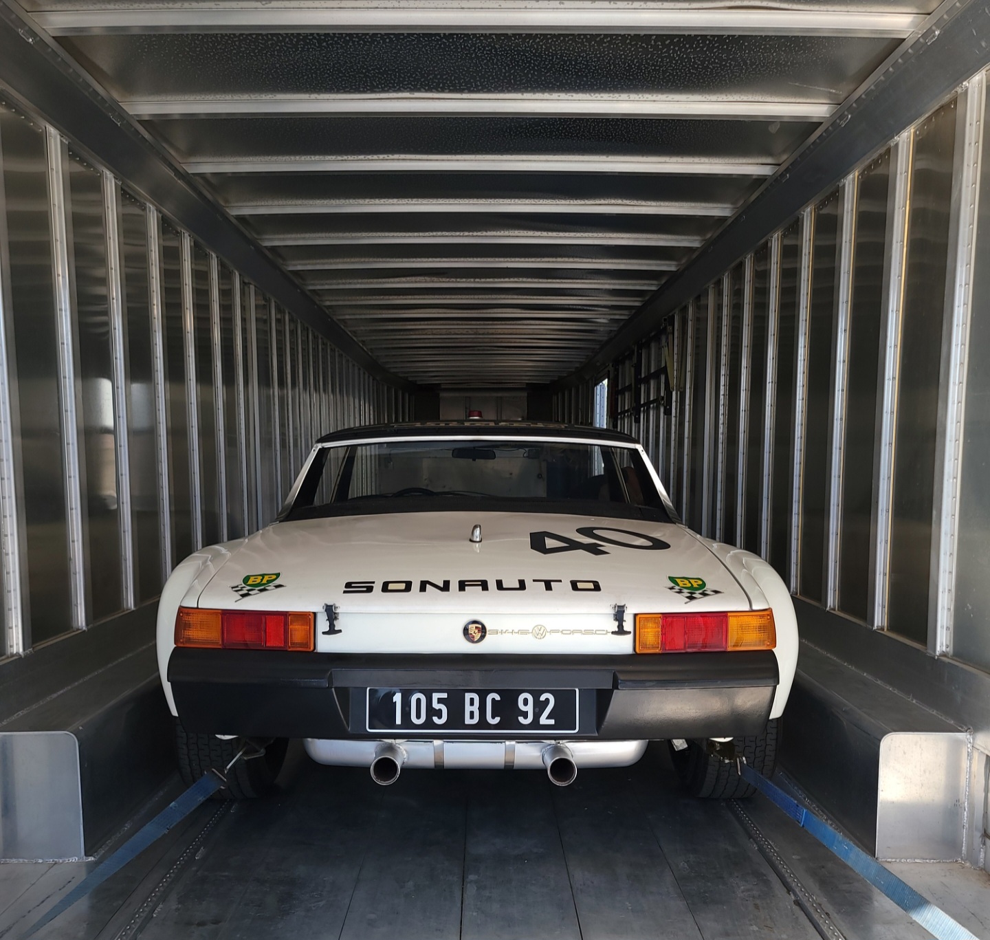

Something came up towards the end of September, and there were plenty of these flat 12 cylinder air cooled racers all gathered there>>took a break from the 8gtt
Maltese Falcon
We were honored to bring the #40 to the gig
Maltese Falcon
One week off of work on 9148-gtt, this Rennsport gig only comes around every 5 years or so.
Maltese Falcon
Pairing up with the Gulf 917 for exhibition laps
Maltese Falcon
And just as the trip (3 in the 914) to Victory lane in 1970, we followed suit and @MATTYLITE riding shotgun...we finished off Rennsport7 and now back to the 8gtt build biggrin.gif

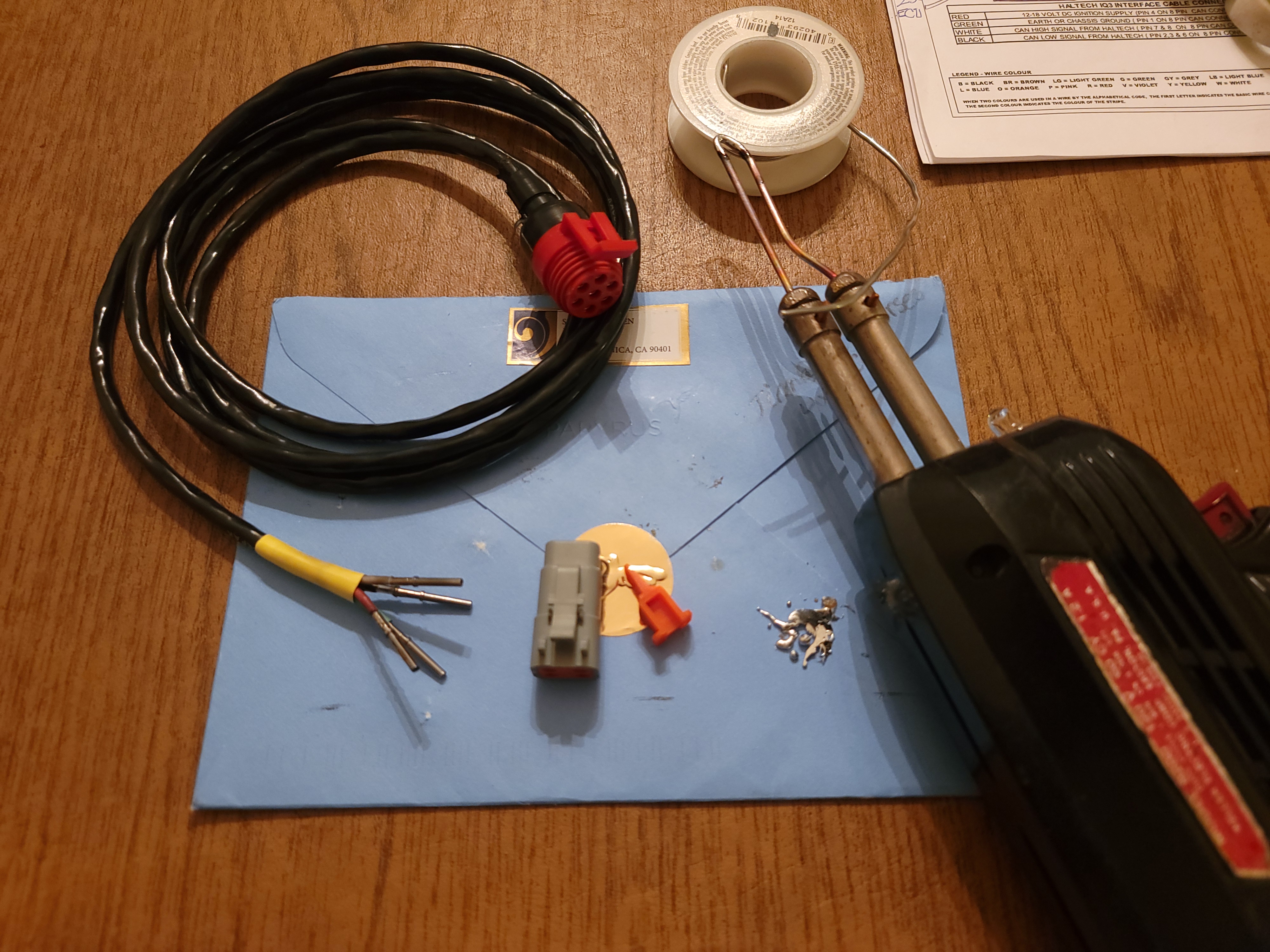

Addressing the Haltech Elite2500 ecu & some of the accessory and C-A-N cables /from and to the IQ3 Racepak dashboard
Maltese Falcon
Complete and ready to plug in and move to the next component

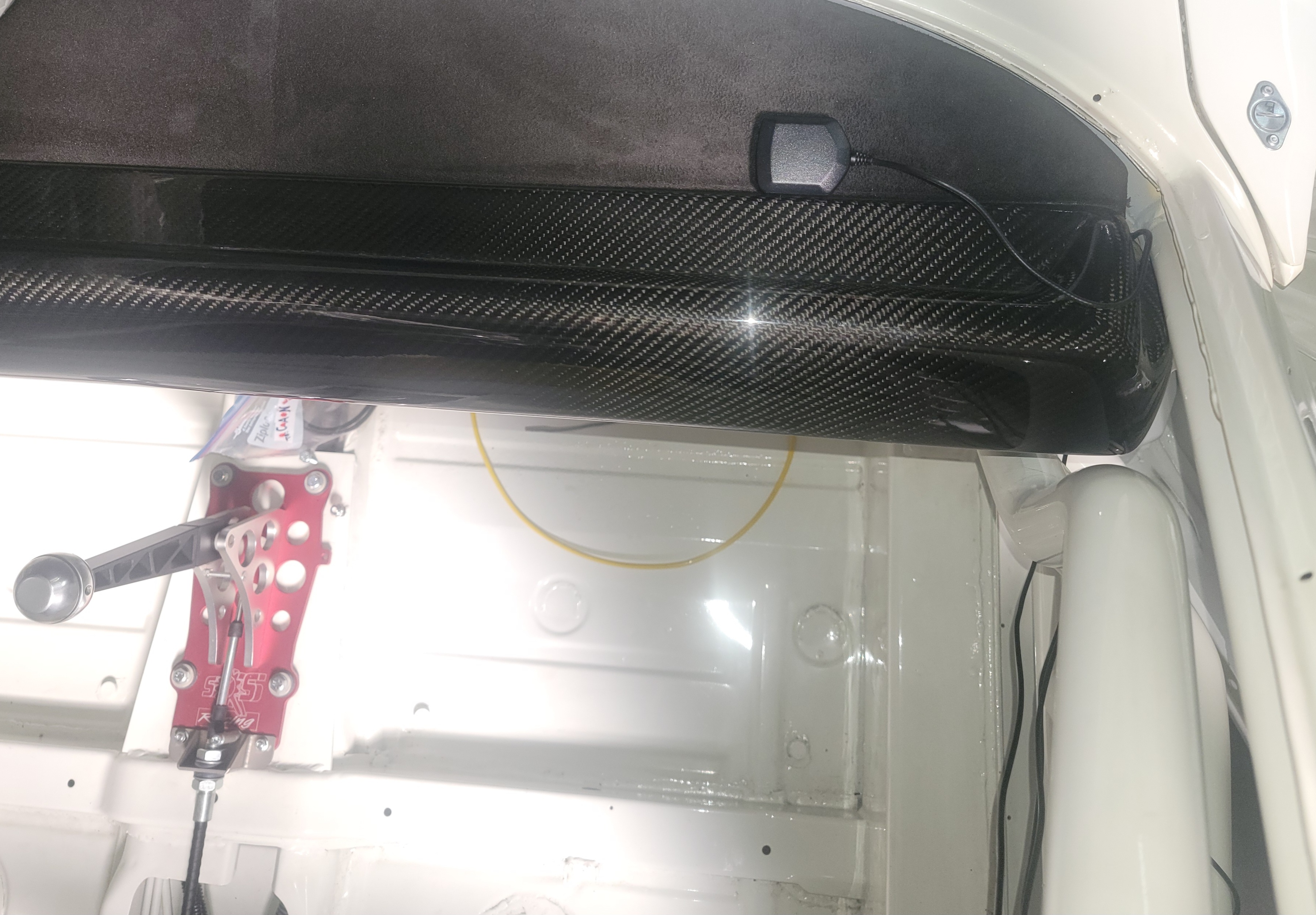

Next up GPS antenna routing for heads up speedo display.
Maltese Falcon

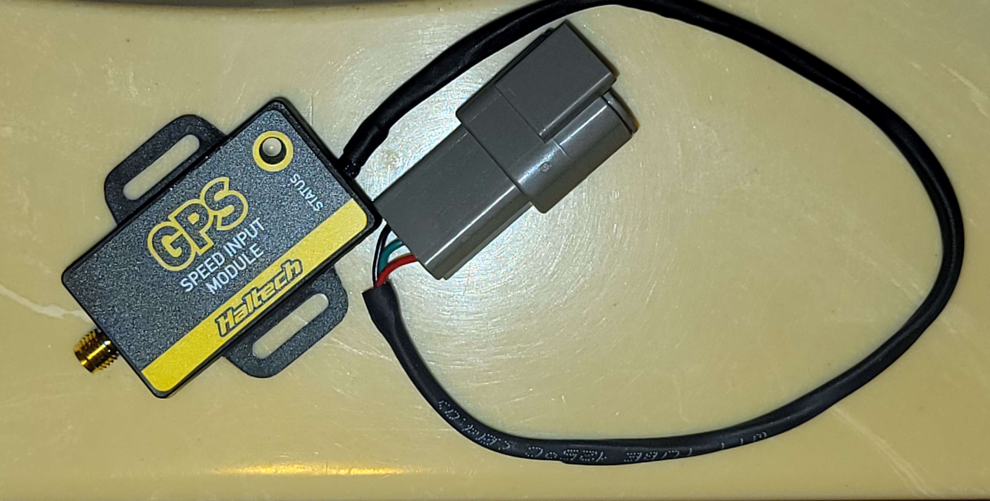

Not a final placement of the GPS /speedometer antenna, but it will be on the dash, facing upwards towards windshield.
Maltese Falcon
and another small component which works with the antenna signals, then interfaces into the ecu. MPH (or KPH) Speeds are determined by how fast the 914 travels between 2 satellites smile.gif

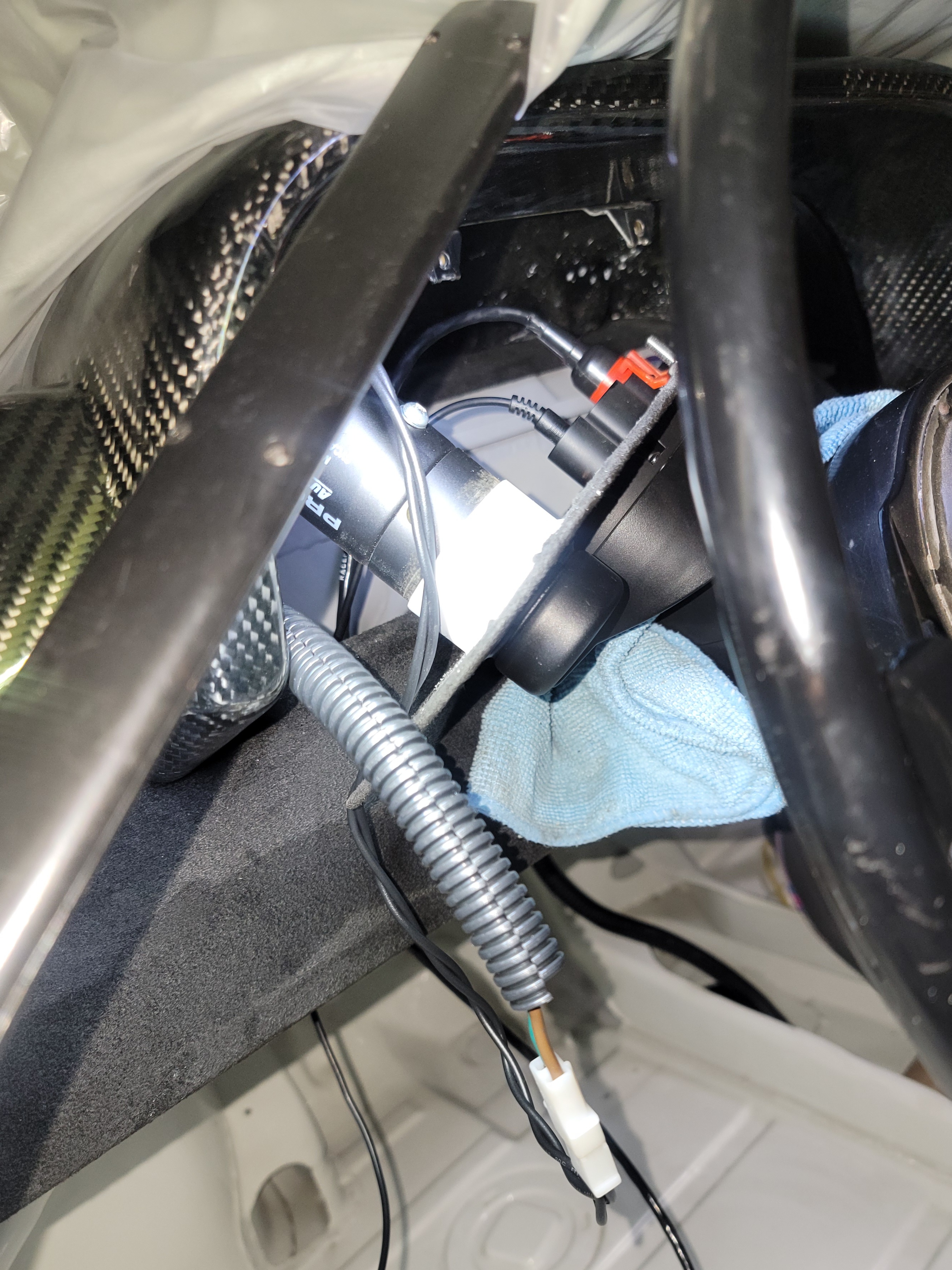

Maltese Falcon

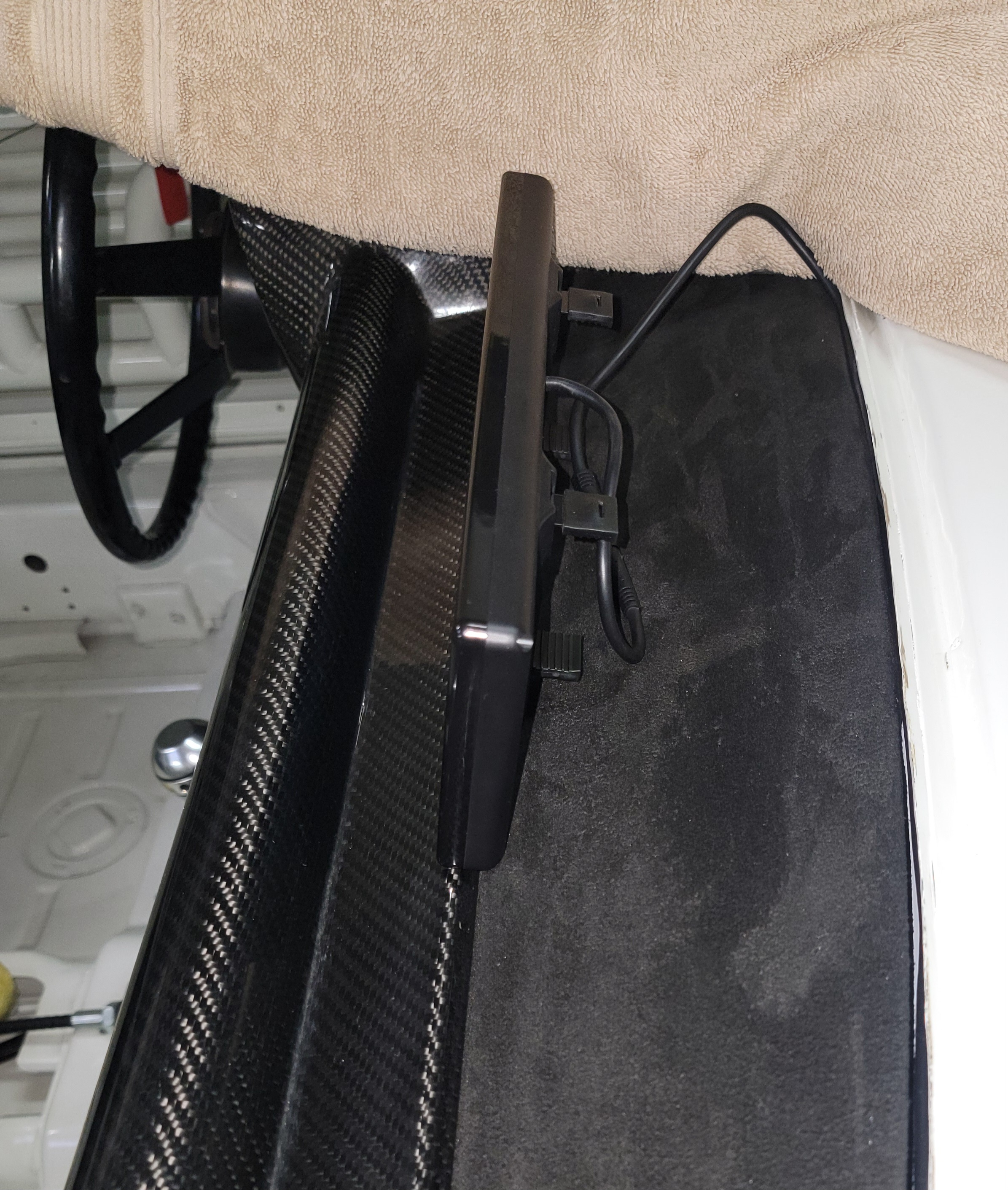

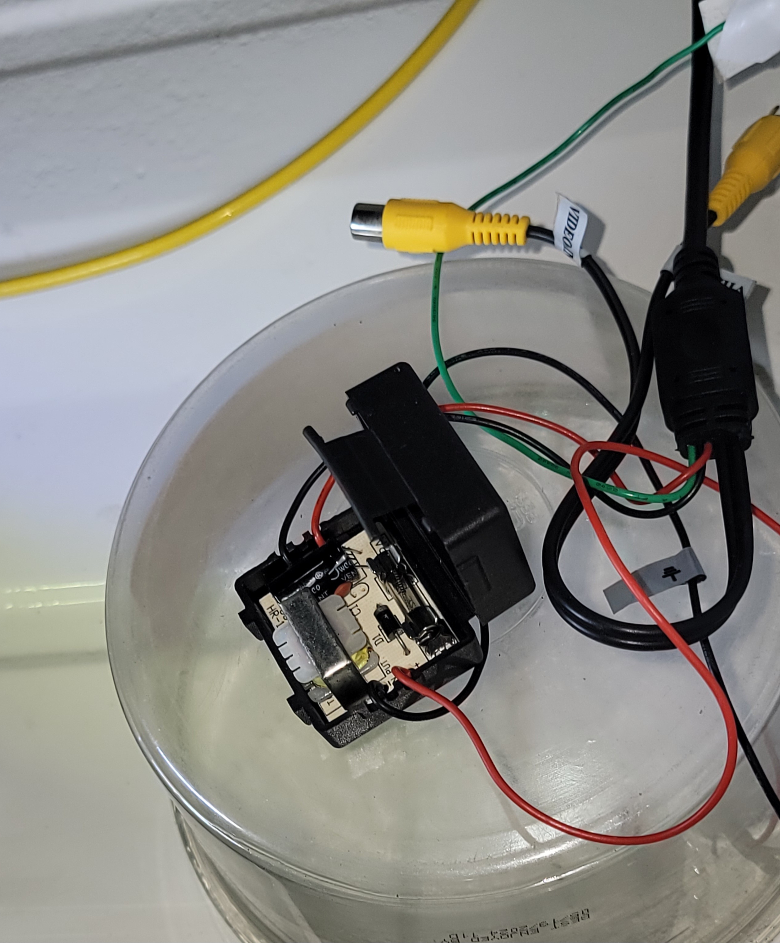

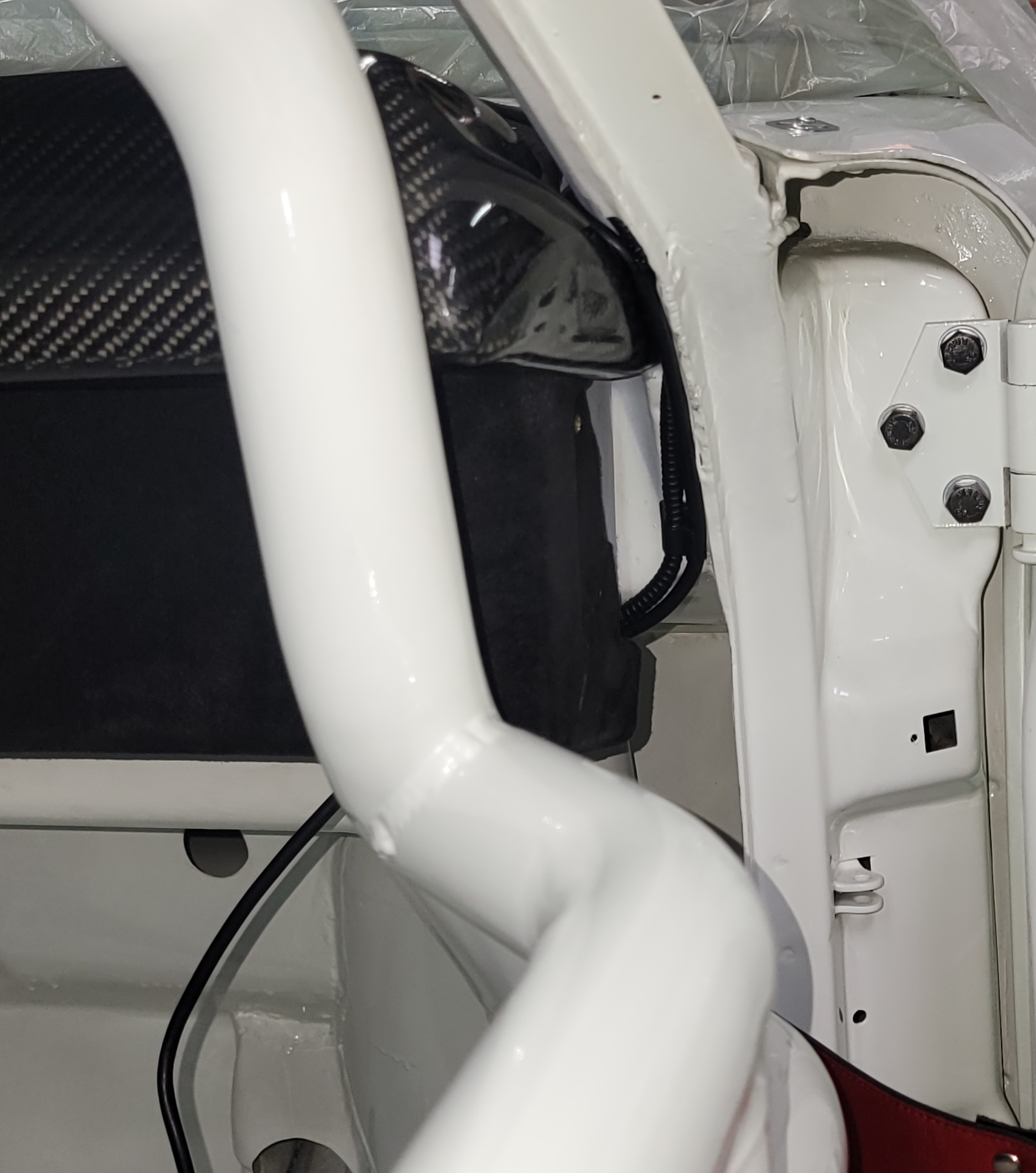

What's behind us is Important so: rear facing camera feed. Just looking at placement options
Maltese Falcon
A few improvements to the camera circuit, easier now to mount + access the small enclosed fuse.
Maltese Falcon
Routing the camera coax line through small passages...less drilling is always good ! Black cable sits in a small groove inbetween the cowl + dash top.
Maltese Falcon
Routing the ¼" camera wire cable in the dashboard gap

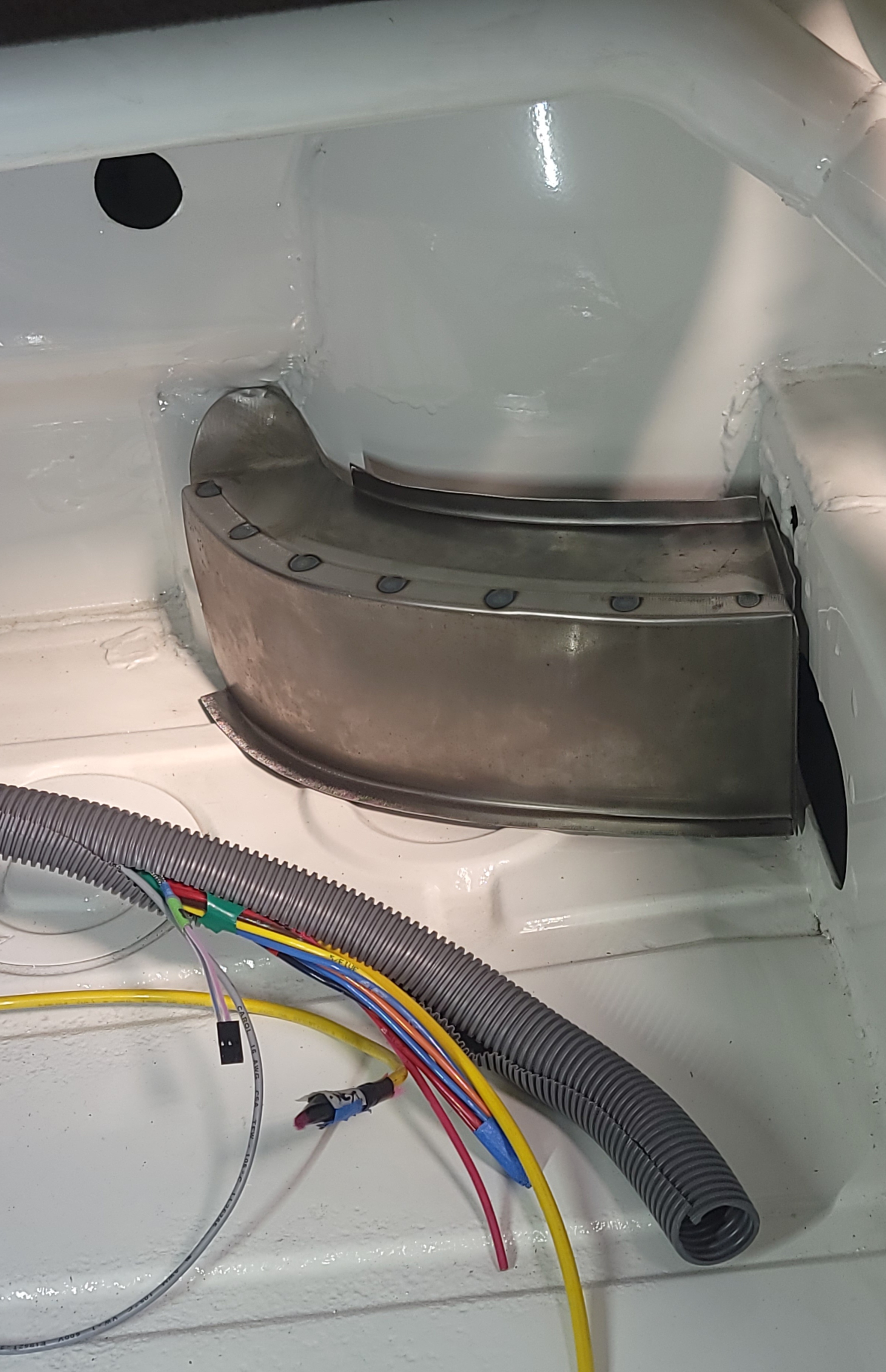

This is the custom right side coolant line cover-plate that Ben @mb911 mfg for us. It's perfect for our use, and since I've elongated the oe opening.. only a small 2×3" piece of sheet is needed to seal it up.

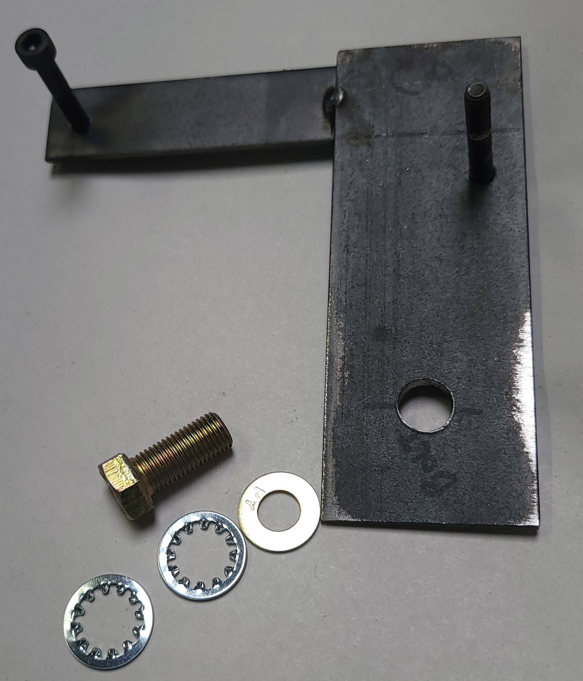

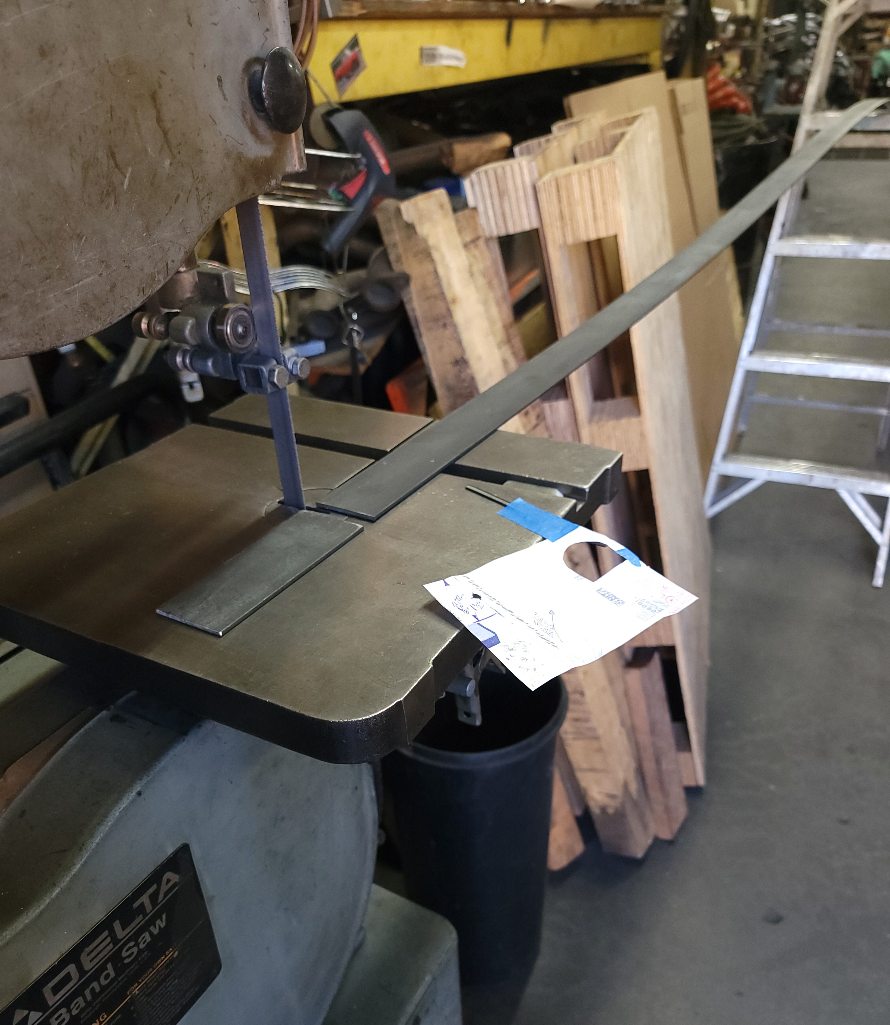

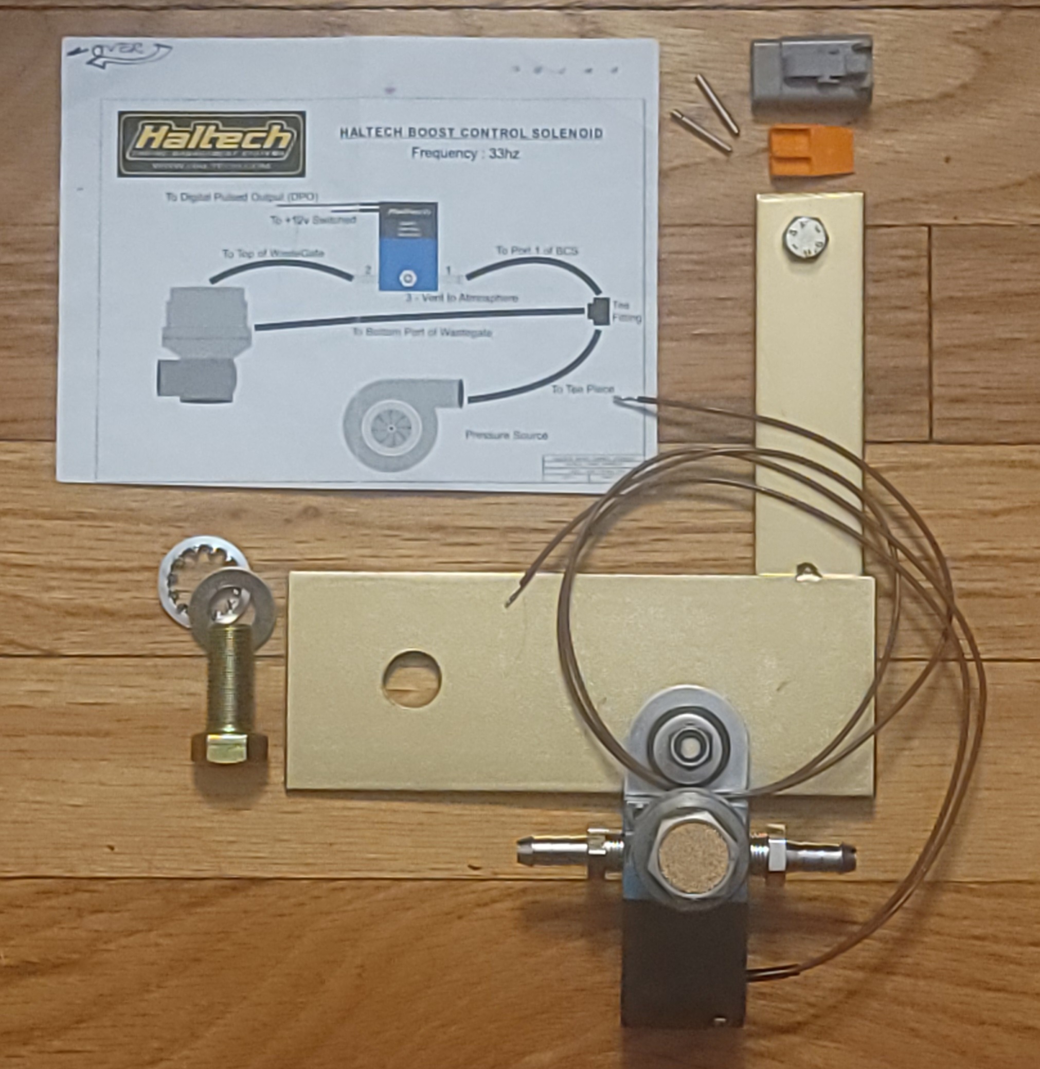

Let's make a boost-solenoid bracket
Maltese Falcon
Basic layout.
Maltese Falcon
Ready for engine bay mounting, then finish hooking into the ecu wire harness.
The upper 6mm bolt at the top of bracket will be a fastening point for 1 of the fire suppression nozzles.
