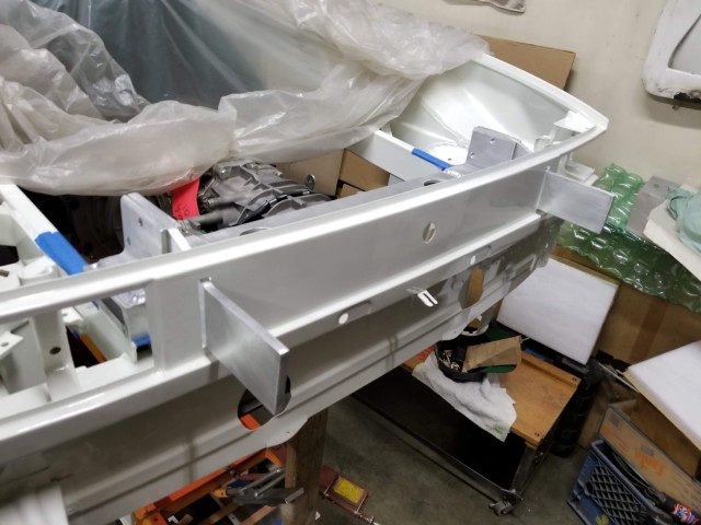

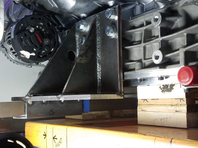

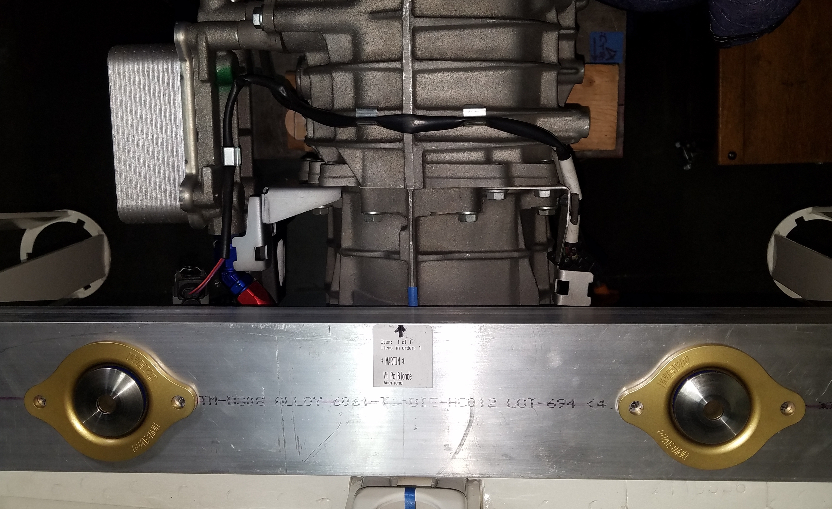

Top Alum piece connects everything to the unibody, transaxle rides on Wevo semi-solid mounts
sb914
pray.gif Marty is the man! Can't wait to see it.and when's the next parking lot party?
Maltese Falcon

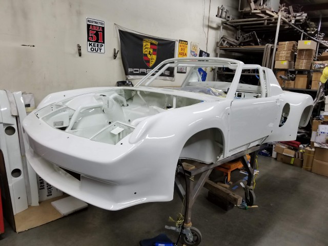

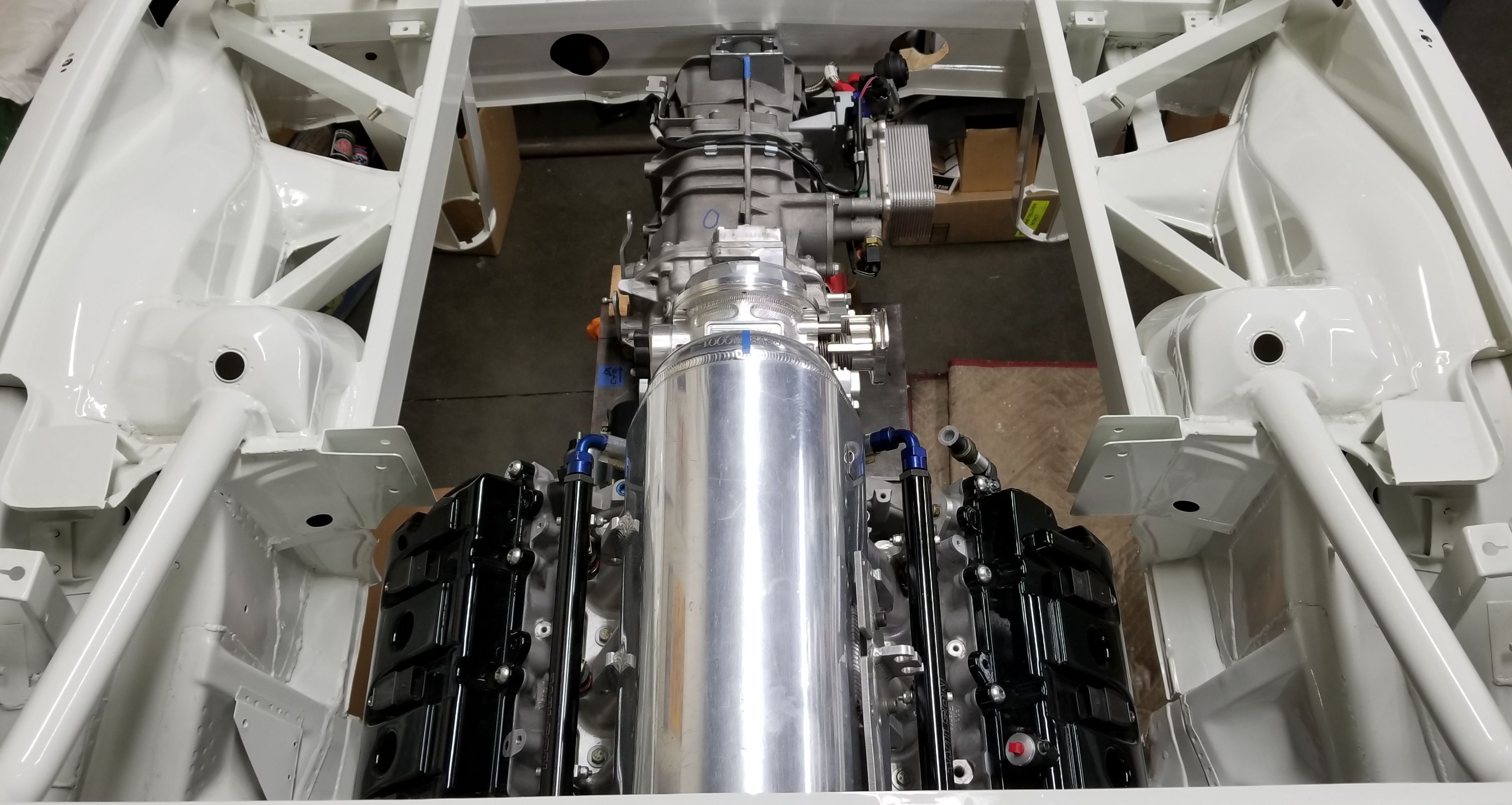

Aerial view...I actually brought the drivetrain up a bit higher so the underbody diffuser is flush to the floor pan smile.gif Click to view attachment

MATTYLITE
Hi everyone,

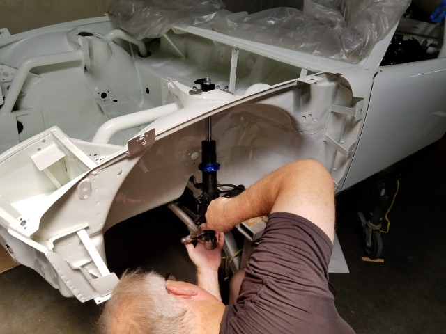

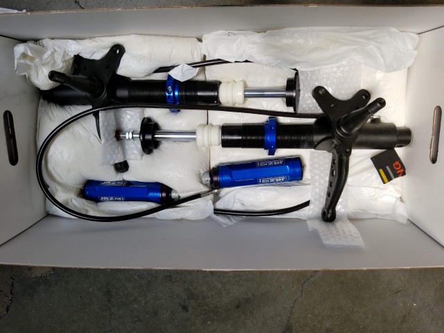

Just wanted to share our progress with you all as we near ever closer to Rennsport Reunion.
We're eagerly awaiting to show you this work in progress project of ours in person, so come stop by any time throughout the event and see for yourself, and don't forget to stop by our vendor booth at 5:00 pm on Saturday 9/29 for the 914 World get together! beerchug.gif
We have been diligently working with Cary Eisenlohr of Eisenlohr Racing Products (ERP) in association with Tarett Engineering to create our 935 front suspension w/ full JRZ coilovers and extended reservoirs.

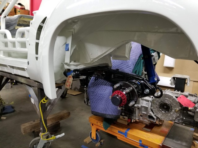

Carey getting hands on
IPB Image
IPB Image
Also, a big shout out to 914 Rubber for the great turn around time on making our steering rack look and feel brand new!
IPB Image

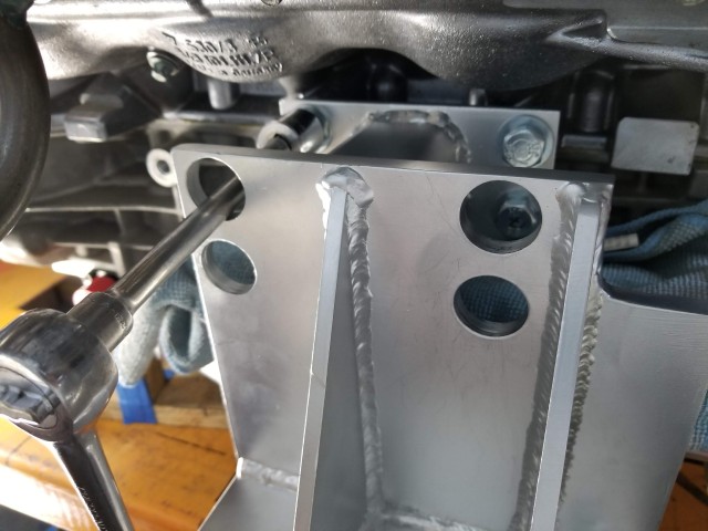

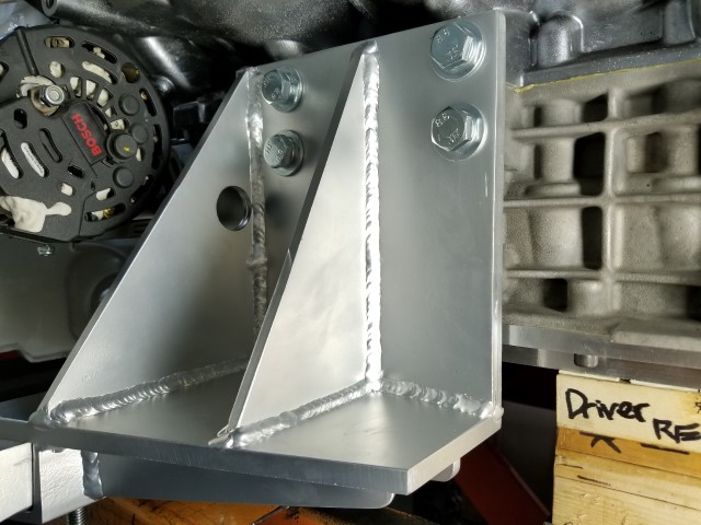

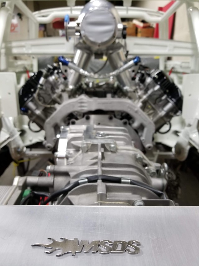

Below are our engine mounts & bar, in which we had ceramic coated.
(Don't mind the bolts in the pic as they're temp for fitment purposes)
IPB Image
IPB Image

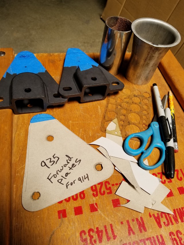

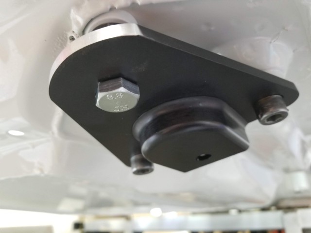

In the middle, you will notice our lower transaxle mount, which is part of a 2 mount set - up.
IPB Image

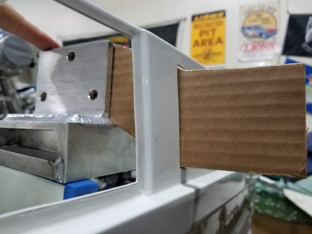

Below is the upper transaxle mount, which also supports the forthcoming wing upright mounts.
IPB Image
IPB Image
IPB Image
It's all starting to come together.

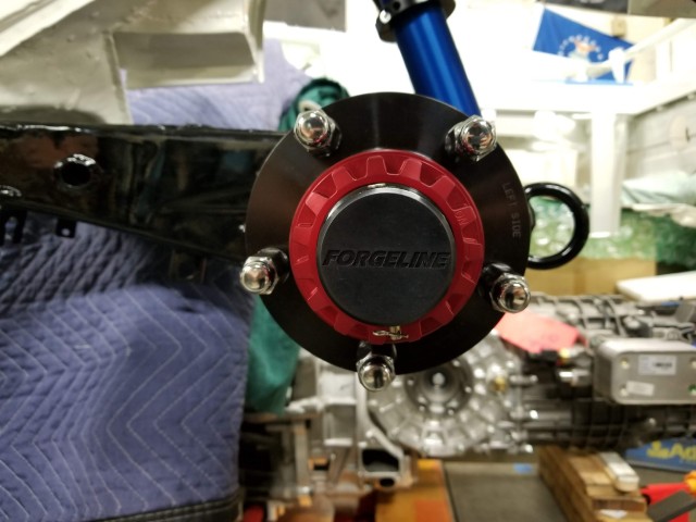

The car will be on display showcasing the Foregline 5 lug Centerlock Conversion Kit, but due to this still being a work in progress, it will be rolled on the Panasports.

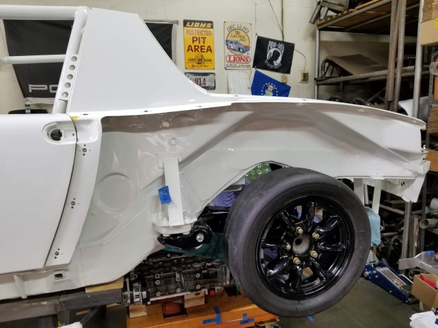

WhiteTwinTurbo >>
I'm sure that we can adapt this wing mount system to a normal 914 trunk, just needs to directly push down on the rear suspension. Feel free to bug me after September for details !

So the metallic ceramic coating was chosen for corrosion resistence, fast dissipation of heat (this biturbo engine will radiate lots), and we will be able to get our hands in there after a quick cool down>> for minor pit repairs. Nickel chrome= too much bling , and golden zinc was our first choice...but the zinc contractor smoke.gif guaranteed us that 10% of my parts would sink to the bottom of their automated tanks and lost. I also send large orders of product in weekly to the ceramic shop, so adding these mounts in was cost effective, all parts back in 3 days, nothing missing biggrin.gif
Great build and I'm happy to bug you after Sept.
What does wing are you attaching?

Brand+ style of wing can be seen on the opening pages of this thread ; the two alum uprights are in our final design stage and will be water-cut to final shape smile.gif

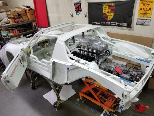

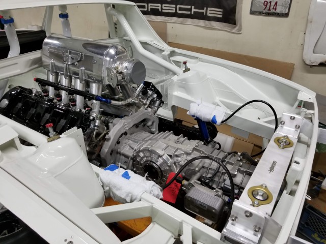

MATTYLITE
We can't wait to show you what we've been working so hard on these last several years, and especially these last several months just to get it into its roller state for Rennsport Reunion.
Here's a quick look of where we're at.
IPB Image
IPB Image
The beefy motor mounts.
IPB Image
IPB Image
The interior is finally taking shape.
IPB Image

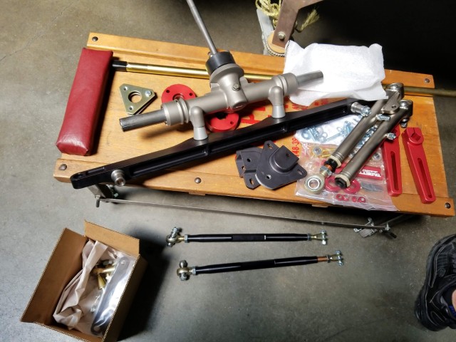

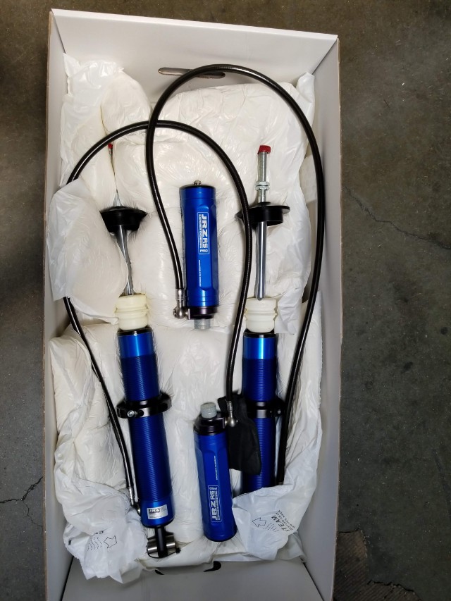

Getting back into assembly of specialty equipment to the project; starting with the SQS sequential shifter moduleClick to view attachment

I bet some trick engineering went into designing and making that puppy. Wow.

Using a (3 phase) electric cord to get the sample length for the shift cable construction ; A local mfg. says about 1 week turnaround for the finished cable .

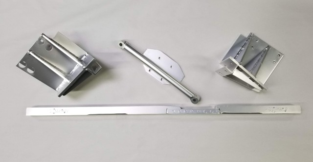

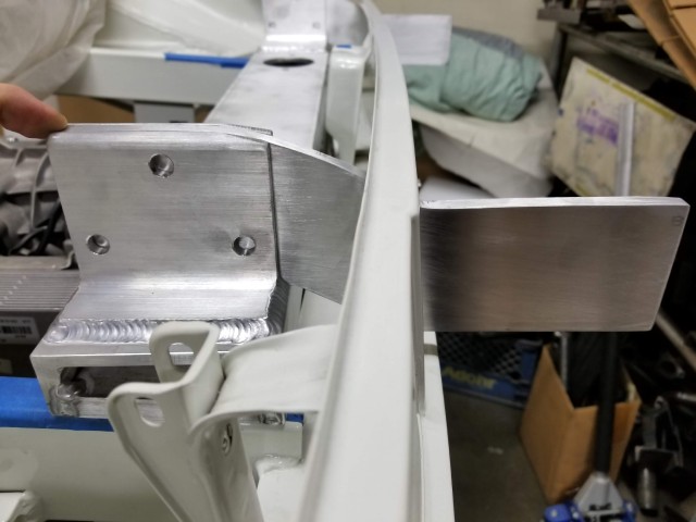

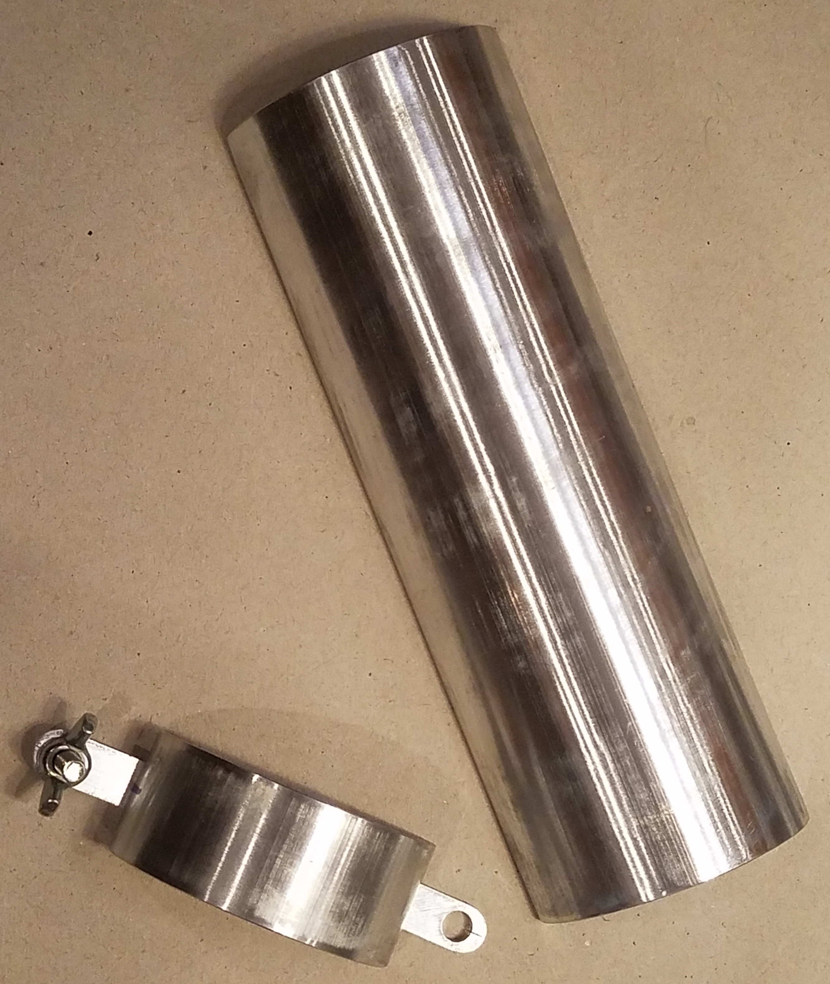

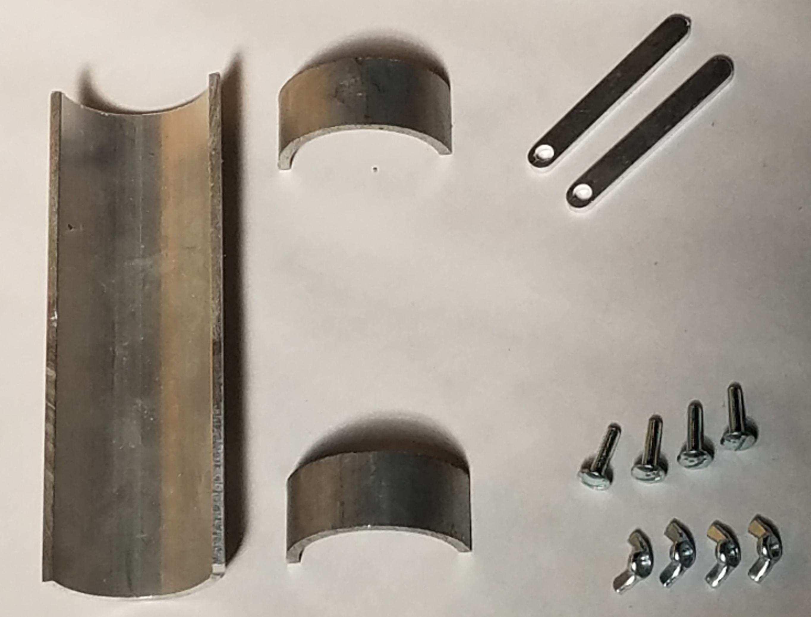

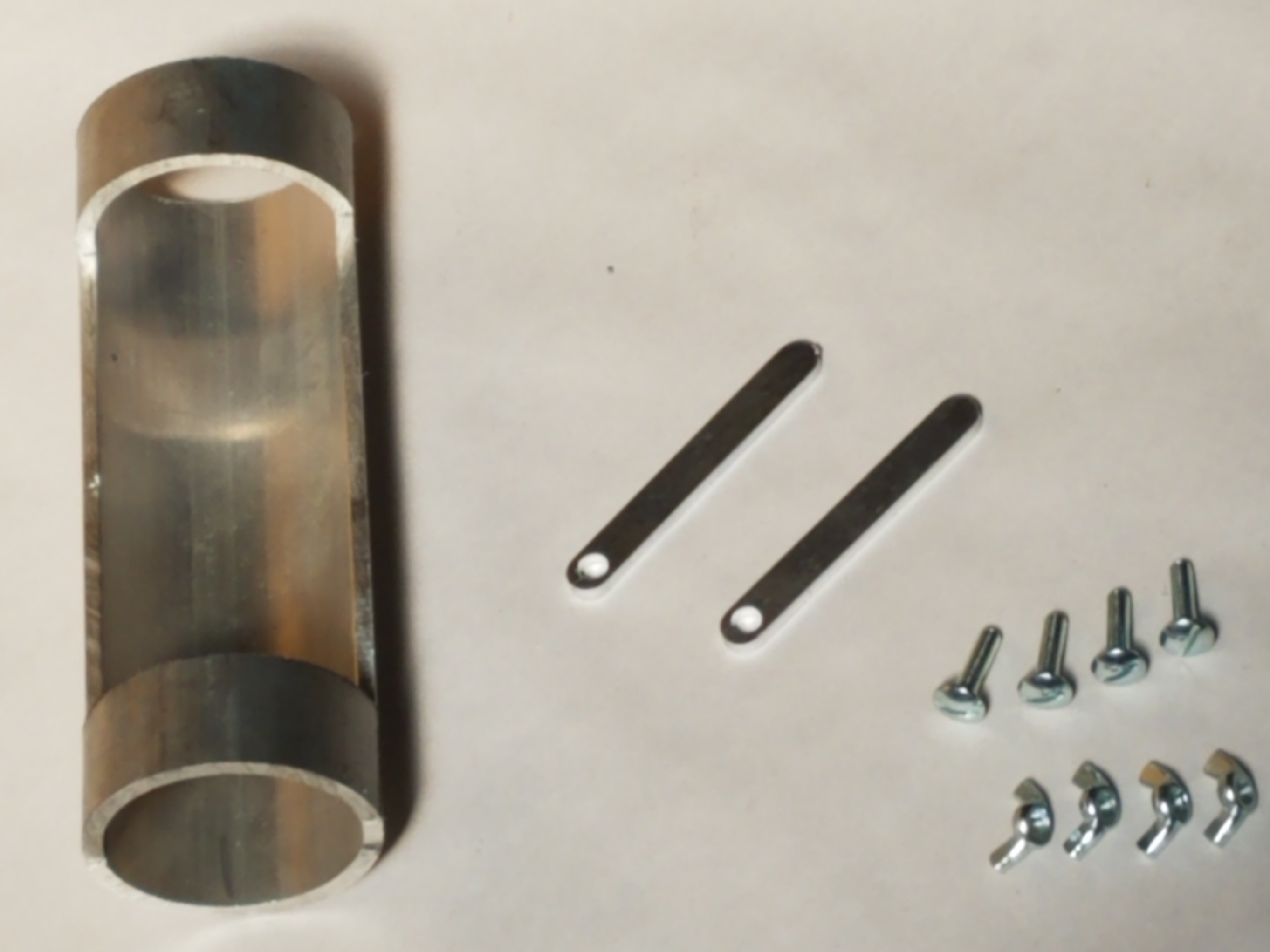

The new JRZ suspension does not come with supports, nor brackets to hold the nitrogen canisters....just not for sale SO; building 4 of these tubular aluminum sectional housings to keep things in place. At Rennsport6 we just wrapped in small towels & zip tied !
Maltese Falcon
Pieced together, minus the tightening tabs ...which need to be cut to size and Tig'd in place
Maltese Falcon
What do you say; leave alum sheen OR color match GP white ?
