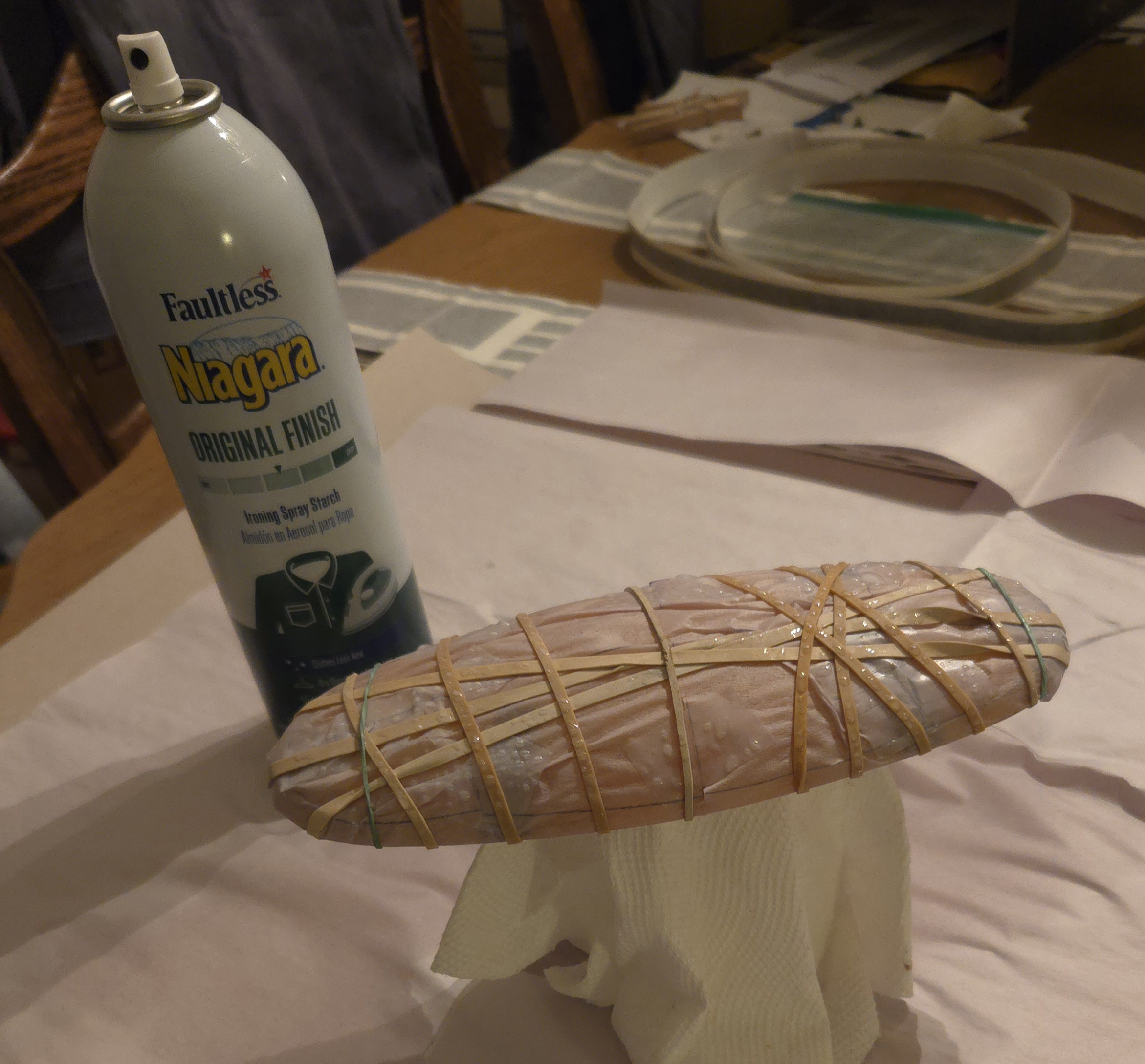

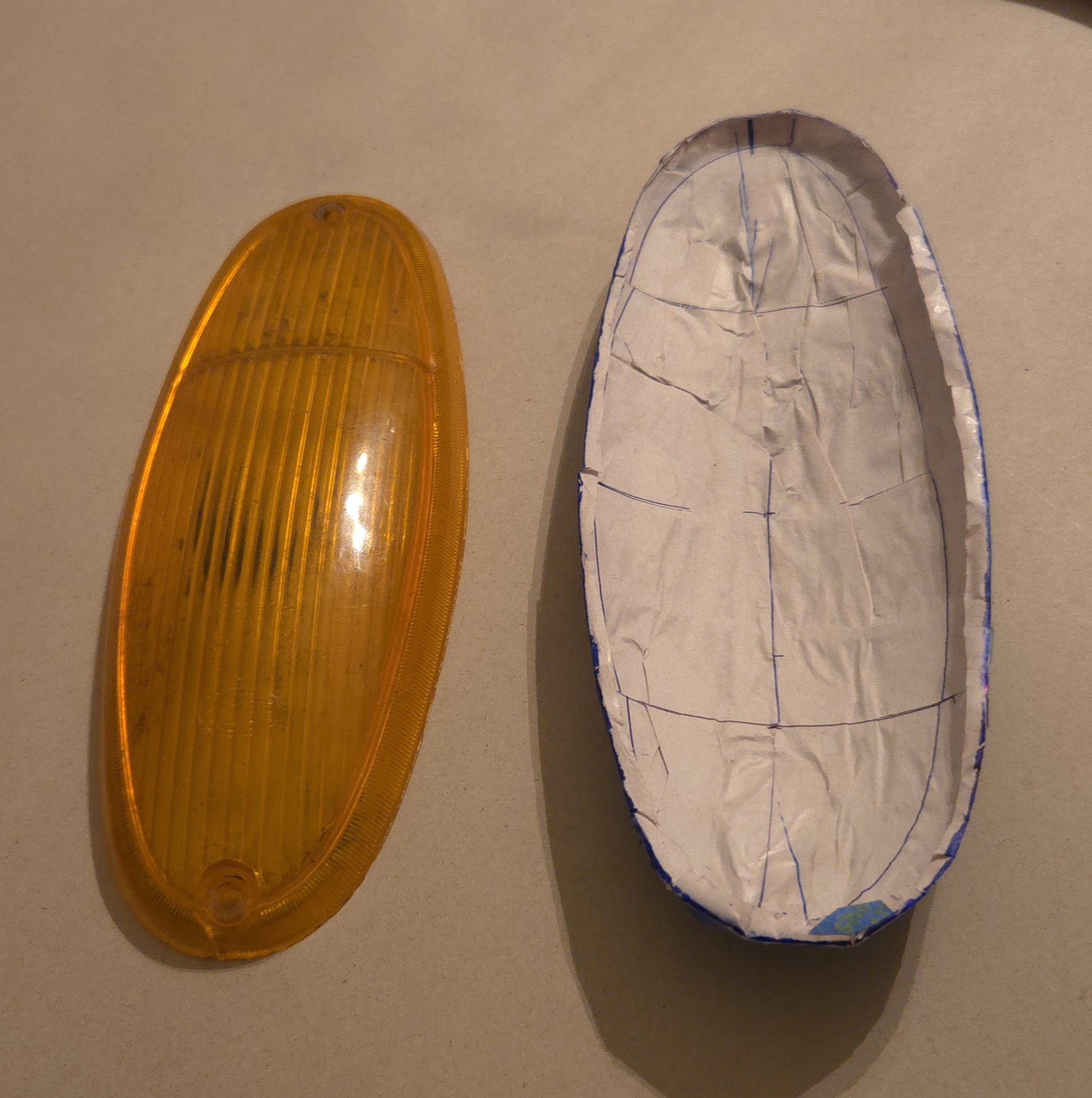

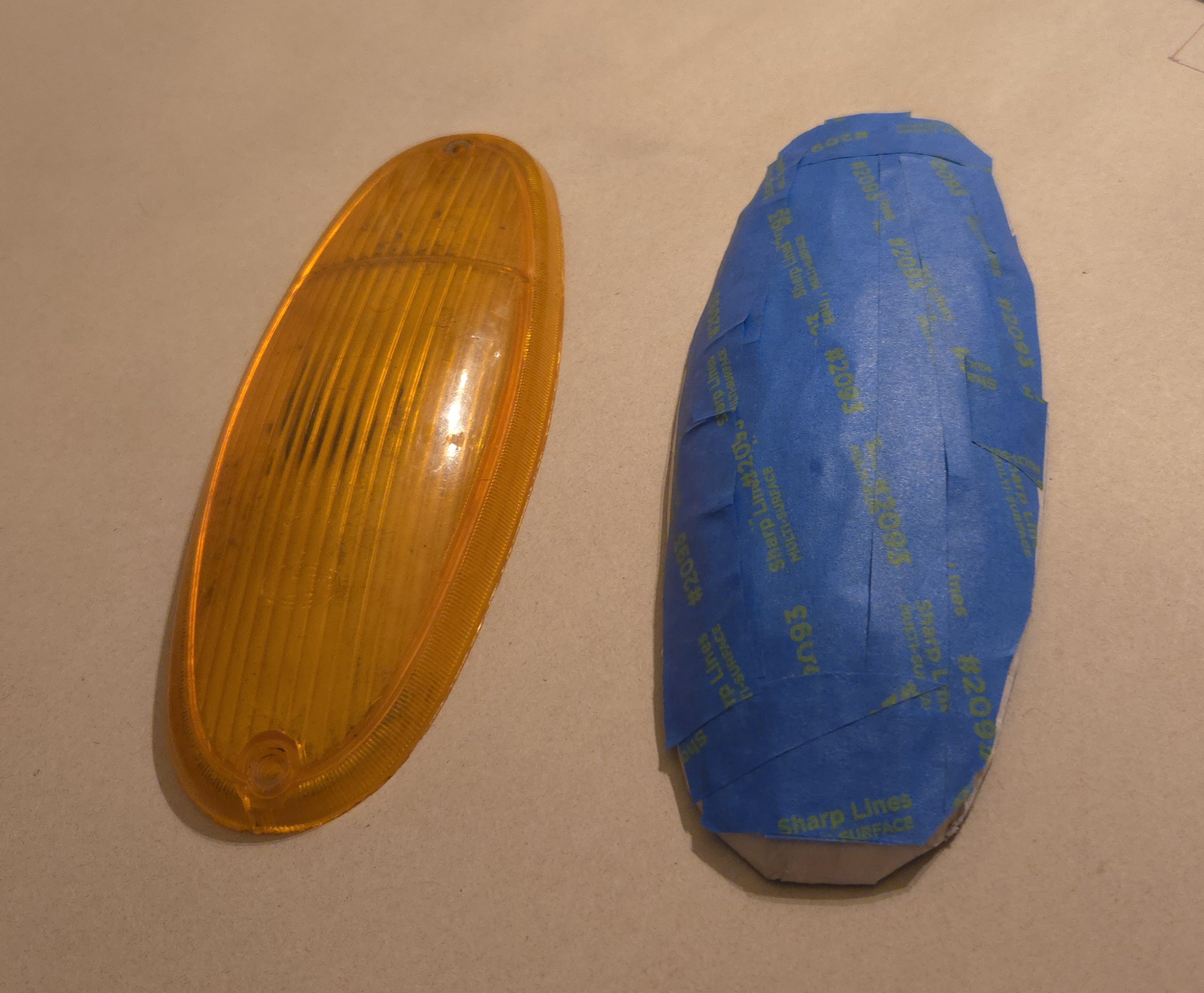

On the advise of @FL000 , I've fabb'd up a 'Mold of the lens using paper + spray starch. Several coats of starch, heat gun to dry and finished product came out good.
Maltese Falcon
The finished shell is a 99% copy of the lens and stays in shape while placing on top of the Sheridan 'bump at the top of fender.
Maltese Falcon
Another view, masking tape will keep it in shape for the cutting outlines.

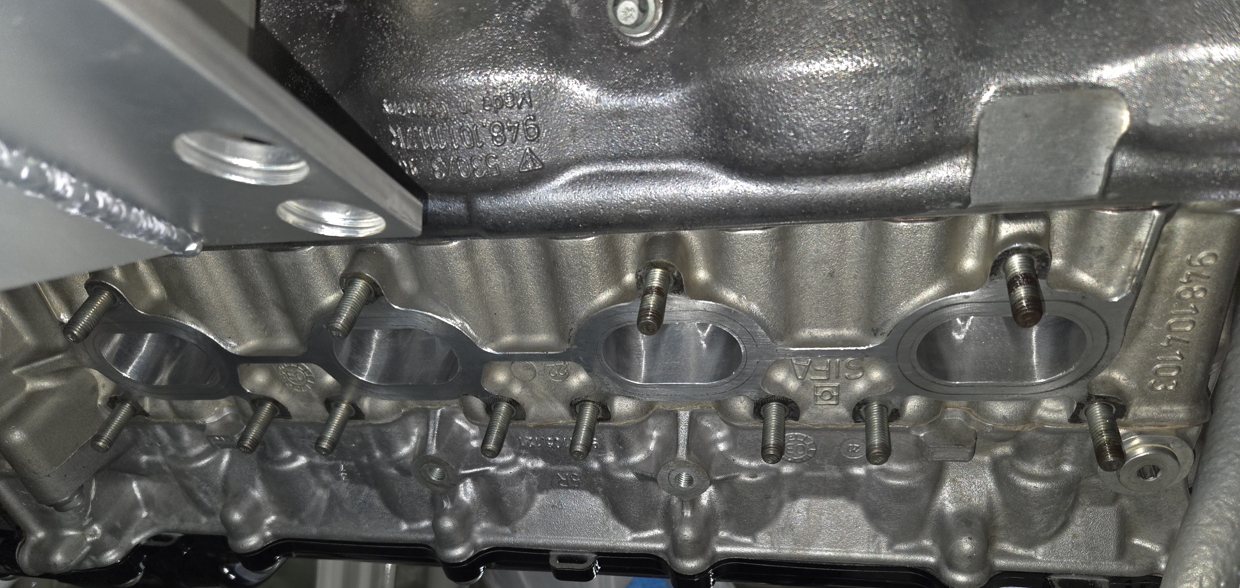

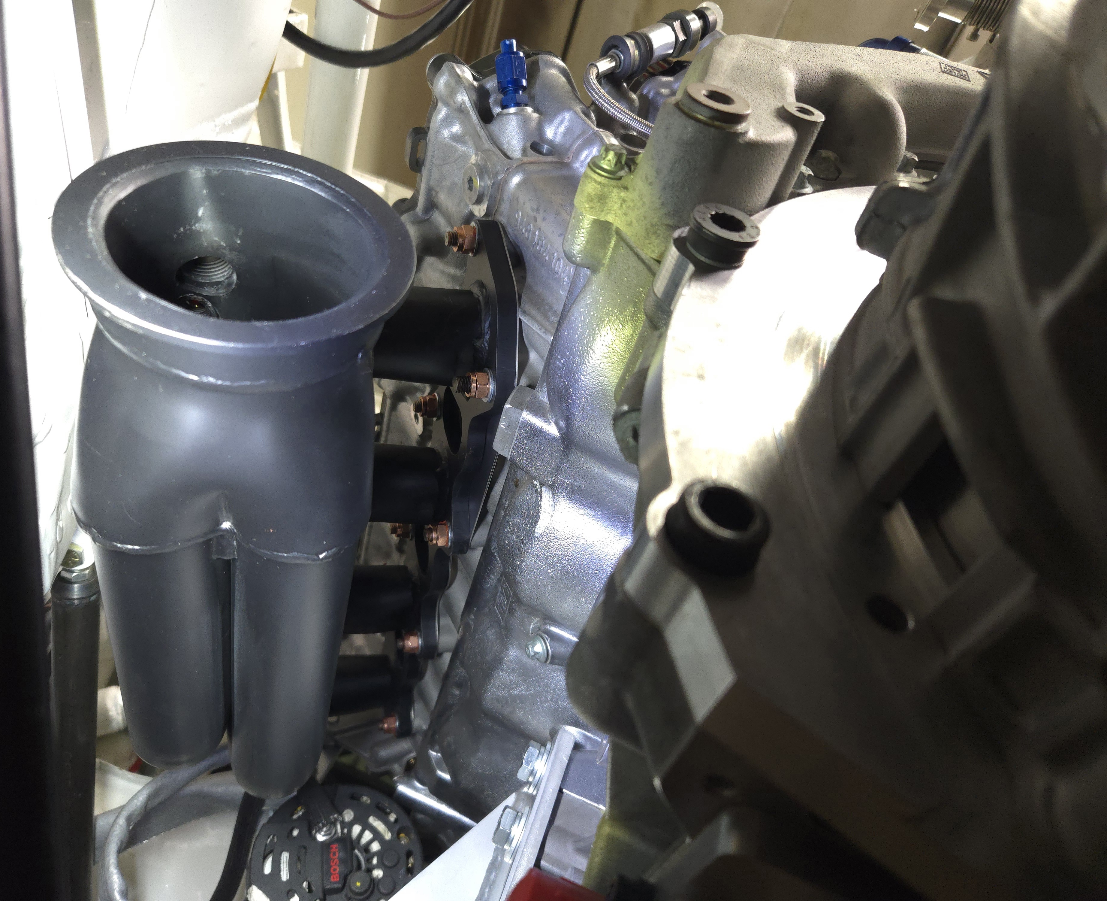

Final torque on the shorty turbo headers exhaust nuts, while I was in that area today smile.gif
Maltese Falcon
One last view of the polished + ported exhaust chambers, and the R-side header was fastened down today. LBP Lozano Bros. Porting in New Braunfels TX does nice work !

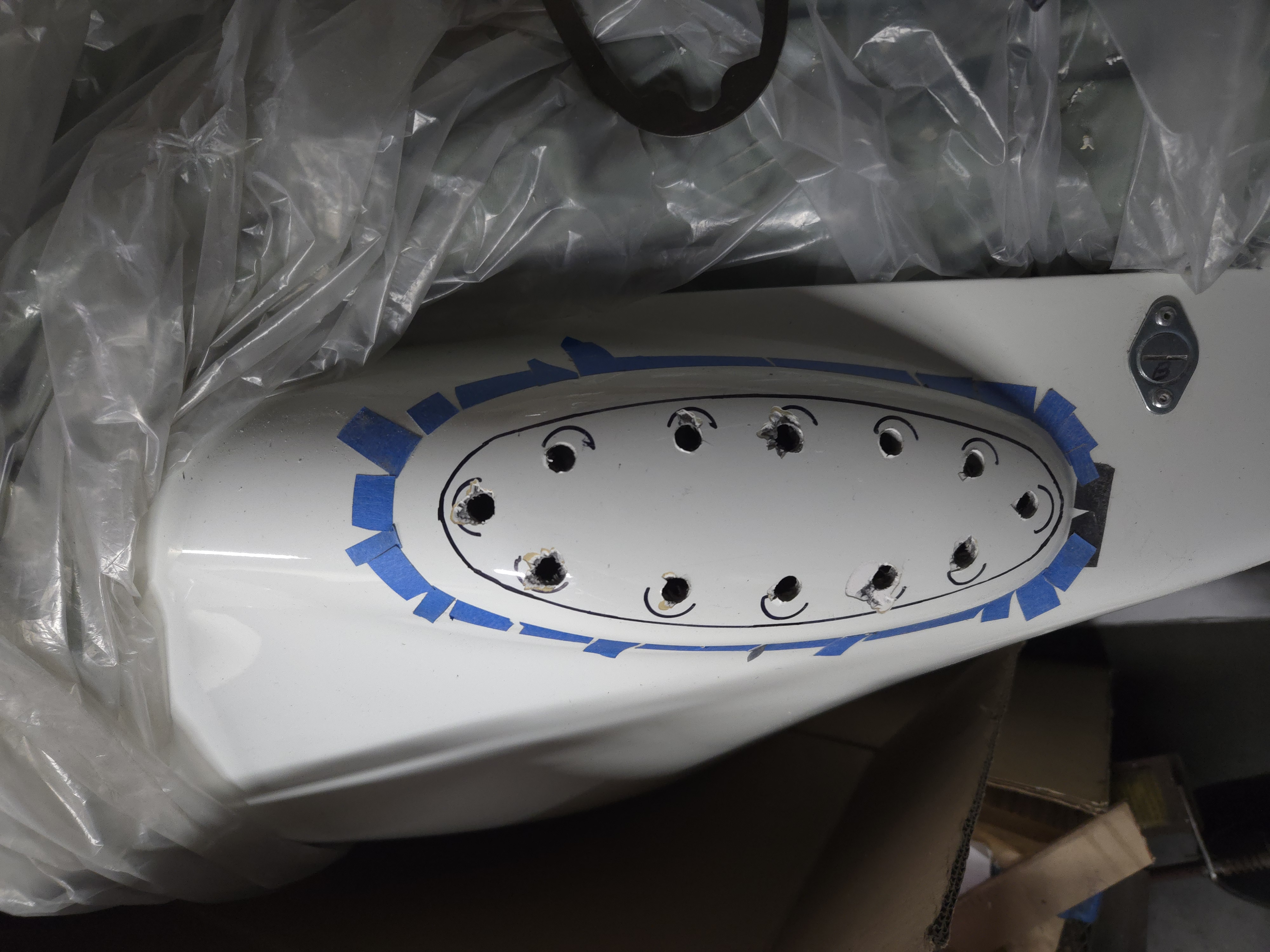

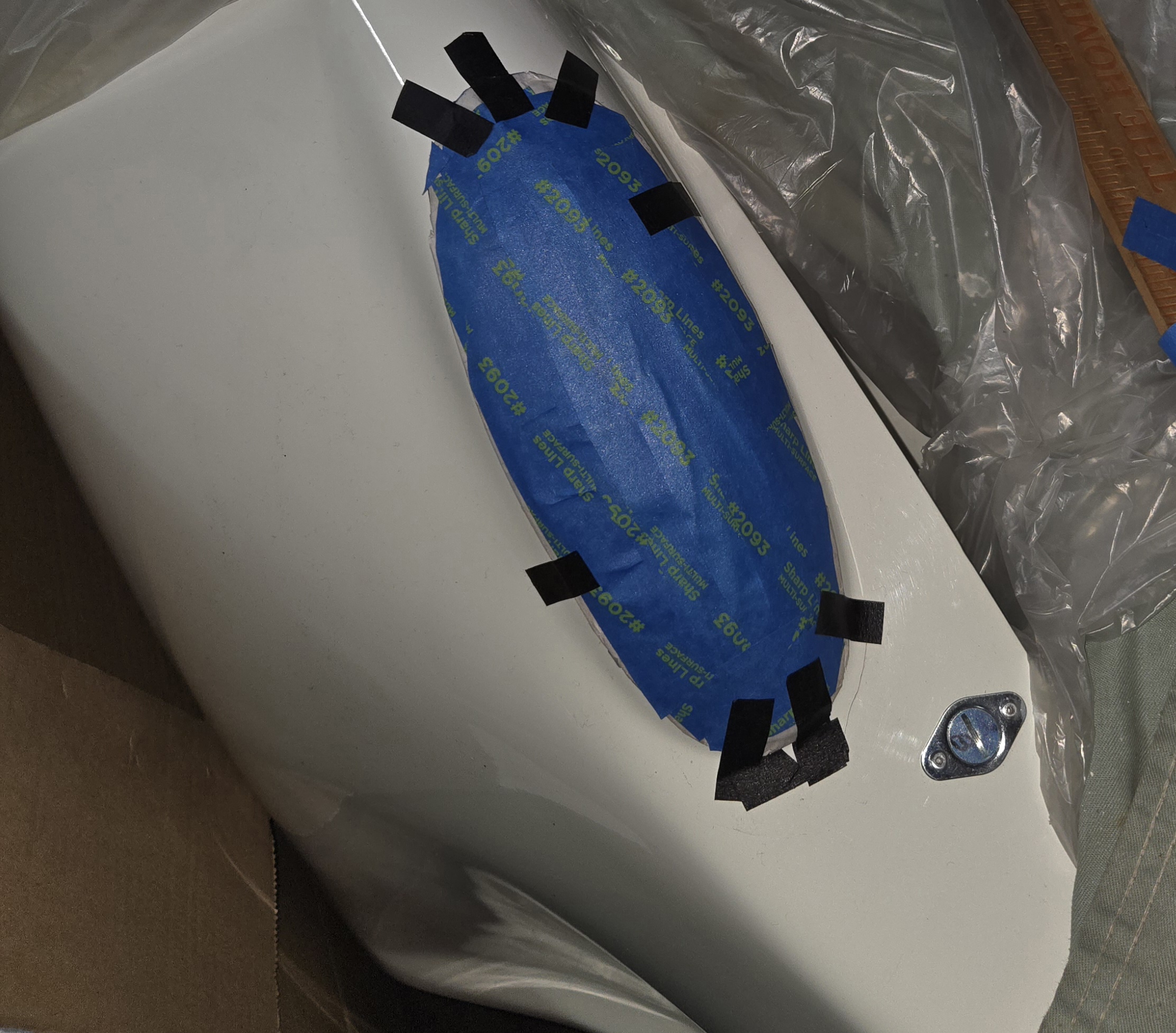

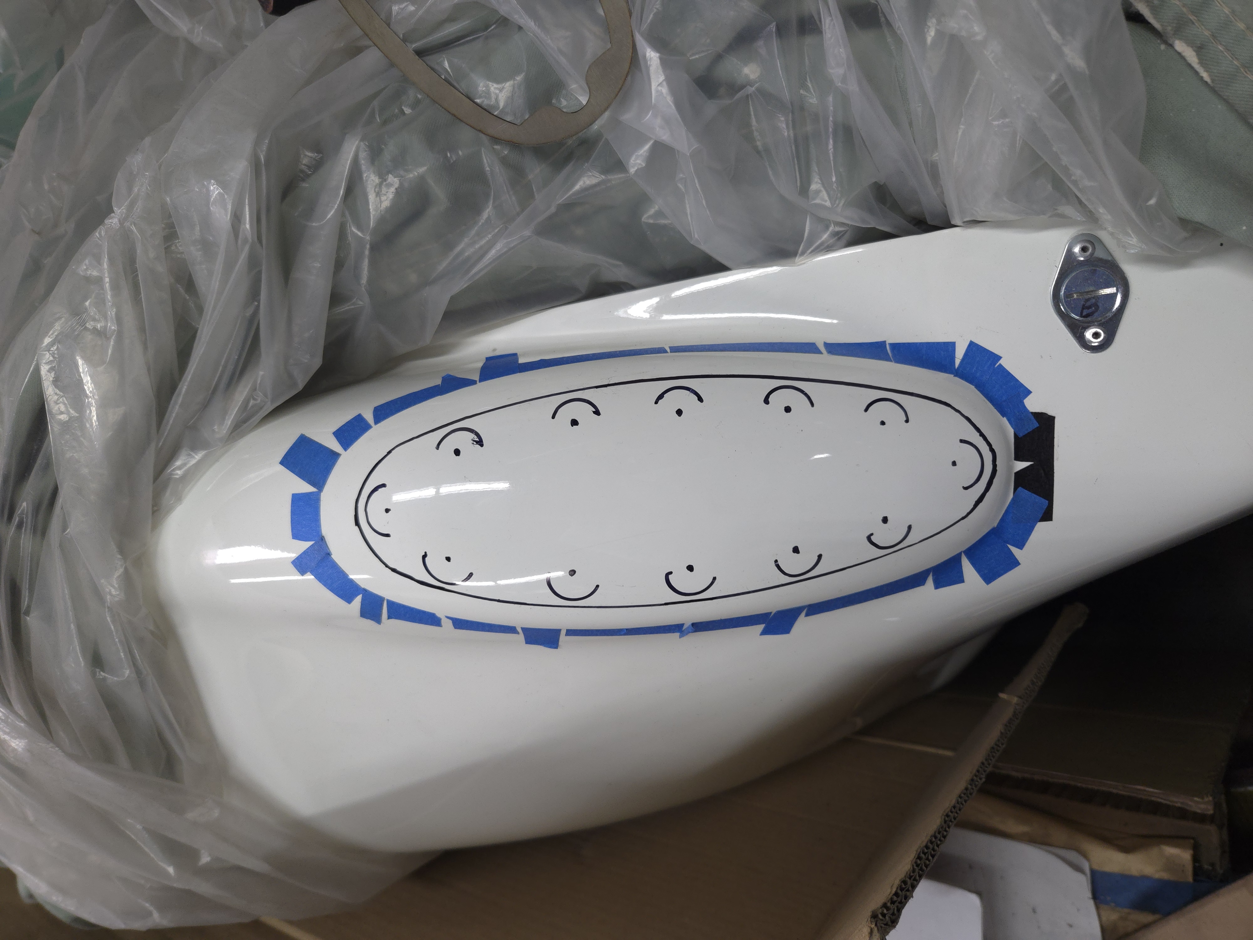

Just a sharpie tracing remaining + let the cutting begin

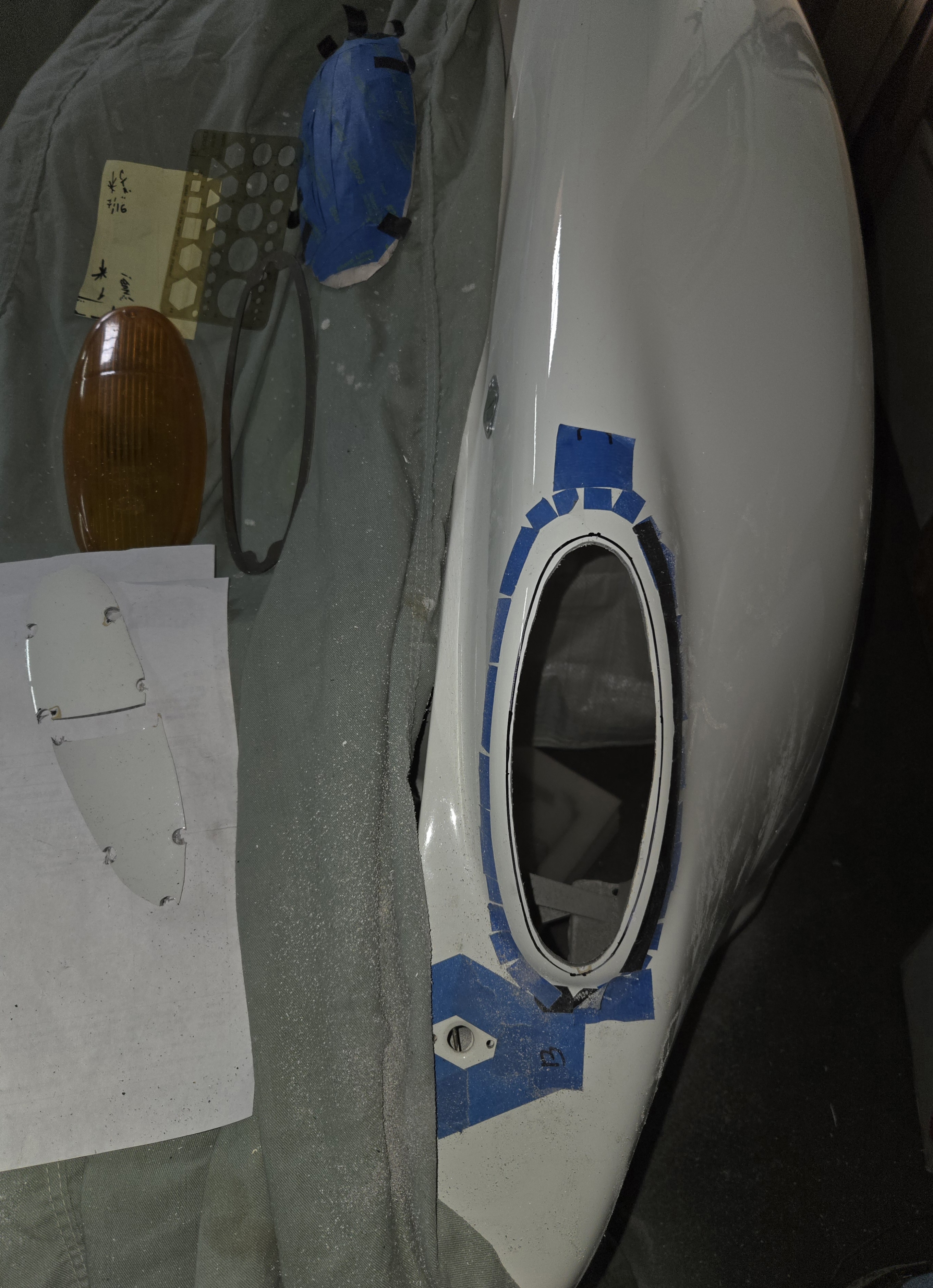

Maltese Falcon
Layout for ⅜" pilot holes
Maltese Falcon
Pilot holes...ready for (fine blade) jig-saw cutting
Maltese Falcon
Cut and contour finished up with dremel + hand sanding to spec
Maltese Falcon

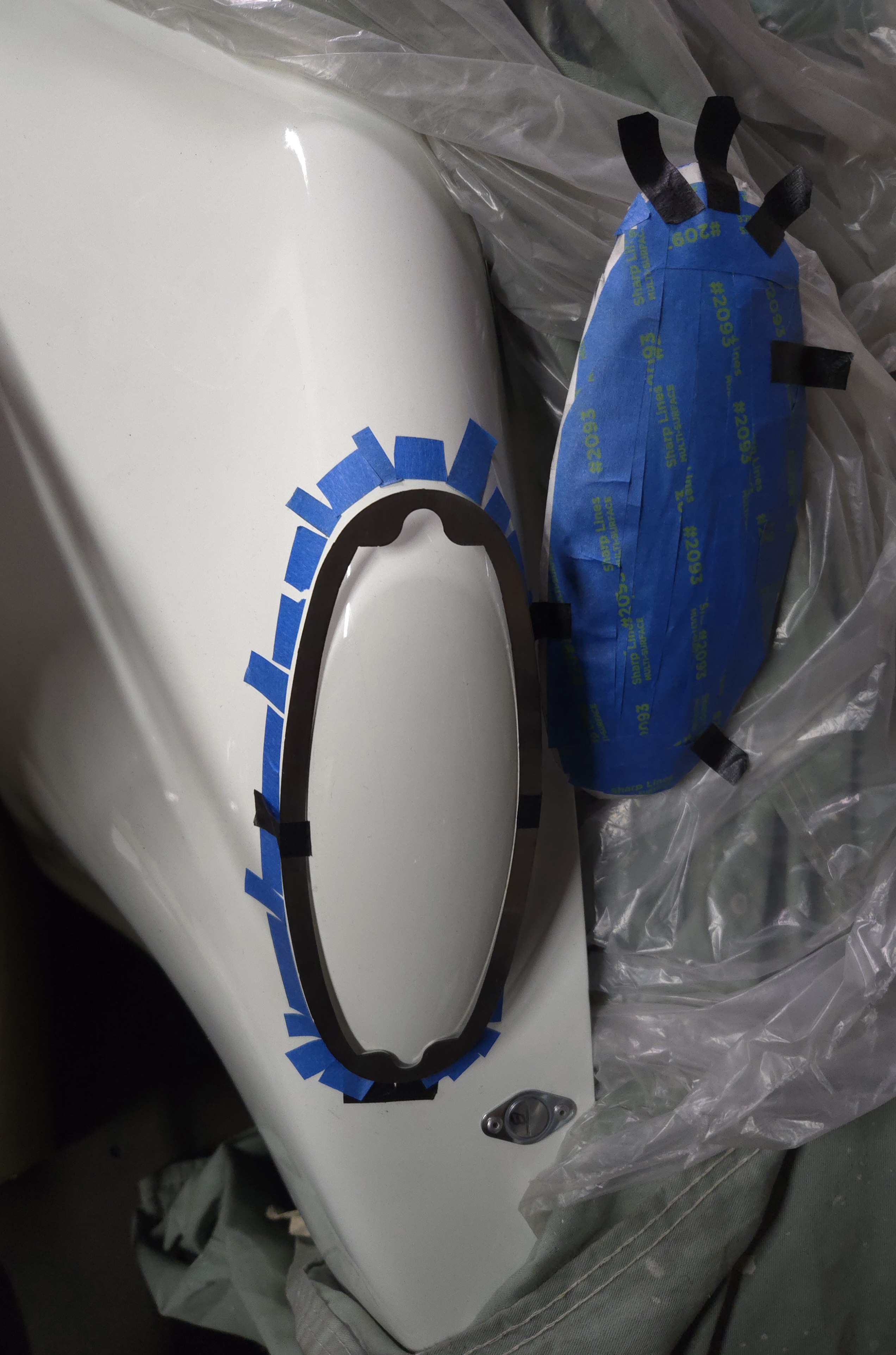

3DGauto headlight pod fits like a glove; thank you Josh @FL000 for the cardboard template idea !¡

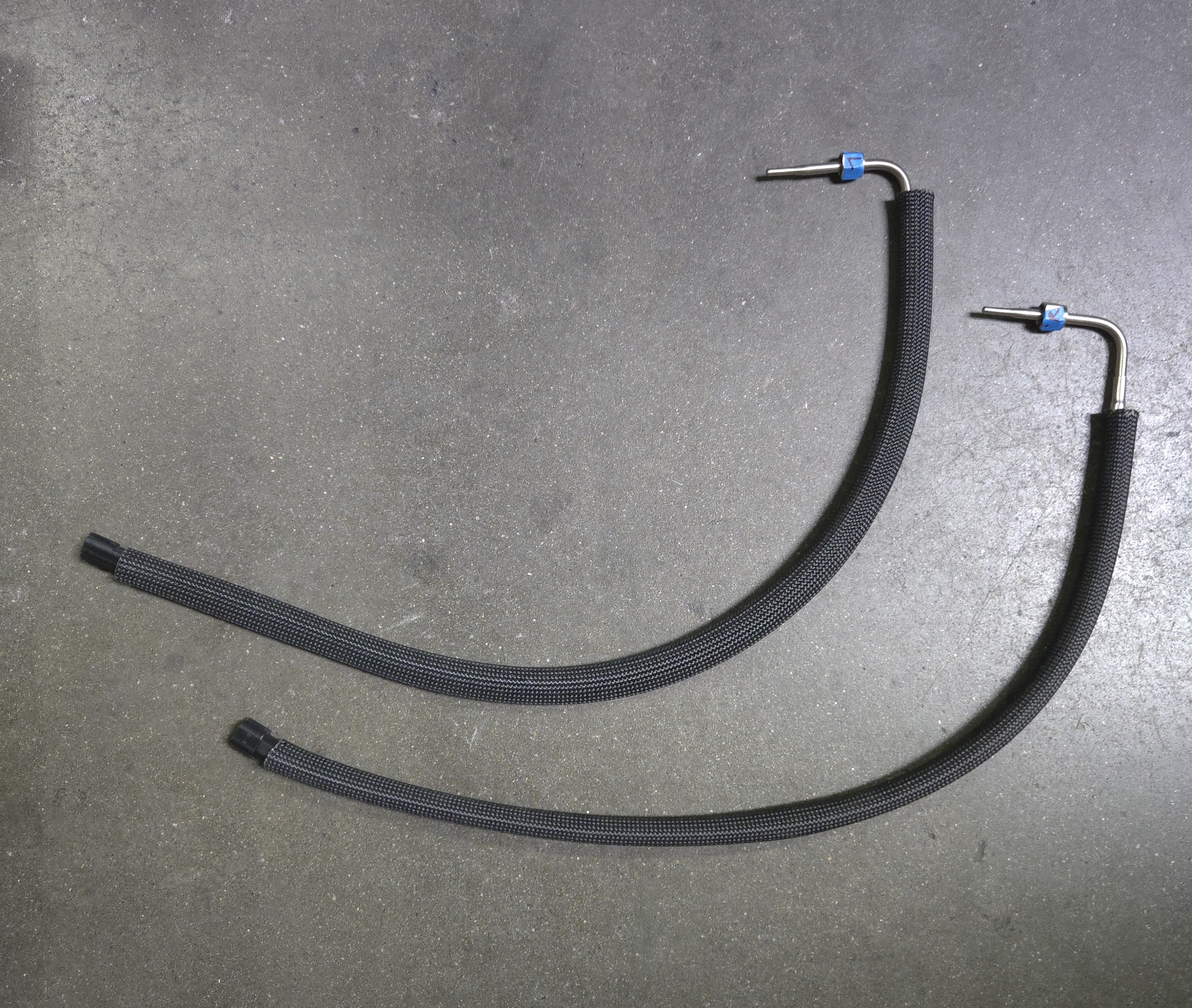

Left and Right side header EGT sender cables...now wrapped in heat protection sleeves

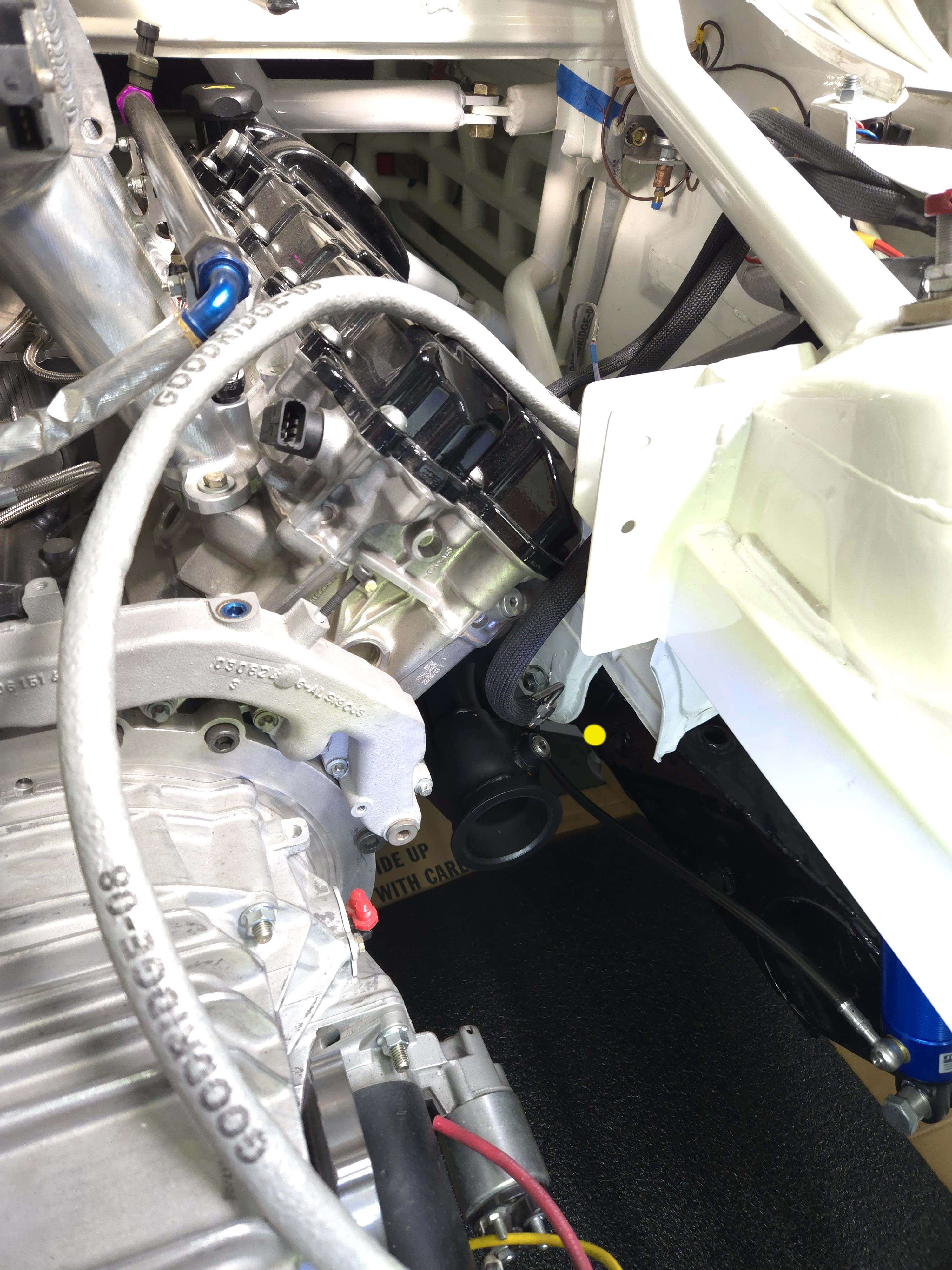

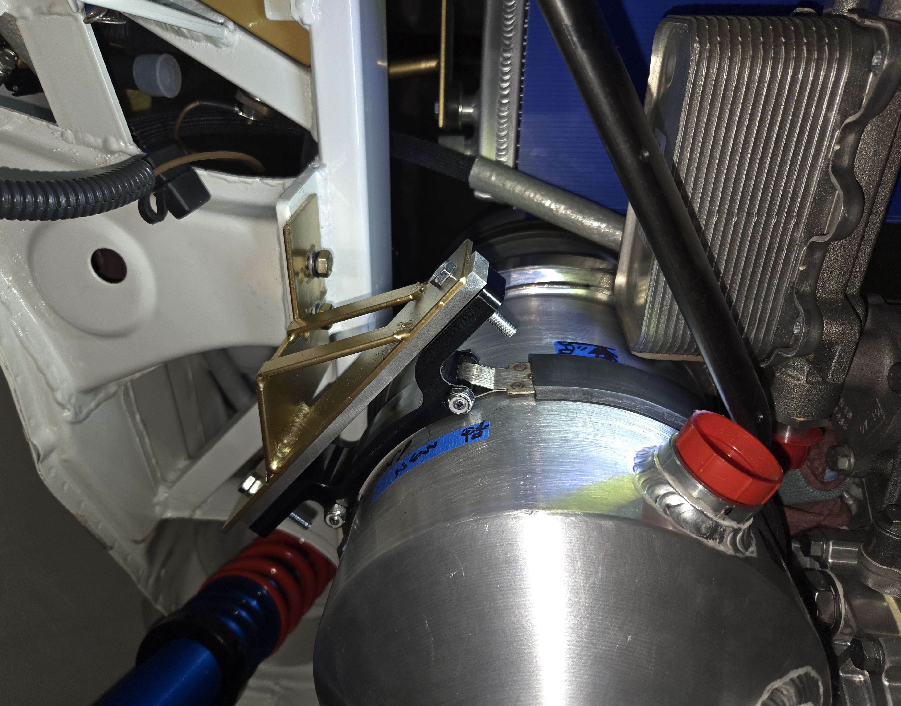

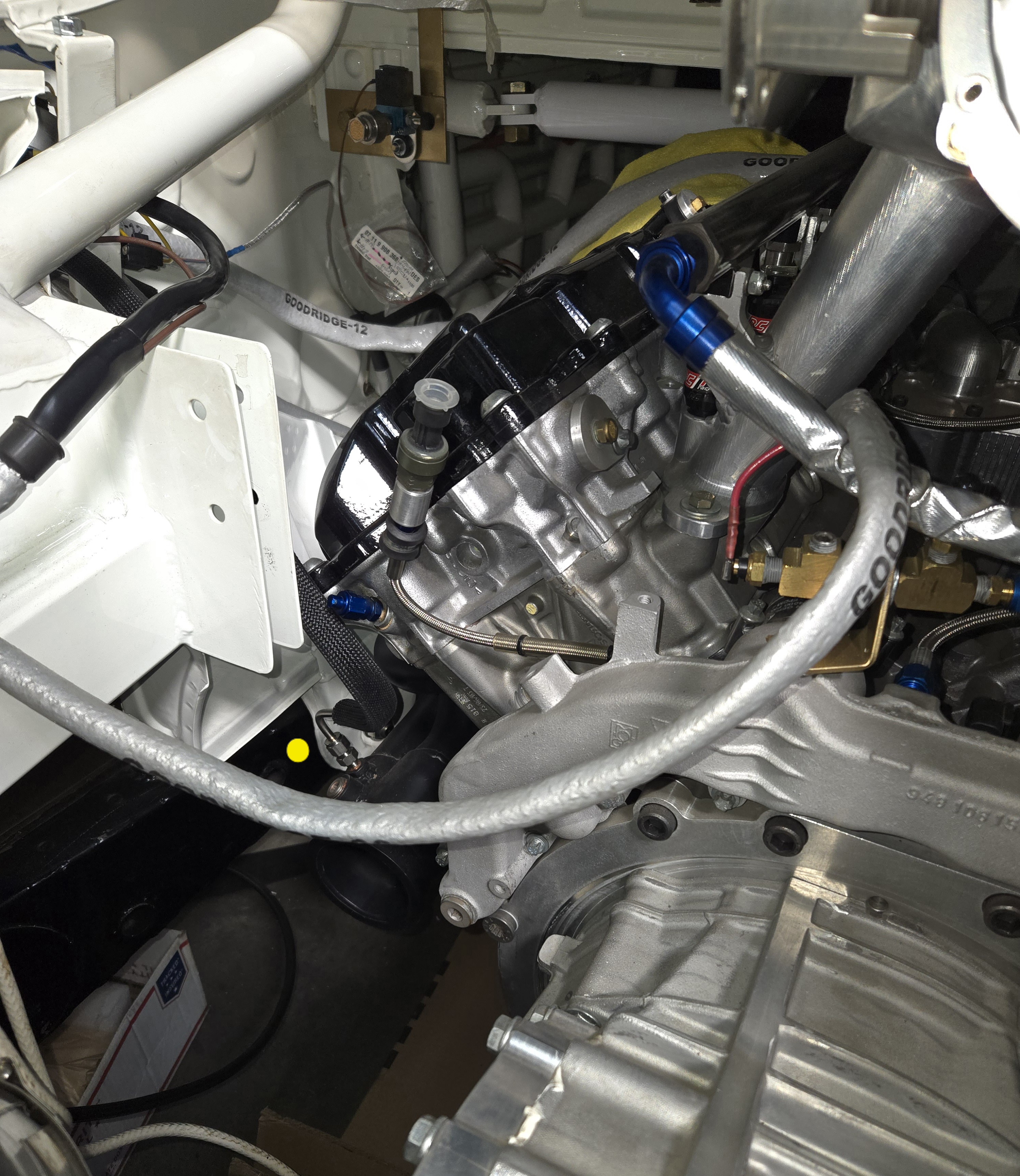

View of the lower bracket attacment for Aviaid dry sump oil tank; tight fit and but clears everything. Thin black thing stuck in there is an LED shop light...

technicalninja
QUOTE(Maltese Falcon @ Jan 21 2025, 01:16 PM) *
Tank to engine mounted heat exchanger clearance is pretty freaking close!
I'd bet 1000hp will cause deflection...
Even if the engine mounts are SOLID Titanium, I'd be worried about only an 1/8" of clearance.
Still "Bad to the Bone"!
Maltese Falcon
@tecnicalninja just a factory hard-mounted transaxle-to gear oil heat exchanger /probably will run pretty hot gear oil with sustained speeds + heavy throttle; then a higher mounted CSF air-to-coolant (independent of engine coolant + seperate pump) exchanger mounted in rear using the forced air stream...that's where most of the cooling takes place for the cooling of gear oil.
Two engine oil coolers (in L+R ¼ panels) will keep the oil (in tank as well) approx 170-180°.
Undershot pic makes some things look stacked >> but not the case.
technicalninja
I apologize!
It looked engine mounted in the pics.
I believe your engine is going to MOVE!
The car, the frame, the motor mounts, EVERYTHING is going to move.
Some more than others...
In fact, at your power to weight ratio FLIGHT is a possibility!

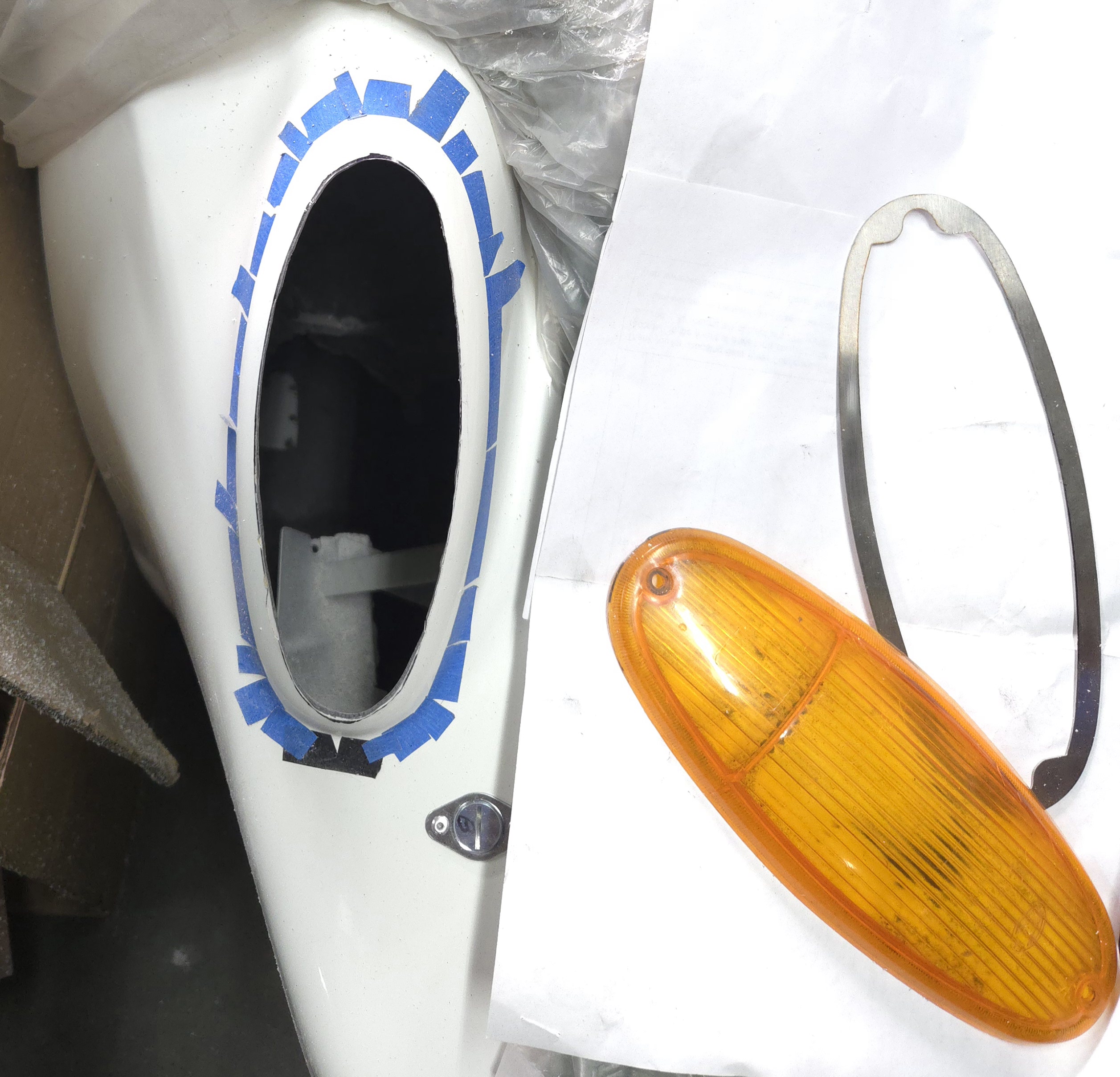

Today's work on the Drivers side front turn signal pod; make it resemble the Passenger side for the 3DG Auto headlights. My 'Marty San RWB saw -cutting 15 minutes of fame...hope that Rodger Sheridan isn't dropping tears over the shredding of his body kit biggrin.gif

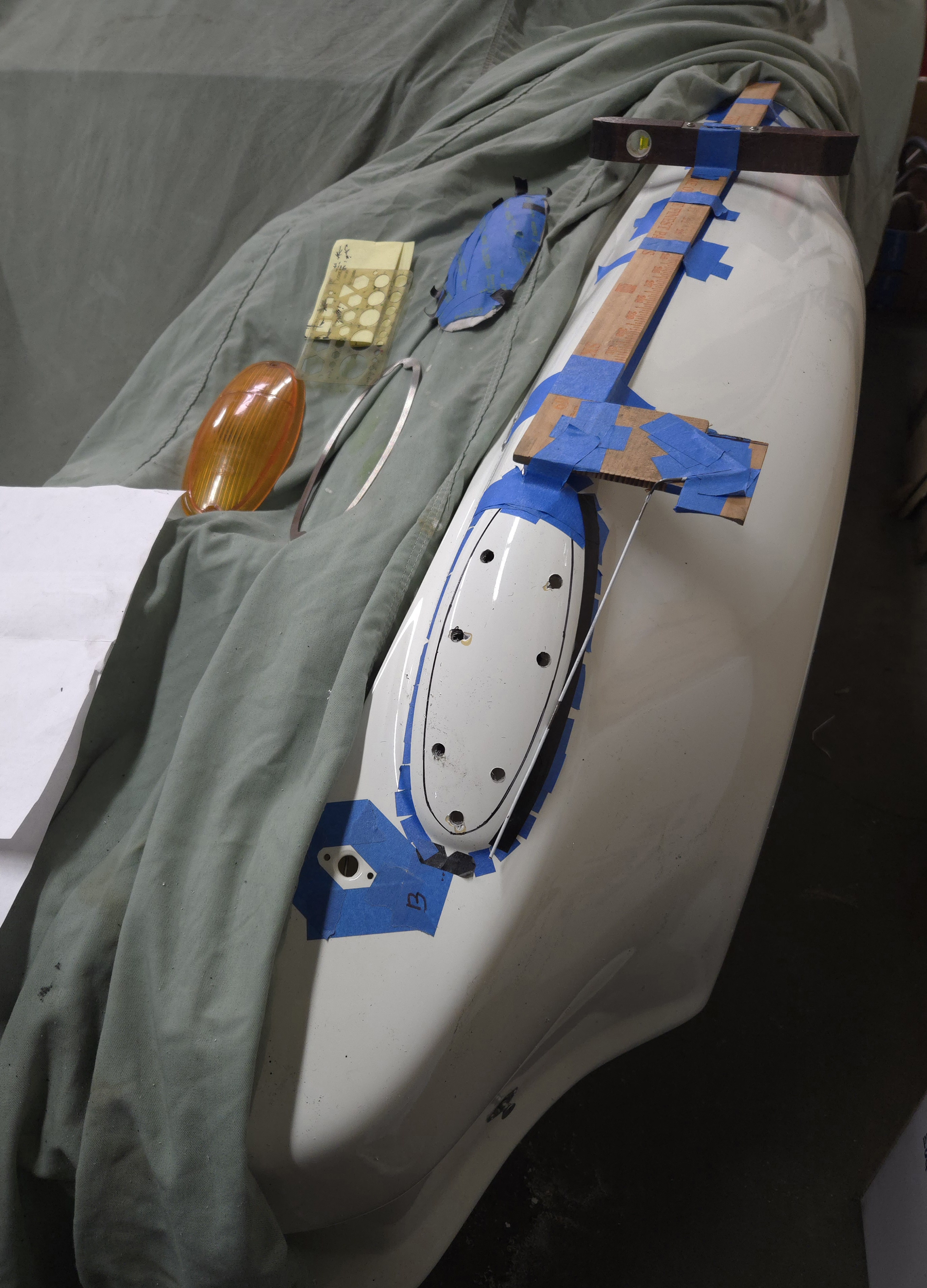

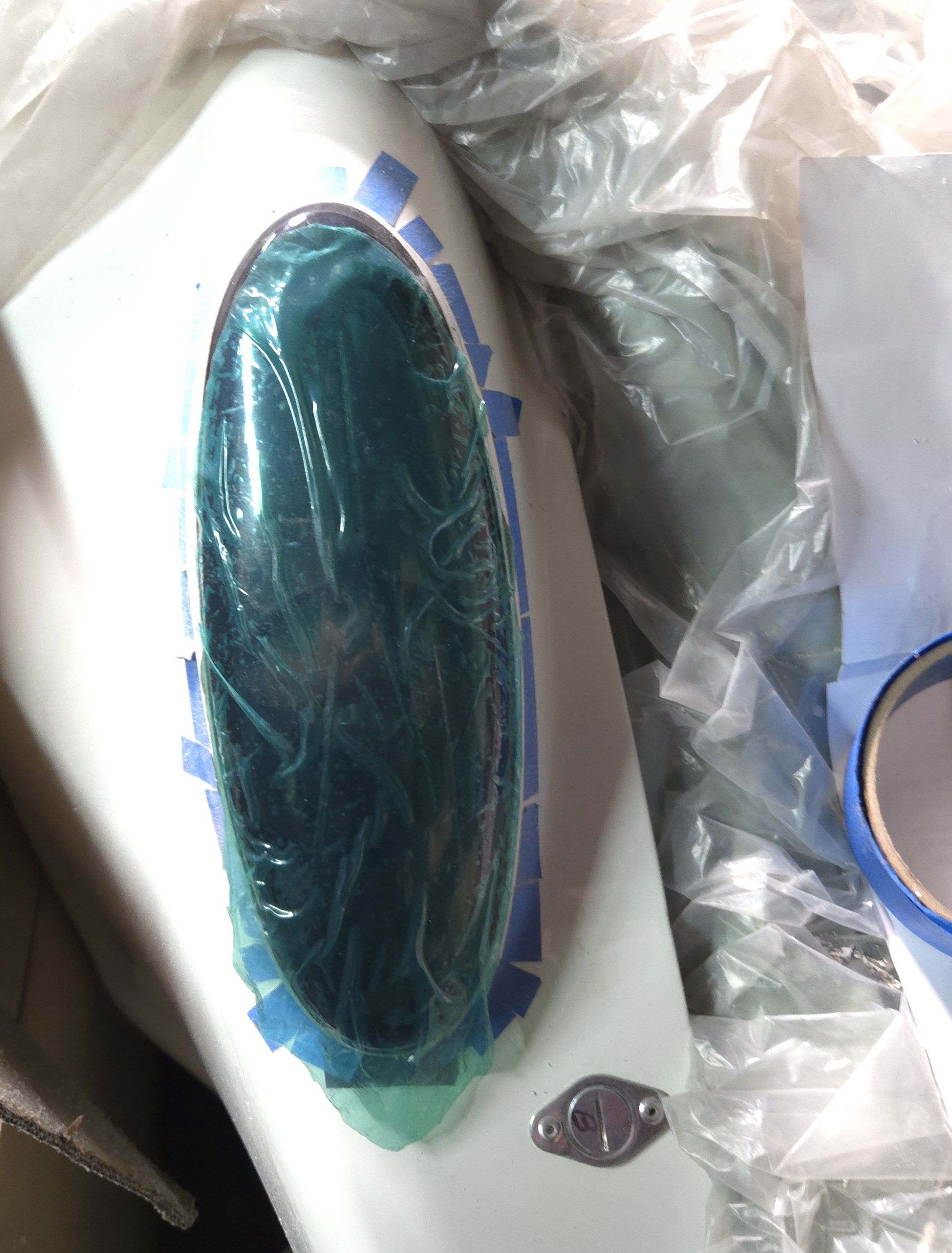

Basic jig-fixture for marking the proper raked angle at the top of the Sheridan fender/ 3dg-auto headlight area.
I've set the angle with a thin strip of black masking tape, and will follow while hand- block sanding with #200.
The new headlights are more pronounced than the oe turn lenses...so I want to keep these sitting into the cut-outs at a nice swept back angle.
Otherwise this mod could come out looking like a '59 Bug eye Sprite shades.gif
Maltese Falcon
...good set-up, now on to block sanding

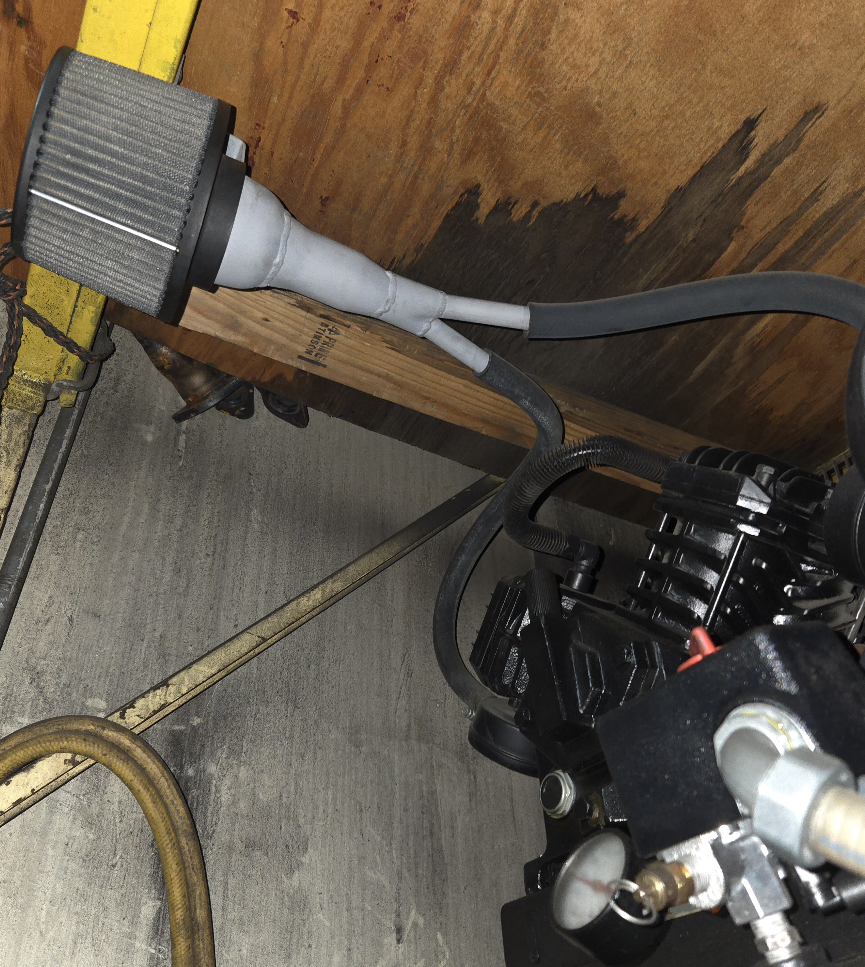

Shop compressor maintenance over the weekend; several years ago I fabricated this small intake manifold and upgrade to a K+N cotton-gauze cleanable /reuseable air filter. This gets serviced every 6 months, using the K+N service kit. The dirt from 6 months use fills up the 5 gallon bucket in solid
black water. Not a trace of dust can be found inside the 3" dia tube smile.gif

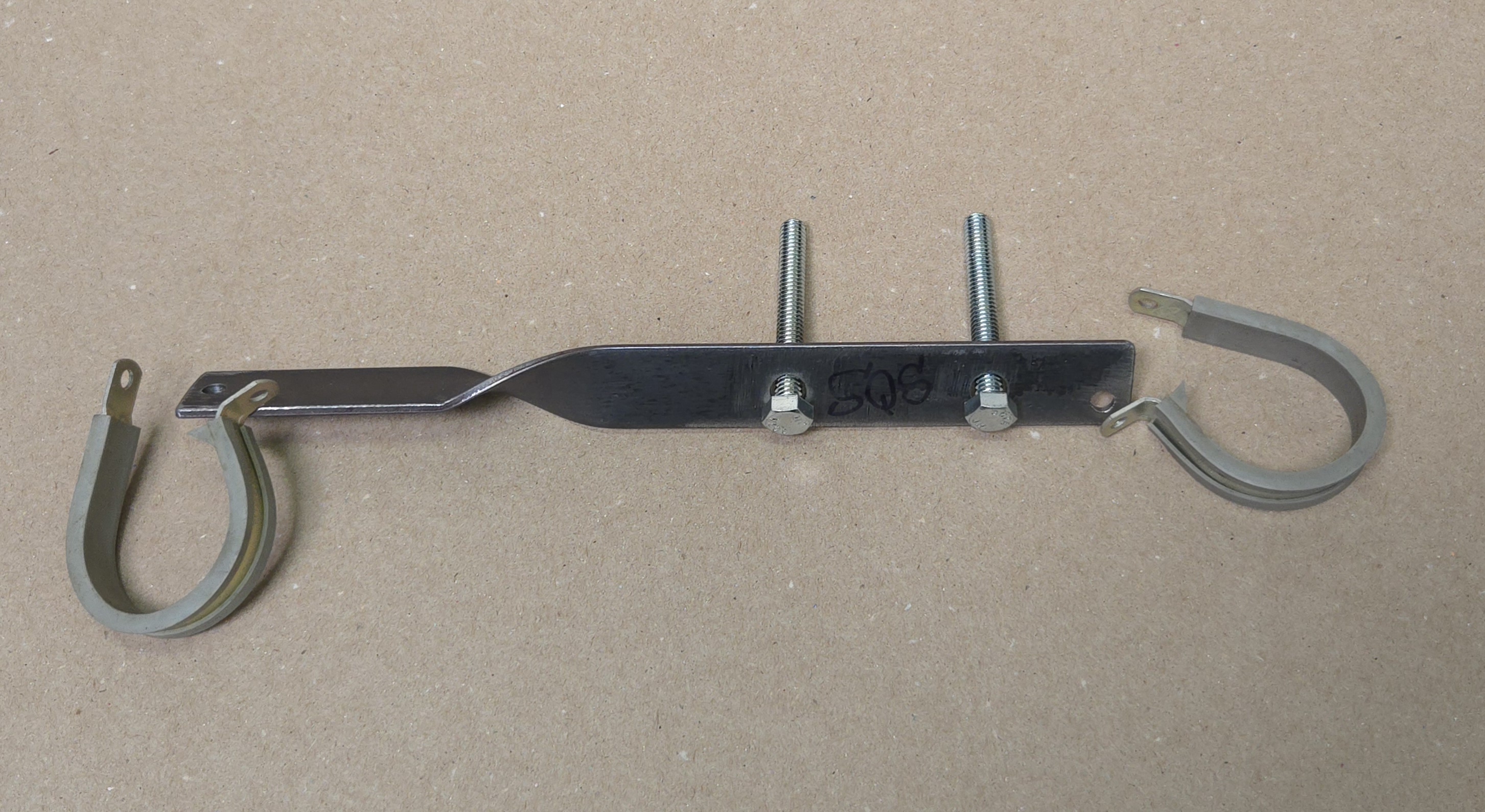

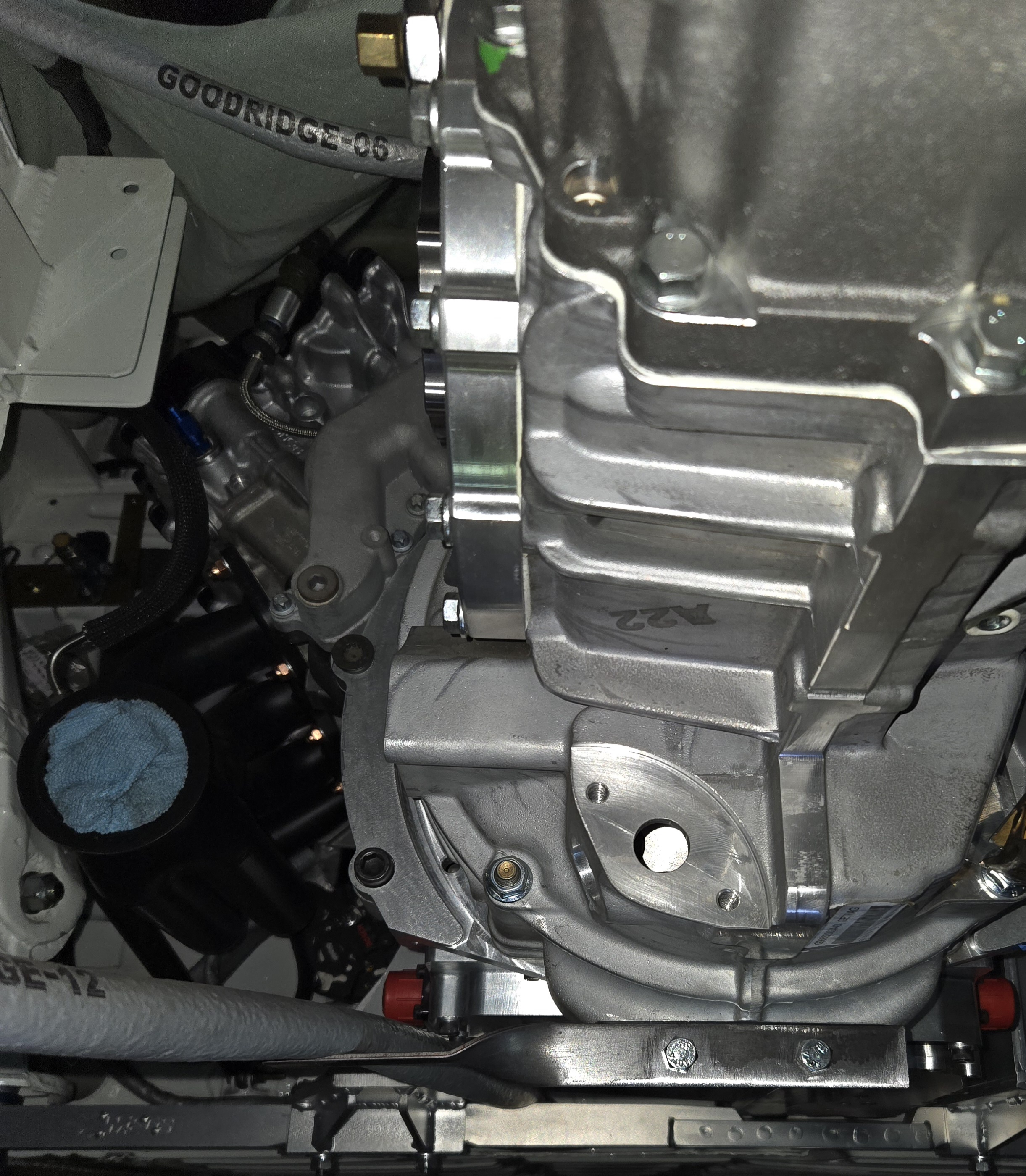

Making brackets: this one is mounted off of the bottom of trans. Left side holds the SQS shift cable, Right side holds a #16 oil supply line from dry sump tank.
Maltese Falcon
Bottom of GT2 trans & bracket area

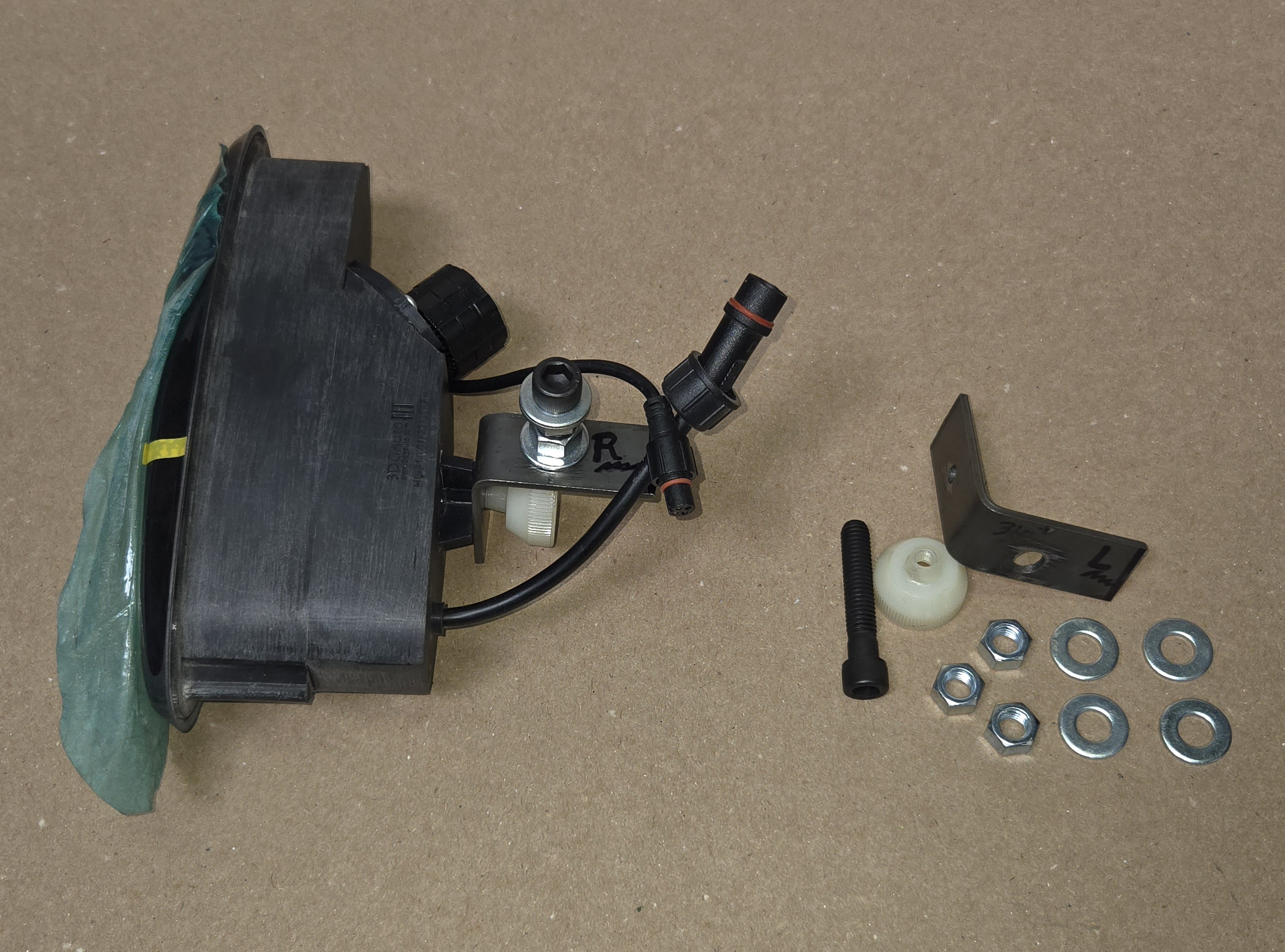

also made the Left + Right 3dgauto headlight mount brackets. I'm using the rear tail lamp 6mm thumbscrews as well/ quick disconnect from the Sheridan front body 'Clip when removal is needed.
The allen bolt sits in an existing 10mm size hole in the oe headlight bucket; easy job ! I made a sample of the brackets if anyone with a (Sheridan) body kit needs to replicate them.

ClayPerrine
QUOTE(Maltese Falcon @ Jan 27 2025, 04:51 PM) *
My GOD!! Even the compressor at MSDS has a header on it!!!!!
Maltese Falcon
QUOTE(ClayPerrine @ Feb 7 2025, 09:09 PM) *
ClayPerrine
QUOTE(Maltese Falcon @ Feb 8 2025, 01:23 PM) *
