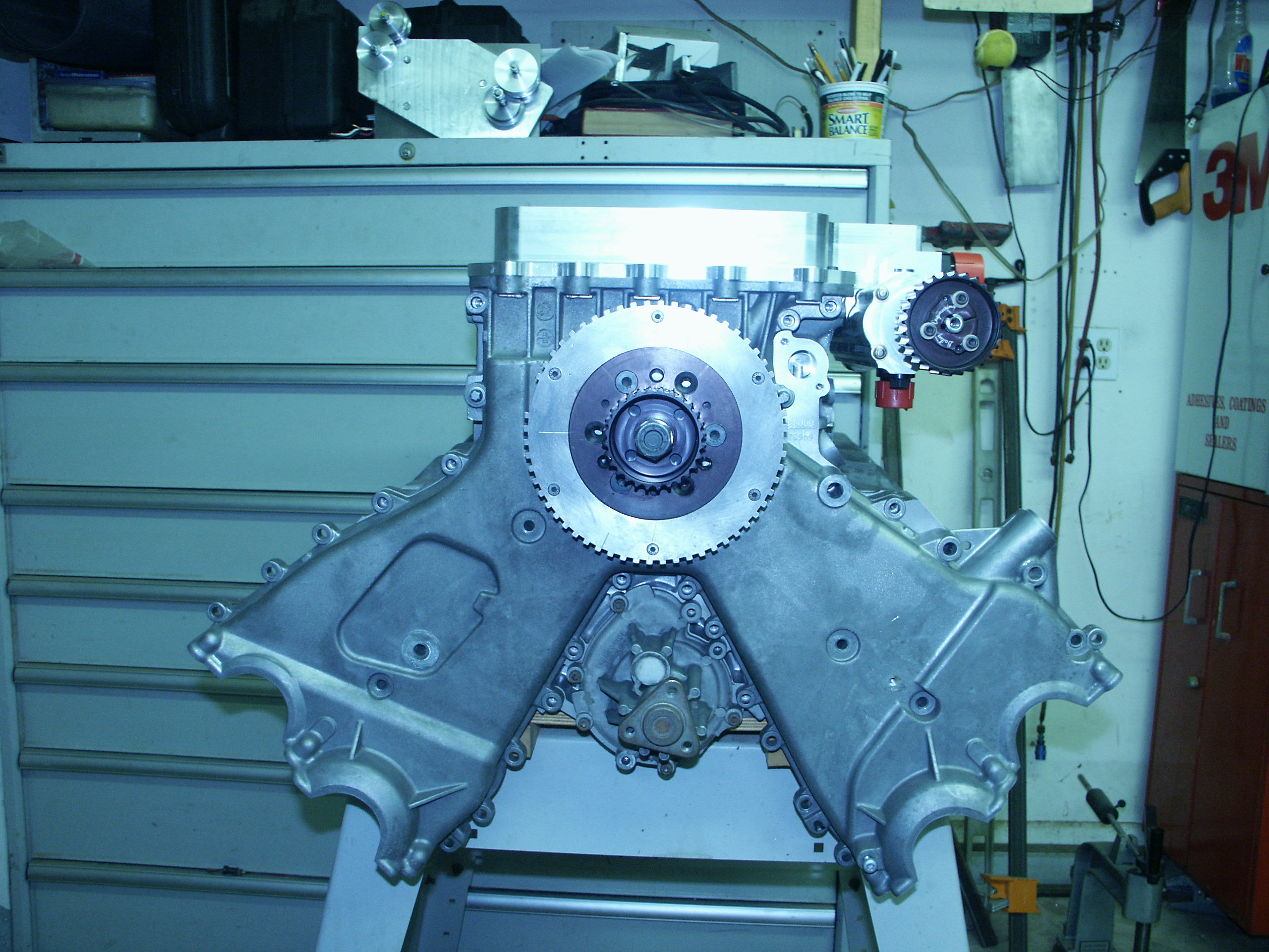

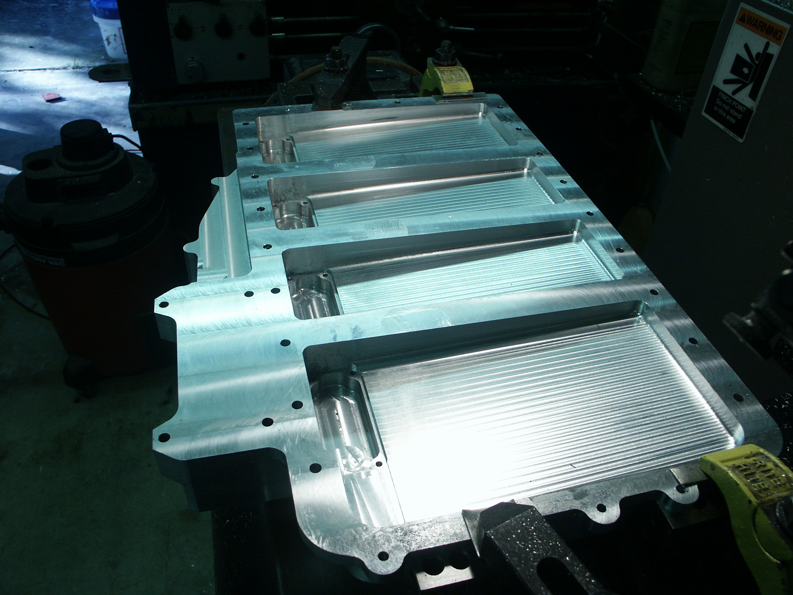

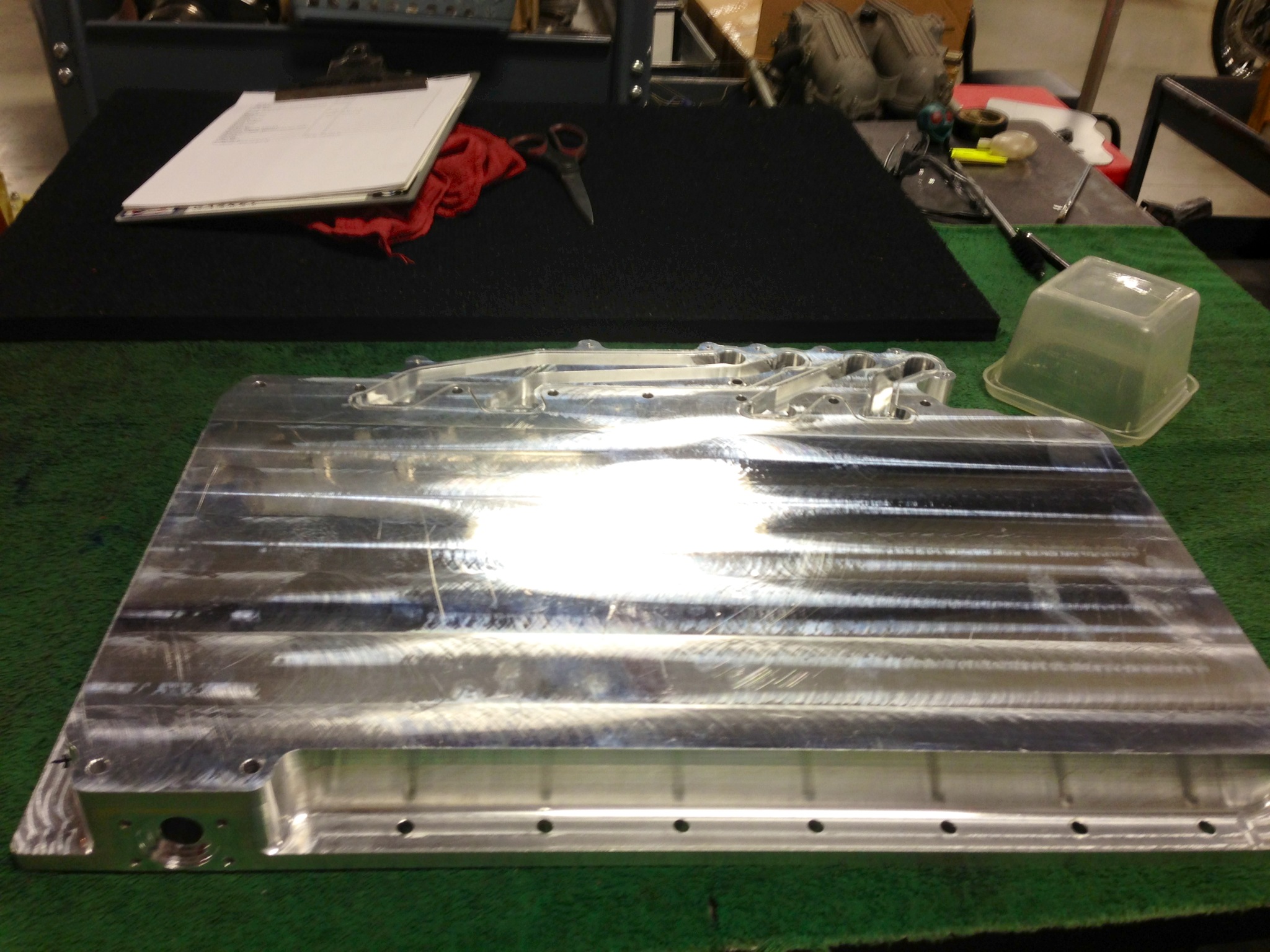

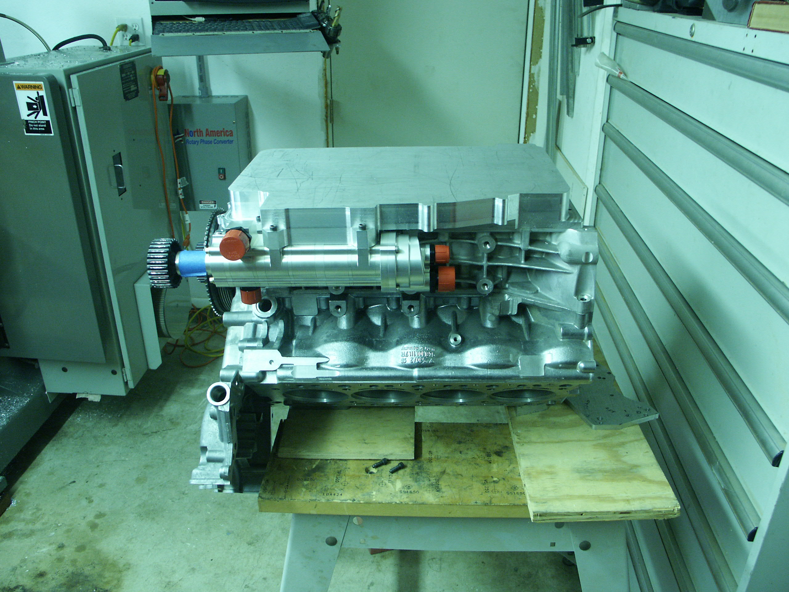

The new cnc aluminum oil pan , now 100% dry sump and a boatload of ground clearance compared to the oe Cayenne pan.
I wonder of this is what Porsche calls their new 4.6 "Flatcrank" engine design in the upcoming 918?
MartyClick to view attachment
Maltese Falcon
Another oil pan viewClick to view attachment
Woody
rick 918-S
Nice work on that pan.
Maltese Falcon
Thank you Rick !
Maltese Falcon
S'more machine work on the oil pan, dry sump chambersClick to view attachment smile.gif
Maltese Falcon
Just enough room in the edge (left +right )of the oil pan "Rail" for the #12 an turbo oil drains.Click to view attachment

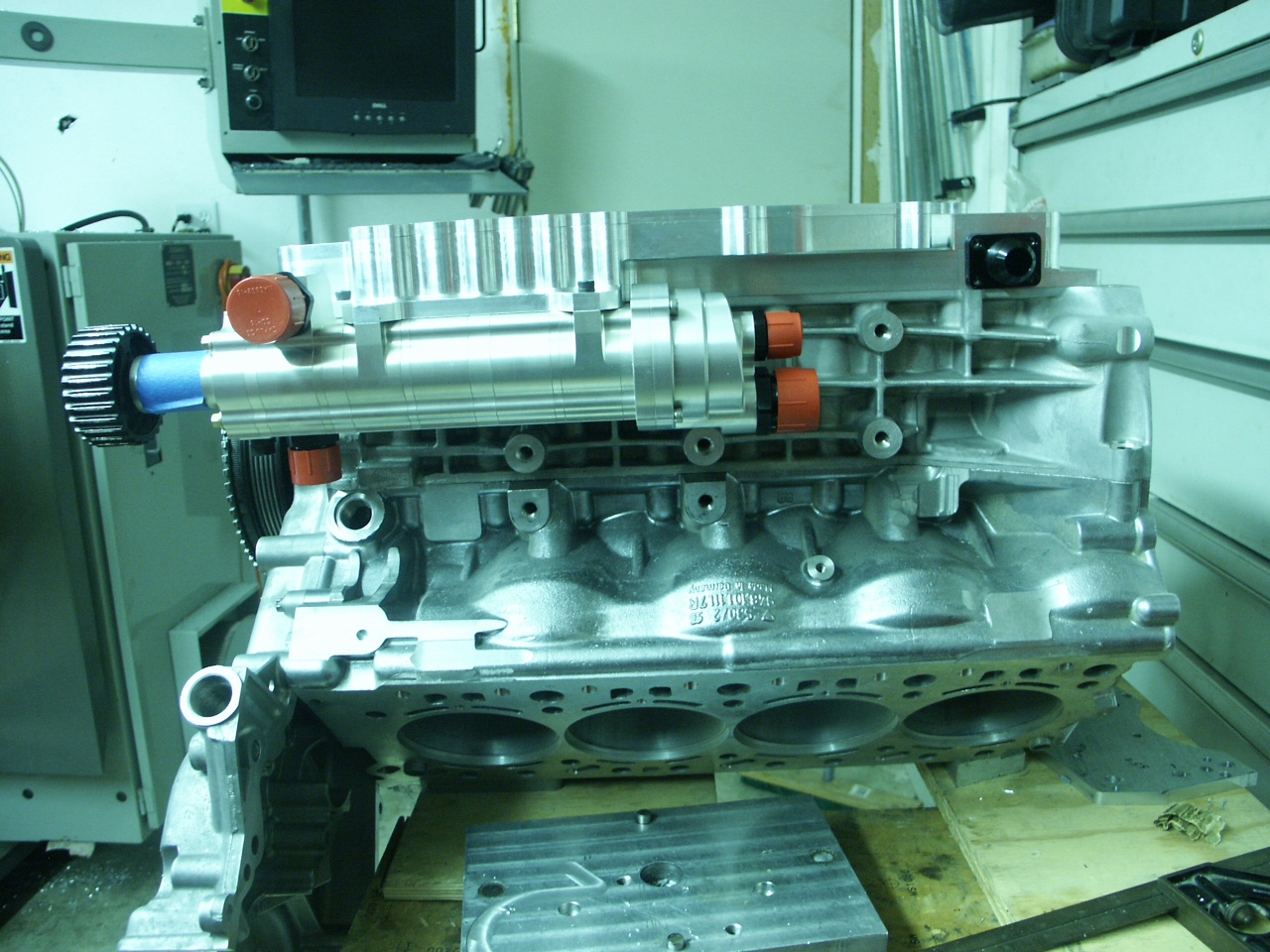

Maltese Falcon
Done, and # 12 a/n turbo oil drains in place.
Black fittings...other one on opposite side.
Pistons and rods coming in early August.

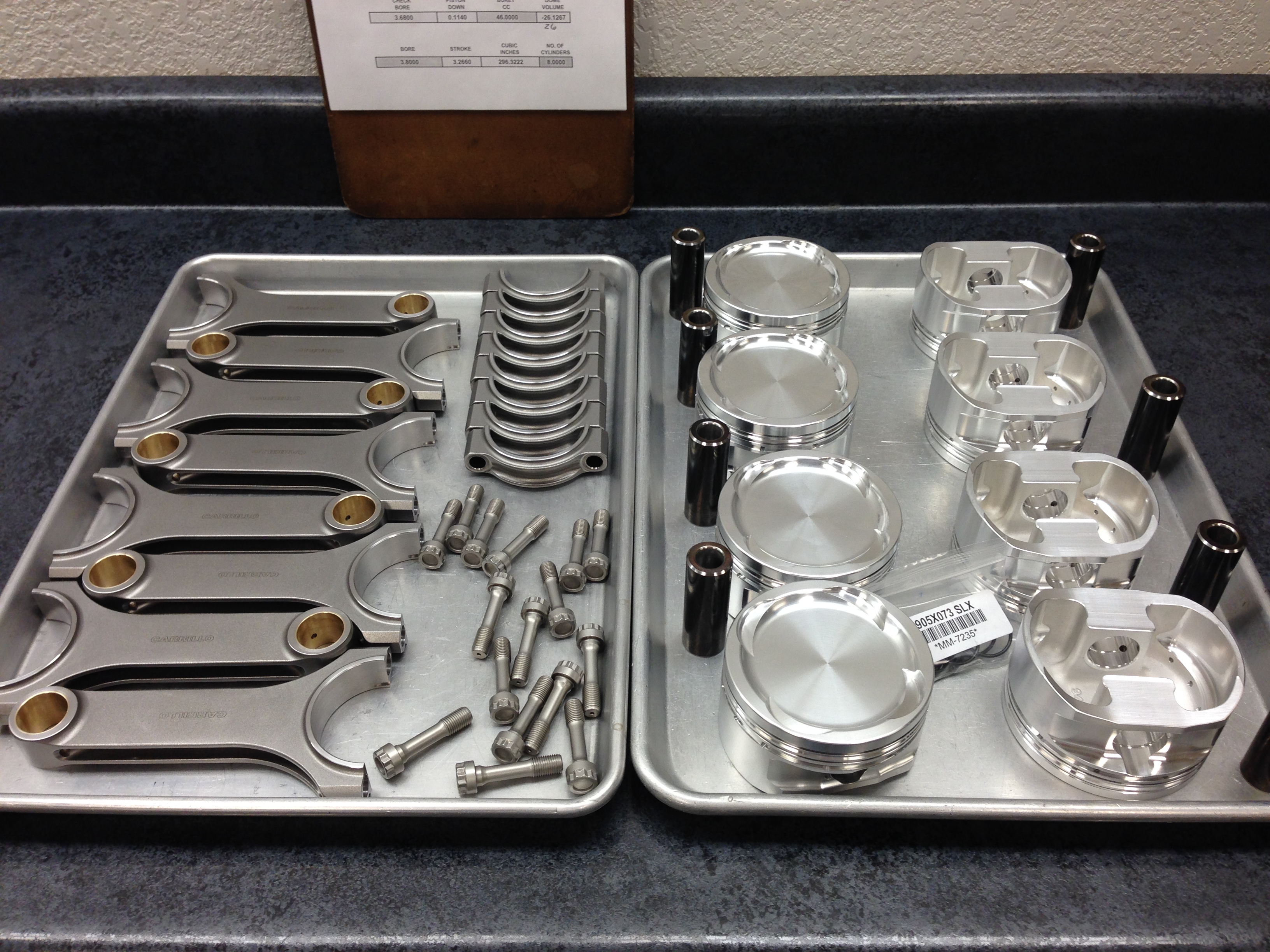

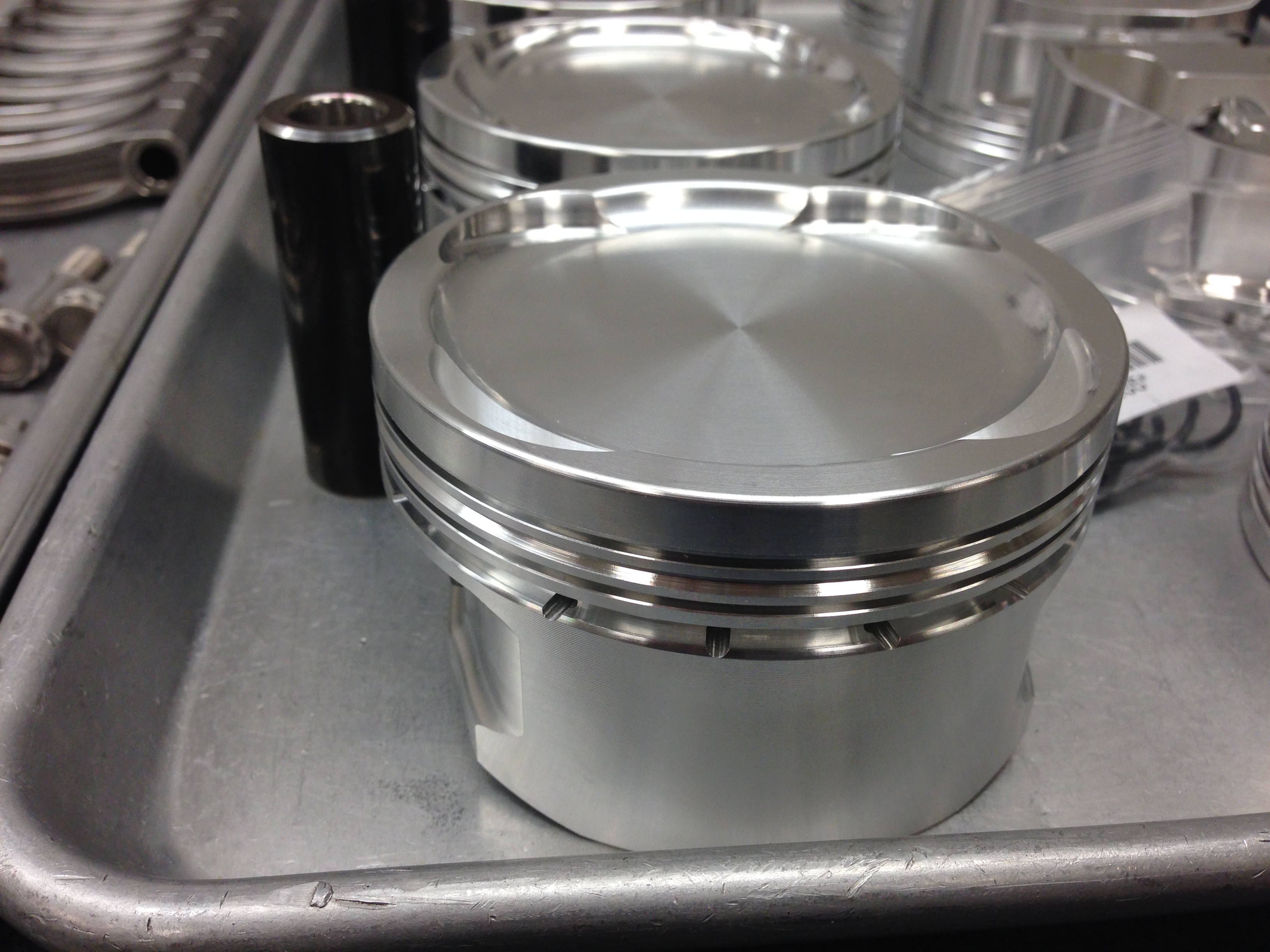

Pistons, rods + hardware arrived. Click to view attachment
Maltese Falcon
8.5:1 cr, 5.0L displacement, Carrillo mfg.Click to view attachment
Woody
Mike Bellis
Marty,
Any special coating for the pistons?
rick 918-S
Very nice!
Maltese Falcon
QUOTE(Mike Bellis @ Nov 17 2013, 03:32 PM) *
Marty,
I'll be weighing in on this with the engine builder this week. We have several heat dissipating things going on in the engine; piston oil squirters , specific forced-induction forged pistons, and lots of external oil cooling.
I am a fan of ceramic coated piston tops + valve faces.

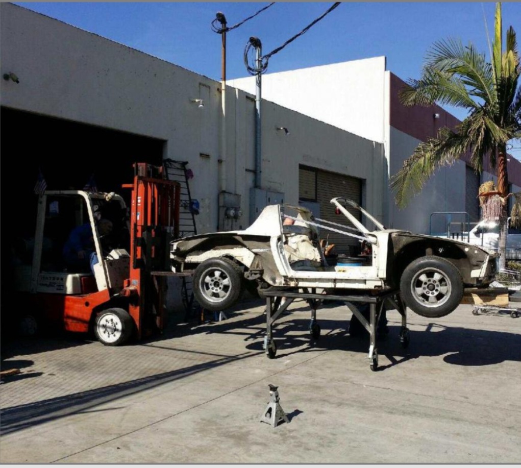

Two forklifts in unison placing the roller onto the dolly...

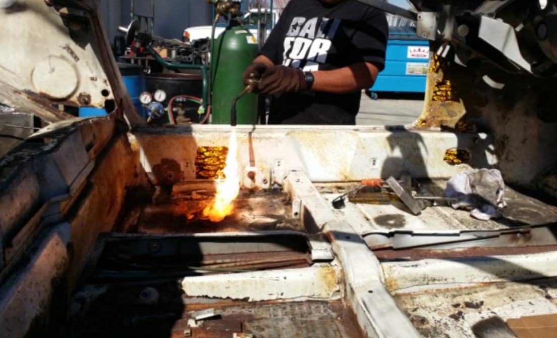

Removing the tar off the floorboards, heading out to the media blaster...then back to MSDS for more action.
Dasnowman
^^ Ummmmmm isn't the heat bad? going to warp and distort the metal?
I used a multi tool with a scraper tip worker great before heading to media blasting.
Maltese Falcon
Snowman, it is all in the " Time on target" and experienced torch skills. It works for us.

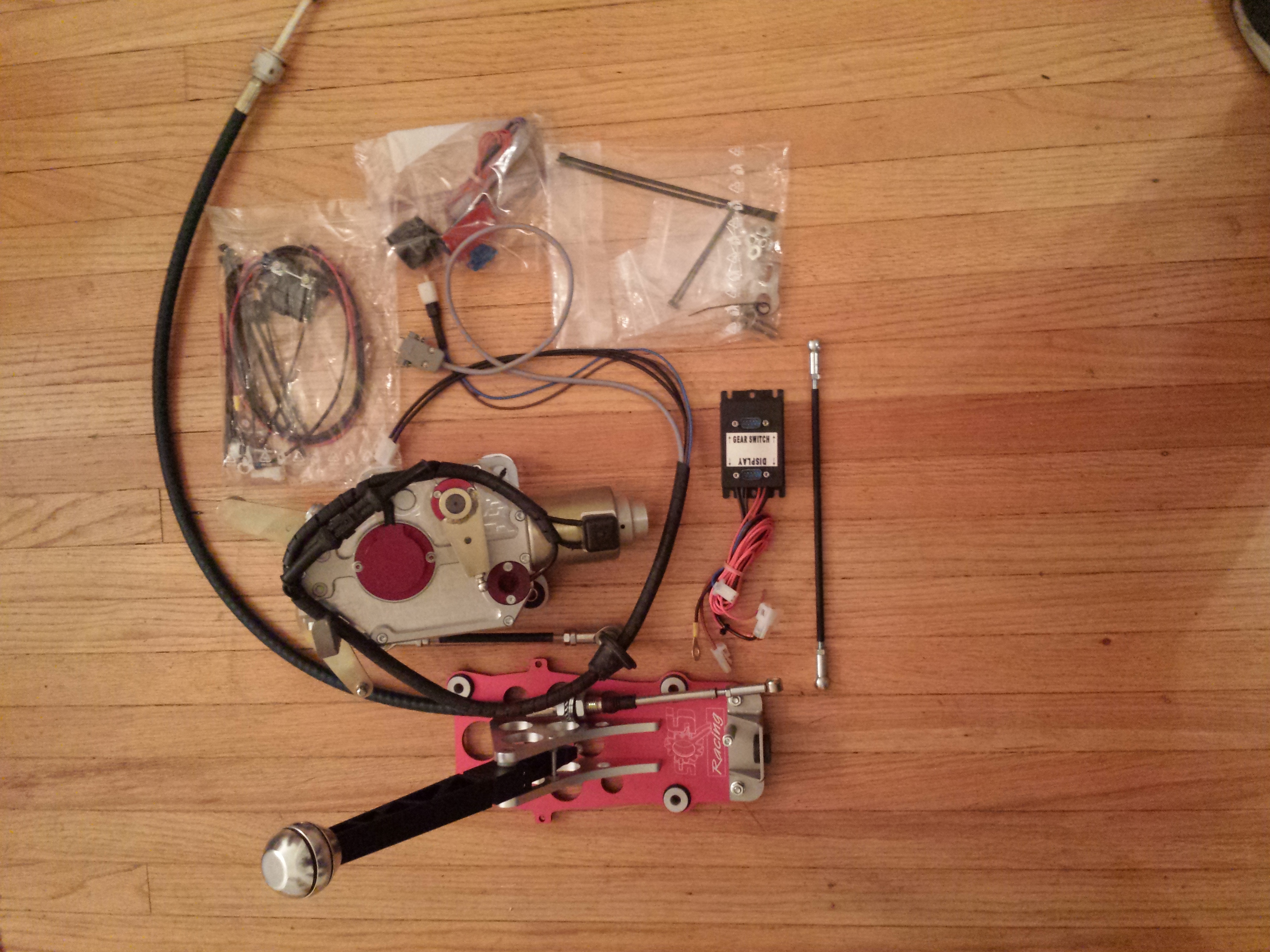

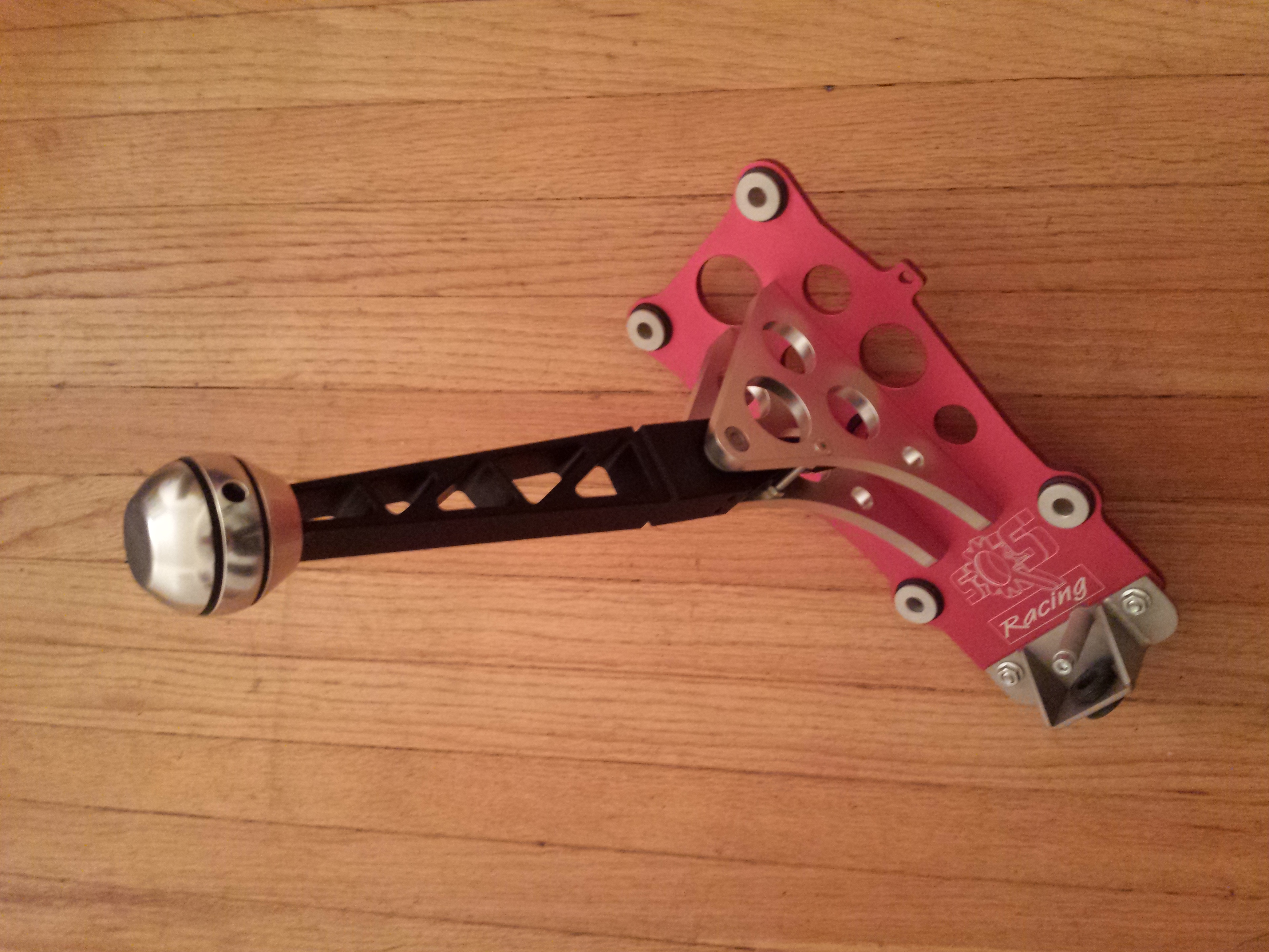

SQS sequential shifter system for the 996gt2 transaxle.
We will need to have a longer cable made for mid engine application. Click to view attachment
Maltese Falcon
SQS, sequential 6 speed shifter mechanism.
