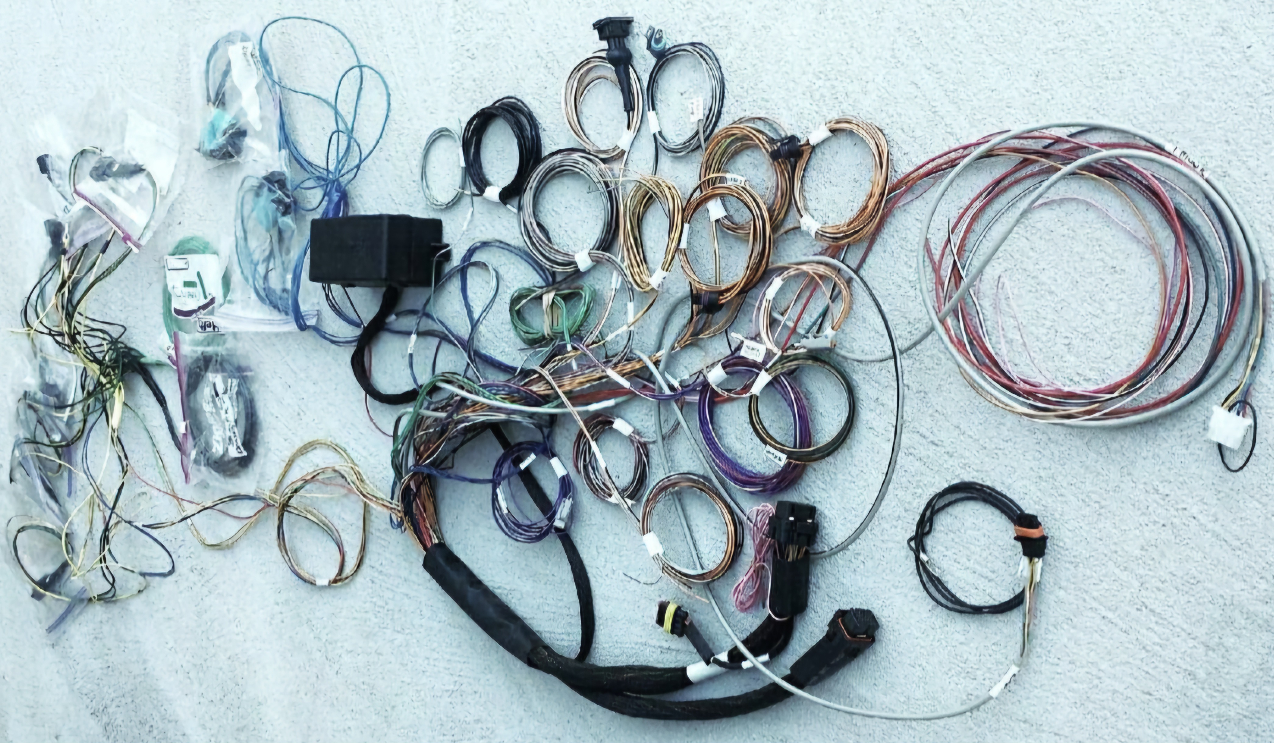

Halltech Elite 2500 was threatening to look at when I first opened all of the boxes. Their detailed illustrations, instructions, every cable + connector marked, and some assistance from our engine builder LB Bros. Porting made it a lot easier !
This ecu layout in picture is just for engine management; basic (custom made) main chassis wiring harness not shown, it's already been pulled through the bulkhead.

Let the connector connections begin! As I was getting started, I remembered that when I did the harness in my LS car, I struggled with change of direction when the harness went up and had to go the 90 degrees into the bulkhead connector.
The wires that were pinned into the upper positions of the connector need to be a bit longer than those in the lower positions. Mistakes in these lengths forces some wire length back into the main trunk and it just looks messy. I'm not doing service loops anywhere so I need to be as accurate as possible.
So I did some measuring and mocked up an in-space replica of the relationship between the ECU and the connector so I can "build to fit" and I should be good to go.
I started with the four, 25 amp, 12 ga wires that'll feed:

If you're going to have two 90 degree bends the in harness, one from the floor-to-vertical and one from vertical-to-the-bulkhead, won't the two bends cancel out any length changes? You'd just have to make sure to keep the wires straight and untwisted while laying them out.
QUOTE(BillC @ Dec 15 2024, 06:09 PM) *
@BillC - If only it were that easy. Nearly every one of the 60+ wires starts in a different location relative to the bulkhead connectors and doesn't necessarily end up in the same relative location because (and this is just one reason) some wires that originate in the same ECU connector (there are 5 at the ECU) end up in different bulkhead connectors (there are 3 of those).
I could go on but let's just say, I know my approach works, even if it's more time consuming.

Ignition, injection and one of the wide band O2 sensors pinned! It's coming along nicely.
Every measurement, wire cut, strip, crimp and insert is at once tedious and satisfying. I find I get into a mental zone where I think it's been 20 minutes but I look up and a couple hours have gone by.
It's easy to understand how motorsport-level harnesses cost ten$ of thou$and$. Parts are pricey, labor is intensive.

No video this week as the wiring work doesn't really lend itself to being watched. So it's pics of this part of the build. I'll do a video "wrap up" once the work is something a bit less tedious and repetative.
Anyway, here's the "VCU" (Vehicle Control Unit = ECU + PDM) and main harness:
- the connectors section takes care of the engine and rear body electrics: lights, etc.
- there's a CAN section with three connections that'll live in the cabin (there will be a CAN connection in the engine compartment, just in case)
- the remainder of the harness supports all the switches and power for interior stuff - ignition, lights, wipers, signals, gauges, seat heat, power windows, and... wait for it... Cruise Control!
Yep, this ECU supports real deal cruise. I'm also future-proofing the harness by building in circuits for things I may add going forward, including a Sport Exhaust mode. I can have the ECU control it as well as have an override button.
The Haltech stuff is crazy capable.
